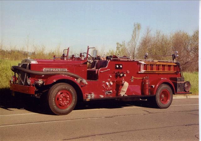

    Panella Trucking in Stockton Ca restored a early mack a 50'something model looks real good

    Nice rig. Strong runners too. Maxi Dyne? Here is my Hall-Scott powered '49 Sterling.

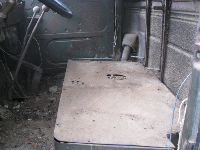

    Just so that you will have something to look at, I pulled an inspection cover off of the bottom of the transmission. I now know where all of the seat cushioning went to:eek:

    Had a couple of hours to work on the truck today. I pulled what was left of the seats out and cleaned up what the rats had left behind. My objective was to pull the fuel tank so that I can get it cleaned out. I ran into a little snag with the center cross bracket. There are three bolts in the front of the bracket with nuts that are almost impossible to get to. Since I wanted to make the most of my limited time, I decided to move to the floor board area. I was able to get the floor plate out. There is one small section that will need to be patched on the plate itself. There is a hole in the floor of the cab that will need some attention, as well as both rockers. I haven't learned how insert the images where they are large and to where I can post comments in between. So, they are listed below.
