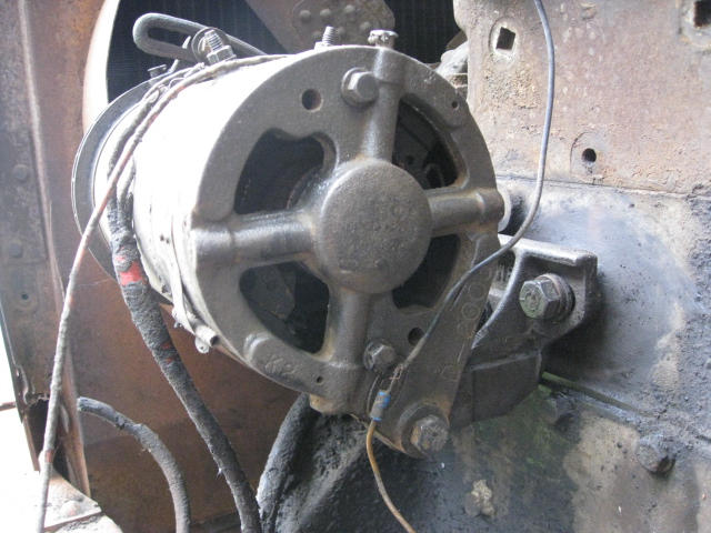

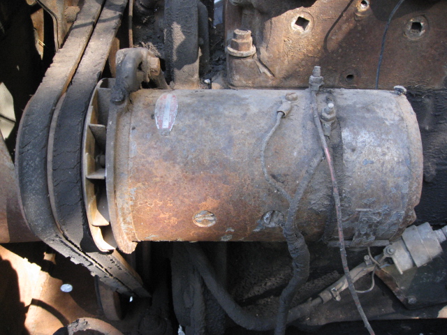

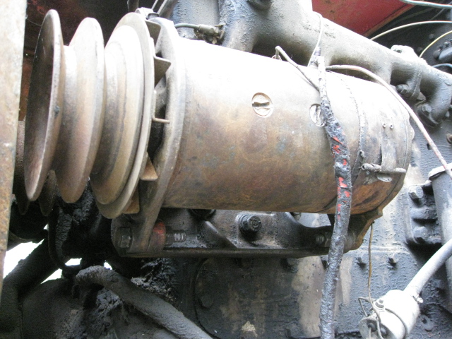

    Quick update. Still waiting for the father-in-law to come over and help. Decided to pull the generator off and clean it up. There were a lot of dirt dobber nests inside and it was very dirty. I pulled the end off, and blew it out real good with an air hose. The bearings appeared to be good and tight, and the brushes looked fine, so I didn't dis***emble it completely. I polished the commutator with some fine sandpaper and greased the bearing. I also cleaned the bracket up and put it back on the truck. The fan belts were obviously junk, so I took them off. I will replace them whenever I get the engine running. Here are a few pics below.

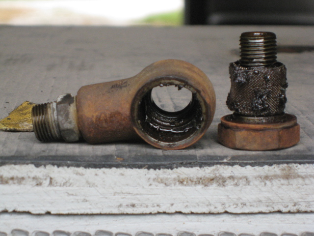

    I decided to pull the carburetor as well to see what the inside looked like. The truck has been sitting idle since 1995. It was not as bad as I thought. The floats were not stuck, which was a good thing. The screen was pretty nasty though and there was some gummy old fuel clogging the drain plugs. I am not going to rebuild the carb at this time. I just want to clean it up for this weekend to see if the engine is going to start and run. Once I know that, I will pull it down again, and thoroughly clean it. The gasket did come apart on me when I took it apart. No chance of finding it in a hurry. So, I bought some gasket material and made one myself. I posted pics below of the gasket outline, but not of the gasket after I cut it out. It was my first time to make a gasket and I was pretty embarr***ed at the result. The good news is, the gasket covered the surfaces and didn't cover any holes!! That is where I am at this point. The plug wires will arrive in the morning and I will make them up tomorrow. I will put everything back together and look forward to hopefully cranking on Saturday.

    Oops, I forgot to post this pic of the screen once I cleaned it. I meant to put it in the rotation of pics above. Sorry.

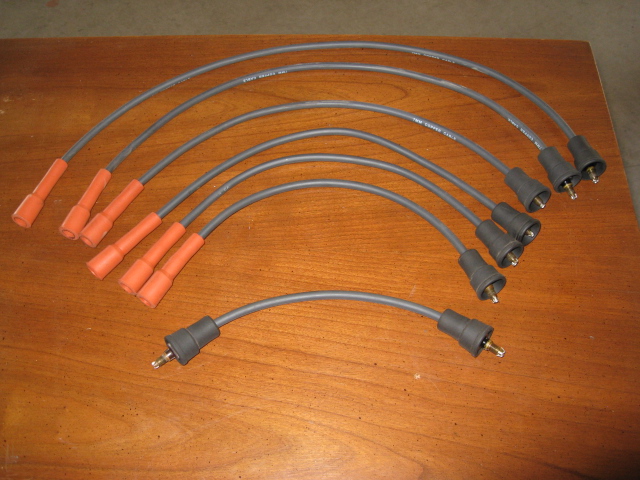

    Ok, so I picked up the universal set of plug wires today. I go to strip back the insulation so that I can expose copper wires. Guess what? No wires. Just a bunch of soft fiber material. That was not going to work for this application. I need the wires to fold back over the threaded tips. So, I returned the wires and started my search for copper core wire. Five stops and no luck. Finally, I try the tractor place. They only had a wiring kit for a 4-cylinder. They did, however, have copper core wire that they sold by the foot. They also had the boots and connectors. So, I got the parts (for only $2 more than the universal kit that wouldn't work) and headed home to make the wires up. Pretty simple. Pics are below. My father-in-law is coming over tomorrow and we are going to try and fire the old girl up. I'll come back at some point tomorrow with the results.
