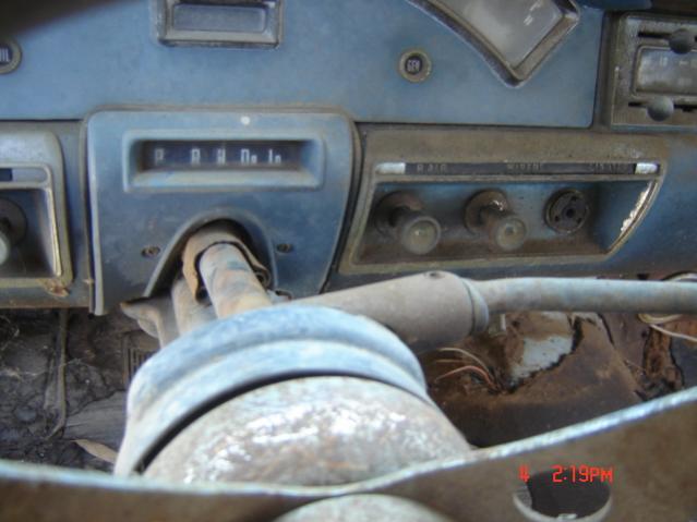

    okay guys so a semi-major breakthrough MAYBE for me today.....
    i brought my car home from the mechanic, he DIDNT CHARGE ME cuz he felt bad he couldnt fix it for me. so.... when i got at my grandmas i took this one bar that i posted a 'wanted ad' for, and i think it may work.... i think i need some rubber washers and a roach clip. but.... would THIS DEFINATLEY work for a column shifter??
  29. luvzccr
    Joined: Dec 10, 2006
    Posts: 668
    luvzccr
    and this is a pic of my pedal setup hitting the yblock throttle linkage setup.... i think i know a way around this, but not to sure.... it involves not using this whole setup though....
  30. Rocket Scientist Chris
    Posts: 632
    Not using the "whole setup" will prevent your Ford-O-matic from going into first gear when you step on the gas. A linkage from that assembly extends down to the transmission (not sure if you have this part :confused: ). It's not really a problem in normal driving. Of course, you can always put it into first from the shifter.
    It looks like you could get the car driveable by fabing a linkage (Home Depot 3/16 rod) with two short right angle bends on either end. These will have to be made to accept the the retaining clip mentioned earlier. This link will connect to the carb and the present trottle link sticking up. The other linkage bits you have in the picture will not be used. Make sure the new linkage operates smoothly from idle position to wide open.
    You'll need a throttle return spring (preferably two). These are available at NAPA or where ever you get car parts (in fact, you can find a bunch of them on the cheapy, quick fix parts isle of most parts stores :) ). Attach the springs to the linkage and another anchor point so the carb closes when you take your foot off the pedal.
    Again, this should get the car operational. But, you won't have first gear on heavy acceleration. Just 2nd and 3rd as normal.
    Hope this helps!:)
