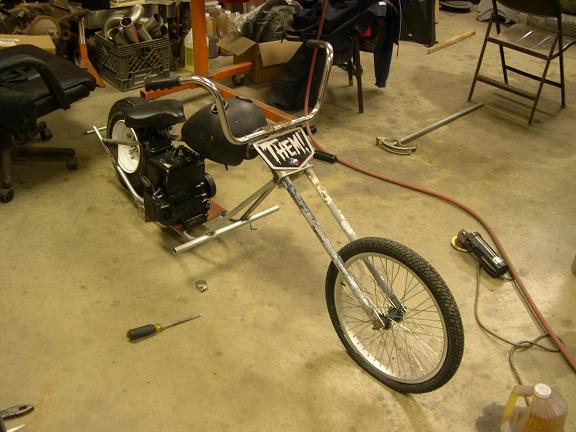

    I know some think minibikes don't belong on the board and I appologize to all of you...but oh well! A million thank yous to Johnny Gringo for the tank! Gonna have less than $100 in it by the time it's rideable (pushing hard for the roundup) Here it is:

    That's too damn cool...I was thinking of messing around with something like that, what a great design...is that conduit or pipe bent up into a frame? What's the tank off of? How are you going to drive the rear wheel?

    you was right..it's perfect on there...damn good job man
    and mercman its a paughco of some kind...aint sure they still make it

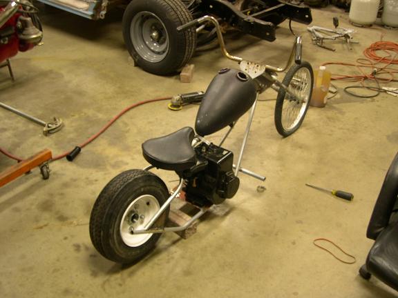

    MercMan - yeah, it's just EMT (elictrical conduit) bent with a conduit bender...and a vise and my arms and feet, anything needed to get it in the right shape. Then engine has a clutch on it...gonna weld a sprocket to the rear wheel and use a chain.
    Those plates on the rear are don't have holes in em for the axle yet because I didn't have an axle.

    Looks great man. If you were a rich dude, it would be scarry what you would turn out!! You definately have a great eye for design.

    That's just sweet...what a neat little project (like I need another)..That tank fits so right...

    Wicked cool build so far, Eric...
    ...glad to see that your talents spill over from plastic to metal!!

    Hey, anyone who knows about this stuff...
    Using a centripital clutch...can it be installed backwards? Like with the sprocket on the inside? I know it would make installing the chain a bit more difficult, but I'm willing to deal with that.
    Just trying to get the engine as close to center as I can.

    Yep, it works. If the chain line is good it works either way.

    Yep, they are reversable...and they can work as a drive-drum, too!!! [​IMG]
    (I used one to power my bike...the clutch drum drives the tire directly...never slips unless it's wet!)
