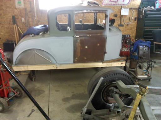

    Just thought I'd put up some progress picks been awhile since I posted.

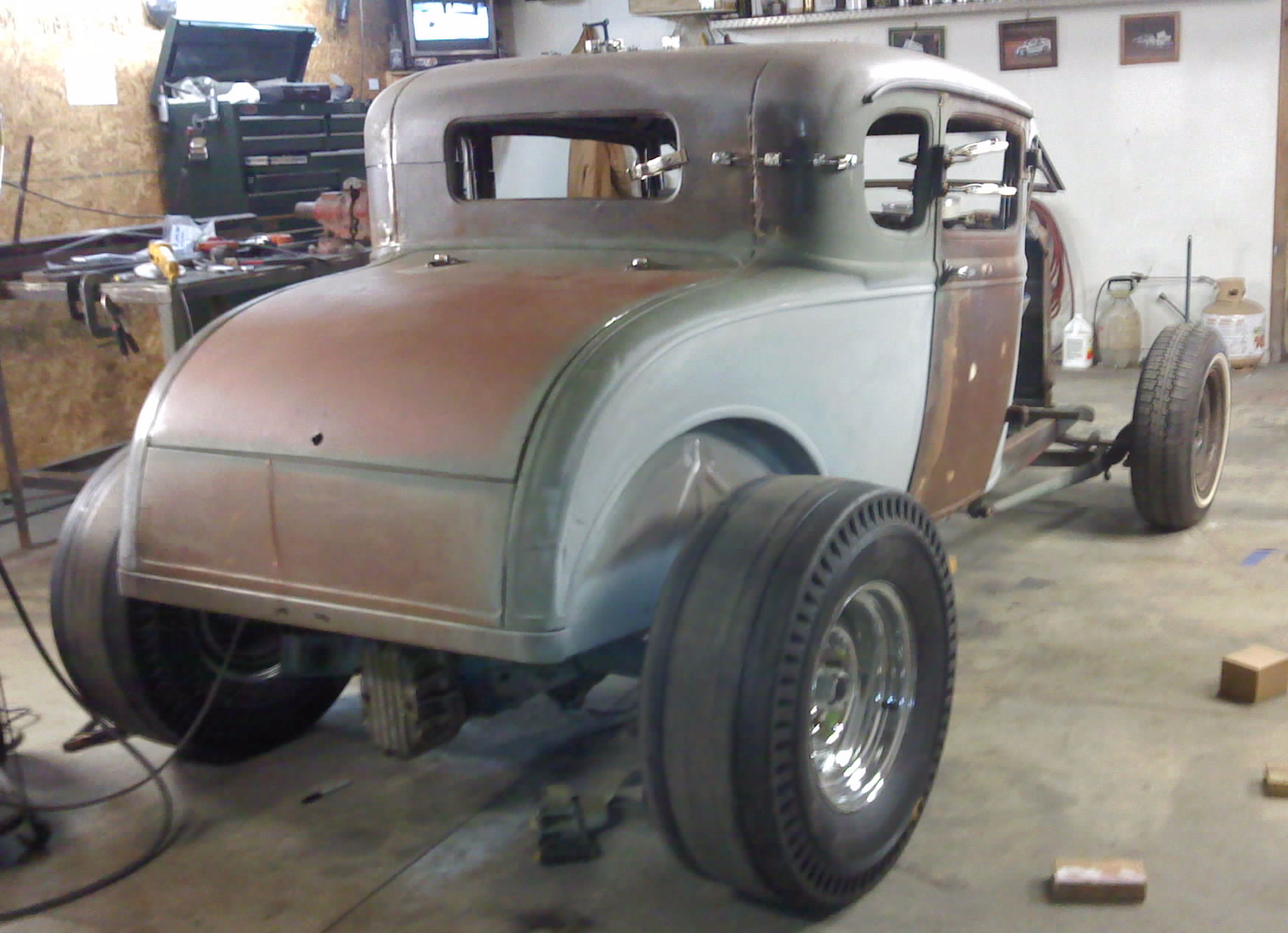

    Sorry Brent here are a couple pics to give you an idea what they look like. I first saw these style hinges on Mr Fords coupe and really liked them. I had some issues getting the other hinges to work so I decided to change. The one problem Is they are built to follow the contour of the humpback and the coupe has a much flatter surface. I have not figured what I'm going to do to fix that yet.
    Pincher I used a howells insert but I won't recomend it to anyone else. I was unhappy with the amount of crown and spent way too much time getting it where I am now and am still not happy with it. May oren the roof back up anyhow not sure yet.

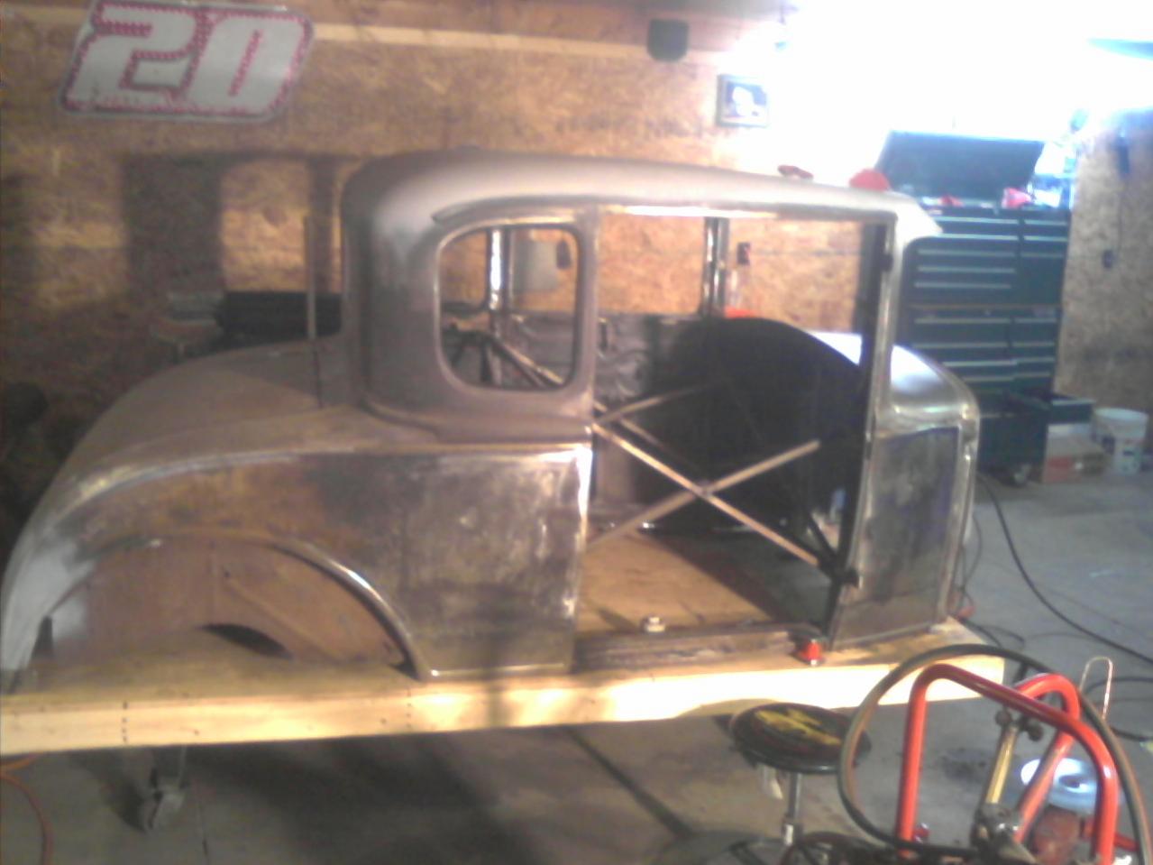

    Got back to work on the coupe finally! Life threw me a couple curve balls and I'm finally getting back to normal. Chopped the frame up put two more inches of kick in the rear. Pie cut the bones and built mounts. Finished the truck arms. I'm to the point that I need to spend some money to keep going. I'm kind of jumping around now doing what I can without spending any $$$.

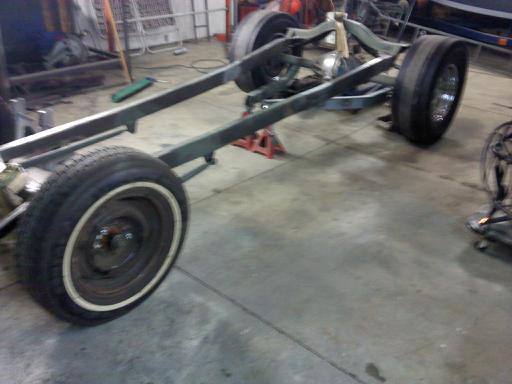

    Motor is done frame is painted quickchange is fresh trans is gone through. This is all I have for now more soon.

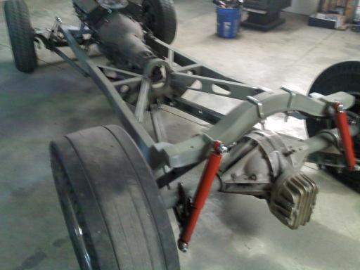

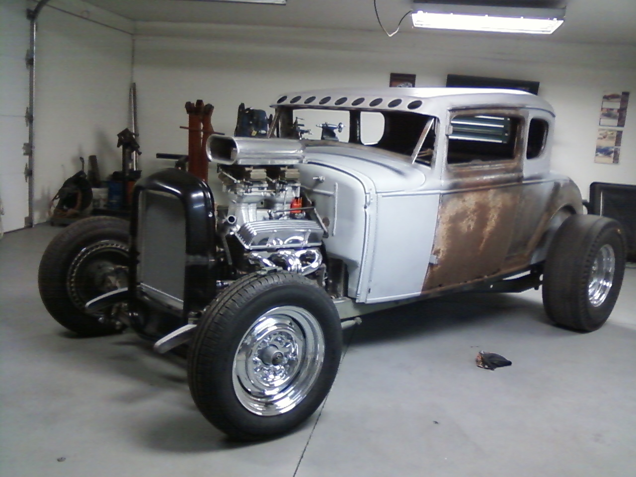

    Here is one of the final mock up pics. some of the visable changes since this pic are lake style headers, got rid of the truck arms and went with ladder bars to tuck them up in better. There have been a bunch more changes that are not so visiable. This is my first hot rod build so alot of things have been done cut off then re done. I hope to have a rolling ch***is in a week or two if the platers ever get my axle back to me.
