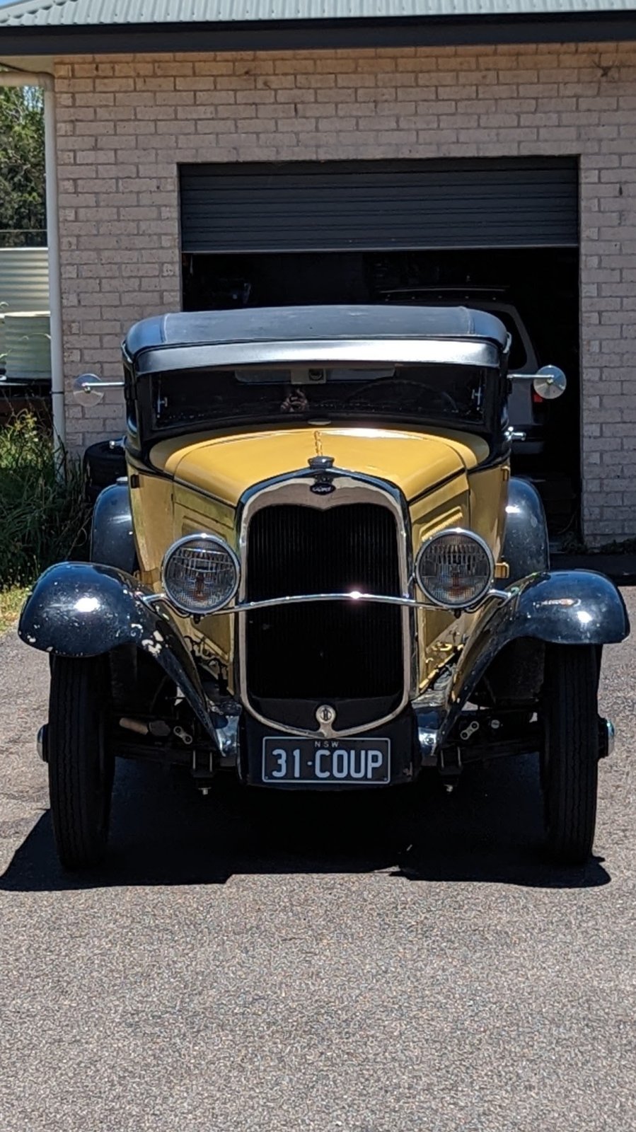

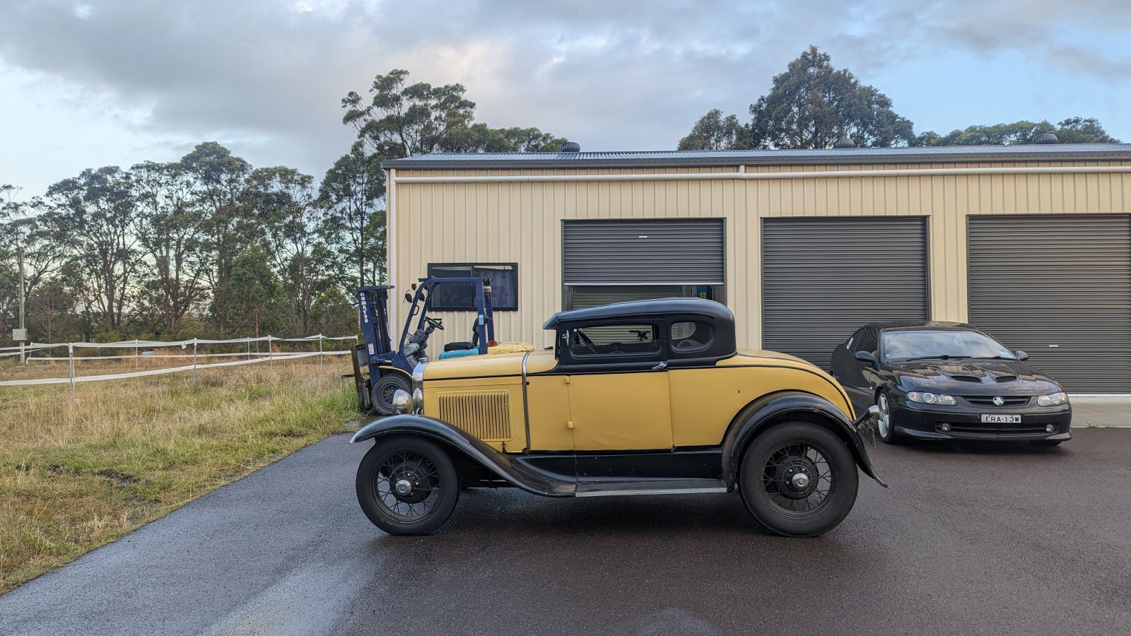

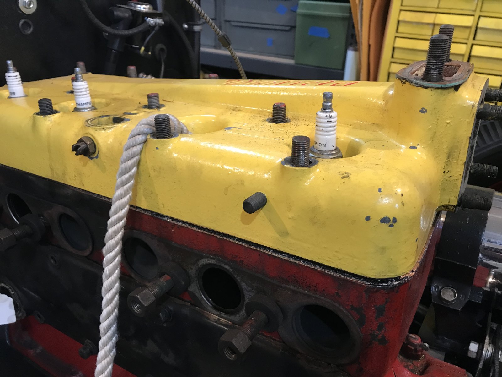

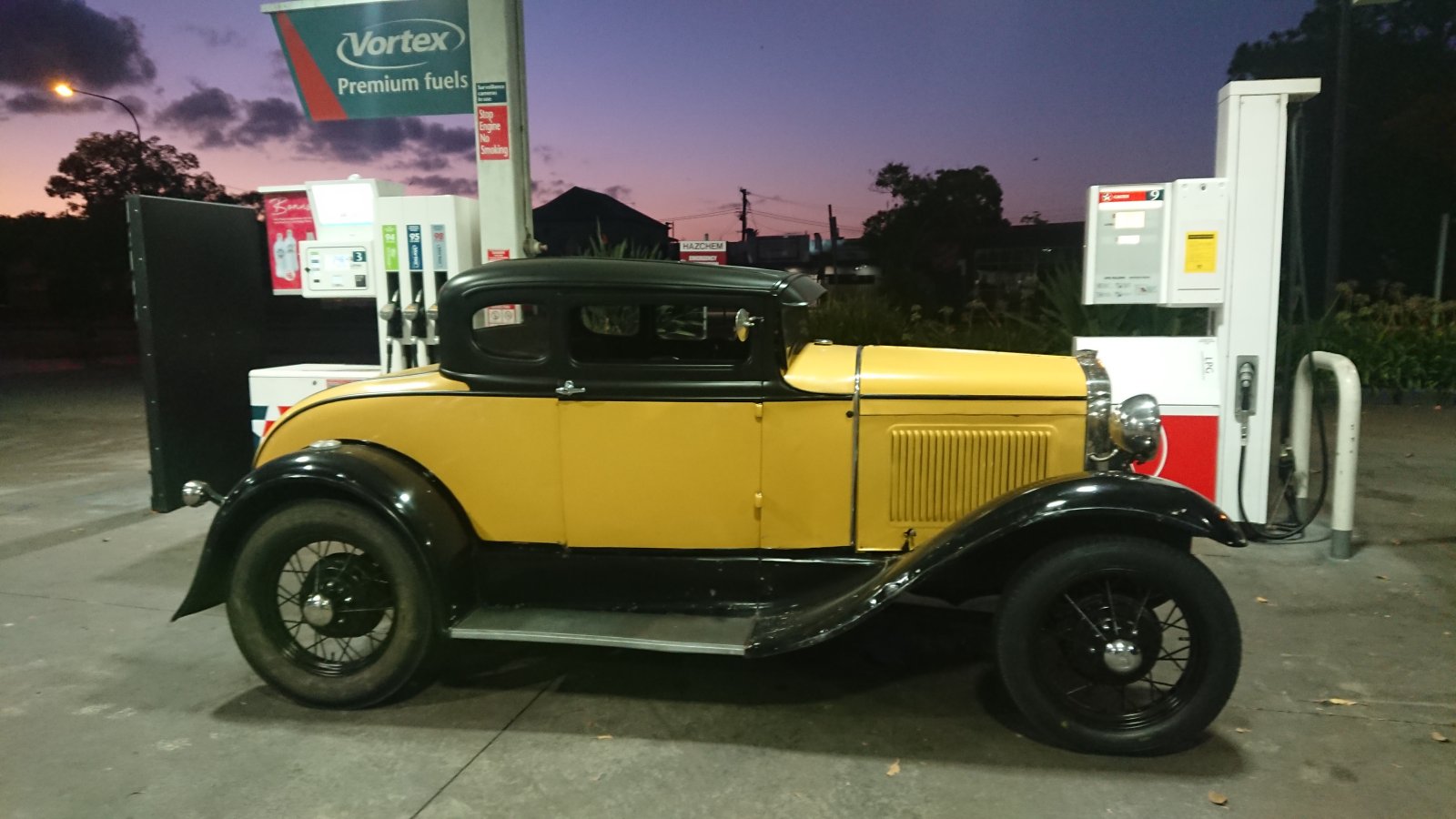

    Bought it like this, about 2.5 years ago:
    This is my first hotrod, but I've owned and built a lot of different cars (mostlely OT). Chop is so-so in execution, but I like it. Luckily I'm short! It just barely ran and stopped, nothing electrical worked, no fittings to mount the boot lid (originally a rumble seat) tyres were mismatched and dry rotted, etc etc... Perfect for me, as I wanted something I could drive as I built it, and enjoy the different stages along the way.
    So the first work was a complete rewire front to back (in original style conduit etc), mount boot lid, get it running better, new tyres etc... Got rego on it and made it in this form (to watch, not compete) to Rattletrap in May 2021.
    Was pretty busy with some of my other (OT) projects and building a new shed/workshop, but still doing little odd fixes, and then in August the head gasket let go. It was a copper faced gasket, and the material in between actually rotted out.
    Getting the head off was a mission. I ended up using a mixture of heat and penetrating fluid and double nutting the studs to get them all out (took a couple of days) before I was able to remove the head, but got there eventually without breaking anything. It was properly stuck!
    I ordered a 6:1 high compression head and FSI distributor at the same time, new water pump etc, didn't see the point in not doing it all together. Unfortunately it took a long time for all the parts to arrive, and I didn't have everything on hand until late December.
    As I say, was busy building a shed and whatever else, so I eventually got it back together and running sweetly around March/April last year. Driving better than ever. Unfortunately it was leaking a lot of oil, but I drove it when I got the chance, and gradually fixed up odds and ends.
    Fitted a dropped headlight bar that popped up, and got the front sheet metal a little straighter... The guards were very off when I bought it, it's much better now, but still not great!

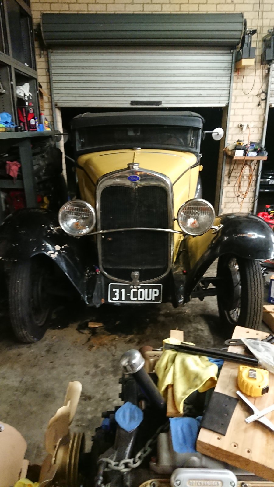

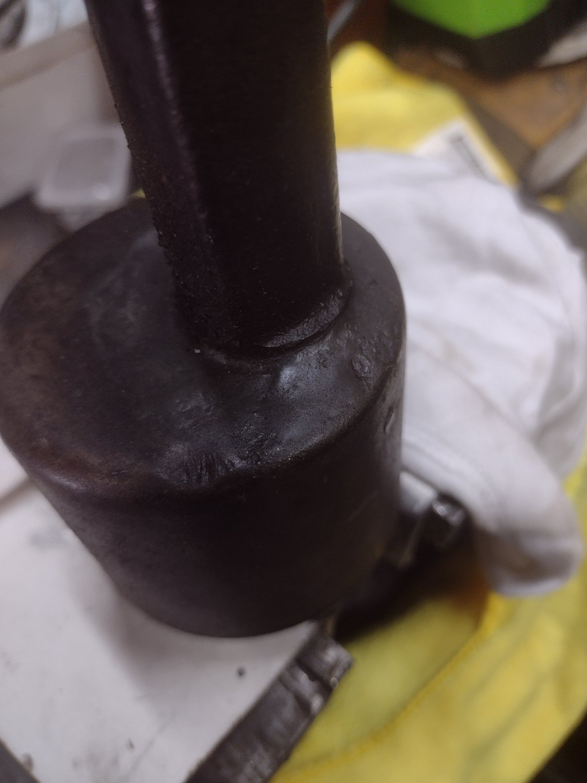

    Next it was time to sort out a few more suspension bits, replace shackles and some other bits and pieces. I was going to reshape the main leaves to reverse the spring eyes, but the main leaf in the rear was cracked, and so were several leaves in the front spring, so I ended up with new springs. Still working on the height, but much happier with the stance now. Drives much better too! I made some further improvements to the brakes at the same time too, added floaters and new (straight!) brake rods. Locks all 4 wheels at moderate speed and effort now!
    So with that out of the way, time to tackle the large puddle of oil left underneath wherever it goes... It appeared to mostly be coming from the sump gasket, so I figured it was a good time to clean out the sump and check the oil pump and stuff too.
    Some pretty good sludge in the pan:
    But everything cleaned up alright.

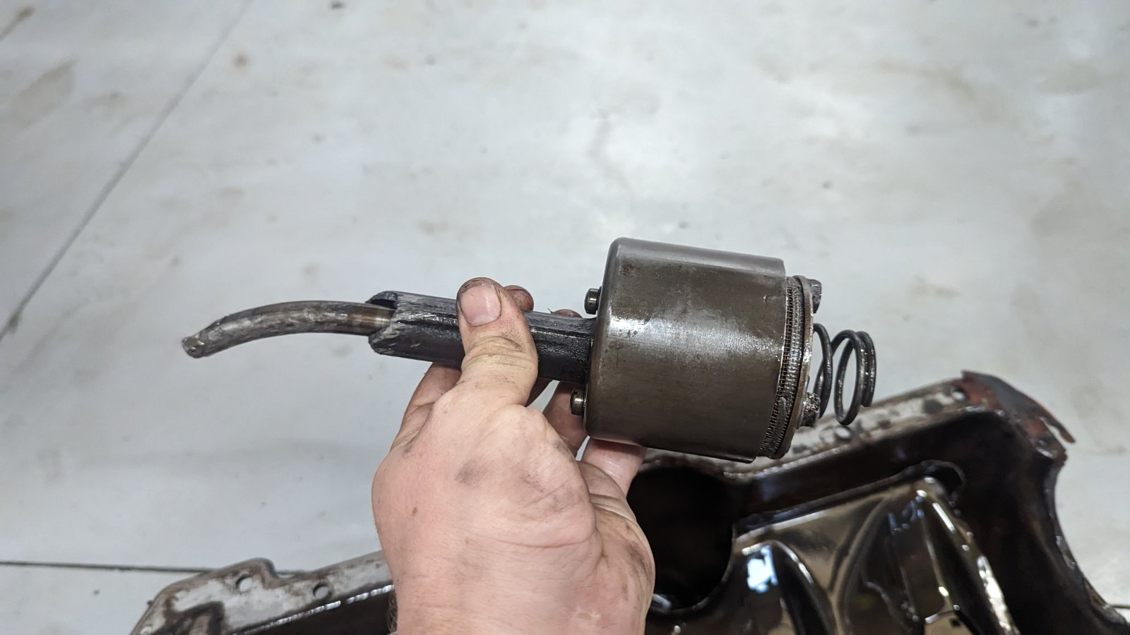

    Now somehow at this point I ****ed up. I dismantled the oil pump and cleaned it all out, and I'm guessing I put the pump rotors back in a different orientation... Anyway I got it all back together, ran it a couple of times just idling in the driveway up to temperature, and seemed to have solved my oil leak. So I took it for a drive. A few hundred metres out of my driveway, there was a loud bang. The car continued to run happily, but obviously something was wrong.
    Hmm... That's somewhat less than ideal...
    Pulled it down to investigate. It appears that the oil pump seized, forcing the camshaft forward and punching out the plunger, and generally making a mess. Fortunately due to very short run time, and the nature of the Model A oiling system, it doesn't seem to have done any bearing damage. But it has spread a lot of metal around, destroyed the pump, and taken teeth off the cam gear.

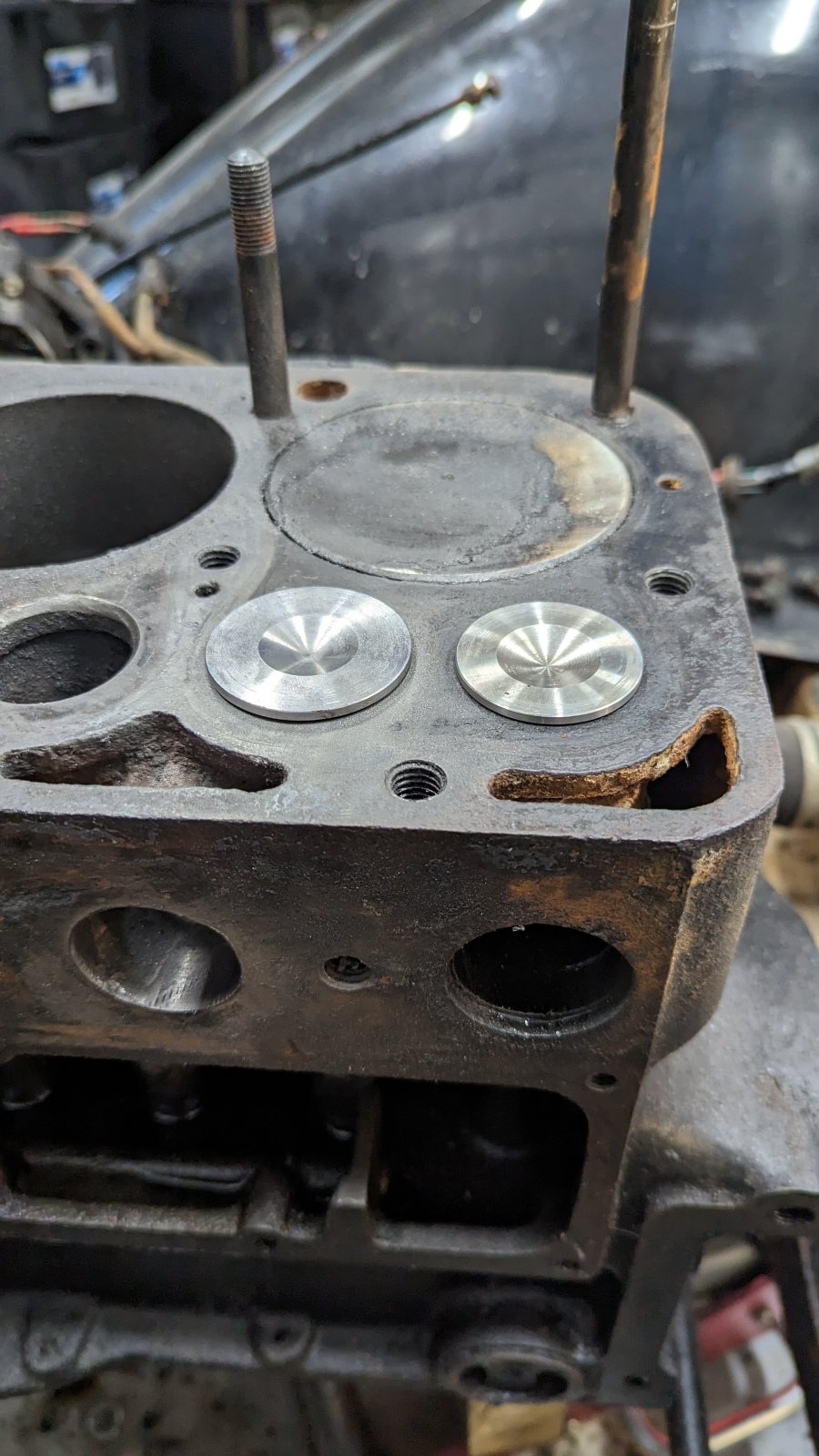

    So... Now I'm in for some more work. Makes sense to me to upgrade the camshaft if I'm replacing the gear, and if I'm doing that then I should fit new lifters. Valves have a load of play in the guides, so really should fit some better valves and guides... Obviously bigger intake valves would be better...
    Starting to look like something....

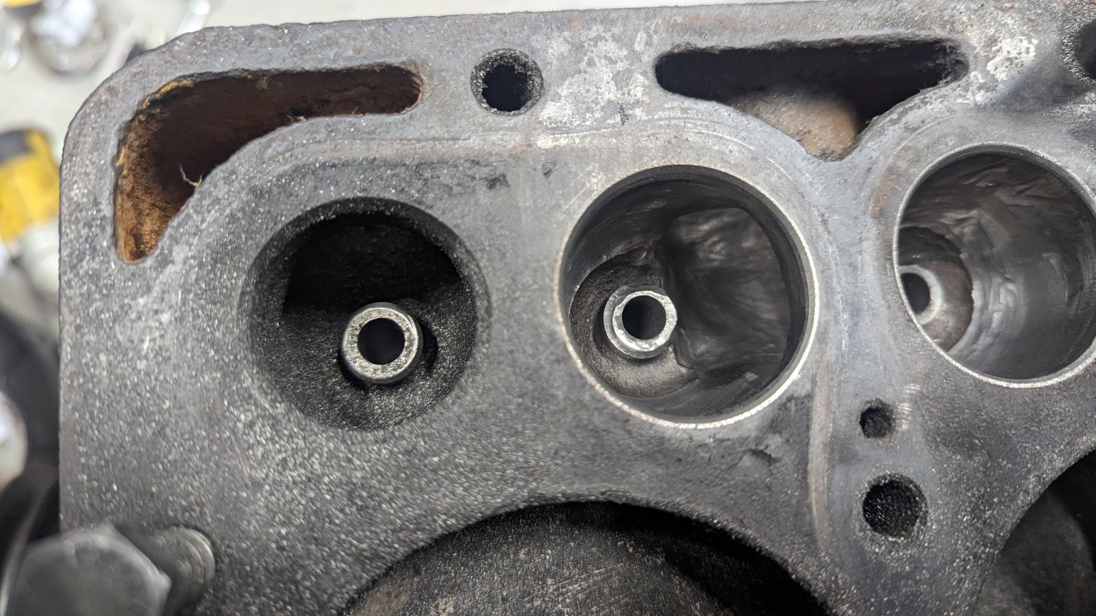

    Crack from one of the exhaust seats... Ok. I've come this far. Time to pull it down completely. Bearings and journals all look sweet.
    I had a mate machine out the crack and put in an oversized valve seat. Problem solved. Measured up the bores... I had intended to just re-ring, but the clearances were huge. Ok. New pistons ordered.

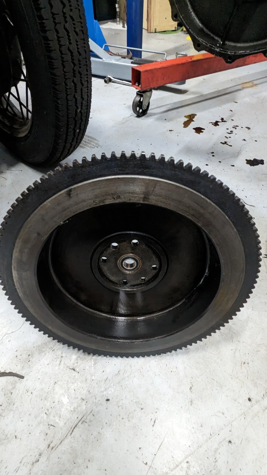

    Alright. While I'm waiting on some new pistons and rings, let's take some weight off that ridiculous flywheel. I finally got 3 phase power to my new shed to run my old lathe and mill at about this time.

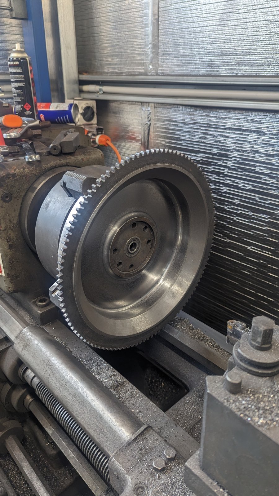

    Final appearance of the flywheel below. I have mated it to a pressure plate from a 2.3L Mustang. I am using the original Model A driven plate. I don't seem to have taken a picture of it all together, but I have bench tested it and it seems to work and release fine, and work with the factory Model A release bearing. Final weight as shown, with ring gear and spigot bearing is 28.4lb. In this picture I am doing a rough balance - I've turned the bolt down to be a nice fit inside the bearing in the flywheel. As far as I could tell, balance was pretty spot on - it didn't want to stop at any point more than any other. Good enough for a banger I hope. Almost all that weight taken off the extreme outer diameter too - should feel much more sprightly!

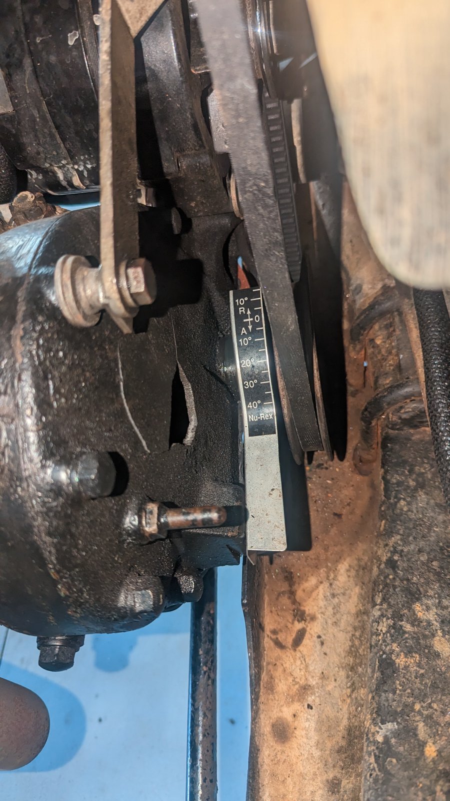

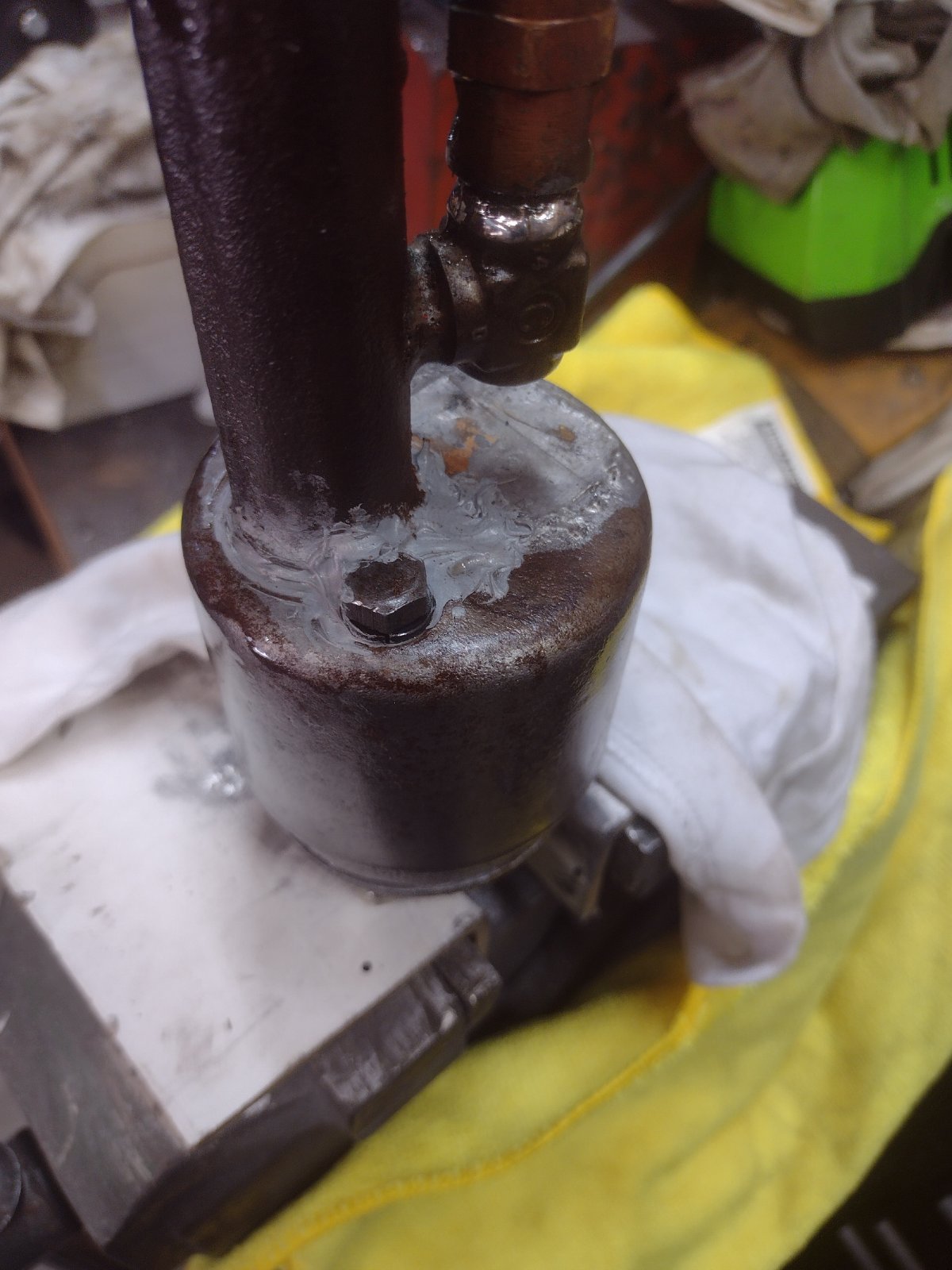

    mmmm, straight cut gears on your oil pump and the one is an idler and the other has the long shaft...kind of hard to get it back together wrong that way.
    if you look at the outer housing...the sheet metal round part, the bottom of it is submerged in oil in the sump....
    oil is drawn up inside it to the inlet to the pump gears.....the gear inlet can be above the oil level...but not the inlet to the pump
    so....if the housing isn't completely sealed tighter than a bulls *** in fly season, to the pump body, it leaks air and won't draw oil....no oil flow
    I seal the outer housing to the pump body with gasket maker loc***e 5699 preparing the surfaces with oil and grease remover prior....then liberal application to seal it on the exterior too
    looking good and you took a serious amount of material off of that flywheel...

    Here...this is what I'm talking about...picture of one that has been completely soft soldered to seal it up... IMG_20230903_091421676.jpg IMG_20230903_091508724.jpg Henry used a paper gasket but I'm sure he would have used gasket maker if he had it available

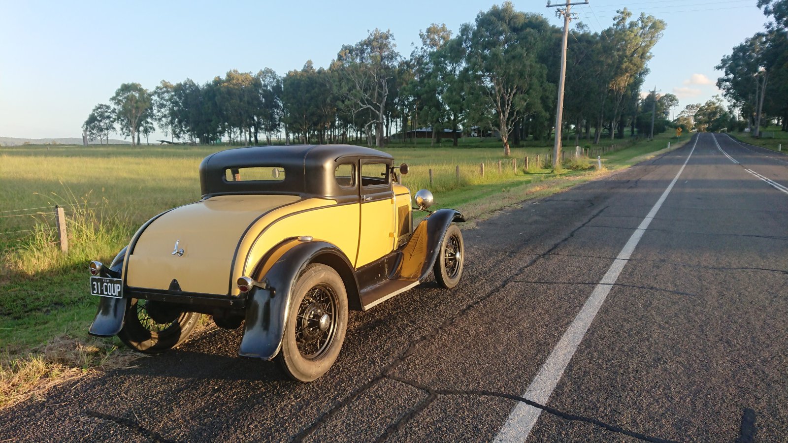

    Thanks for all the responses! No progress today, I had hoped I might clean the block ready for machining, but I basically slept all day. A couple of updates though, I finally got my copy of the good book:
    And last night my partner found a hotel room available in Gulgong. So we are going, car or not. We had been intending on camping originally, so that was one of the other reasons I was thinking I probably couldn't go. Getting up and down from an air mattress on the floor doesn't sound like fun at the moment...
    Thanks!
    Yep, no doubt it's chopped! The seat cushion is shortened, and fortunately I'm not too tall!

    Yeh the flywheel was a big job! I couldn't really understand why the standard drawings of what to do seemed to work on ID and OD equally, since OD will obviously provide greater benefits? Both in more material removed and in greater reduction in rotational inertia. But I've left plenty of meat for strength and it should be a lot more responsive now.

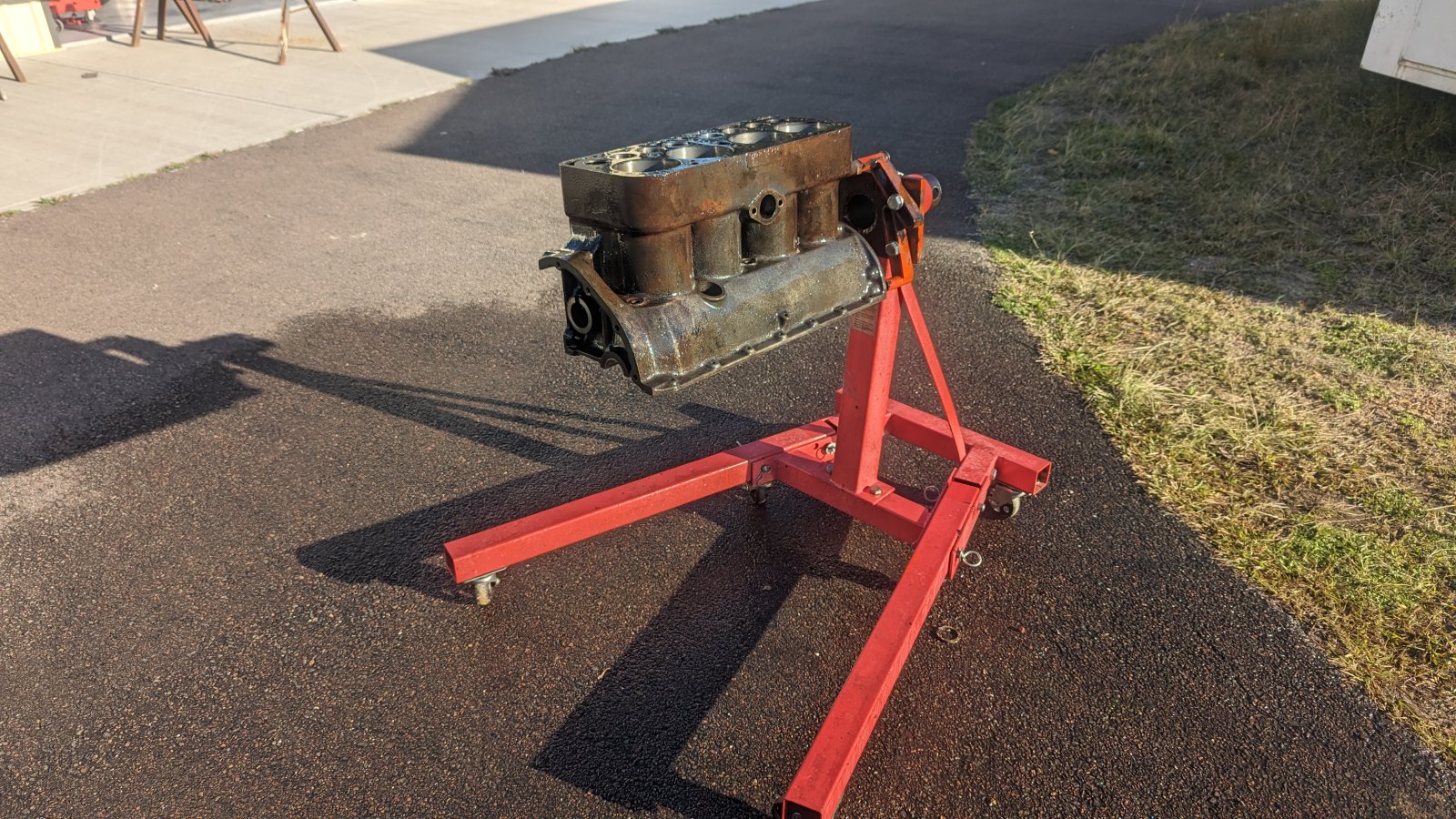

    Still pretty useless and very sore, but I gave the block a bit of a clean this afternoon (in these photo's it's drenched in wd40 after cleaning) ready to go on the mill.
    You can see the oversized exhaust seat fitted to fix the crack mentioned earlier here:
    I have some hardened seats I can fit in the other exhaust seats too. Do people think this is worthwhile to do, or do they really not wear much anyway?

    Oneball
    I don’t think your pump seized. I think it wasn’t mounted right and ended up in the bottom of the pan and then the crank hit it and pounded it into the cam shaft. Be worth checking the cam is straight.
    Lead in petrol didn’t exist when your car was made and it’s survived so far without hardened seats.

    Yeh, I had wondered about the possibility of something along those lines. I suppose it's possible, but there's no marks on the camshaft, and I was pretty confident that I had the oil pump in right. I was working underneath the car, I can't say that it's not possible that it moved without me noticing while I was getting the sump in, but I was pretty confident I got it together ok.

    Missed your additions - cam appears straight, but I've got a Burtz cam to go in it anyway. More of the "while I'm here" mentality!
    I agree, although I have heard that they can last a long time until fresh seats are cut. Not sure of the reasoning behind that, something to do with the previous lead protecting the seats?

    @Oneball There's a big spring on the bottom of the pump that holds it up. I don't see how the pump could have come down. There's the dip tray to get around too. Something weird going on there.
    Stogy and metalhead140 like this.
  25. Oneball
    Joined: Jul 30, 2023
    Posts: 1,683
    Oneball
    I was thinking it could’ve been half in half out and at a funny angle missing the recess in the pan or missed the hole completely, the dissy would still the turn wouldnt it?
    I guess if it seized as MH said maybe it snapped the shaft and then fell out???

    With regard to the head being royally stuck, I've been there. Here's a little tip for you and anyone else who encounters this: Pull a spark plug, then jam as much rope as you can through the plug hole, making sure to get it over and into the cylinder. Then put the car in gear, give it a push, and the force of the rising piston will push the head up.

    Another way, if the car was a recent runner. Is just bump the starter with the head loose. Done that a few times. Works great.
