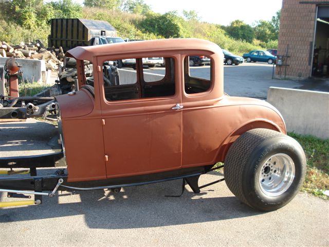

    About a year ago I found a body and frame in Tennessee which seemed to be in good condition, with front and rear axle for a pretty reasonable price. I contacted the folks up at Oddball Kustoms, just outside of Toronto, we arranged to get the body and frame up to CA, and the project was under way.

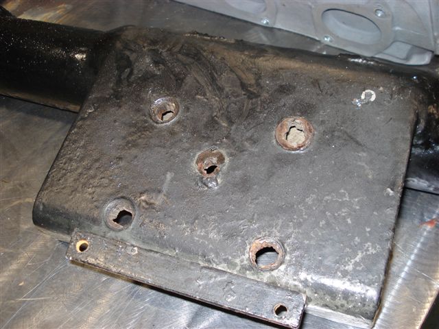

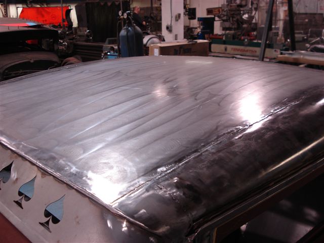

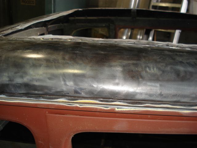

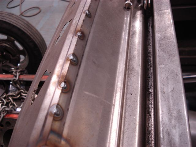

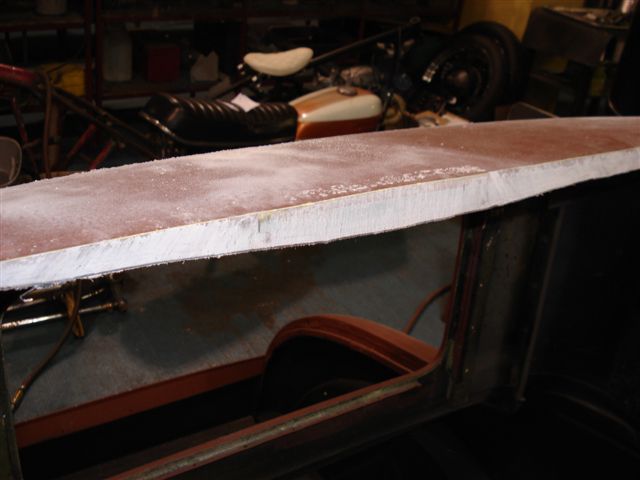

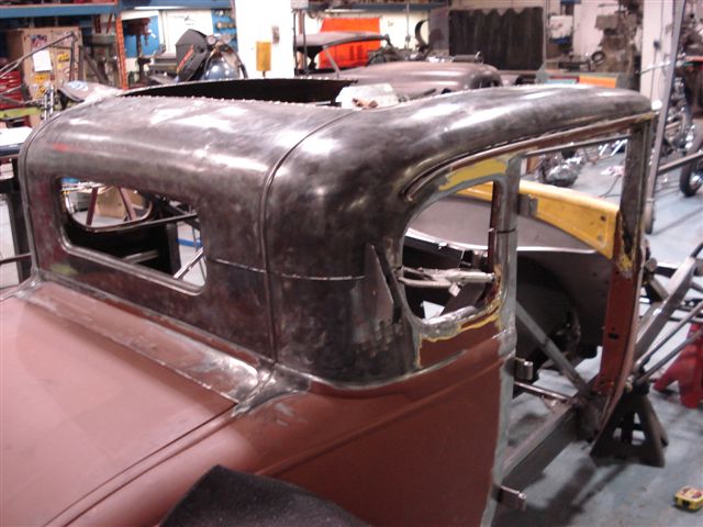

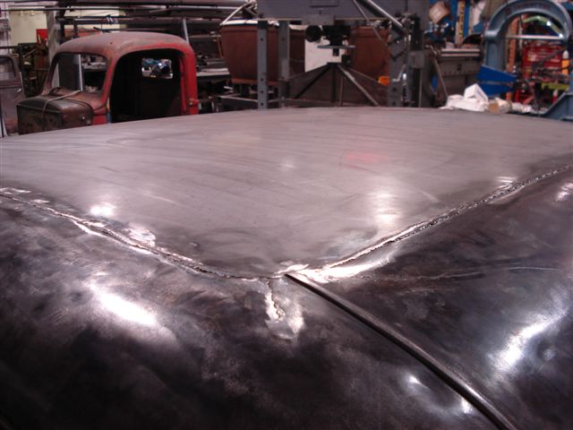

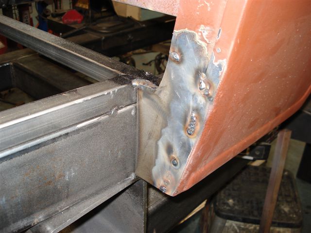

    Soon we found out everything wasn't quite as awesome as we had thought. Check out the 50 lbs of bondo on the roof, the less than sup-par welding on the frame which happened to be fairly twisted, and the glued on patch panels on the doors.

    The guys at Oddball were super cool about building a new frame, which we could build to spec, so we ordered the front end and the job of removing all that filler from the body began.

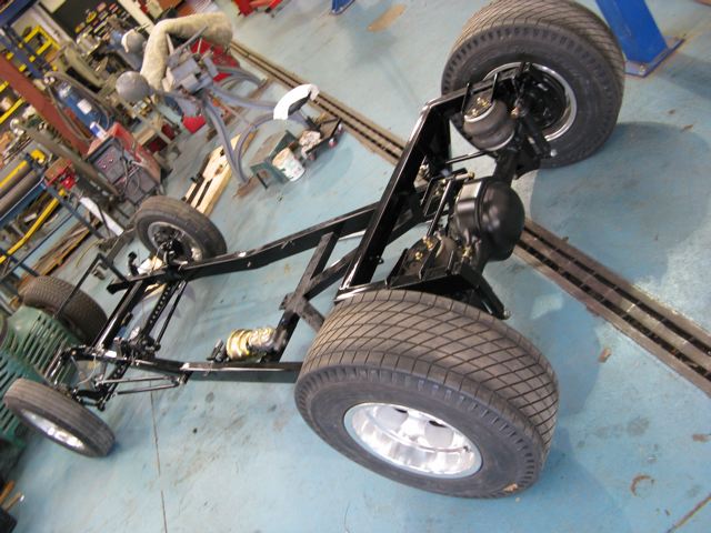

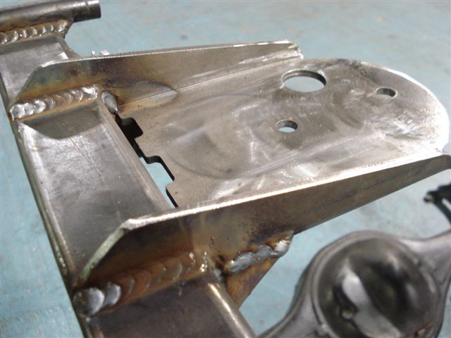

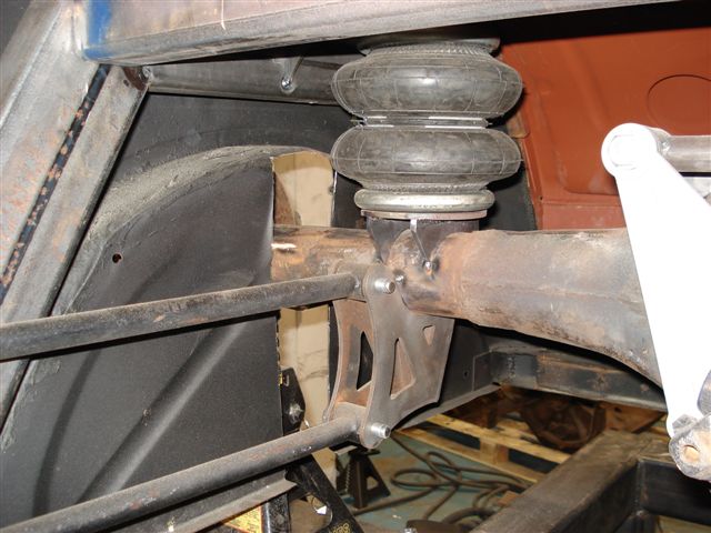

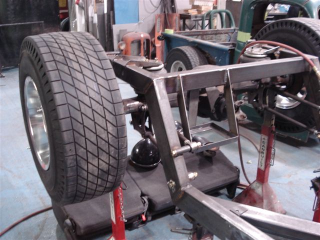

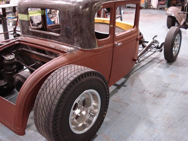

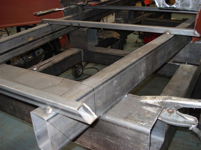

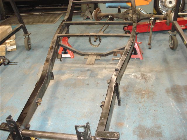

    The frame started to come together, with airbags for the rear end (a 9 inch), 4 link, and an upward sloping front of the frame instead of the traditional "z", seen here without horns yet, so the front end could be mocked up. We decided to go with a 4 inch drop cross drilled i-beam from superbell. Finally, the body would only be channeled enough to cover the frame, so that any scraping or damage from speedbumps, etc, would be absorbed by the frame and not the body.

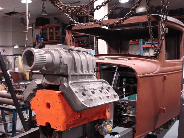

    We were super lucky to find a stash of 10 331, 354 and 392 hemi blocks and about 20 sets of assorted heads that an old drag racing engine builder in Ohio had sitting out in his barn. I snatched up a 392 for myself and Stony took the rest for future projects. I figured this was going to be the time to do a blown 392, so mock-up began with the plastic motor and I flew to Toronto to get inside the coupe so we could measure for the chop and eye-ball steering wheel placement.

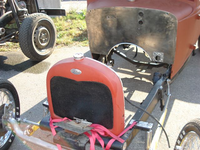

    My friend Jim was kind enough to be willing to part with this sick looking grille shell, which Stony sectioned. Then he finished welding the frame.

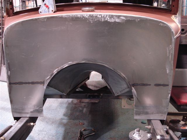

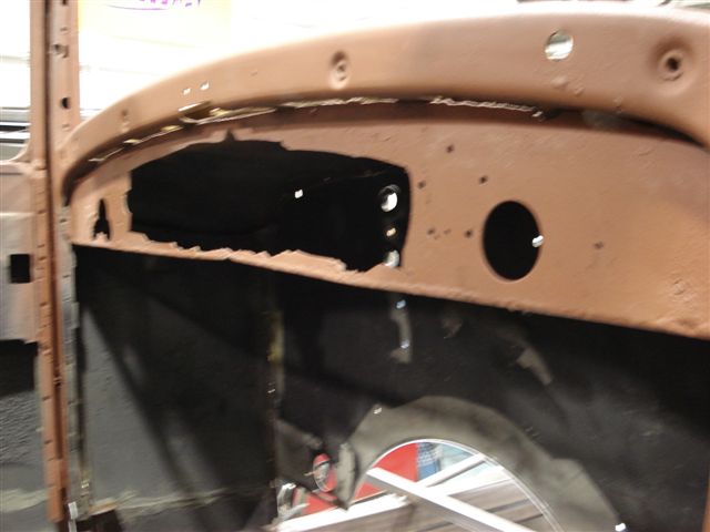

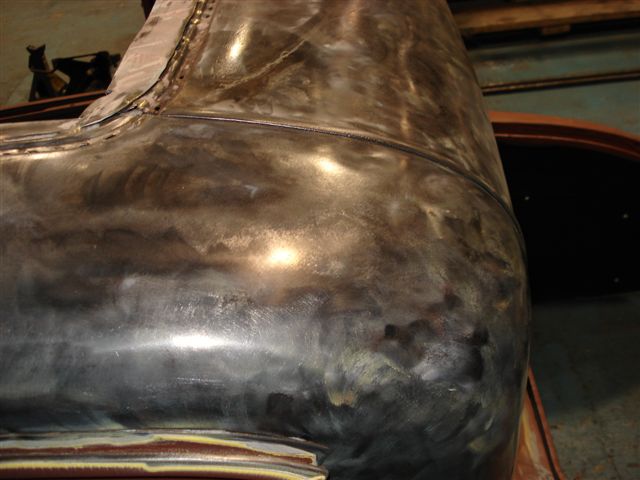

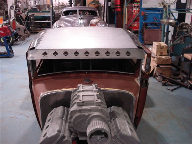

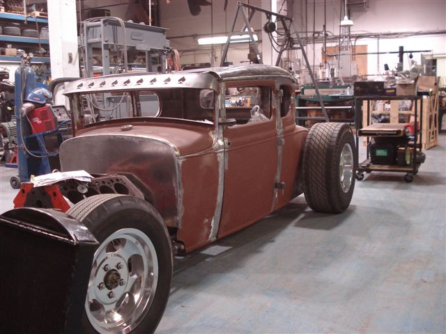

    the old dash was removed, the new dash installed, wheel wells adjusted for the low stance of the car, doors suicided, all in preparation for the chop. I had a local North Carolina tool shop use a water jet to cut the spades into the visor.
  9. portiadog
    Joined: Jan 8, 2008
    Posts: 76
    portiadog
    And so begins the chop...
  10. portiadog
    Joined: Jan 8, 2008
    Posts: 76
    portiadog
    The chop looks great and the visor is tacked into place.

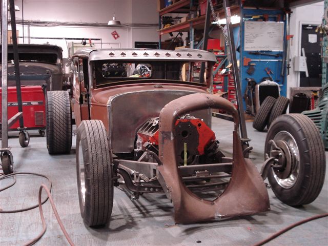

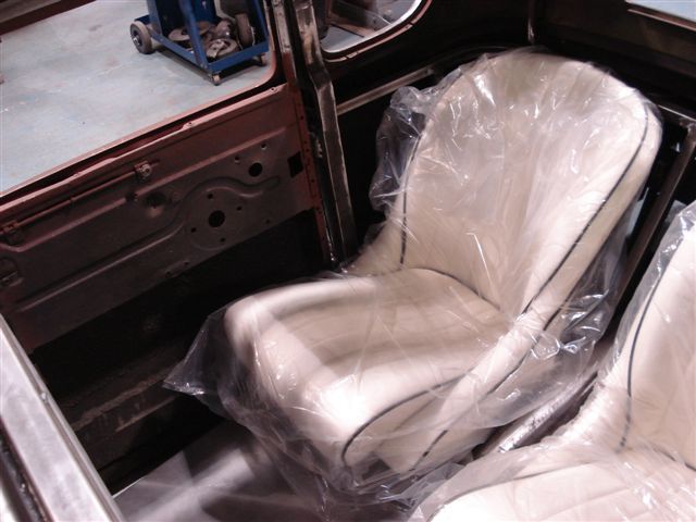

    The car is starting to look pretty mean! We decided to use English style racing seats, and 1950 Pontiac brake lights to compliment the E&J's up front.

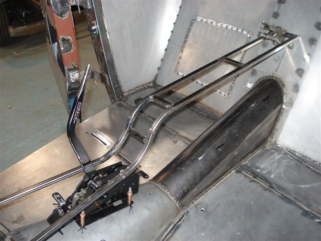

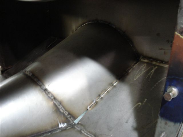

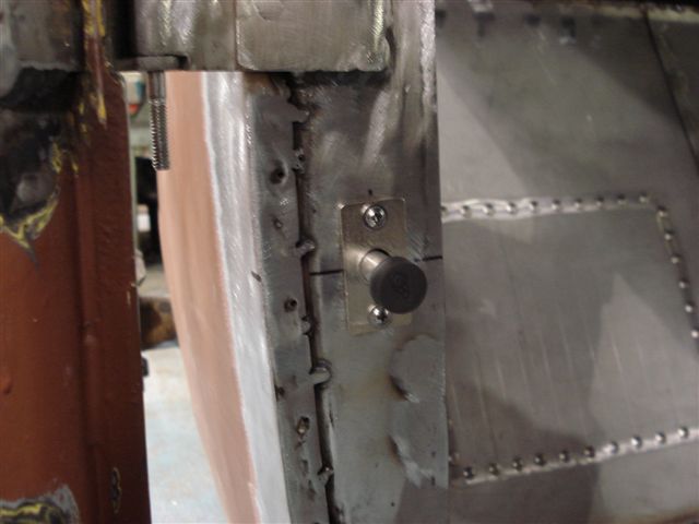

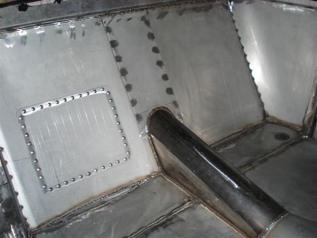

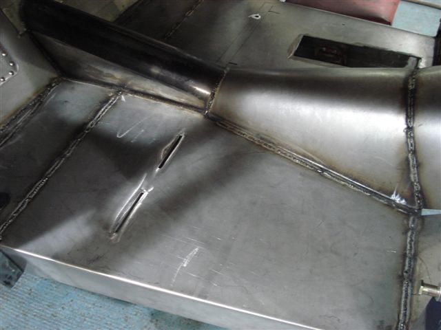

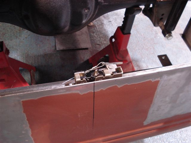

    Floorpan and tranny tunnel coming together, along with the new firewall, door and trunk poppers.

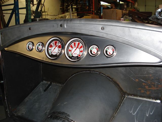

    The roof is filled in, and the roulette gauges mocked up, which are so gaudy that they are pretty awesome. Or so I think.

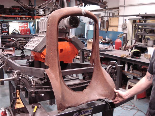

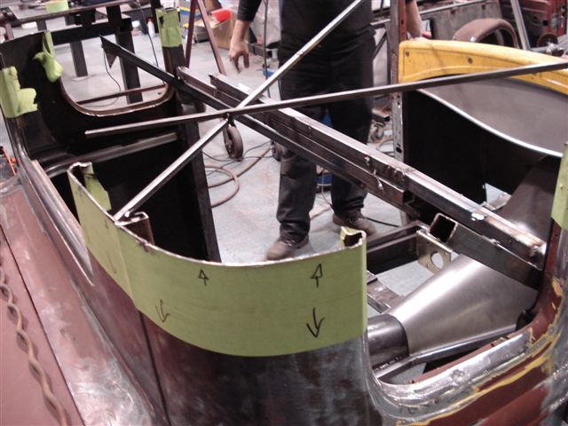

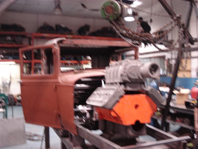

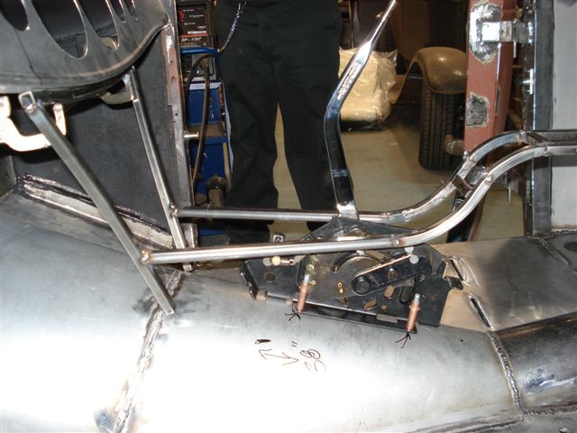

    The center console gets tacked together. We're using a 700R4 and a Hurst Pro-Matic II Ratchet Shifter (truck series for a bit of added length). The Garlits Scoop which will enclose a Holly 850 double pumper arrives, and looks pretty wicked sitting on top of the plastic motor. Stony, who has an amazing eye for lines and is an all around awesome fabricator, decides that the grille shell is leaning forward a bit too much and leans it back a little, which requires stretching it out a bit.

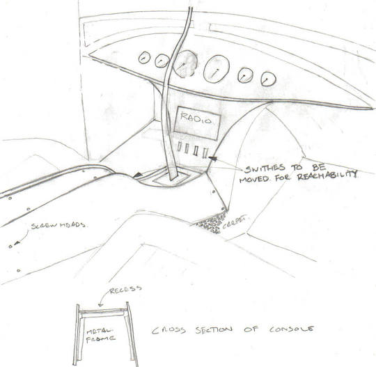

    Center console drawing, and a very cool Americar steering wheel from Willy's project. (Not my project). I found an article about this tube amp stereo head online somewhere and was able to track one down on ebay. They never sold in the US, and a tube amp car stereo is probably the most impractical thing I've ever heard of, so I figured it would be perfect for the hot rod. Finally, we are using aircraft style switches, like the one shown here.

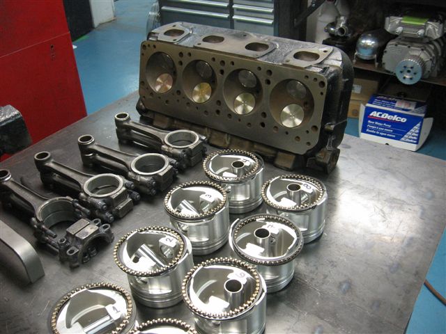

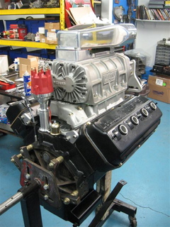

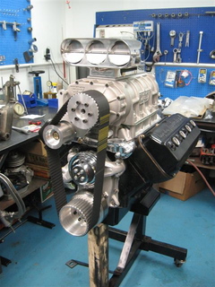

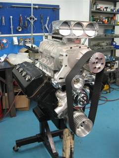

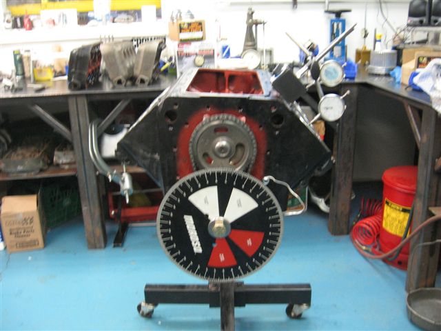

    Needless to say, I was pretty stoked when we found those old hemis in Ohio. I was also pretty excited when I found a pair of "Chrysler Industrial" Valve covers. But nothing could prepare me for seeing the fully built (well almost) motor. My jaw hit the ground. Once again, Stony and the guys at Oddball outdid my highest expectations.

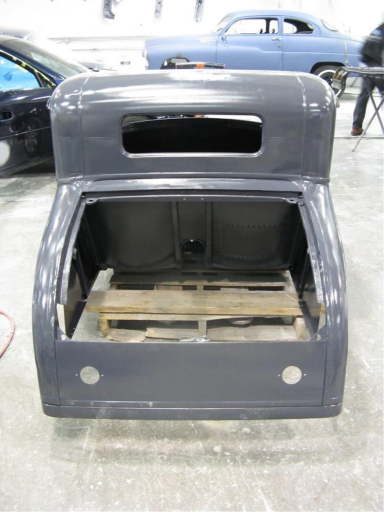

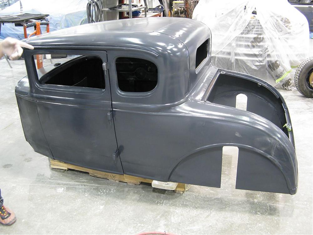

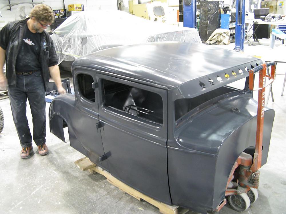

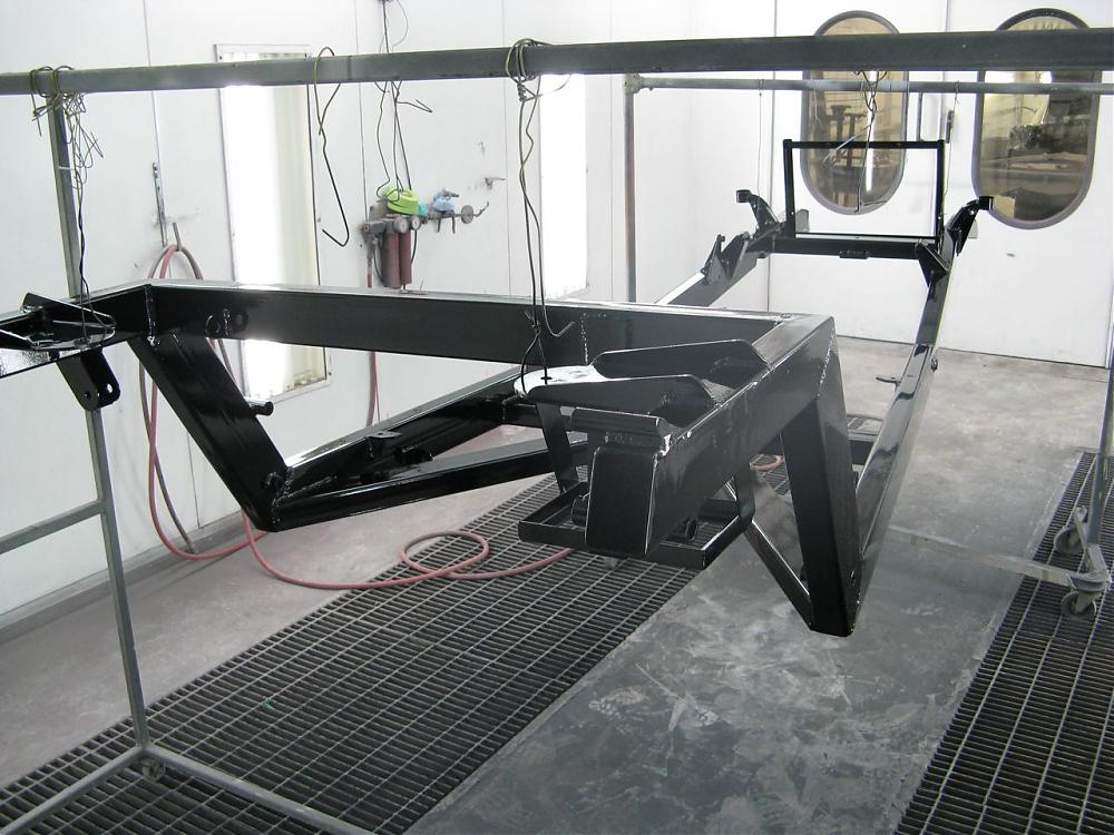

    The body went to the body shop for primer and a little touch up work. The frame and the chassis parts have been painted with black urethane, so they could even survive the Canadian winters and any flying debris that might come at em.
  20. portiadog
    Joined: Jan 8, 2008
    Posts: 76
    portiadog

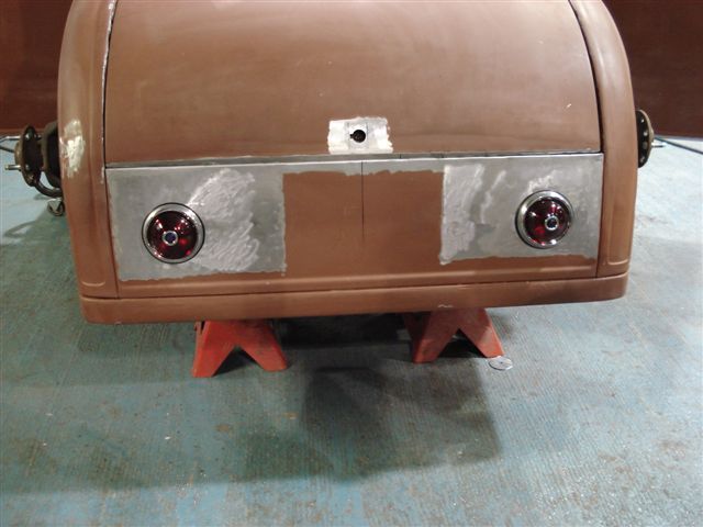

    And finally catching us up to date, the body with some of the weld seams getting a bit of a smoothing over. The trunk and graphics. Thanks for the positive comments y'all, will post more progress soon. Thanks again Stony!

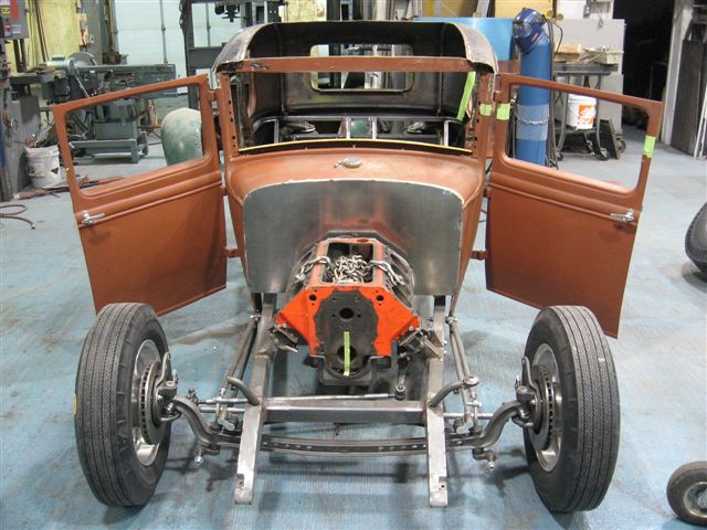

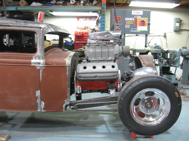

    Thanks guys, appreciate all the compliments. Here's some new pics of the rolling chassis, some with the engine/tranny mounted. Soon the underside of the body will be painted, then the body re-attached, and the whole thing painted. Then we will be in the final stretch of assemby.
