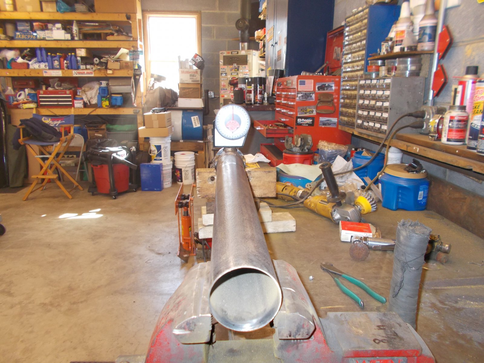

    Brian Lacovitch

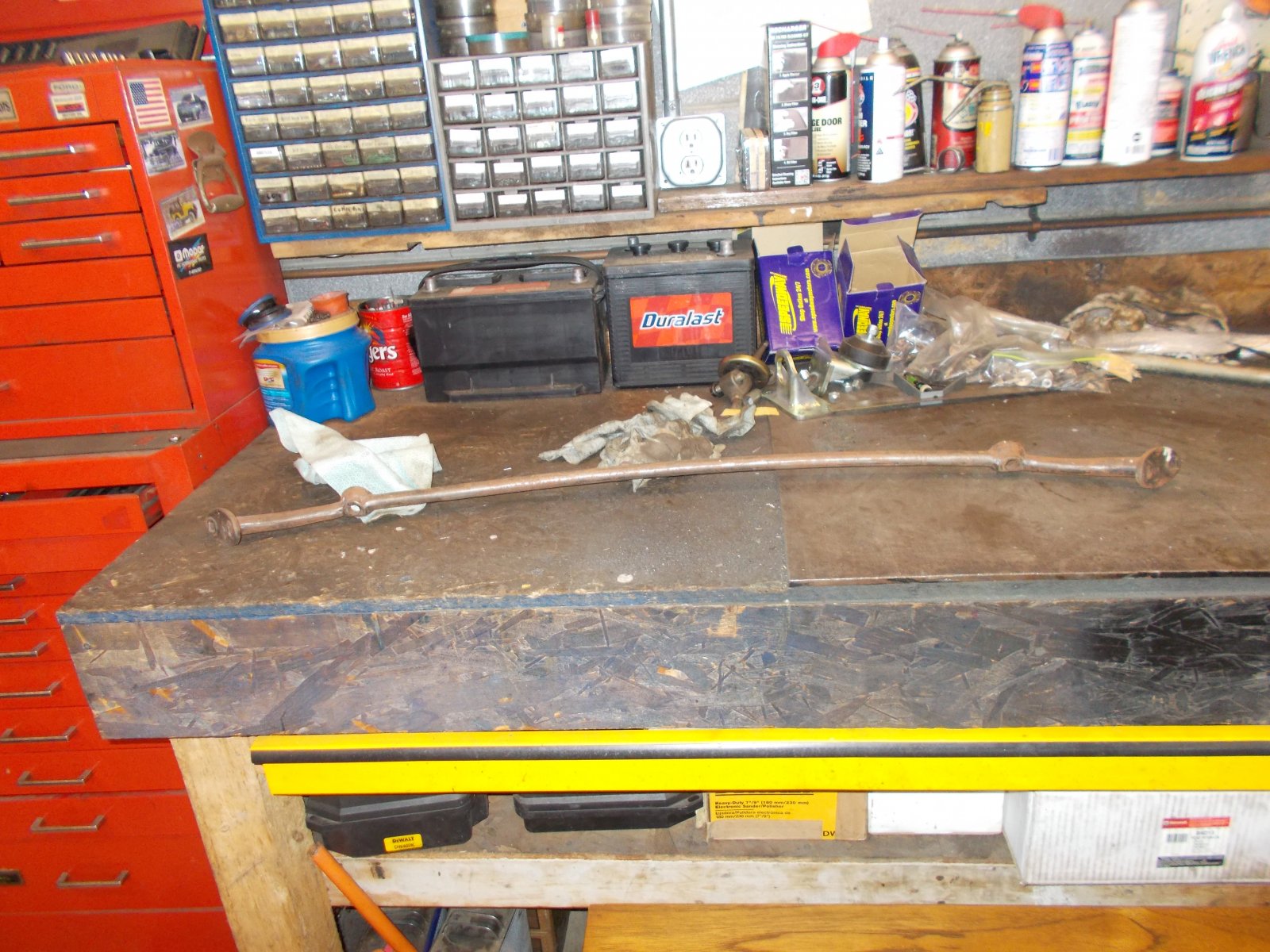

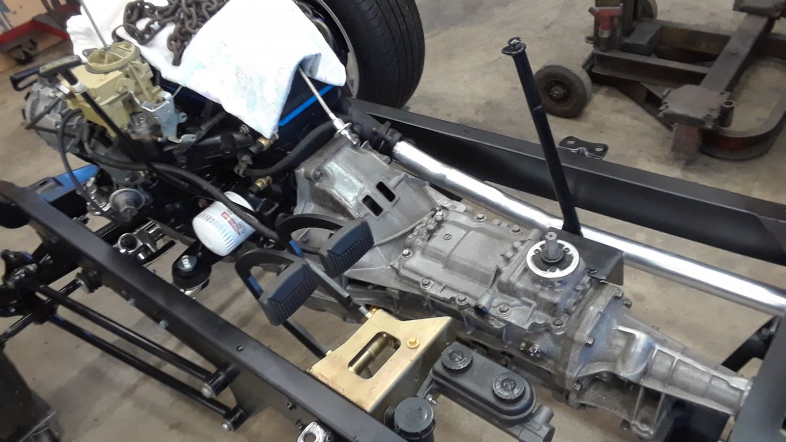

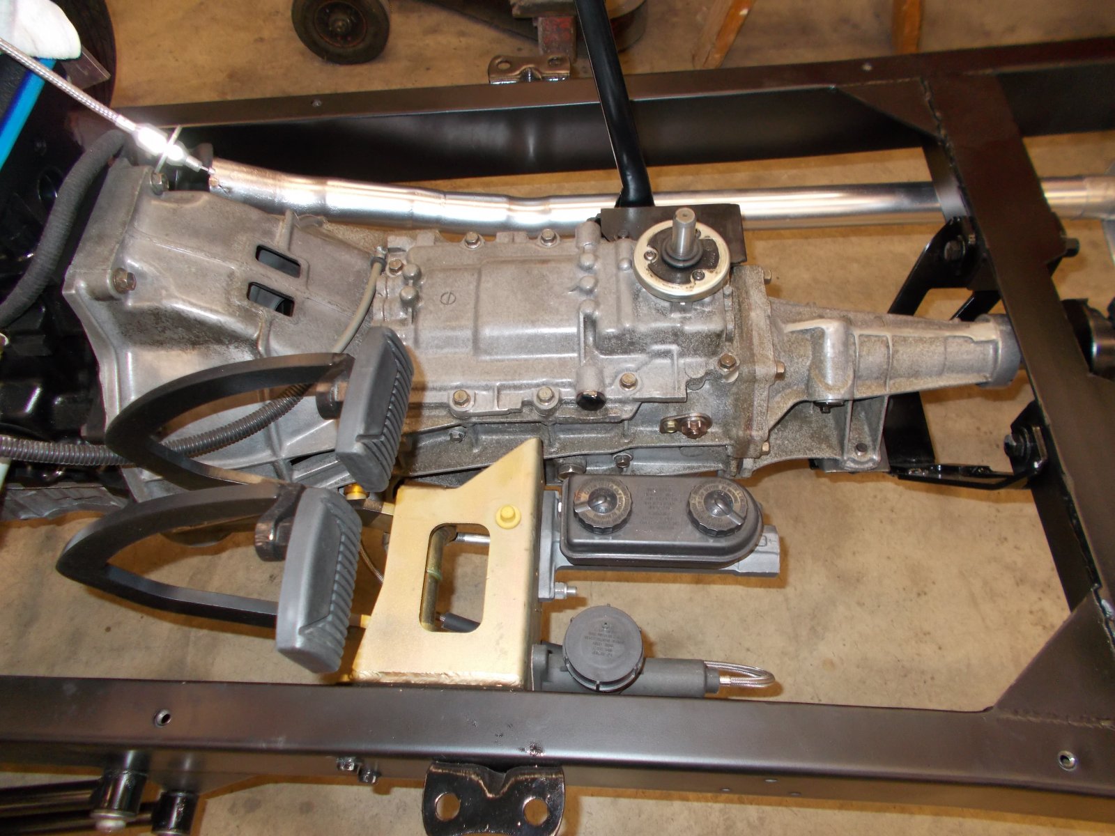

    I bought a used Mustang driveshaft and shortened it to fit. I was taught how to do this from an old man, and I did it when I installed a Desoto hemi in a 1994 Dakota. That truck was fast and didn't have any vibrations! I never knew there was rubber inside the tube either.

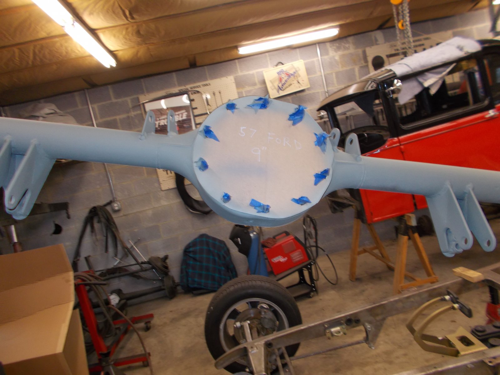

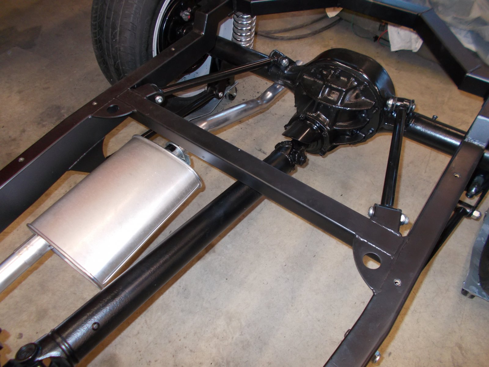

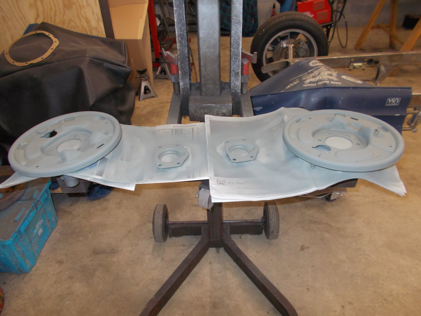

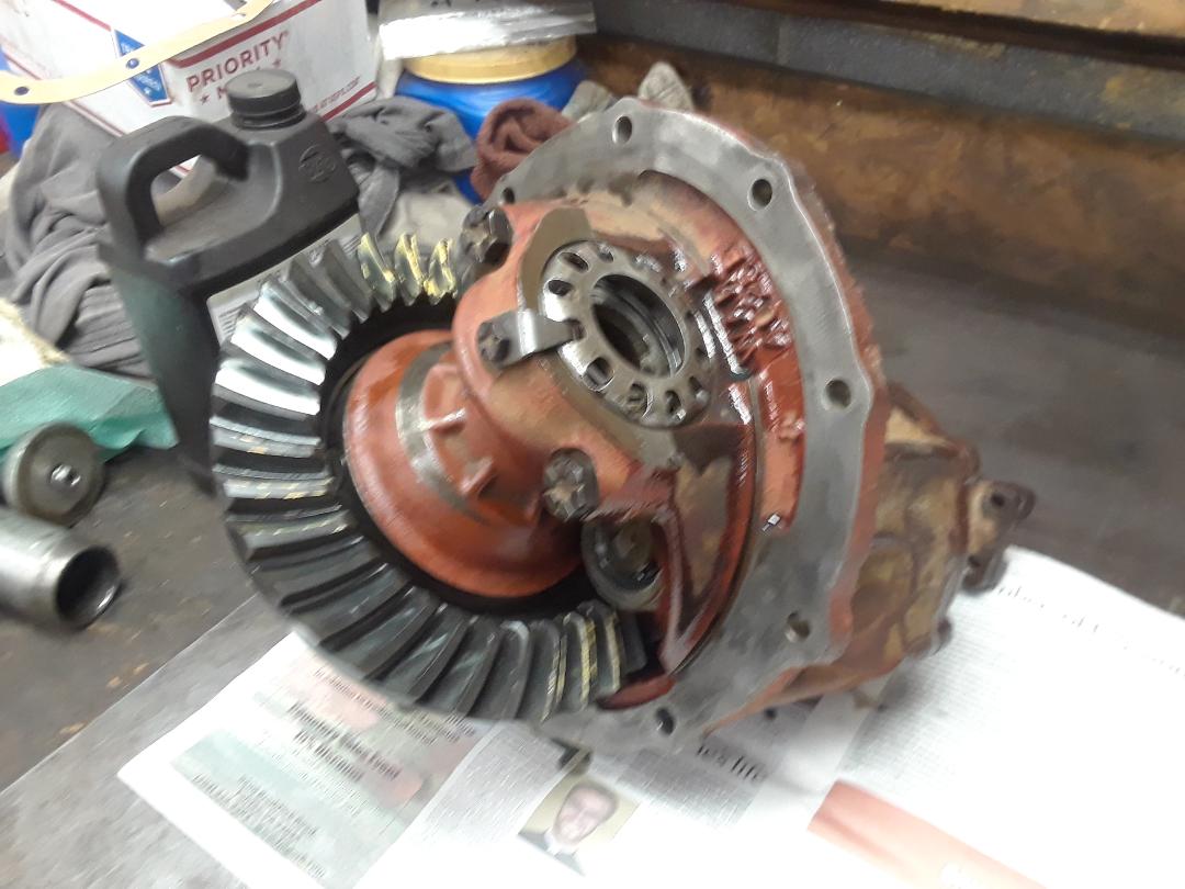

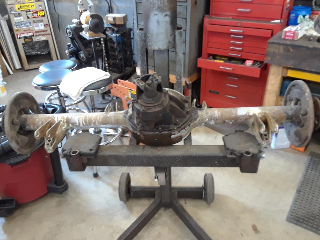

    Brian Lacovitch

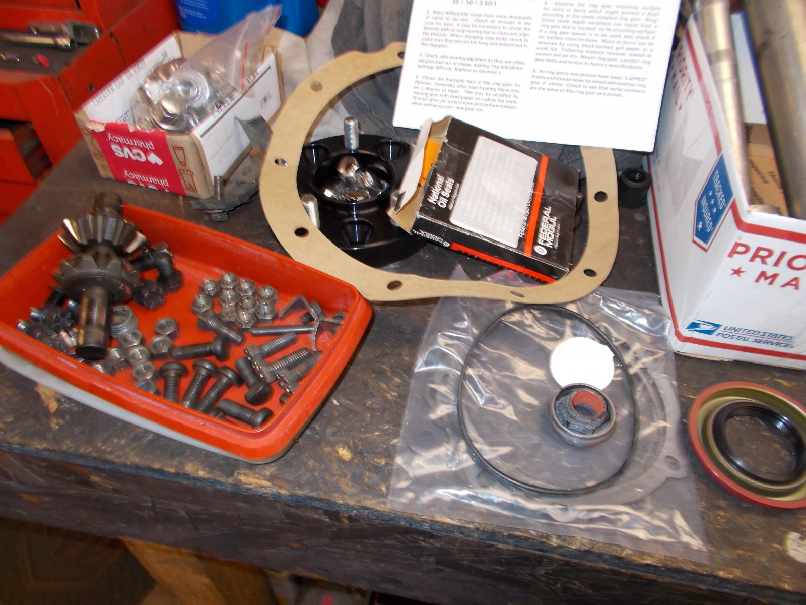

    When I bought the ch***is, it had a 1957 9-inch rear already set up but wasn't gone through. I stripped it down and rebuilt it with 3.73 gears. It is the stock width.

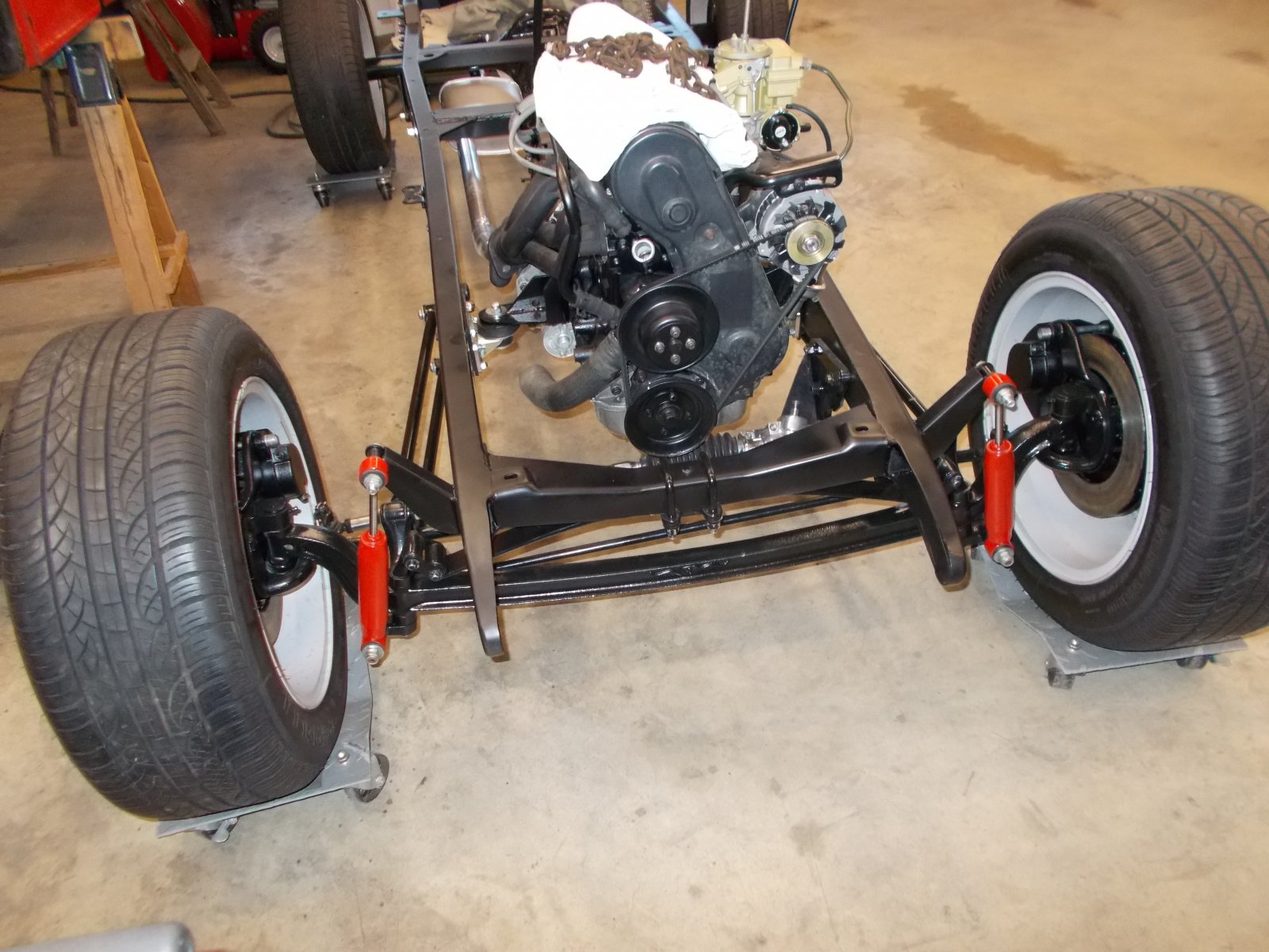

    Brian Lacovitch

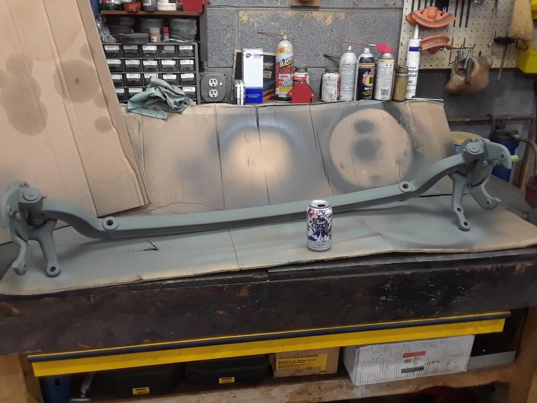

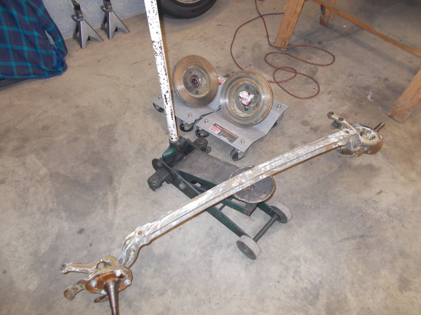

    Front axle, cleaning painting and installing. It is a Super Bell dropped axle a mono-leaf and 4-bar suspension.

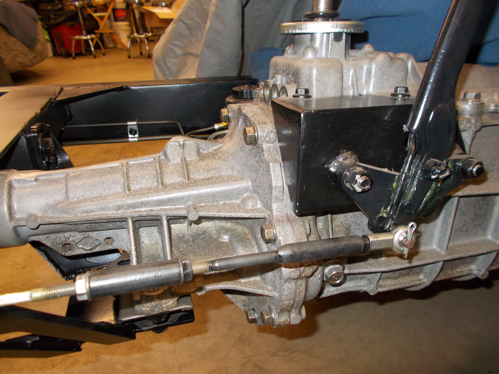

  4. Brian Lacovitch
    Joined: Jan 22, 2020
    Posts: 36

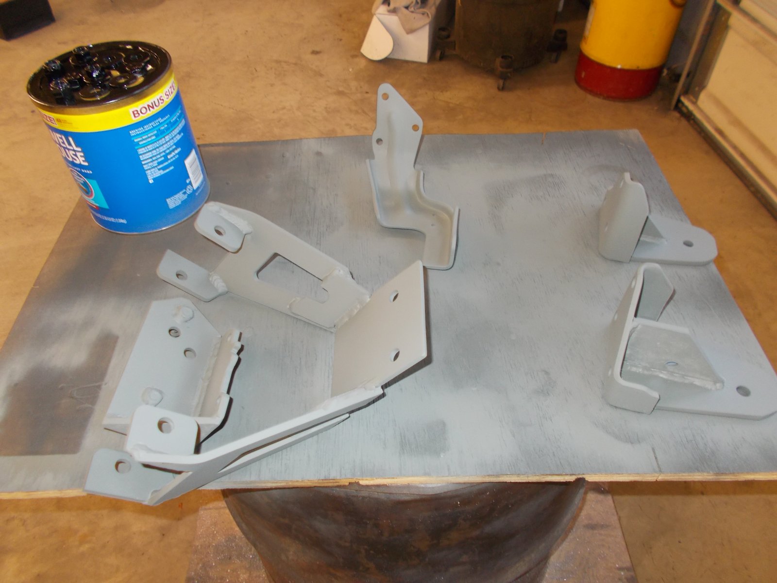

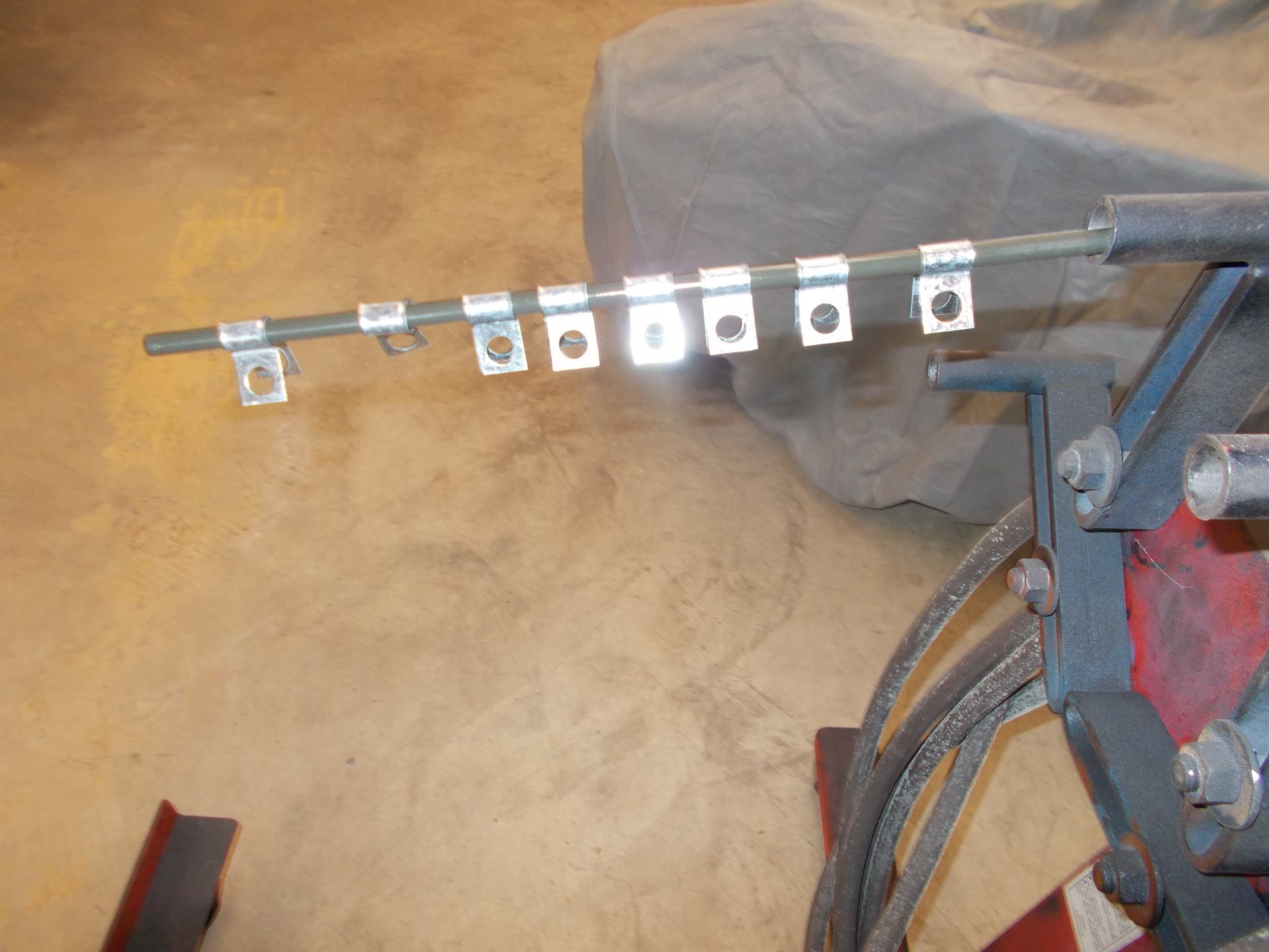

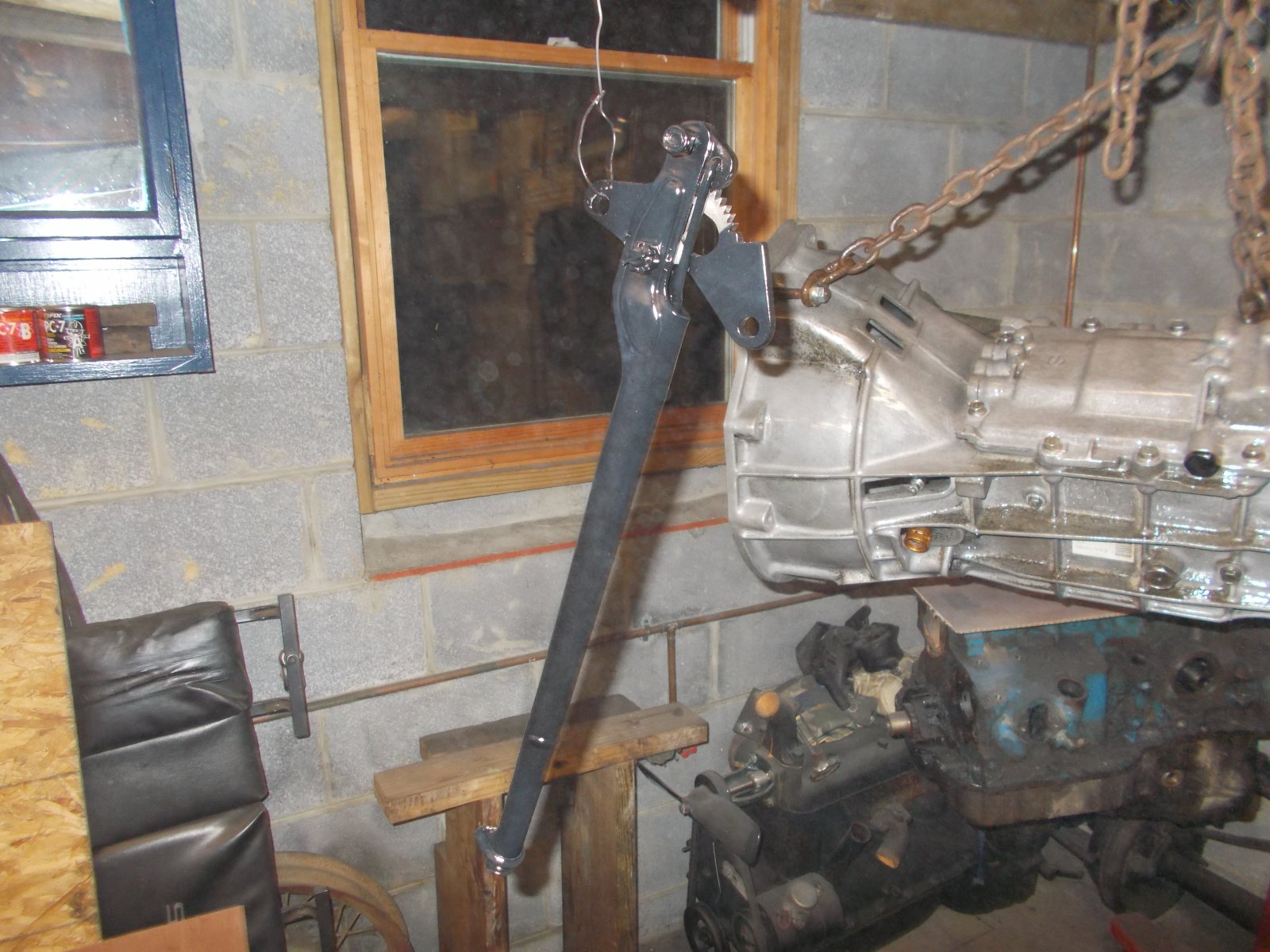

    Brian Lacovitch

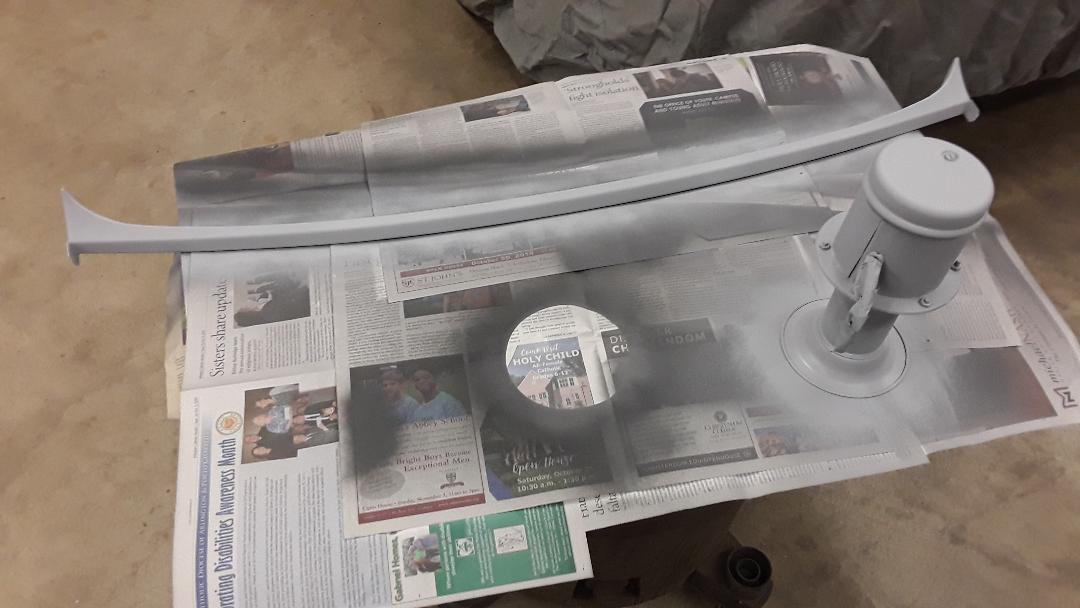

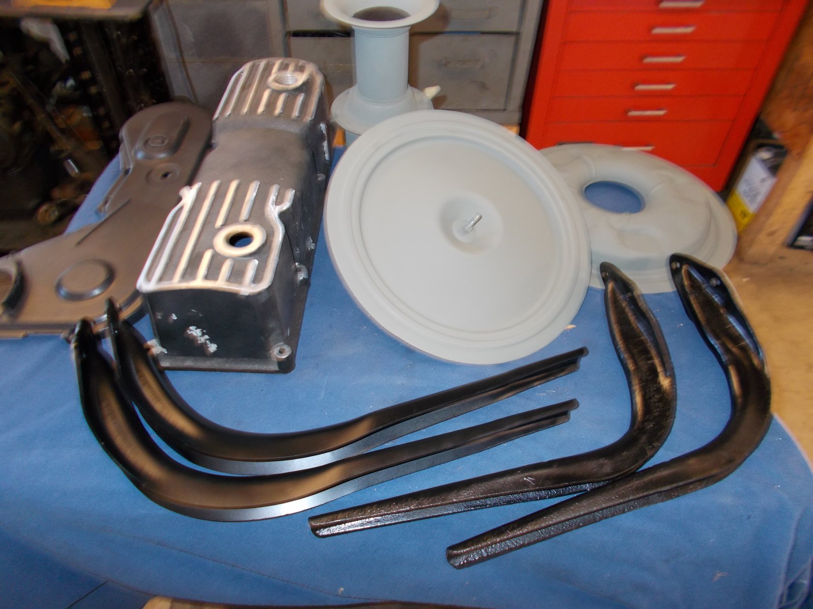

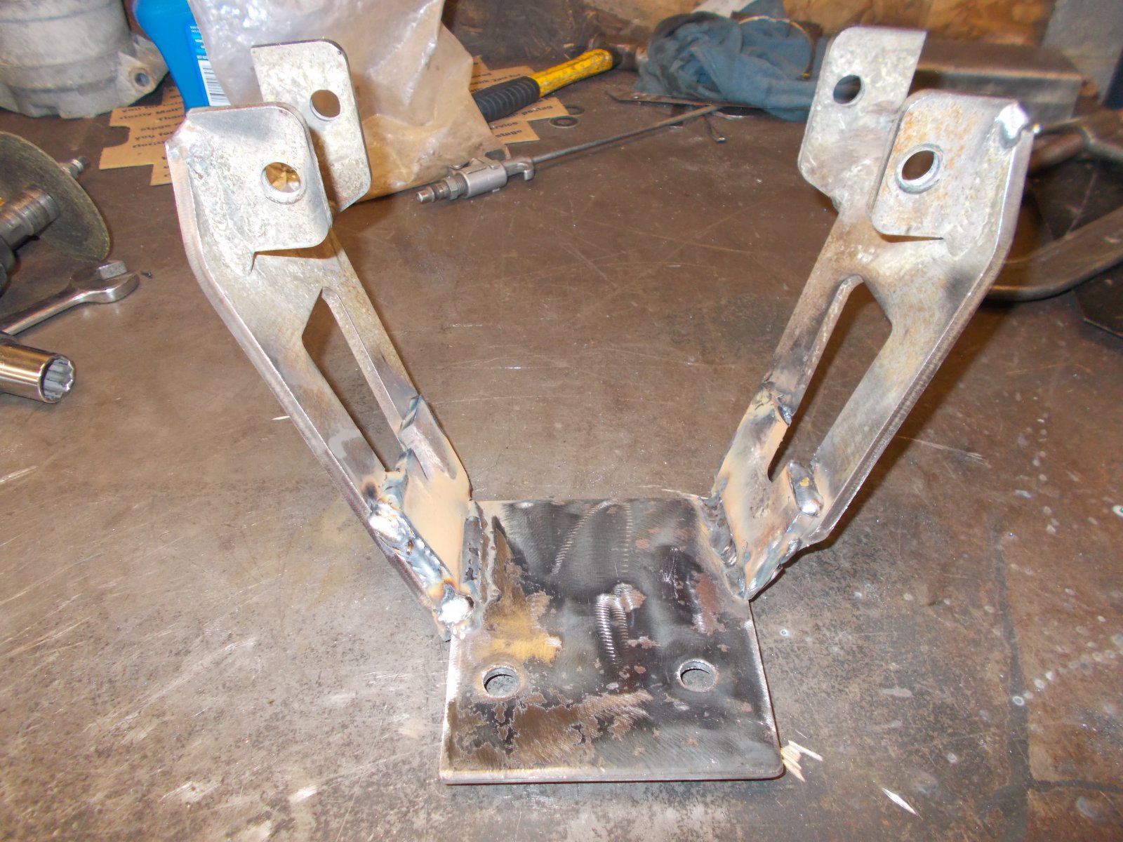

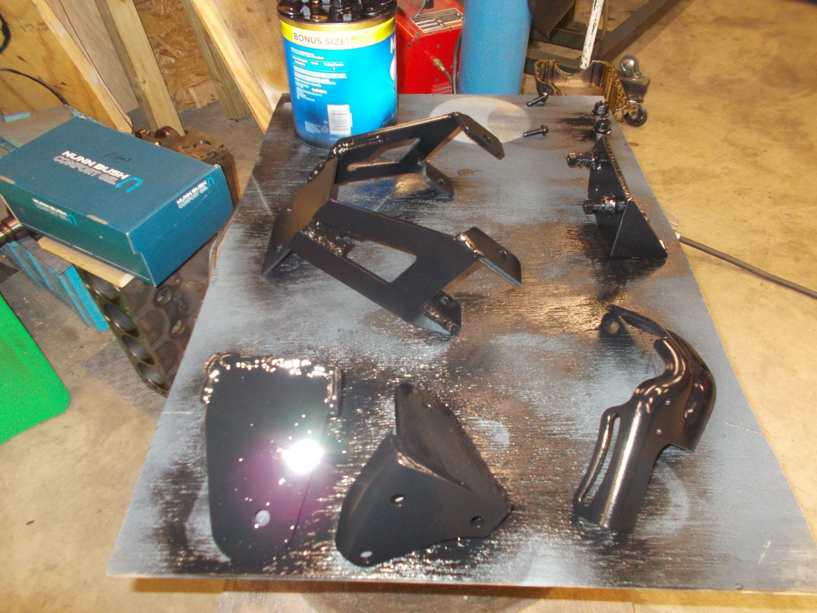

    I made a custom trans crossmember, motor mount brackets, and a throttle bracket. The rest of the pics. is painting a lot of stuff.

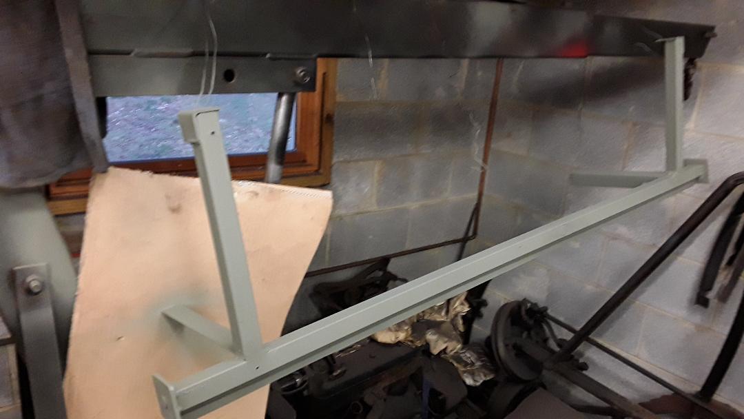

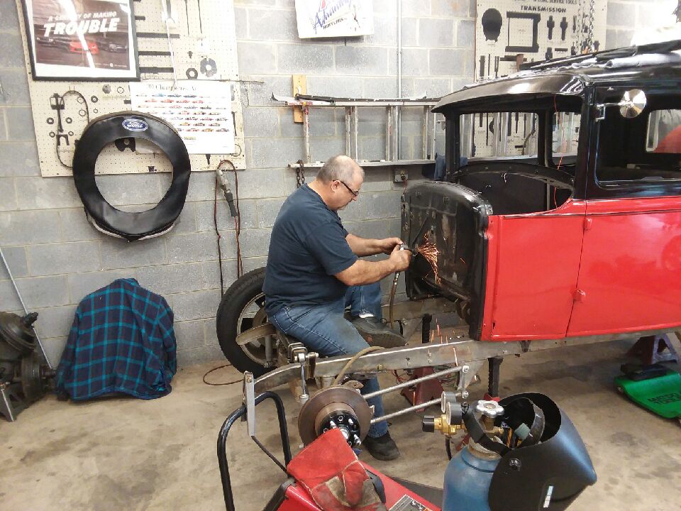

    The next set is my friend Bob (the skinny one) and me working on the fire wall.

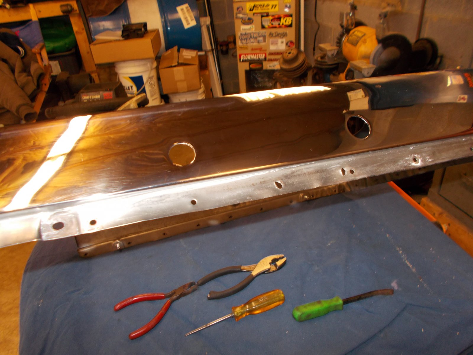

    Brian Lacovitch

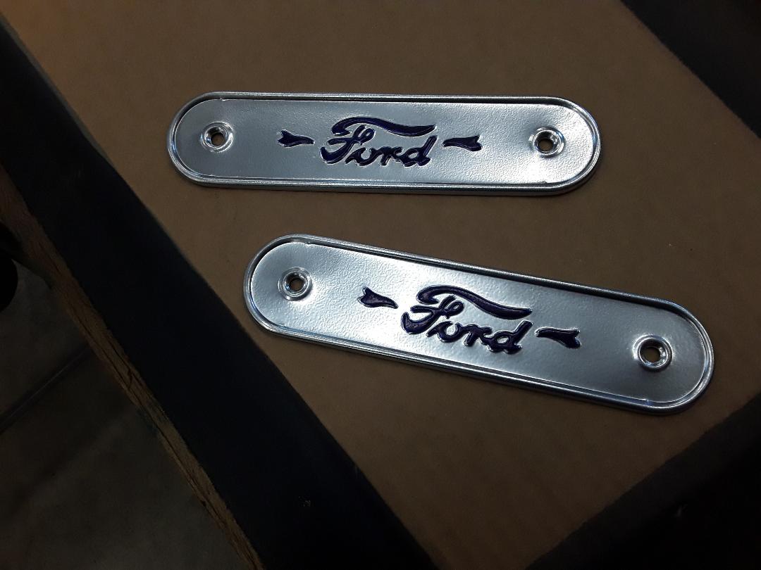

    I went to a street rod show in York Pa. and bought a lot of stuff. I went to an auction and bought the correct headlight bar, painted the scuff plates, made my own battery cables and bought new running boards. I bought 1930 boards but turns out I needed the 31 style to fit.

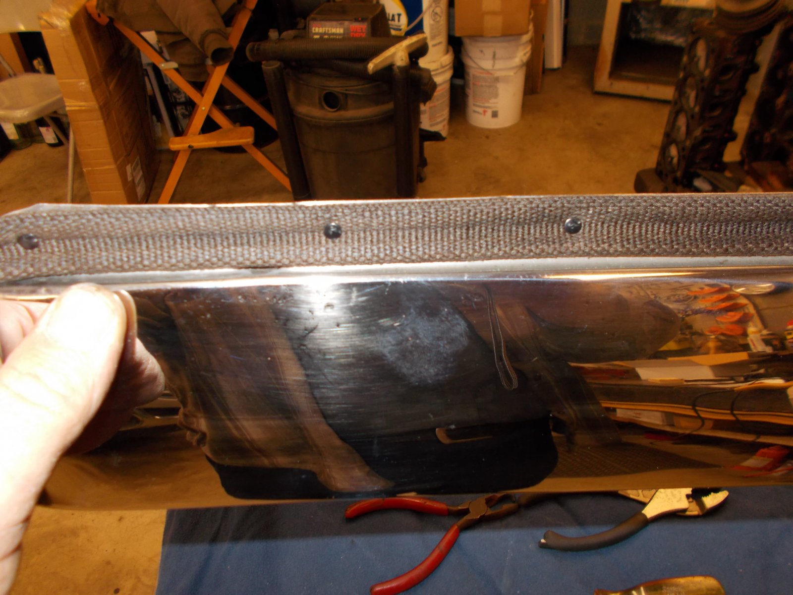

  8. Brian Lacovitch
    Posts: 36

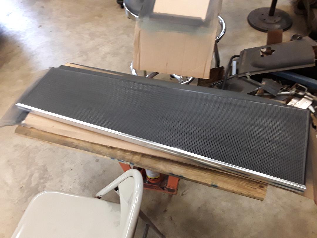

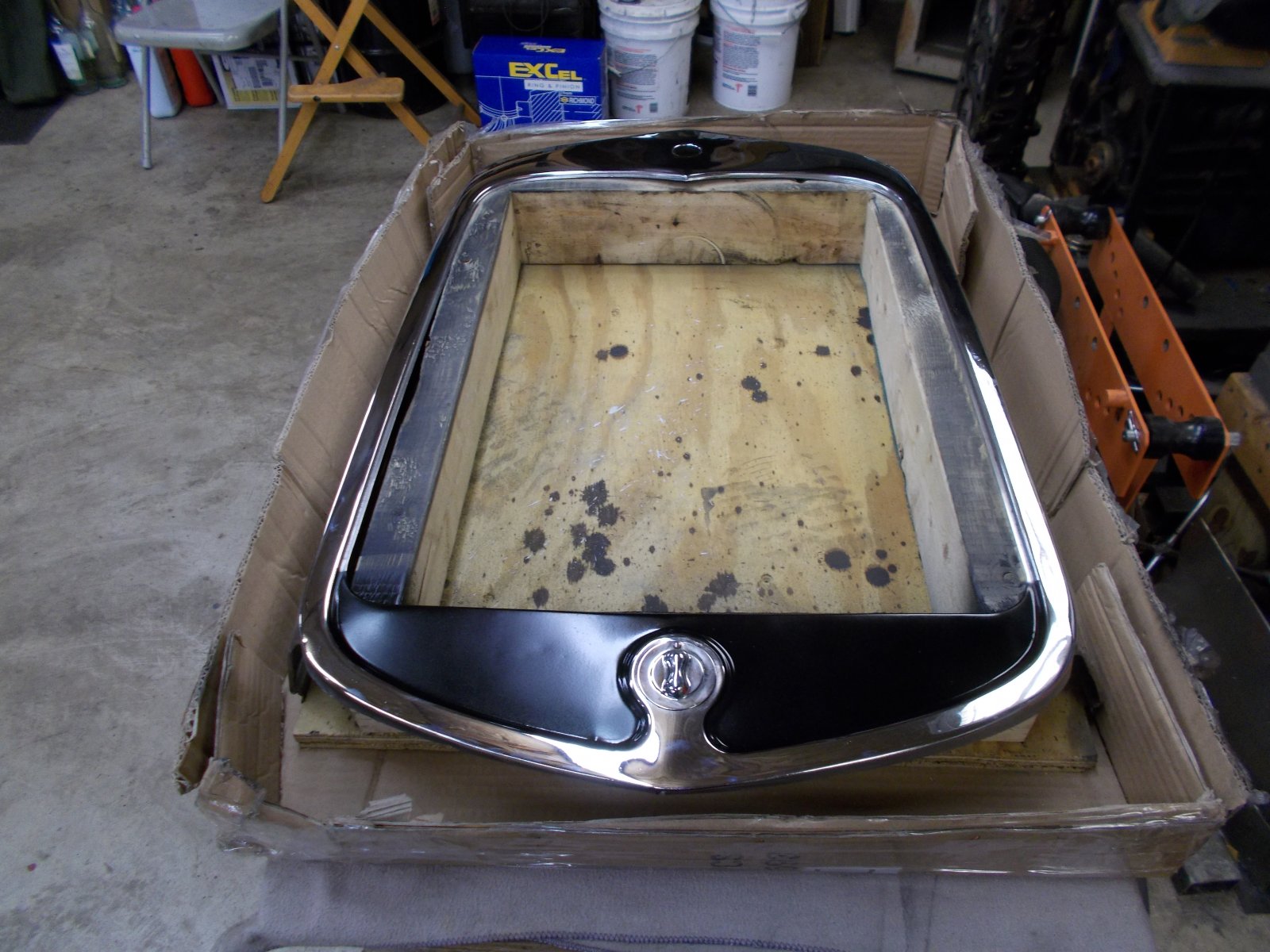

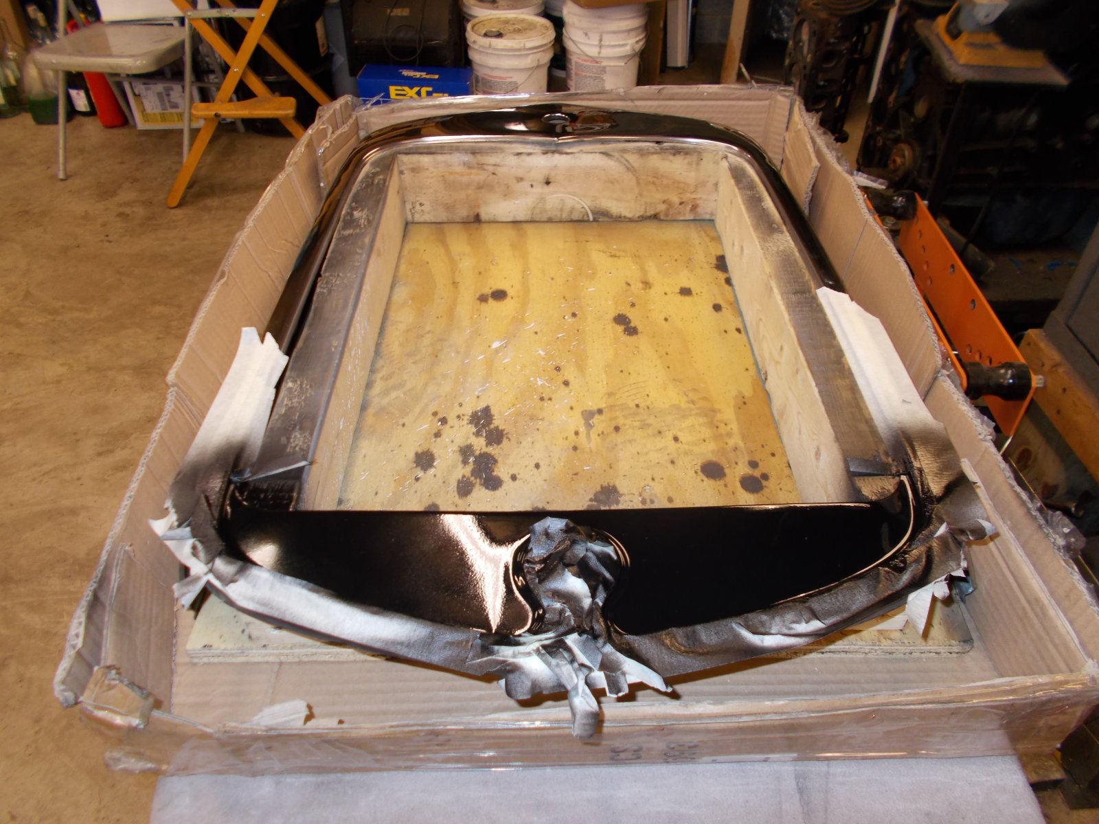

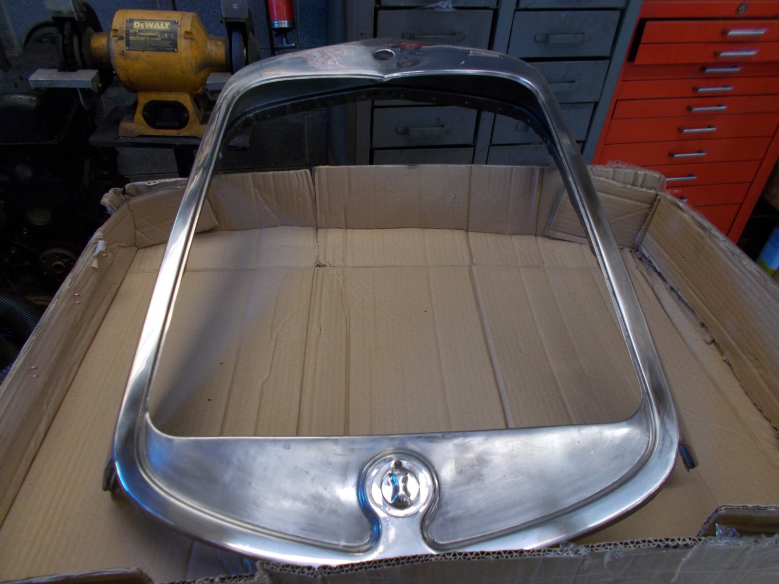

    Brian Lacovitch

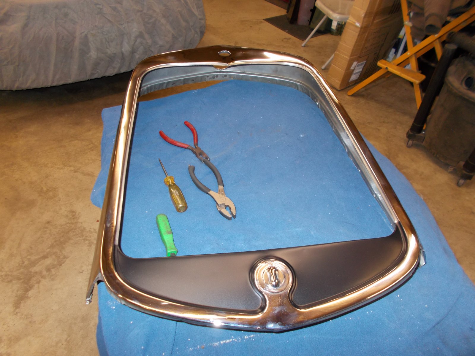

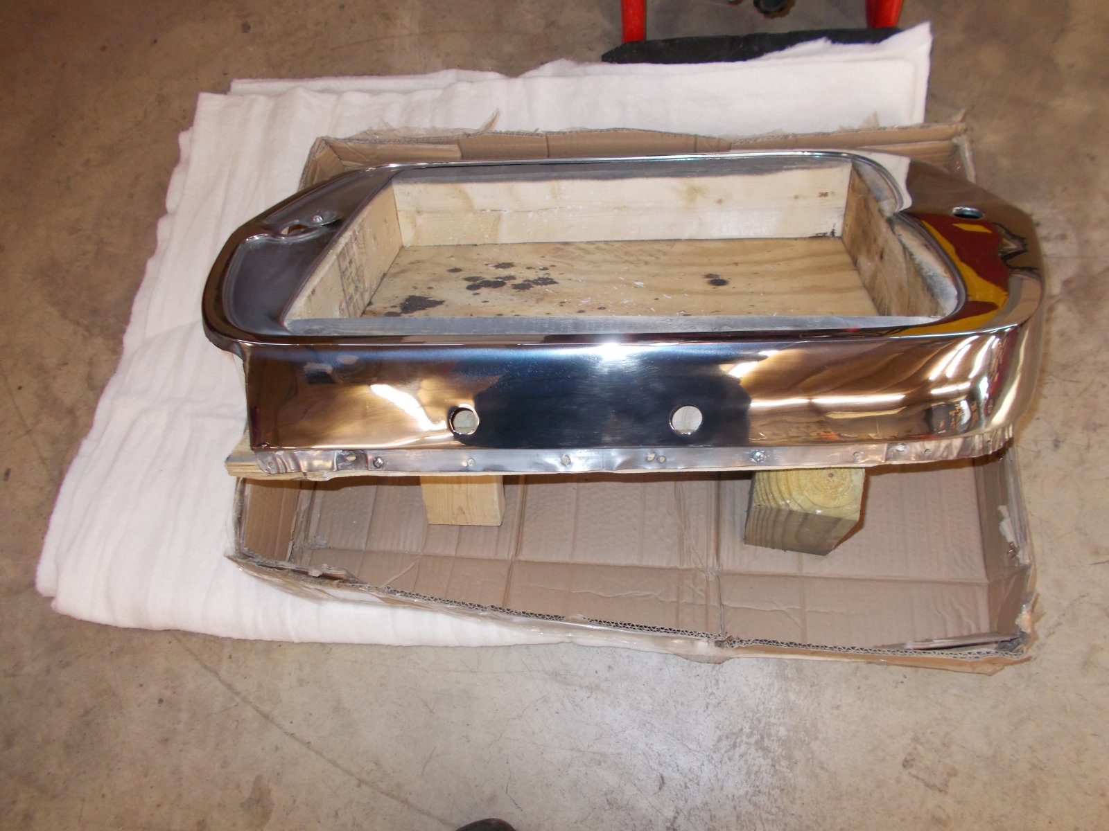

    The radiator shell that came with the car was in poor shape and I bought a good used one that wasn't cracked. I restored it and I think it came out great. I have never polished stainless before but watched some you-tube videos and gave it a try. the pictures don't do it justice.

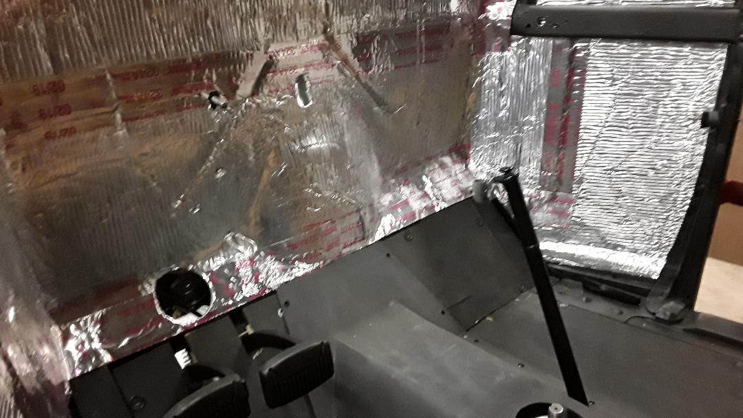

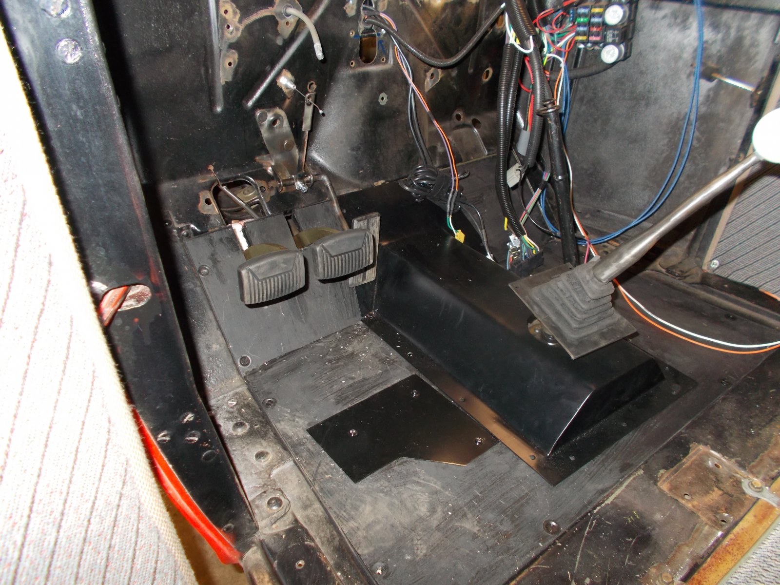

    Brian Lacovitch

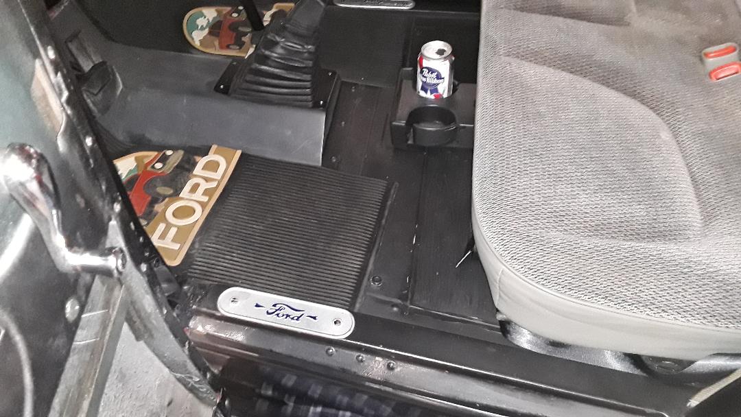

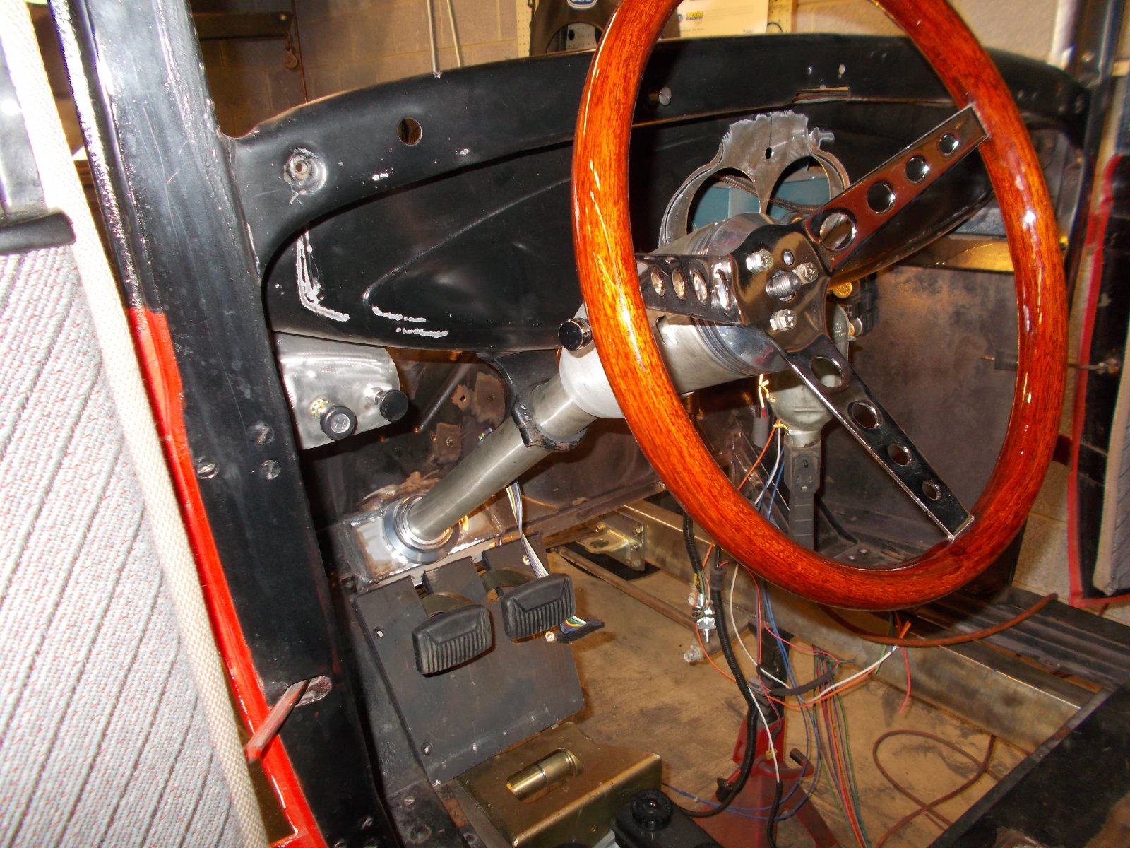

    Ok, the next set is shots of the pedals installed, the steering column and wheel, insulating the fire wall and trying out that cup holder!

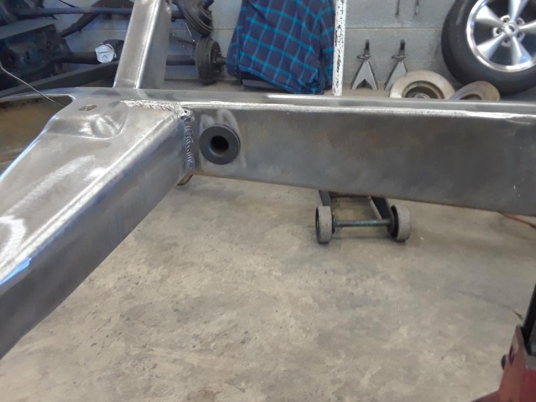

  10. Brian Lacovitch
    Posts: 36

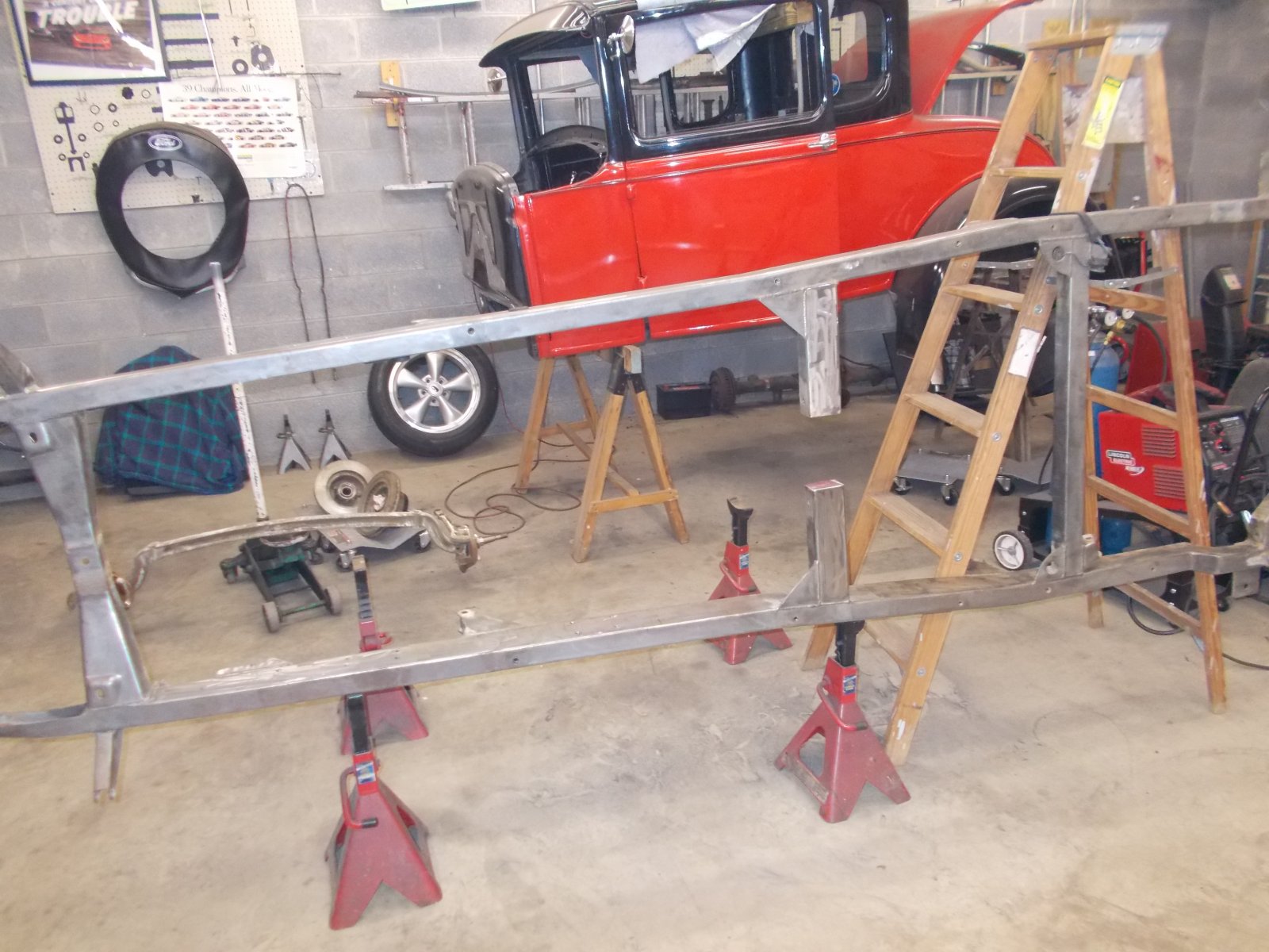

    Brian Lacovitch

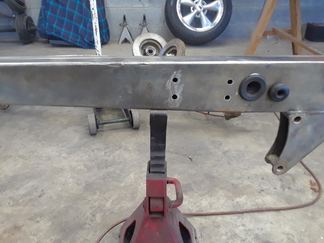

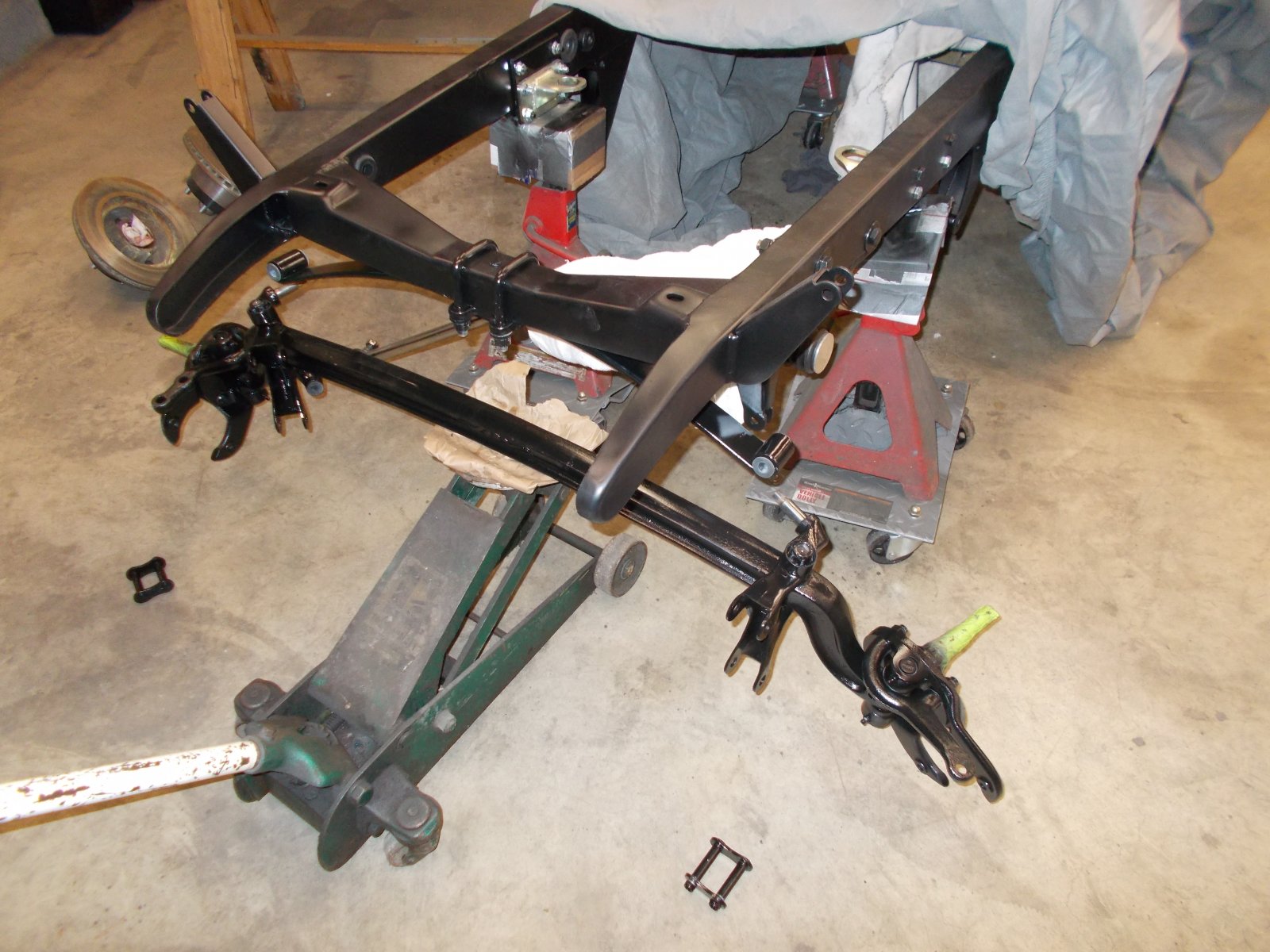

    Getting the frame ready for paint. The rubber grommets you see is for the wiring and battery cables were routed through the frame. Disregard the wheels as I didn't use those. I cut out the center crossmember so I could get the engine and trans as high as I could for ground clearance. I plated it back up at the top and got new body to frame blocks.

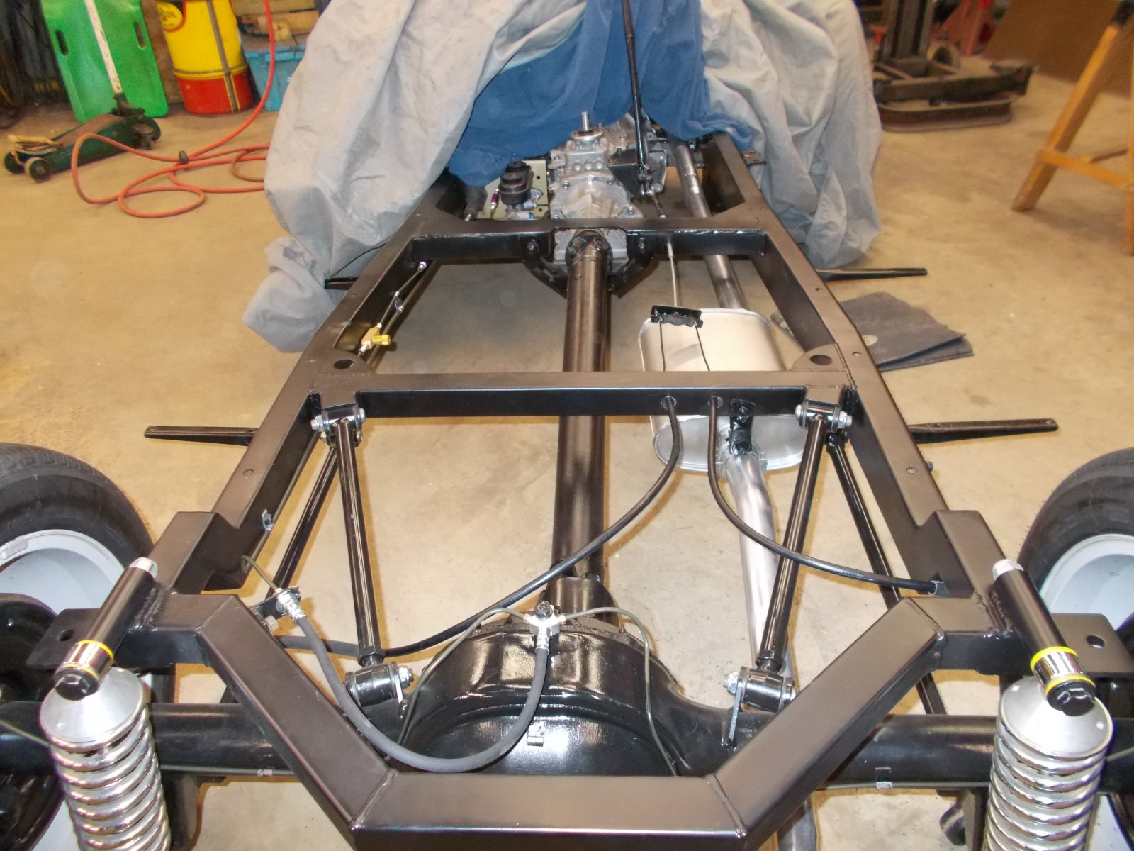

  11. Brian Lacovitch
    Posts: 36

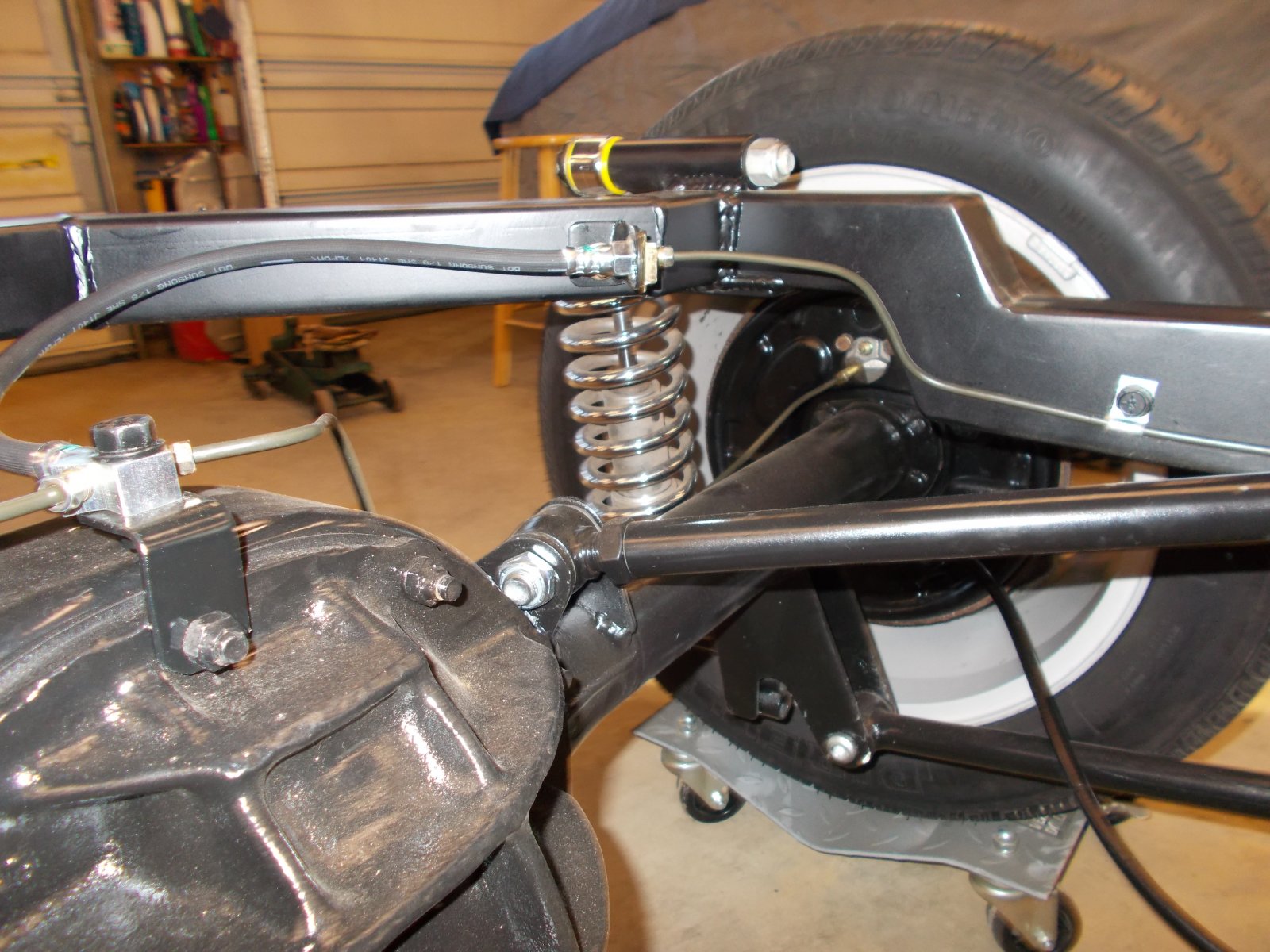

    Brian Lacovitch
    After I painted the frame, I installed the rear. These pics. some the details of the e-brake cales and routing of the brake lines and rear hose.
  12. Brian Lacovitch
    Posts: 36

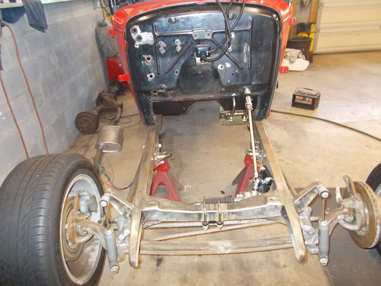

    Brian Lacovitch

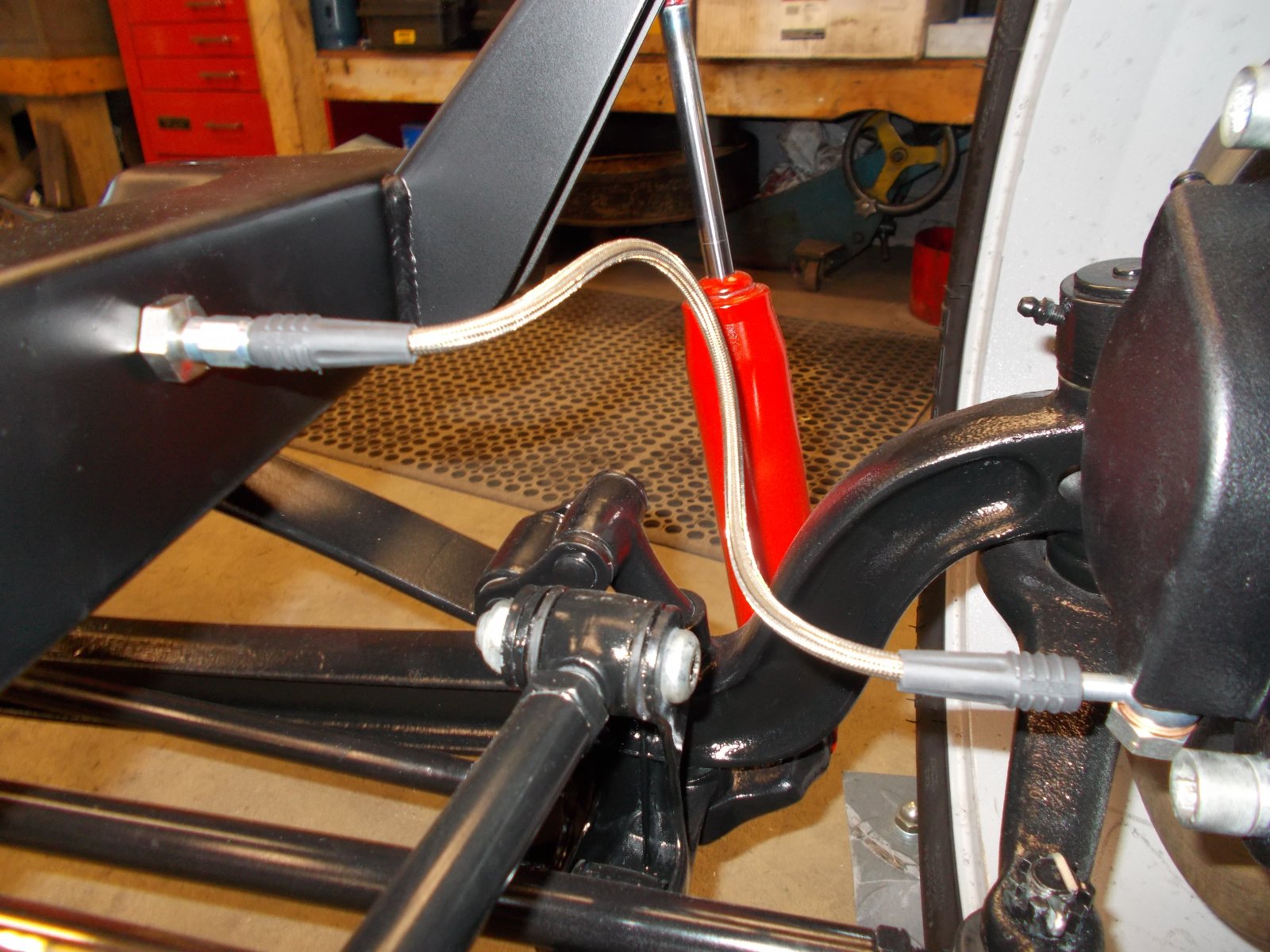

    So, the front-end is in, all the brake lines and hoses are installed, the drivetrain went in and were almost ready for the body.

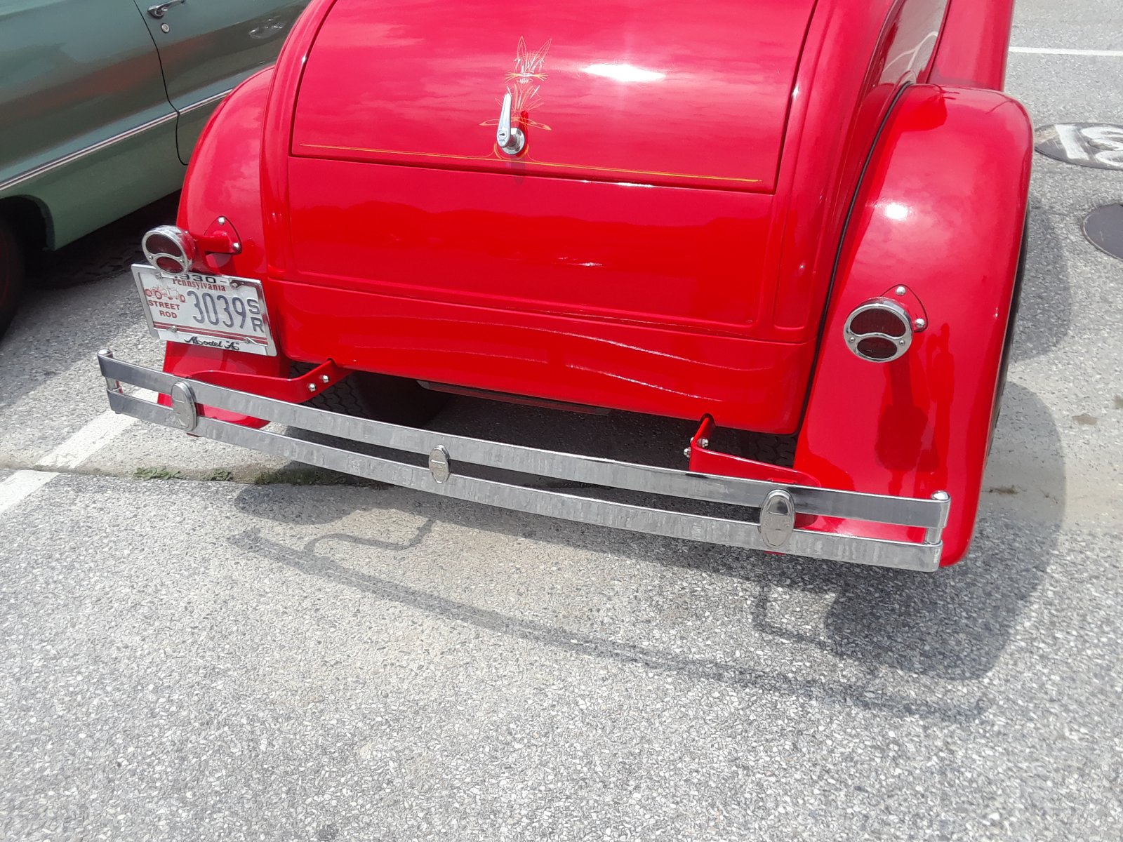

  14. Brian Lacovitch
    Posts: 36
    Brian Lacovitch

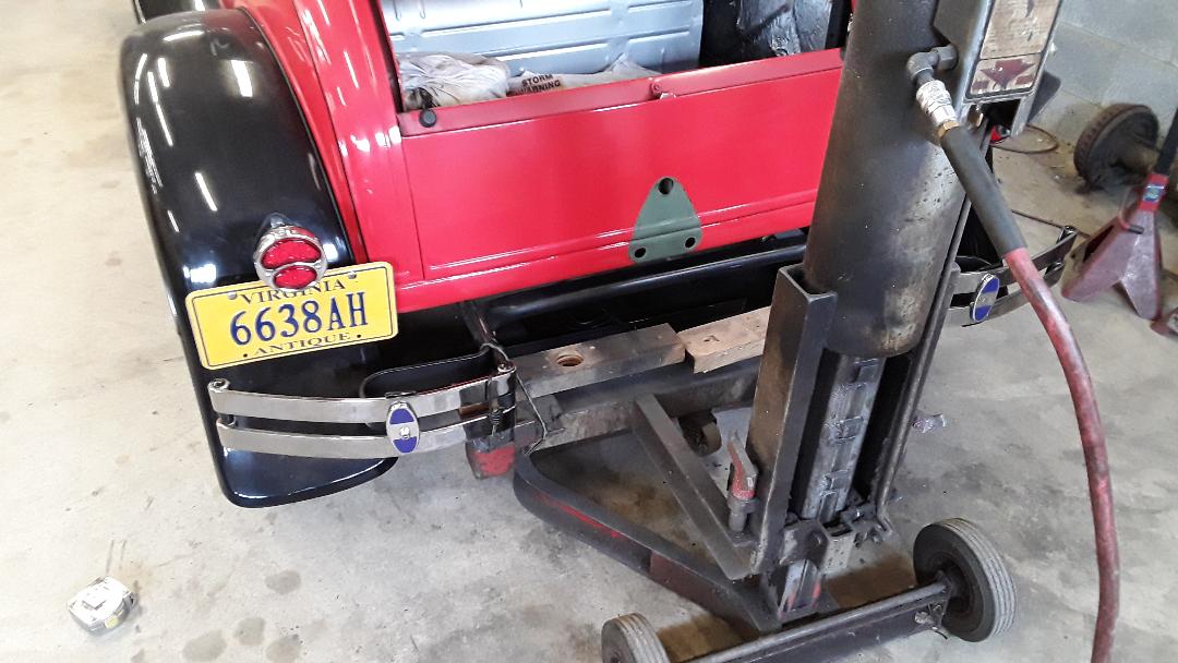

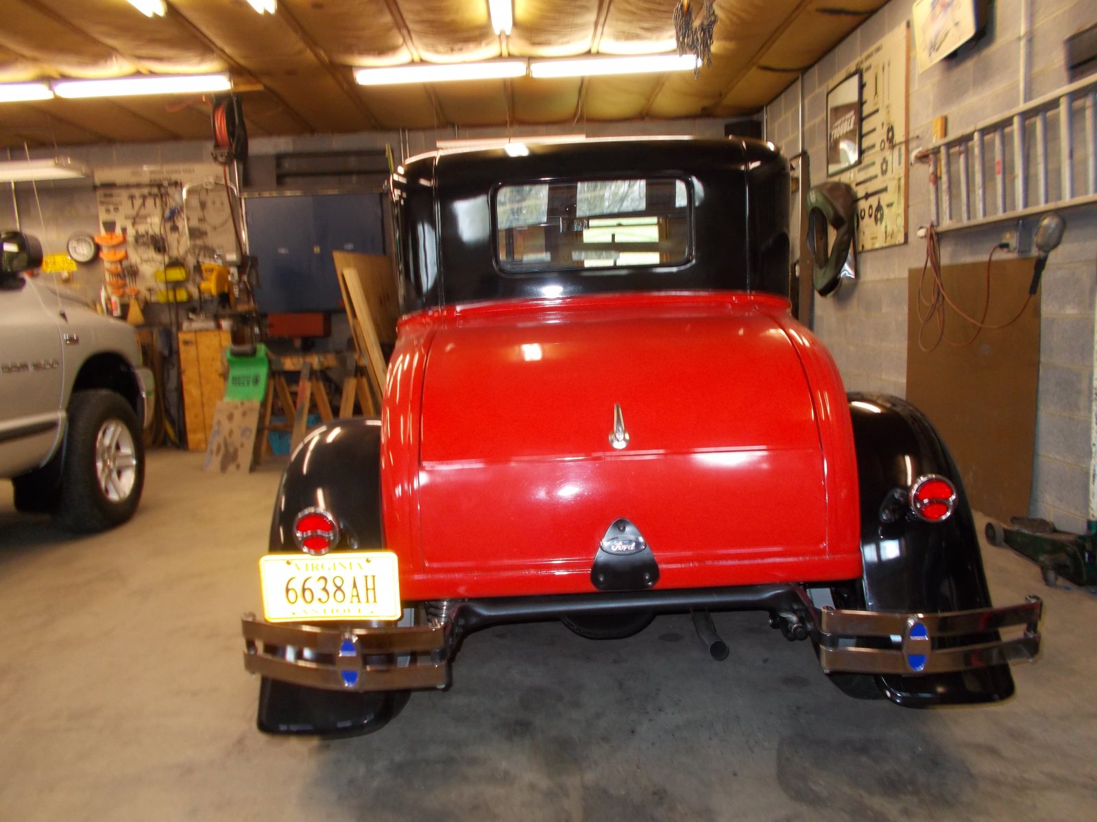

    I would love to shorten those rear fenders. I think the term is bobbing? I don't have the heart to destroy fenders this nice. It didn't look so bad after I raised the mounting of the rear bumper higher then stock. The original bumper brackets wouldn't bolt up to that frame anyway. The last picture is not my car but I like the look of the front bumper on the rear.

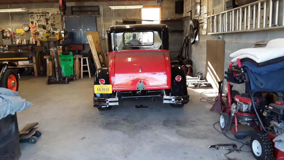

  15. Brian Lacovitch
    Posts: 36

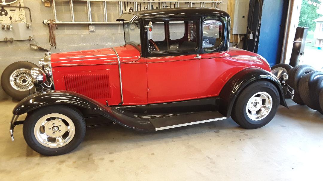

    Brian Lacovitch

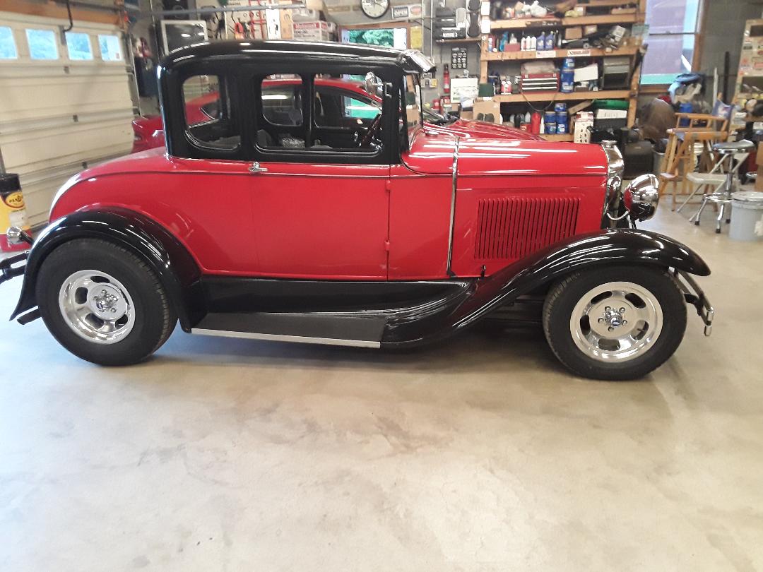

    I have some pictures of the first time the car was outside in 5 years, but I won't show them because I had the Bullitt wheels on it. I didn't know that it just about impossible to steer it, the radius was way too wide. Ok so I have 2 pictures of the car about 90% complete. The interior isn't done, and I'd like to find a used front bumper for the rear. The last 2 pictures have American Racing slotted wheels on it, red car 2.jpg done for now.jpg and I like them. If this build offends anybody, I'm sorry but I thought this project was very similar to others posted on here. I don't do body work and this paint job isn't perfect but if it was, I'd be afraid to drive it. Than's for reading all this!!

    Looks great. I like the Ansen type wheels on your car with the fenders.

    abonecollector
    I was hoping you were not going with those fancy wheels i saw in a few of the posts. The aluminum slot wheels look right on that model A. Nice looking car.
