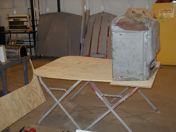

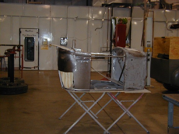

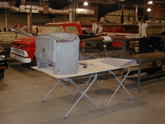

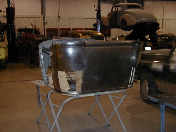

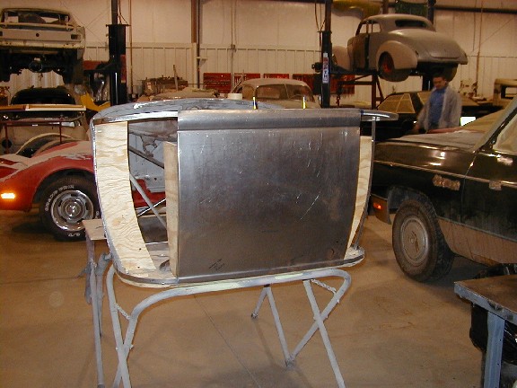

  1. O.K. This will be my first attempt at posting pictures. Here's my story. I moved my wife and kids from Lowell MA to western PA to go to Wyotech. I just finished with the street rod program and now I'm off to chassis fab. I've never swung a body hammer or did any sheet metal fabrication (some structural though, frames, etc.) before I took this class. I started witha 30/31 roadster cowl and a 30/31 gas tank that I picked up for $20 a piece at Amherst. After I sandblasted them and did some repairs, I started laying out the size of the body I wanted. I then formed some "L" channels to make a basic skeleton of the shape I was going for. I then fabbed up the back panel, two side panels upper and lower prtions of the corners. I have ot do final trimming, shapeing, welding and then I can move onto making the doors. Like I said i had never done anything like this before and I'm pretty happy with how everything is coming out. I'm by far no expert on this, but I would like to do this for a living when I move back to the New England area this summer. Let me know what you guys think of this. Thanks Ed

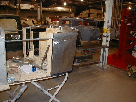

  2. Here are some of the body panels
