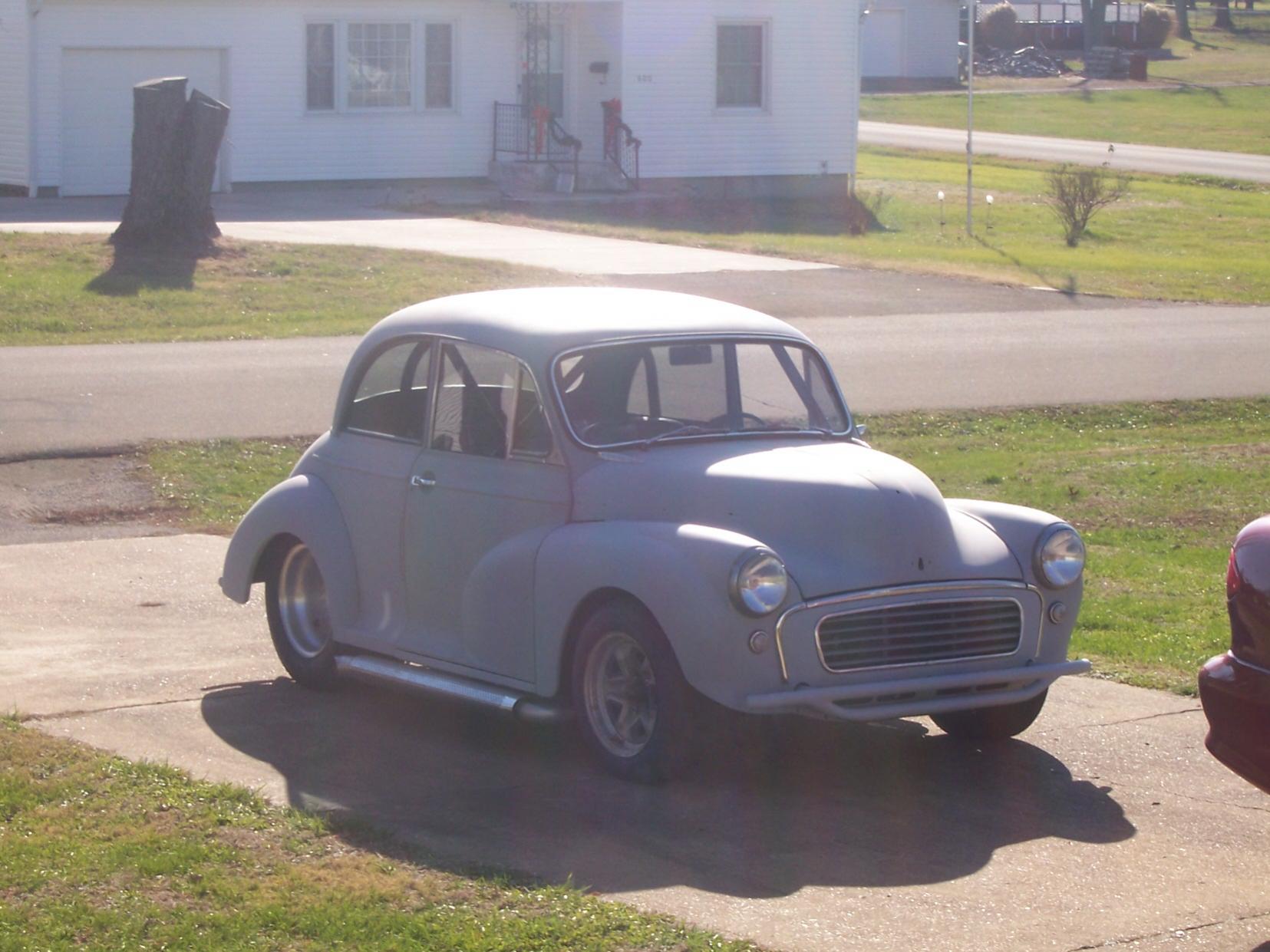

    Here's the latest update on Morrie. I have the roll bar installed and the seats mounted. Will post more photos later.

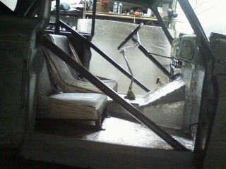

    Here is a better photo of the roll bar and seats and column mount.
    Next comes the carpet and and wiring. I still need to install the swing outs for the roll bar door bars.Getting too old to climb over the bars for every day street driving and this will be my daily driver when I am not riding my motorcycle.

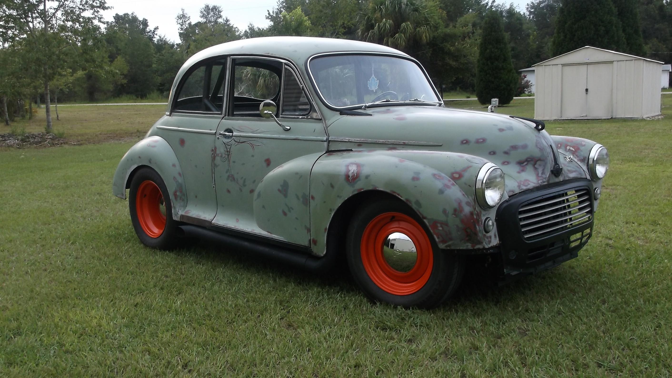

    Here are some photos of the Morris Minor at it's first car show and getting some pin striping.It drives really well,but needs more gear. With a 3.00 gear and the AOD it is turning 1200 rpm's at 55mph and it is almost lugging the motor at lower speeds unless I manually downshift. So I am going to go to a 3.70 gear which should help and I am going to put 6 in wide front wheels and put some 195/60-15" tires on the front.I need to widen the track a little.
    AHotRod and volvobrynk like this.

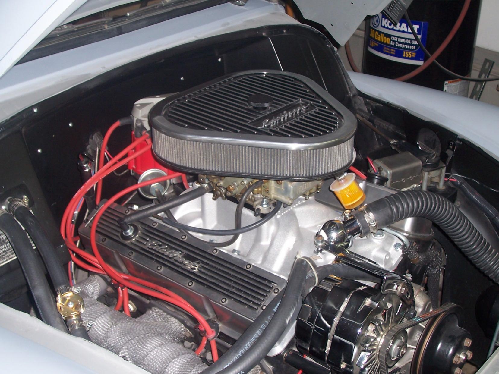

    Update on my Morris Minor. I had some bump steer issues and am adding a bump steer kit to lower the tie rod ends. I am also adding a rear sway bar to try and stop the car from unloading when I lift from full throttle. the car gets a little spooky when the weight transfers back to the front end.
    I have a 4.11 posi chunk to stick in the car and a pair of aluminum heads and a Comp 35-440-8 cam to make it even more
    fun to drive. Short wheelbase overpowered cars are so much fun.

    I have changed the heads and cam and stuck the 4.11's in and it really can to life.Still drive it almost daily.Have not been to the track yet,waiting for cooler dryer weather down here in Fl.

    Poll. When I go to cruise-ins or car shows ,I get about a 50-50 opinion about paint. Some say don't paint it.Some say when are you going to paint it. I have the paint to paint it Lime Green Pearl,but what to do if I get it it done and don't like it.
    I have struggled with this for months.How about a poll ,maybe that will help me decide.This is the way it looks now.
