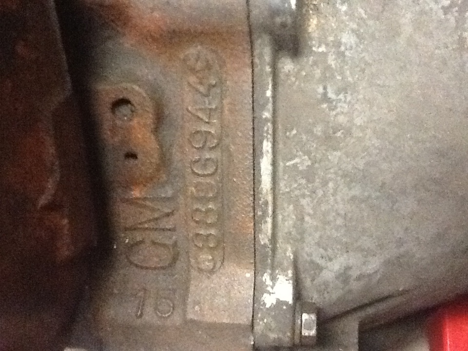

    El Bricolaje
    Engine block numbers.

    1967 283 block, and most likely has a 1.82 first gear Powerglide. It has the "better" design dampener. Parts shopping time on that auction site we all know and love. Butch/56sedandelivery.

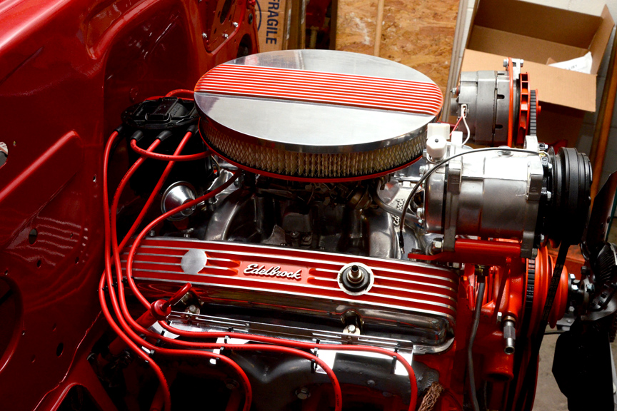

    I just got finished with a 64' 283 for my Belair.Bored it .030 over,Comp Cams 262,Power Pak heads,MSD dizzy,Weiand,Holley, w/ 2 sp. air cooled aluminum powerglide,factory posi rear.I'm real happy with the results,good little street motor.Fun to drive without spending a ton of $.

    283 and 327s have my heart. Mine is a 66 283 bored 4" (needs to be tested first) with a 327 crank and camel heads. 3x2 on top and she screams!

    Just cranked my 283 up for the first time yesterday....75 lb oil pressure, 190 on the temp, had no real problems....had a carb fire on the very first crank, but it went out quickly. Small 700R trans leak at the filler pipe, was in a bind...okay now....need to brace off the alternator a little more though.
    Engine sounded real nice...like its going to run just fine....bored 60 over, Z28 58cc 601 bigger valve heads, 327-300 cam, quadrajet, HEI dist, flat top pistons....yep...high test motor.
    It reminded me of my 327-350HP motor in my vette...it turns quickly...about 2400 rpm was my max yesterday on break-in.
