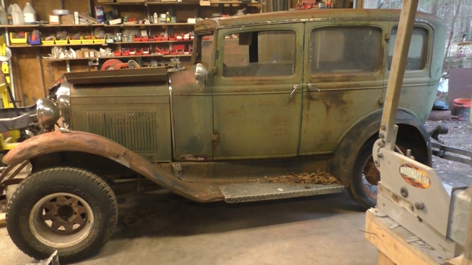

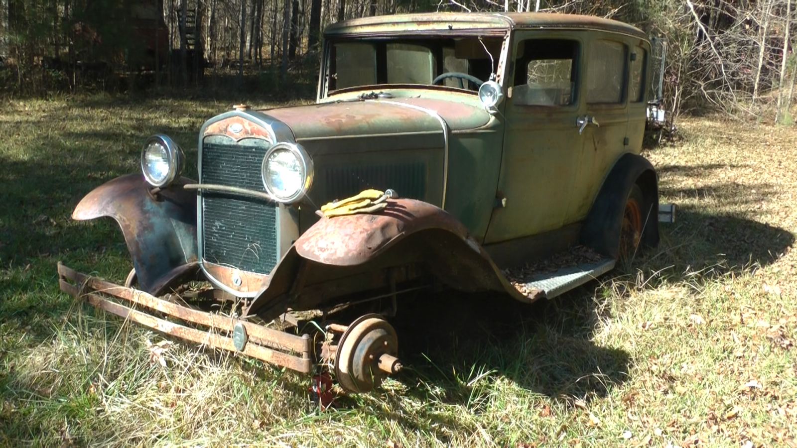

    Now on to the pictures! Here are a few do***enting the start of the build and some teardown. I have lots of plans for the build, I will post them in a later post. In a nutshell, it will be a street rod build (sorry traditional guys) modern drive line, paint, suspension etc.
    The car is actually in very good shape! Rusty but not a basket case. I'm currently cleaning several smaller parts in electrolysis in preparation for starting to rebuild the body eventually. The subrails and floor are in pretty good shape compared to some I have seen on the web, so I should be able to salvage them. I think. The body does need work- but it's not trashed.
    The car was all complete (minus a few small things) and all original when I bought it, and most mechanical things (except the engine, which was partially dis***embled) are in pretty good shape. Axles still turn, steering works, brakes probably work, ****** even still shifts. I will be selling some items down the road as I won't be needing them, most notably complete original frame and drivetrain, original fuel tank (if it's still good, I think it is.... need to test) plus some other stuff.

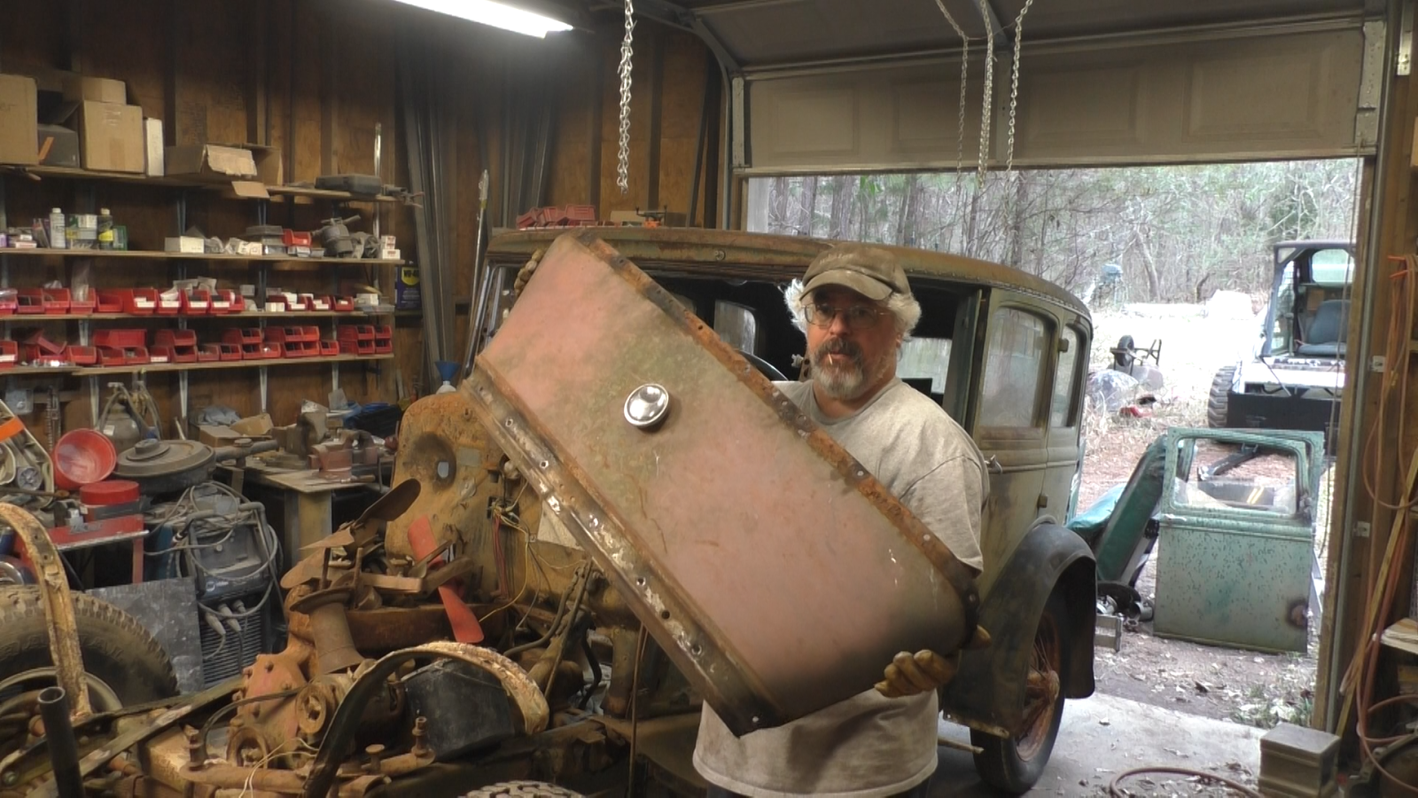

    I have broken down nearly all of the front body. The cowl sides and all but one last piece of the front "feet" I think is what they're called have been removed, ran through a cycle of electrolysis and sandblasted in preparation for rust repair. I have one last foot bracket to soak which I'll do this week. At some point I'll be removing the front "H" frame as a unit and placing it in electrolysis. How you might ask? I have some ideas I'll share when I get that far.
    Both cowl sides need some repairs but they're not horrible. The bottoms are gone as to be expected. The cowl areas around the drivers door hinges are severely damaged from some horrible brazing of cracks many years ago, so those areas need to be repaired.
    I'll be making my own patch panels for those areas as I am a fabricator, experienced body man and pretty good metal shaper. I'm getting better at it too and have bought several specialty metal shaping tools in the last few years - I wish I'd had in my 20's but oh well... Most of the aftermarket patch panels don't fir correctly and I hate that. So making my own it is.
    The one panel I'm not sure of making yet is the upper cowl panel. I'm not using the stock tank, but I'm 90% certain (still need to test) it's a good tank and I don't want to cut up a good tank, so I'll need to buy or make a replacement. Still not sure which way I'm going. If I can find a Brookville I might get one from them. Would be easier for sure.
    Anyway here's a few pics of where I'm currently at.
    Cowl foot in electrolysis tank. If you've never used electrolysis you should. I have a couple videos on my YT channel if you're interested, or just search the web.
    This is one of the cowl feet after about 30 hours of soak time. The black color is the iron compound that rust (iron oxide) turns into. But, a lot of the rust just falls off. The black coating is what's left. Once the piece is in this condition sandblasting is VERY easy. And quick. (See the blasted pieces above)
    For comparison, here's the p***enger side foot as it is before I remove it. BIG difference.
