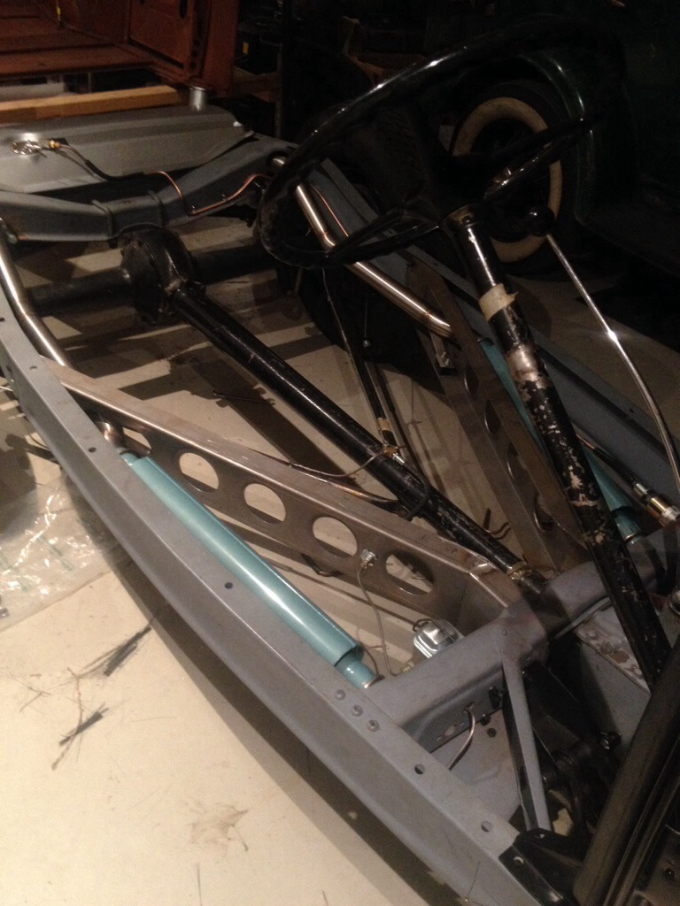

    Well still going at it, running brake lines, fitting up fuel tank, needed a bit of instant gratification so mounted gauges, drilled and tapped some bungs and welded to back of dash, just wanted to keep it plain and simple. ImageUploadedByH.A.M.B.1371557991.443986.jpg

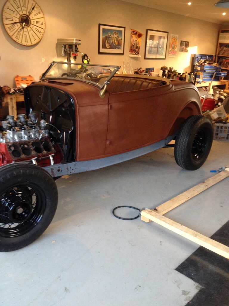

    Couple of updates, got the roller back from Rancho deluxe last week where Ben fabed one of his primo exhaust systems and did a couple of other jobs.
    Today a couple of club mates came over to help lift the body on for final mock up. To me this is what hot rodding is about, perfect spring day, buddies and talking ****, life doesn't get much better. ImageUploadedByH.A.M.B.1380975197.206813.jpg ImageUploadedByH.A.M.B.1380975224.000375.jpg ImageUploadedByH.A.M.B.1380975249.930653.jpg

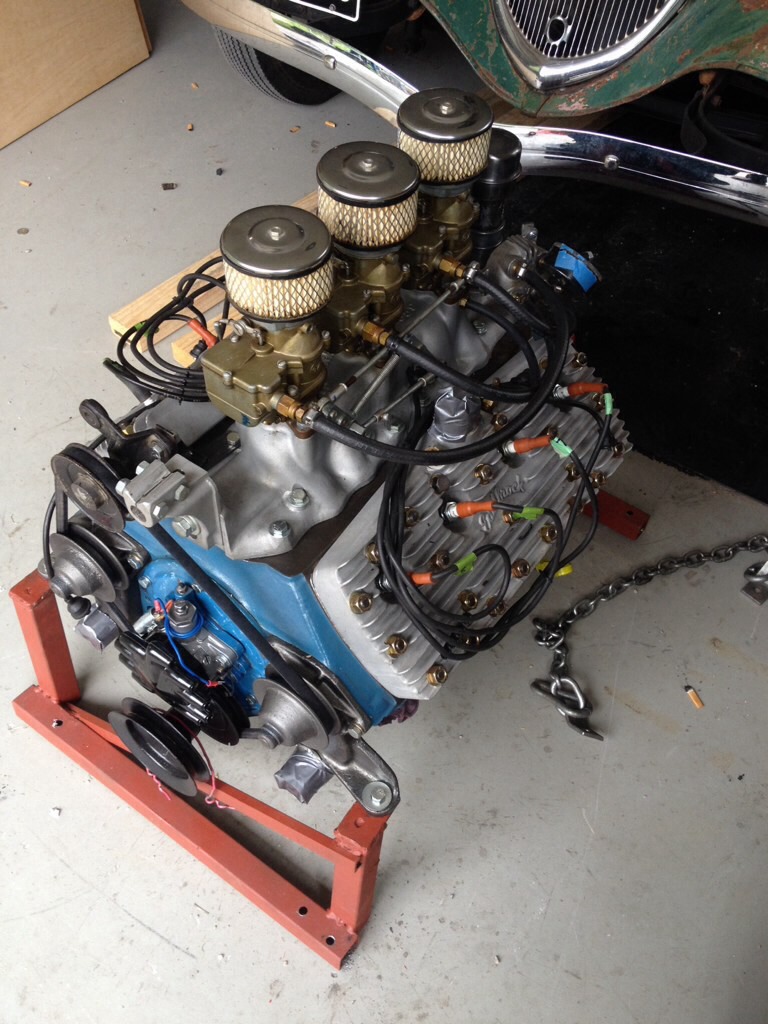

    I was browsing the HAMB cl***ifieds a couple of months ago and spotted this 59a, with my machinist taking an eternity on my merc block, well one thing led to another. I called up Bill, who at the time was a new member here but a long time member on ford barn, a deal was done and it's here now.
    It's a race flathead with isky 404 radius lifter cam, all the right parts, may be a little overkill for street use, I'll run it as is for now and if need be a cam change to tone it down a little. ImageUploadedByH.A.M.B.1382832471.817563.jpg

    I run a 404-A cam on the street and it doesnt sound nasty, but has a very wide powerband
    Which makes it good for street use.
    It makes very good power, too !
    hotrodA likes this.
  24. HotRodMicky
    Joined: Oct 14, 2001
    Posts: 1,793
    HotRodMicky
    Just to make clear , the 404 only has 265 duration and i think only 36 degrees overlap
    So not very radical
    The trick is that it has very steep ramps .this why it needs radius lifters
    It gets very good gas mileage , too
    Going 120 km/h the engine need 12Liter per 100km
    The potvin 3/8 has a much worse mileage, for example.
    So if set up right, you will love the cam and it will last for a looong time
    I have 10.000 km on my engine so far

    Thanks for the heads up Micky, my concern was an increased rate of lifter/cam wear due to the steep lobe ramp, can't wait to drive the wheels of this thing.
