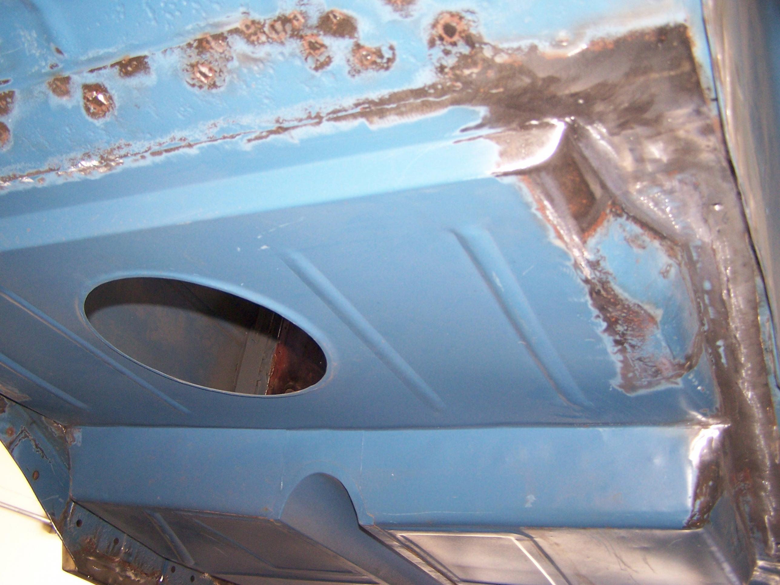

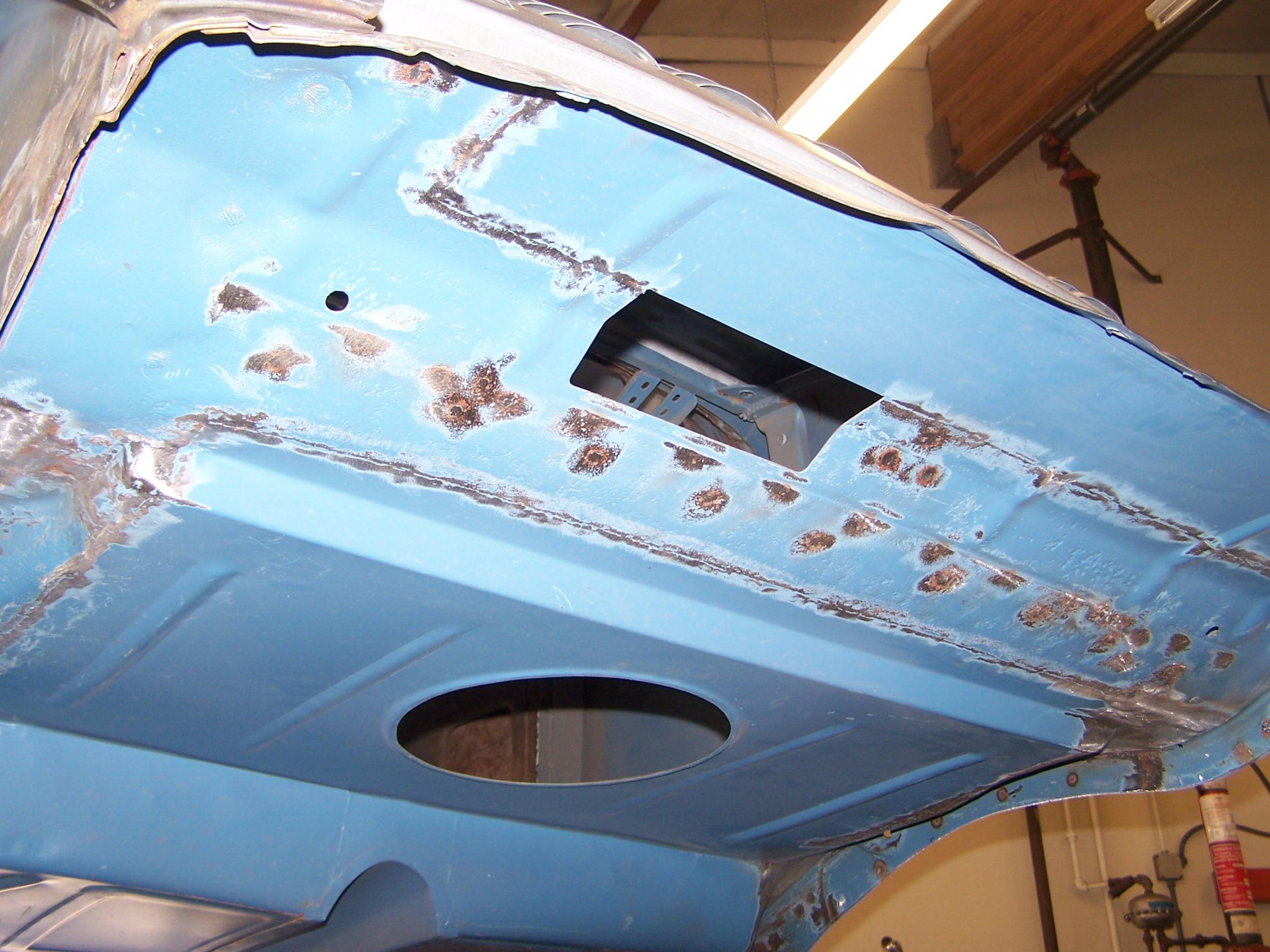

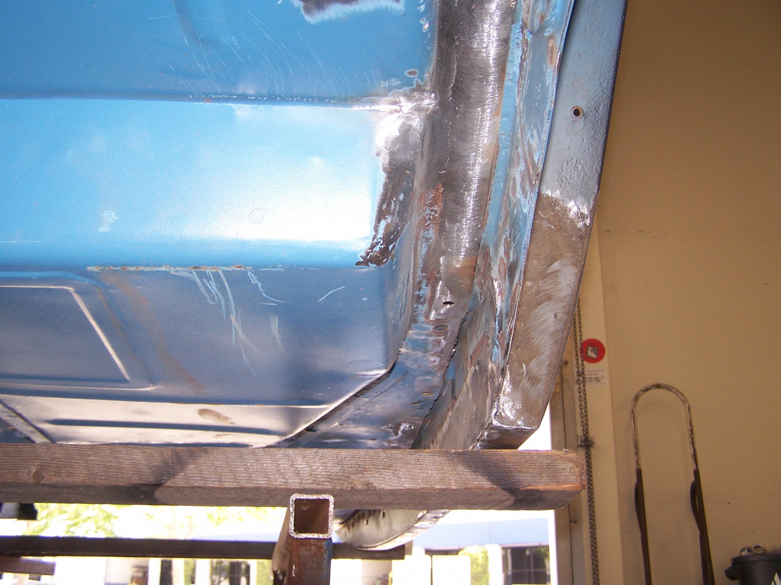

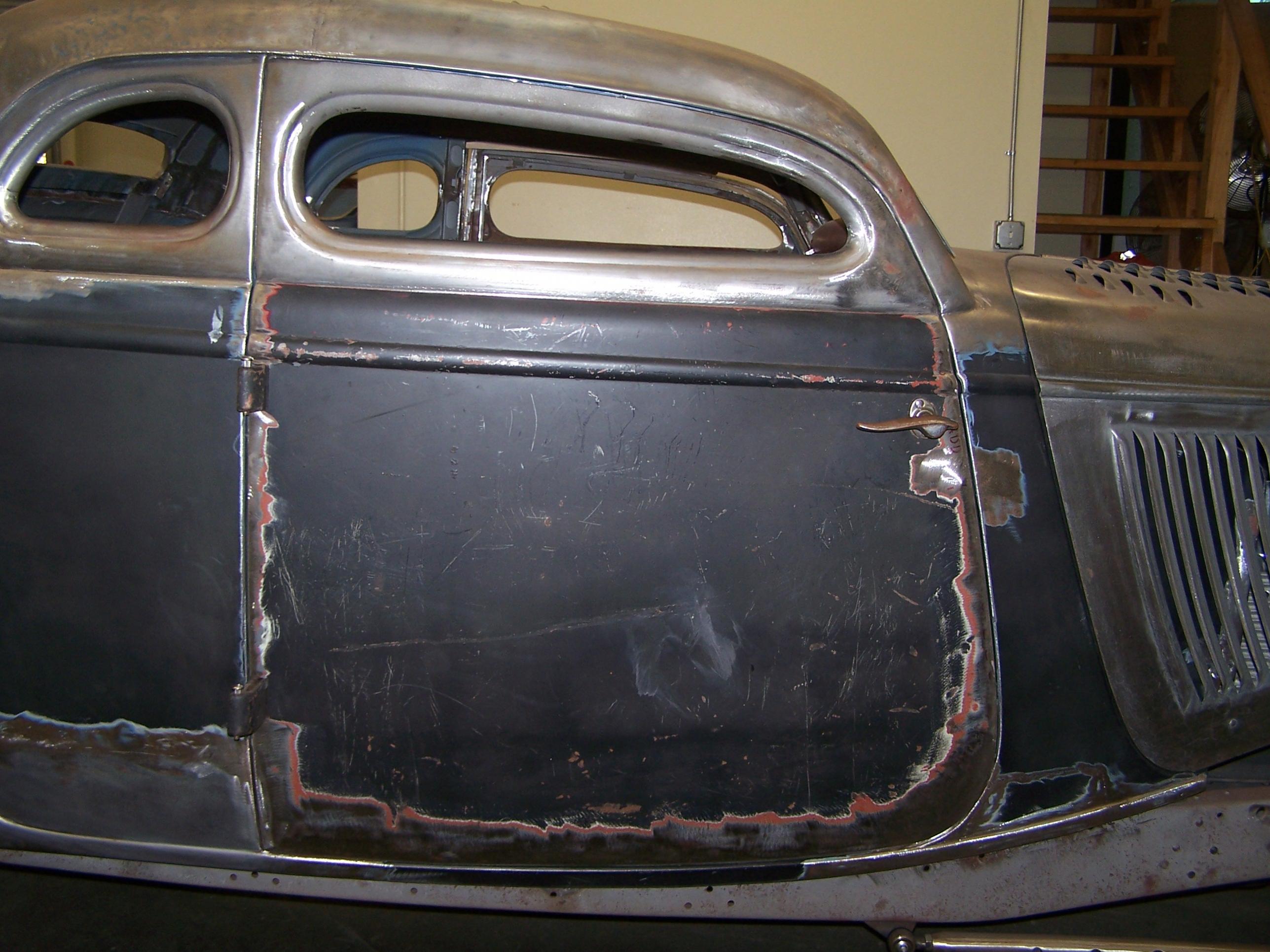

    "Below are some pics of the endless hrs of tedious metal repair to preserve the original floor and subrails"
  15. D ROD
    Joined: Jun 28, 2010
    Posts: 965
    D ROD
    from New Jersey

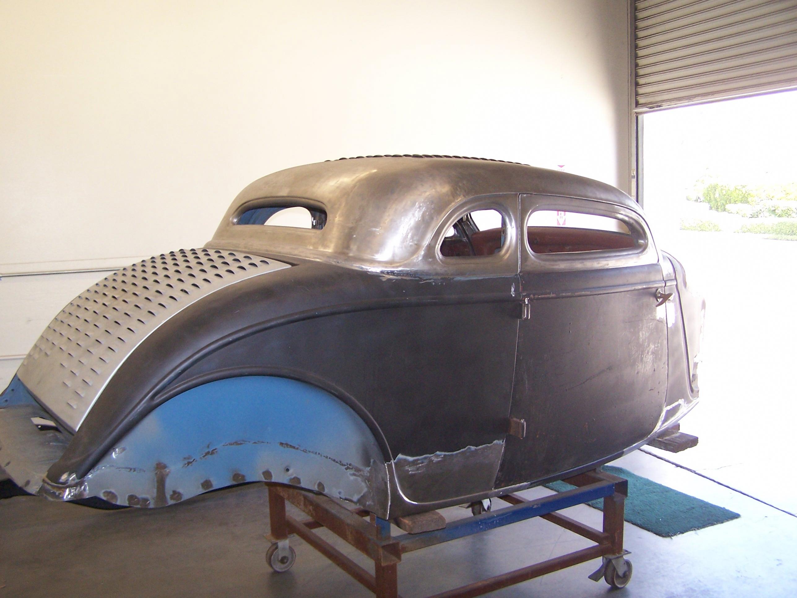

    Your typical inner rear wheelwell and rear patchpanel repair!!!

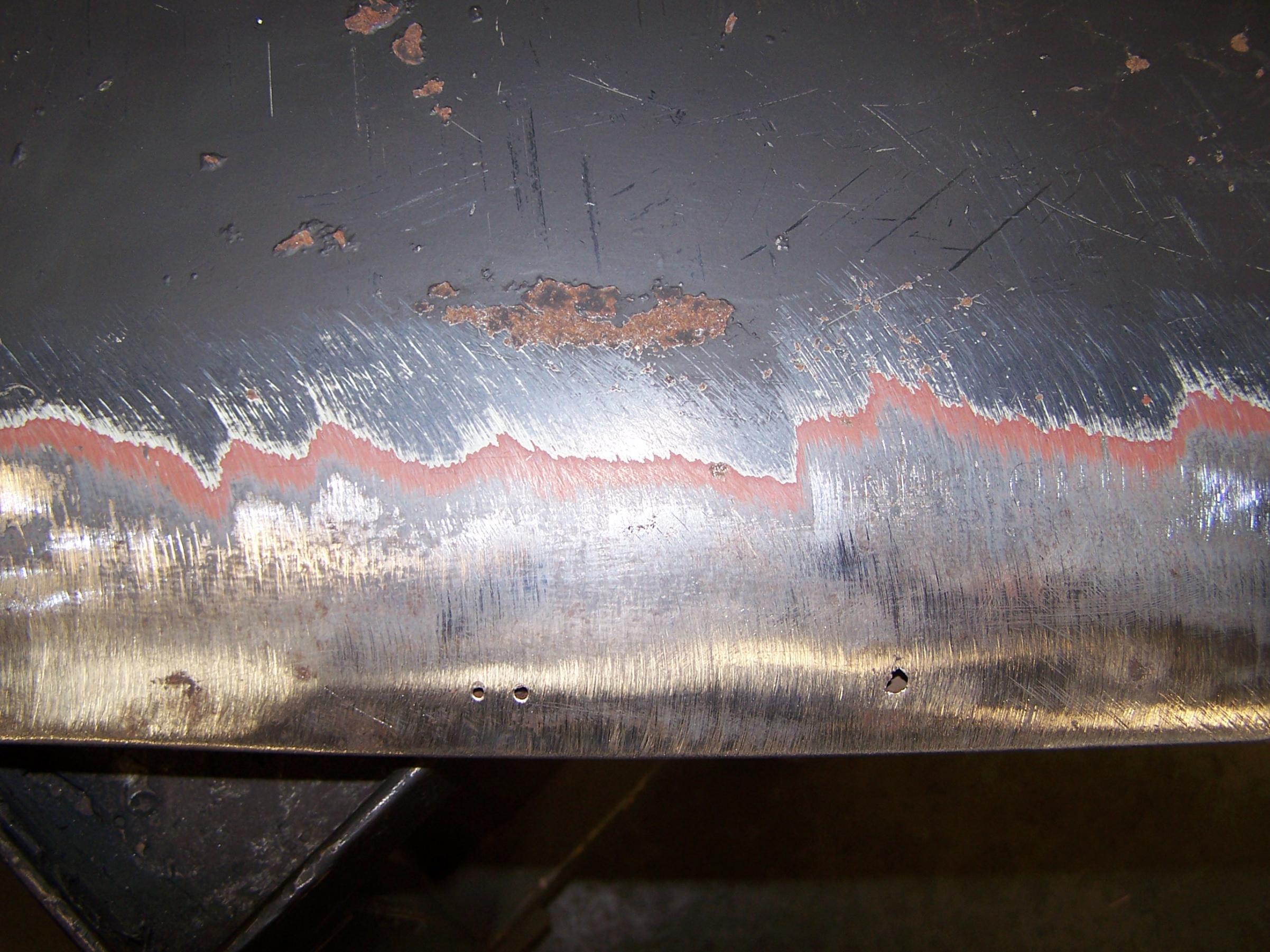

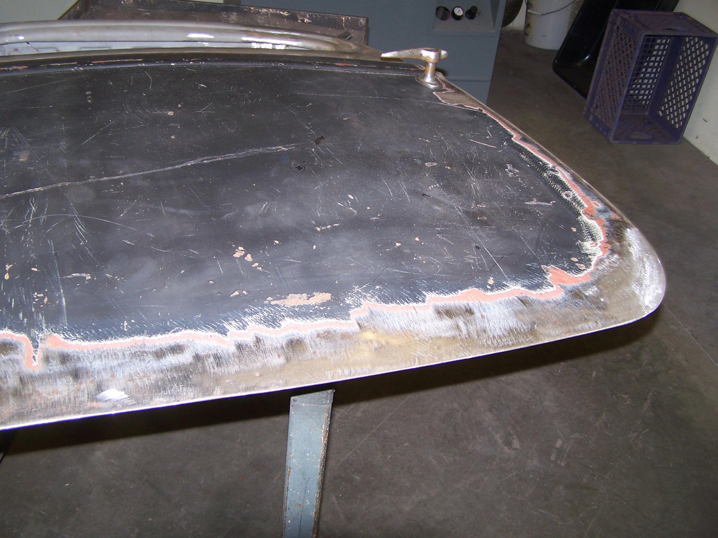

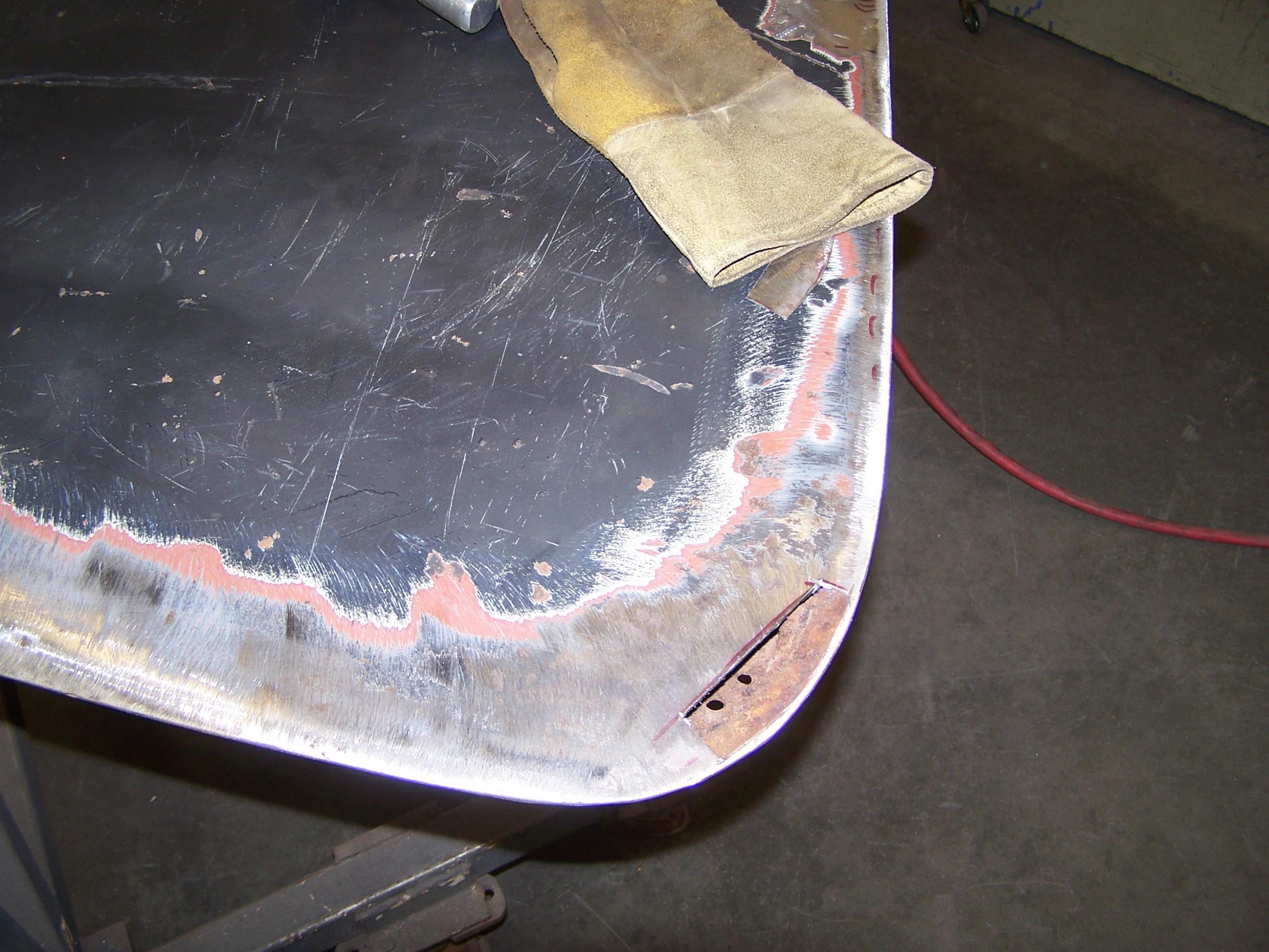

    A before, middle, and finish on some metal repair too the p***enger side door!

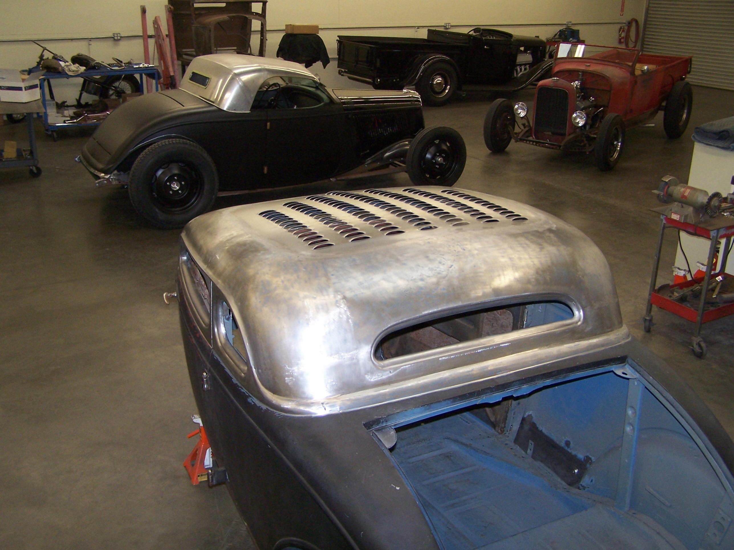

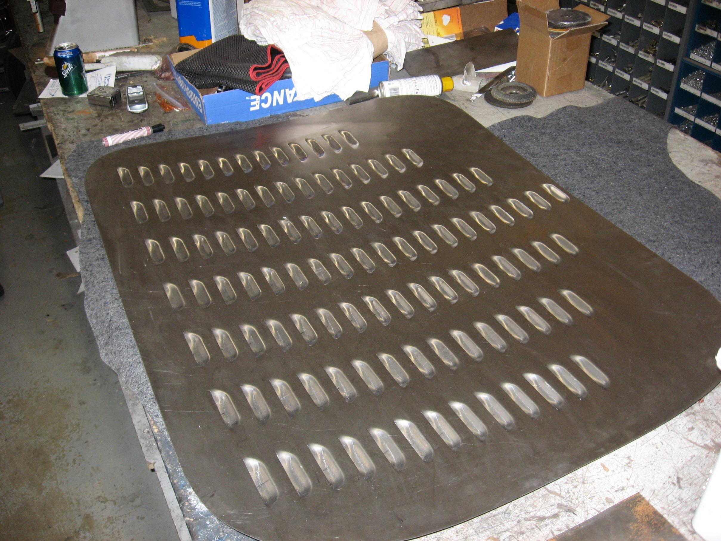

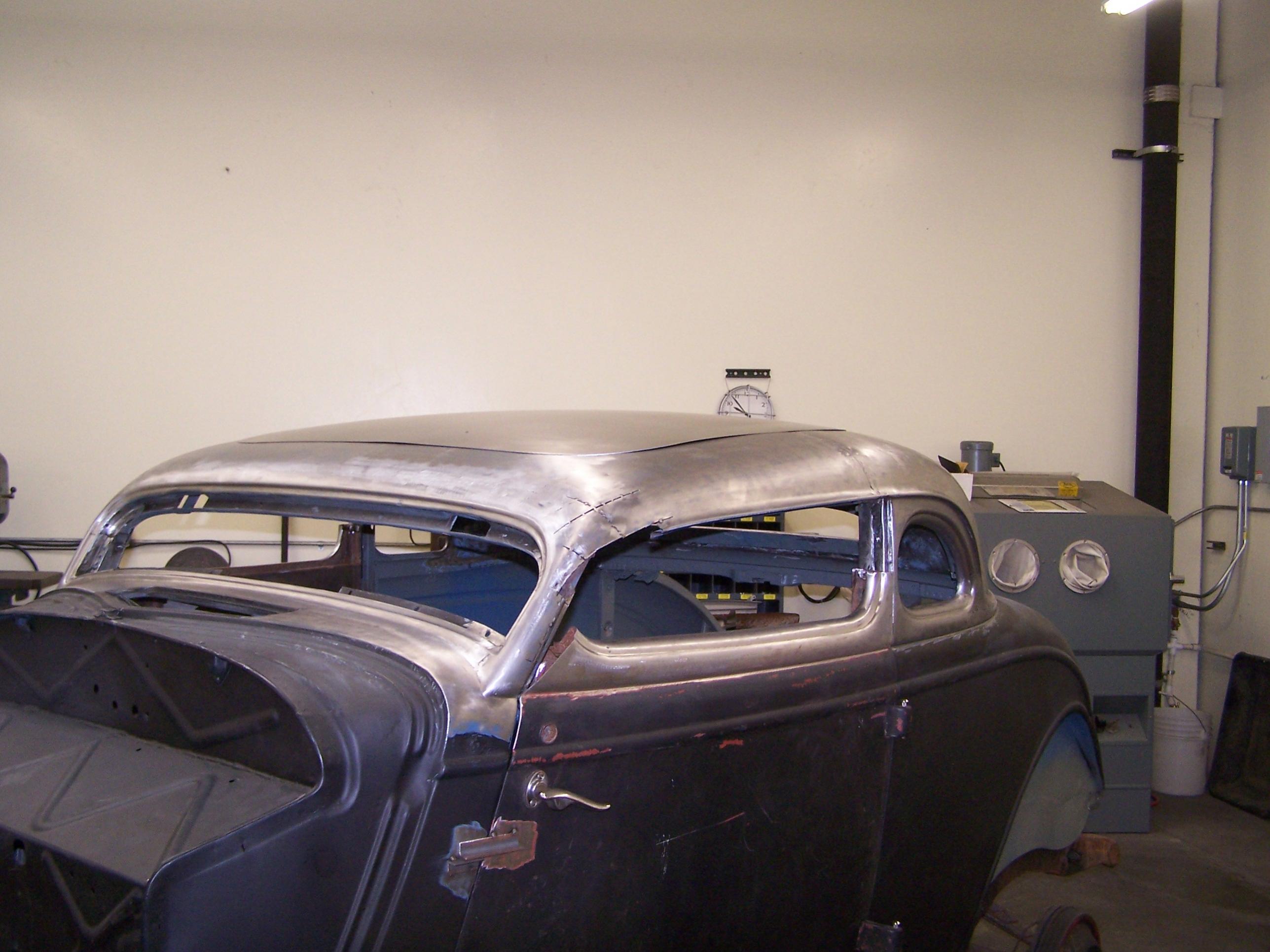

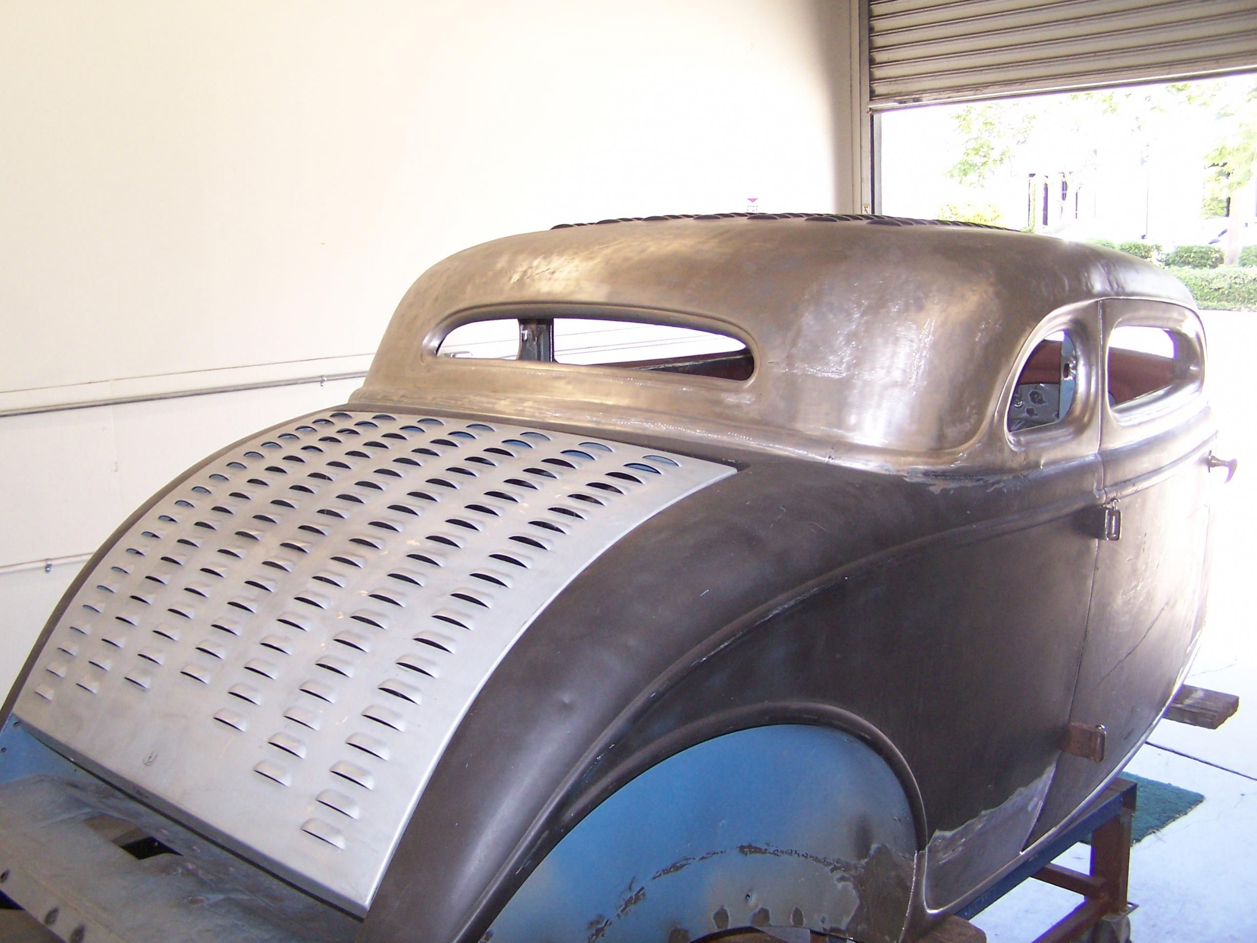

    I would highly recommend the Bobby Walden insert. They metal form, shape, hammer, and dolly these bad boys to perfection. This thing fit like a glove already before Rudy even touched it.
    We had both decided from the beginning of the build that we were gonna louver the insert then weld it in fixed!!!

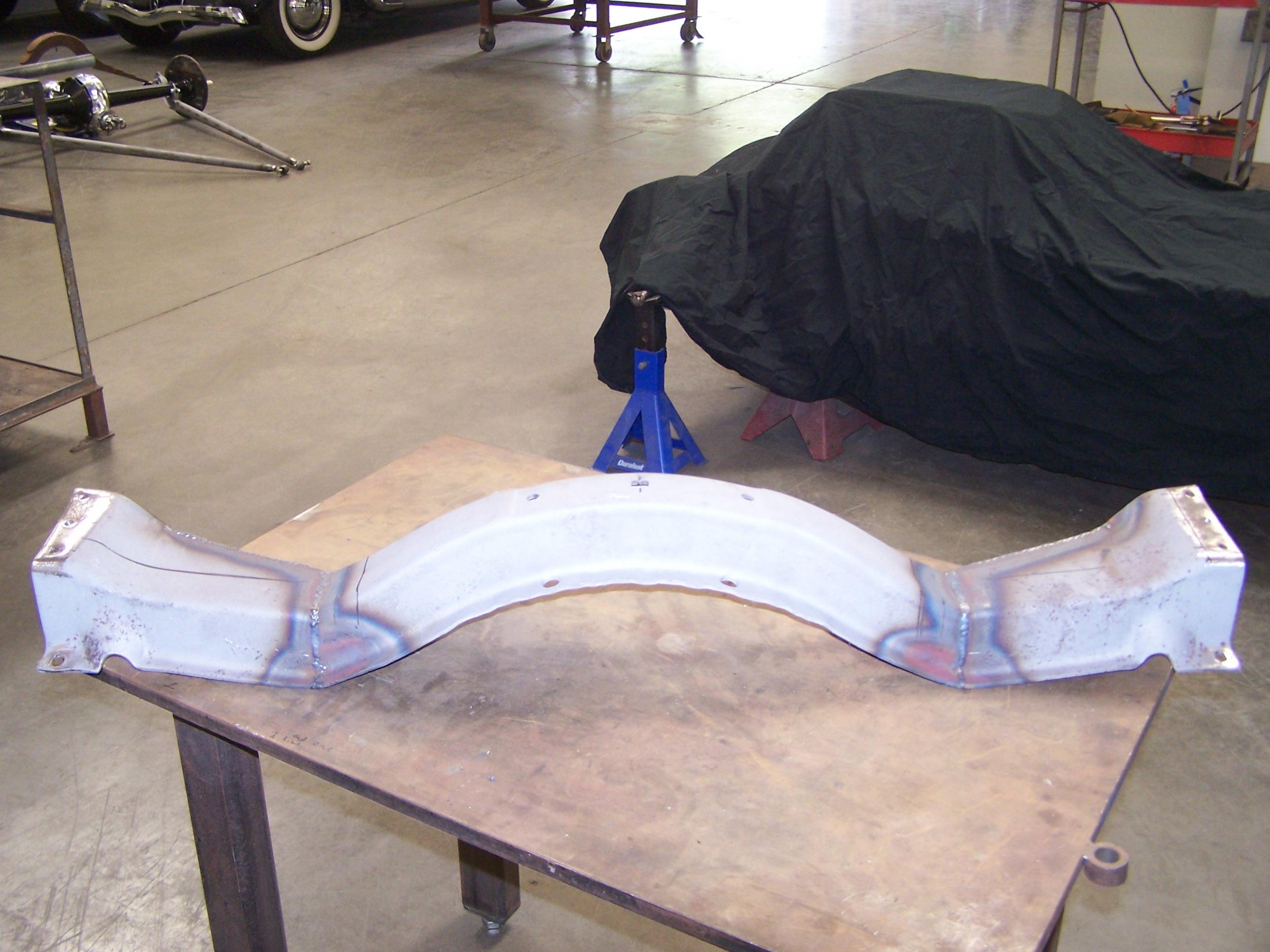

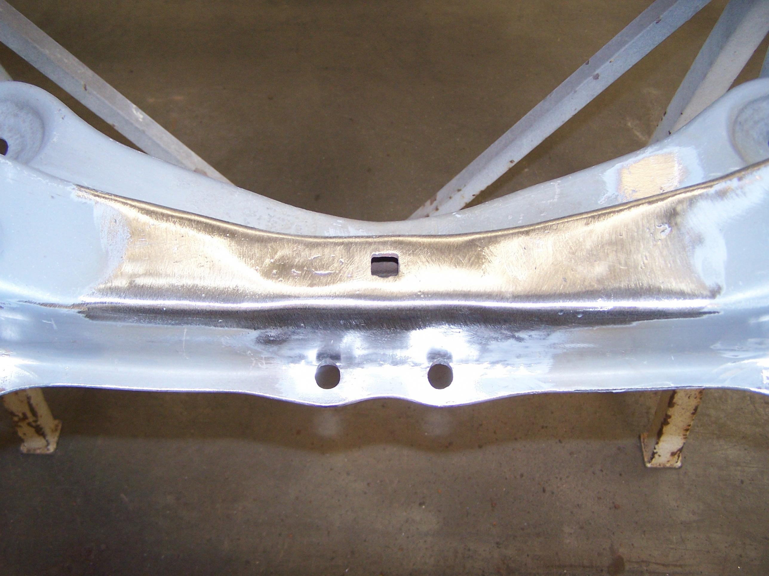

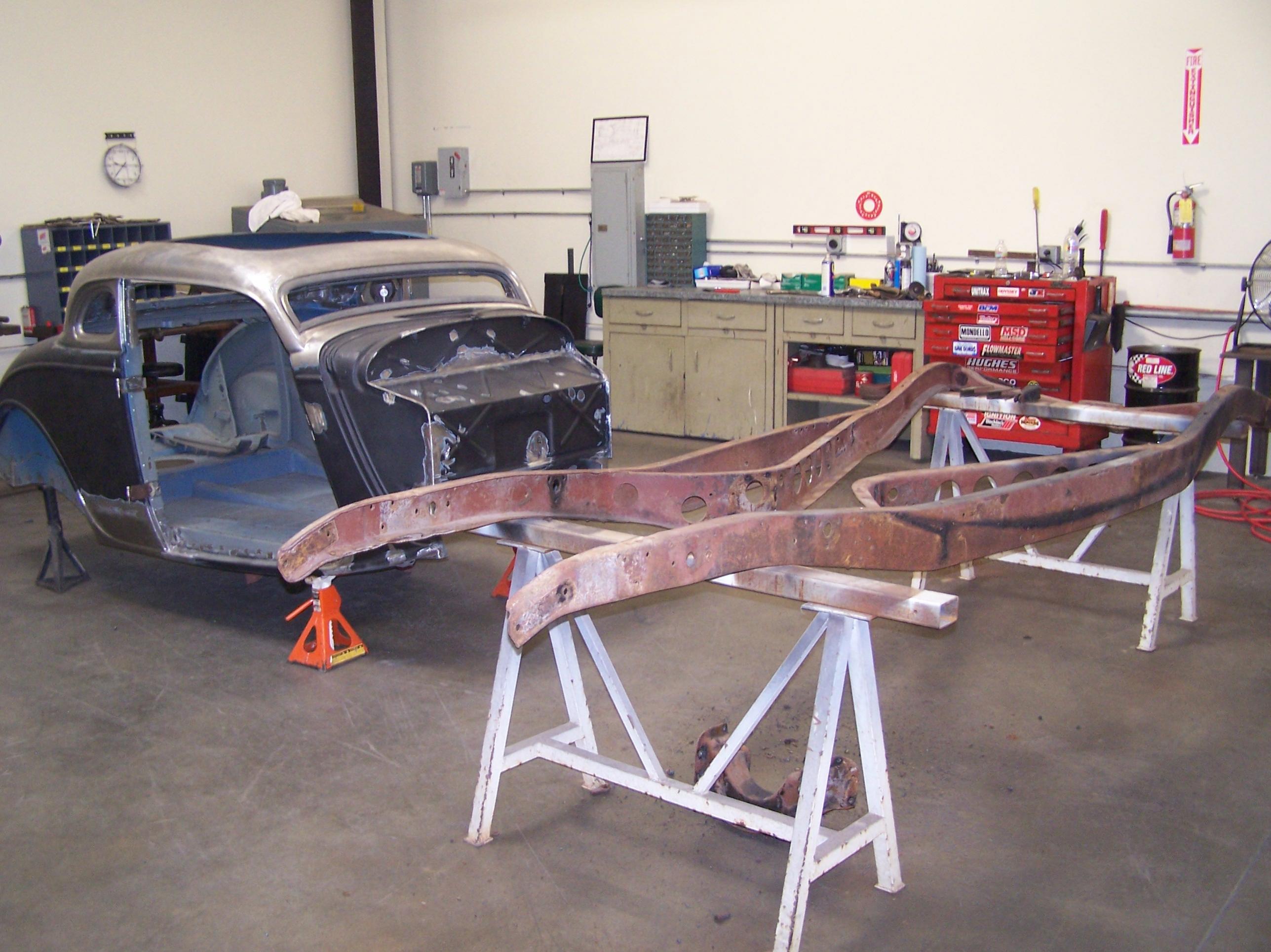

    Time for some ch***is fabrication!
    Took original matching #'s frame and stripped it down, cut out trans hanger then sand blasted!
    Took out front x-member and replaced with a better 33 that had almost no pitting, but had a typical crack in the center. Rudy then welded, filled, ground and worked the new member to look like new!

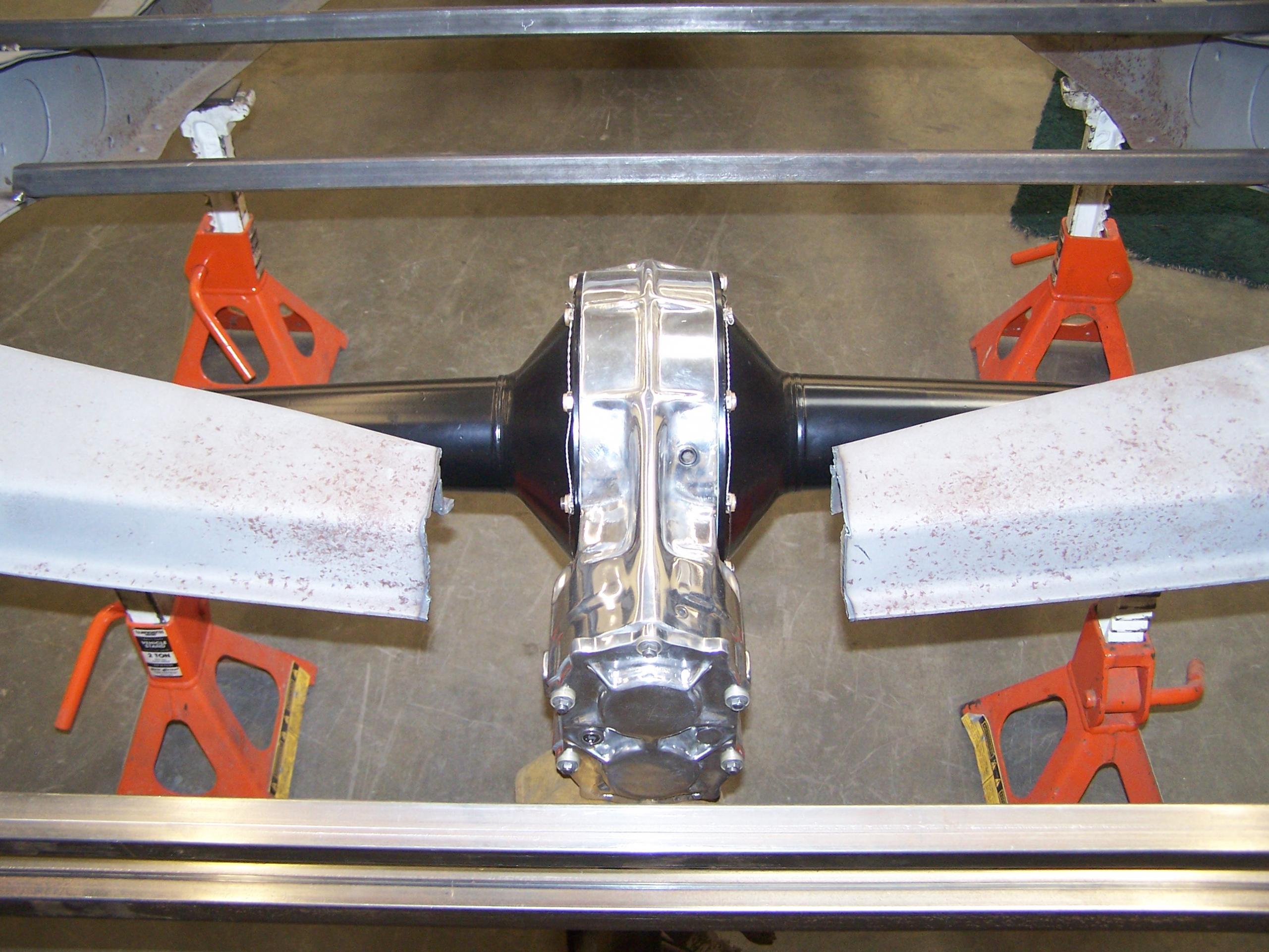

    Posts: 965
    D ROD
    from New Jersey
    Halibrand set in place for mock-up!
    Center of x-member removed. then Model A grafted into stock 33 member

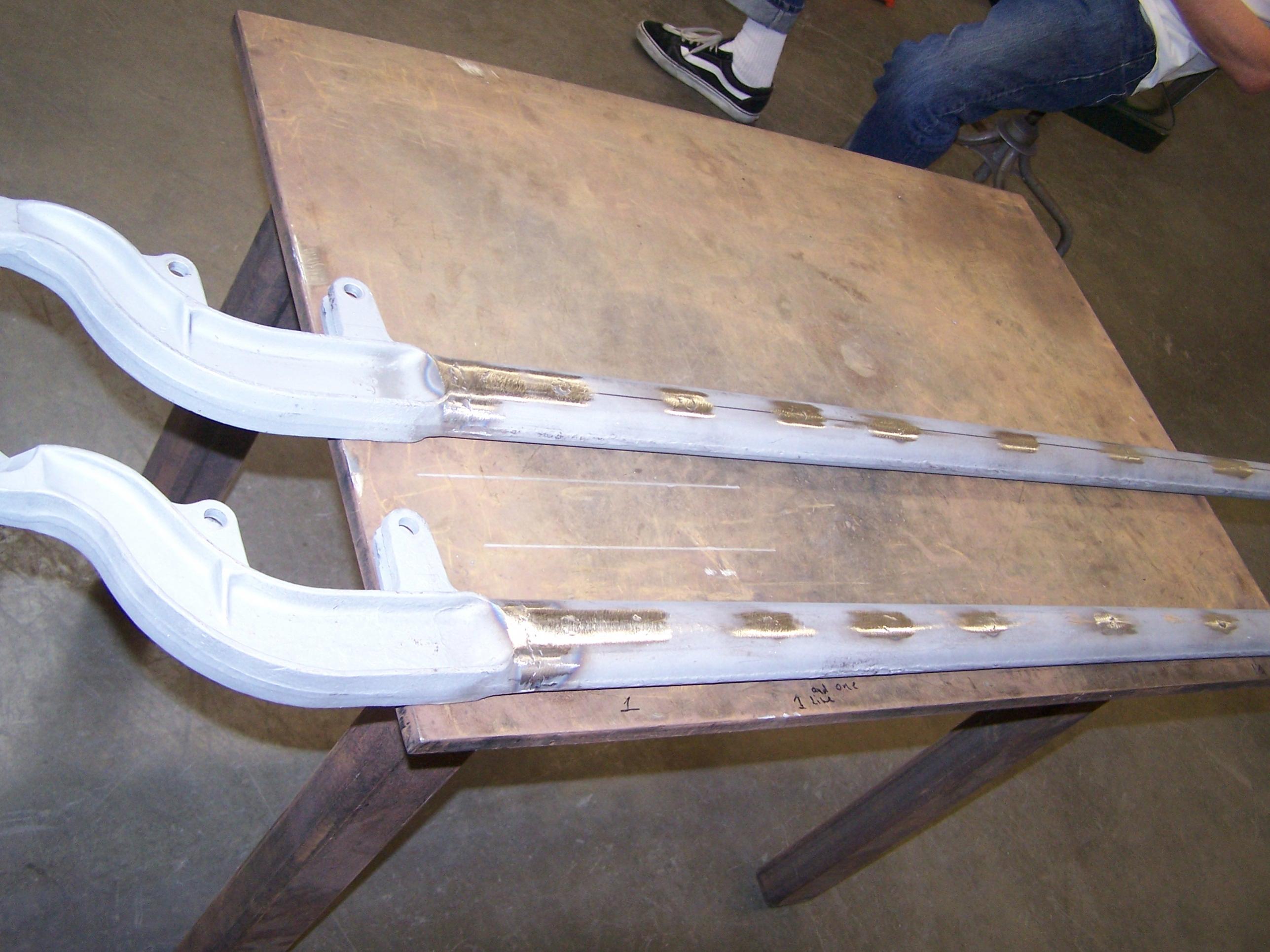

  26. D ROD
    Posts: 965
    D ROD
    from New Jersey

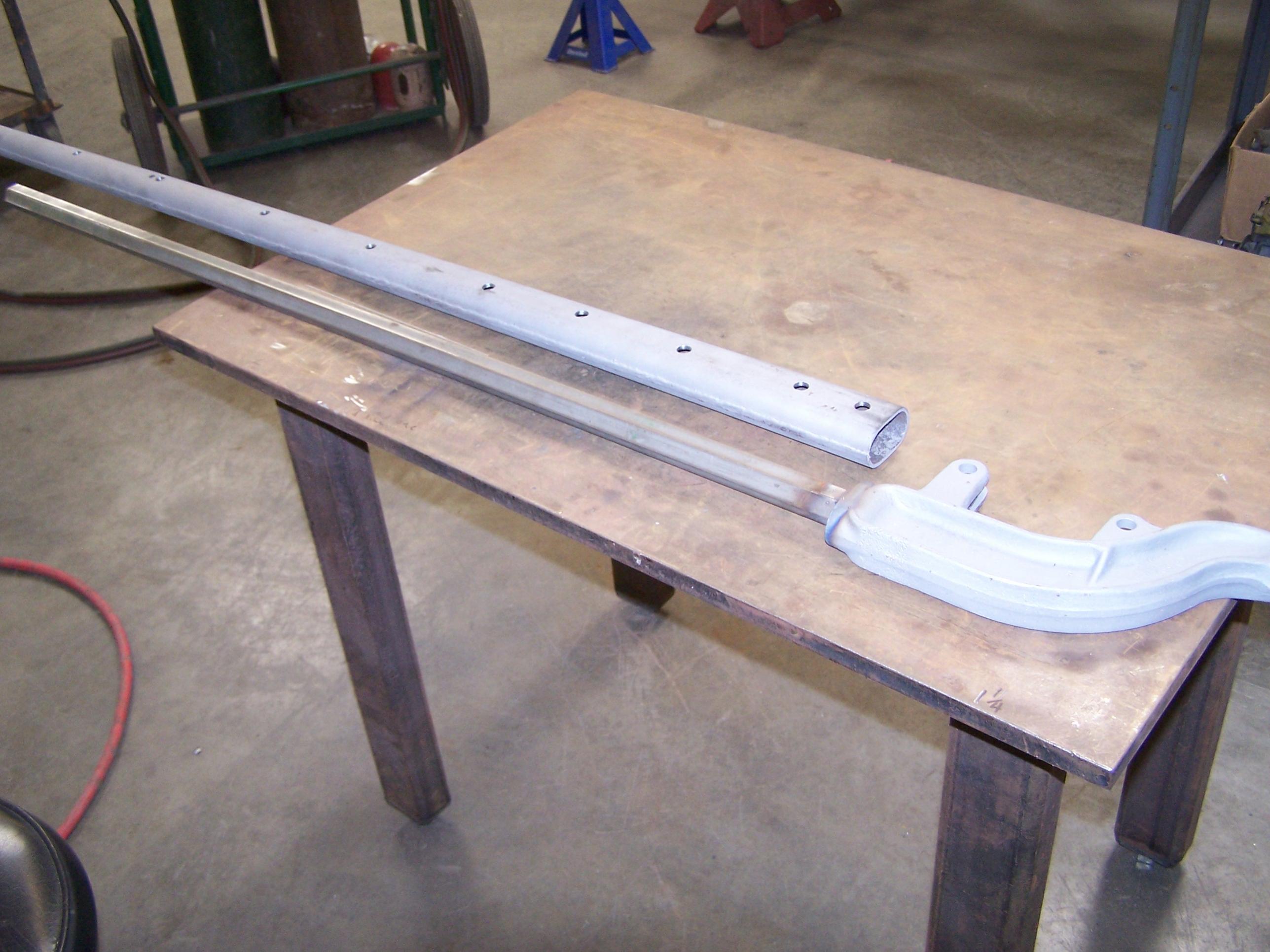

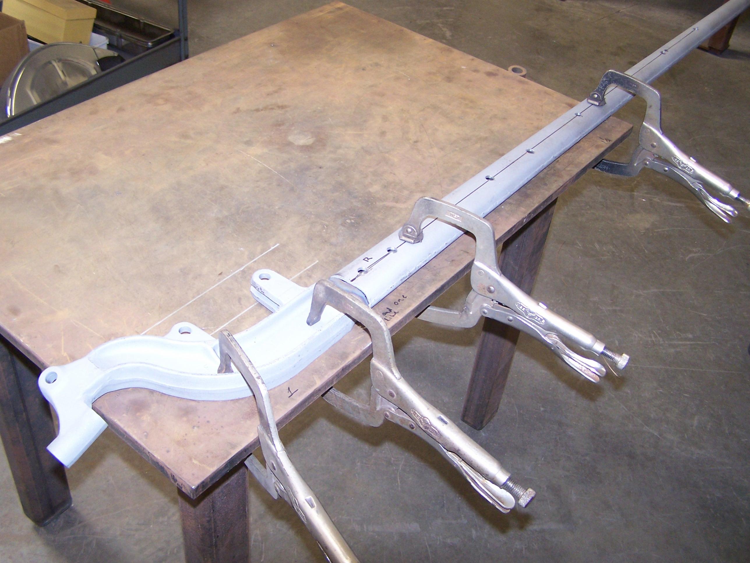

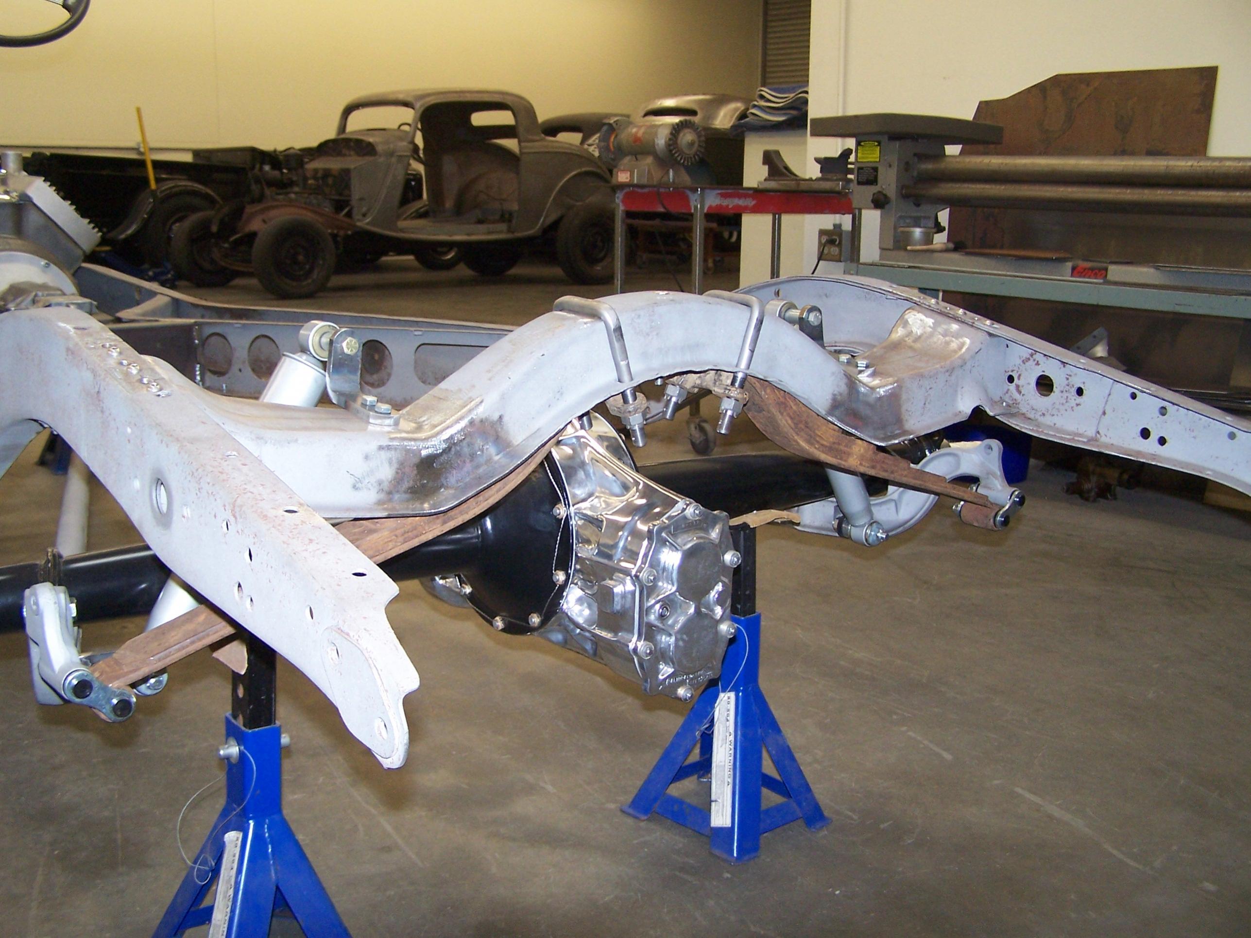

    We decided to use 36 rear radius rods, cut them open, then reinforce by welding a solid steel rod down the center. Then fill holes on outside of rods, grind and finish!

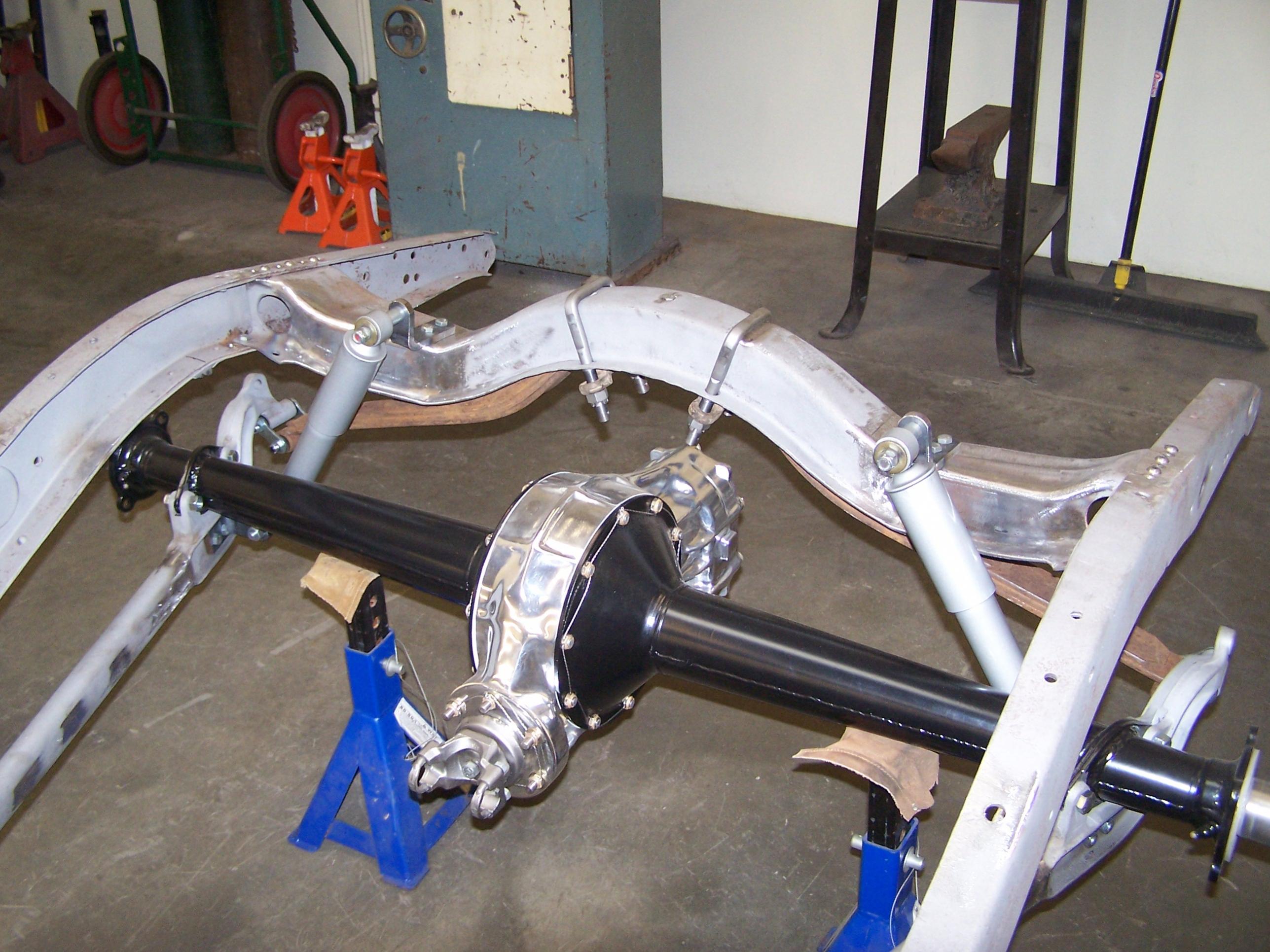

  27. D ROD
    Posts: 965
    D ROD
    from New Jersey

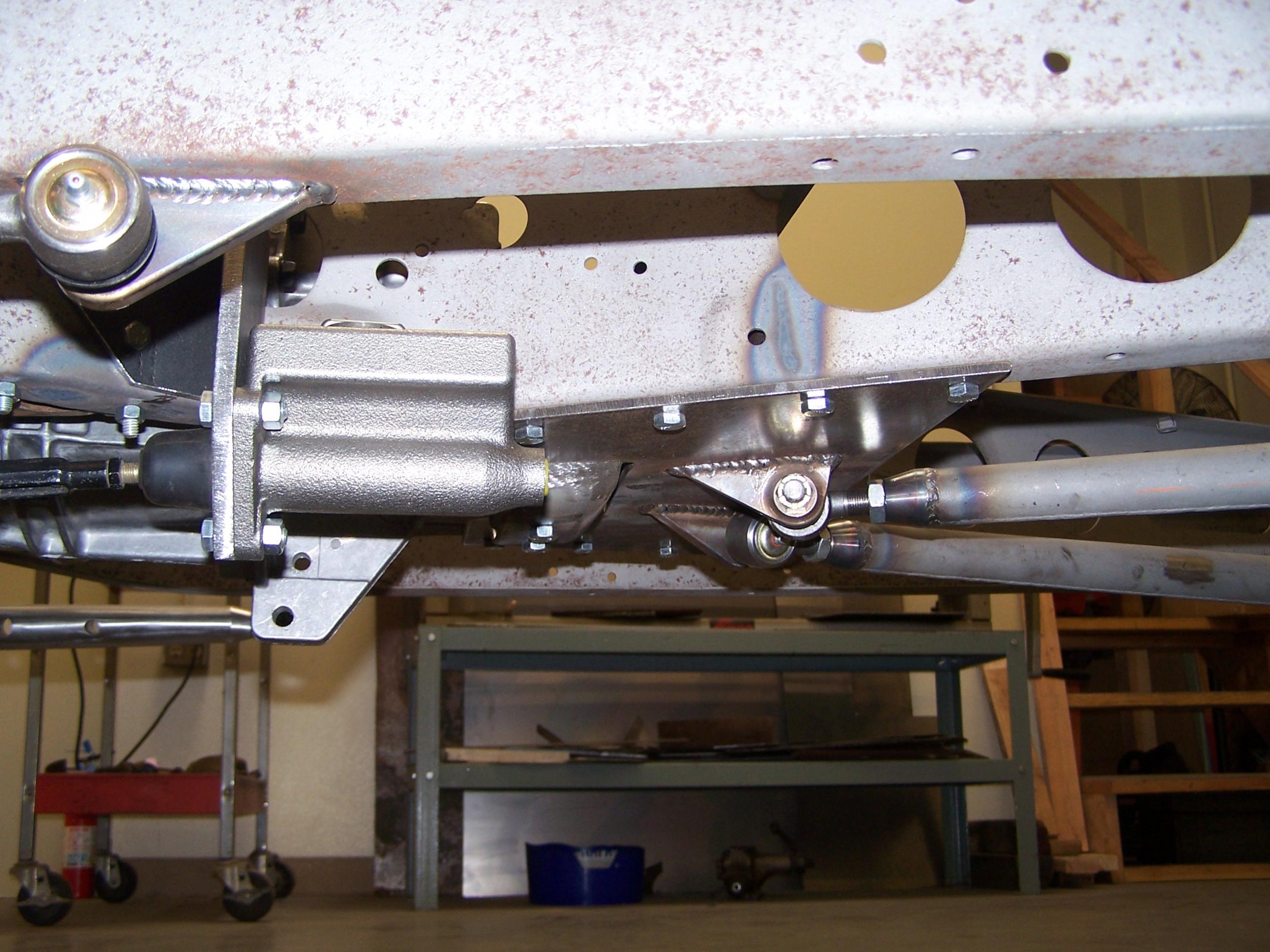

    Set rear, installed shocks, rods, and T spring
    ls1yj likes this.

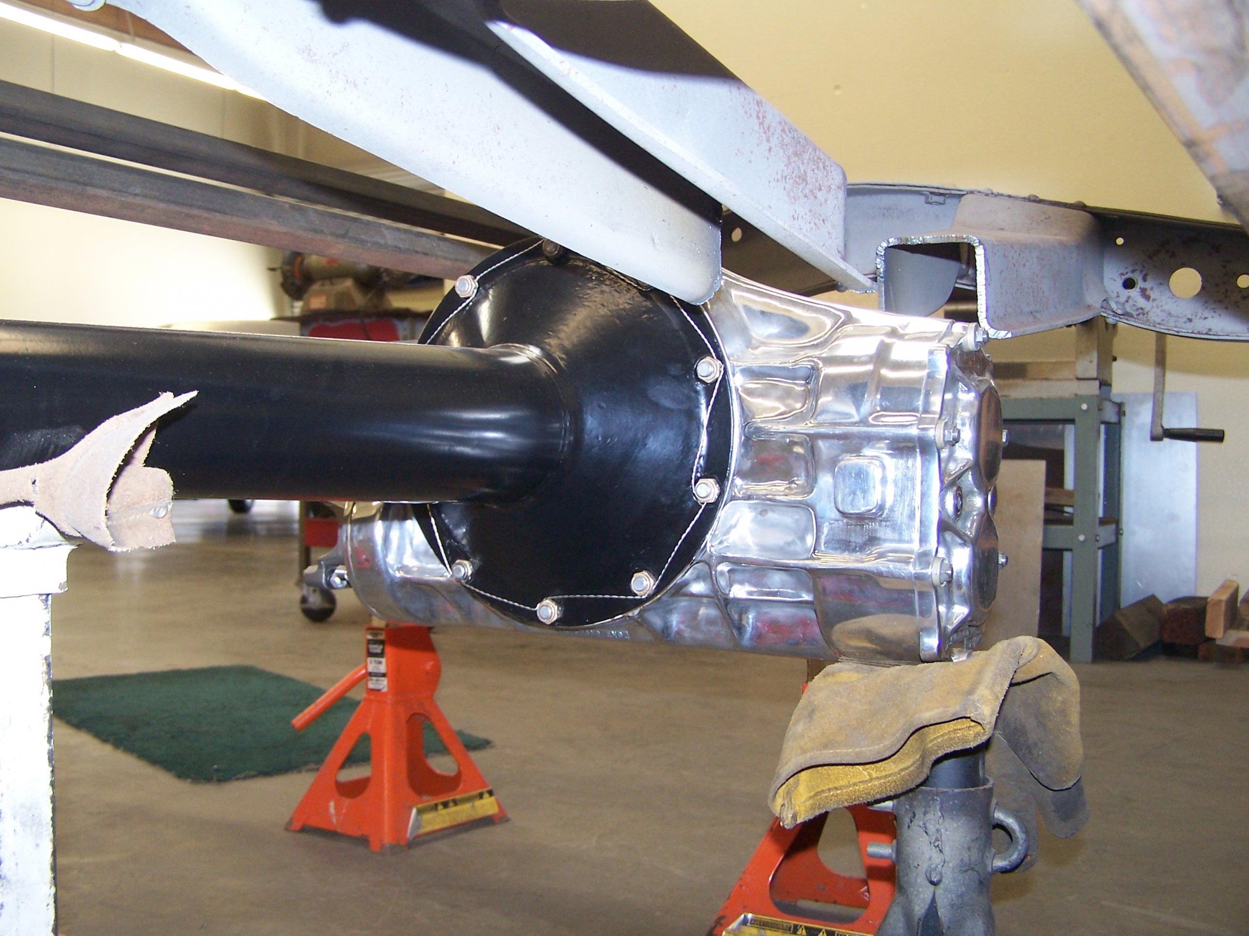

    This is the attatchment plate Rudy fabbed for the front of the rear Radius Rods!
