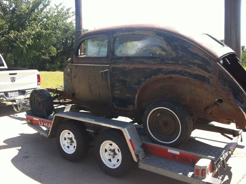

    Love it. Reminds me of my sedan, but mine was in much worse condition.
    If the flathead is junk the most economic thing to do would be to drop in a Chevy V8. It's a time honored and easy swap, that's what I did in my sedan.
    Before and After.

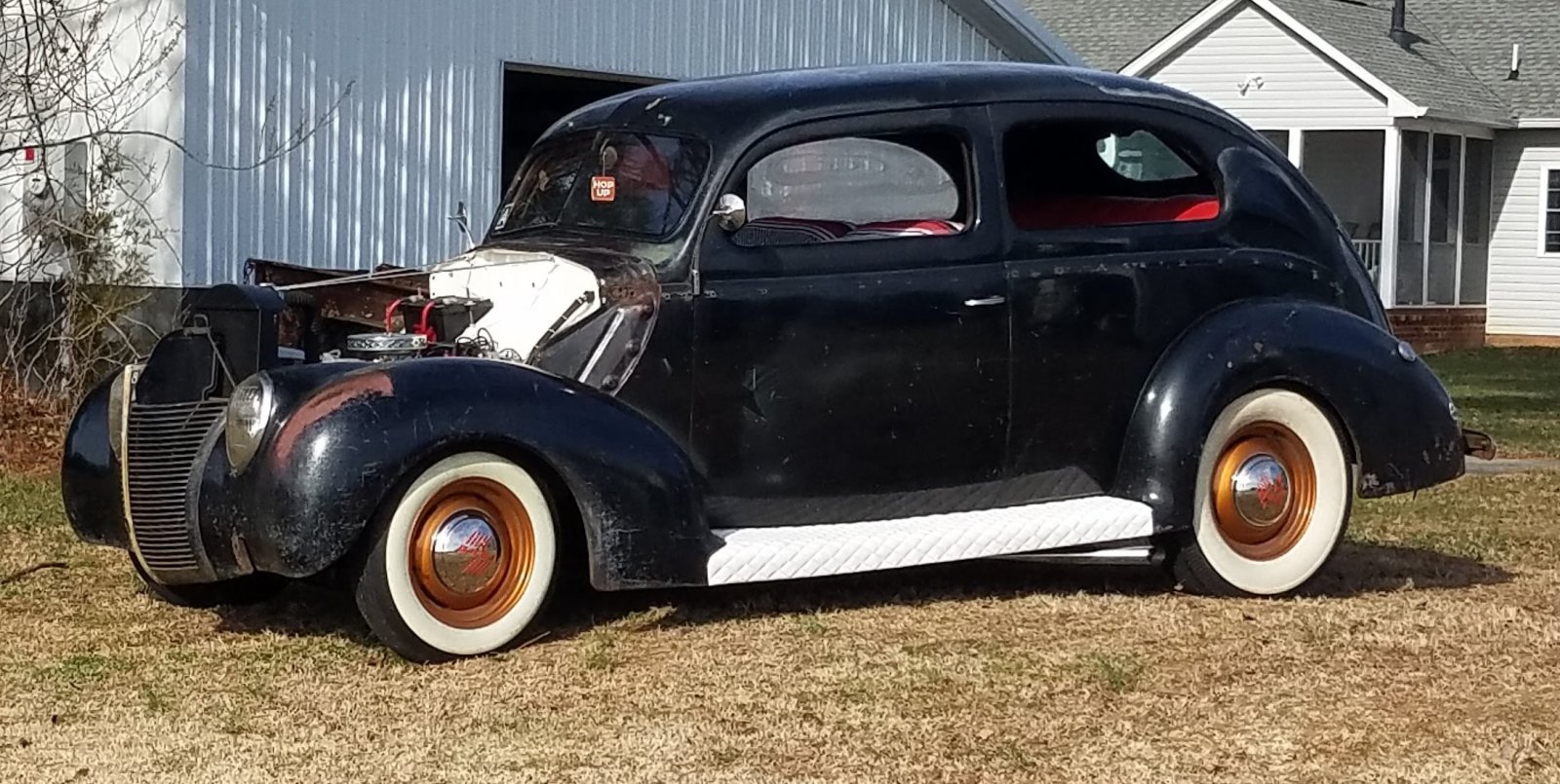

    Killer score!! that was what i was really hoping to find when I started hunting for a 39 or 40 but found my 39 standard in stead. A little touch up work on the paint on mine, but mine was not far off from what you have on your coupe. mine is about 80 % original pant just buffed up. Other than the paint mine was in almost exact same state, I did have to put floors and rockers in mine, but didn't think I needed too till I really got dug in to it. Hopefully yours doesn't.

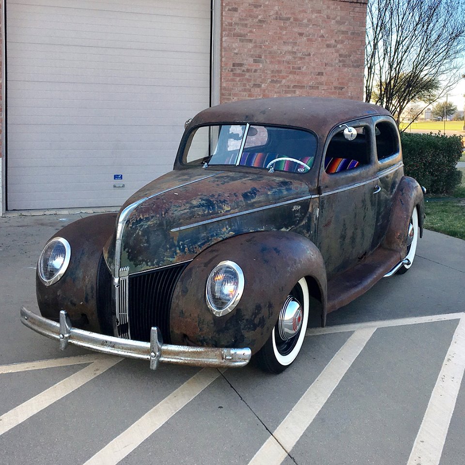

    Yep, this coupe reminded me a lot of your Tudor Dan. I thought of going to find some pics to post as inspiration here. But, you beat me to it. :D I still like your old Tudor and will always remember riding in it for a Texas Hot Rod Hundred. :cool:
    Outback, chryslerfan55 and Dan Hay like this.

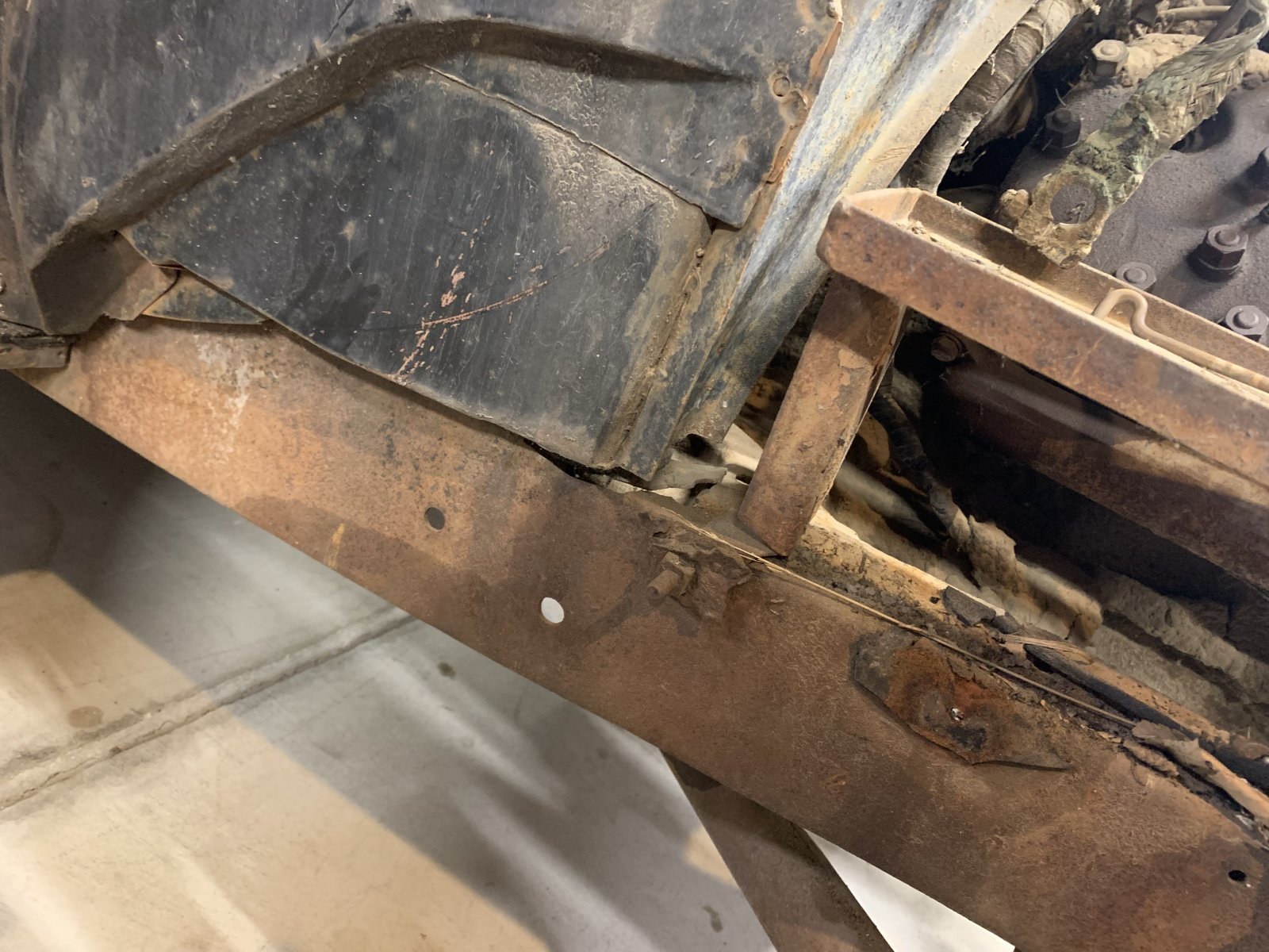

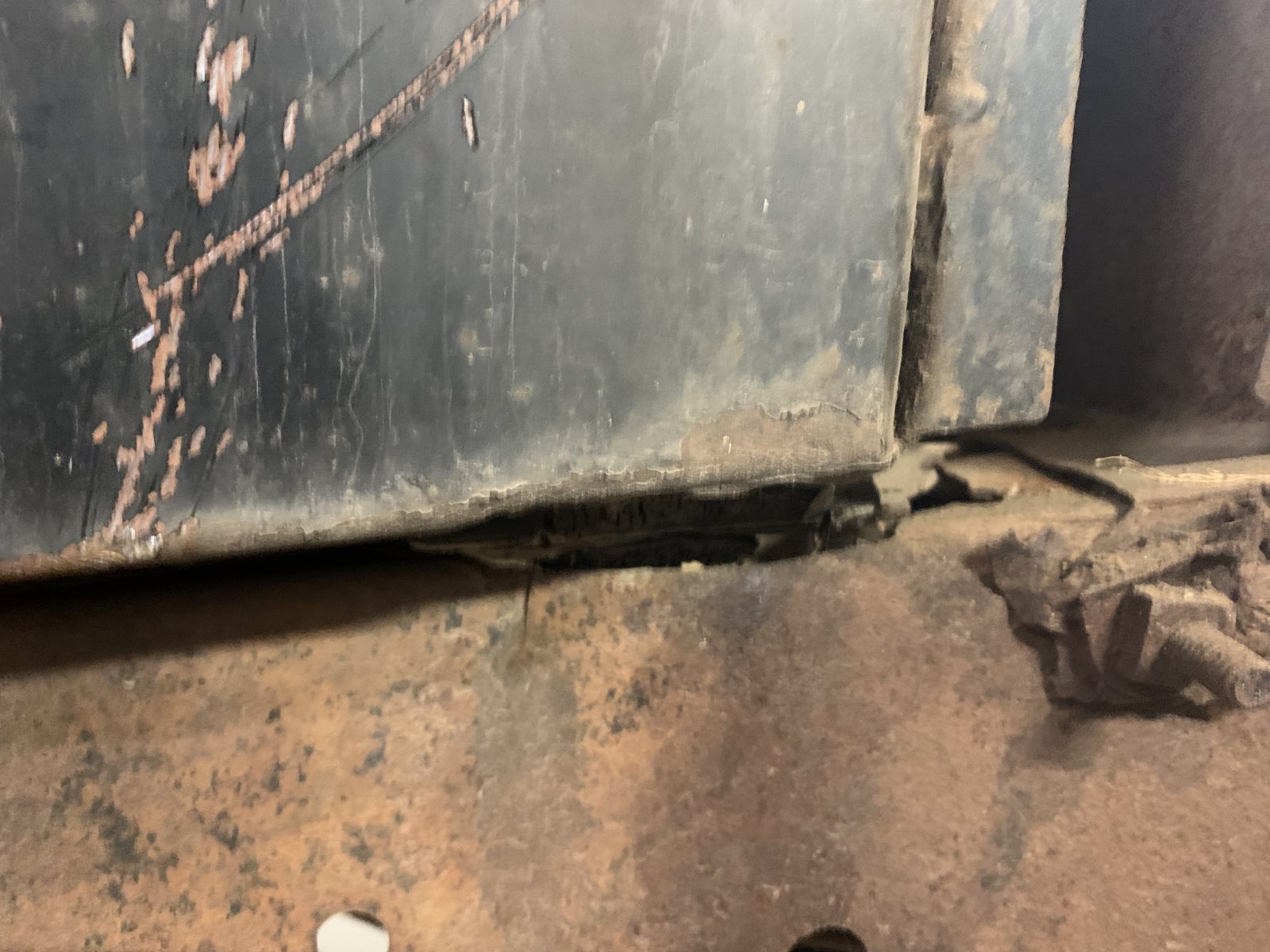

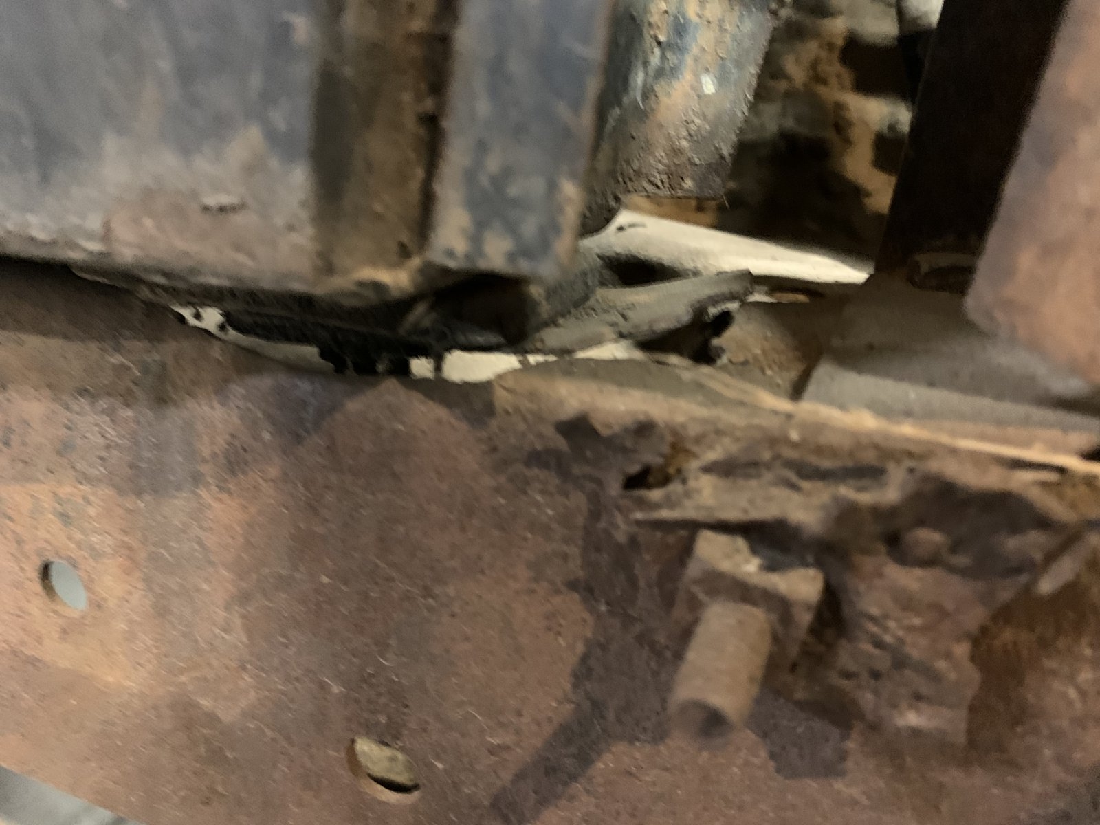

    834B4824-72D1-4DB9-86AD-B562008AE6C7.jpeg Man, the more I work on this car the less I want to get crazy with it. How low can I go with stock suspension? I like low cars but I’m kind of falling for the interesting stock suspension parts.
    I got the front end off. Every single bolt was a fight. Had to cut 6-7 of them off. That should be a fun problem to deal with later. I’m kind of annoyed that every nut/bolt is just that, a nut and a bolt requiring two tools to remove, versus having bolts that screw into welded (is the term captive?) nuts. When I go to re***emble I’ll probably weld nuts into place. I’m not sure this car has ever been apart. Not a single missing washer etc. still pumped.
    Working to pull the engine. I had a glimmer of hope when I got the front end off and finally got a socket around the 1 1/8” crank bolt and things started to turn…turns out I was just tightening the crank bolt. Motor still stuck. Engine coming out next!
    also, looks like where the front of body mount meets the frame has ripped a hole in the frame. Another piece that tells me I probably need to pull the body from the frame to fix stuff.
    7EA2127A-746A-49AE-8E5E-BFFA05F04B89.jpeg 0369E3CB-1D05-4C4E-AE60-AD58EB84FD7F.jpeg

  28. I had to repair that same area on a 40 ch***is I built for a fellow a while back. Wasn't ripped, but thin from **** trapped in that spot. And, a dropped axle will get you down where you want.

    A 1940 Coupe does not need to be lowered to be a hot rod. Just repair what you have right now because you have a lot, I mean a a lot to do. It's more than you know. It's easy to get enticed by such things as dropped axles and fancy speed parts. You can always do that later.
    In my profile pic is Jed's 40 Coupe from the 1958 Movie "Thunder Road". That car is not lowered but it's a cool *** car. It's worth watching "Thunder Road" on YouTube just to see those few shots of Jed's 40.
    Don't do that. Welding the nuts is a waste of time. If that car had captive nuts, you would still be working on it because they break. It's a pain in the ****. Learning this make me love a '40 even more.
    The main reason not to weld in nuts is ease and alignment. Each through nut and bolt has a little adjustment. If you weld nuts, the alignment may get off. It's just counter intuitive.
    Not so fast....
    See below.
    Mission Creep Alert!!!
    OK....
    Here's where things can get a little dicey. You have found structural damage. It's not "bad" but....
    Truthfully you could probably ignore it and be fine but it bothers me. In my opinion all structural damage has to be repaired. Sheet metal and even some holes in the floor is one thing but structure around body mounts...that's something different.
    In my opinion this needs to be fixed and fixed correctly which means, lifting the body.
    This is a "cross roads" for you.
    You have to decide what you want to do.
    As far as working space, this project could easily have the footprint of 3-4 cars.
    If you pull the body, where is it going to go?
    Since the engine is stuck, the engine and transmission is going to have to come out as a unit. Where is that going to go?
    Body...front clip...engine transmission....ch***is....You can see how it can easily have the footprint of 4 cars.
    You have to decide what to do.
    You can go ahead and pull the engine and transmission and save the ch***is and body for later.
    You can pull the body and leave the engine and transmission in place for now. The ch***is can act as a "engine stand" with the body off thus saving some space for a time..
    As you can see this is a major crossroads. This could easily go from "Getting it running to...frame off.....
    What I would do....
    I would make the space indoors. Nothing stays outside.
    I would realize that this has gone from a quick and dirty rehabilitation to a sure-enough restoration.
    I would pull the body and start with the ch***is.
    How to pull the body, how to roll it it around, how to roll the ch***is out from under it...that's up to you.
    I would get it down to the ch***is. I would repair (cracks weak places, replacement of areas) the ch***is.
    I might elect to leave the engine of the ch***is for now...simply for space and it can be worked on a little on the ch***is.
    Body off actually makes things easier like brake lines, brakes, suspension. You can really do a nice job on the ch***is with the body off.
    Take photos.....
    Save stuff, even broken stuff.
    Save that old wiring. All those factory connectors are like gold and they can be repaired and re-used in a new harness, especially if you elect to build a harness.
    Good Luck and have fun.
    p.s.
    Flathead v8s can lock up in two places....
    1. of course the cylinders and rings.
    2. the valve train will lock up a flathead.
    If it's "locked up" in the valve train, you can remove the cam gear and the crank may can be turned.
    Also, it could be locked up at both places.
