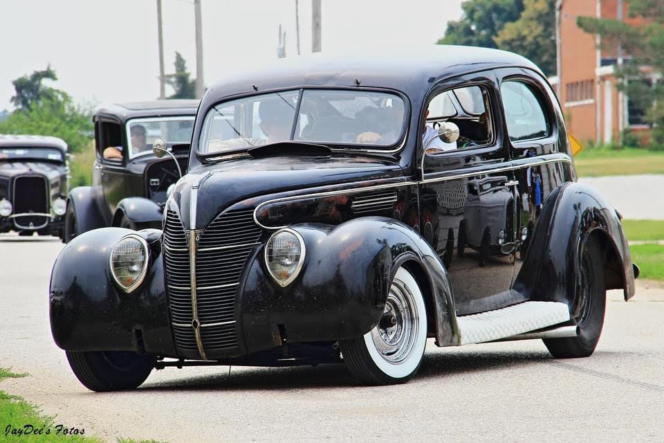

    22008282_10105706405379767_2966726725032093772_n_10105706405379767.jpg IMG_3161.jpg
    If you want to nail the stance in the front, here's "the secret sauce" this is what was under the sedan I built.
    47" king pin to king pin dropped axle. it's about 1.5" narrower than stock, tucks the wheels inside the fenders. I got mine from Chassis Engineering but they don't make them anymore, but several companies still make this axle.
    Corresponding narrowed spring from Posies. I believe it's the spring for the 35" perch width.
    Split the wishbones, as it's necessary for a narrowed axle.
    I ran 500/525 16 firestones but in retrospect they were too small. I'd go with 550s.
    Front Pete and Jakes Sway bar.
    Also, F100 or Lincoln brakes on the front are a nice upgrade.
    Do all that and it'll sit low and drive well.

    Dan hay. Thank you! That is the kind of info I need. Including tire specs Too. Thank you! Car looks awesome.

    I forgot one detail. You'll need to heat up and bend the spring perches on the wishbones if you go with the narrowed axle and spring. Kinda hard to explain, but as you narrow the triangle that is the wishbone, the perches will not longer be parallel with the spring eyes. You heat them up to cherry red and straighten them out. I can give more detail if you go that route.

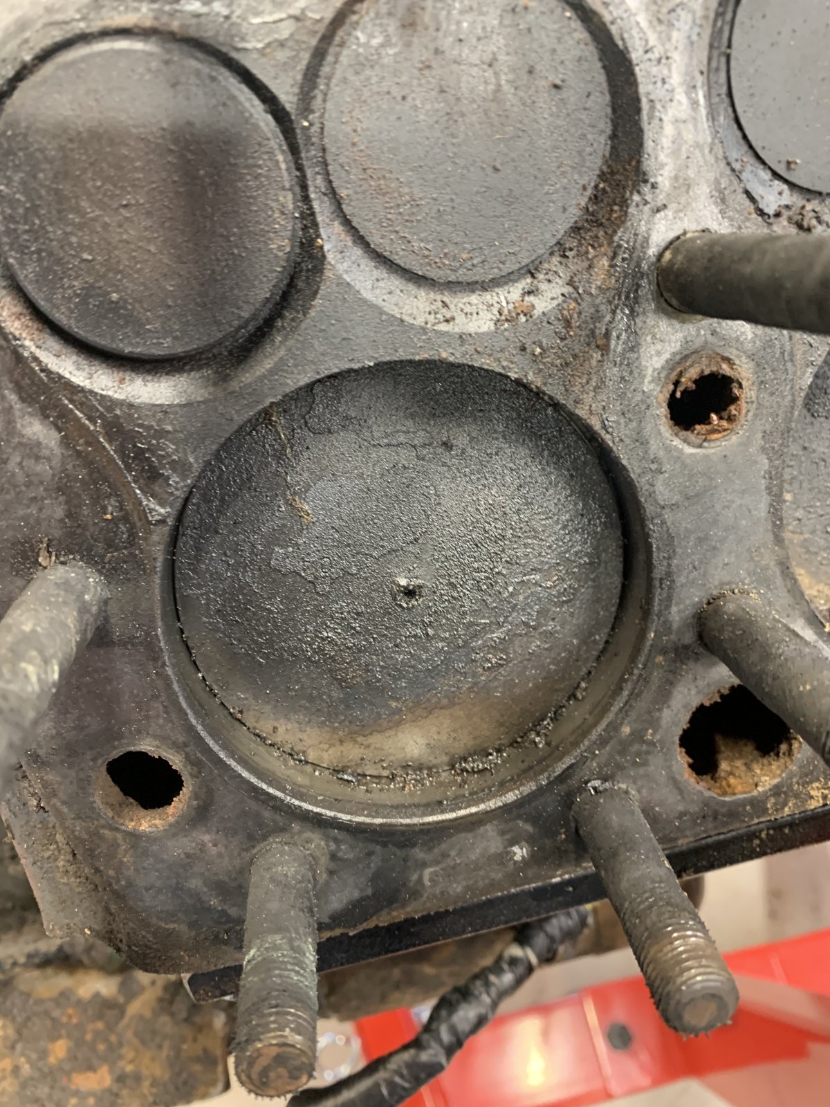

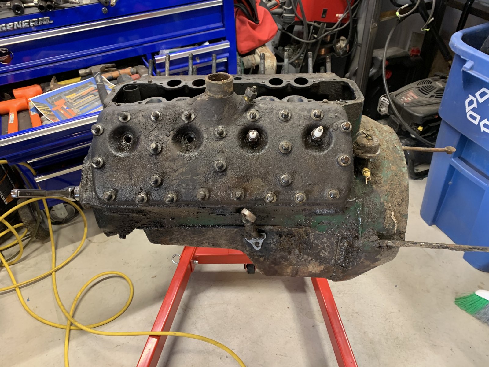

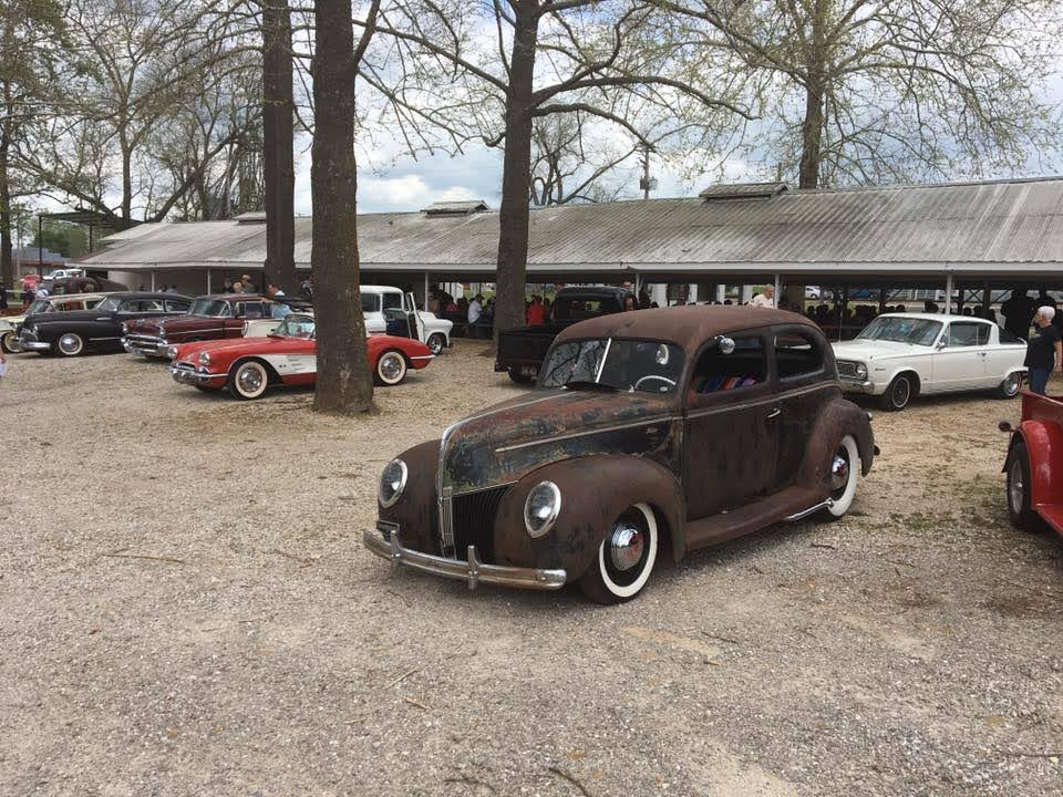

    Making progress. Got the engine out and partially disassembled. Having a hard time with the one head. Anyone have suggestions? Also, does the front pulley need to come off (how???) to get the timing cover off?
    it’s pretty sludgy on the top end. I’ll probably get to pulling the pan off later today or tomorrow.
    do any of these photos provide clues as to what I have? It has domed pistons. Is that normal?
    my daughters been home sick all week and she’s feeling better so she helped me out too.

    If you can't get the head off by tapping it pretty hard horizontally around the edges some have had good luck with removing spark plugs and feeding in rope into the cylinders and rotating crank with a breaker bar. The rope squishes up and pushes it off from the inside.

    Yeah I saw the rope trick last night on tv. But my issue is this motor will not turn over.

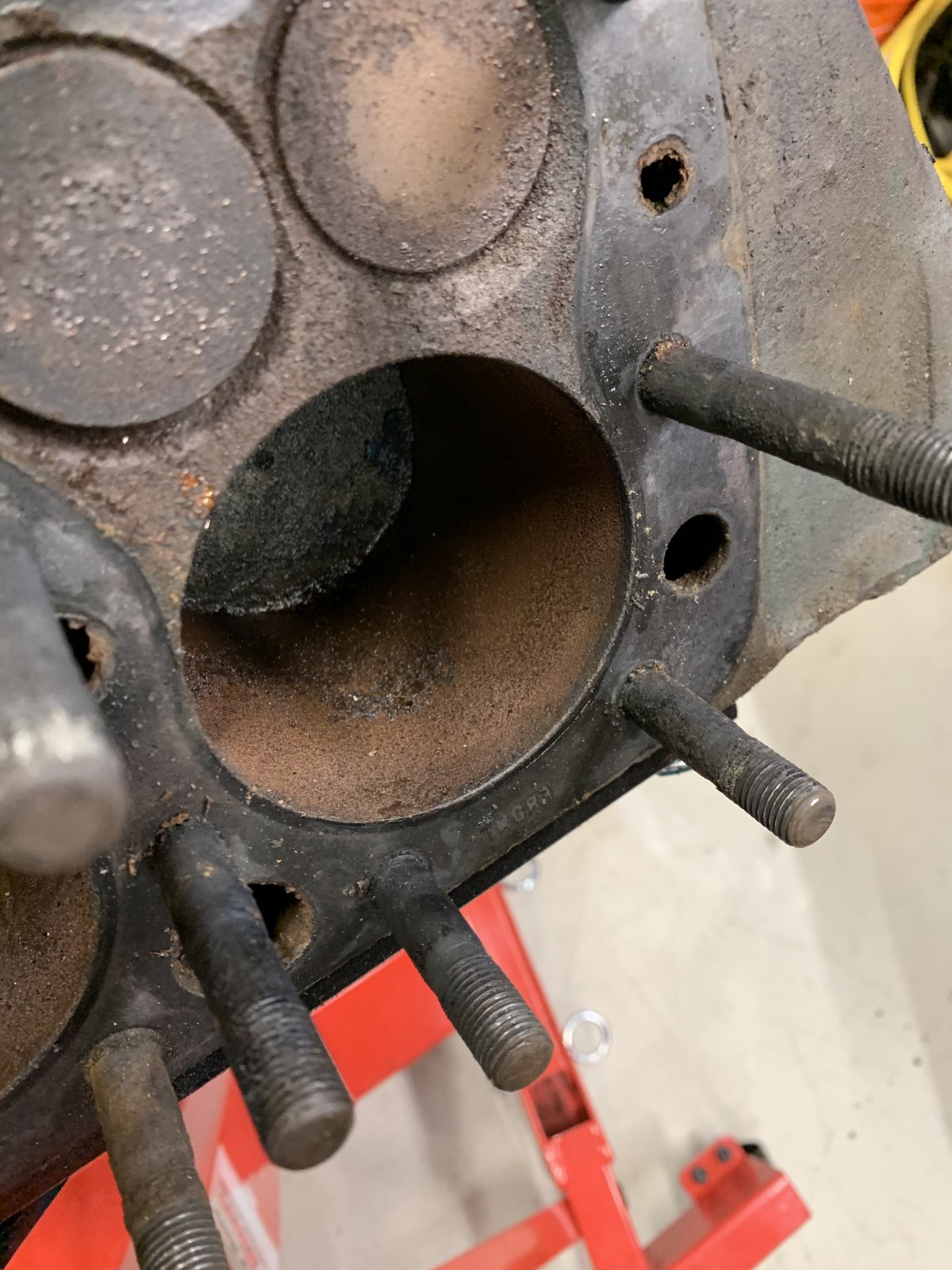

    Oil pan off. Pretty sludgy. Still won’t turn over and no obvious signs of failure. From what I can see the cam looks fine. 2 of the 4 cylinders that I can see so far definitely have rust in them. Absolutely zero ridge at the top of the cylinder wall though.

    Stock, unbored, 40 engine. You will find it has tin sleeves from the factory. See the small ridge where it folds over at the top of the cylinder. There used to be a replacement piston size made to fit right in after a guy removed the tin sleeve and honed the block.

    Original 1940 85 hp engine, note the small welsh plugs in the pan rails. I'd start pulling rod caps until you can get it to turn over; at least that will let you determine which cylinder/cylinders are stuck.
  20. It could be stuck in the cam/lifter area as well, with the gears still meshed.

    I always wanted to make an adapter that had a grease fitting in it that would screw into the plug hole to be able use a grease gun and hydraulic the head loose. That would only work if the valves were already closed or if you cut the valve sprngs off and were able to pull the valve closed on the cylinder you were pumping grease into.

    That’s a great idea. In theory even if the valves were open eventually the grease would fill the piston cylinder too eventually forcing the head off…maybe. I have an idea I’m going to try tonight which involves a slide hammer and a hollowed out spark plug. We’ll see. I’ll take photos!

    Even if you can get it apart and things look OK, you really need to inspect the block for cracks.

    Yep, I plan to tear it down completely and have it cleaned and inspected by a machine shop before I decide my next move.

  25. I hope I'm not too late, but go easy with the slide hammer. The spark plug area of the head CAN be busted if you go gorilla on it. It would be best to give it a couple of whacks and move to the next hole. Do all four and repeat. First step is to soak the hell out of the studs before you get physical. If it moves at all, keep the penetrant flowing!

    If alchemy is correct (I have no reason to think he is not), those tin sleeves are about .041 in. thick. If you remove them, you have a roughly .080 over bore which means you could possibly use 239 +.020 or +.030 pistons . Disassemble carefully and good luck.

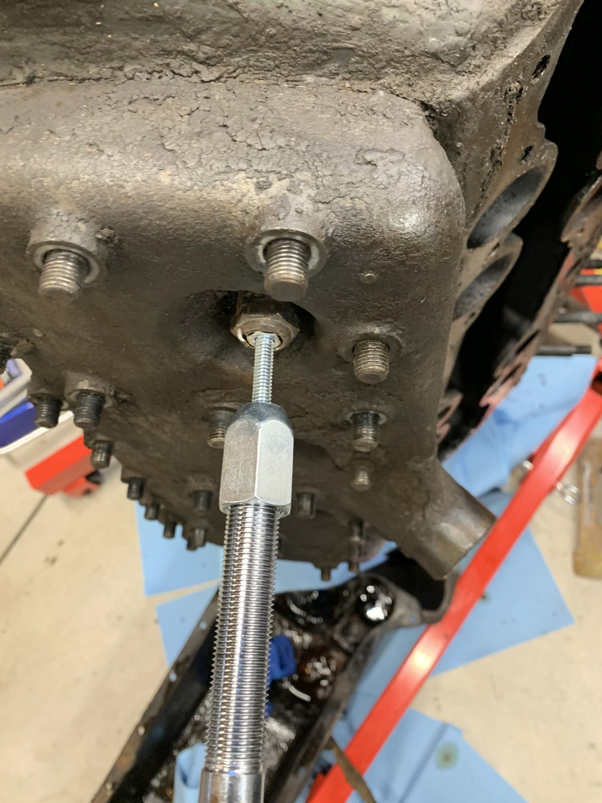

    It’s alive! And by alive I mean it now turns! It took about four hours of cursing but I got the head off. I used a hollowed out spark plug with a bolt through it and my slide hammer to get the seal to break. This was not as good of a method as I was hoping for as the bolts I used kept breaking but it was enough to get half of the seal broken. From there I thought I was home free. Boy was I wrong! After getting the seal broken, it still took another 2 hours to get the head off with a combination of heat, hammers and other tools I’m ashamed I used (but no damage done).
    From there, I started removing pistons starting with the ones I suspected were the cause of the engine not moving. 2 cylinder walls were rusty. I removed 4 pistons so far and it now turns over nicely. One valve is stuck open so I started soaking with penetrating oil.
    At first look without measuring anything, everything looks pretty good. A small groove on one of the crank journals is the only problem I’ve found visually so far. The groove at the top of each cylinder is very minimal. I’m torn on where to go next…do I totally disassemble and clean it and the build it or do I hone the cylinders, fix the stuck valve, put in new bearings and roll the dice that it will run? I’ll probably go the rebuild route but I’m tempted to put it all back together. Thoughts?

    If you aren’t going the full rebuild route, don’t spend money on bearings. And, properly fitting rod bearings is not a drop in situation for a ‘40.

    My suggestion is let the engine tell you what it needs. Keep stuff clean and in order.
    Find original literature with the "specs". Original Ford or say vintage "Motors Manuals" are great for this. These will give you basic clearances.
    Use "mash gauges" aka plasti-gauges to check clearances.
    Ford Tractor restoration sources may have valve seat grinding, valve grinding sets....It's worth a look.
    It's possible all you may have to have is rings. If the clearances check out. You can fudge a little but not too much.
    It may be fine after a honing, rings, clean-up and a valve job.
    Get the factory manuals.
    Flatheads are so simple they are plumb complicated so remember that. It's like nothing you have worked on before.
