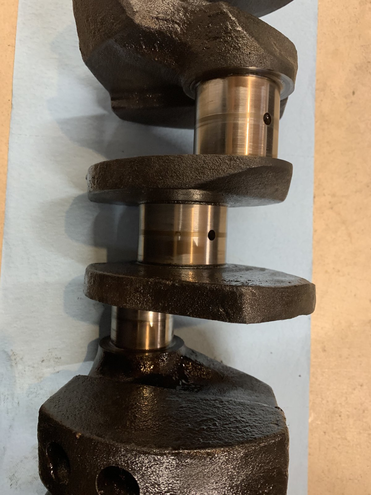

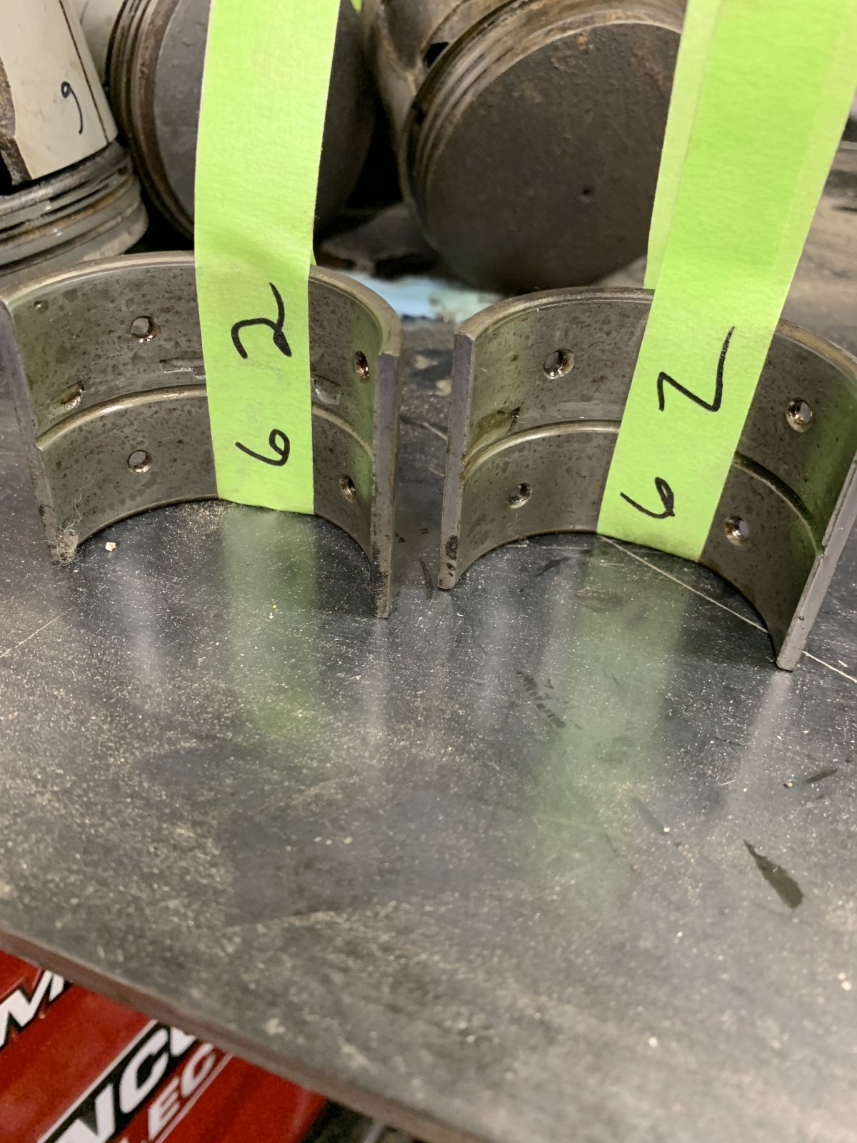

    Do you mean these bearings? I was going to ask if they were “floating”.
    these are the only ones I’ve removed so far. I labeled them. There is a gash in the surface but it almost looks like it was that way from factory (I find this hard to believe)? But there is not weird galling or damage on the crank in this same area.

    I don't think I'd run those rod bearings but I'm picky about stuff like that. Also be aware that both surface of the rod throws and the ID of the rods have to be considered when running full floaters.

    Thanks. Yeah the bearings don't look all that great! The ID of the rods so far look almost new...again without measuring yet. not a single scratch or mark or galling or anything.

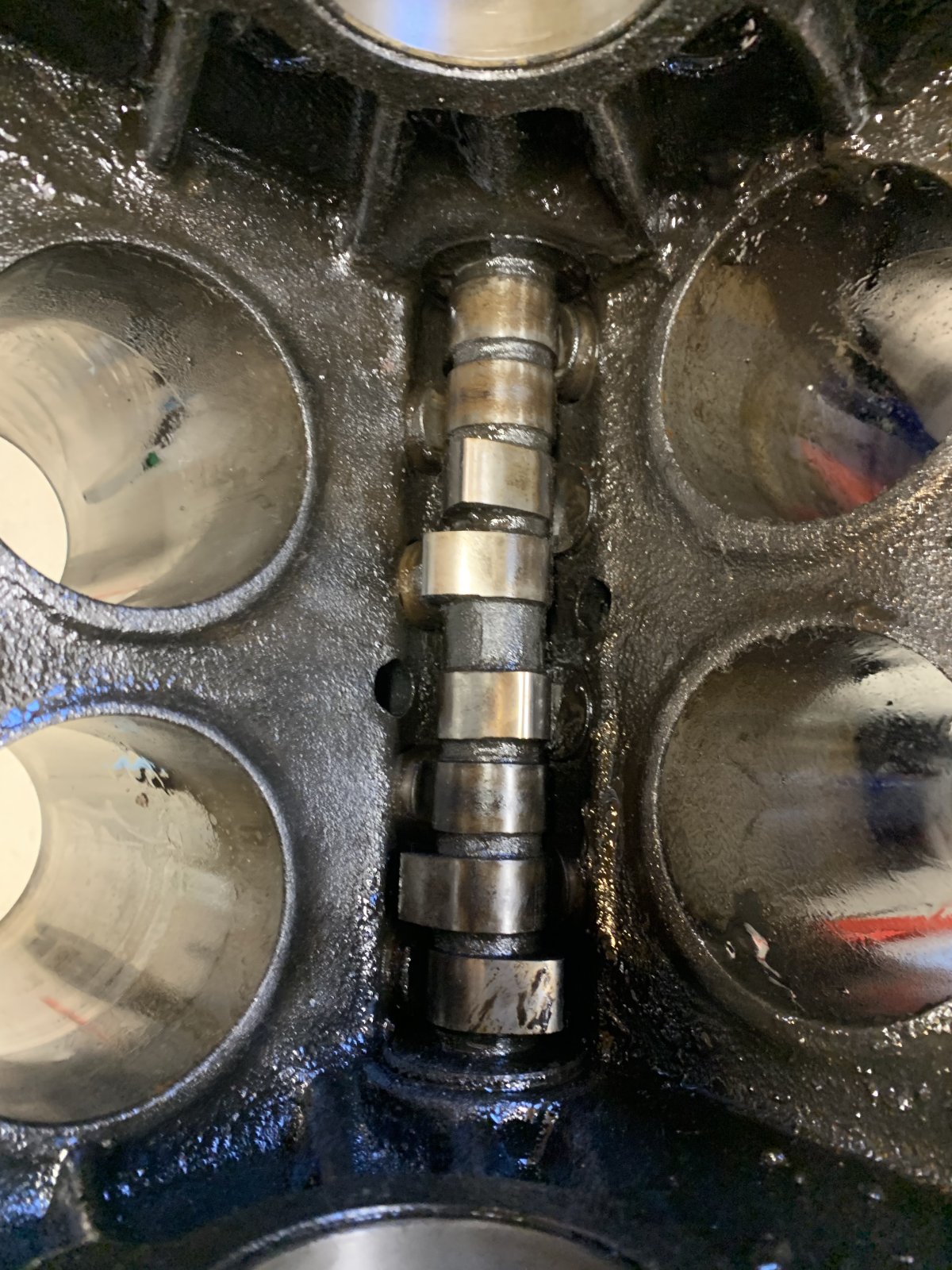

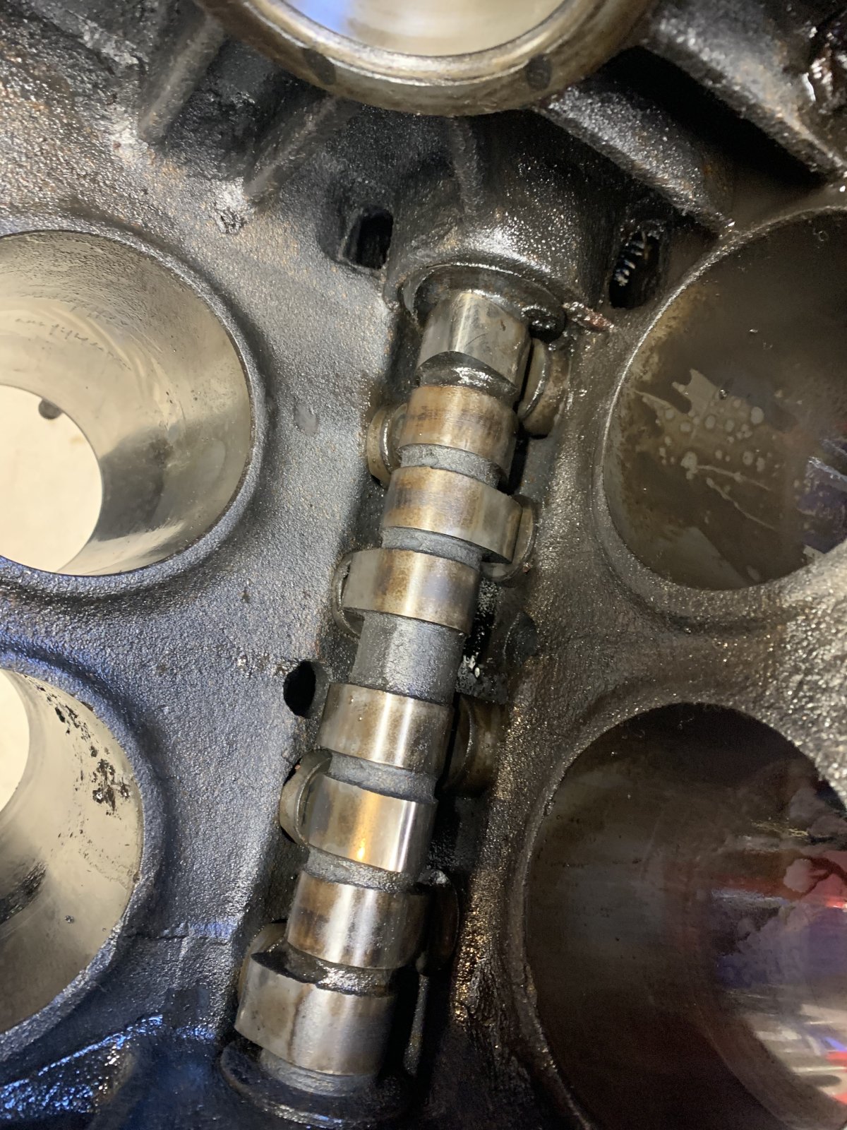

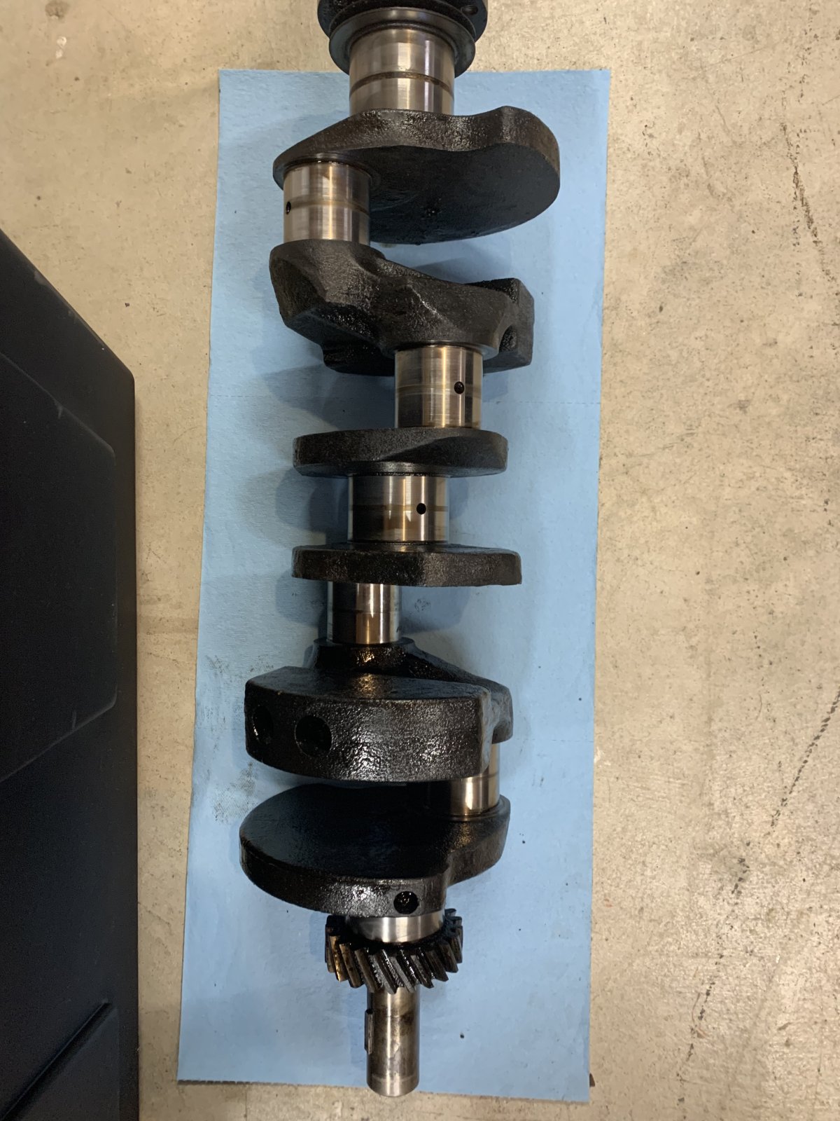

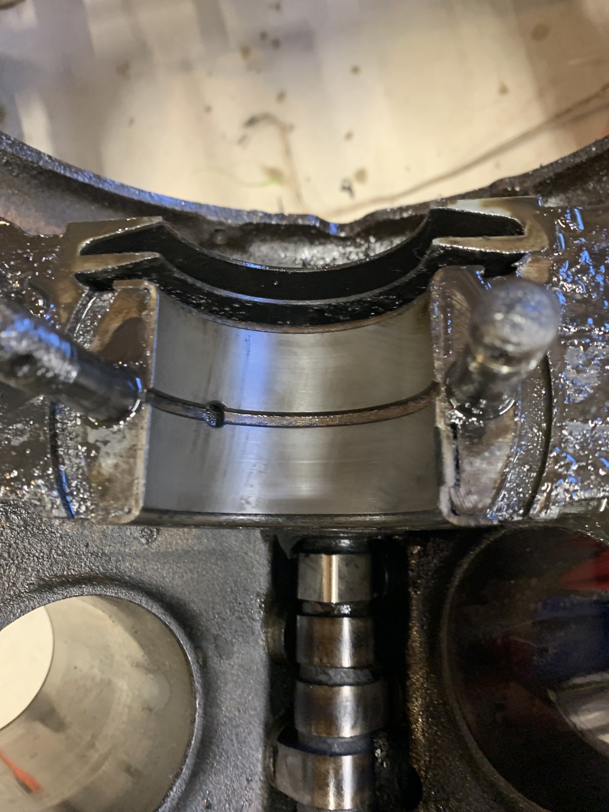

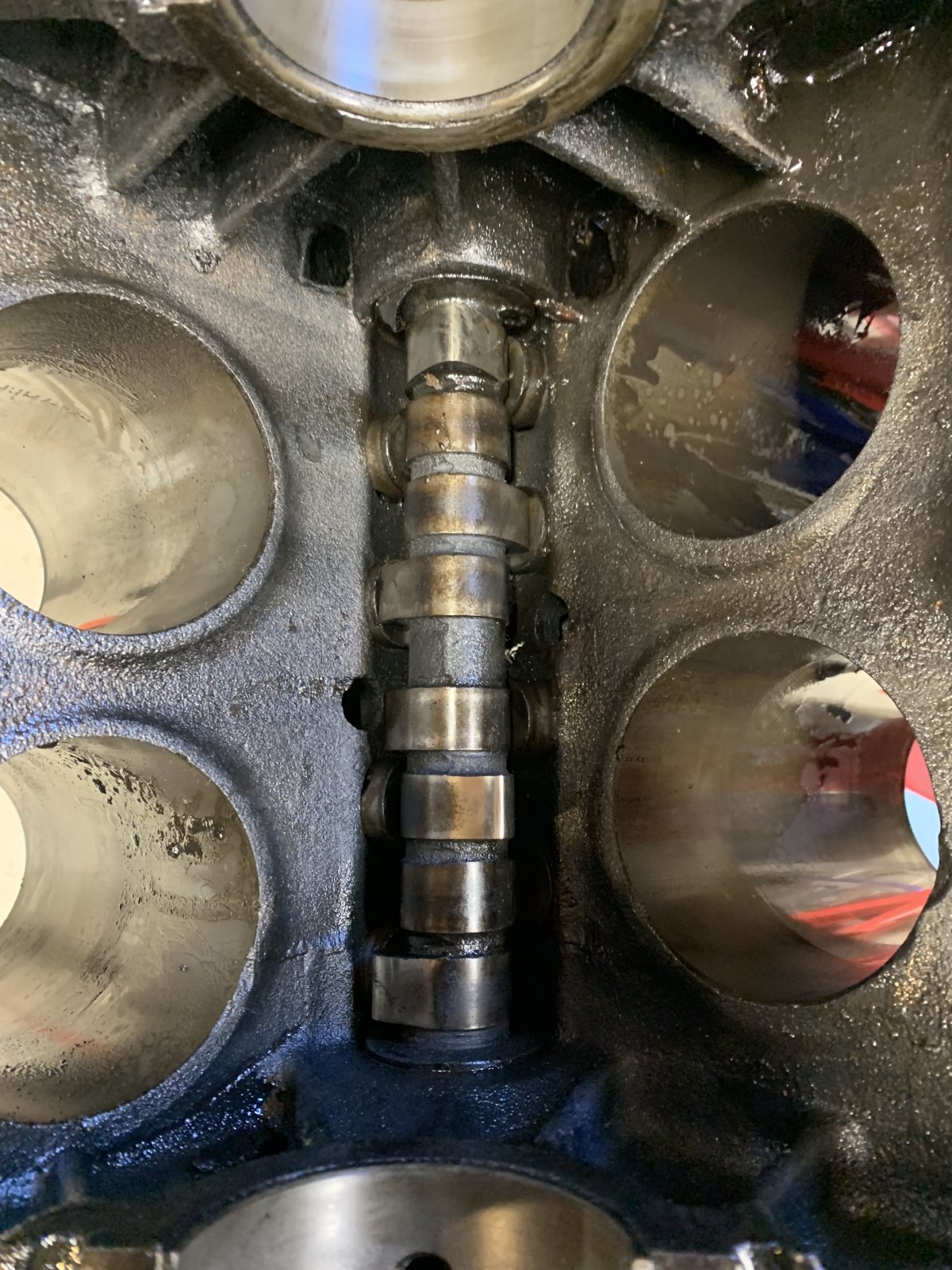

    I got the bottom end finished. Sorry to bore y’all with this stuff but I’m do***enting some of it for my own future reference.

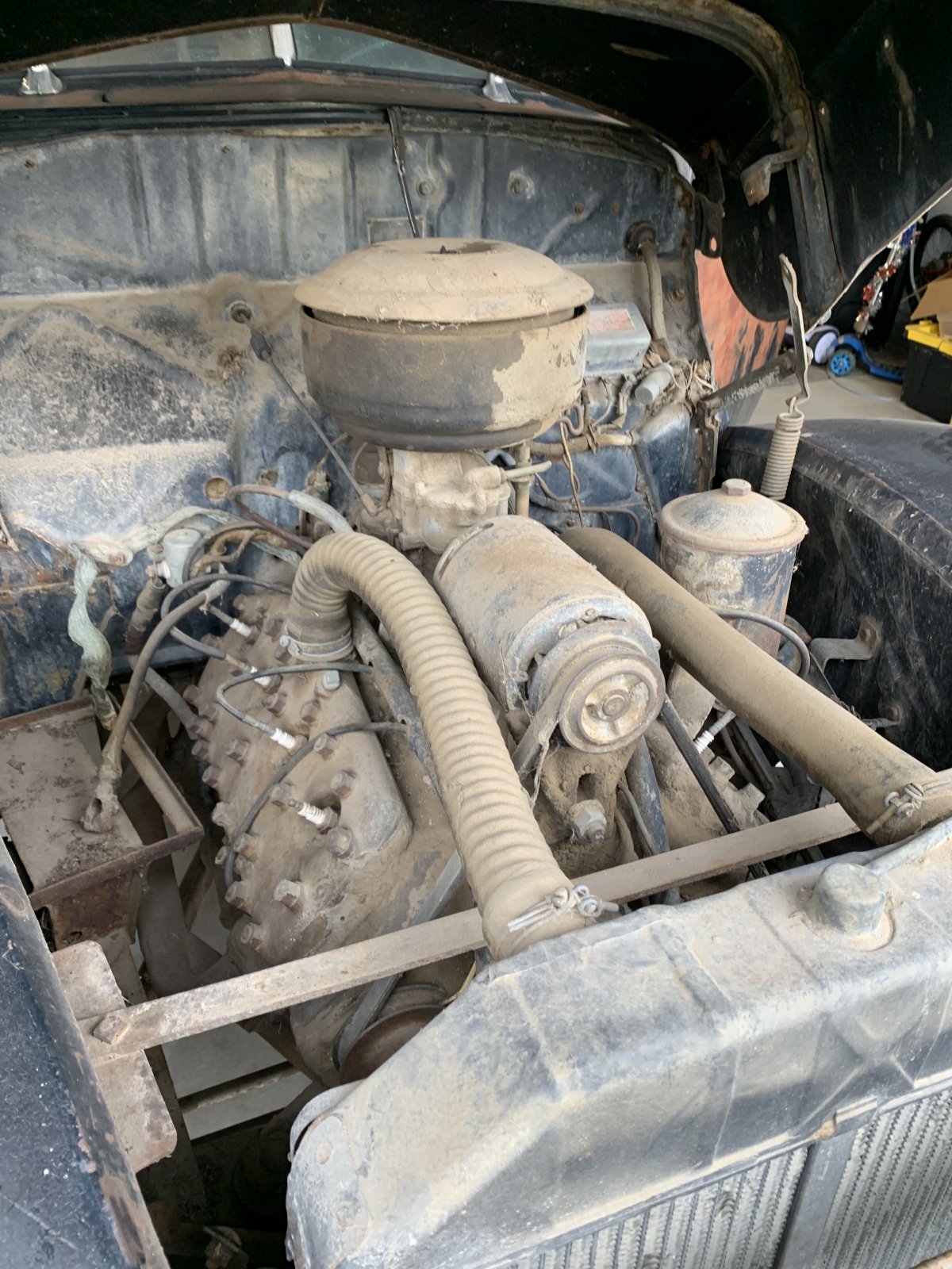

    I’m waiting on the valve pry bar tool and then I’ll get the cam and valves out. So far the only thing that may be concerning (and I don’t even know if it’s concerning?) is the dark spots on the cam. Other than that, everything “looks” good!
    Advice time. I’ll be buying measuring tools (dial calipers etc). I should have done it a long time ago. Anyway, if this was yours and budget is somewhat of a consideration though not too important cause I want to do it right, would you put this back together and run it? Budget is only concerning because my spreadsheet of other parts is about $20k long! I obviously know there are some risks involved with putting it back together after a thorough cleaning. But again, so far it all looks great upon visual inspection. If it checks out measuring wise what would you do? Is it a pipe dream that it actually measures out in spec?

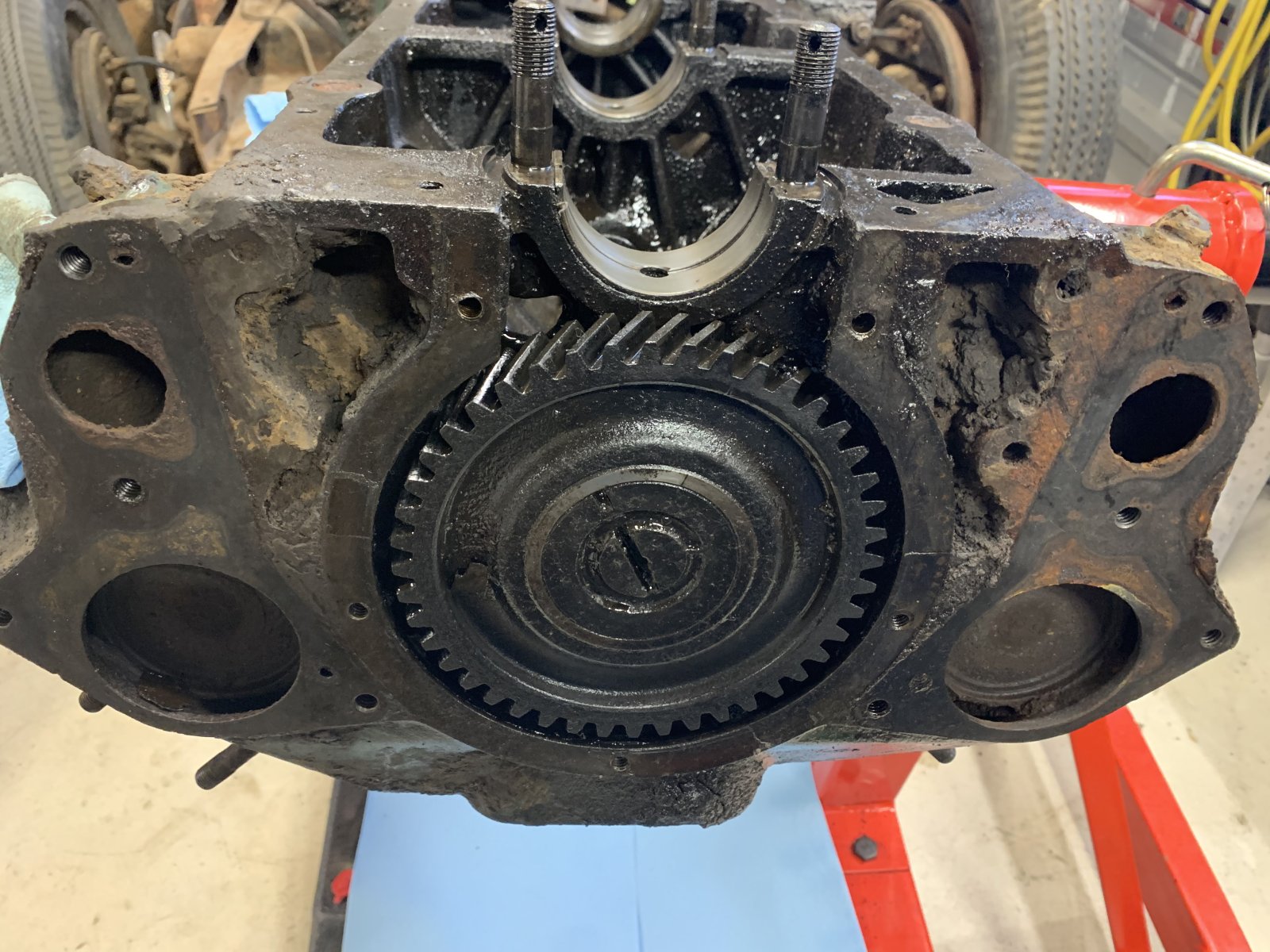

    Hmmm, does this tell if it’s pre or post war?

    warbird1
    That cam doesn't look bad, but you'll want to check the lifters out carefully. I'd do a quick check of the existing valve lash before pulling the valves, that will tell you a little about the over-all condition of the valve train. That block is a '40, pre-war, it p***es the pencil test.
    Welsh plugs in the pan rails suggest it is a pre-war block.

    ...and be a good time to check actual valve lift on each so you know what shape the lobes are in
  23. Flathead Freddie
    Joined: May 9, 2021
    Posts: 806
    Flathead Freddie
    Your front main is excellent and that is the one that usually shows signs of vibration with small hammered divets in the bearing faces . Get another cam or have this one reground . A little heavier duration will do the engine good but spoil the perfect silent idle a little bit still idle smooth and your freeway entrances will be improved

    The plugs in the pan rail makes it a 39-41-ish block. There are no serial numbers stamped on it to guarantee its the original to that car. Another indicator of a 40 era block is the tin sleeves, which I can see the fold at the deck, but I can't see through the grunge at the crankcase. Can you feel the tin sleeves with your fingernail down there?

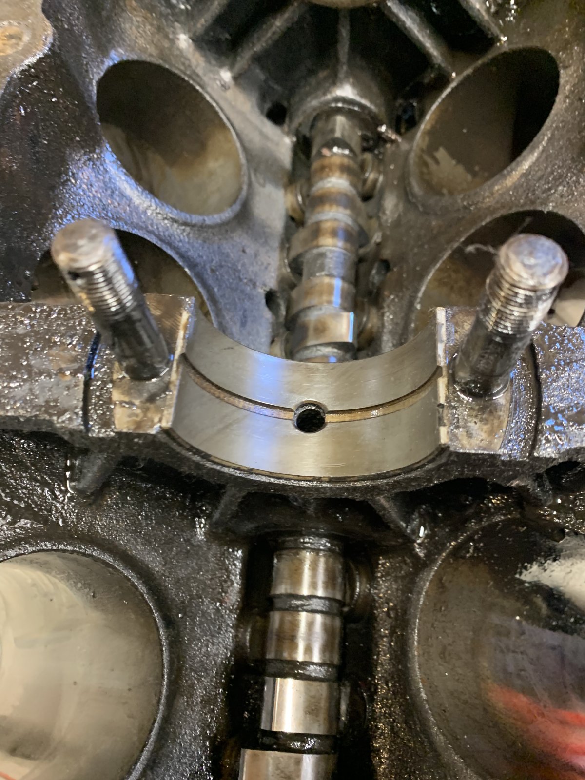

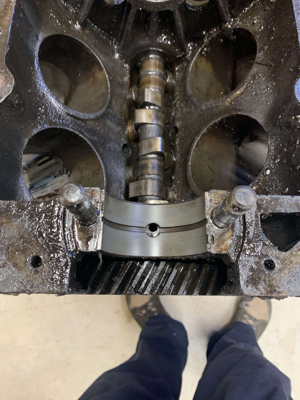

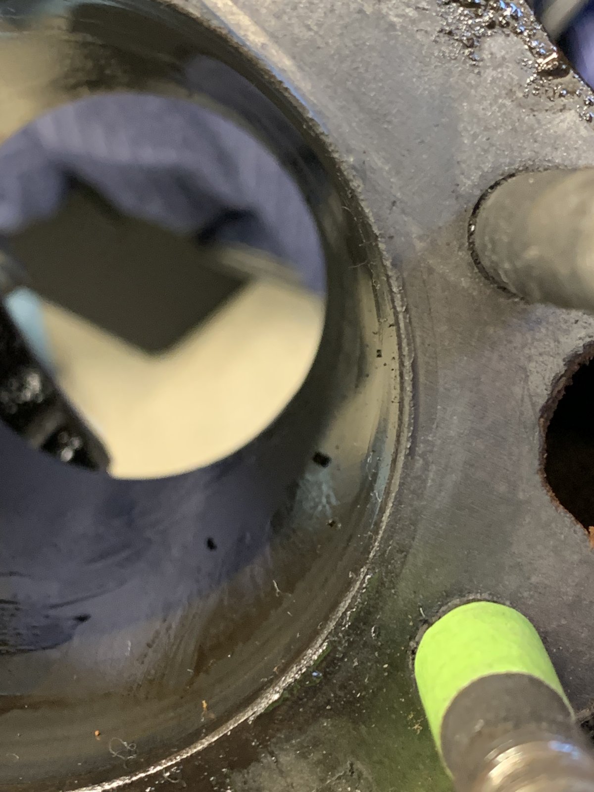

    I can feel a very slight edge. Also looks like I can maybe see where the sleeve ends and the cast iron starts. Question, if it is sleeved, is the benefit that if you remove sleeves, it makes it have more displacement and thus more power? How much power are we talking?
    58623F02-D4D4-4A0A-836C-CACA0D80DCDF.jpeg 5E3312FB-5890-4460-A989-0A858518CC79.jpeg
    This might be the death nail which leads to a rebuild. Placing a straight edge along the top of the block on the 5-8 side, there is a slight rocking motion of the flat edge. The other side is perfectly flat. The warped side measures .021" of gap. Is that too much to get away with without machining the head surface? The heads both have no gap when checking with a straight edge.

    rusty valley
    I don't think your method is accurate enough. The deck would be spotless clean, and a real machinists straight edge would be in use. Many folks say to not cut the deck if you can avoid it with flatheads as they are thin to start with.
