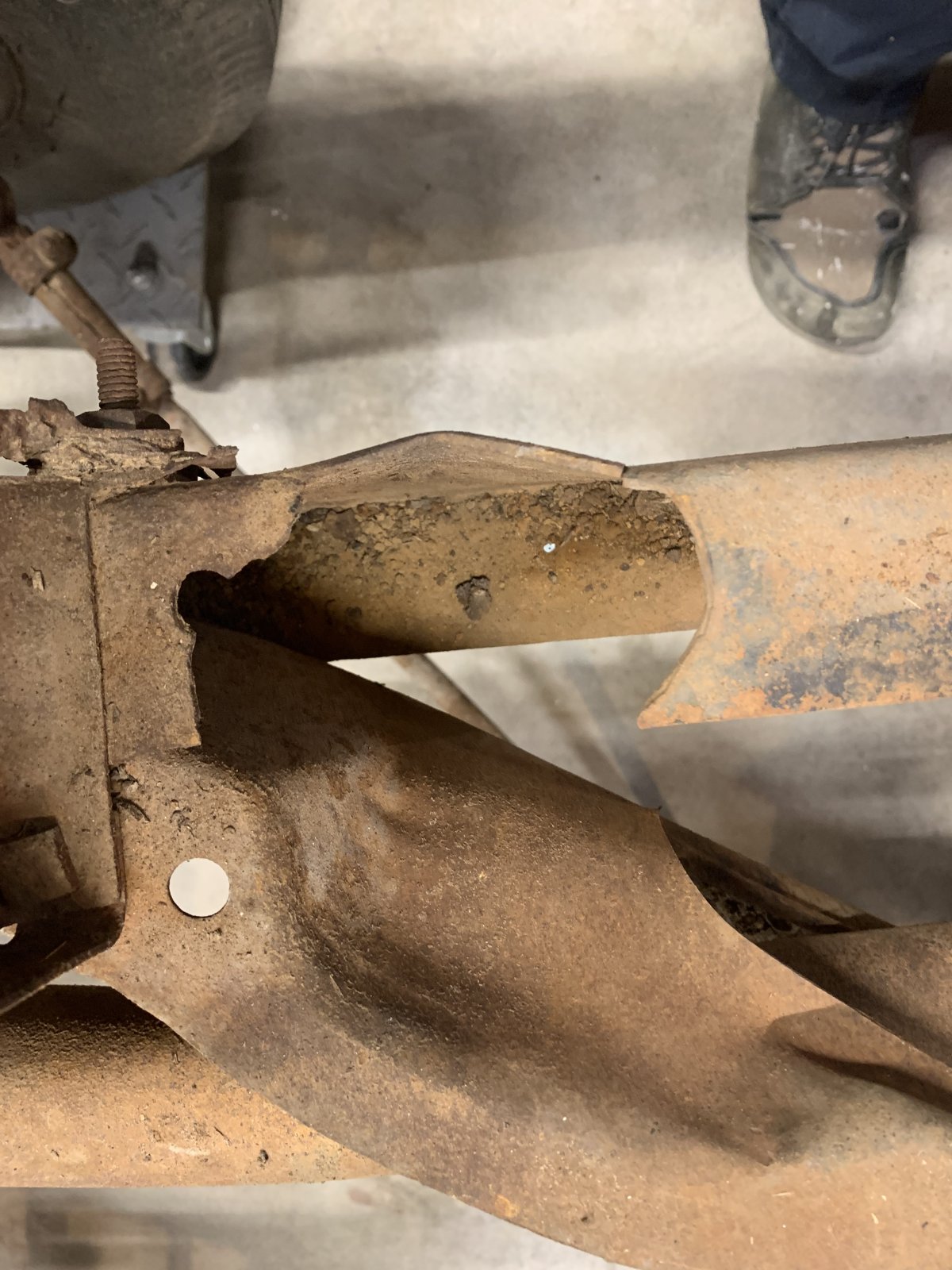

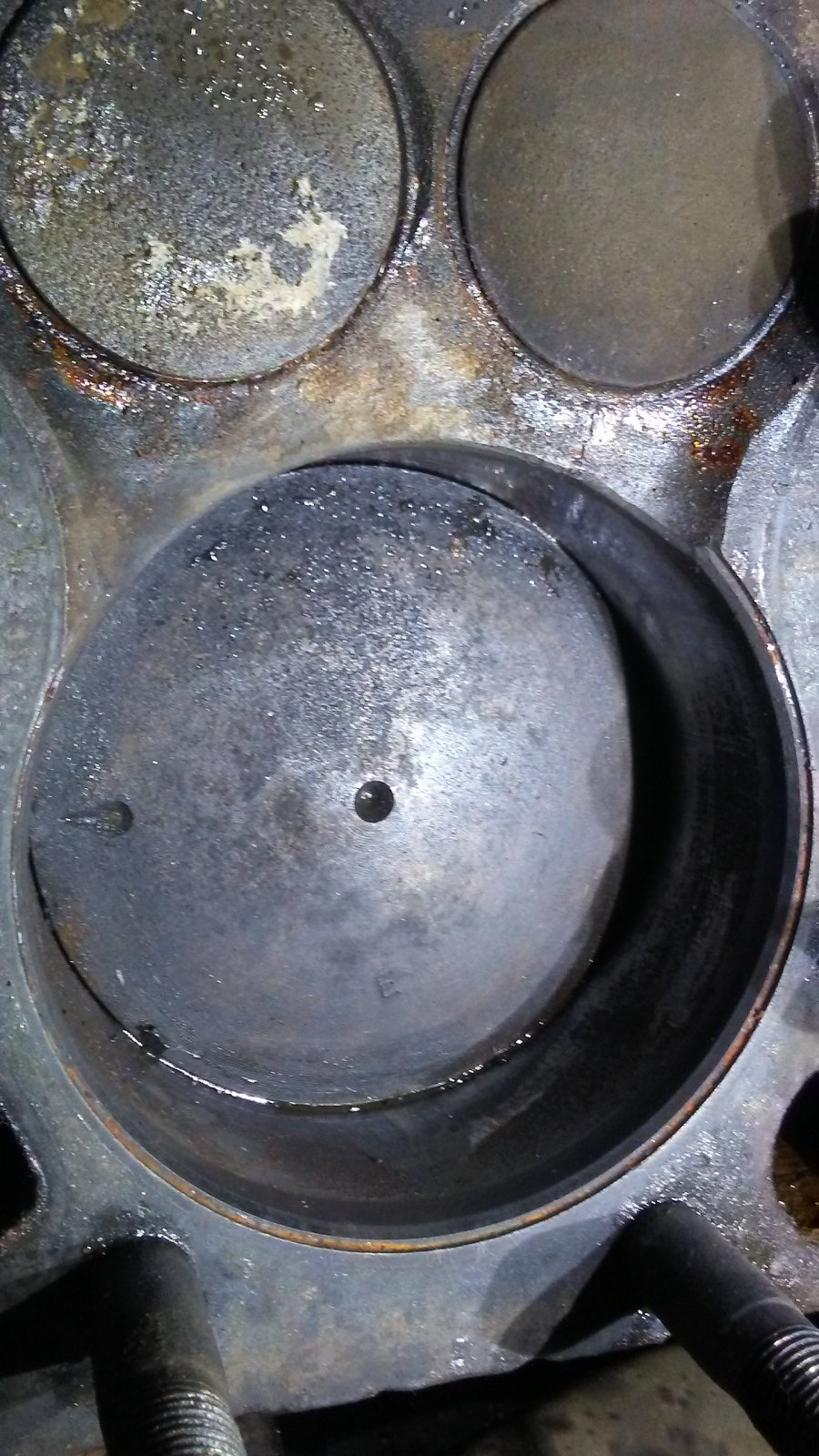

    Moving right along. The block is in the machine shop. It checked out and I’m working on the next steps of that while working on other parts of the car.
    Took the body off the frame last night. The two front mounts were completely sheered off of the frame. Other than this, the frame looks to be in great shape. I’ll tear it down next for sand blasting and paint.

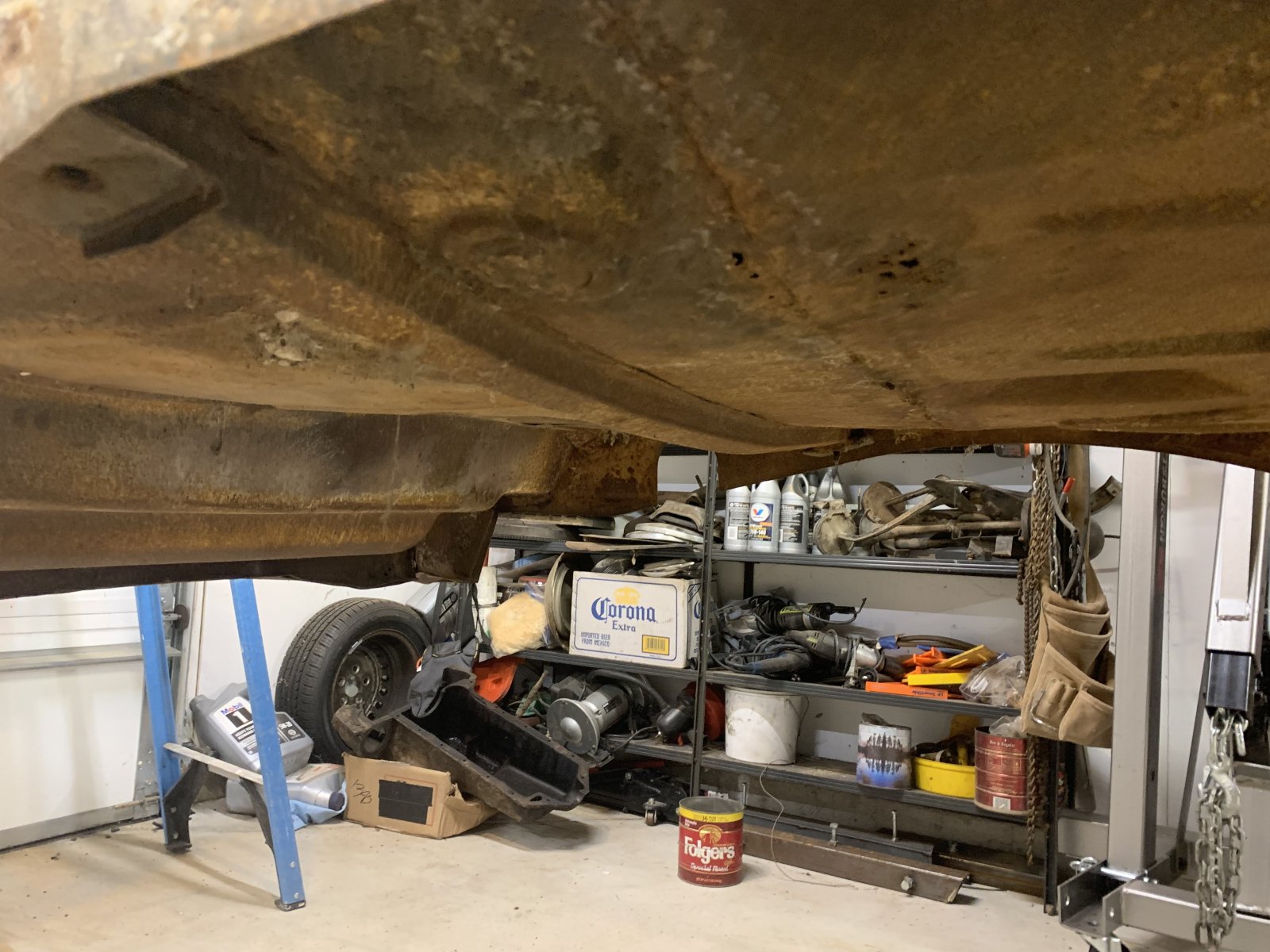

    I found a little more rust. The trunk floor may need to be replaced as it’s got a few holes in it and has some overall damage. Can anyone tell me if this rear cross member is supposed to be curved (like in the last photo) or if it should be straight?

    That brace in mine was totally rotted out but what was left was straight. Looks like somebody used it to haul something very heavy. Those frame cracks happen there on mine too but just a small single line not missing a whole chunk like that. My guess is that car was driven hard on rough roads with quite a load. Sounds an awful lot like like a 'shine car to me.
    Double check the two layers for rust at the rear kick-up where the X enters the rear frame legs at the rise over the axle, that is the usual place for rust on these frames as that area gets packed with dirt thrown up by the front wheels and leads to moisture being concentrated there.

    I agree with Crusty Chevy, looks like someone was packing an extra flathead around in the trunk or too much white lightning. I can't figure out why the frame has been cut by the cowl.... Just one more thing to fix. Your 40 looks to be in about the condition my coupe was when I started working on it. Lot's of challenges ahead for you. I hope you enjoy the process.

    I think the frame by the cowl literally just “tore” off. Both sides are like that. The rear trunk is definitely beat up and the right side is pretty dented. I’ll probably replace the trunk floor. I kinda wish I had known that before removing from the frame as I would have fixed it first. Hopefully I do t have alignment issues when I go to put the body back on (at which time I’ll replace the trunk floor after it’s back on the body).
  13. Atwater Mike
    Joined: May 31, 2002
    Posts: 11,618
    Atwater Mike
    When cutting out the torn sections of the frame, be sure to cut diagonally rather than straight across.
    The filler piece should be a parallelogram instead of a mere rectangle.
    (It is a 'physics' rule, as straight line repairs {especially vertical ones} induce new cracks alongside weld repairs)
    The weld will also be longer, spreading the former line of stress.
    Outback, Algoma56, The 39 guy and 2 others like this.
  14. Busmania
    Joined: Oct 16, 2022
    Posts: 193
    Busmania
    from Denver
    Thanks for that advice! If I have the pieces of the frame should I not just use those for the repair? Or should I definitely I use virgin metal? I’m thinking if boxing in parts of the frame too in that area for strength.

    If you can find the replacement trunk floor from Carpenter ( or Drake) it will have the correct floor support/ brace and yes; they are flat not bowed. Patching those gaps in the frame in front of the firewall is critical to get right the hood/cowl/ front fender alignment. Wescott has a diagram with all the dimensions for the 40 frame. I'd guess the frame is already sagging at the firewall. You mght try tacking the missing pieces in then check check for a parallelogram, twist, sag, etc. Good, straight frame = happy ***embly.:)

    Thanks. Getting it to start in the car was not in the cards. It was frozen and upon tear down I don’t think I would have ever gotten it to turn over without tearing it down. Two of the cylinders were rusty holding the pistons tight. Anyway that ship has sailed and now the entire car is apart!

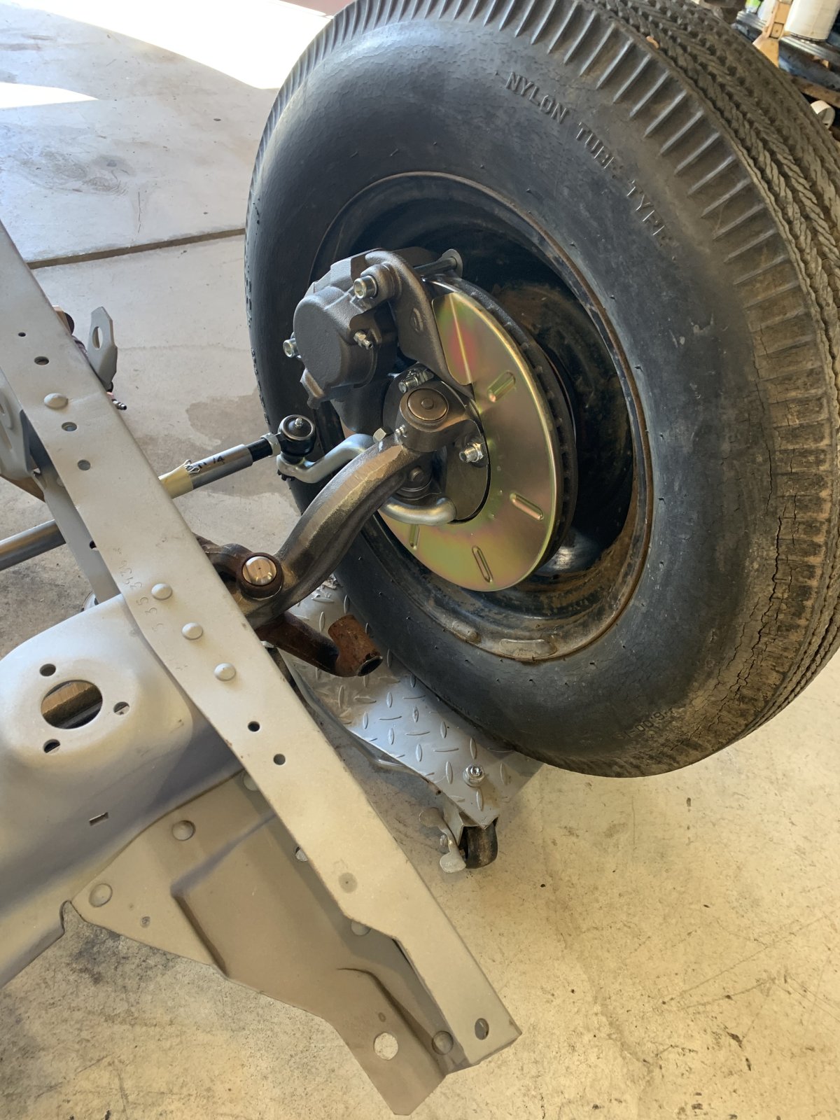

    Finally on to some fun stuff. Tear down mostly complete. Still waiting on engine parts from
    Machine shop. Working on mock up before I tear it all apart and paint all these clean parts. Having the ability to quickly clean parts with my sandblaster has been a game changer for me. 7448D28D-B9A8-431B-8FF9-D00516DF195D.jpeg 46BED4F6-1AB6-469E-87F8-6A35FDF77874.jpeg 37F98299-A278-4172-B145-4D0750C762A3.jpeg 2442FFEE-14DD-4C09-8FE7-C294E2D96B97.jpeg DF04E10E-C7F3-4E2C-877C-51FBBD2953E0.jpeg CEC5832C-3A49-421C-A629-B054603D99F7.jpeg 0D89179B-060E-4F71-8FAA-BFAF8D338107.jpeg
  27. sdroadster
    Joined: Jul 27, 2006
    Posts: 450
    sdroadster
    Did you intend to put the front wishbones on upside down? Is that a lowering trick I haven't seen?
    rod1 and Algoma56 like this.
  28. Busmania
    Posts: 193
    Busmania
    from Denver
    shhhh. Don’t tell anyone! I actually fixed them after photos were taken after I looked back at tear down photos and realized they were upside down.
