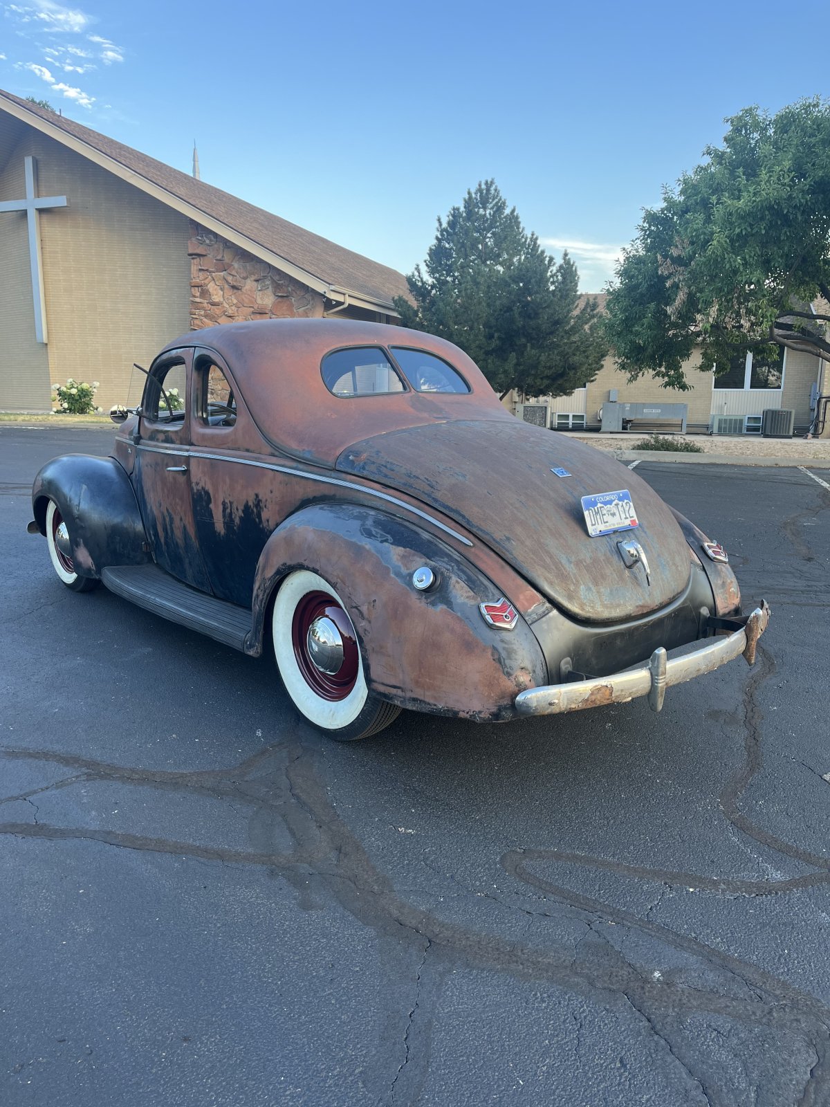

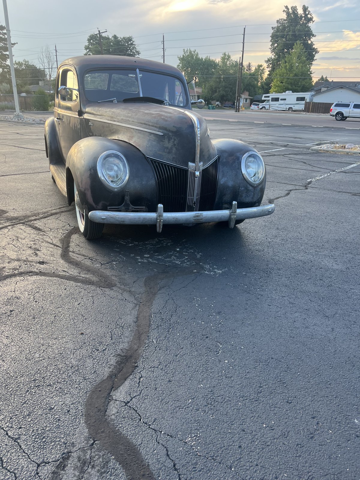

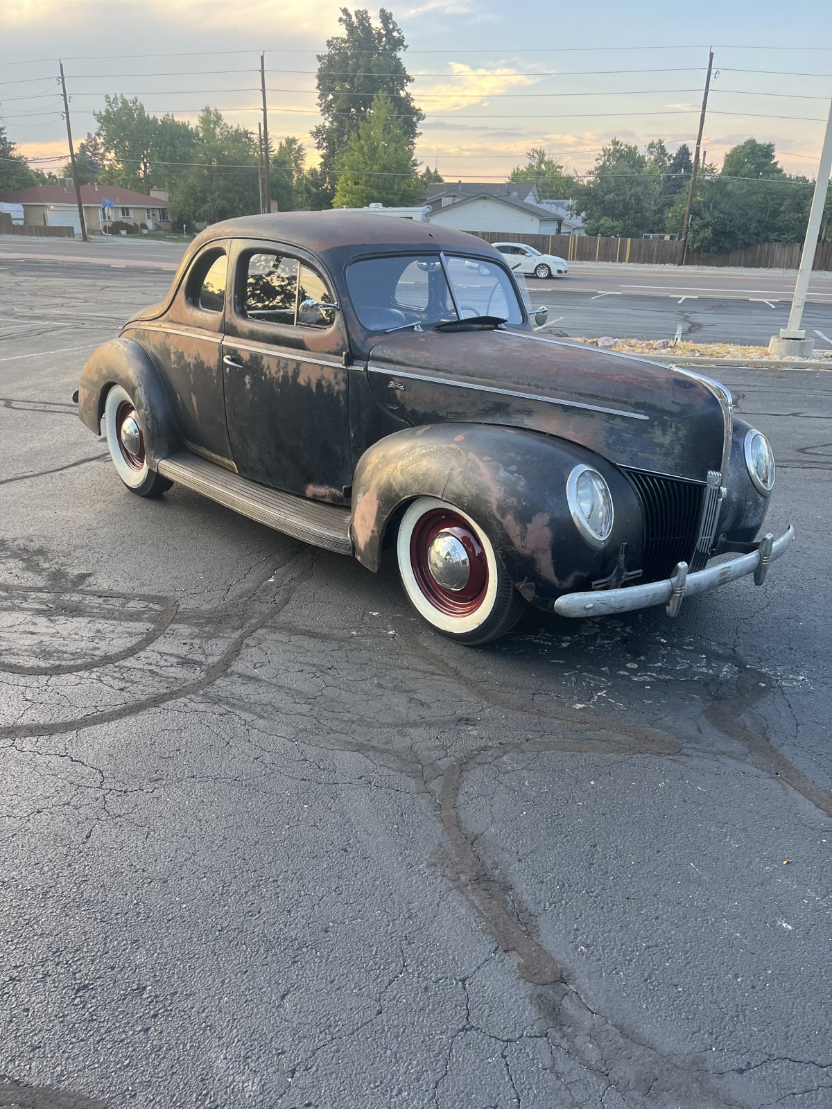

    Got bored yesterday so I cruised over to an old timers yard to see if he might have a front bumper. He did so then I got motivated to install them last night. The front was a ***** as it’s clearly tweaked so putting it together was a challenge. Hard to see in the photos but I think the brackets are bent so I ordered new ones. The p***enger side looks super cool pushed in towards the body but the driver side looks out of wack as it sits where it should. Anyway, I have new brackets coming.
    I didn’t even try to clean up the rear. I left the flaking chrome as is (and some blew off on my first drive just now. lol).
    what do yall think? Bumpers or no? I’m undecided. I wish they didn’t stick out so far but I may try and trim the brackets (or make new ones) that pulls them into the body.

    I like it better with the bumpers. Thats my vote.

    I like bumpers on '40's. The brackets are spring steel and thus very difficult to re-drill to **** in the bumpers. Best done on a mill vs a drill press but if you are patient it can be done. There is a filler "gravel panel" available for the rear that takes up some of the gap visually and keeps rocks thrown from the rear tires from hitting the inside of the bumper and flinging back up and chipping the trunk lid. I have one for my build and will be using it. Pic from web: gravel.jpg
    EDIT: Forgot to mention there are two different front brackets. The one for Deluxe is longer to clear the more protruding grille, the one for the standard is about 2" shorter. Standard on a Deluxe will pull in the bumper, but obviously you have a standard and need the shorter ones to begin with. Top is standard, bottom deluxe. These are a bit bent but you get the idea.

    I love the look of the bumpers on your car.
    I ****ed the rear in on my 39 1.5" as I didn't like how far out they stuck.
    I will be doing the same to the front as well.
    Car is looking fantastic.

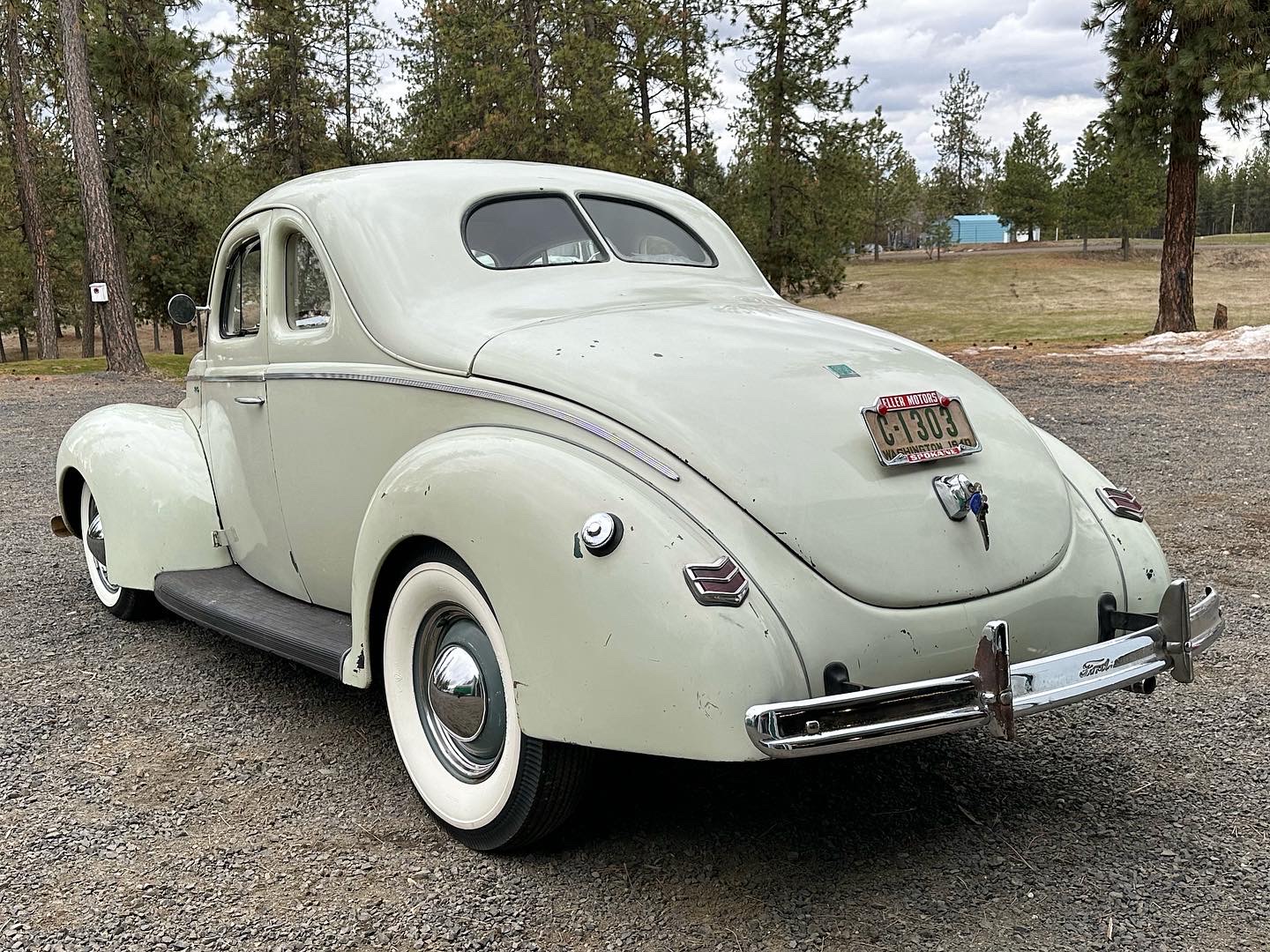

    Here is @Chris ’s great survivor coupe with 41 Super Deluxe bumpers.

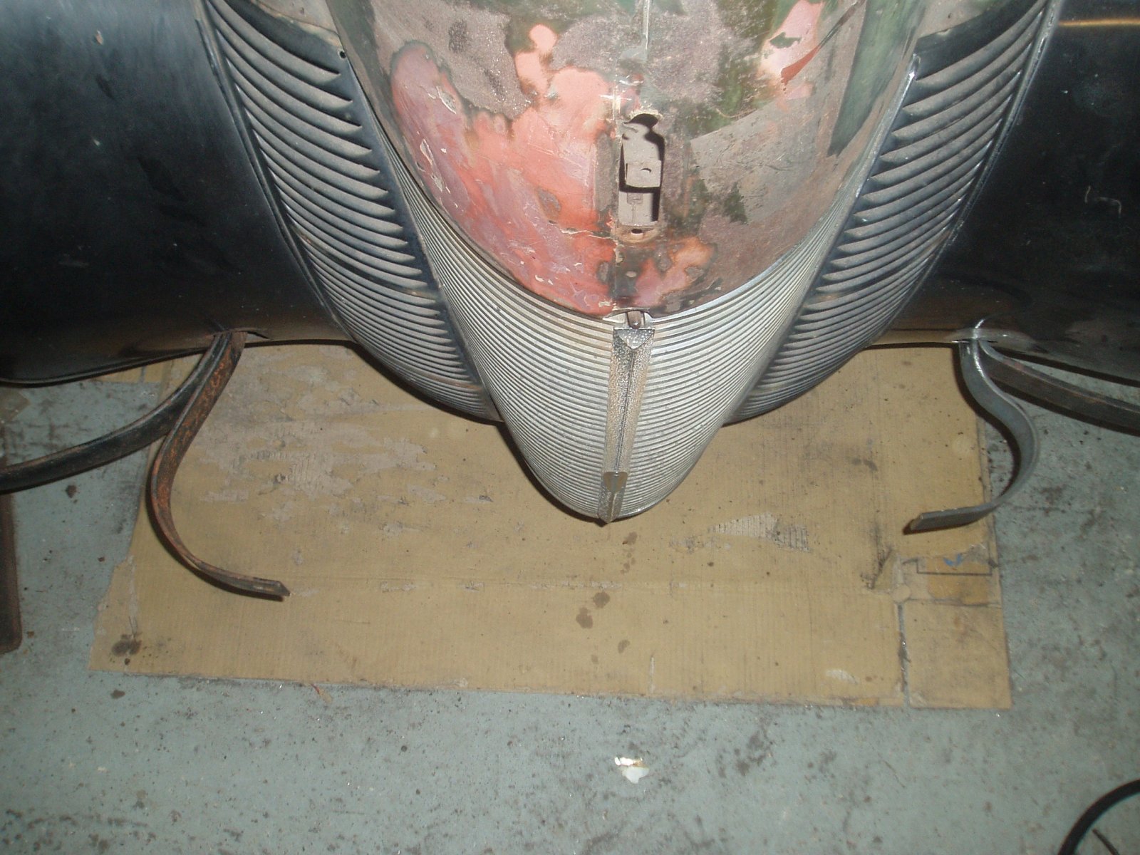

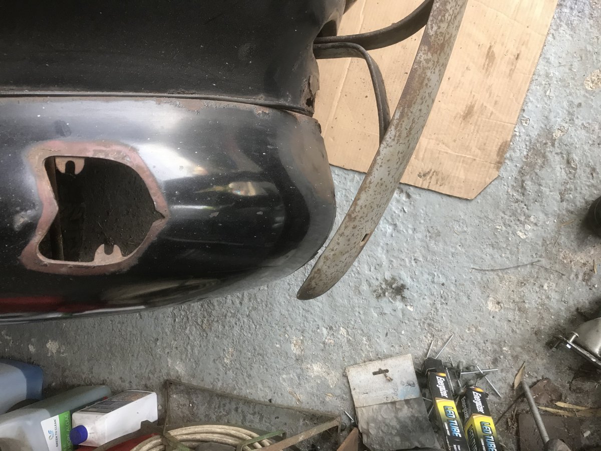

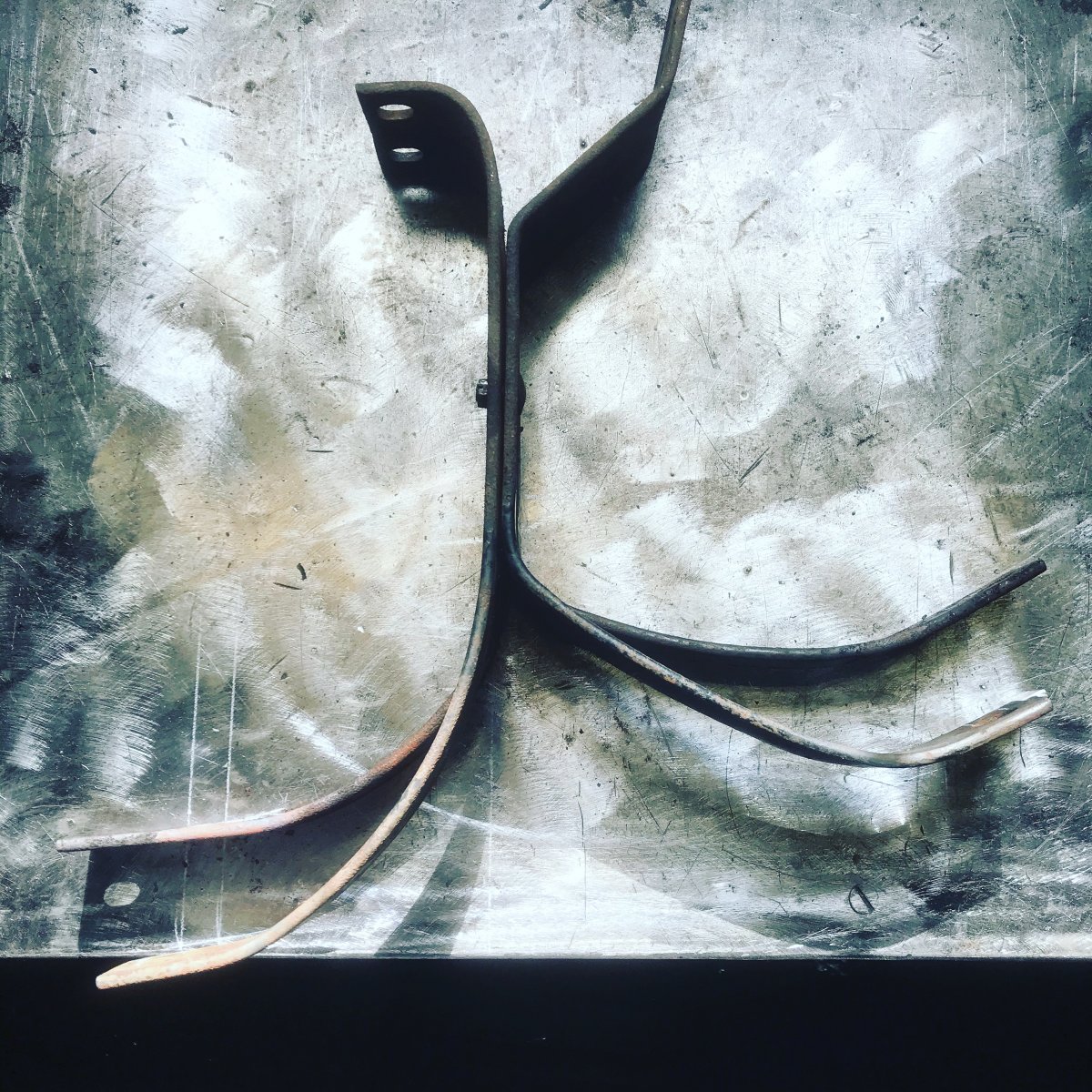

    I tucked the front and rear on my sedan. Front I made new ones using flat bar stock, rear I tweaked and redrilled, which went fine. Tucked both about 2-3 inches, also dropped the front one. First three pics are front, last two rear.

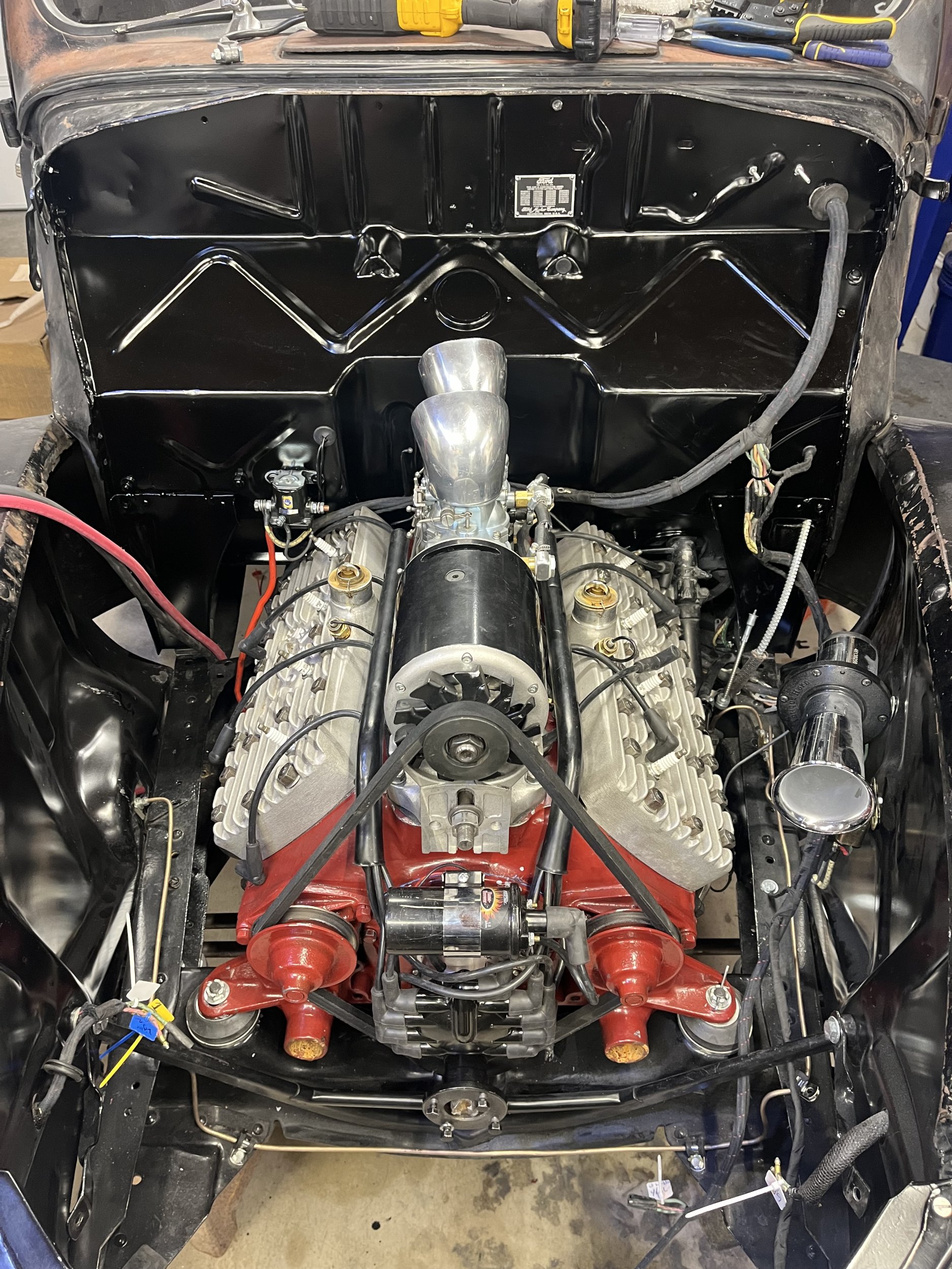

    Back together. Holes filled, battery moved to trunk. A few more items and I’ll be on the road again.

    Looking good. Do you have one of the covers that attach to the firewall where the harness splits? It helps clean up the wiring a little.

    Looking good. What was the outcome of the distributer issue?

    yes I have this piece but the new wires seem fatter so I need to make a spacer so it will fit. Every time I try to install it as is, the electrical goes wonky cause the new wiring seems to be fatter.
    I replaced the cap and rotor and all has been good since. I also added an electric fan for when sitting at idle on the hottest of days.
    got it off jack stands today. Drove around the block. It’s running like ****. Backfiring, not great power, etc. Haha. I guess I’ll look into it after the holiday. I probably need to tune the carbs.
