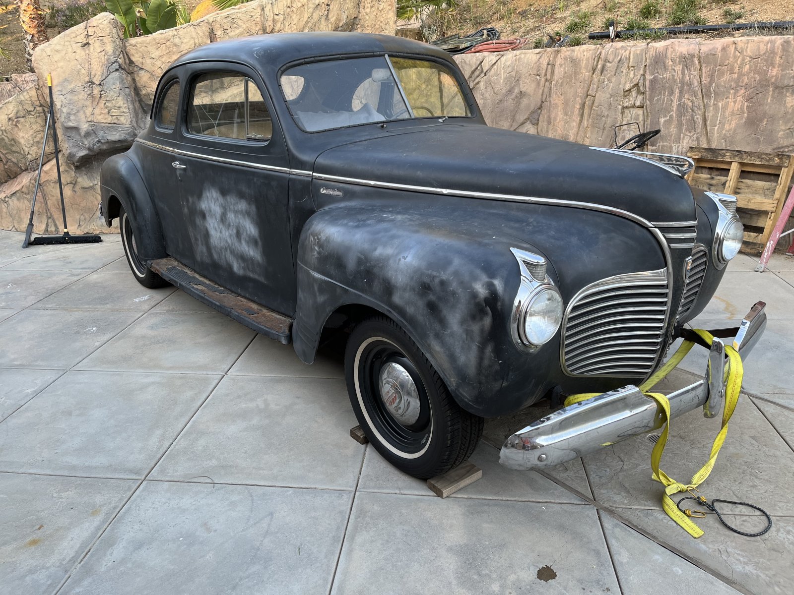

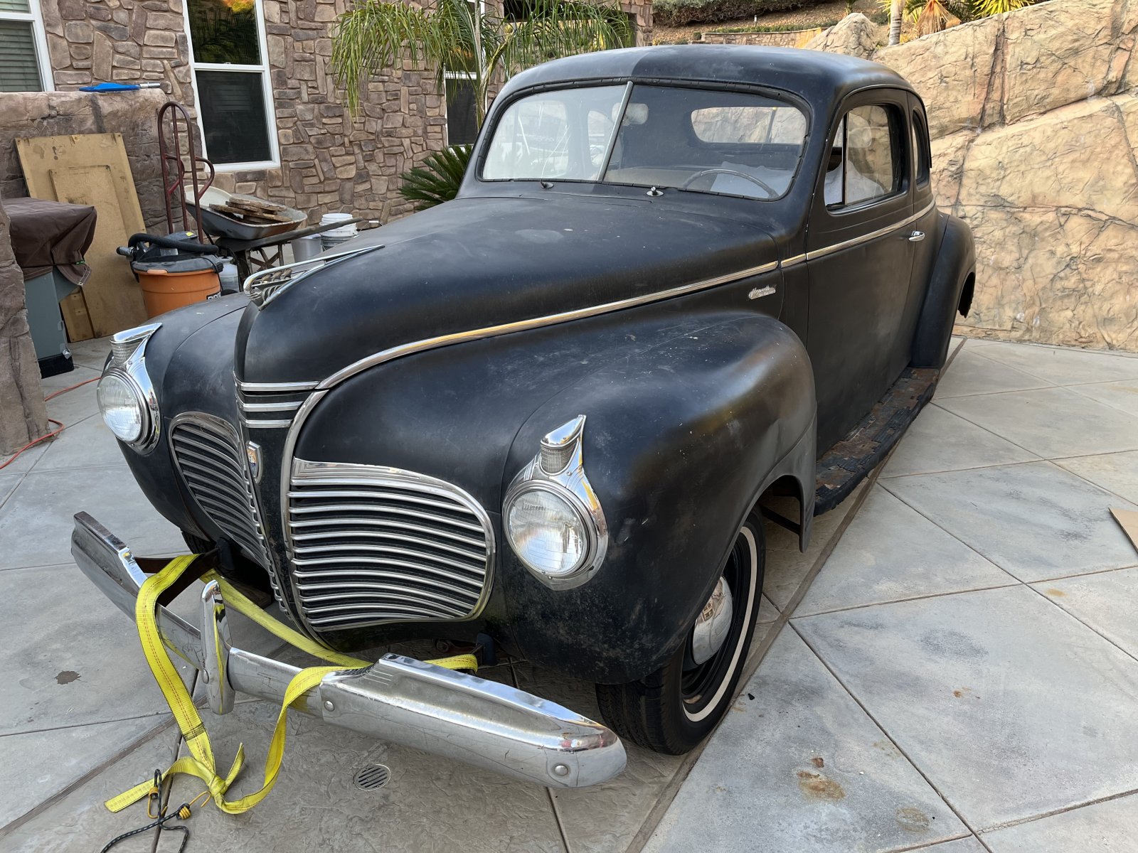

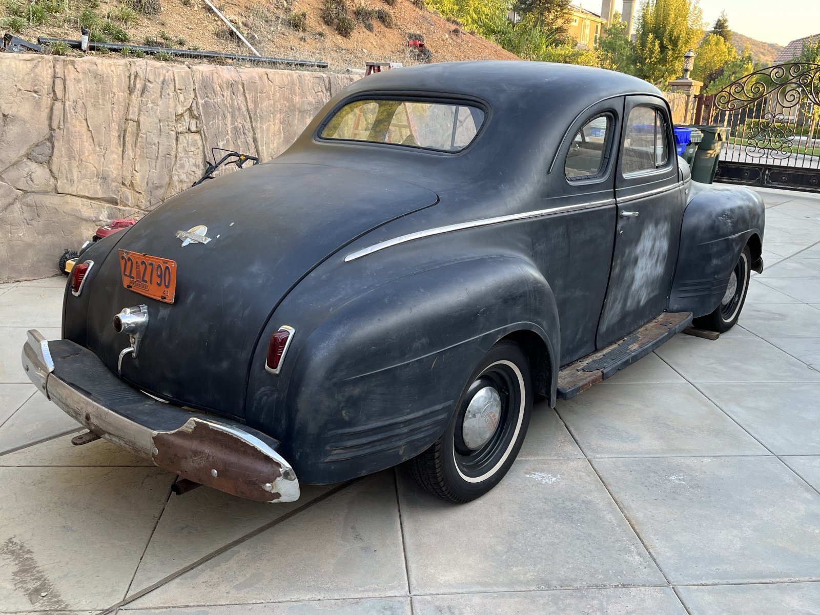

    4C04F81E-99B3-4E8B-AAF0-1C7AA49B10A4.jpeg E4D91331-5BA3-4895-AC6C-F1D6F34D1FA8.jpeg 7839C4D7-71D8-4BF2-8890-9DC84776AA24.jpeg F5296CA0-164D-4CE9-91B3-577305E46555.jpeg 32B13154-928C-4DD5-AA62-F4EAB356A735.jpeg C95E31AE-8D63-42B7-9416-4FC3FB623545.jpeg 3890CAFB-B3CD-4E71-827A-674BAAB59E68.jpeg 12B95B5F-335C-4254-ABEC-741BA4D364DF.jpeg F382B08B-3332-4076-BCC8-83A4E24A6B03.jpeg I posted a thread here a few year’s ago with questions about 41 Plymouth coupes, I was looking for one at the time but stopped due to moving and some remodeling of the new place. I currently have a 54 Chevy PU and a 57 Chrysler NYer 2drht. The other two vehicles I want are a 41 Plymouth coupe and a 59 Impala 2drht.
    A really solid looking 59 popped up at the Colorado auction on 10/15, I bid to my pre-determined limit of $37k, and the car sold for $37.5k. Disappointed but relieved at the same time as I had not seen the car in person and avoided the possibility of finding cancer in places not shown in the photos after spending a huge chunk of dough.
    As luck would have it, a few days later I found this 41 coupe online, located in central Oregon. Looked solid and the owner did a FaceTime video with me showing whatever I asked. The seller agreed to hold it until I arrived so I borrowed my son’s car hauler and me and the wife headed to Oregon from southern CA early the next day.

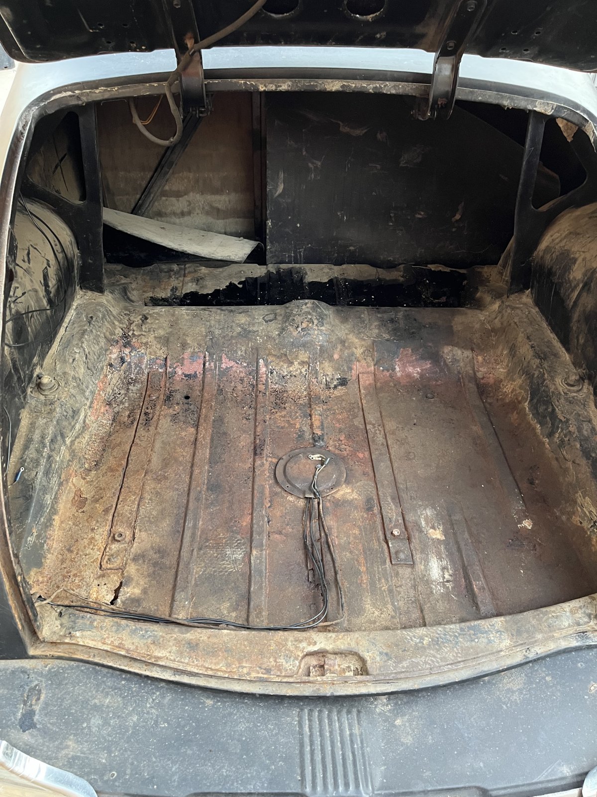

    We arrived and my inspection revealed zero cancer except a very small spot in the back corner of the trunk pan, just as the seller had stated. Loaded it up and on the way home stopped at Springfield Auto Recycling in Oregon and the next day at Big M Automotive in Williams CA.

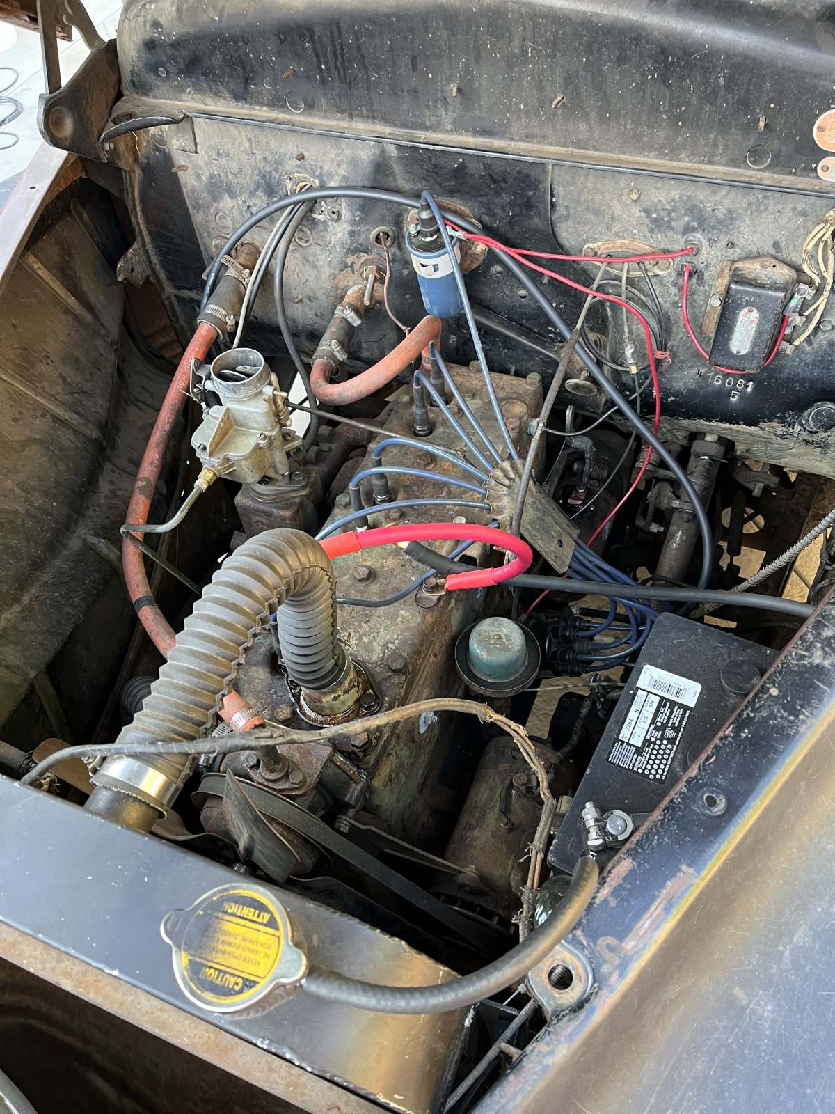

    The car is currently not running, the seller stated that it will but needs a new starter relay and possibly a starter rebuild. I ordered a relay and while manually engaging the bendix briefly touched the negative battery cable to the starter post and she turned over just fine. (Positive ground system). I’m confident I’ll have it running soon after the relay arrives.

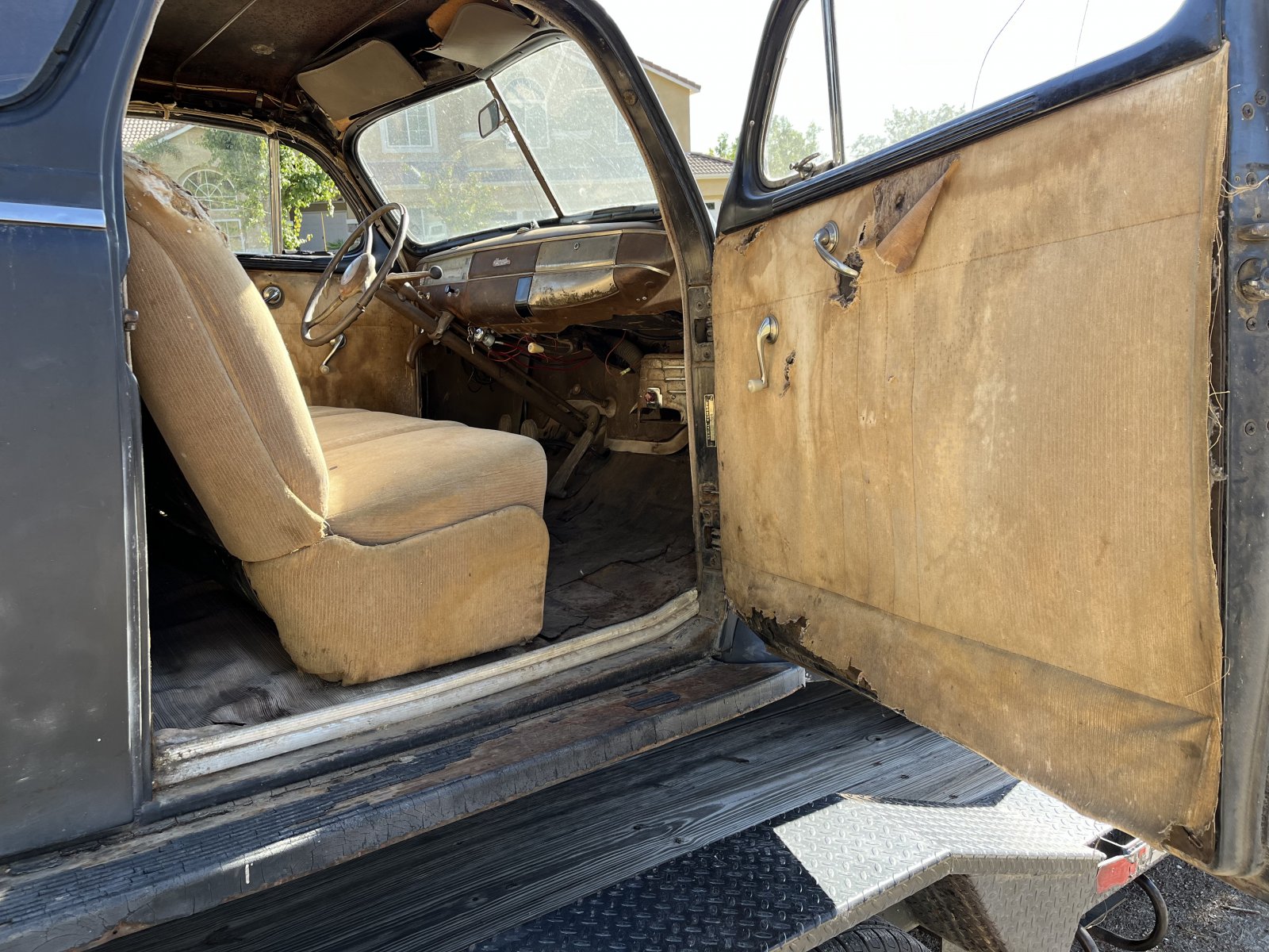

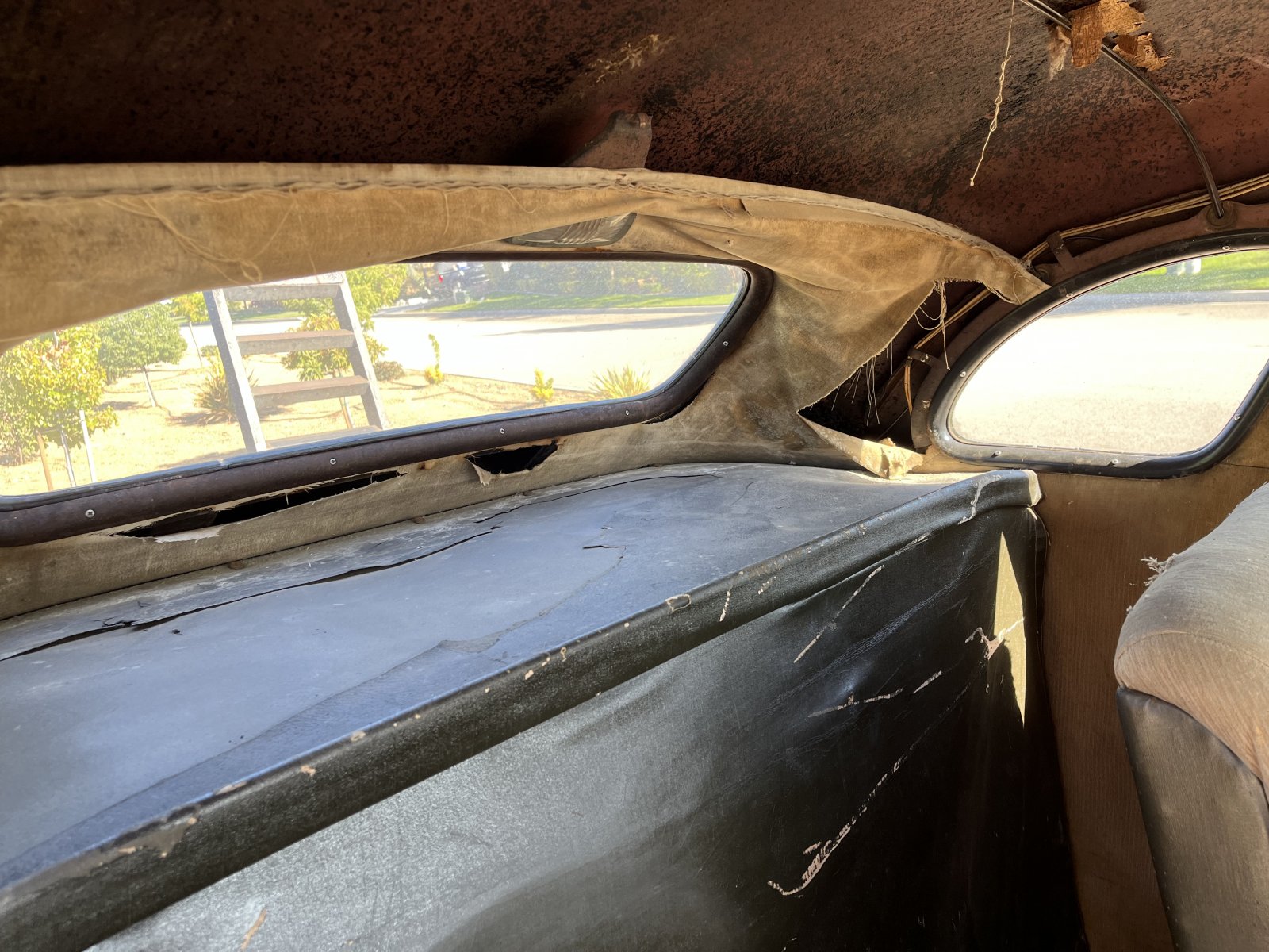

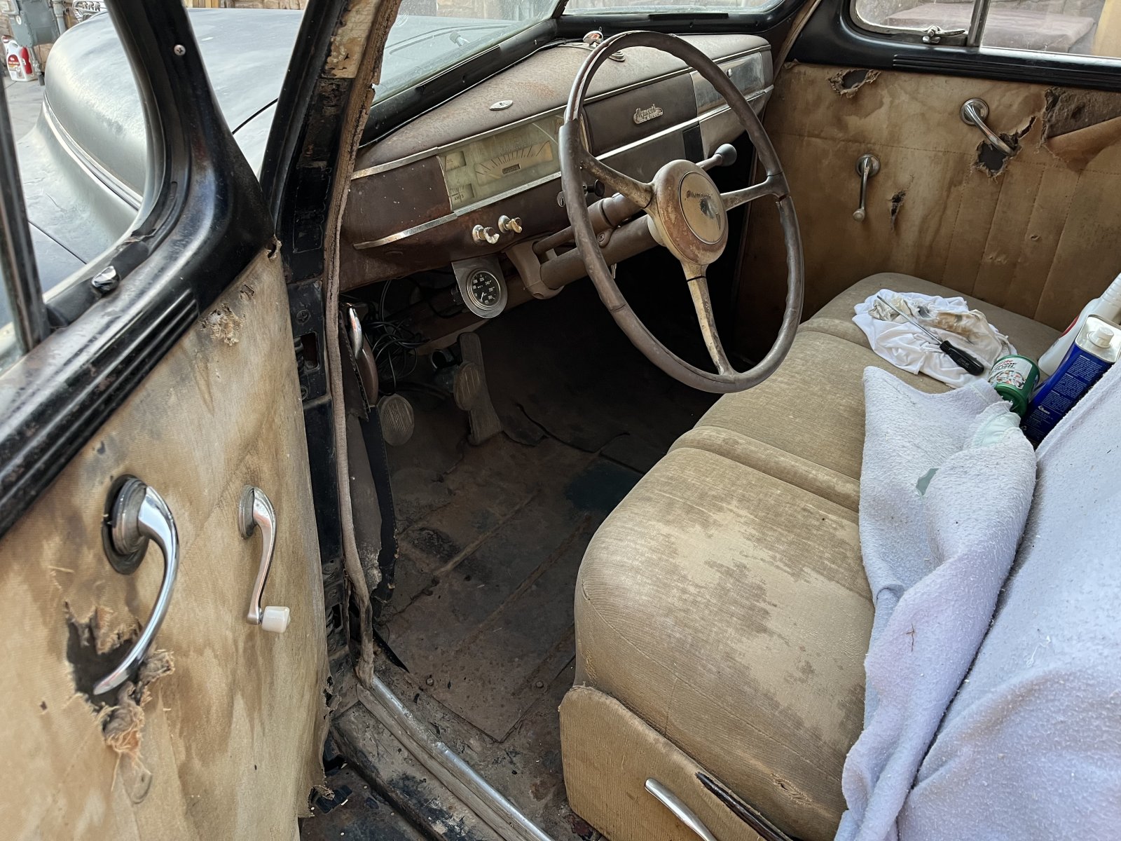

    The car is like a time capsule, the engine is original as the block number matches the registration. Nothing original seems to be missing. The rear floor mat and spare tire curtain are still in place. The cardboard kick panels and trunk panels are still there, although in poor condition.
    For at least the short term I plan to keep it simple, get it running, clean it up, inspect and renew the brakes, fix the transmission and differential leaks, treat and paint the surface rust, lower it a couple inches, paint the original wheels red, stock hubcaps, wide whites, and repair and paint the body panels one at a time, satin black.

    the present exterior has a lot of charm. if it’s mostly original just clean it up some. otherwise except for the headliner issues … your interior is serviceable for a little while (until it’s absolute shreds.) and wide whites… I love the idea. however if the narrow skinny white walls are still serviceable I would drive them and wear them out. THEN do the wide whites. for present… focus on getting it running good.

    Sweet! They are not easy to find, especially in that condition with all the trim pieces, etc in place. Be very wary of the wiring. It is cloth covered and really old. It will literally fall off if you just touch it in some places! I was going to drive mine "as is" for a while but electrical issues finally convinced me to go ahead and do the whole build. Thread is here on the HAMB.

    A previous owner did a quick and dirty spray can paint job on the exterior complete with runs and paint on the trim, otherwise I would leave it.
    The existing tires are dry rotted and cracked between the treads, I’ll probably use portawalls for the short term because I won’t be driving it for a while, other than around the block.

    Agreed on the wiring, I’ll add that to my list. I enjoyed reading your thread a couple year’s ago and will be reading it again as I improve this one.

    So, that is what the original floors looked like? I don't believe I've ever seen original floors in a 40s Plymouth or Dodge car before.
    What a great starting point for which ever direction you choose to go!

    The seller stated that the car was a daily driver not very long ago. I got it turning over normally today, but no spark, I’ll fix that tomorrow.

    I got the engine started over the weekend and ran it for about 30 seconds. runs a little rough (as expected), lifters are ticking and it needs a carburetor rebuild. Compression check showed about 105 psi in all cylinders, that’s good news. There is no oil filter, although there is evidence that there was one previously. So I’m going to change the oil, add a filter canister and a little marvel mystery oil, and rebuild the carb before starting it again.

    Typical when Mopar 6 sits for a while...valves stick in the guides....maybe a little marvel mystery oil added to fuel might loosen them up .
