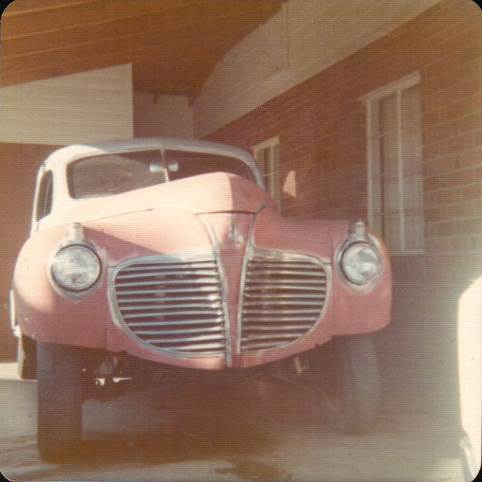

    Here was the start of my '41 back in 1973...found a donor '64 Chevy for the drive train and bucket
    seats, 283" to start. Used a saber saw to cut the fenders to make the tilt front end. All done in the
    carport. Didn't have a lot of money, but lots of vision of what I wanted. Love your Plymouth.

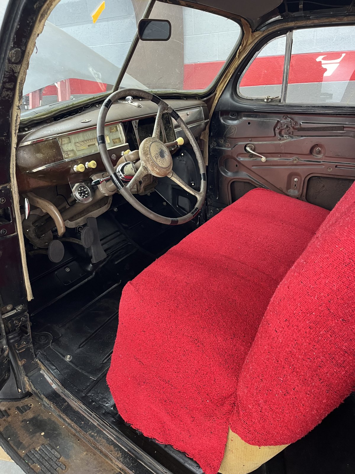

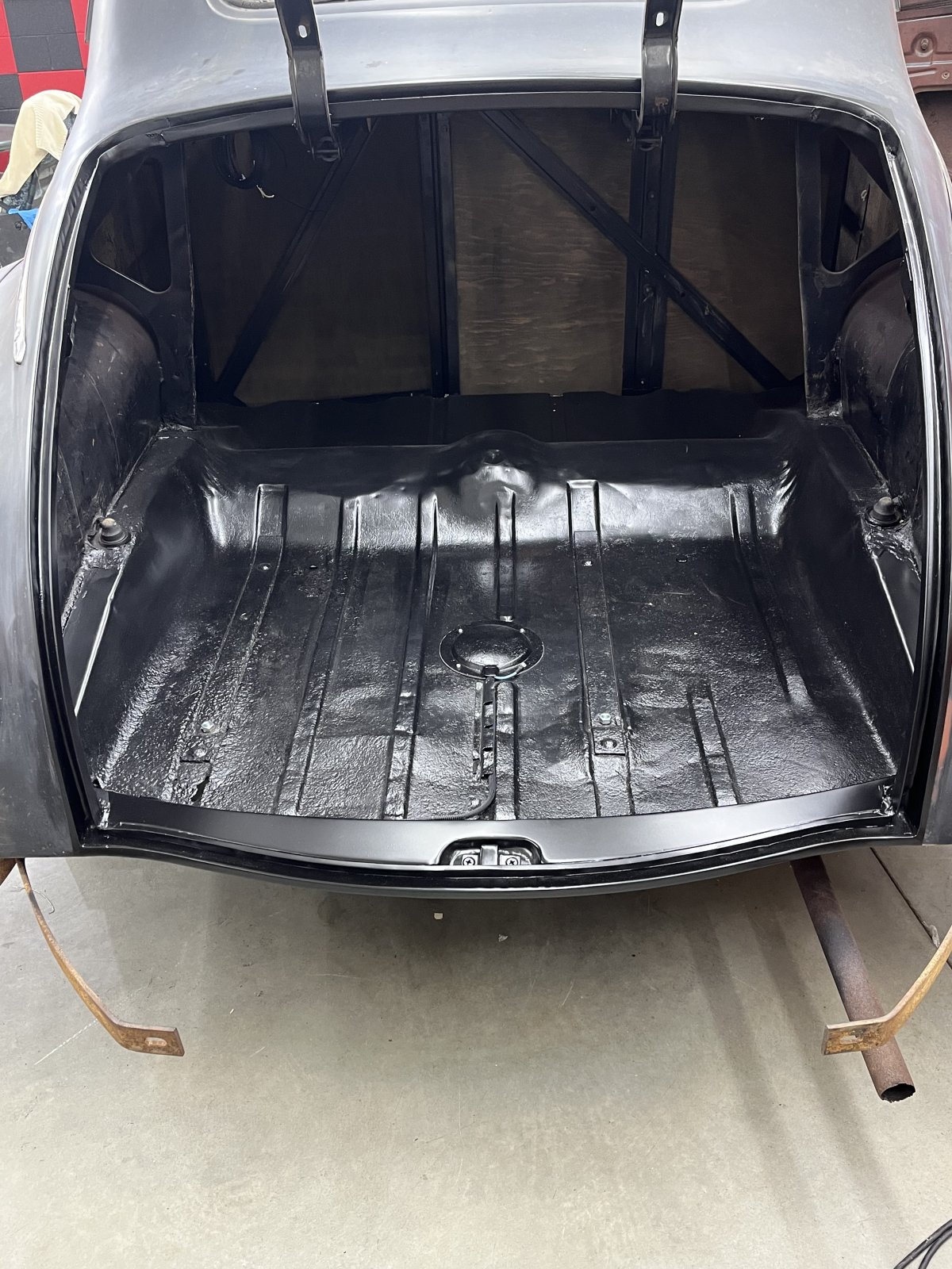

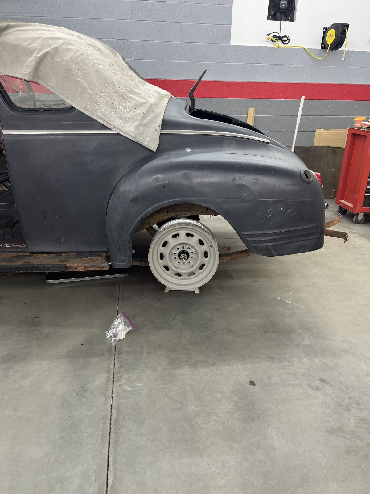

    After I bought this car, I only worked on it part time for a couple months, then spent about a year building a 1,200 sq ft shop. During that time I got the engine running well and repaired the passenger side cowl damage and door fitment.
    I’m back to work on it now and have completely rewired it and added turn signals, replaced all necessary brake parts, put 2” lowering blocks in the rear, painted the floor and trunk pan, new fuel tank, and cleaned up the dash with new knobs and patina sauce, repaired the fuel gage, and made a blanket seat cover.

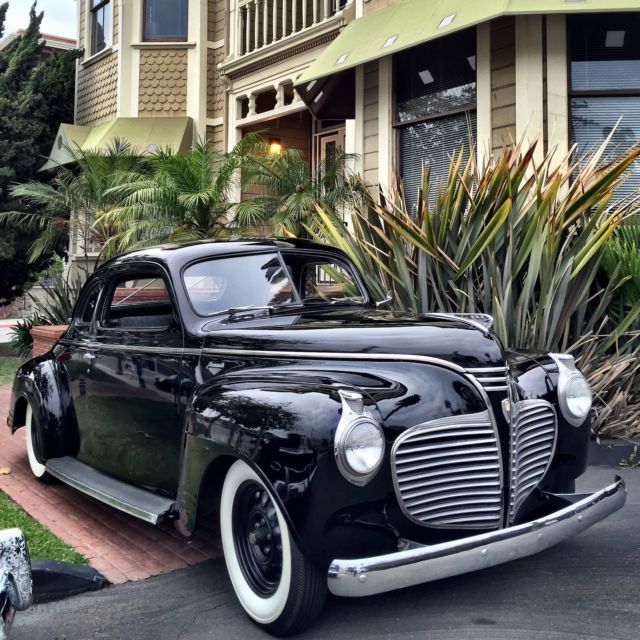

    The car in this photo is my inspiration for the build on my car. Although I’m going to paint mine with satin black rather than gloss black, because I’m painting it in pieces and the satin will be more forgiving. I also have a set of 16” artillery wheels that are a little bit different than the car pictured.
