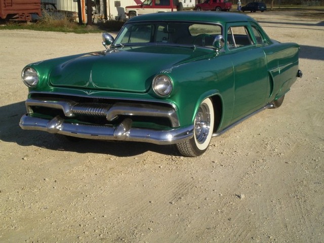

    I am relativley new to the HAMB, but am truly amazed at all the insight and information found here. I am wanting to drop my 54 as low as possible without bags or major front end surgery. Does anyone have any info that would be helpful? I was thinking three inch blocks in the rear, and Aerostar coils up front, any suggestions would be appreciated!! ImageUploadedByH.A.M.B.1371531836.314521.jpg

    Speaking from experience, the Aerostar coils are the way to go. You get a substantial drop and improved handling. Now go join the 52-59 Ford Owners Social Group- over 1100 strong. Lots of great folks and advice. Best of luck to you.

    there are front 2" dropped spindles and 3" dropped leaf springs available. have fun with project. post more pics and details.

    That's what I have in my '52 and I'm real happy with it. Rides nice, no rubbing, sits low enough to look good without causing issues.
    Another thing I did with my car was modify my front bumper brackets to get the bumper to sit about 1 1/2 inches lower. I always felt these cars looked like an old man with his pants pulled too far up from the front with where the bumper sits, mine is a bit closer to the pan now and I'm much happier with it that way. The 54 doesn't show it quite as bad as the 52-53 models did but it's still something to consider.

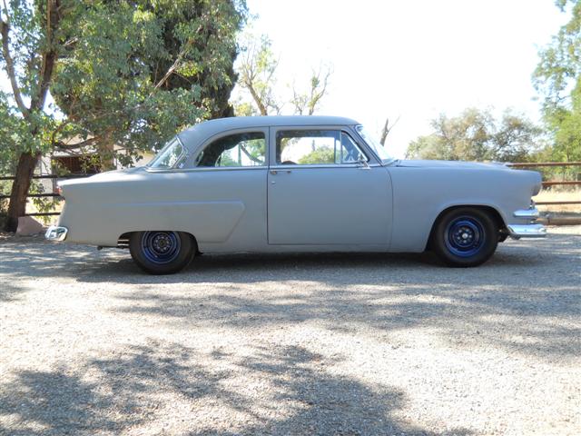

    Good luck man! I miss my '53 Customline (302/C4). Lowered in the front with a bolt-in kit from Butch's and in the back with lowering blocks. ImageUploadedByH.A.M.B.1375139574.816381.jpg
