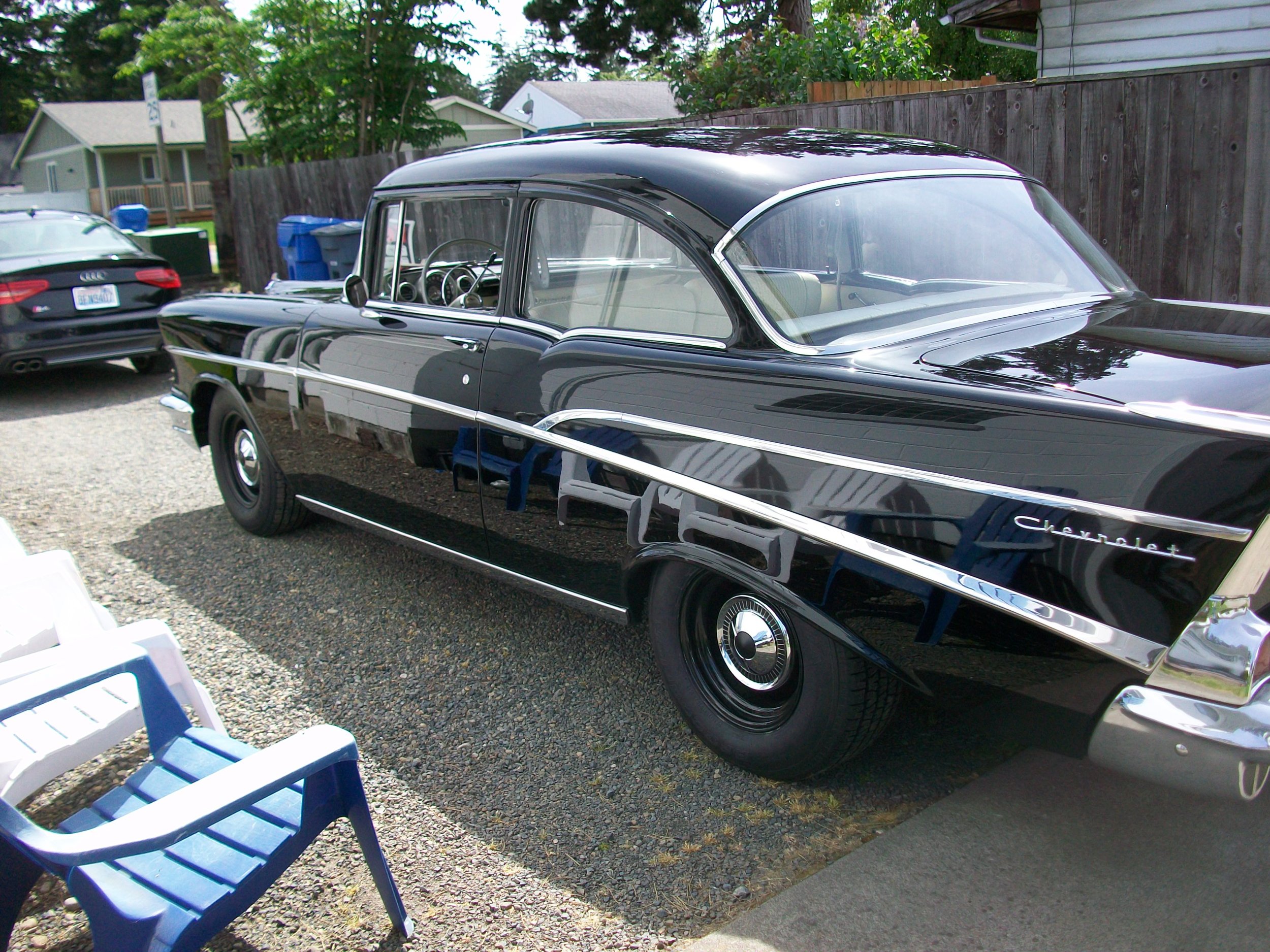

    I just bought a very clean 57 210. Its rust free with a fresh black paint job and stock replacement interior. It has a stock 283, powerglide. The previous owner installed 17 and 18-inch mag wheels and tires.
    I will be going with a 327 and muncie 4 speed but first I need these tires and wheels off the car. I will be going with 15 inch wheels but need help with width and back spacing.
    What have you 57 guys run?

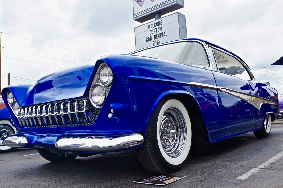

    Not a 57 but a 55 is pretty close. 15x6 with 3 inch backspace and 6.70-15's

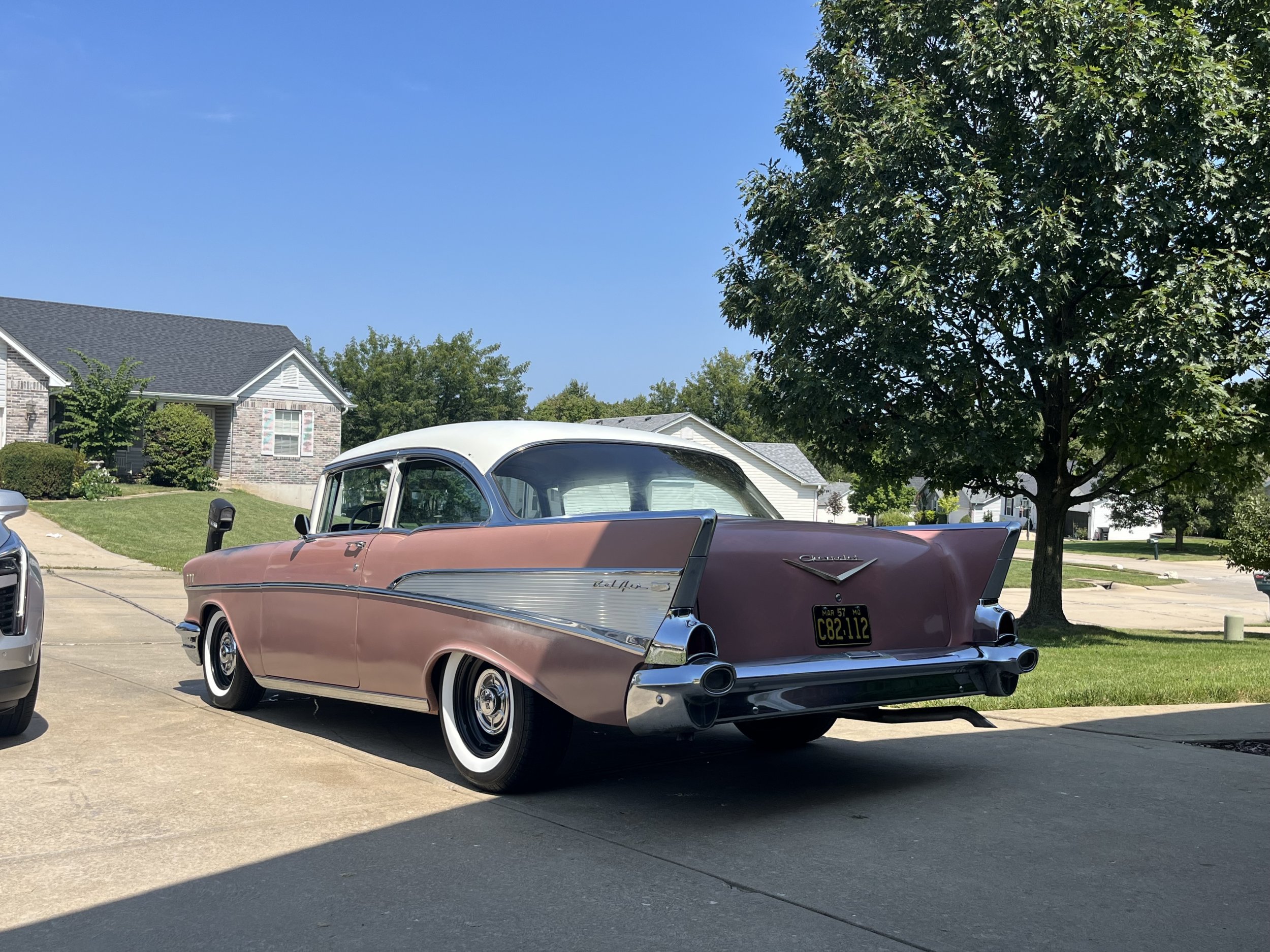

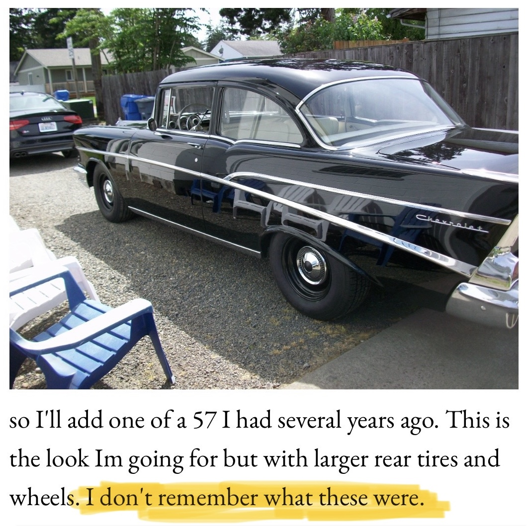

    I'm having trouble loading new pictures, 100_1257.JPG 100_1259.JPG so I'll add one of a 57 I had several years ago. This is the look Im going for but with larger rear tires and wheels. I don't remember what these were.

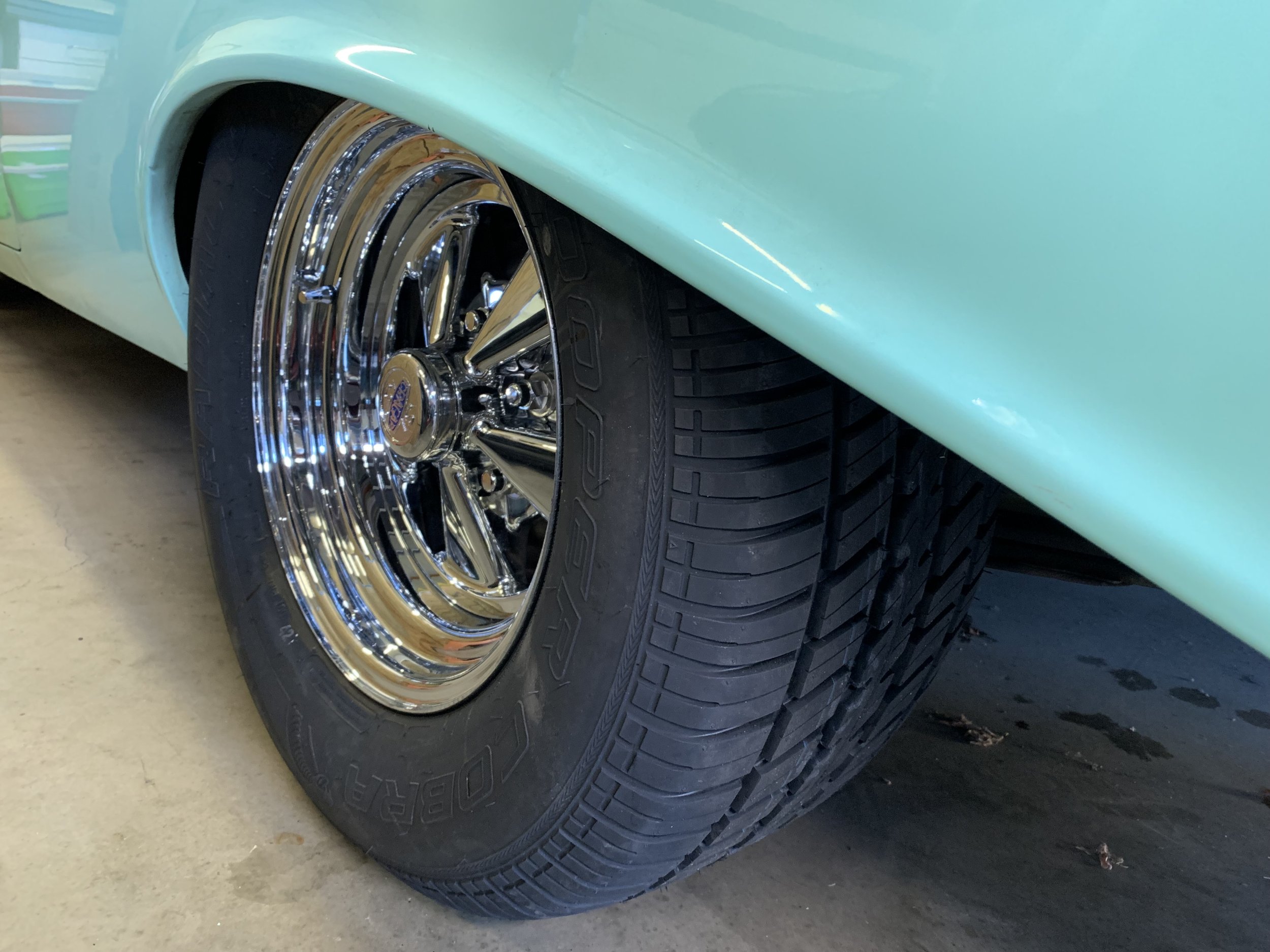

    If I’m being paged about 15 8’s, yes they’ll fit. 4 1/2” back space is the ticket. These only come close in 4 1/4” & 4 3/4” back space. So a 1/4” solid style wheel spacer and the 4 3/4” back space got them in with a 275/60/15. (Note, stock rear end) IMG_3314.jpeg IMG_3315.jpeg

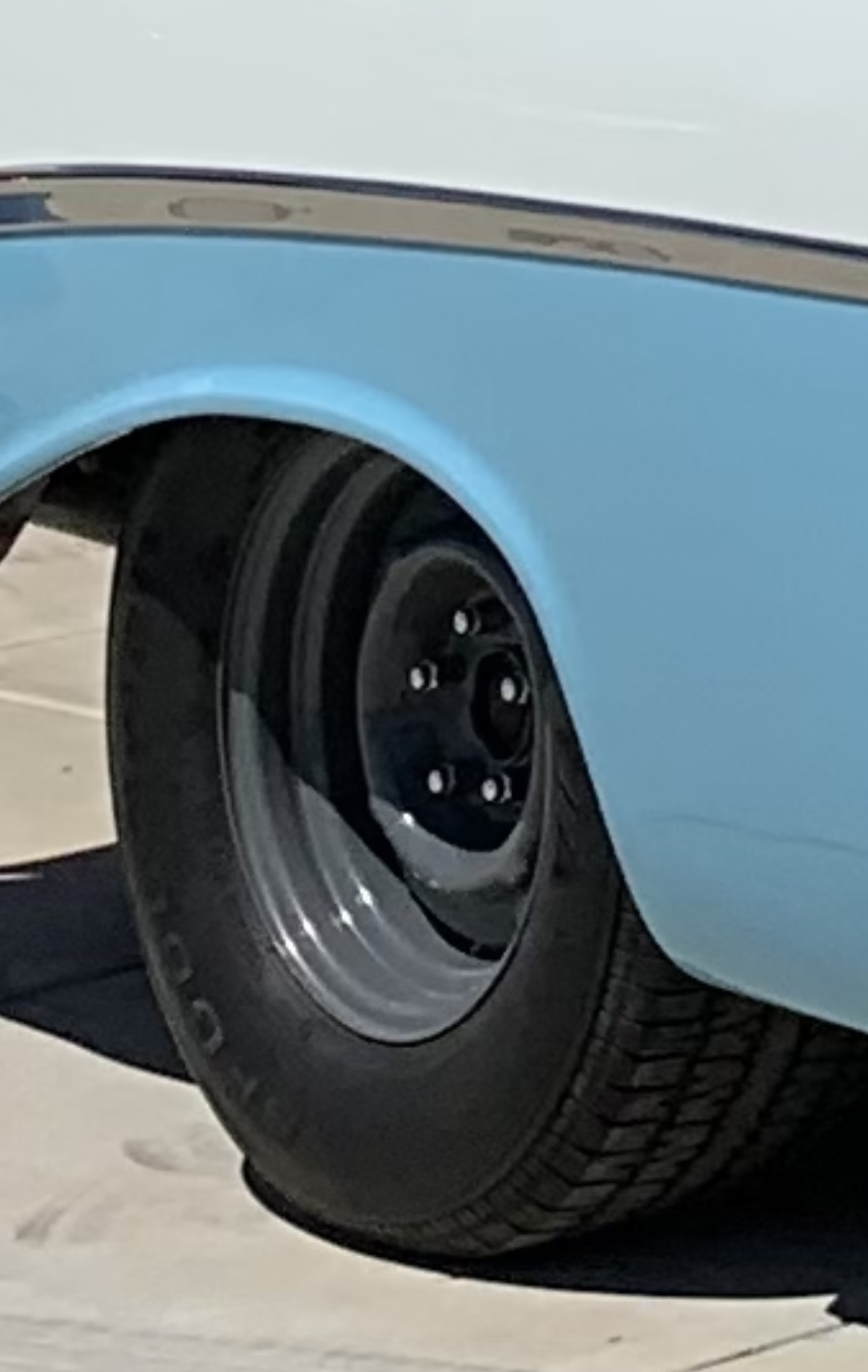

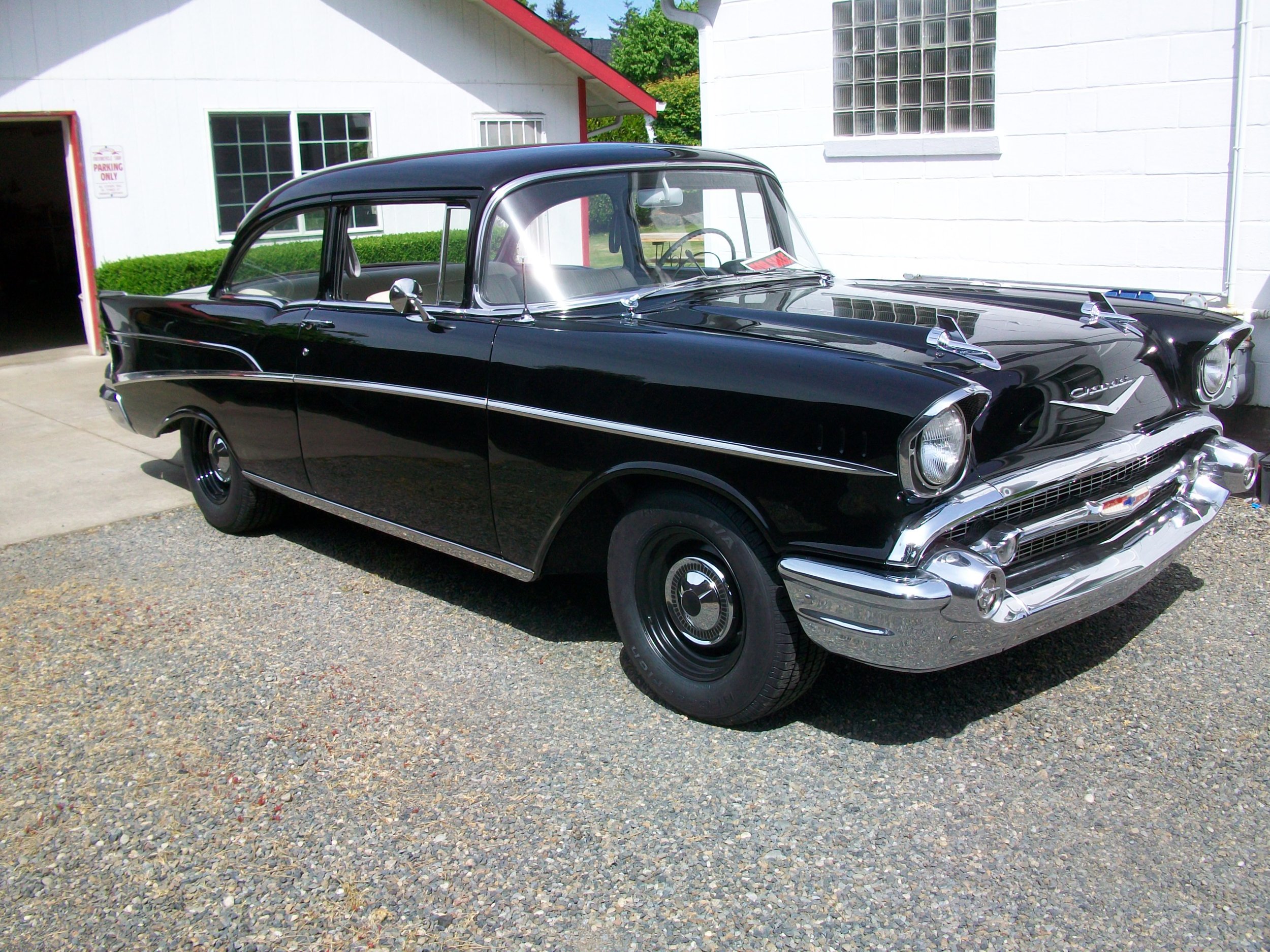

    Fronts - 15x5 wheels on 205/75 tires
    Rears - 15x7 wheels on 235/70 tires.
    Don’t laugh at my low hanging p***enger tailpipe. Hanger has been replaced since photo was taken.

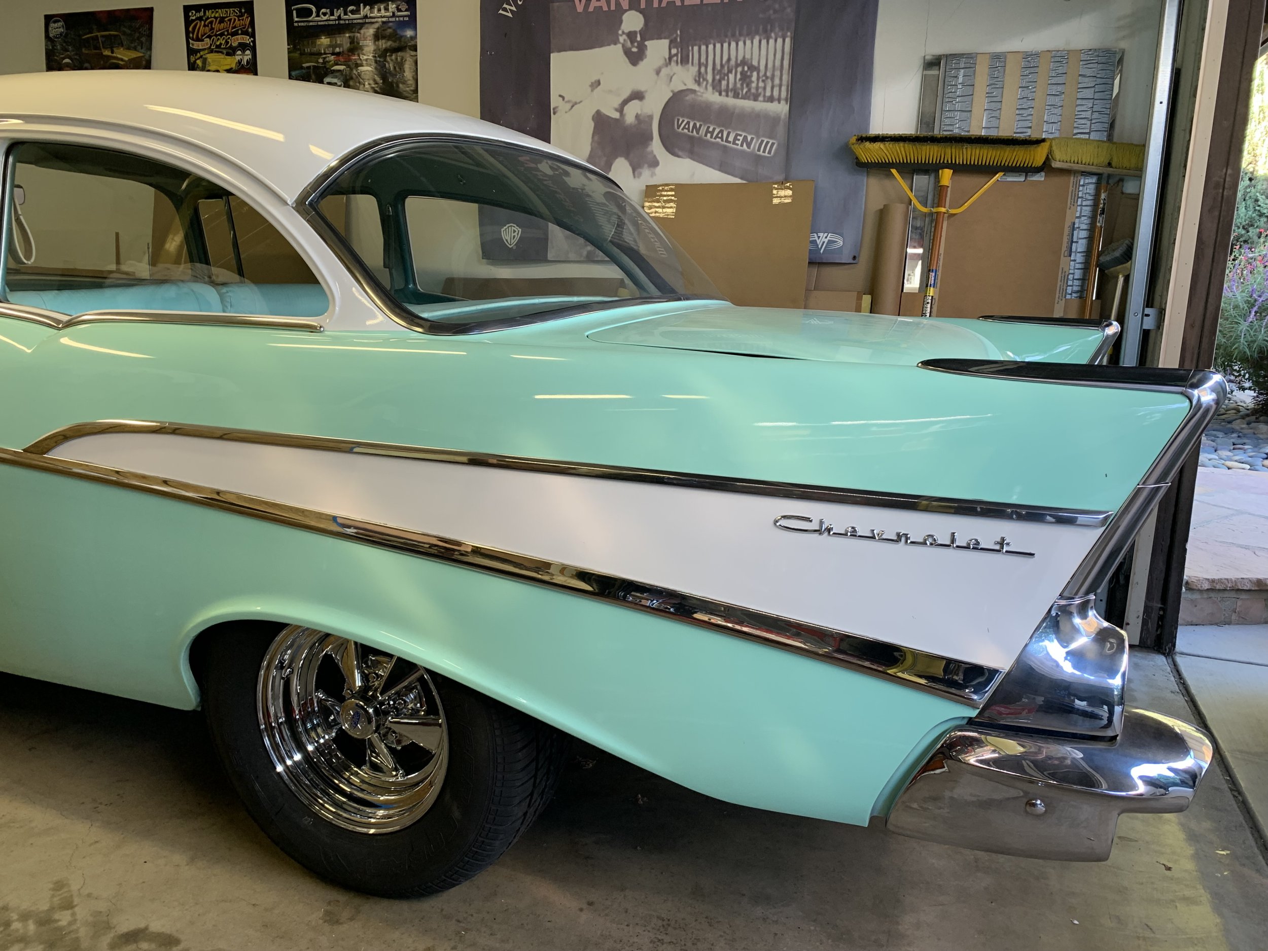

    ^^^^^ Those rears scream stock Chevy 15 7’s with 255/70/15’s.
    That’s what’s on the back of the avatar 56. Clearance is great. On and off easy. IMG_3436.jpeg IMG_3437.jpeg

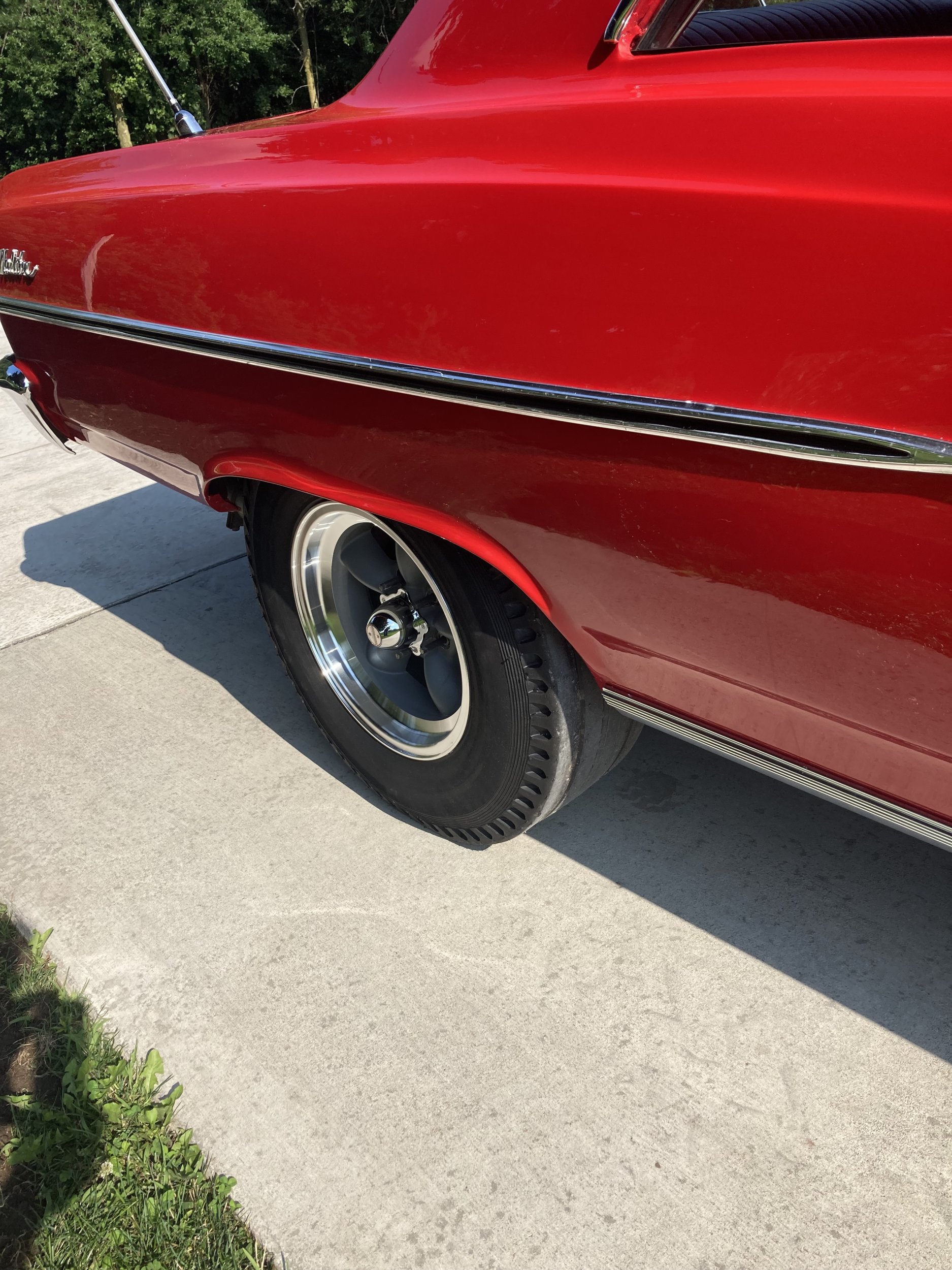

    I'm running magnesium Americans - 15x6" with 2.5" backspacing all around. I rolled the rear lips for extra clearance, and haven't had any contact all around.
