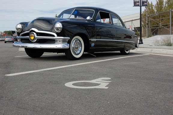

    Oh man, that is sweet - keep the pictures coming.

    BLUDICE, I love your shoebox. Clean and simple looking. How did you do the light in the center? I am on the volunteer fire department here where I live and would love to do a light in the center but a strobe/red one to run calls hehe... If I remember correctly the old police cars in the day had this...???

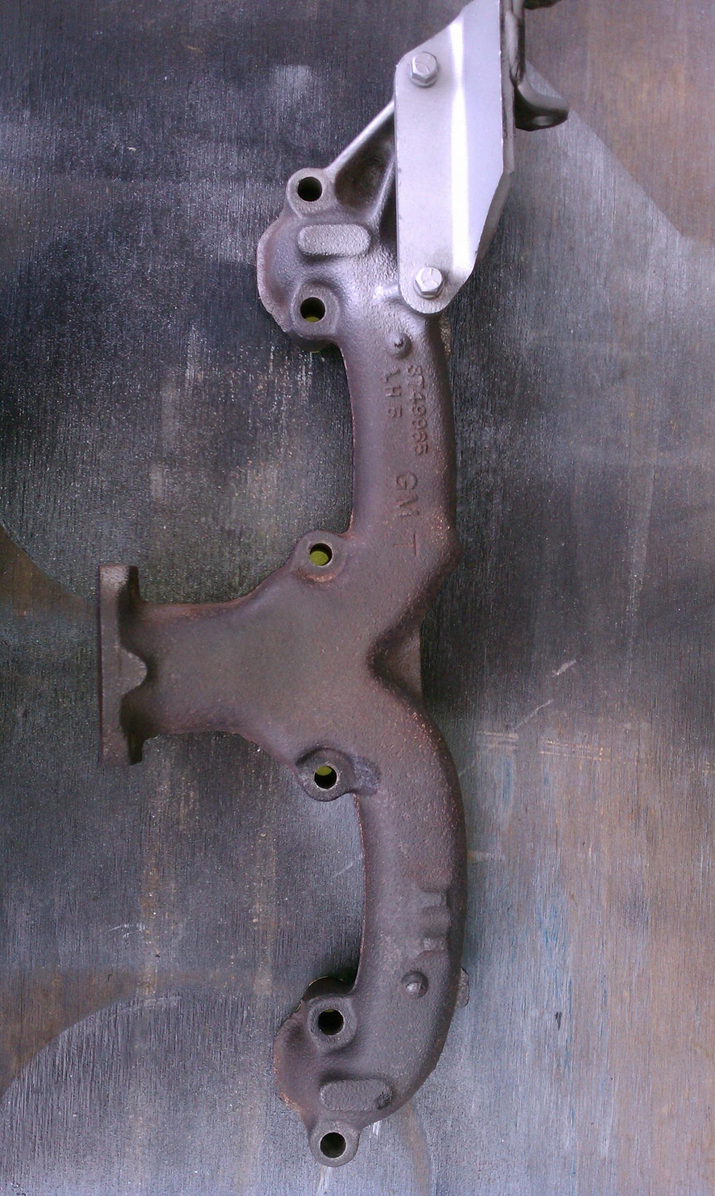

    Update!... Well I finally got my 49 further along than the last time I posted and hope to have it wrapped up and somewhat drivable within 3 weeks. I got a buddy to fabricate a transmission tunnel to accommodate the bigger 200-4R OD trans unit I put in it. He did an amazing job and will post pictures tomorrow. Also had to take the original trans cross member, cut it and completely box in the correct mount and location (took lots of time but it's done and beefy as hell). Got the transmission in today, removed the dummy block/engine and put my motor in. I decided to go with stock ram horn exhaust manifolds. I blasted them and painted them with header paint (cast aluminum). I know people have issues with an MII front end, SBC and exhaust on these cars but mine is different. First off I do not have a crossmember MII kit, mine is an entire front subframe and the very first one Fat Man ever did. The engine mounts also move the engine forward and higher a little bit for HEI clearance, exhaust, etc. This still gives me enough room for flanges, exhaust, etc. I have access to transmission bolts, distributor and everything front the top of the engine so this thing will be easy to work on when needed.
    I am still stuck on what size exhaust to go with. I most likely will do 2" since I plan to run lake pipes (which I now have) with baffles to quite it down some.
