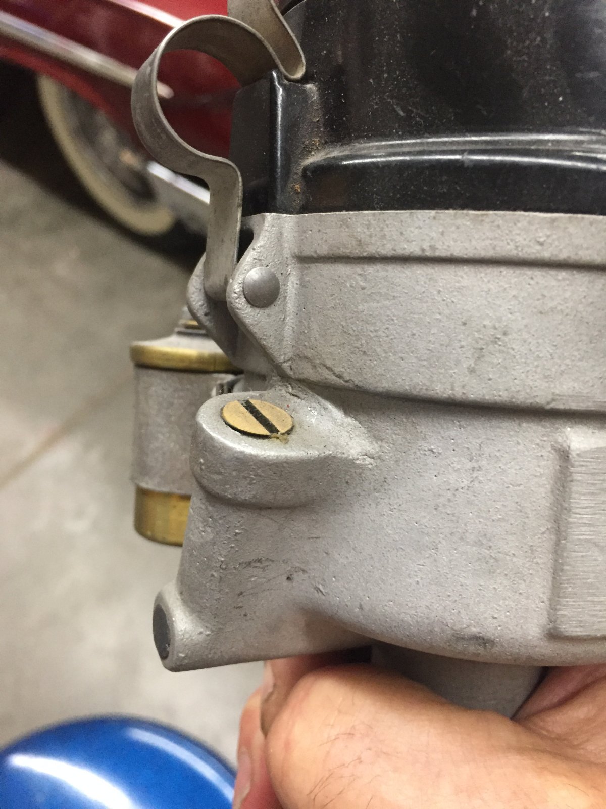

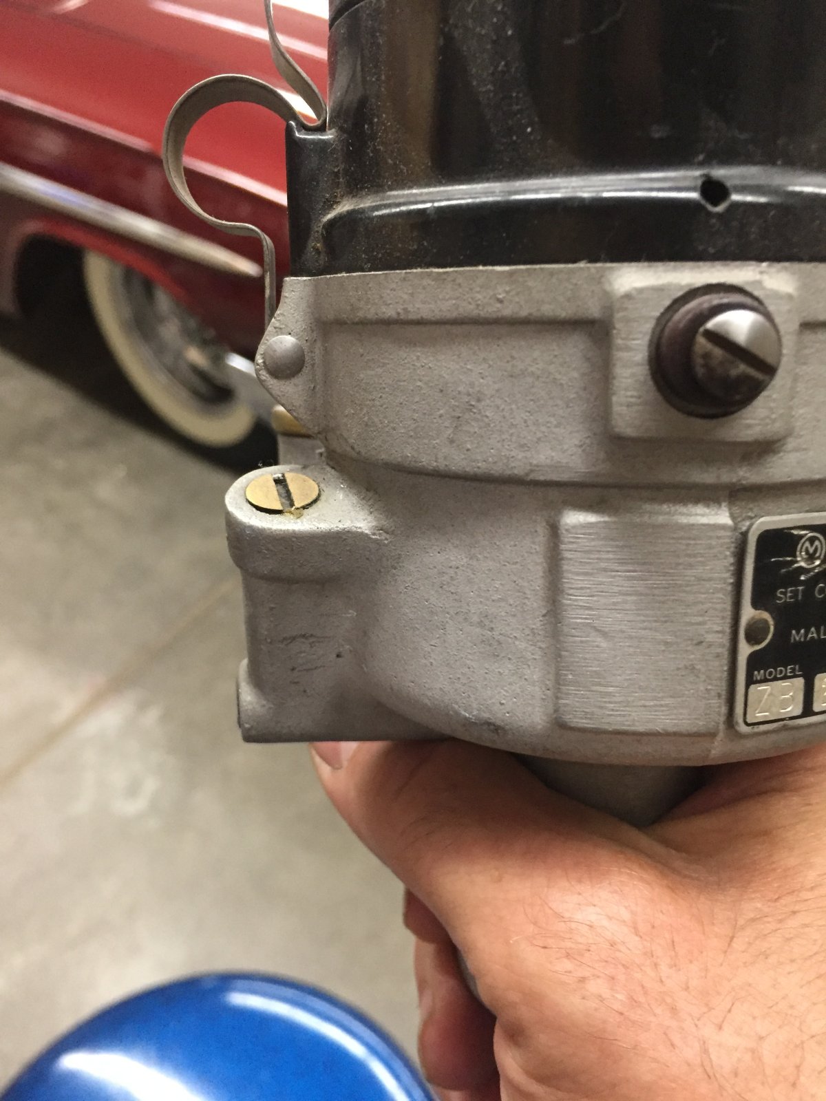

    Does yours have a screw like this one or an oil pot or one of those spring loaded ball things. This is for oiling the bushing. I oil the one on my 40 every time I change the motor oil

    I’ll be darn, I’ve never noticed that screw plug before, but never had an AM distributor, I ***ume aftermarket? My ‘59 Chevy 235 had a flip up cap like a generator does. Think that’s the only distributor I had that could take oil like that.

    i have a screw like that, never knew thats what that was for. How do you oil yours? just a couple drops of 80/90 or what?
