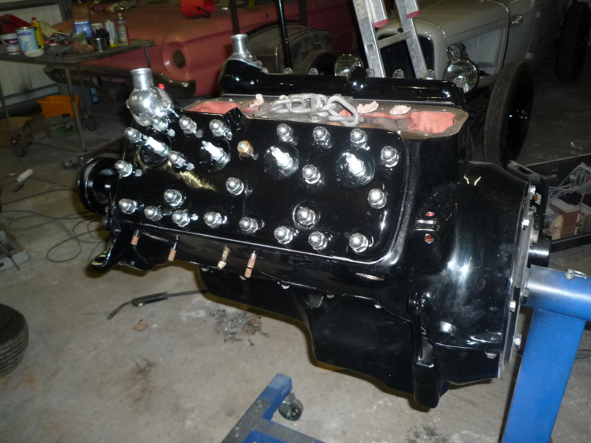

My new military french flathead will be converted to a Hot Rod engine

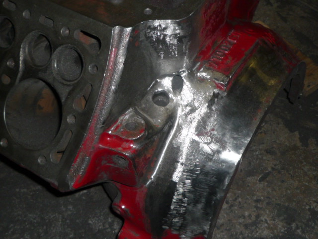

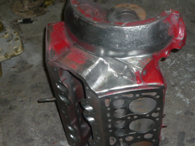

    I'm using a french block to put an Ardun together. I'm having some problems. I'm to the point of removing the big m*** of material on the back of the block. What type of plug did you use to plug the holes? Was the block easy to tap or did you just press in a plug? Thanks Erick.

    I,m also thinking about the relif? The holes are easy, I did just use a oversize plug and press it in

    The block looks the same as a ford with a little bit of relief. We decided the easist way to do this was to surface the relief off. Now I have to have pistions made. I feel it is better then welding up the block. Preheating the block to weld just scares me.

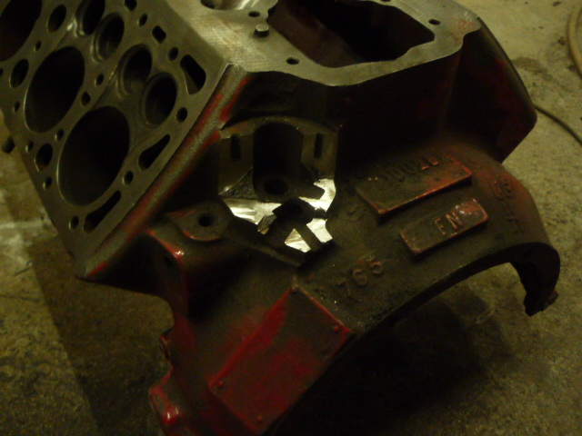

    i got a question to all of you and i think i know the answer :( .
    The cracks in the two pictures are the end of a flathead (even a french), aren´t they?

    They can be repaired. Lock-n-s***ch pins are the preferred method.
