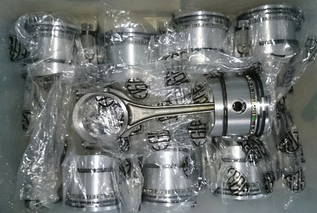

  13. With the information given by you good folks, I was able to make my piston sets today. Even got the rings on each piston. Little bit scary putting rings on, but didnt brake any or damage piston walls. I had expected would have to file the rings, but they did not need it. In fact most were a couple of thou over ideal. I.E: Wanted 12-13 thou, got 15-16 thou on some. Should I be worried?
    I found the oil hole on con rods, that Ronnie spoke of. When viewing engine from behind (as if facing forward), pistons 1-4 have the hole facing front of engine, pistons 5-8 have the hole facing rear of the engine. The little arrow on each piston top faces front of engine, regardless of cylinder number.
    Am trying to upload some photos. No luck yet!
    Thanks again, guys!
    My new sets of pistons & rods.
    Yay, I worked out how to post a photo.

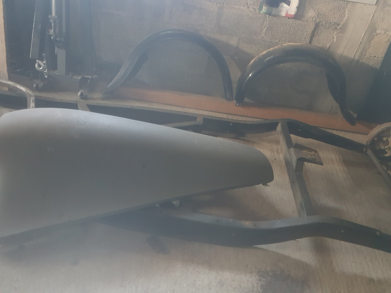

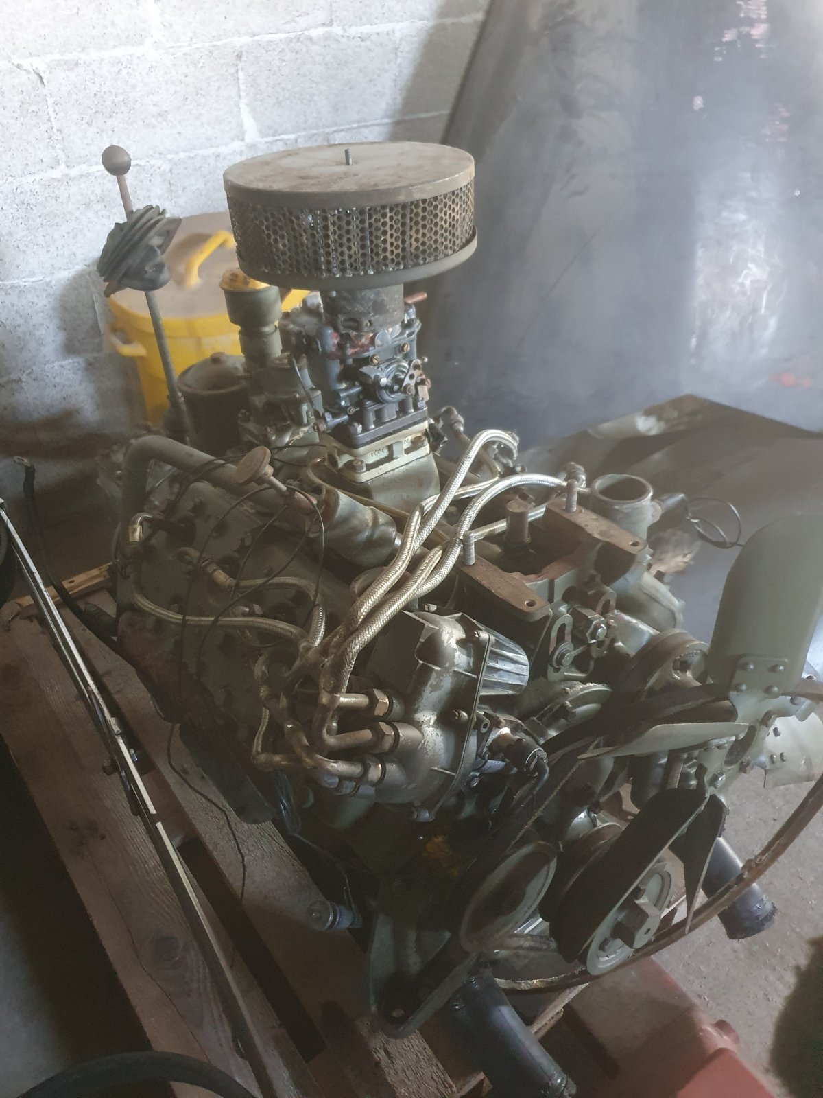

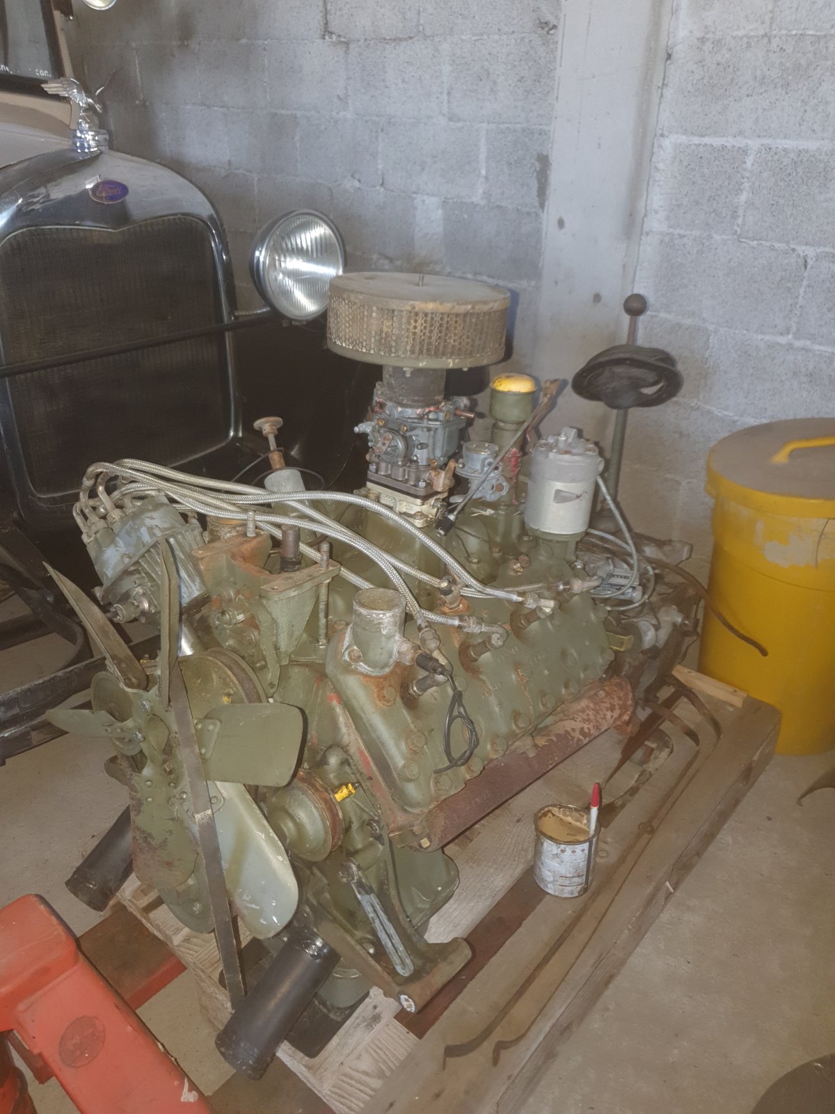

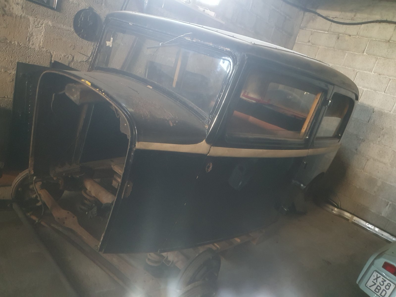

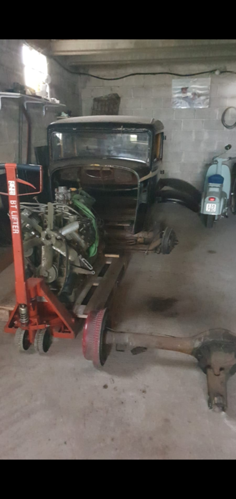

  22. Braits
    Joined: Mar 26, 2023
    Posts: 2
    Braits
    Hello friends!
    Thanks for your answers.
    I'm from Venice!
    Thanks for your advice, thi is a very long project. I can wait for run , for the moment I need to find the parts that must necessarily be replaced, if, as you wrote, you have some pieces that can really help me, we could have the deal. I think that unfortunately, looking for adaptable parts in Italy is useless, even if something from Simca can be found. I saw that you have to work on the back to adapt it on the firewall. That s ab hard work! I try to upload some photos of the car and the engine. it is a 1932 European. I think it was made in Cologne, Germany. but he lived most of his life inside the automobile museum in Slovenia. until they have it dismantled. thanks again.. if you have any parts to sell, tell me how to buy!
    Sorry for the q 20230327_124655.jpg 20230327_124648.jpg 20230327_124644.jpg 20230327_124637.jpg 20230327_124455.jpg 20230327_124630.jpg 20230327_124451.jpg 20230327_124443.jpg 20230327_124437.jpg uality
