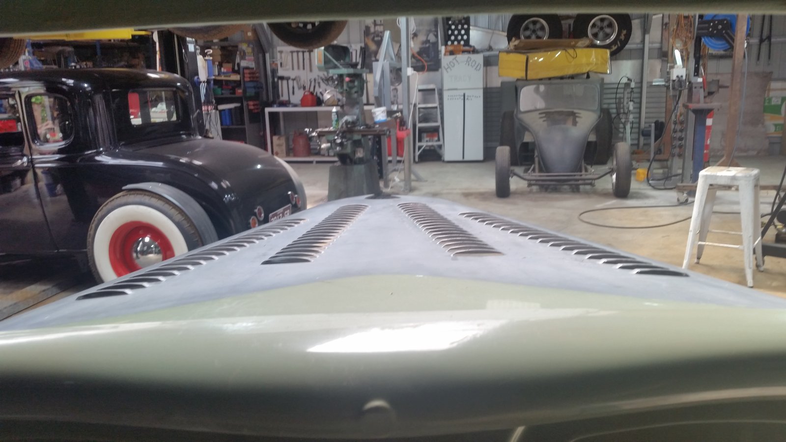

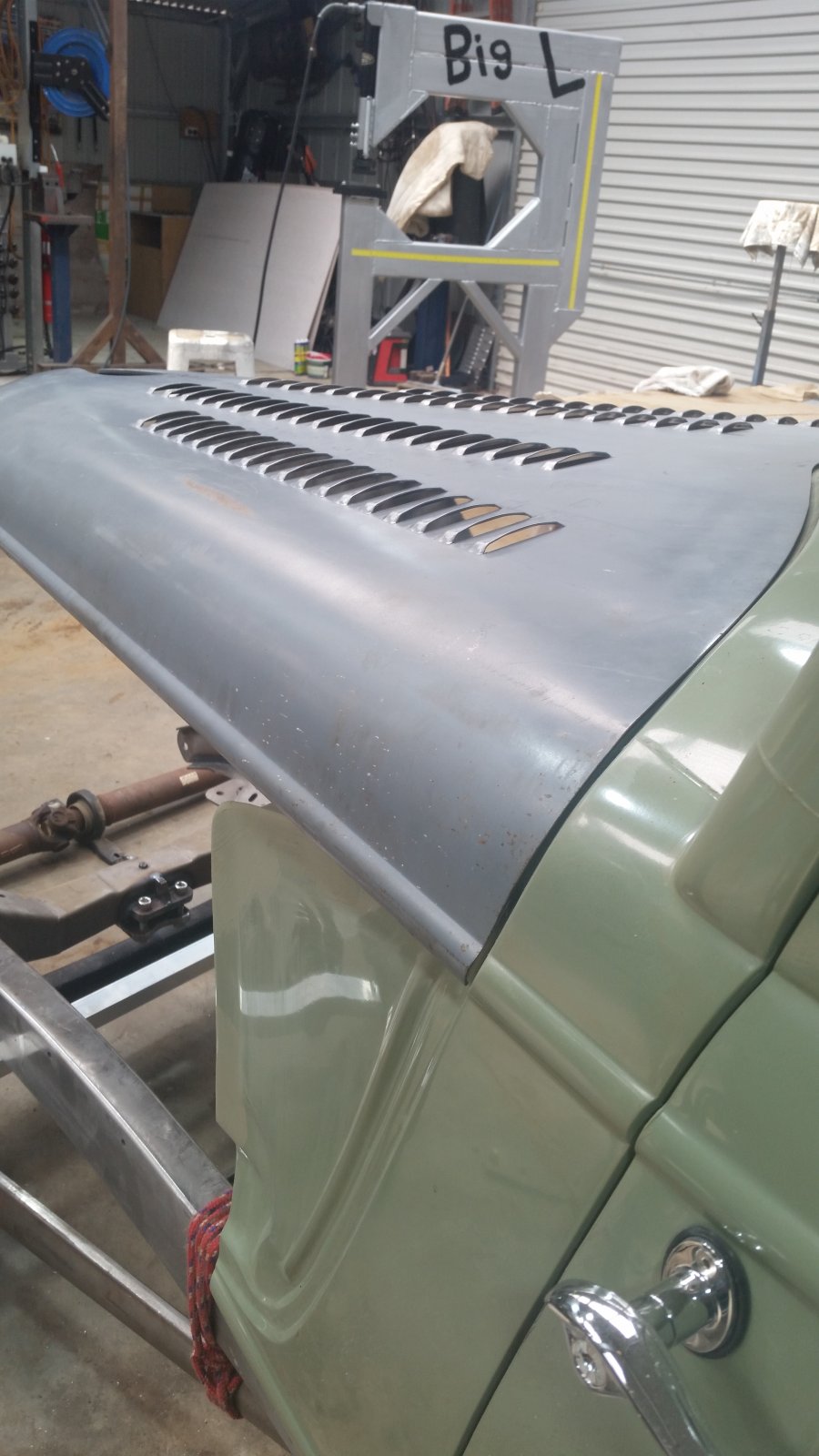

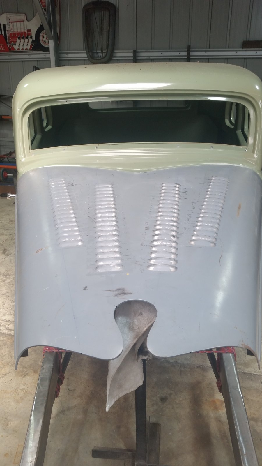

    I recently purchased a rootlieb one piece 34 bonnet from a local hotrodder, plan is to punch it full of louvers using Big L. Today I mocked up several designs and will probably go with two rows per side as in last mock up pic, with angled louvers, I punched several angled louvers 14 degree, 12 degree and 8 degree, will probable use 12 degree angle, a few pics. Glen 20221120_171355.jpg 20221121_134148.jpg 20221121_134959.jpg 20221121_142452.jpg 20221121_135407.jpg 20221121_163407.jpg 20221121_162802.jpg 20221121_182713.jpg

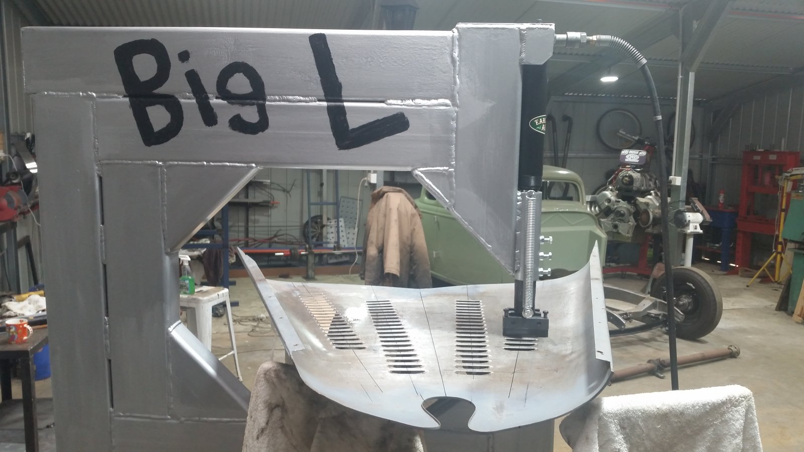

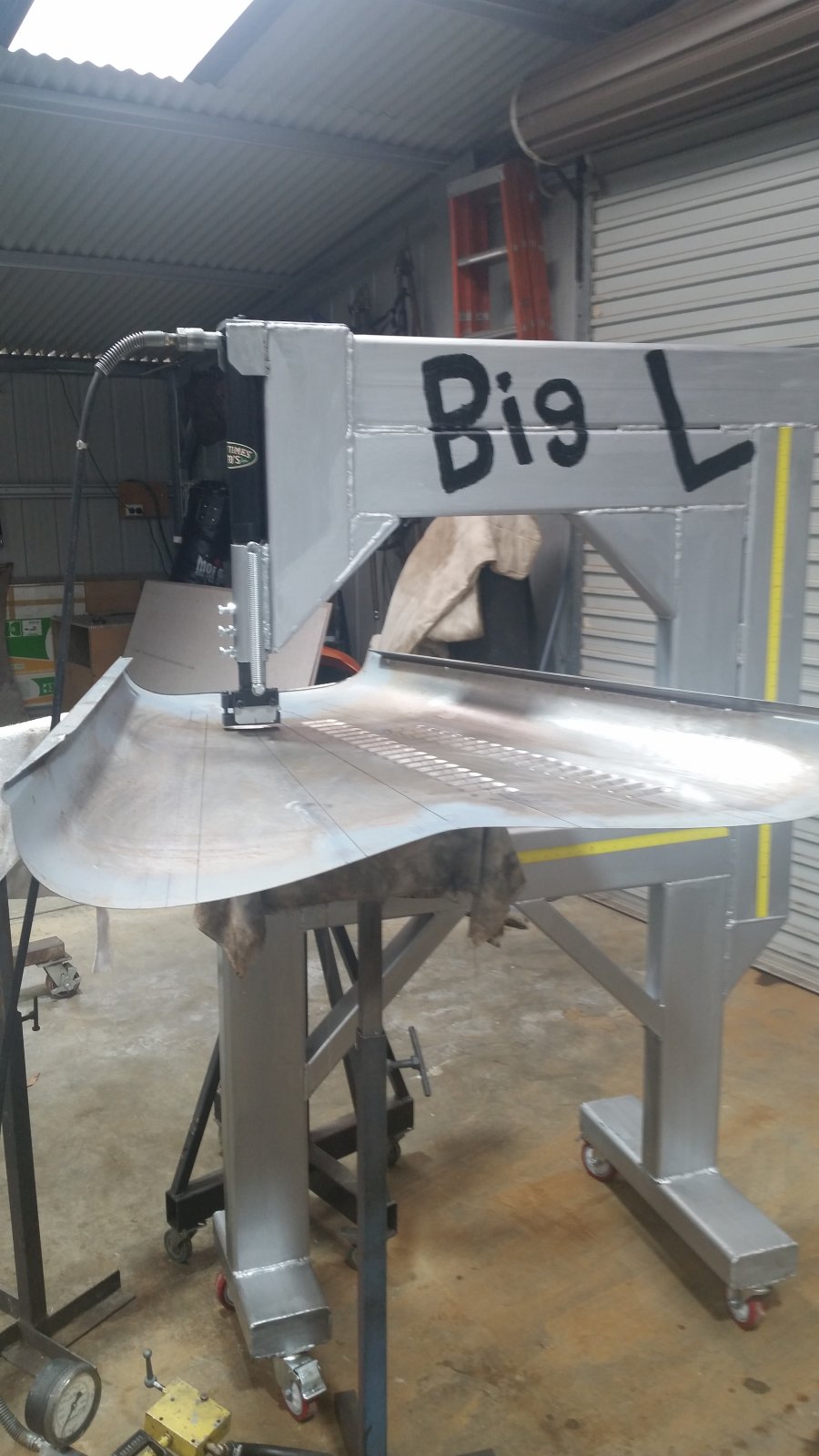

    Punched 74 louvres into bonnet today, by myself, Big L performed awesome. A few pics. Glen 20221122_123621.jpg 20221122_130833.jpg 20221122_141740.jpg 20221122_142158.jpg 20221122_142530.jpg

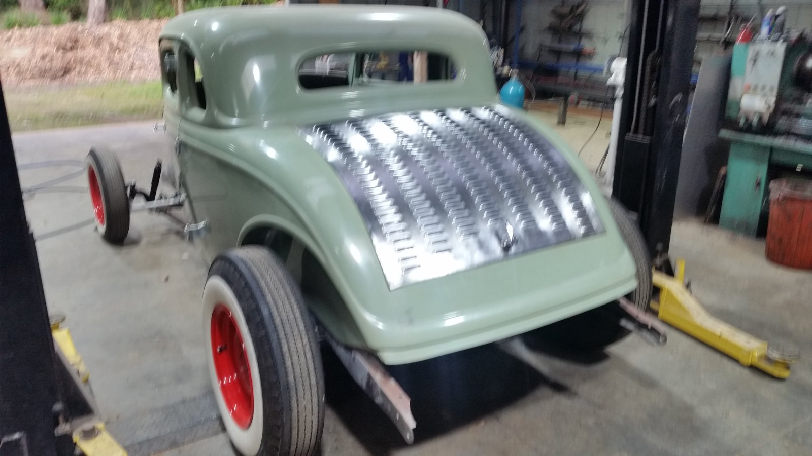

    Sorry guys, I'm not the shinny paint type, although I like shinny cars, just not mine. I don't like washing cars and like the used / dirty look. Not neglected or rat rod look, just a car that's driven. I want this car to look like its been dragged out of a barn. Anyway lately I've been working nights so only working about an hour a day on my trunk lid, got it hinged and the handle mocked up. Just need to finish weld and tweak all gaps before fabing the louvered skin. A few pics. Glen 20230907_175131.jpg 20230907_175152.jpg 20230907_175158.jpg 20230907_175210.jpg

    Started fabricating deck lid skin recently, used the brake to fold the edges then the shrinker to form the shape. 1st go was unsuccessful and was s****ed, I needed to remove the two inner bars in order for skin to sit properly, still lots of tweaking and fine tuning to get it right but I'm happy with the gaps and how its looking so far. Tomorrow I will punch some louvers, finish weld frame and hopefully tack weld skin on. A few pics, Glen 20230911_171554.jpg 20230911_165630.jpg 20230911_165550.jpg 20230911_165518.jpg

    Thanks Outback, maybe we will catch up some day, I'm near Pakenham Vic, where are you located. A few pics of todays progress, punched 152 louvers into my decklid , Big l performed faultlessly again, happy with results so far, still need to tweak lid sort out gaps and weld to frame. Only issue from today is I found out trunk lid opening was not perfect, the right side is 1/4 inch shorter, I only noticed on the very last louver - noticeable in pics. Lucky this car will be patina and not pretty so its not a major issue. Glen 20230912_121731.jpg 20230912_145106.jpg 20230912_175045.jpg 20230912_175032.jpg 20230912_175038.jpg 20230912_181515.jpg
