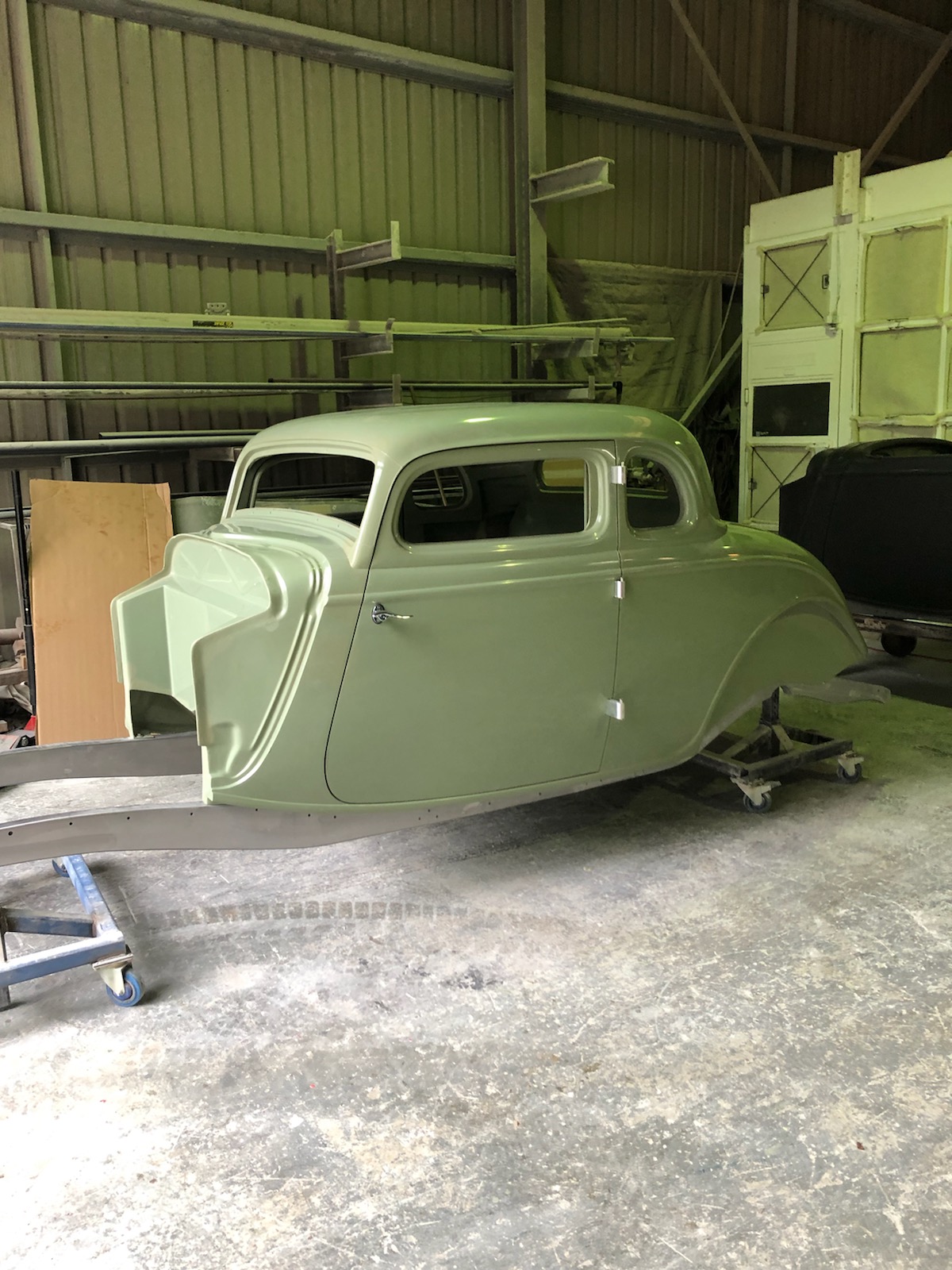

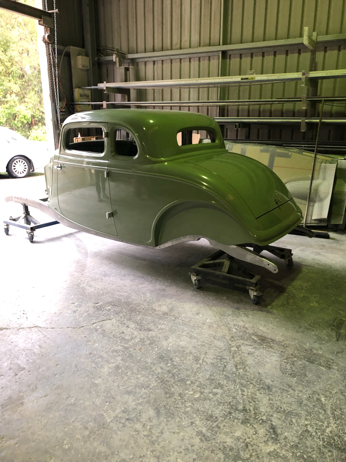

    I recently took the body of the ch***is, only took a couple of hours to fab up a wooden trolly and lift body off. First job is to modify front cross member to achieve a 30mm / 1 1/4 inch lower stance then I plan to set up front suspension before tackling the rear end.. A few pics. Glen 20240622_145324[2].jpg 20240622_150203[1].jpg 20240622_151328[1].jpg 20240622_170104[1].jpg
