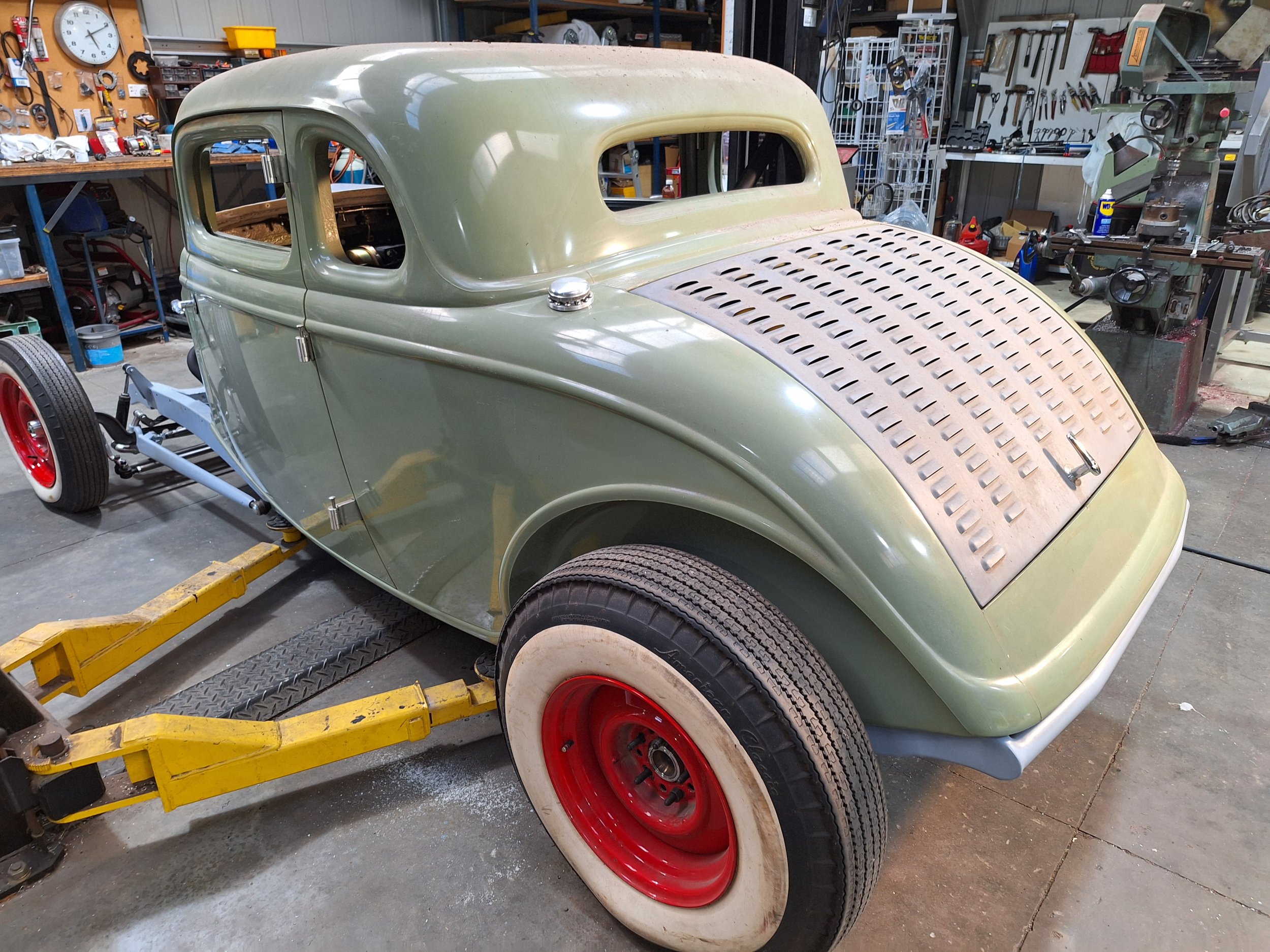

    Finished and painted exhaust recently, so happy with how its turned out. Started on fuel tank today, decided to go with aluminum, a few pics, Glen 20251002_110517.jpg 20251002_110353.jpg 20251002_110344.jpg 20251002_132959.jpg 20251002_134641.jpg 20251002_155529.jpg 20251002_155801.jpg 20251002_155810.jpg

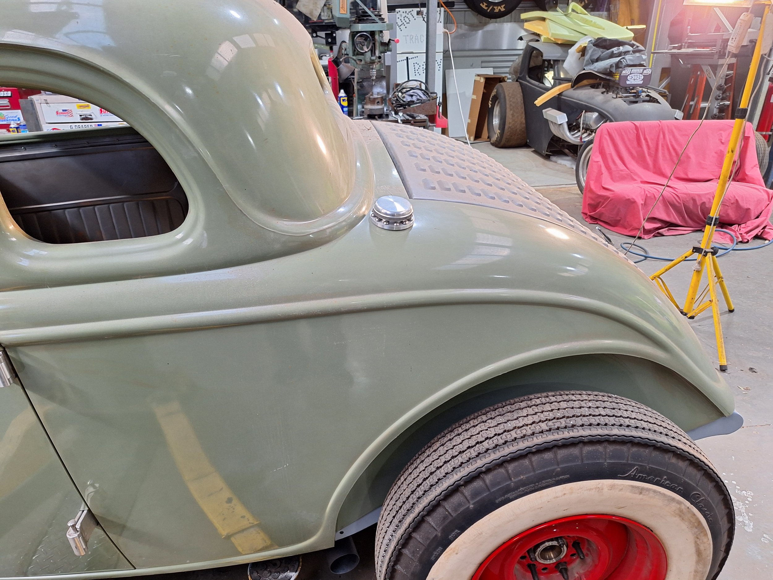

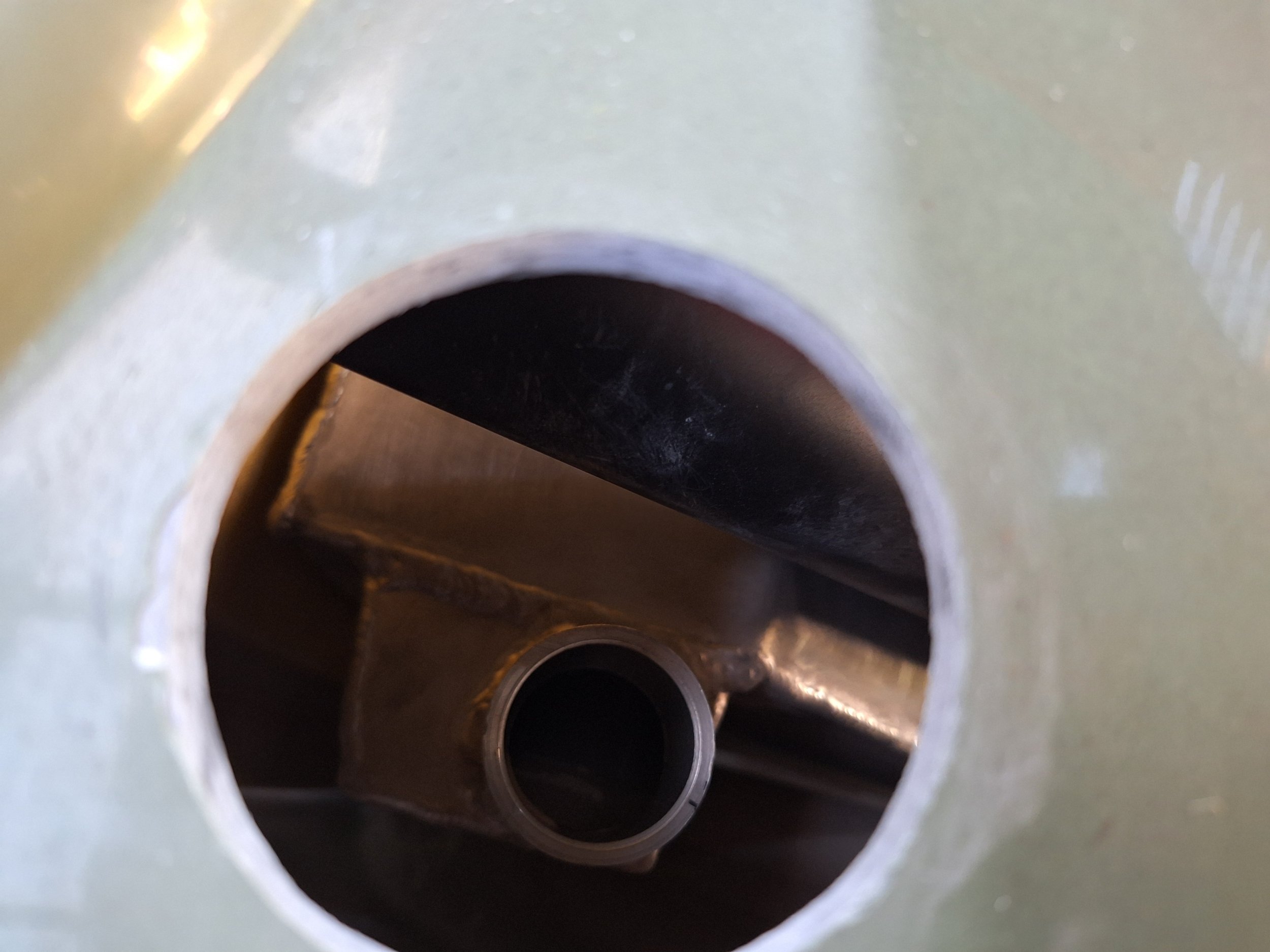

    Fuel tank is still a work in progress, I ended up buying a new tig welder as my old unit had seen better days. They did not have a suitable foot pedal in stock so I needed to order one, when I receive the pedal I will start welding the tank, most of the tank is fabricated and just needs to be stuck together. While waiting for my pedal to arrive I fabbed up a cover for my rear crossmember, I also mounted my modified fuel cap, a few pics Glen 20251012_133843.jpg 20251013_122219.jpg 20251013_164000.jpg 20251011_170906.jpg 20251011_170913.jpg

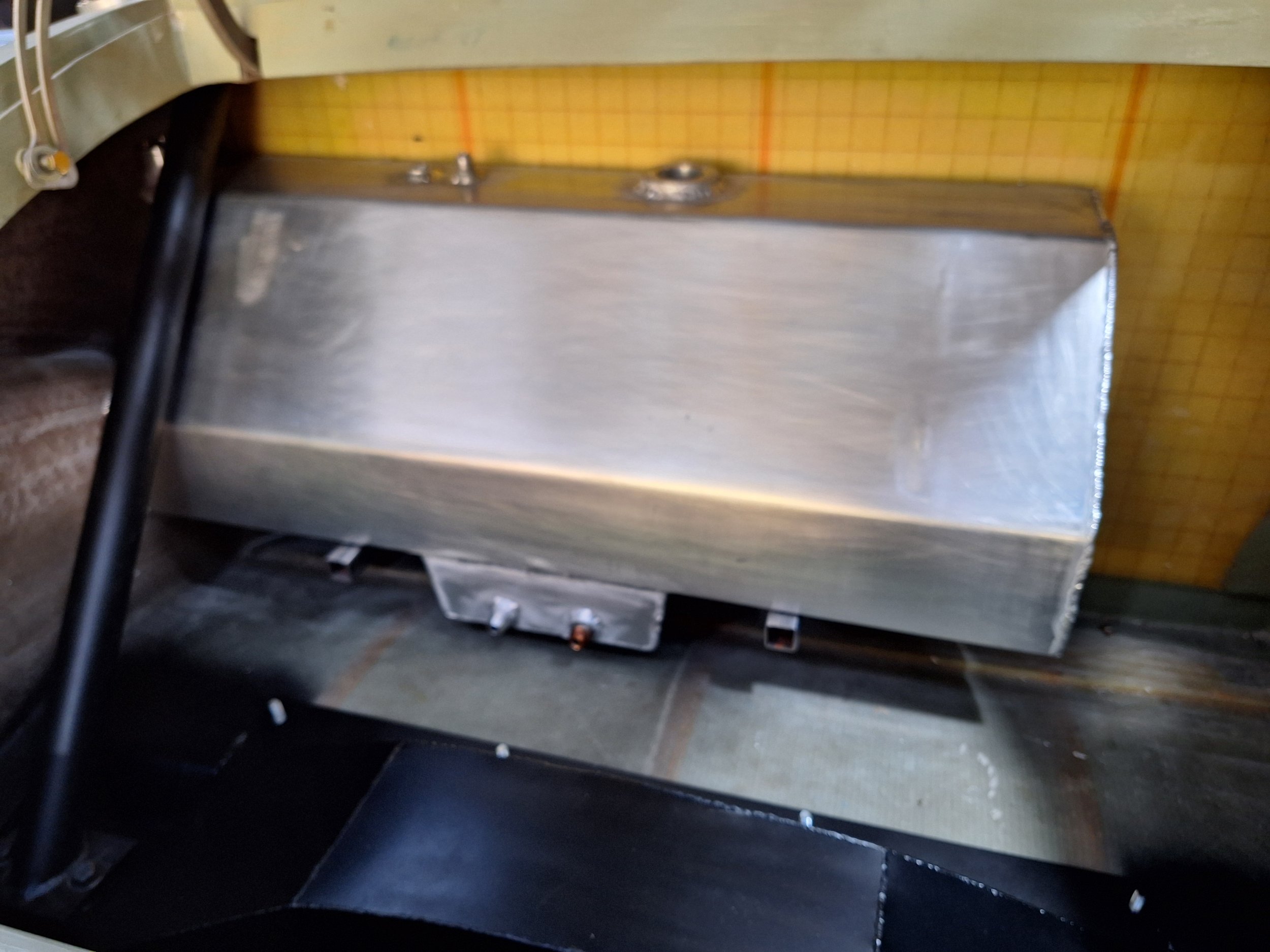

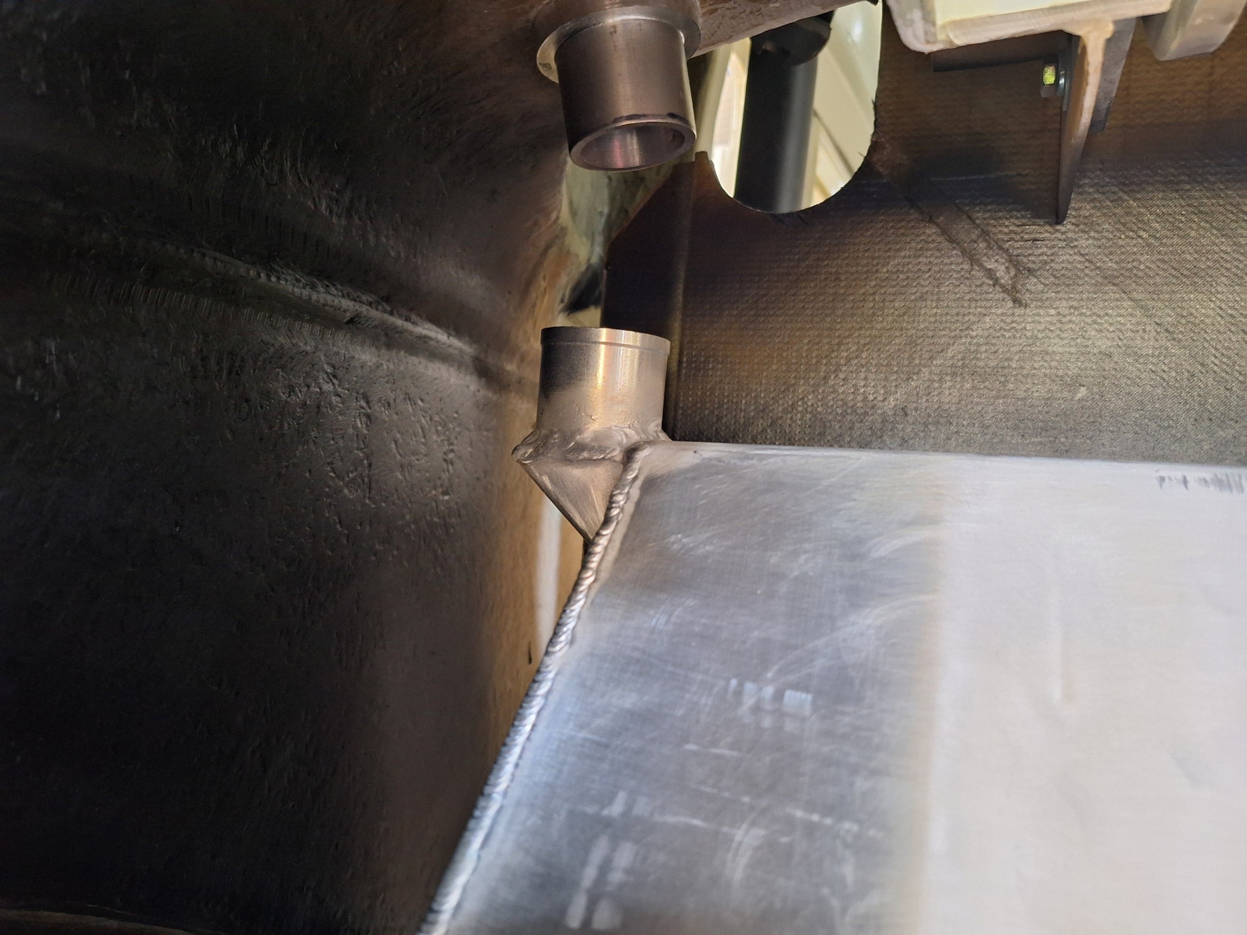

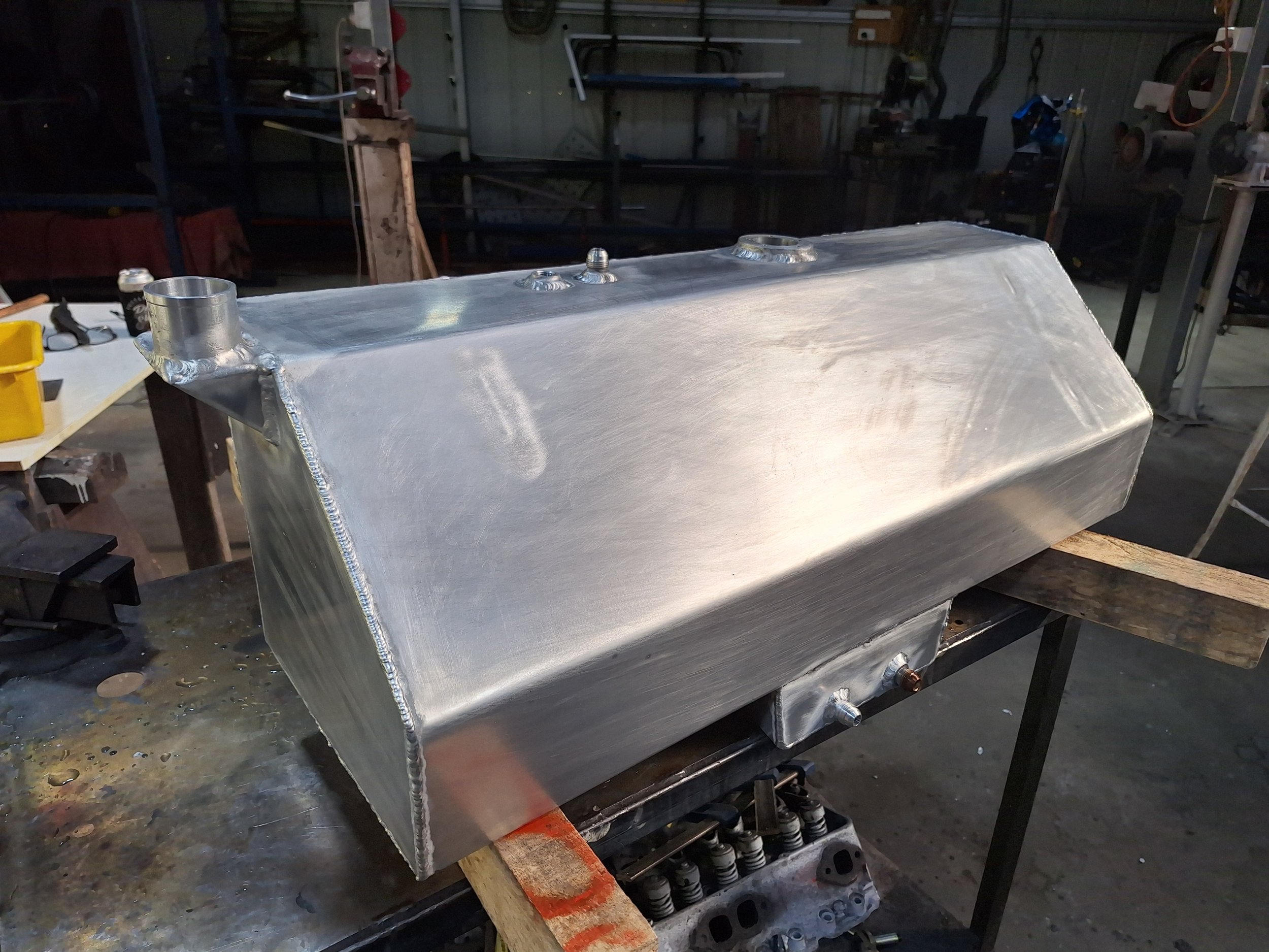

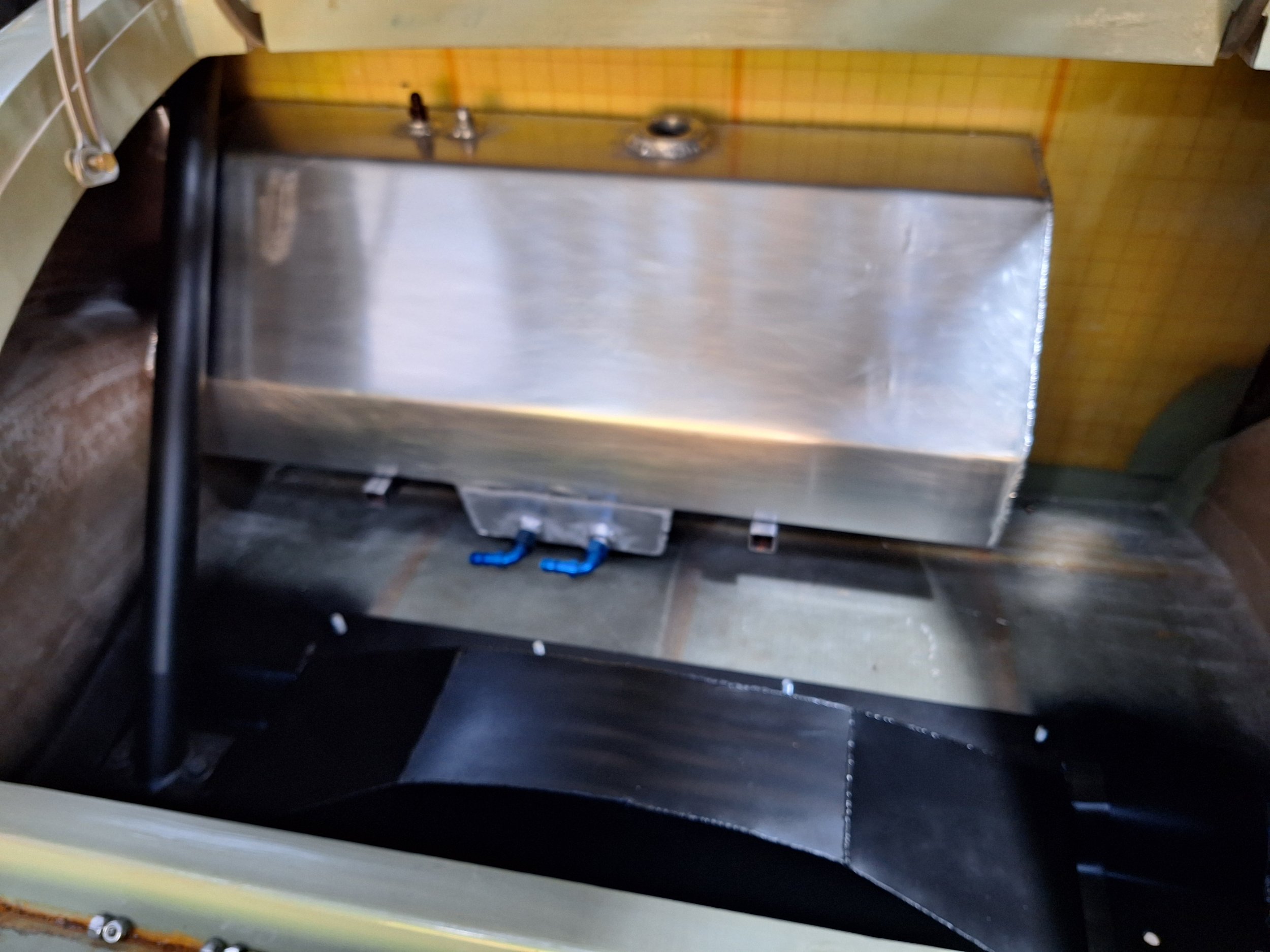

    Welded up fuel tank today, still need to fab mounts and leak test and have certified, overall happy with result. Glen 20251014_172248.jpg 20251014_172319.jpg 20251014_172328.jpg 20251014_172335.jpg 20251014_180505.jpg 20251014_180511.jpg 20251014_190523.jpg af5fe910-9f33-4a4f-a613-cd6eadf72e75.jpg

    Nice! Will the sender R&I without pulling the tank?

    I didn't think it would, but I tried it today and it is changeable while in car. Glen

    Fuel tank done for now, I just need to pressure test myself before sending it out to be certified, today I started working on my firewall for distributor clearance and making my gearbox cover. My plan is to glue some 2 inch by 1/8 flat to the underside and bolt transmission cover to it ( this is how I fabbed the rear crossmember cover ). The cover will be made out of 16 gauge cold rolled sheet, I will also incorporate a provision for my Winters shifter. I was going to do in fibergl*** but like the idea of a removable cover, a few pics Glen 20251017_132132.jpg 20251017_135911.jpg 20251017_135918.jpg 20251017_135931.jpg 20251017_165810.jpg 20251017_184252.jpg 20251017_184300.jpg

    You might want to add a couple gussets to the neck. Lots of twisting and pull when that gets removed.

    Filler neck should be ok, lots of support in that area, pic doesn't show it, fuel cap side is machined out of solid, Glen
