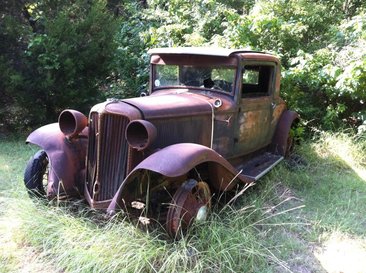

    Happy with my new project :D
    Just bought it, picking it up this weekend. Got it from a collector with a yard and a barn full of cars who decided that he was not going to get to them all, so he's selling.
    Planning to put in one of my Seagrave flathead v12's, keep the rest of the car as close to original as possible. Probably put in a 9" rear (I've got one sitting around) and probably will have to lengthen the frame a bit to fit the motor.
    The car has very little rust, except for the driver side running boards and is very straight. Rumble seat, roll down rear window, cowl lights.
    The only real damage I could find was the aluminum edge on the running board and the grill insert.
    Haven't decided yet on fenders or highboy.. but I don't think that decision will take too long.
    Have some nice spoked wheels ready for her (yes it's a her).
    So I know it's a Chrysler, is it a 1932? what model? what to look for?
    Anyone have a grille insert?

    WOW, good looking ride, keep the fenders since you have them...dig that grille:rolleyes::)

    I vote to keep the fenders. That grille looks repairable too.

    Early Chrysler's always have cool lines, nice score. I vote keep the fenders, you don't see too many 30's era Chrysler's. Let alone ones with all the fenders!

    Yowza! That thing is really complete. Another vote for keeping the fenders.

    There were 6 and 8 cyls with that grill type in 31 and 32. I am pretty sure 31 was a split year with the early ones being the older style grille.
    Don't know about that car, but many mopars of that age, used the model letters as the prefix on the engine ID number stamped into the driver side of the block; up front near the head.
    I'd have to look up the years/models, but one six was the CM6 as a model name. CD8 rings a bell for the 8

    I've got out one of my books...yikes there are many changes throughout the 31 and 32 years, early vs late, first series vs 2nd series..
    They claim the ID tag is on the pass front door pillar.
    And the 6's and 8's did use the model letter as a prefix on the block;
    I do have lists of the ID numbers and engine numbers. I can look it up if you have them.
    Just looking at the side view, I'd say it was a 6, and most likely an early 31, model CM6...just a guess rom what I see in the book.

    Looks like a "New Six Series" 4 passenger coupe. The rumble seat makes it a 4 seater as opposed to the business coupe that had a trunk only.
    Also called the Series CM, and the Royal coupe.5327 were built at a price of $885!
    The 1932 closed Chryslers had split, Vee'd windshields, and the 1930's had a narrow rad shell, almost completely covered by the hood.

    Technically, it is. they made so many half year models and series.
    That grill came out in Jan 31 which was well into 31 production. The earliest post Jan cars had no visor, buyers hated it, so a visor was then put back into production.
    Many car makers did the same first series-second series thing. They had leftover unsold cars, parts, etc, so they carried them over to dump them, Then came out with the second series, which was a completely modernized version.
    Your car has a very old looking 29-30 style body shell with the newer very modern V rad.

    This car has a visor, which would make it a later model..
  15. Chrysler during that time was introducing the new models in January, selling them six months or so as that year, then selling and titling the same car as the next year for the second half of the year, before coming out with the new car. The only way to determine the year for certain is with the serial number.
