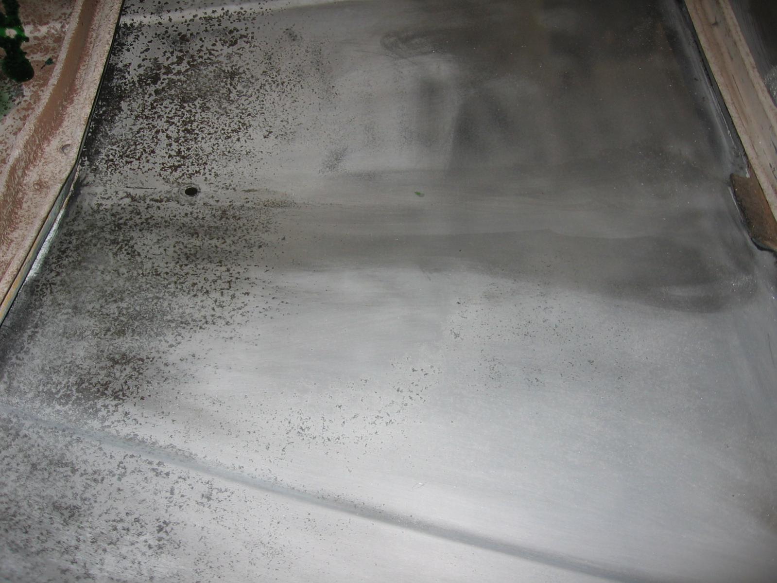

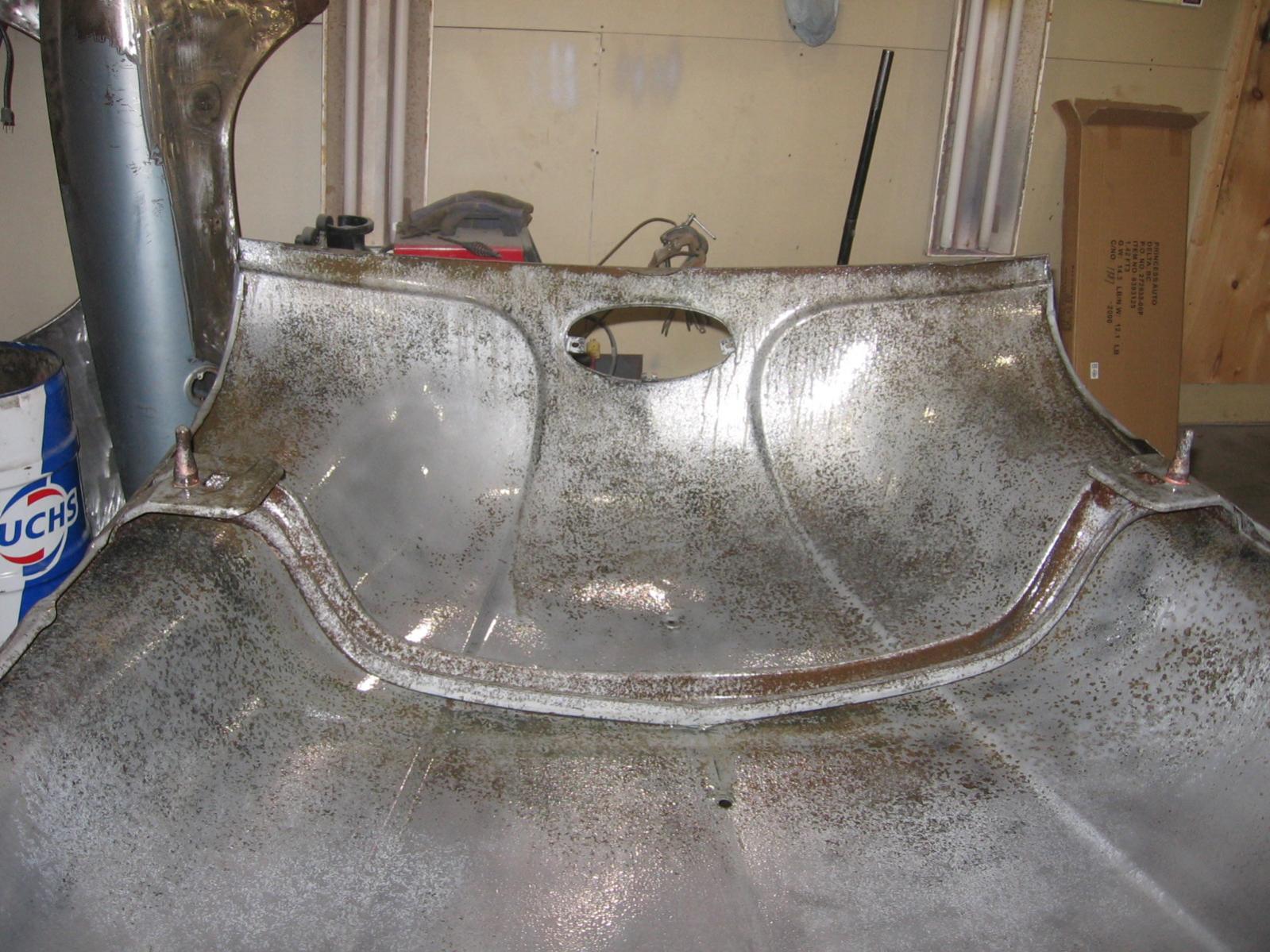

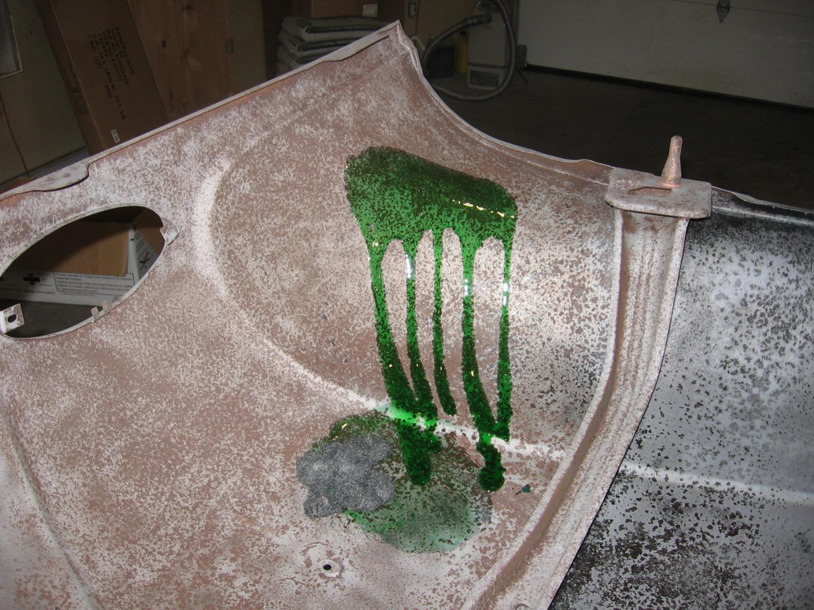

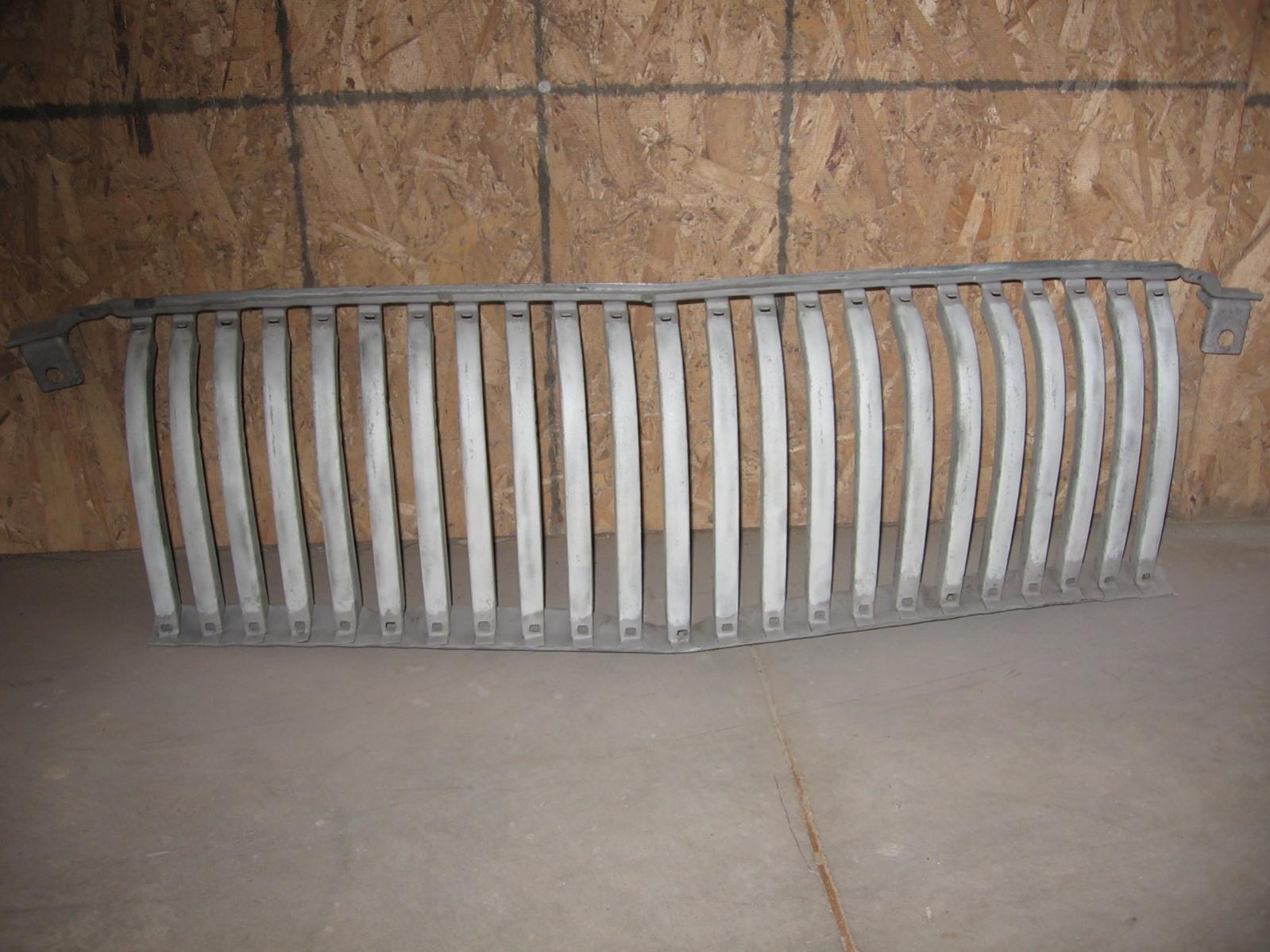

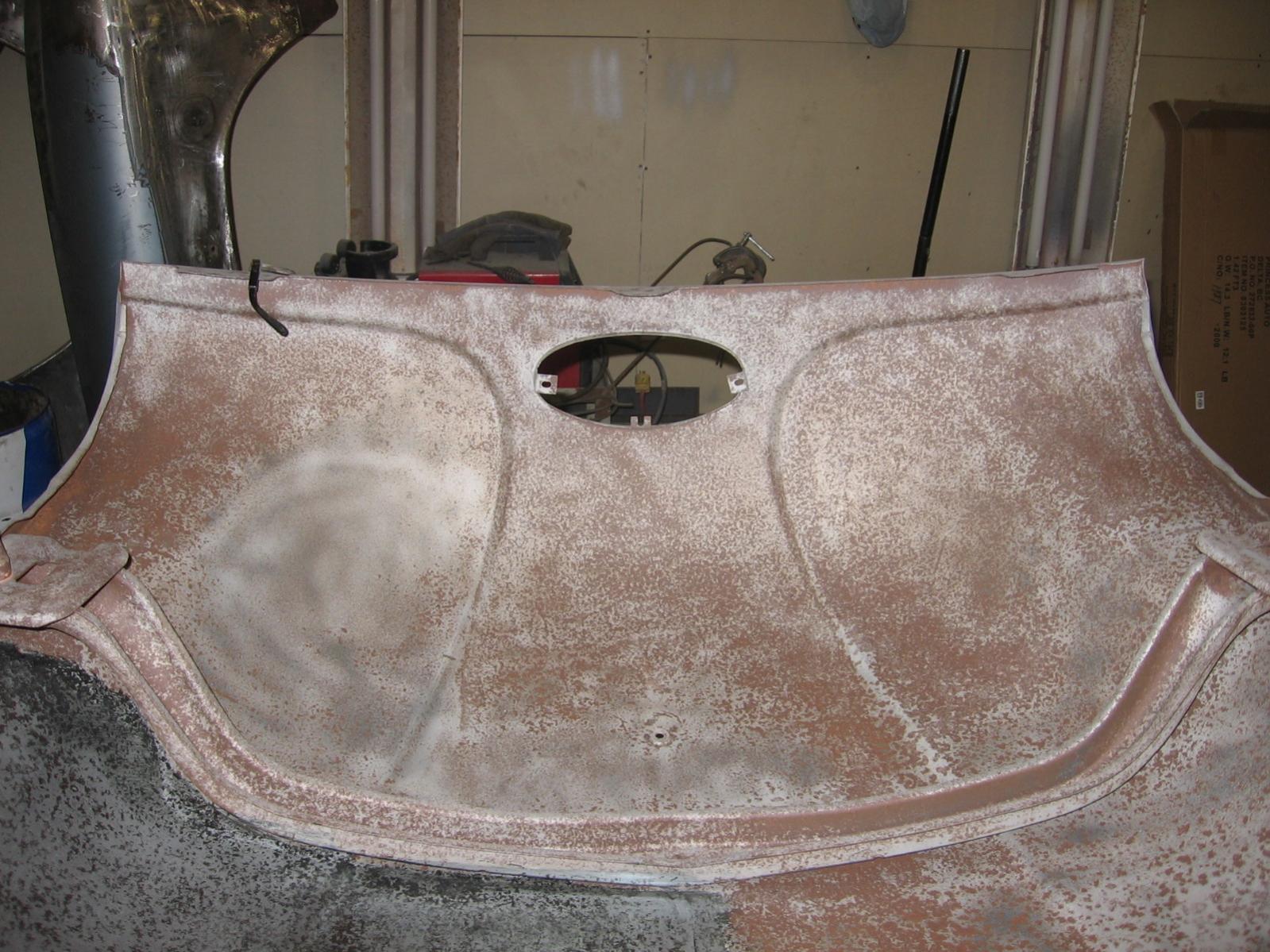

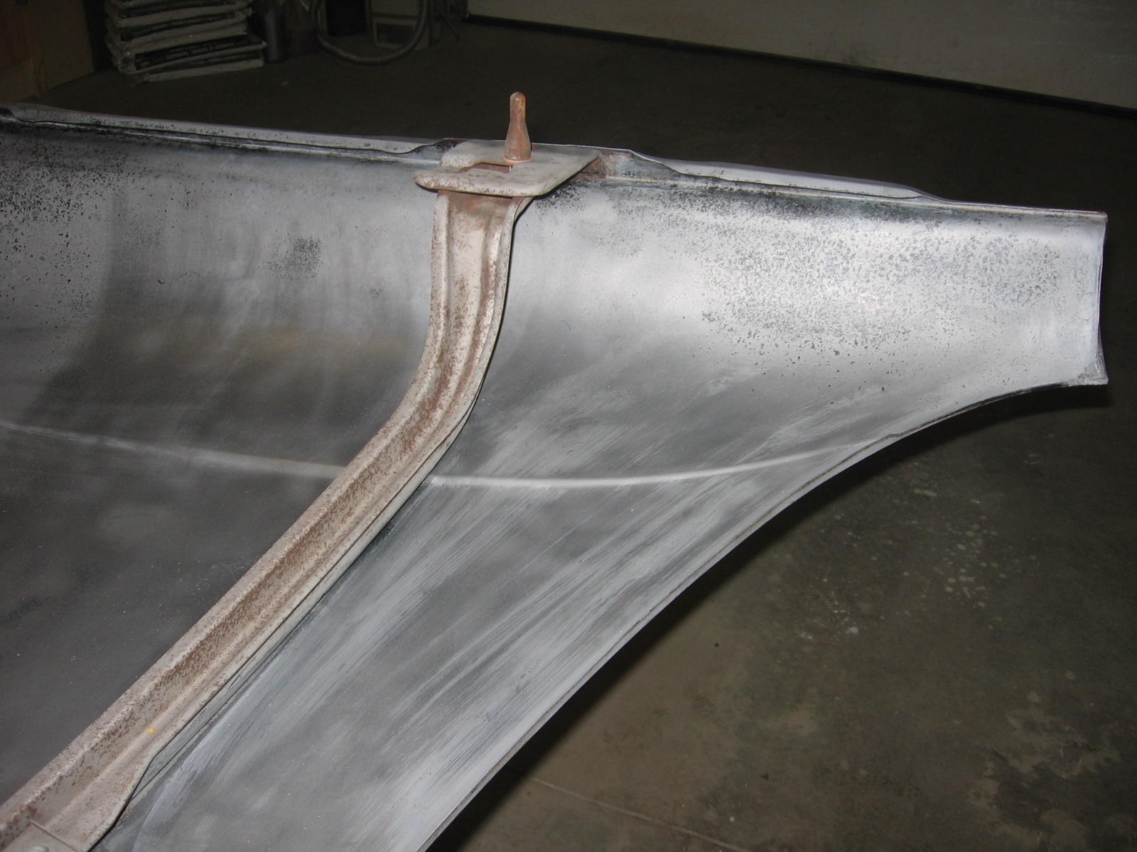

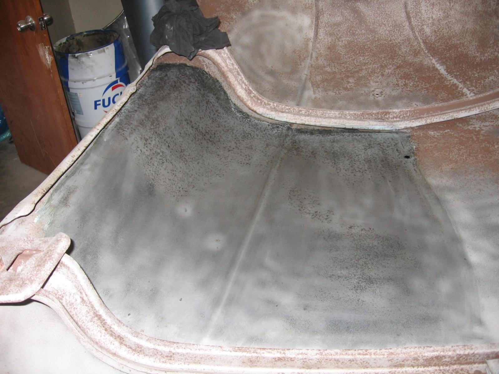

    Well its been a while since the last update . There has been no progress up until the last few days . I am on holidays and I think I will be able to squeeze a couple days for the car . In june I took on a paint and body repair that took 10 days and then not two weeks later replacement of two quaterpanels on a 2001 Blazer . Have to make the coin when you can . The Buick is outside under a tarp . Hate to see that, but when jobs come in the shop the Buick has to go somewhere . Anyways I was able to sandblast the hood and dis***emble the grille and blast it as well . The hood underside had some heavy surface rust and I am in the process of removing it with jellied rust remover and Rustmort . When this dries it will be ready for primer . This may be my last build so I am going to do it right . All of my previous cars were drivers that looked good topside but I never showed the engine compartment . They were never detailed much . Might be few more posts later this weekend we'll see , thats my intent anyways . Andy....

  7. Never heard of Rustmort before. It's not something I have seen on the shelves down under, but it's something I think I need to have here and now. I've been squrting Killrust all over the place inside my car's cabin, but I think it's nothing more than just expensive spraypaint. Looks like Rustmort is a phosphoric acid/water based rust remover, and I have found something similar here called white knight.
    Anyway, if it doesn't work, I can always clean my teeth with it...
    Great (little) project you have there. She's a beauty :)

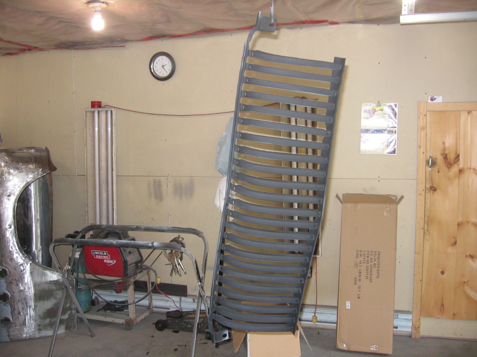

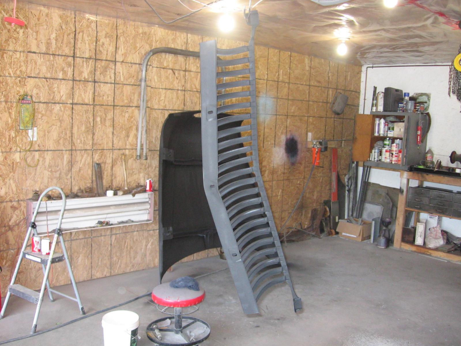

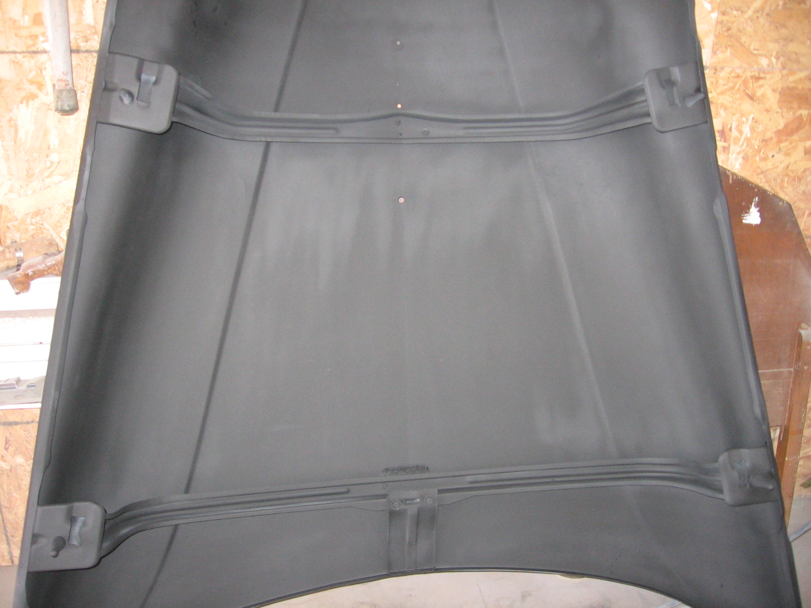

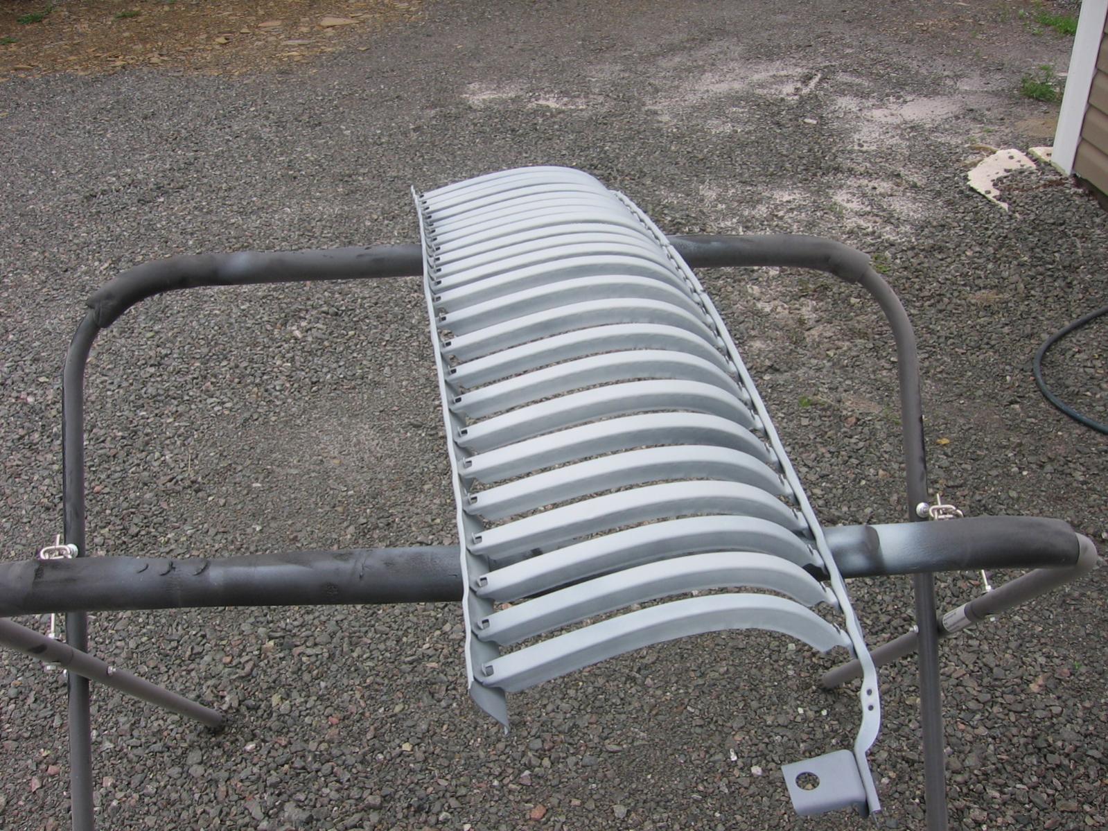

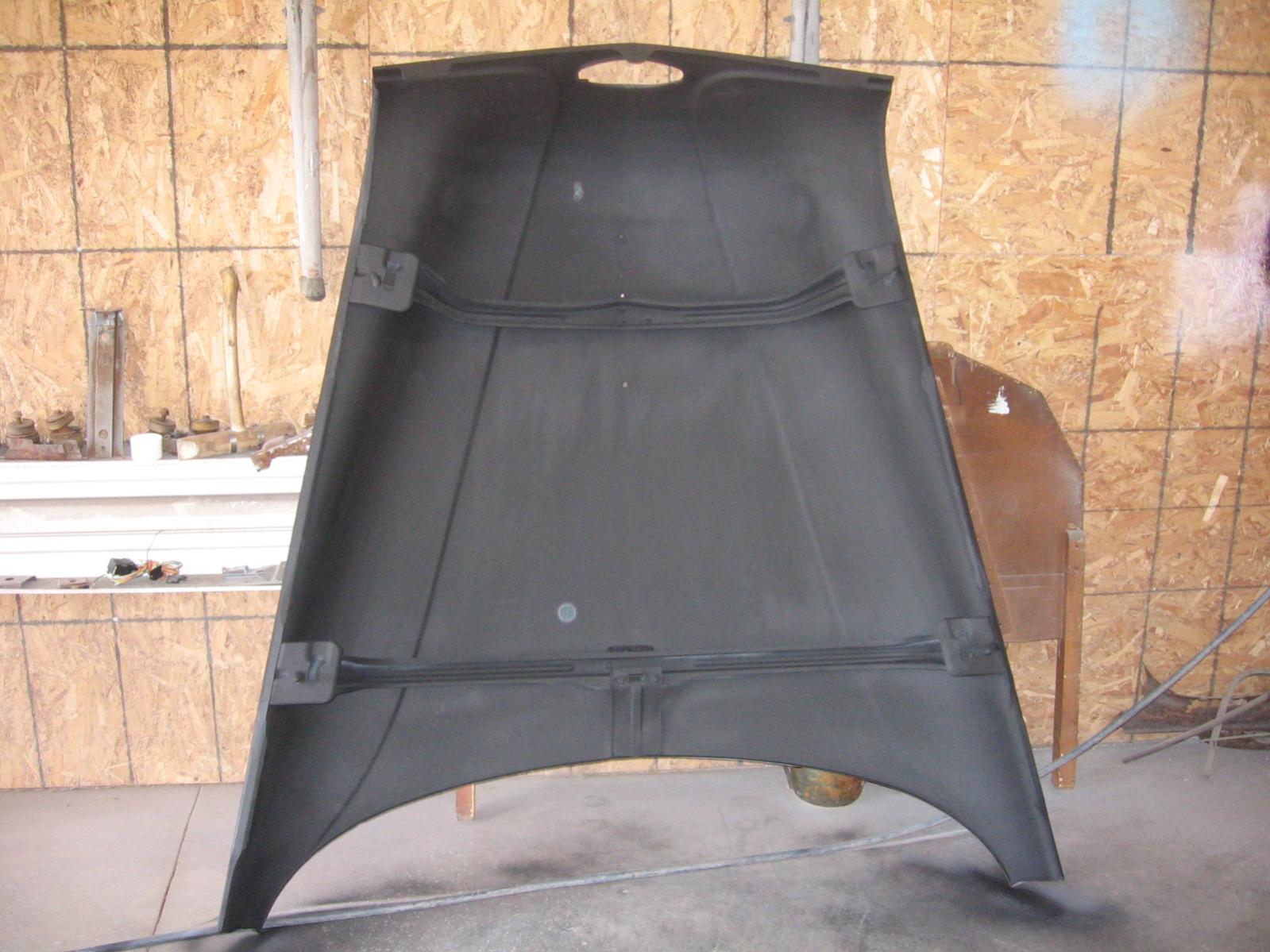

    As I was also Steve but I had a job in the shop that weekend that I had to get out so saturday was a bust for me and I didnt have the time to go to the show on Sunday either because I had to ***emble the Blazer after paint then off to my other job for 3:00 PM Heres a few more of the hood and the grille all cleaned up and in primer now . Tomorrow I will be in the garage all day hoping to get more progress on the buick . Andy...

    What I used on my Model A was white vinegar & water. It was mixed as 1 part Vinegar to 3 parts Water ratio. It cleaned the rumble pan nearly new. A few spots were still showing some light rust but it came off with some scrubbing.

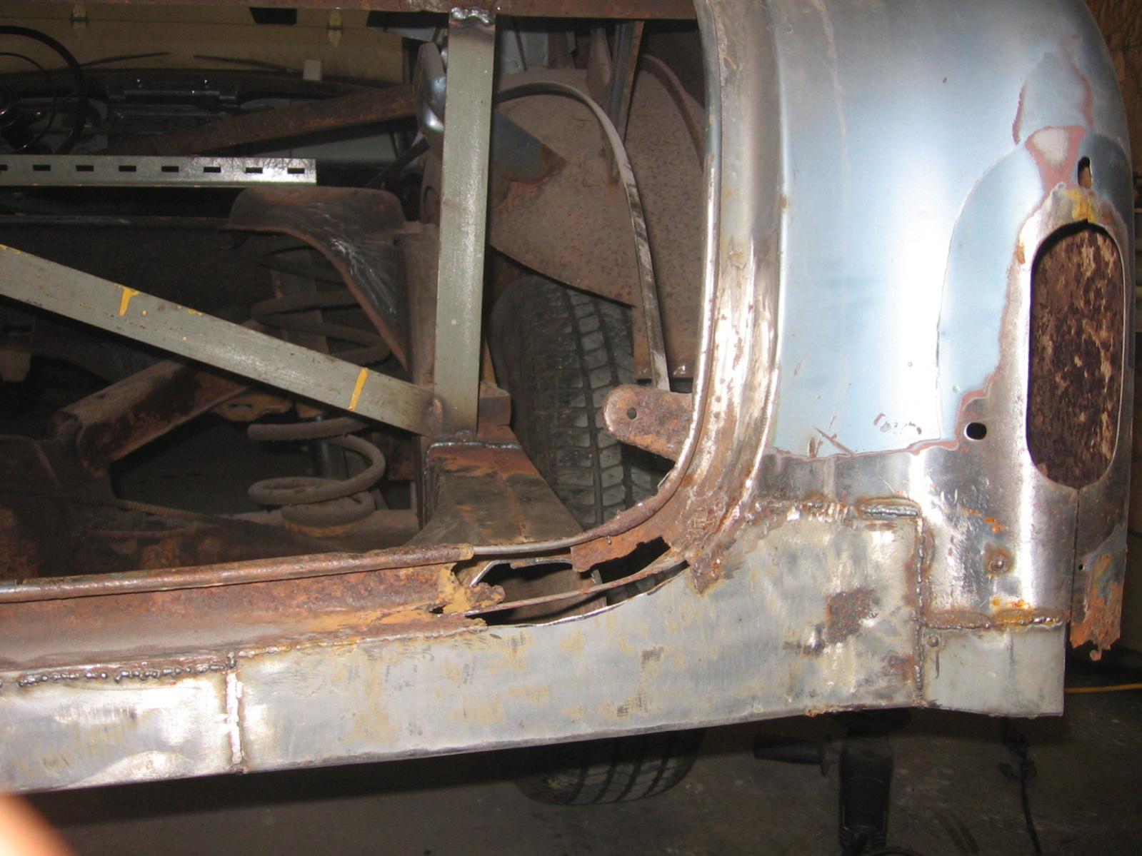

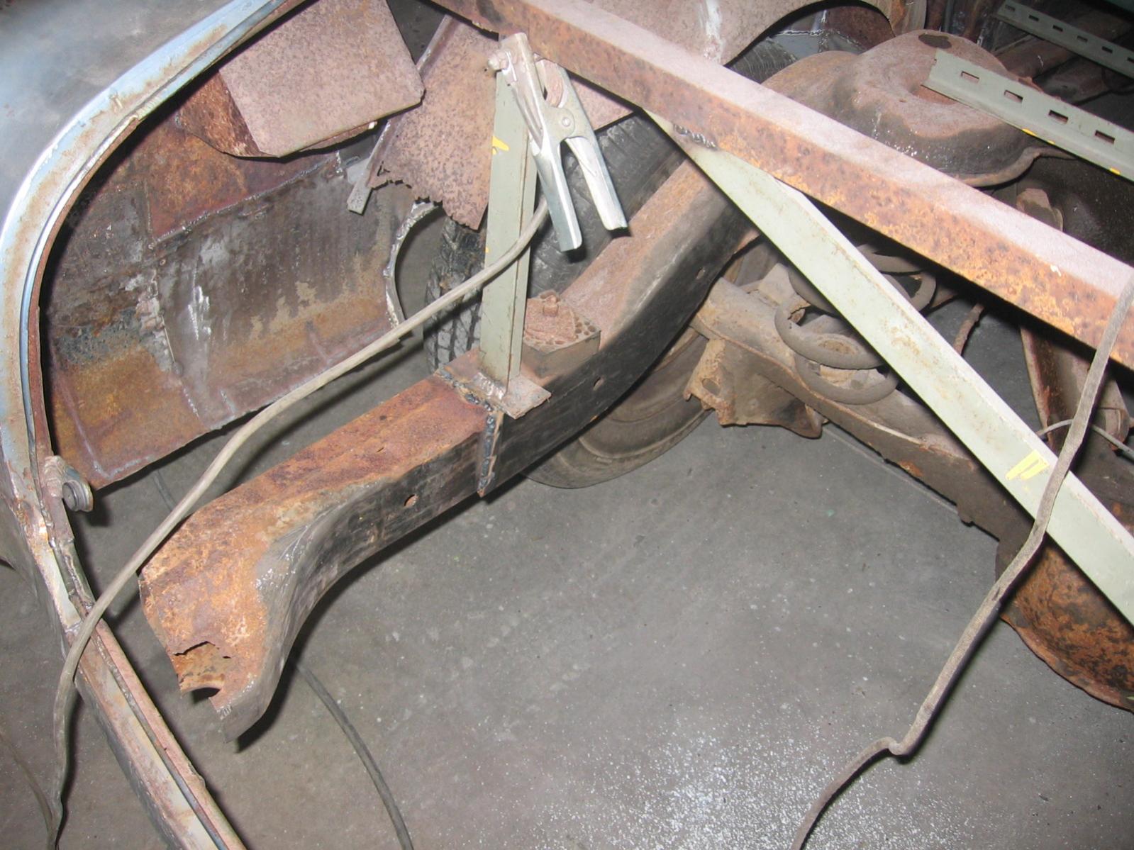

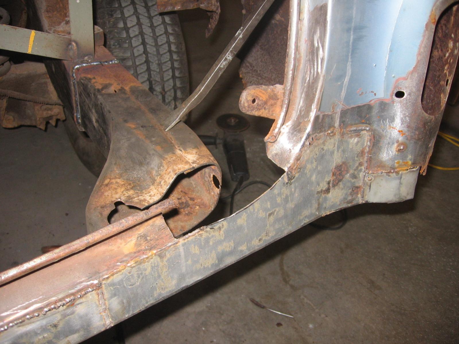

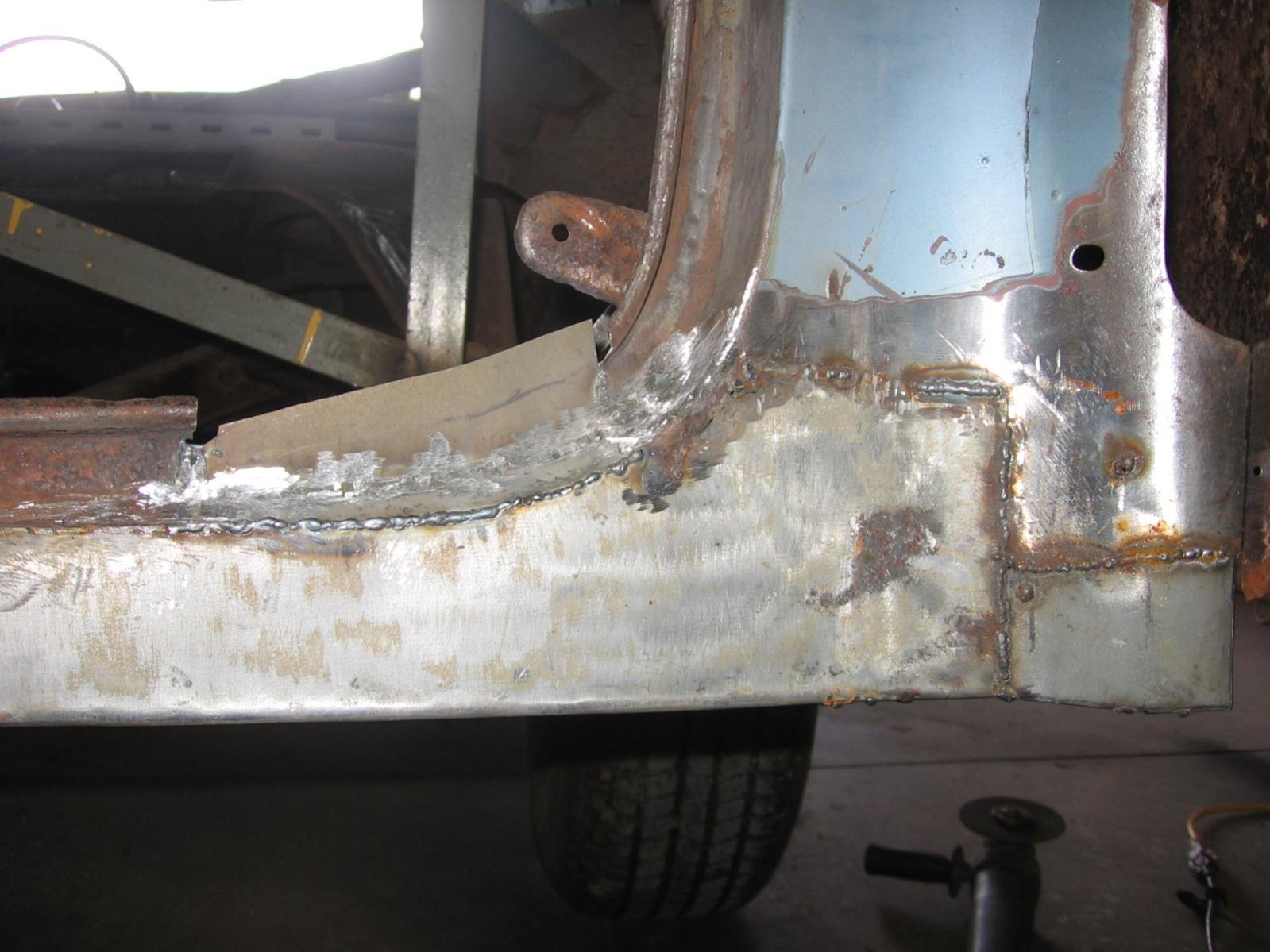

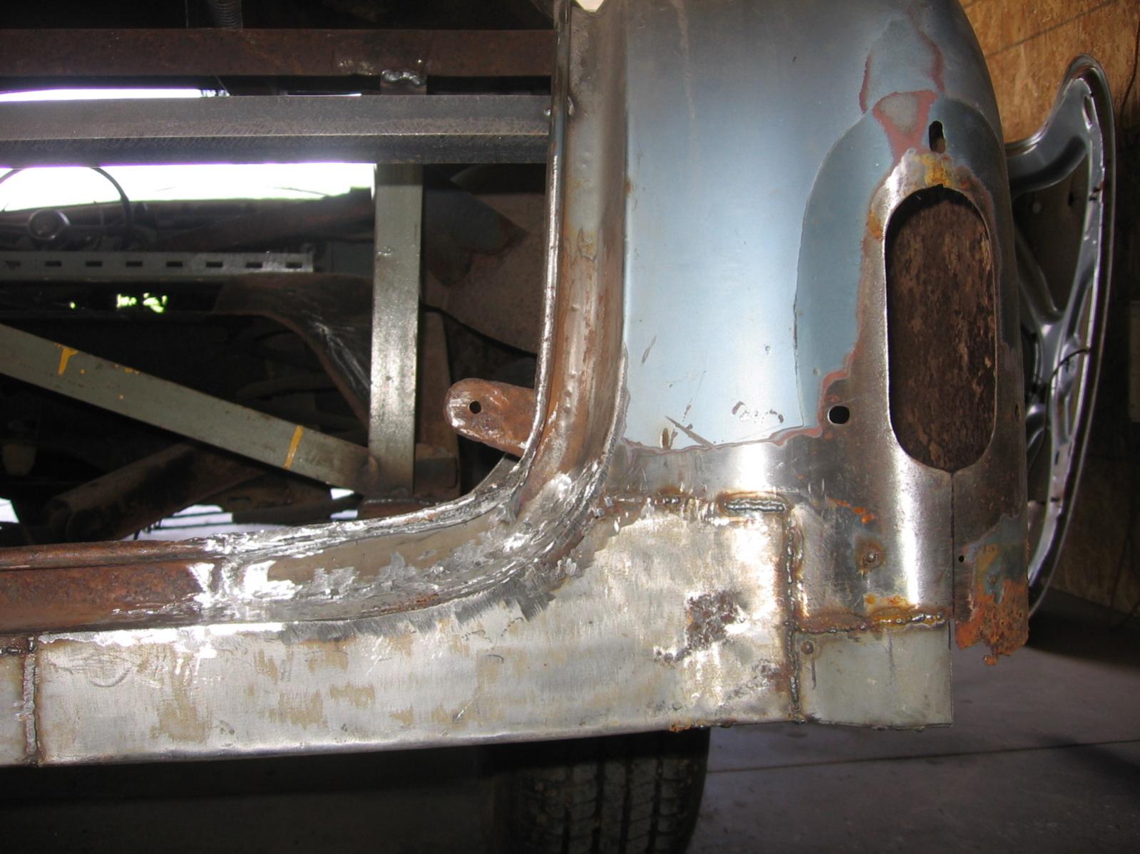

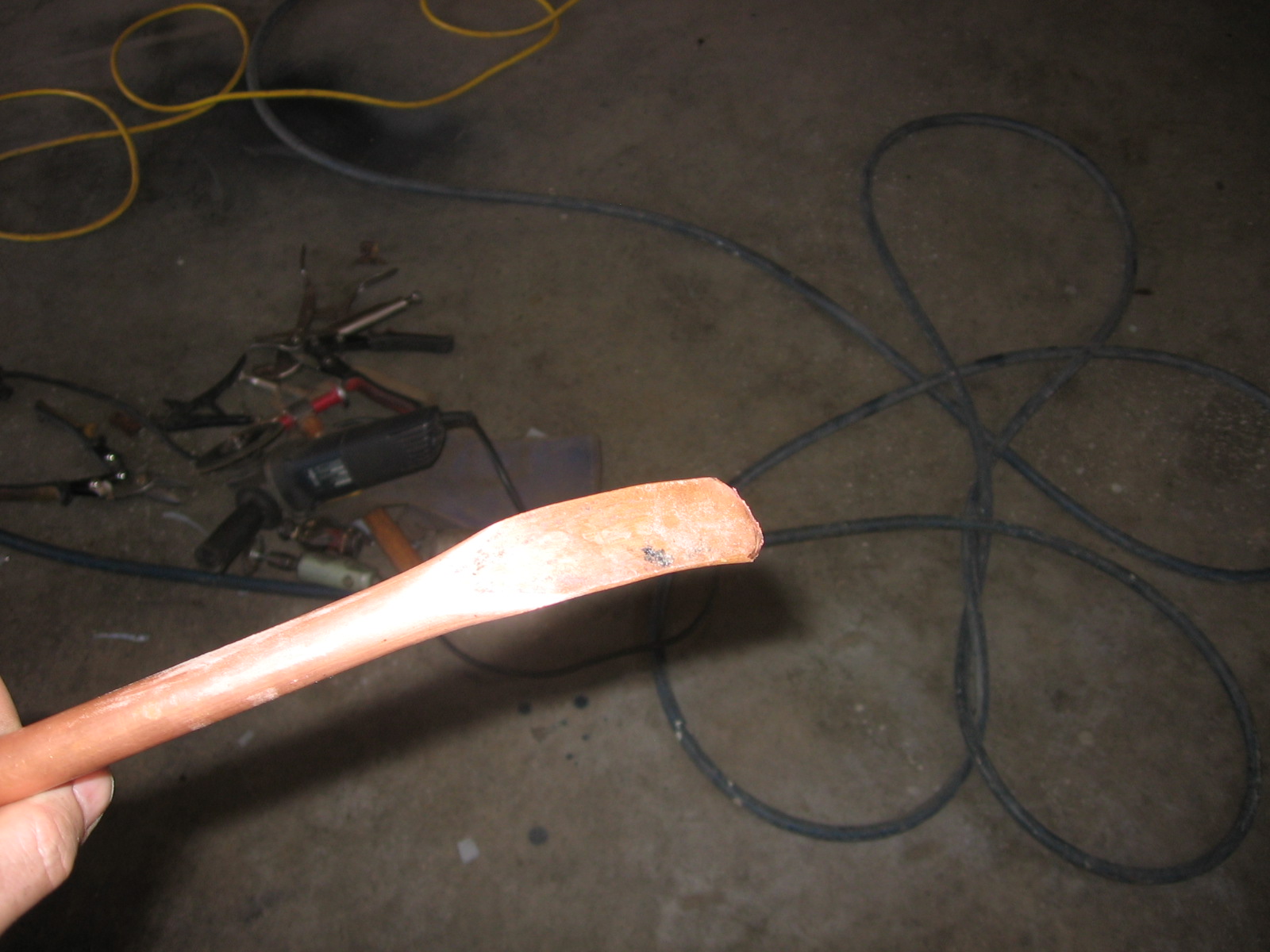

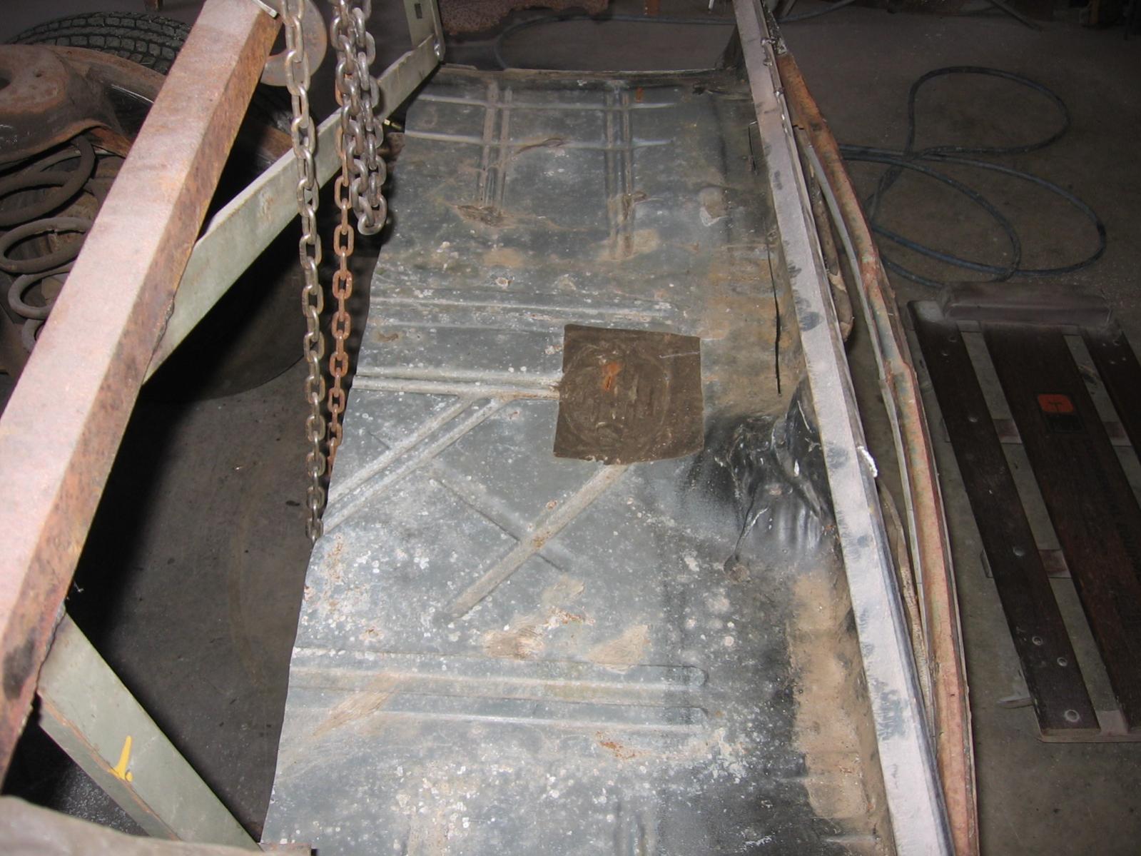

    As I stated I would have another day with the Buick . To hot here to do anything else (33 degrees ) 98 F :eek: I got the rear frame section cut to length and welded back on both sides. For some reason the frame on the drivers side is lower than the other but when I check level at the front of the car its fine but I have to put a bottle jack back by where the trailing arms attach to the frame for the rest of the car to be good . Anyway I'll deal with that later . 2,3,4,5 is the rear corner water channel that needs repaired . Dont pay Eastwood or any other company for a copper backup plate for welding pinholes . This is just a piece of 1/2 copper waterpipe cleaned and the crushed with a mall . It works great . :D I started to cut down the caprice trunk floor to install . Andy..

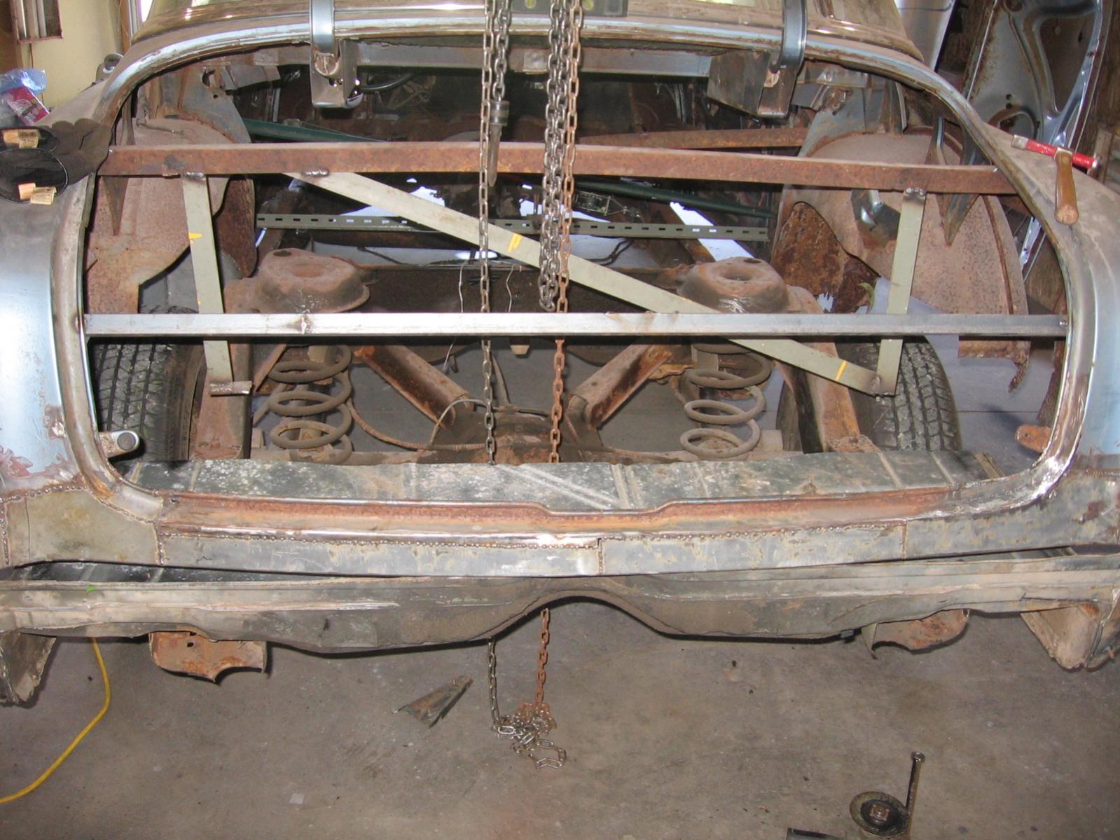

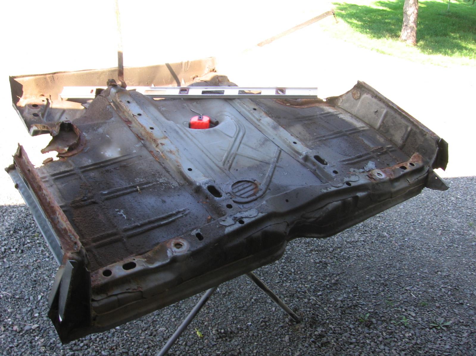

    More pics of the trunk first mockup . Had to trim it to fit . But remarkably it is the correct width at the trunk drops . Funny how some of this stuff works so well with these old cars . I did a measure of the upper deck shelf that goes from wheelwell to wheelwell and it is exactly the right width . Go figure :rolleyes:

  16. I've been using the copper pipe too! It's a lot cheaper than buying the copper backing plates from Eastwood, as you've mentioned. While filling the holes on my buddies '50 F1 firewall, he'd hold the flattened copper pipe over the holes from the inside while I welded them up from the outside. Worked great!
    It's good to see you making some more progress on your Buick. I'm still amazed at how you are transforming the rusted mess into a really cool custom. Keep up the great work!

    I should have mentioned that it takes a couple days immersion. Hope that didn't 'slow' you down
