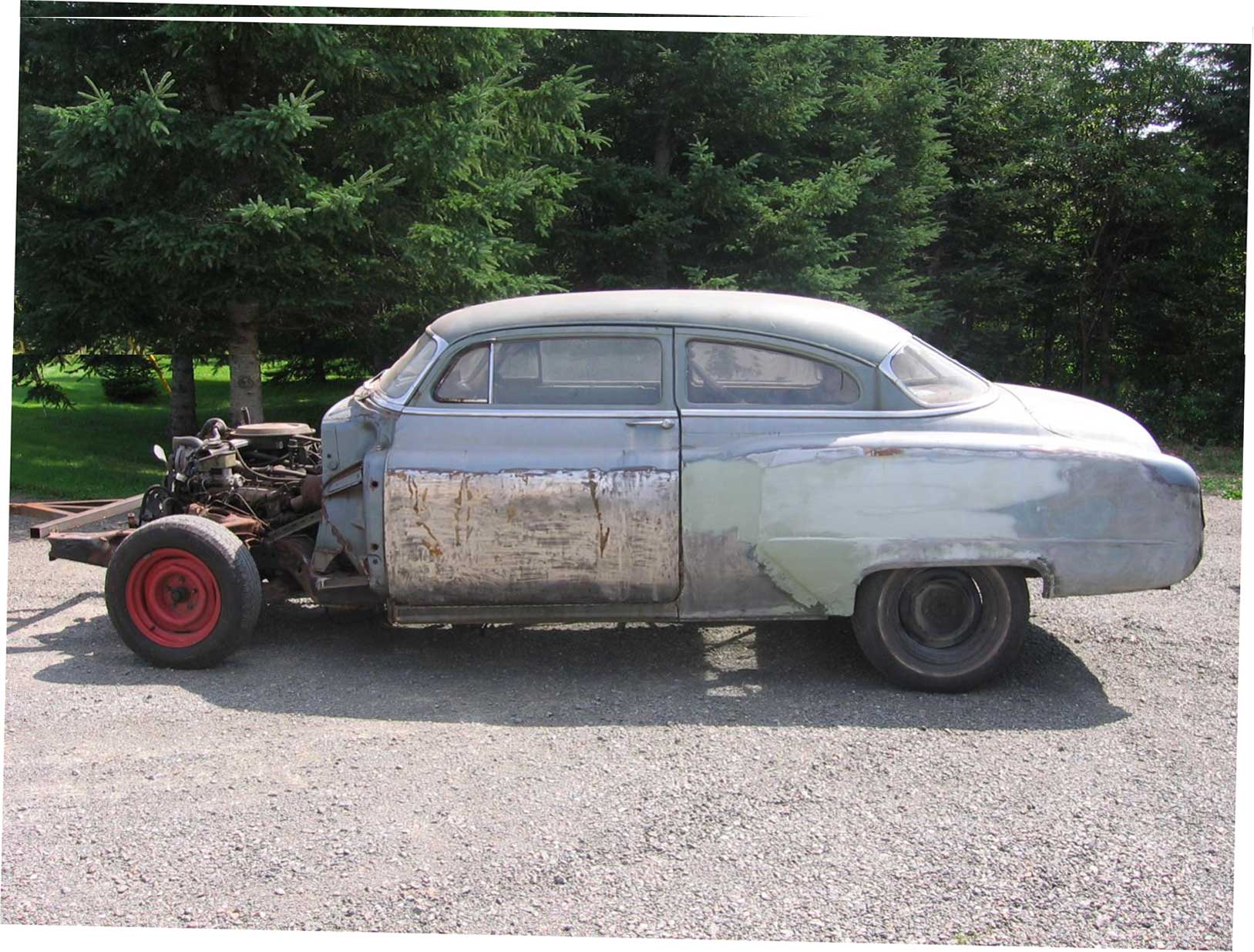

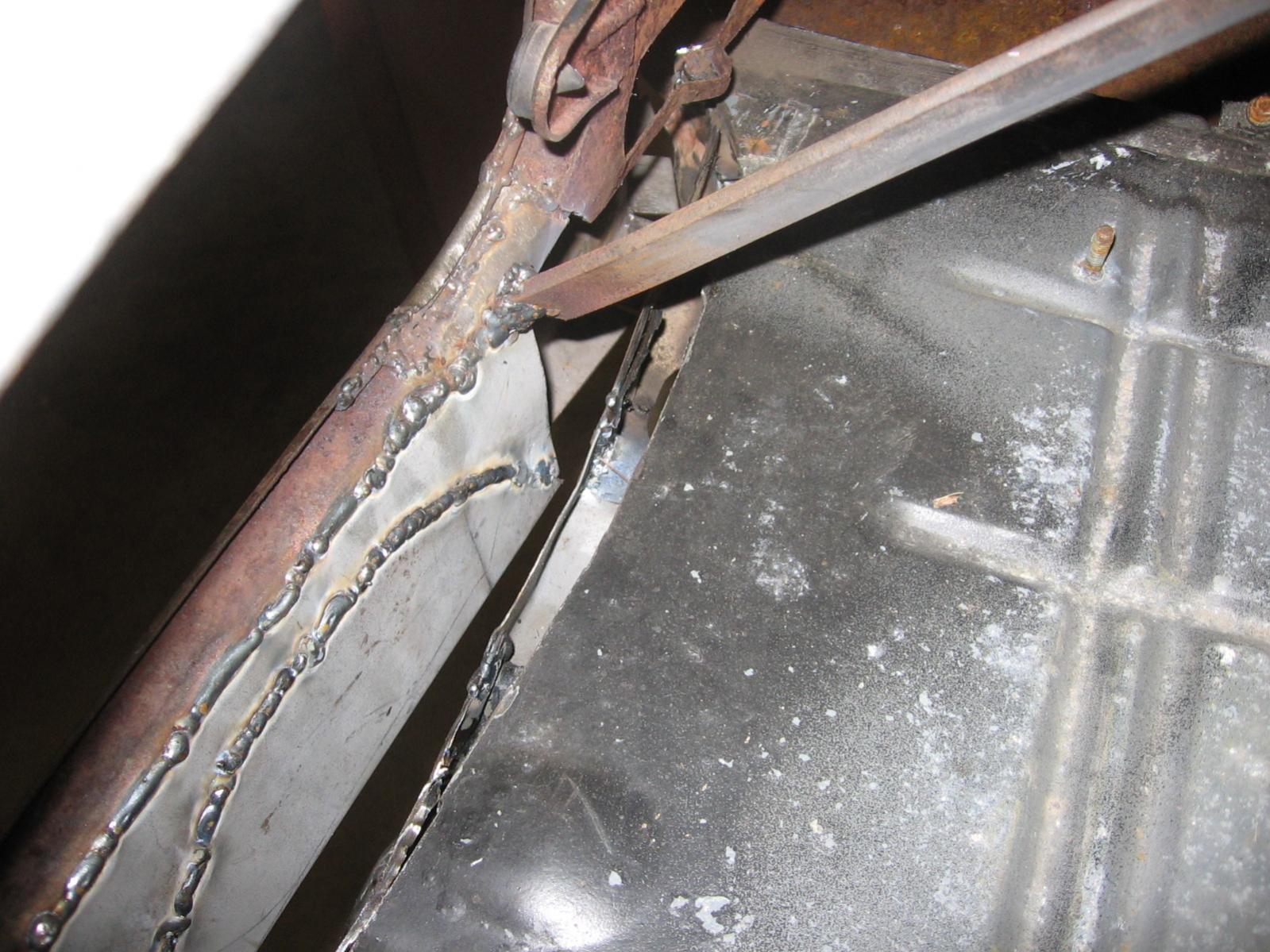

    Not much done in the last few days but progress is progress . Was able to have the rear of the body setting on its new rear mounts for the first time today . Removed the rear brace that was holding it in place for the last 8 months. Small wins, a day at a time over the rust issues . :D

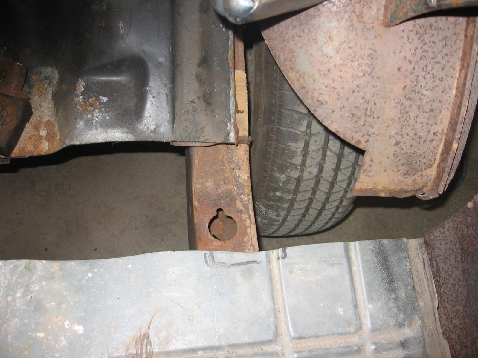

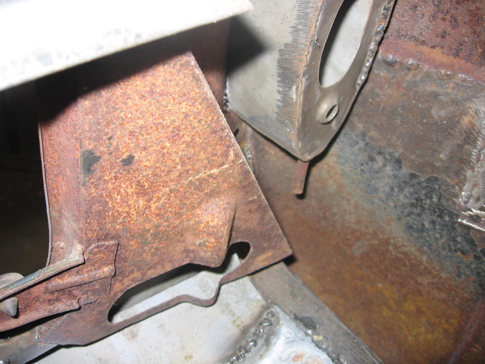

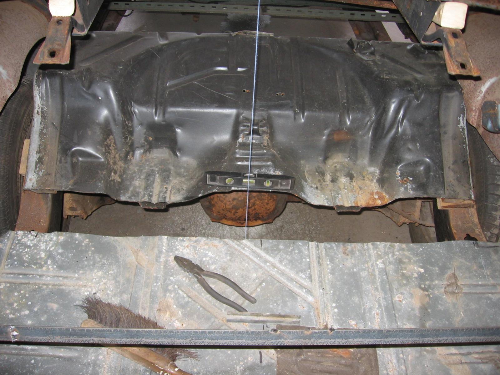

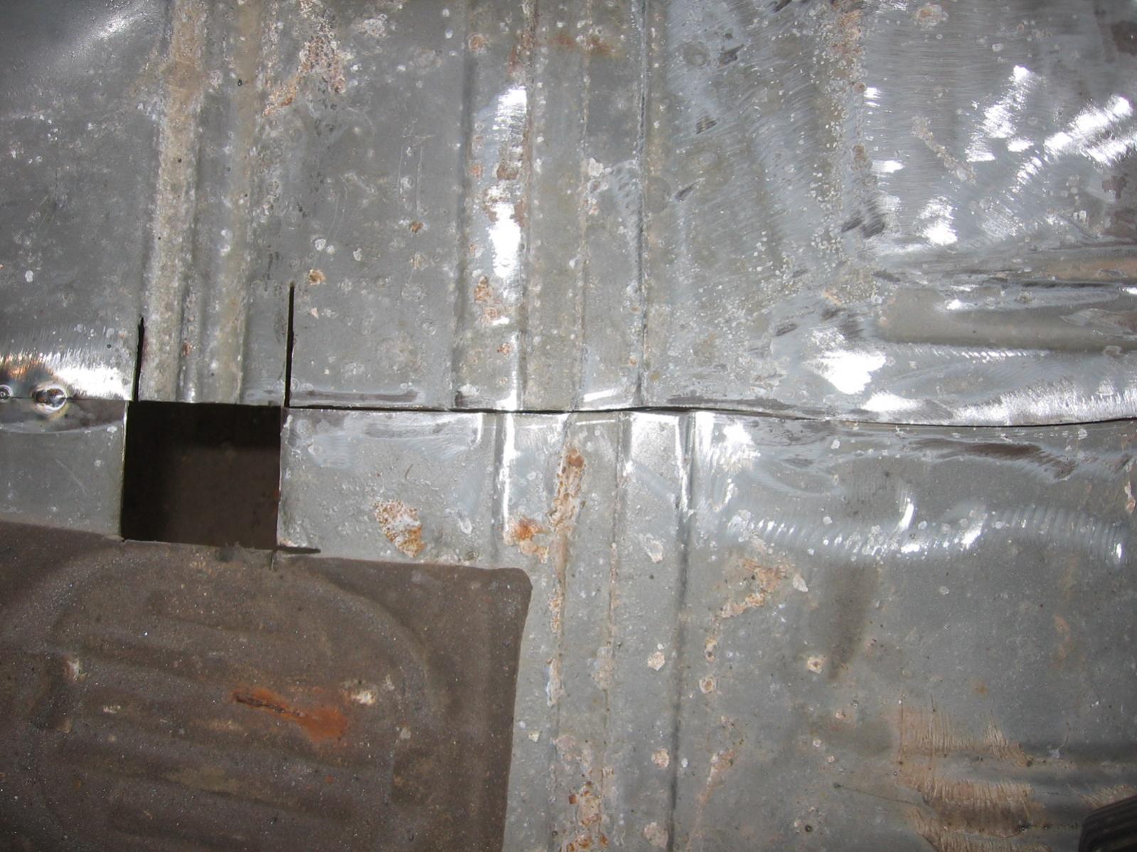

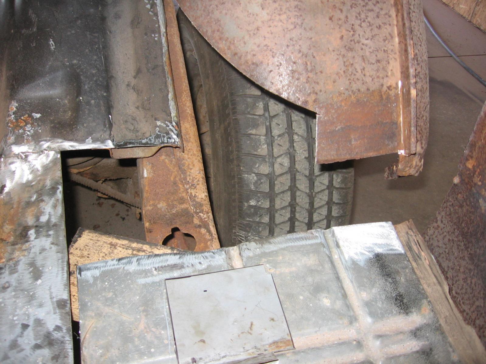

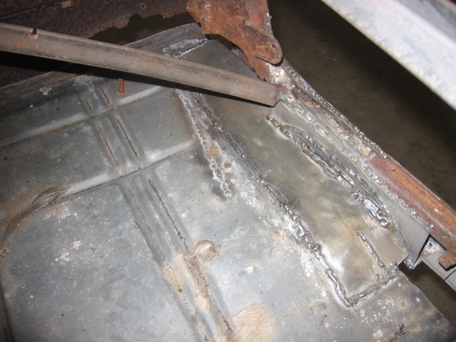

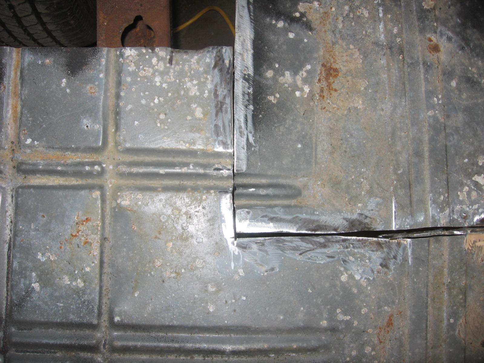

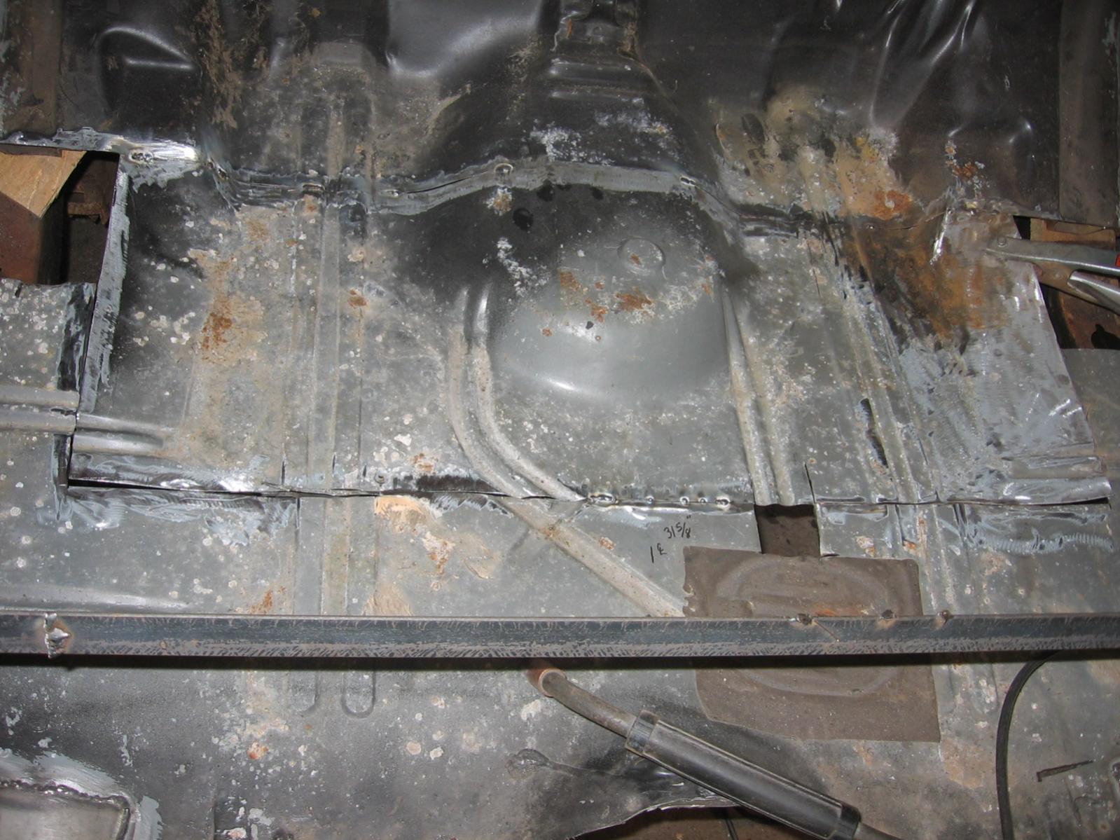

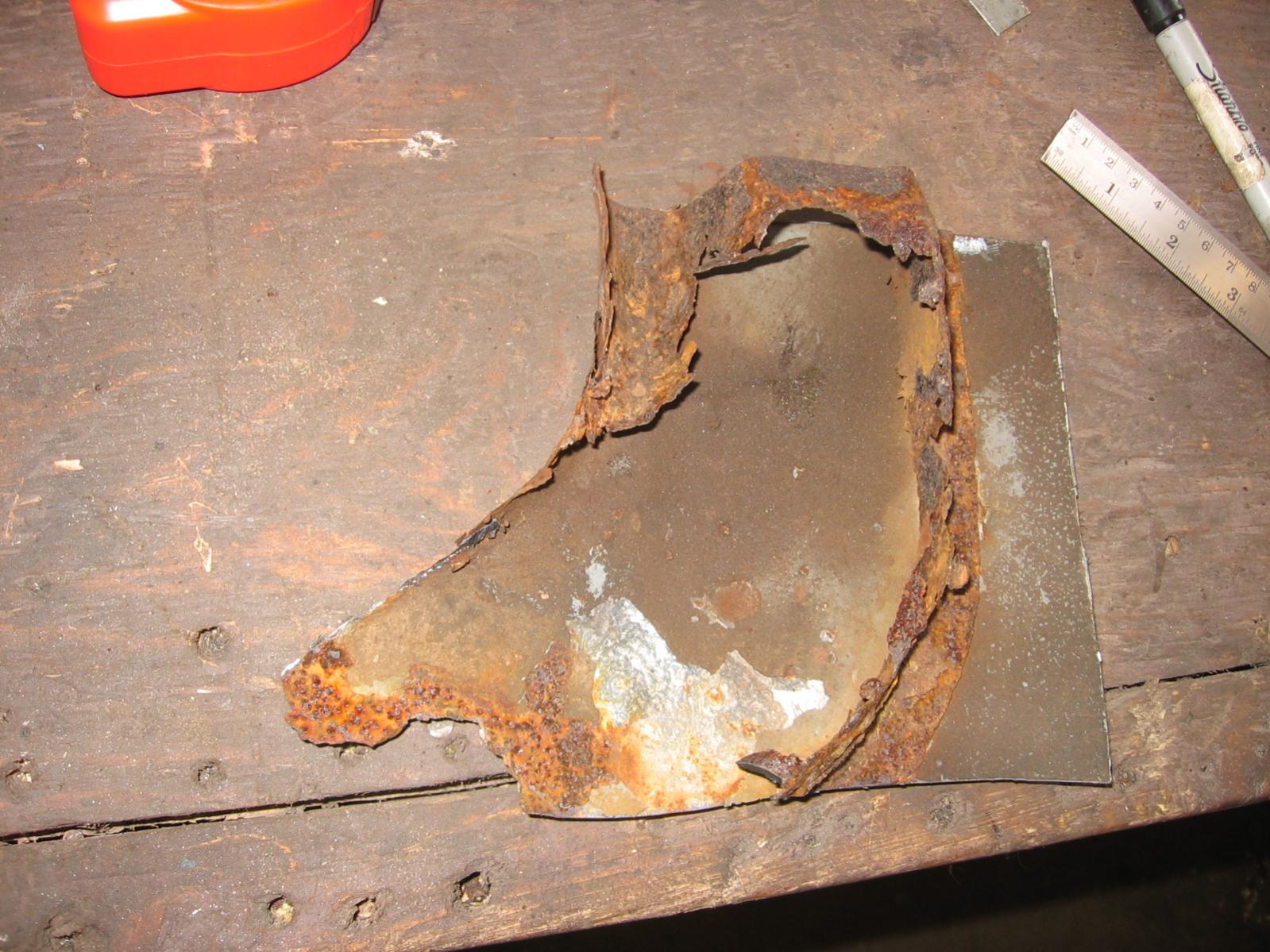

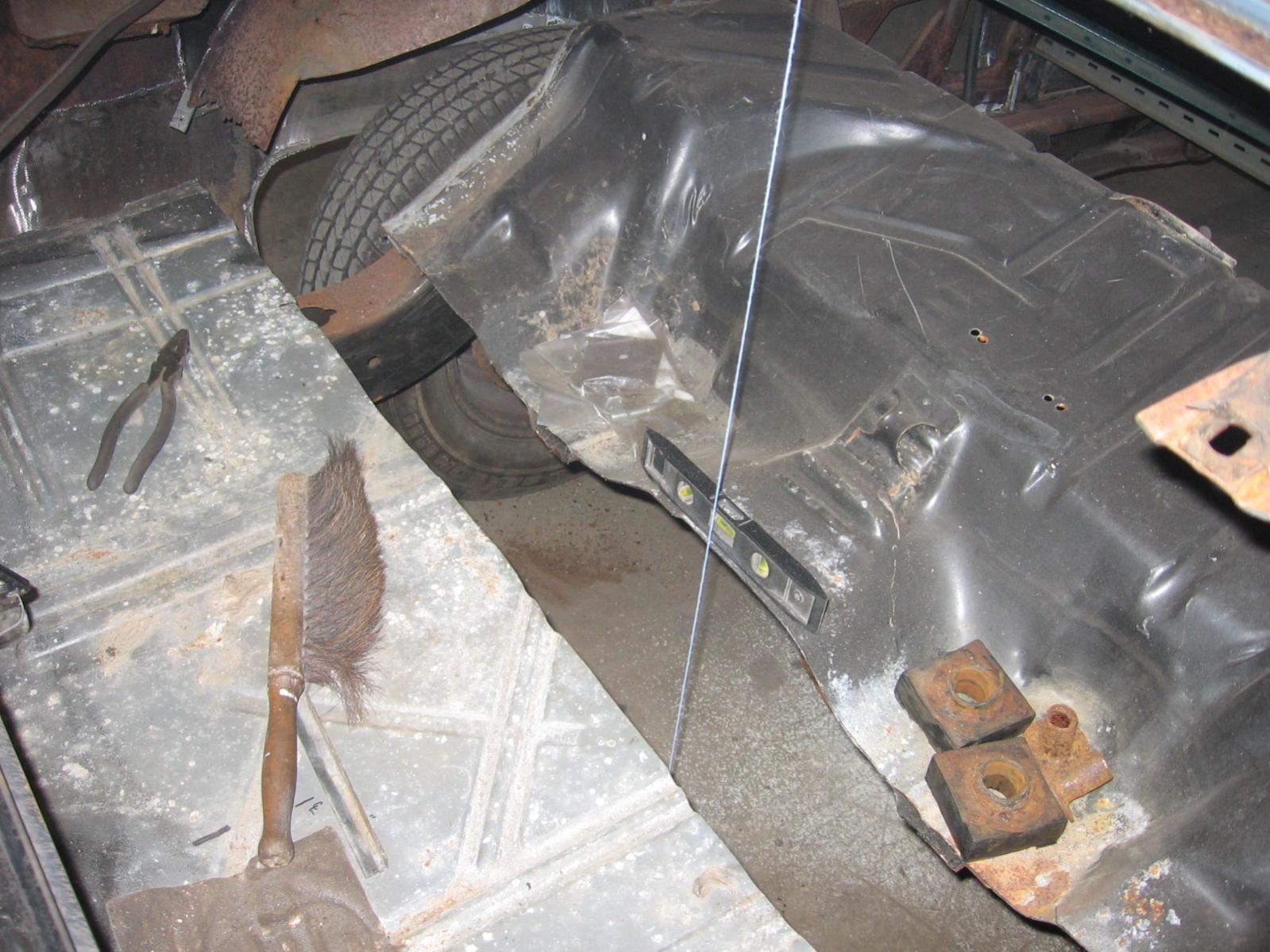

    Was at it again today . I needed to replace the metal that was absent between upper portion of the panel and the lower portion. It was a void of about 5.5 - 6 inches .Once the car was plumb I removed the plumbob and was good to go . I had to leave the hump in the filler piece to facilatate the gas tank when I go to reinstall it . I dont know what I will use for a tank now as the floor has been made smaller by 6 or 7 inches. The caprice wont fit now . Maybe a Malibu tank ??? We'll see . The initial panel fits well but some of the reinforcement beads are clocked wrong . I will cut these out , shift them were they belong and reweld them in the proper place . I know its a lot of work for a trunk floor that will be covered but sometimes I THINK, correction , I know I am OCD on some issues and this be one of them . I just cant let it go and say good enough. I have already removed one of the offending alignment issues at picture number 6. I have a couple more pics coming kinda boring though as it is of the under side of the trunk support that I am fixing . Oh well it all has to get done ,boring as it is ...

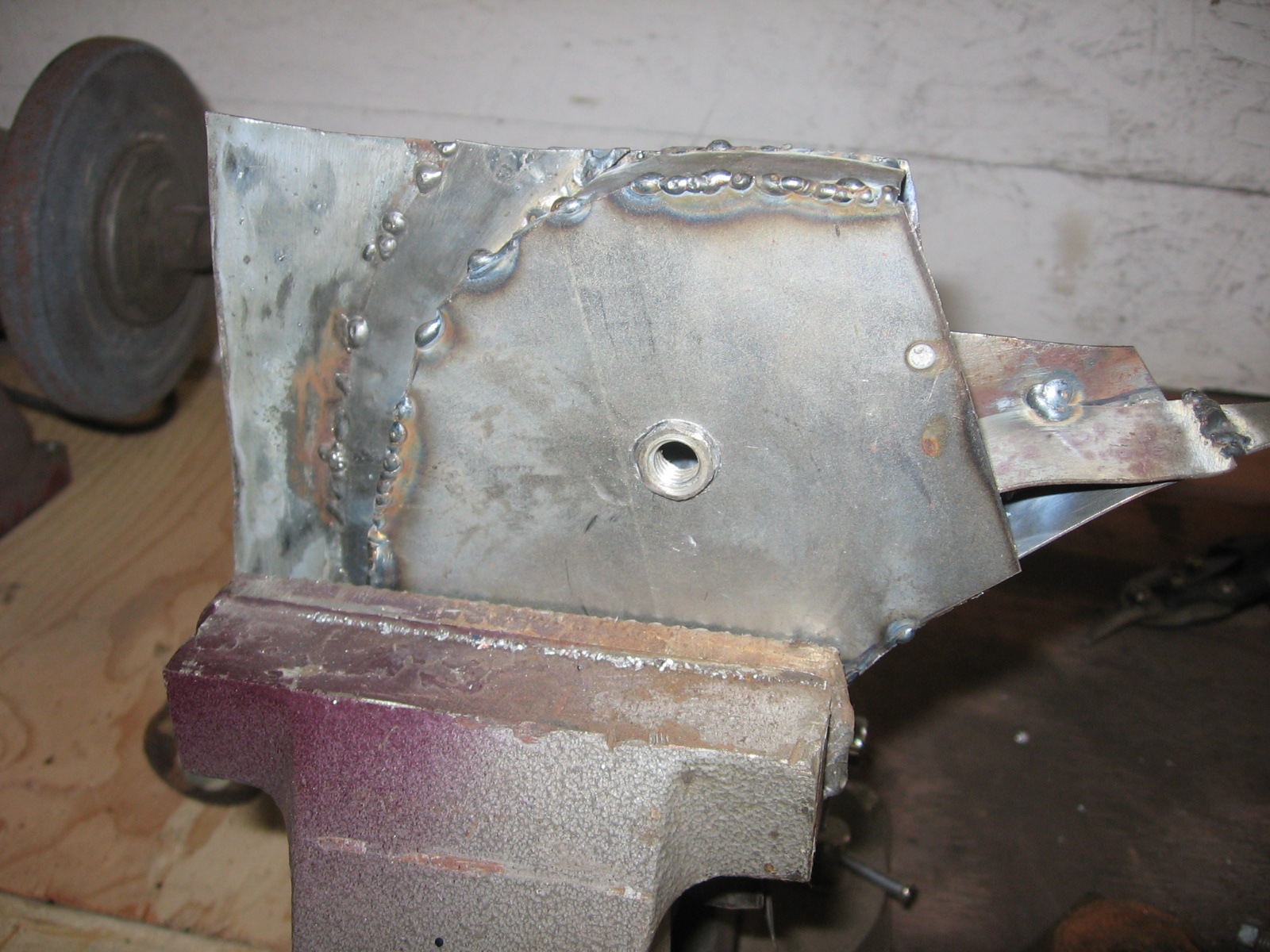

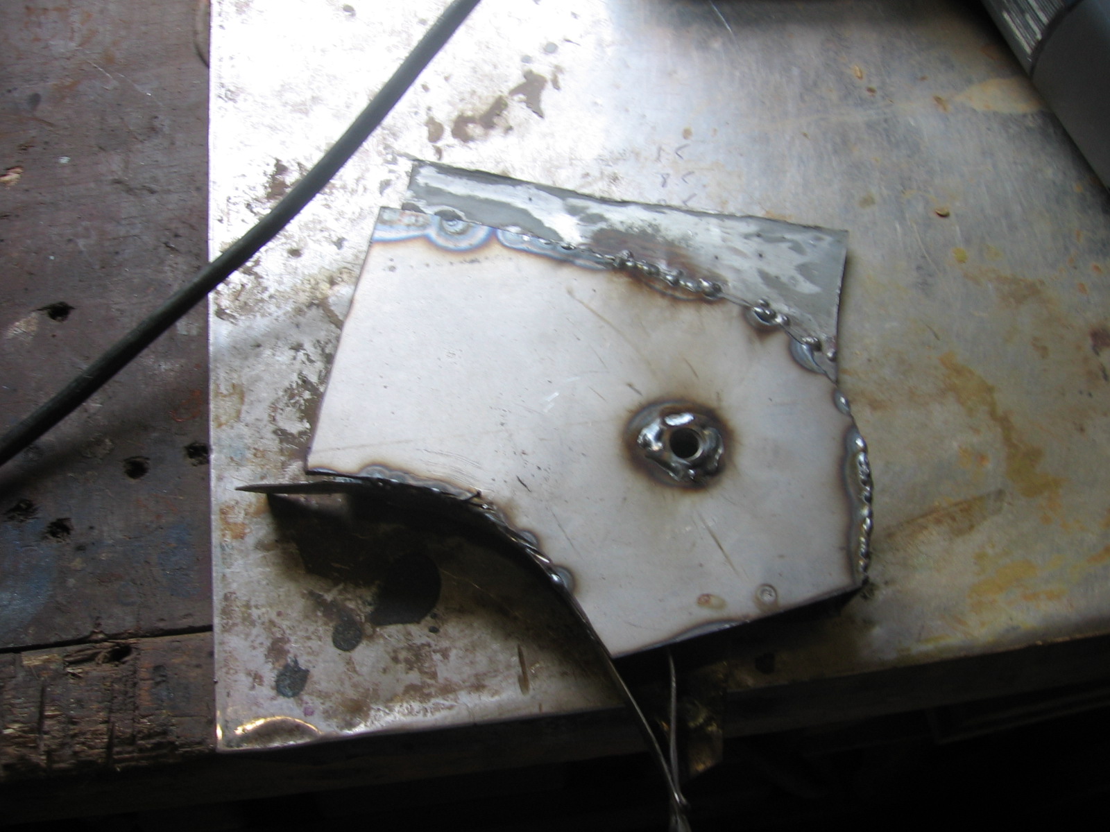

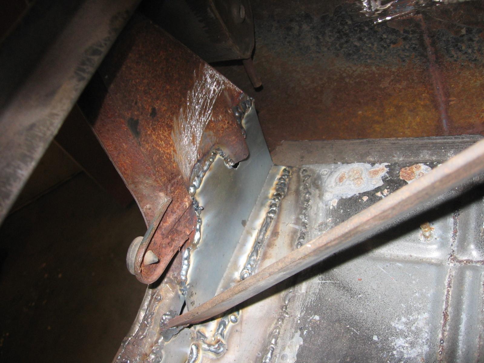

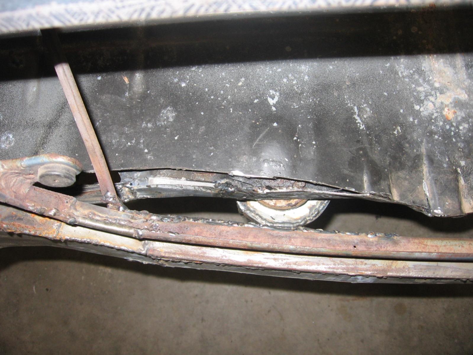

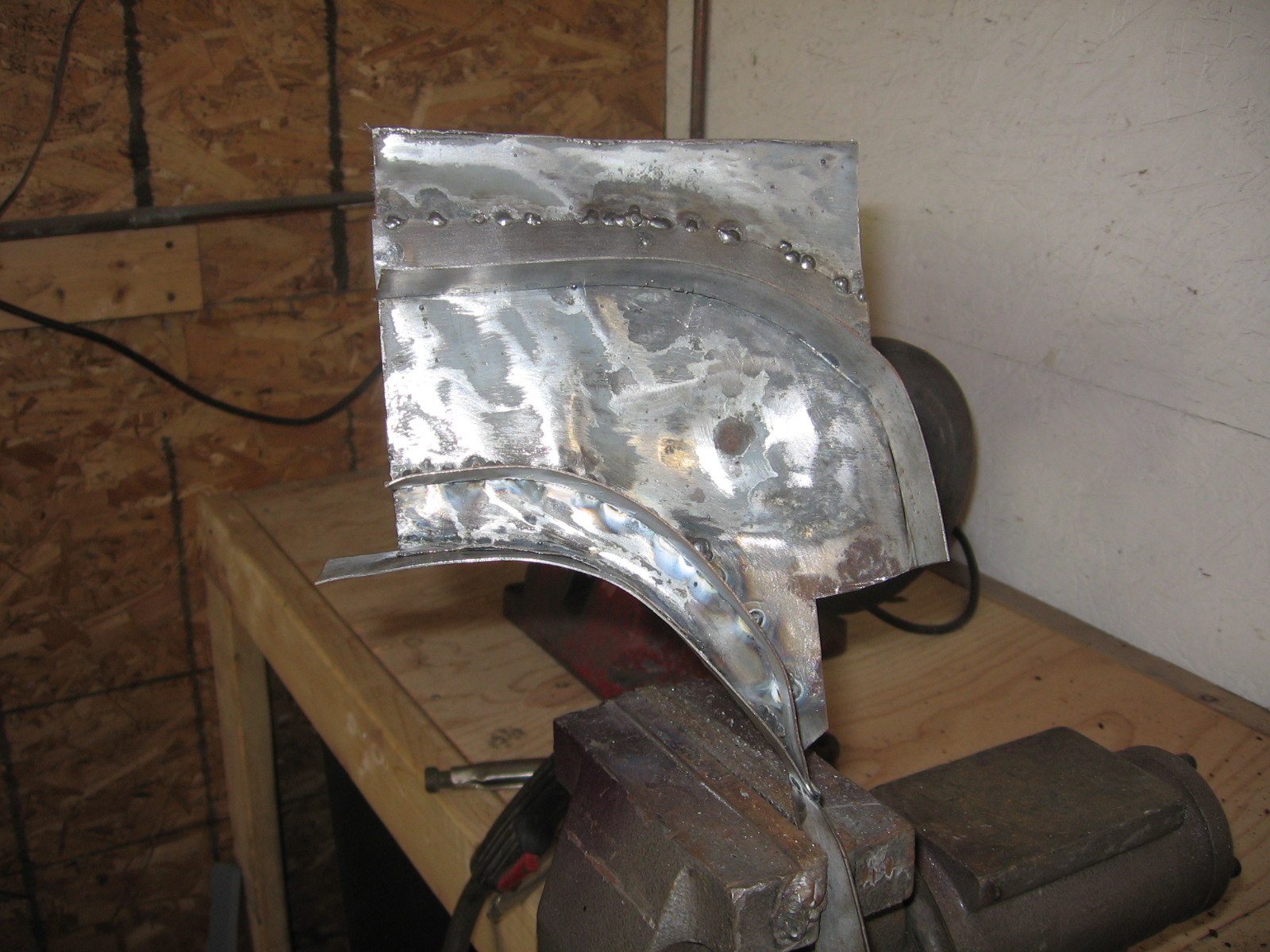

    Just the rusty POS of a body mount before and almost done after .

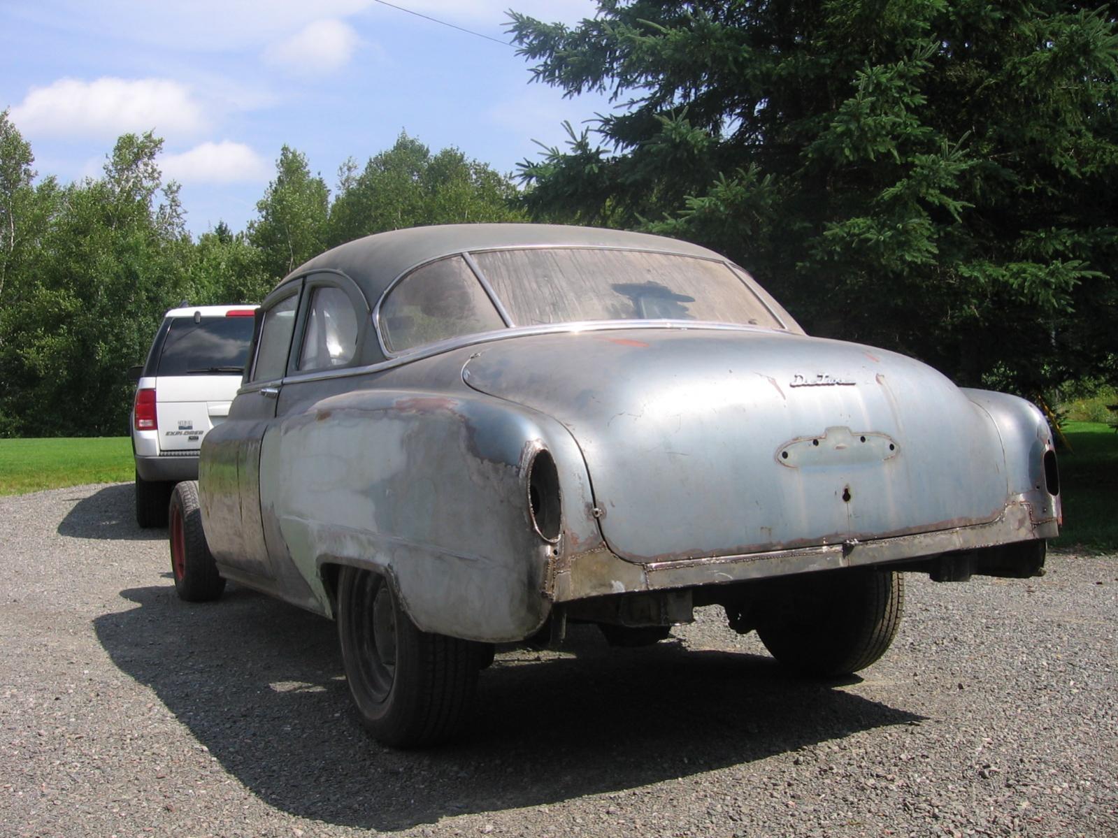

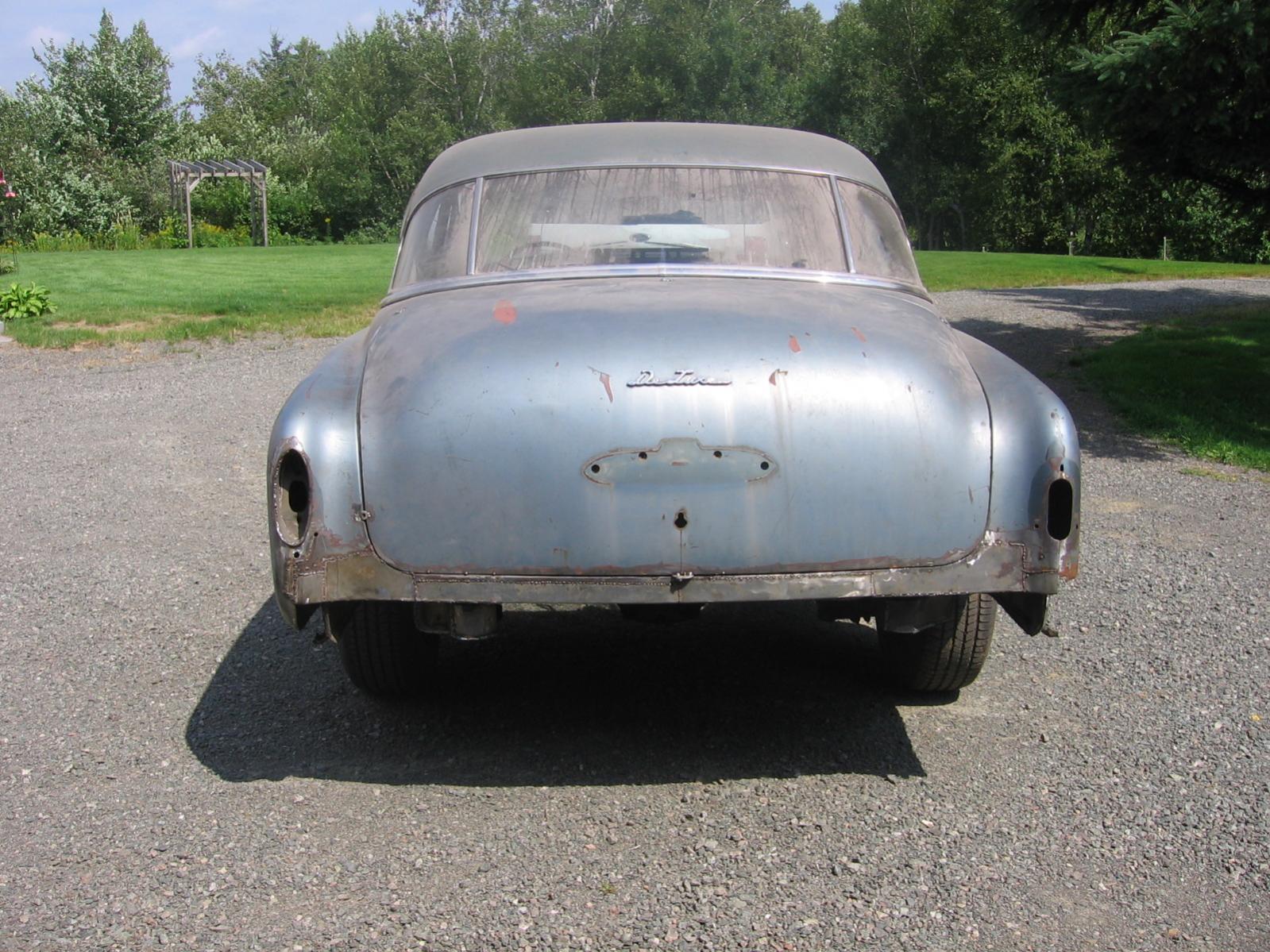

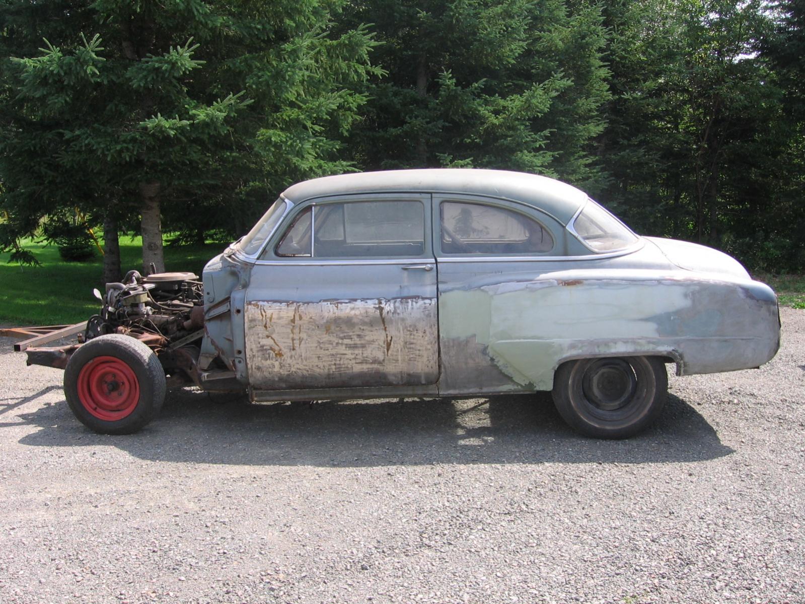

    Rear body mount all welded up and ready to install . Had to move it to the other side of the shop . Why is it that a car takes on a totally different look even in this condition when it is outside ??? Someone photoshop this side profile if you like and post it up here. Chop it up . 2 , 3 , 4 inches whatever you like :rolleyes: . Andy..

    Is that a Ford tail light in that Chevy????;) Man it looks great outside, you're making great progress!

    Thanks boys and yes Rob that is the great looking 49 Ford tailight that is going to reside in this GM . Some might say they will be the icing on the preverbiele cake .
