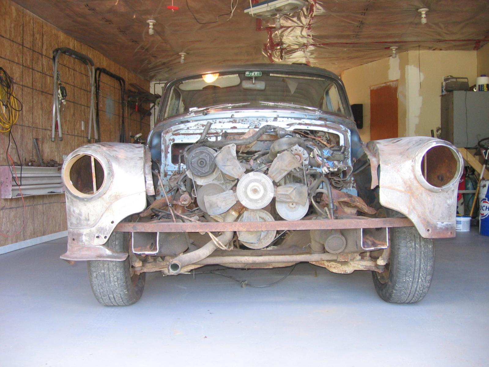

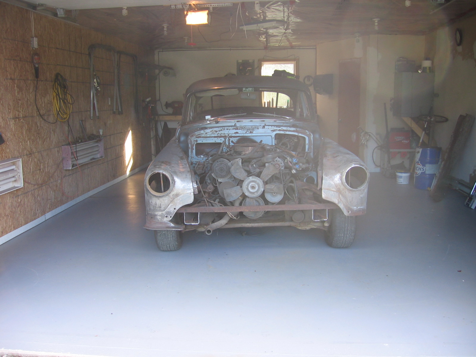

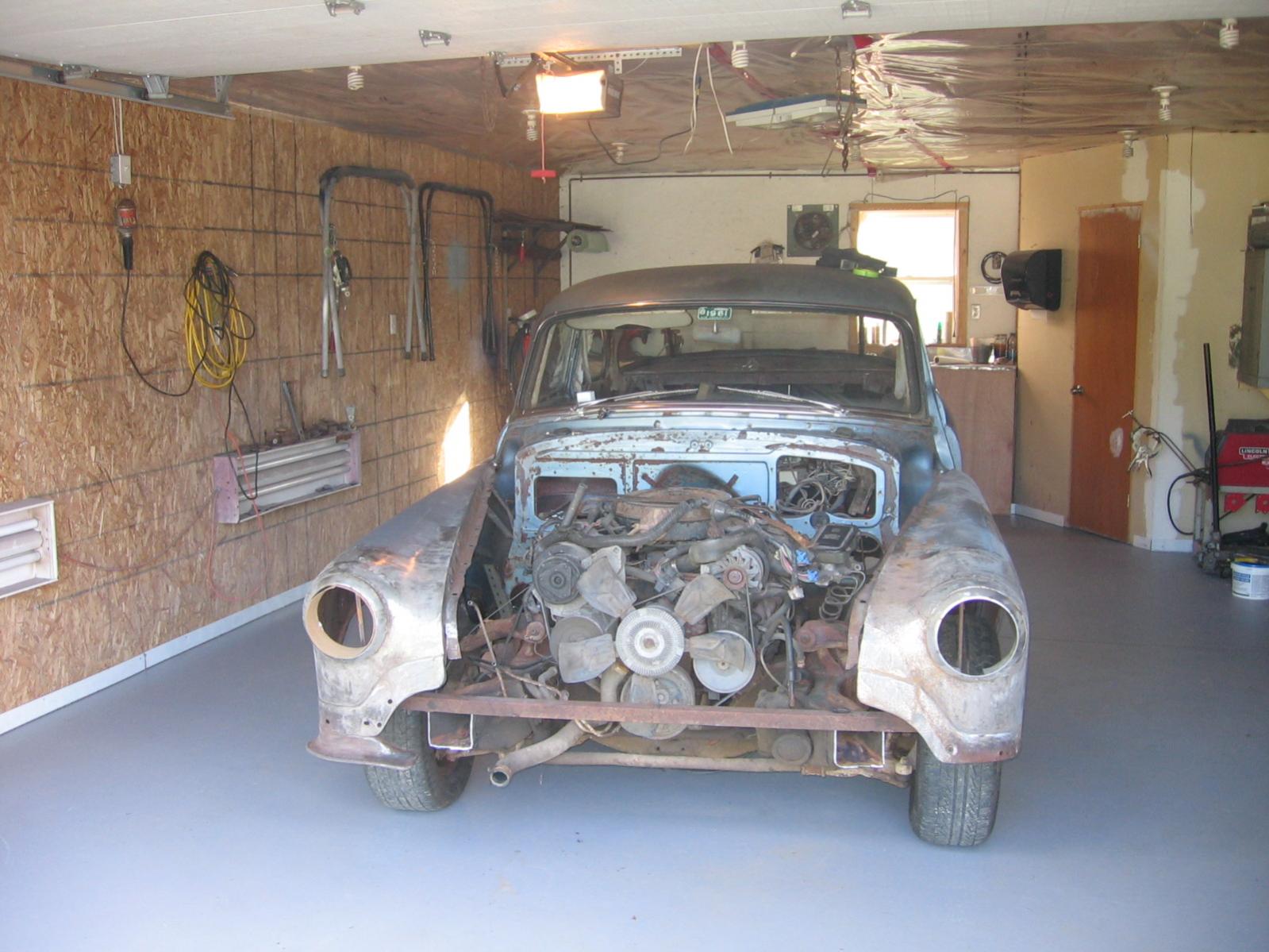

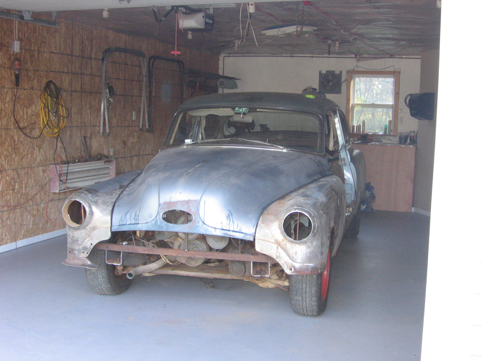

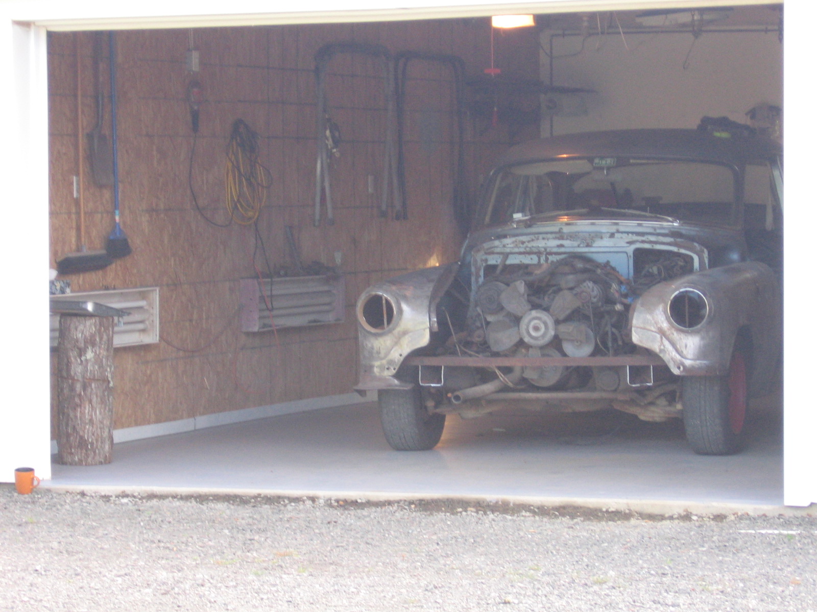

  9. Well its been a few weeks and I have been pretty busy on other things that needed to get done . Holidays this week and I was able to squeeze a few days in on the buick . Ever have one of those days where you worked for hours on something and failed to check the most important thing of what your working on . I am talking about doors , I worked like a dog for 4-5 hours trying to get things to align on the drivers side . I thought there had to be something wrong with the A pillar post . Come to find out the bushings were shot in the upper hinge :rolleyes: . As Homer says Doh!!! Anyway back on track . The car is now all aligned front to rear in regaurds to body to frame alignment . As previously mentioned quite a few posts back I though I had it then but I was way off . Its al good now and with the first mockup the fender to hood gaps are looking right on with just some minor tweaking needed . Heres some pictures in the first mockup with the panels being supported by stanchions . Pretty boring I know but some might enjoy the progress . I will get the door back on at some point and then the real fun begins with making up body supports and floors . Cant wait :D
  10. OOPS the pictures didnt load . Here ya go .

  12. Thanks Eric . I see you are making a shitload of progress on yours as well . I am pleased with the work of the last couple days . Andy

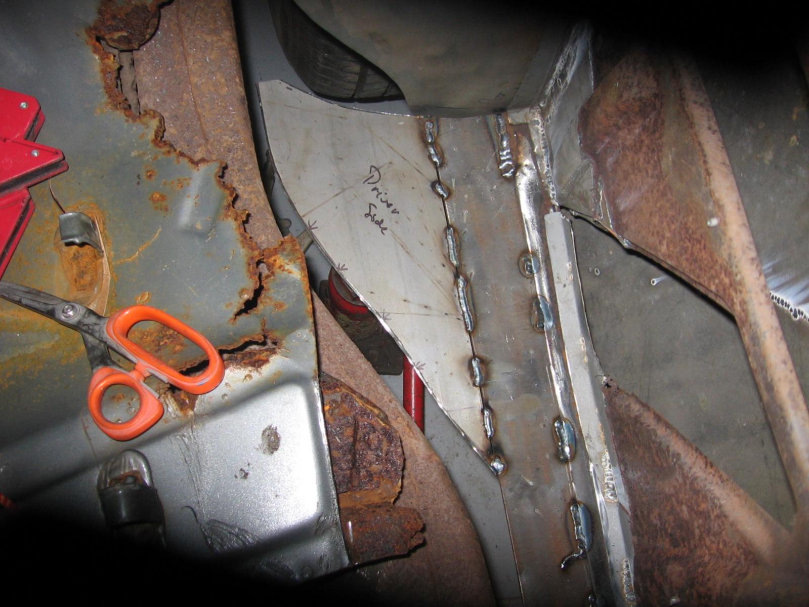

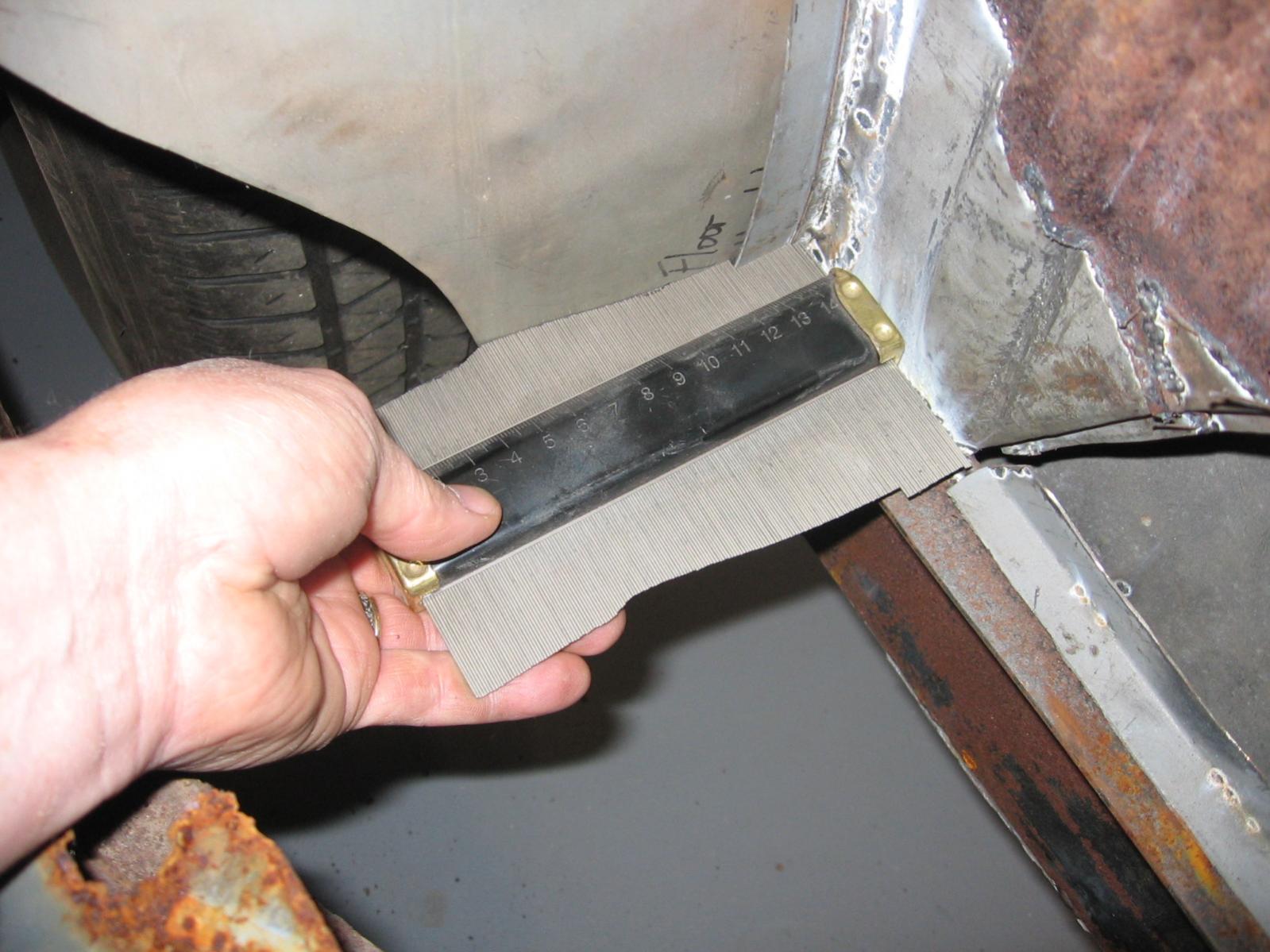

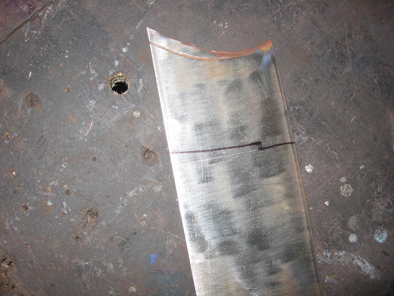

  15. Got some more done tonight . The reconstruction of the drivers side rear by the wheel well . This is 1/8 plate as it will also make a good jack point if I get a flat.I put the Caprice seat riser in place and it will work out just right . The footwell for the rear seat is 7" below the seatriser main surface. This will be my depth that I put the new floorpans at . 3rd shot is of the new inner rockerpanel I installed last winter .I welded a new return to it (1/8 plate)
    More to come . Pics will show the filling of the void and it will be shaped somewhat the same shape of the frame .

  22. Rocco the clearance is not an issue . The wheels turn full left and right without hitting the fenders . Thanks , Andy
