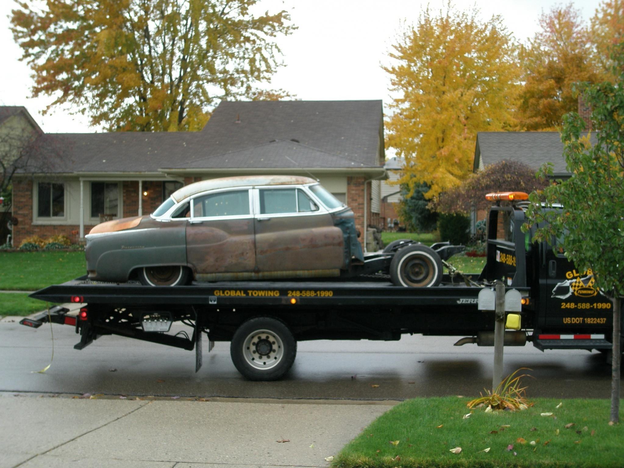

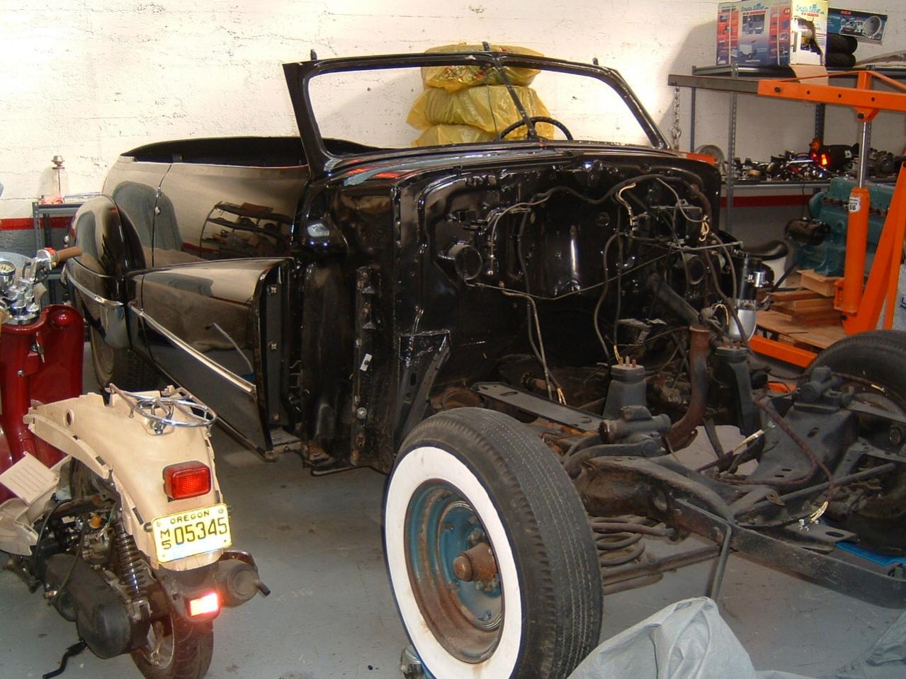

    Here are a couple. When it arrived and mocking up the engine and trans last weekend. I will defiantly be asking questions, thanks.

    Looks like a good start to your plans . I will subscribe to your thread . Post more pics when you can . What did the guy use for a frame ? Andy..

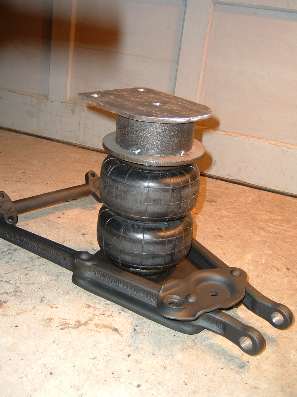

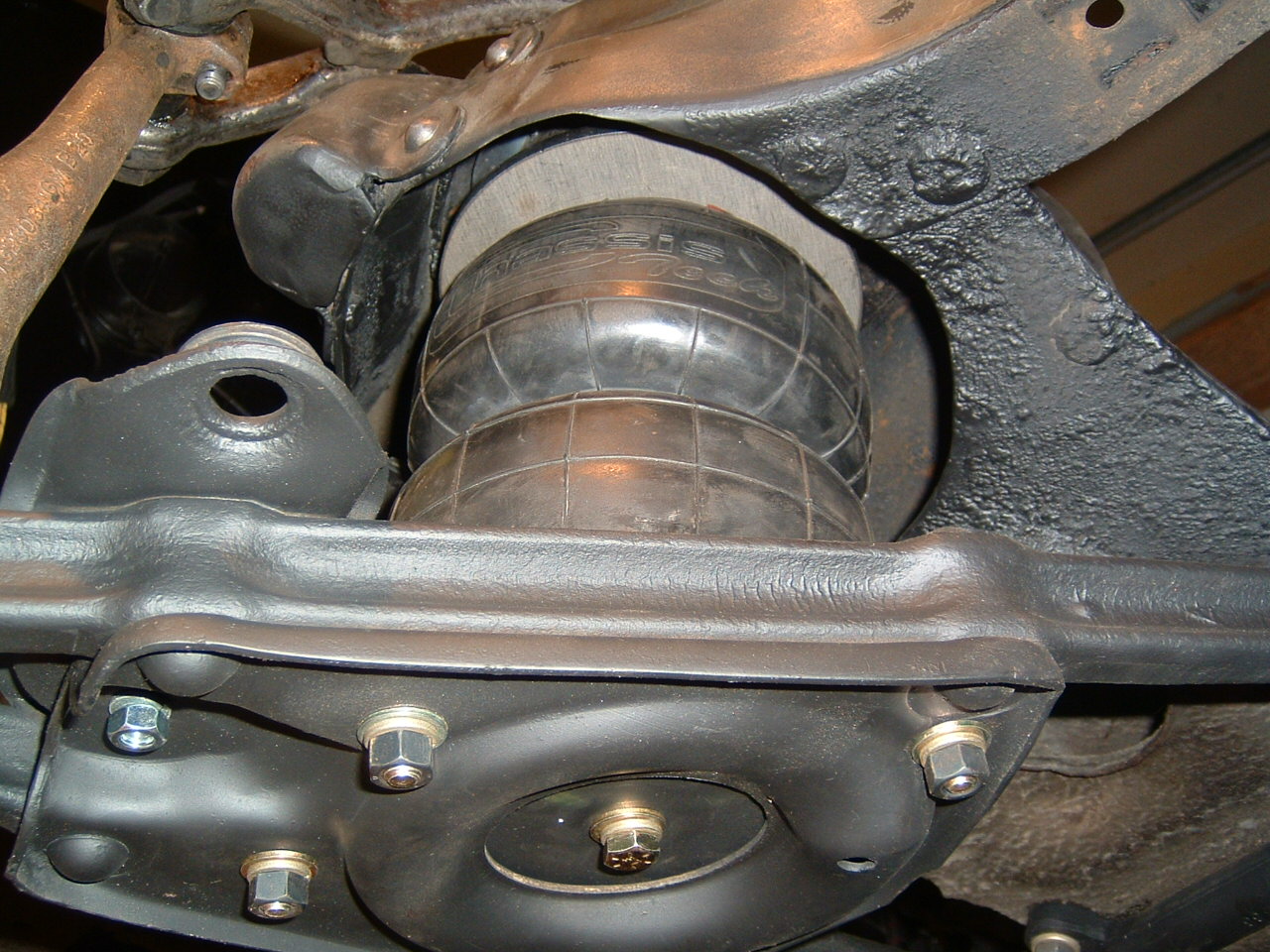

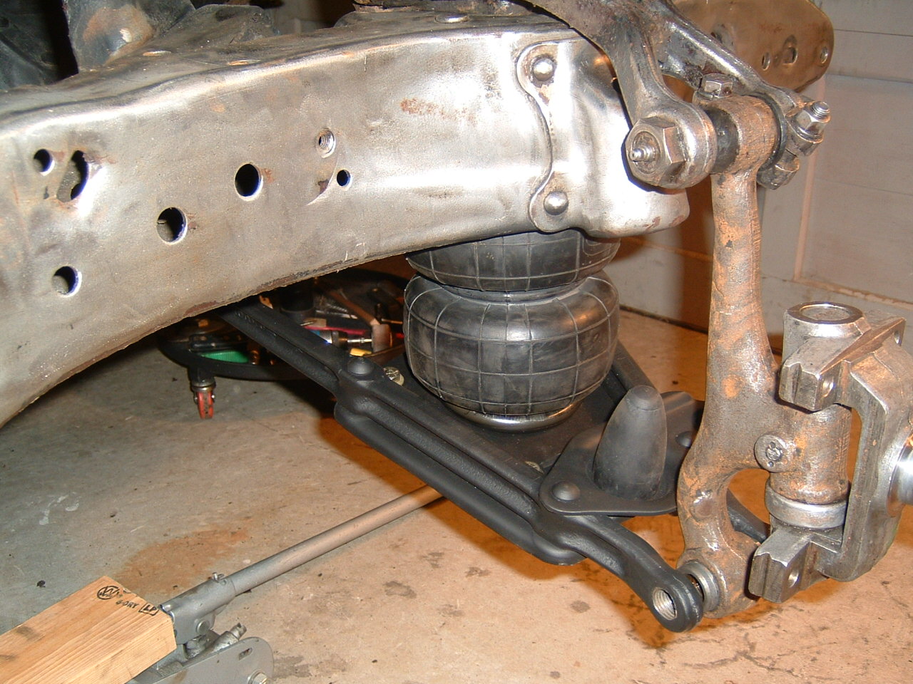

    Andy...Attached are some pic's of my car. Most of them are the first time I went to buy it. The rest are of the upgrade to air bags on the front end. I need to take more pic's since I have come quite a ways since these were taken.
    Let me know what you think.

    Wow Dale that car will be sweet when you get her all back together . The paint looks real good from the pics. Wish I had the coin to bag my car as well . Not a priority for me right now as you can see LOL !!! Andy...

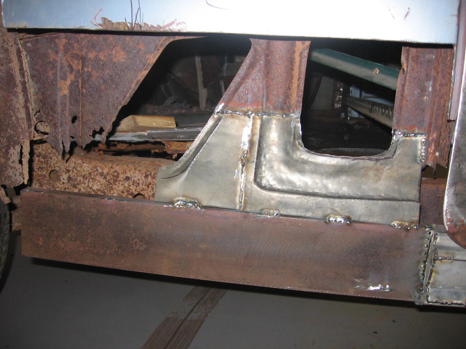

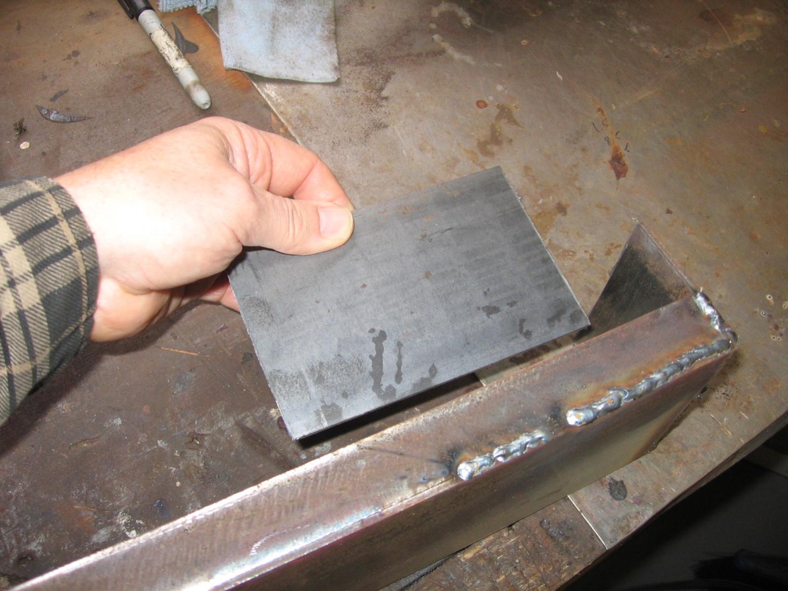

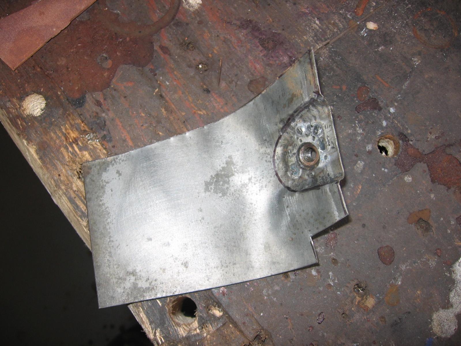

    Was able to do some work today but man this stuff is slow . Cut out the bad stuff on the A pillar and had to make all new lower part of the pillar . Have a look . I had to weld a nut to the backside of the panel for the lower fine thread screw . The cage nut was long gone so I just measured and welded the nut in place . After about 7 hours of work today this is all I was able to accomplish . :mad: More to follow in a few minutes . Andy...
  18. aw1950
    Joined: Dec 21, 2008
    Posts: 1,511
    aw1950
    A few more from the work of today . Some of this stuff makes you just want to pack it in somedays . Imagine I have to do this all over on the p***enger side . :eek: Andy.

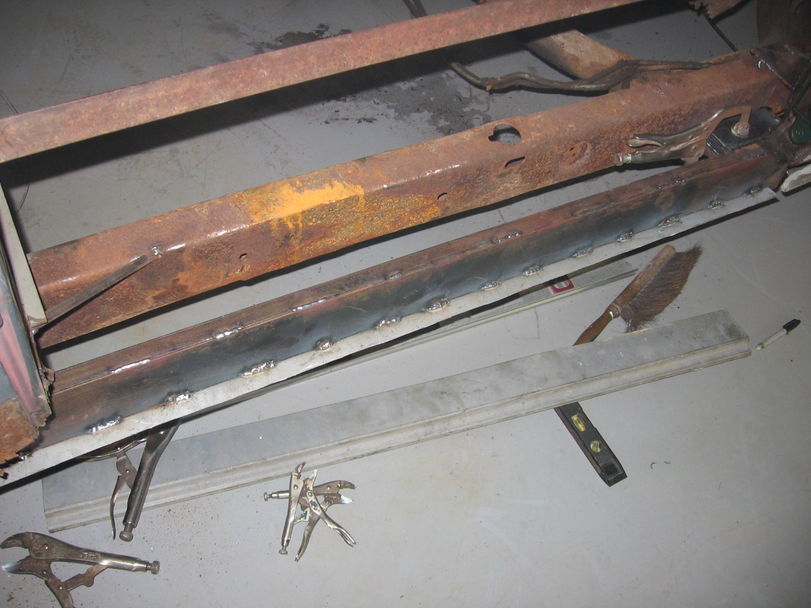

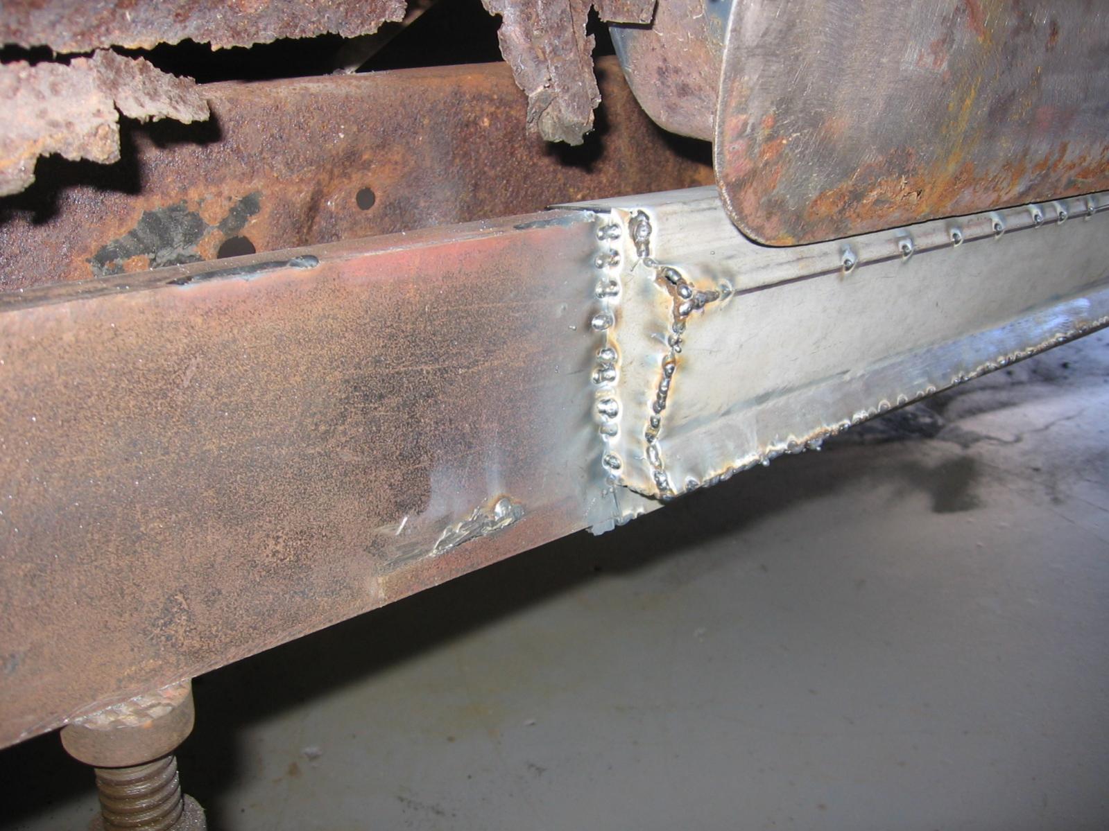

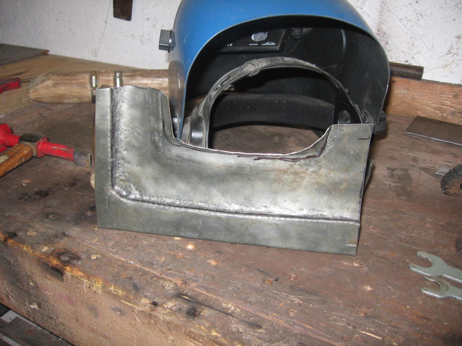

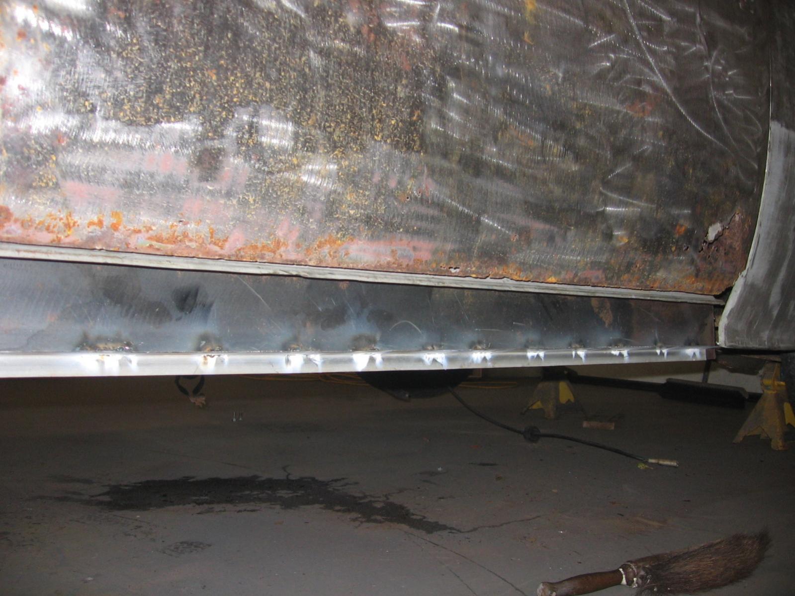

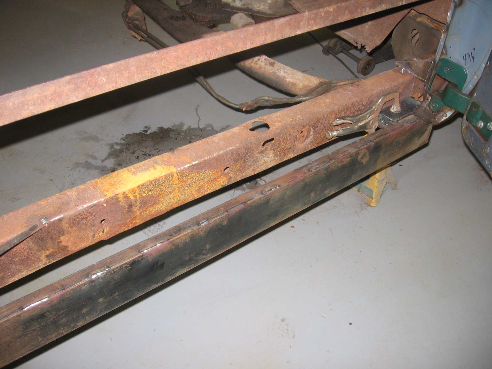

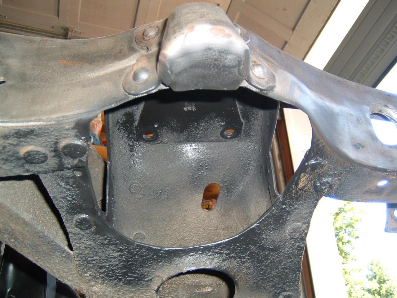

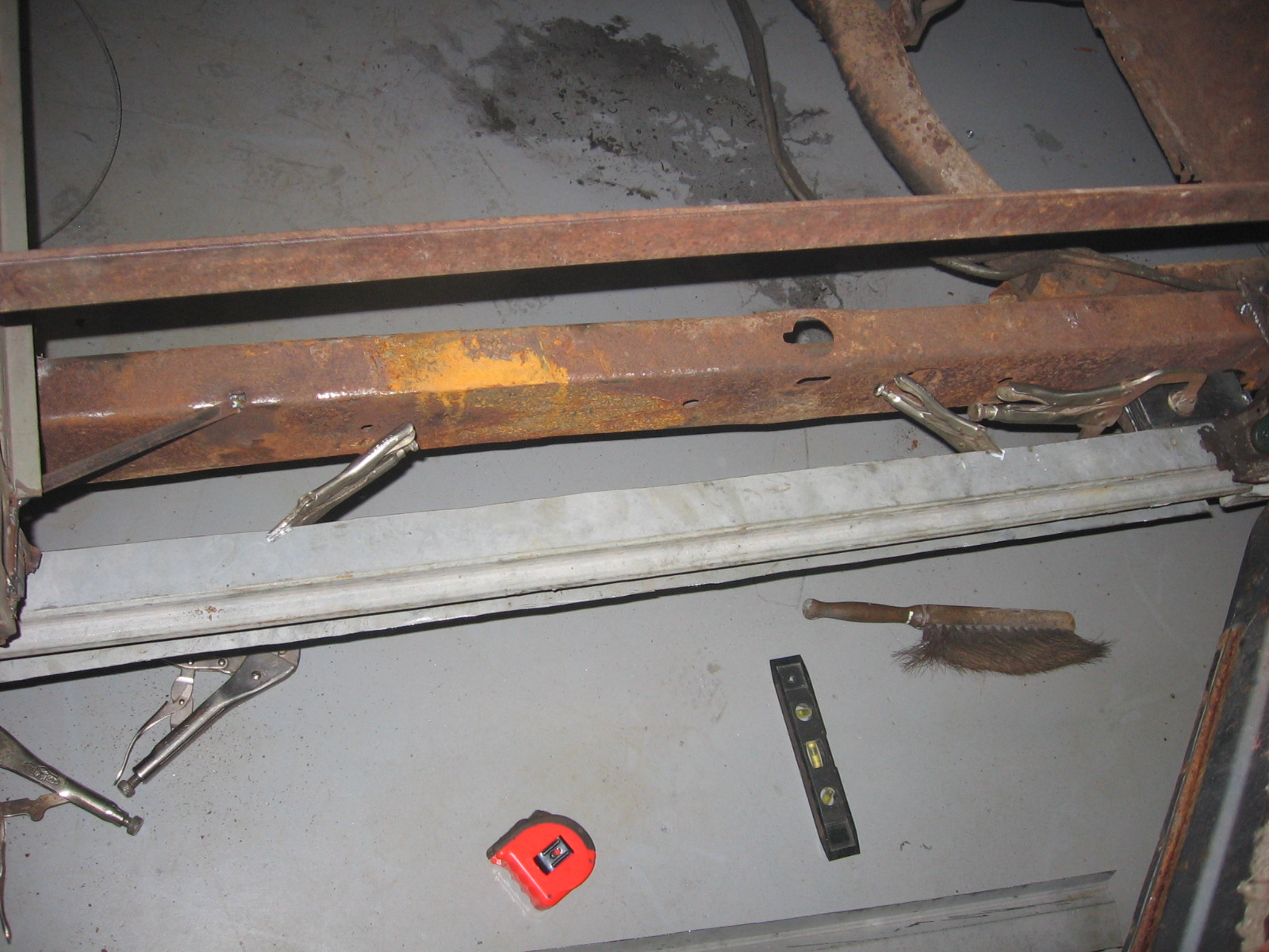

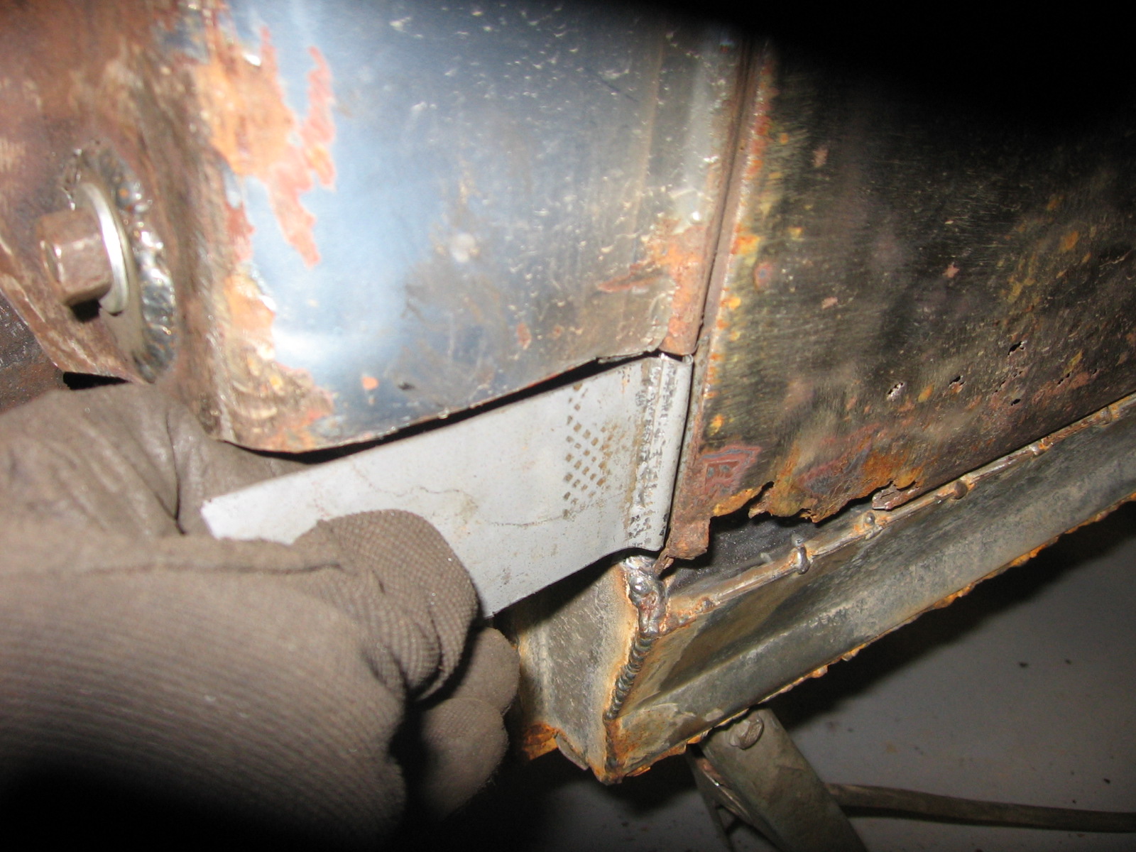

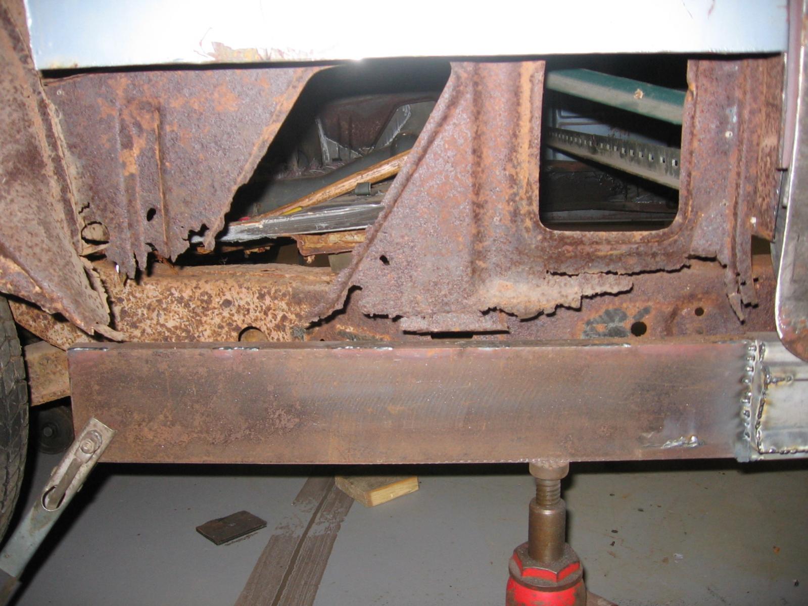

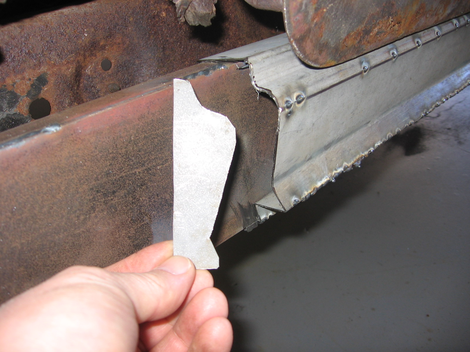

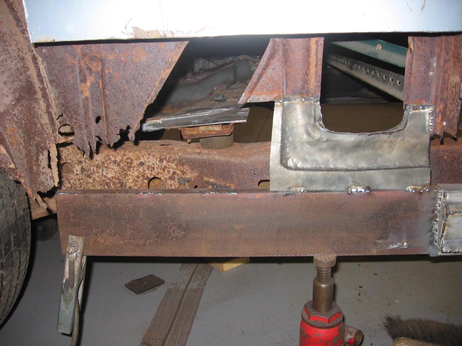

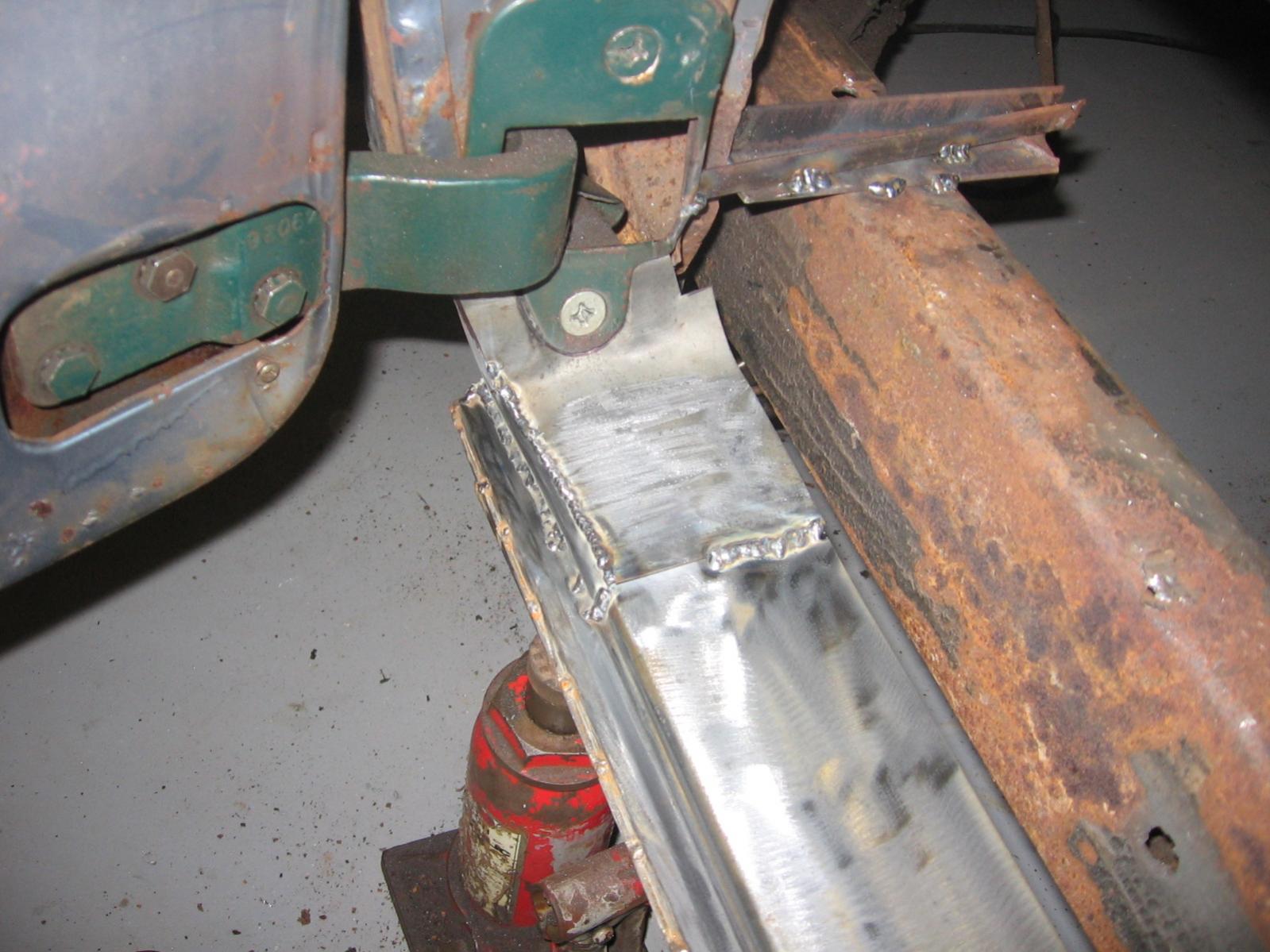

    Well a little more got done . Pissin down rain , might as well be in the garage . I am in the process of rebuilding the p***enger side inner and outer rockerpanels . I used 1/8" x 5" plate for the inner rocker and 1/8" plate x 1" for the return. I welded onto the side of the frame the new body pads that the body will bolt to . You can see one finished in the previous thread. I have yet to drill 1/2" hole and bolt it down but you guys get the drift I am sure . The 4th photo shows the inner rocker clamped in place . I then welded on the bottom part of what will be the rocker panel pinch weld area . I welded it on before I ****on up the front face of the rocker . The previous owner had two rockers made up but they were too big for this application although they the correct shape I still had to cut them up and weld them back together .The last picture is of the top part of the rockerpanel at door opening ( sill ) This is as far as I got today as there was lots of measuring on this side . !!! Andy

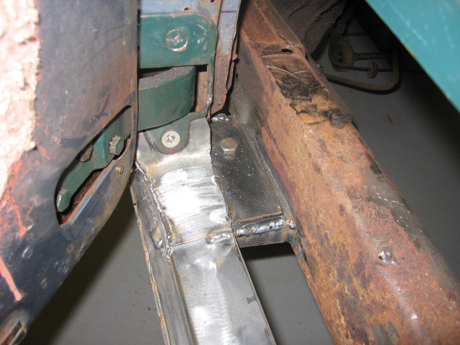

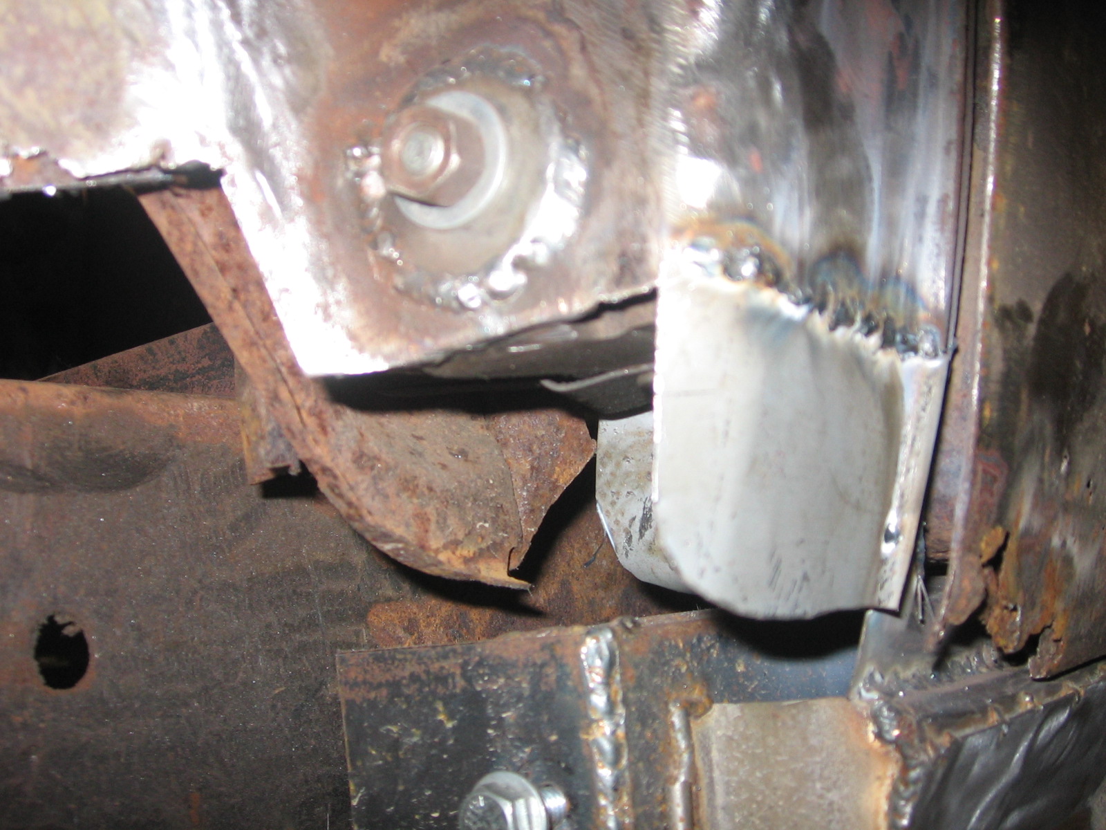

    Updates from Saturday Oct 8 . Frame pad on the p***enger side and then clamped the inner rocker in place , door gap looks good . # 5 the outer face of the rocker is welded into place . Fits well . And then I capped off the rocker end . I will weld a new quaterpanel from this point back . More to come . Andy...

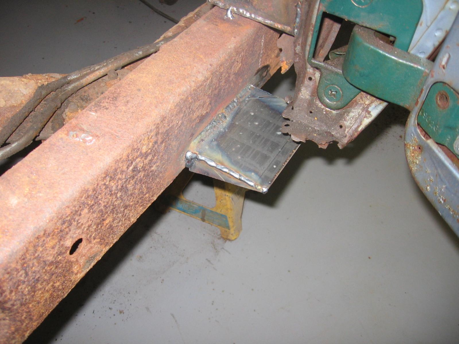

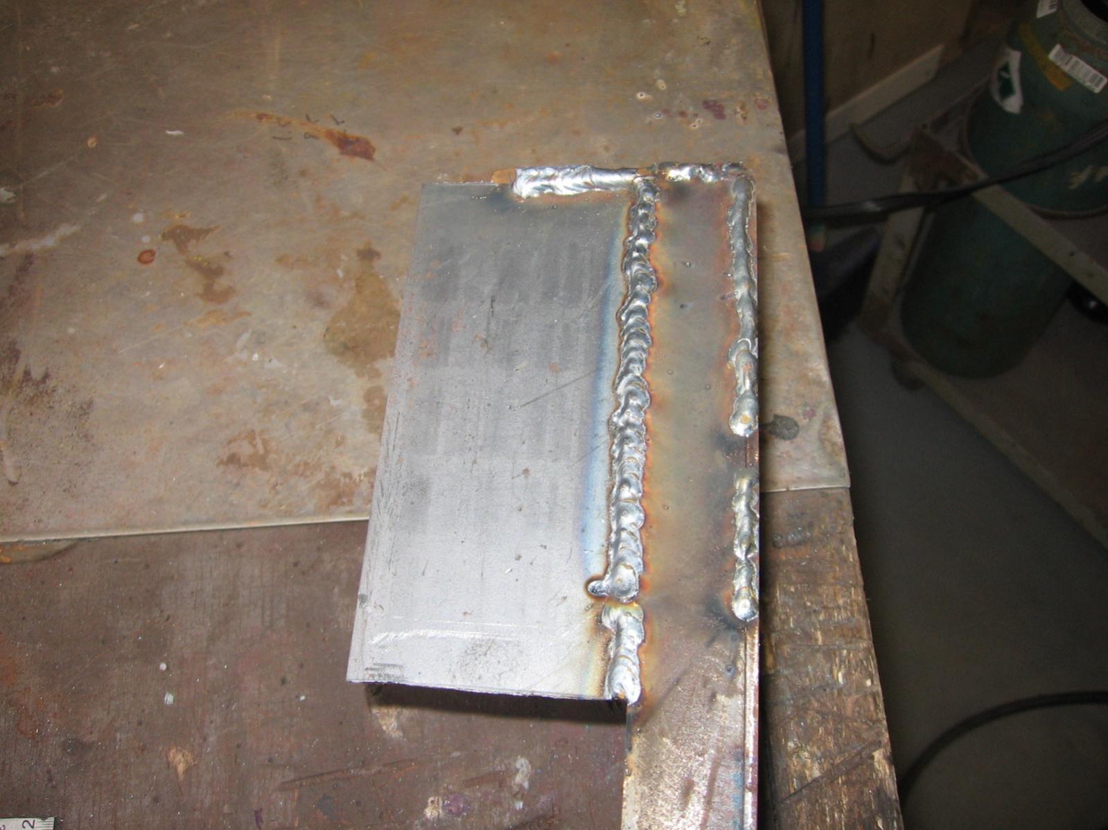

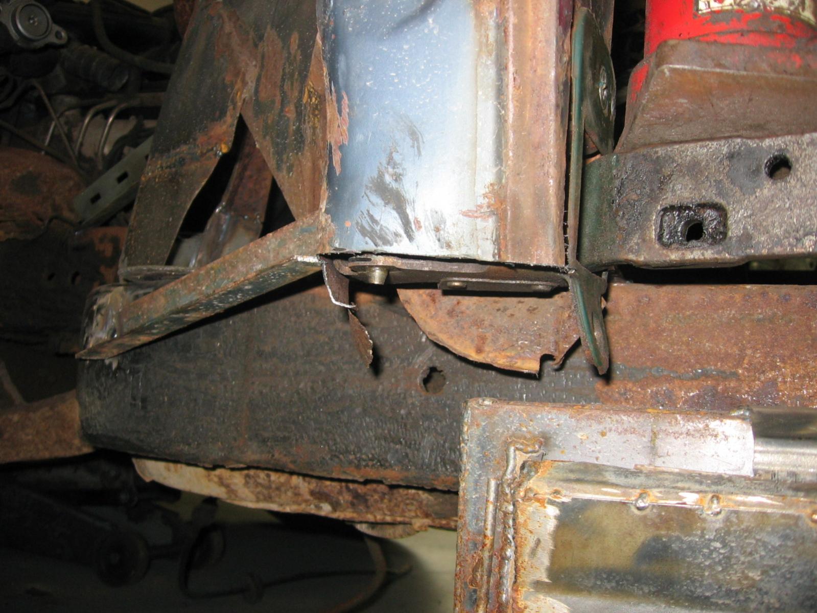

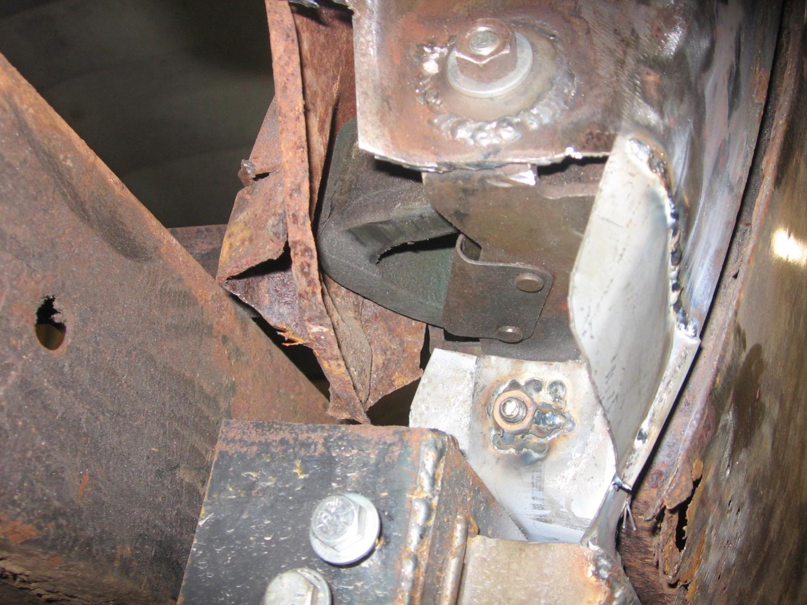

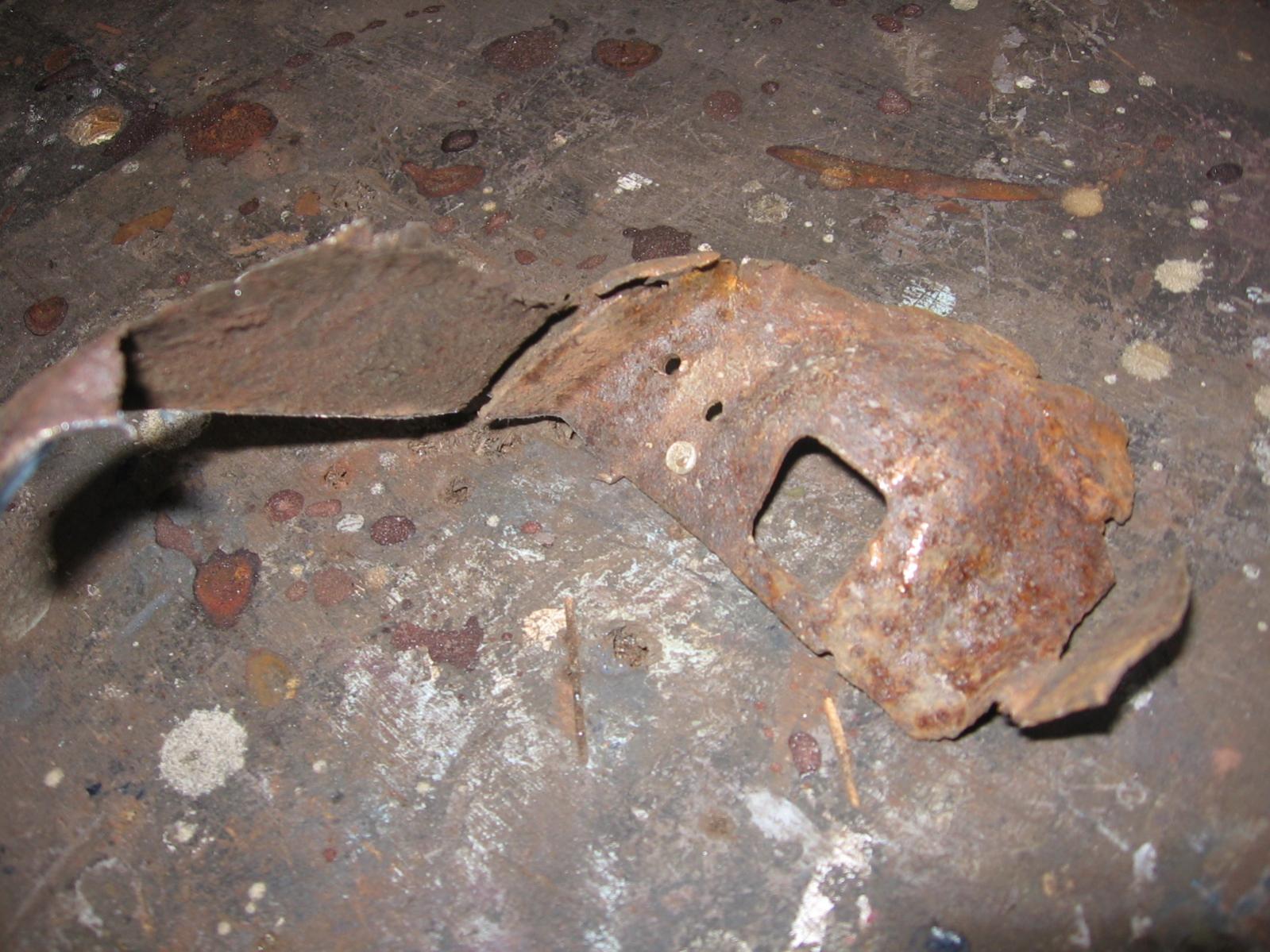

    More from today. What a mess . This is the inner structure that is at the B pillar post to the rear wheelwell . Not much left but enough for a pattern . I had to make this in two pieces then weld it back together on the car . Its coming along . Took about 2 hours to fix this up . Not to bad . No sence getting to fussy as it will never be seen .
