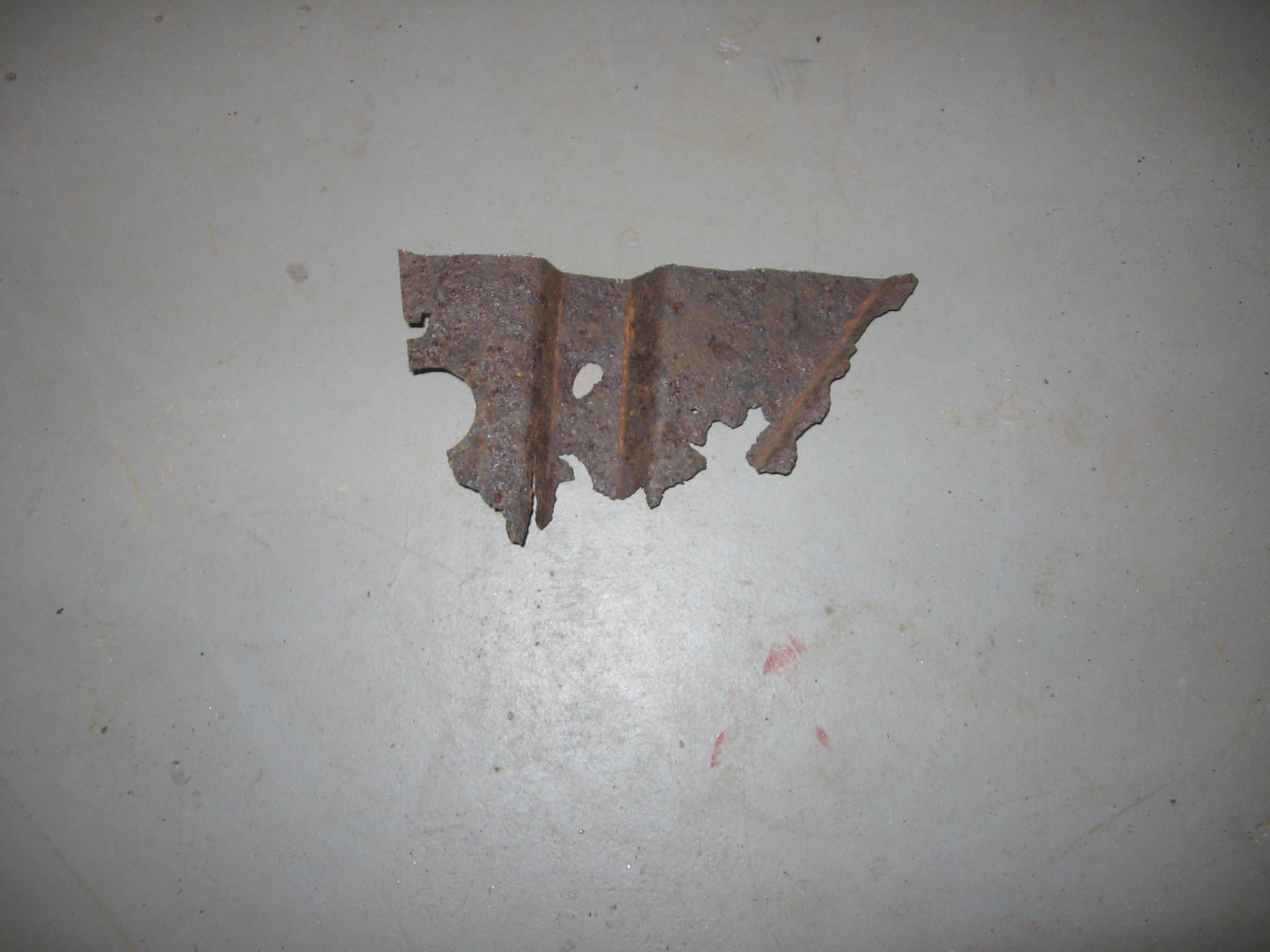

    Just a small update for those of you following along . 2 Hours spent just replacing this rusted piece of **** . It is 7" x 9" , so not big at all but 1 1/2 hours cutting and hammering into shape and 1/2 hour welding into place . The car gets stronger with each panel that gets repaired . Working away one hour at a time :D . Again no need to be to fussy in here but yes I agree with 48superconvert that it will make outer skin easier to keep straight when it comes to doing so . Andy..

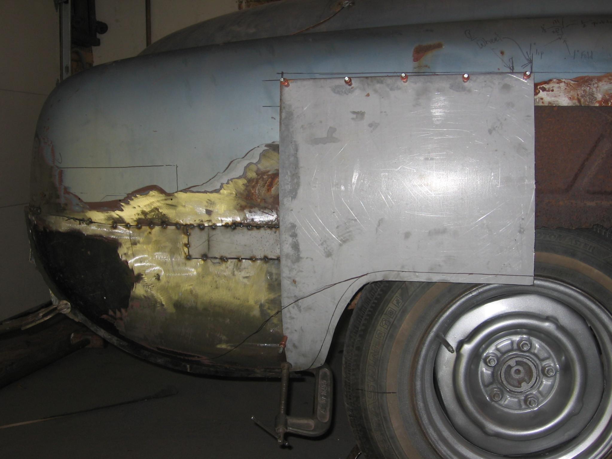

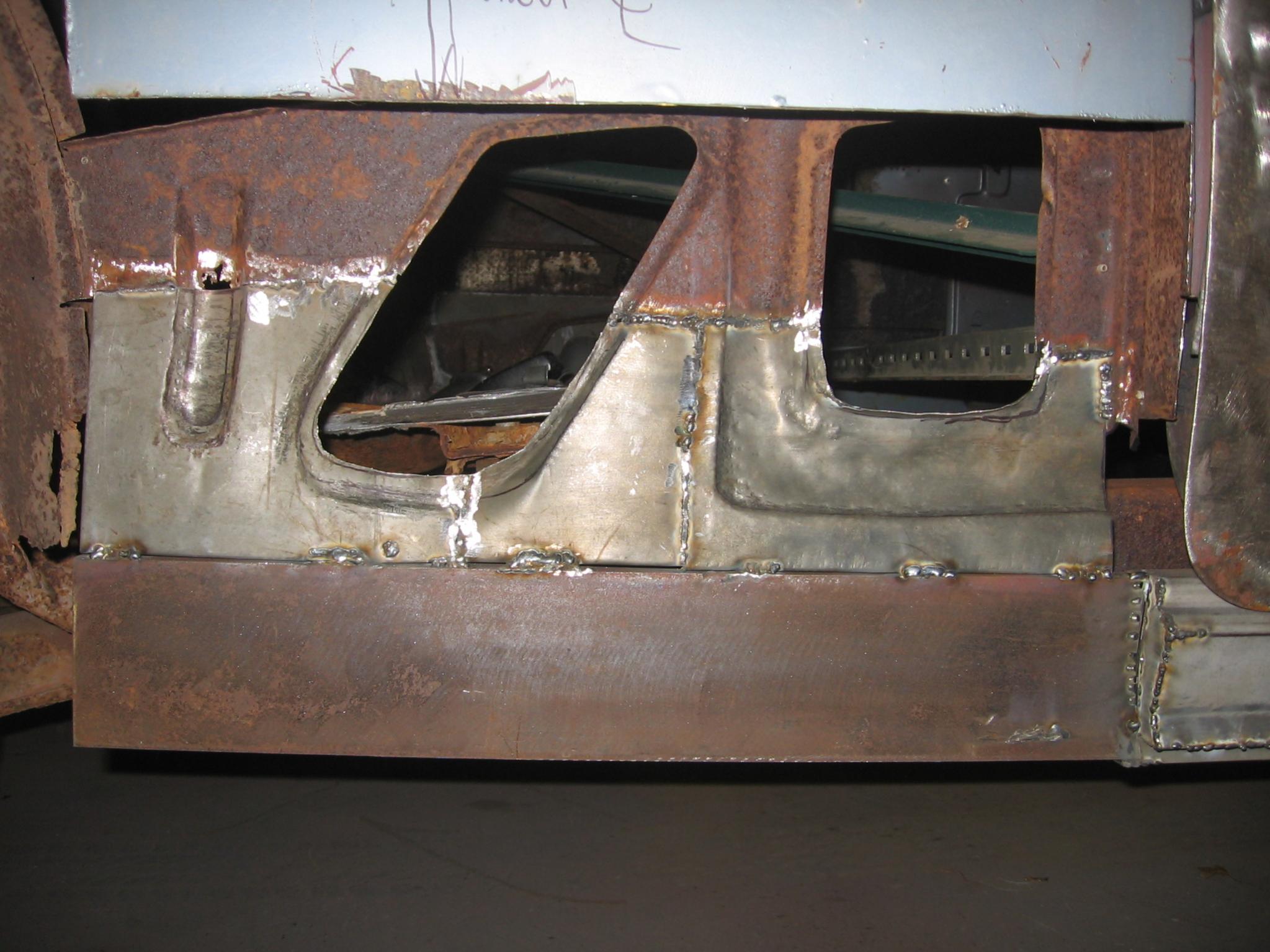

    Well its been a few days and I got a little done on the Buick . The last picture post showed the B pillar inner structure in place and welded up . I made up a panel that will cover from the door opening to about where the wheel opening will begin . I think I am going to make the opening like a Chevy quarter of the same era. Its flat and easy to work with . Can bend one up in no time , we'll see ? Anyways The panel was stretched over the beaterbag to give the rolled bottom edge that is on the Buicks .

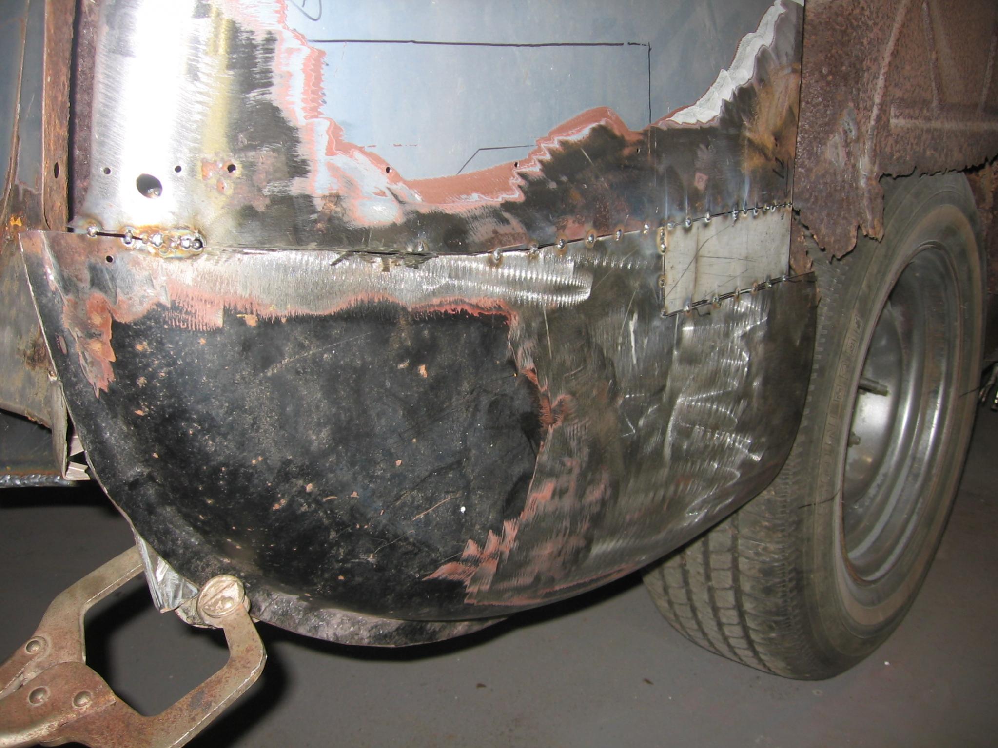

    Next is more of the same in regaurds to the rust issues at the wheelwell and rear quaterpanel . At the rear of the panel is where I get a little creative . I am using the top section of the 52 chev donor quaterpanel to give me my needed lower return for the buick . I know it looks a little funky right now but I have to put the rest of the panels in place first before I say one way or the other . I think it will be fine though . I am going to use the early 50s chevy wheel opening on this side as they are very basic and easier to cover over if I decide to run cruiser skirts at a later date . What do you guys think should I continue s***ching her up ?

    A few more pics. of the return . Andy

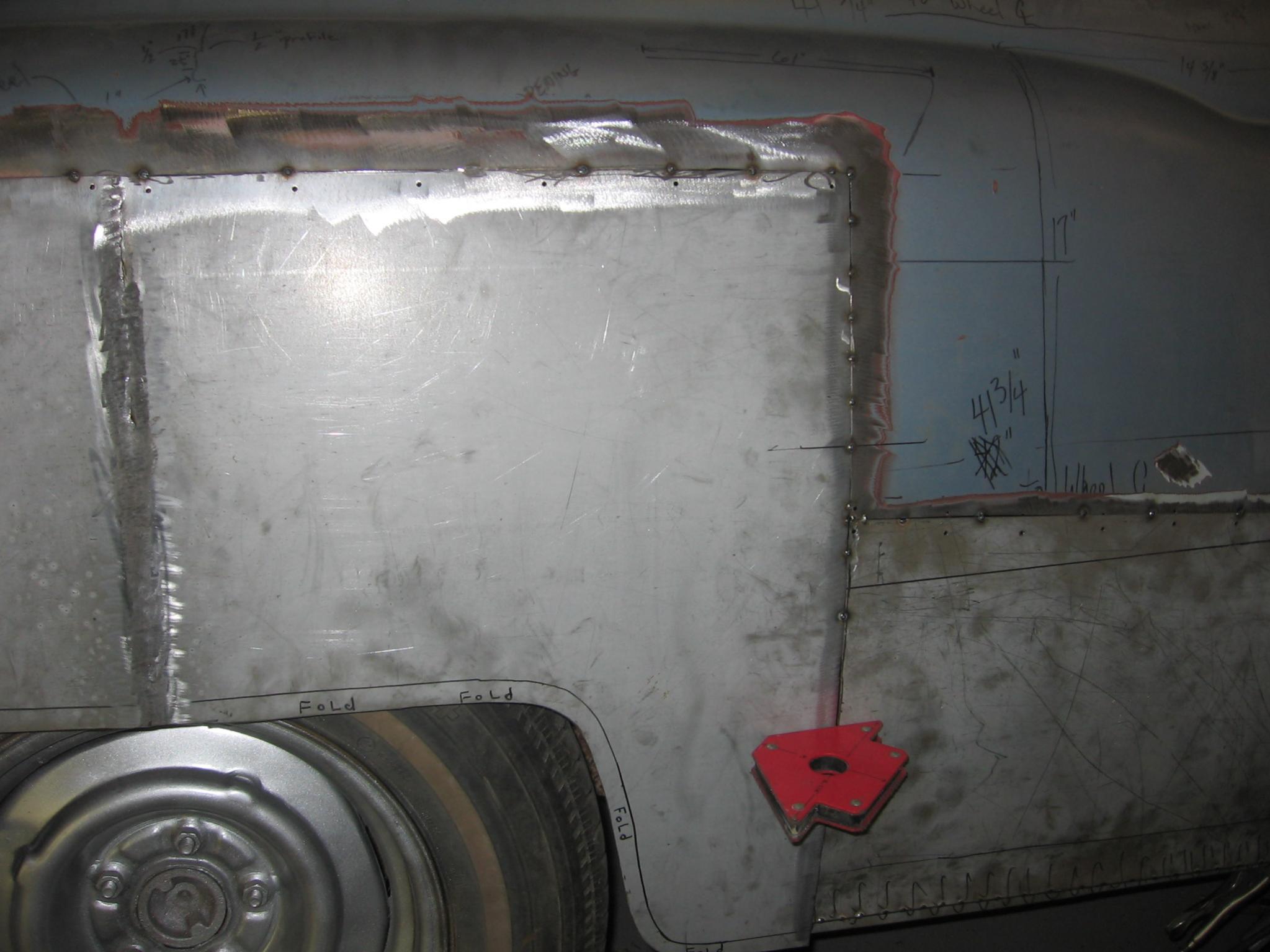

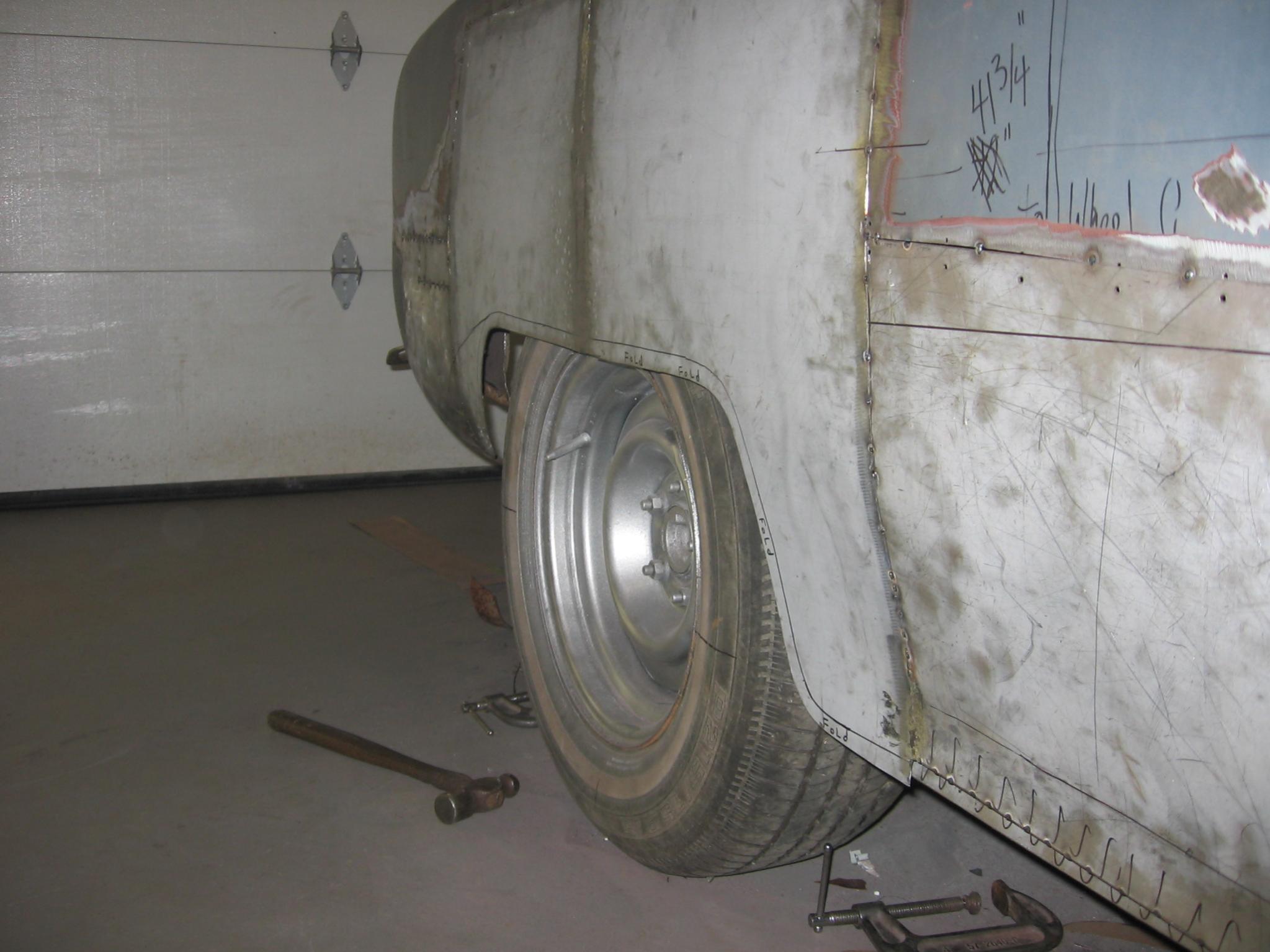

    Got some more done today . This holiday thing is great . I get some work done for the wife and then its garage time . I still have another week so it will be busy for the next week with the posts. I worked on the quarterpanel tonight and got it all in place and tacked in . It looks pretty good . I wish I had a english wheel though as there is a compound curve in these cars thats hard to achieve without one . All I can do is all I can do . I can put some pressure to create the correct bow in the quarterpanel when I get the car on the rotisserie . I have the plans and some material to build one in the near future . This is the only way that I am going to get the underside all tied in as well . I will use it for this project and then sell it to finance the car some more . I still have to fold the lip on the quaterpanel . I will have to remove the wheel to get this done . That ought to be fun as I know that there is clearance issues still with the tire , brakedrum , wheelwell . Andy...
    PS the third picture is of a panel puller that I am using to align the panels when tacking in place . Might as well use the cleco holes for something .
