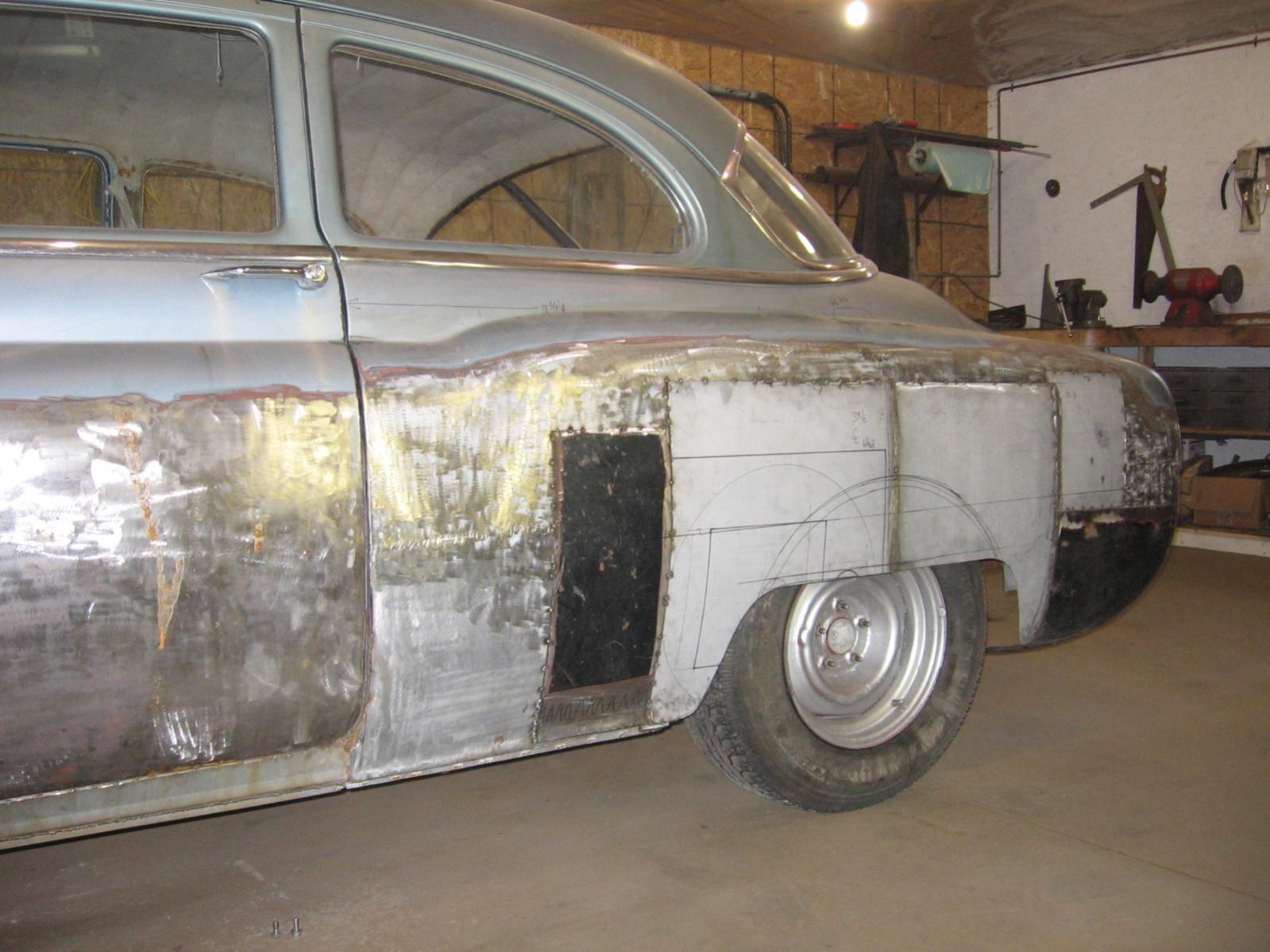

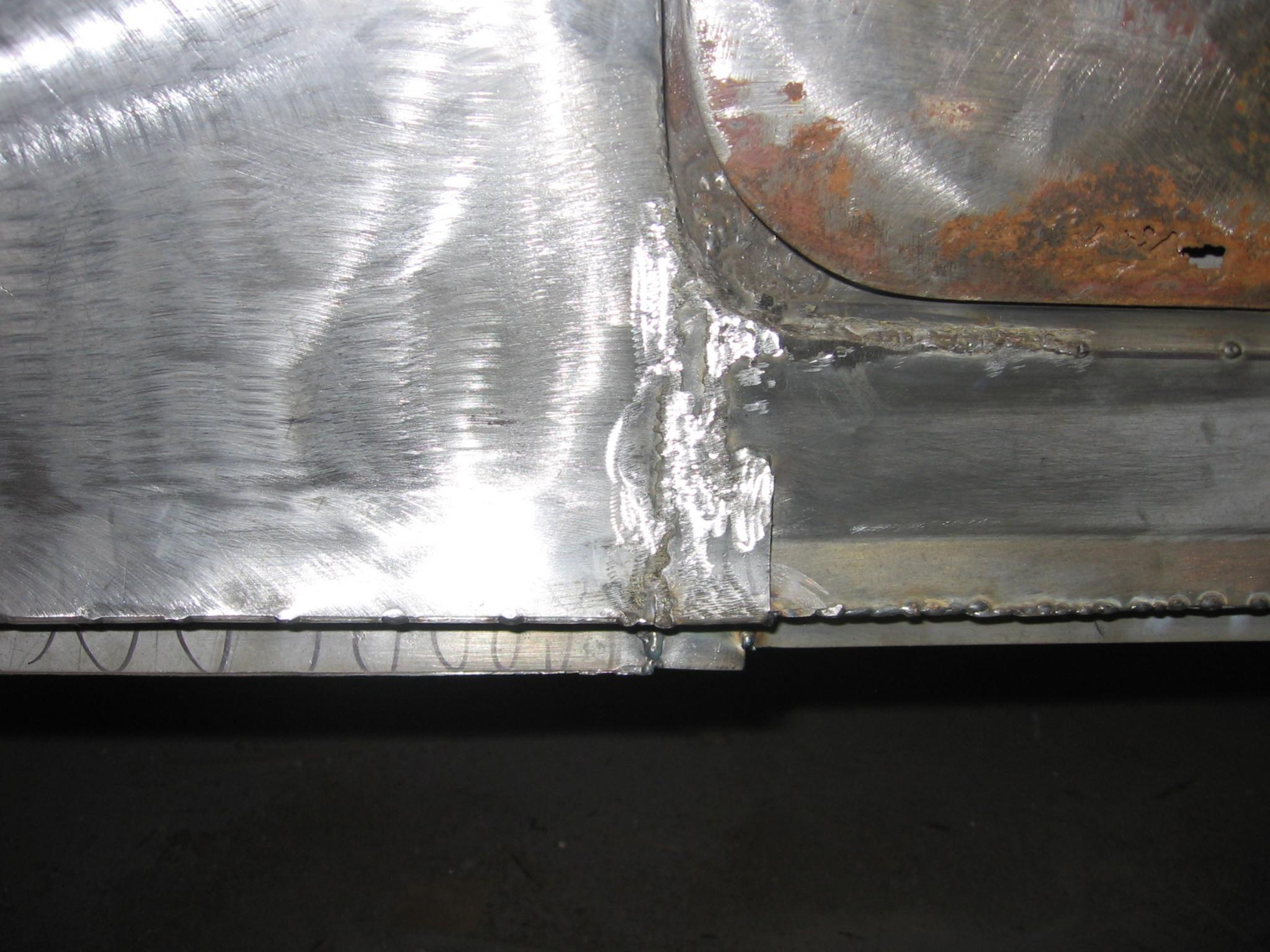

    The last few days I have spent off and on working on the car and house maintenance :mad: Thats not what holidays are for !! are they ??? :eek: Anyways still plugging along on the door opening return and transition from quarterpanel to rocker . Have a look .The first and second pictures are of the donor return channell off of the 52 chev coupe donor car .Third and fourth is of the piece welded in place. Five the rest of the repair panel for the main part of the B pillar to rocker panel . Six is the huge gap that needs filled and the fillar panel made for the gap . Andy.. PS How do you get more pictures than seven on the thread at a time ???

    Filler piece finished and welded in . Preliminary grinding of the welds done . Looks OK to me . I know its hard to see but I am going to have to make a strip the whole length of the rockerpanel , about 2 inches wide and shaped for the body reveal line at the bottom of the panel . It lost its shape bad when I was building it . The angle is way to sharp where it should be more of a shallow swoop !!! Also I know the door corner needs more work too. Way to much of a gap . I will have to play with the adjustment of the door some more before I weld anymore on this corner . Its all the little things isn't it ???? Andy..

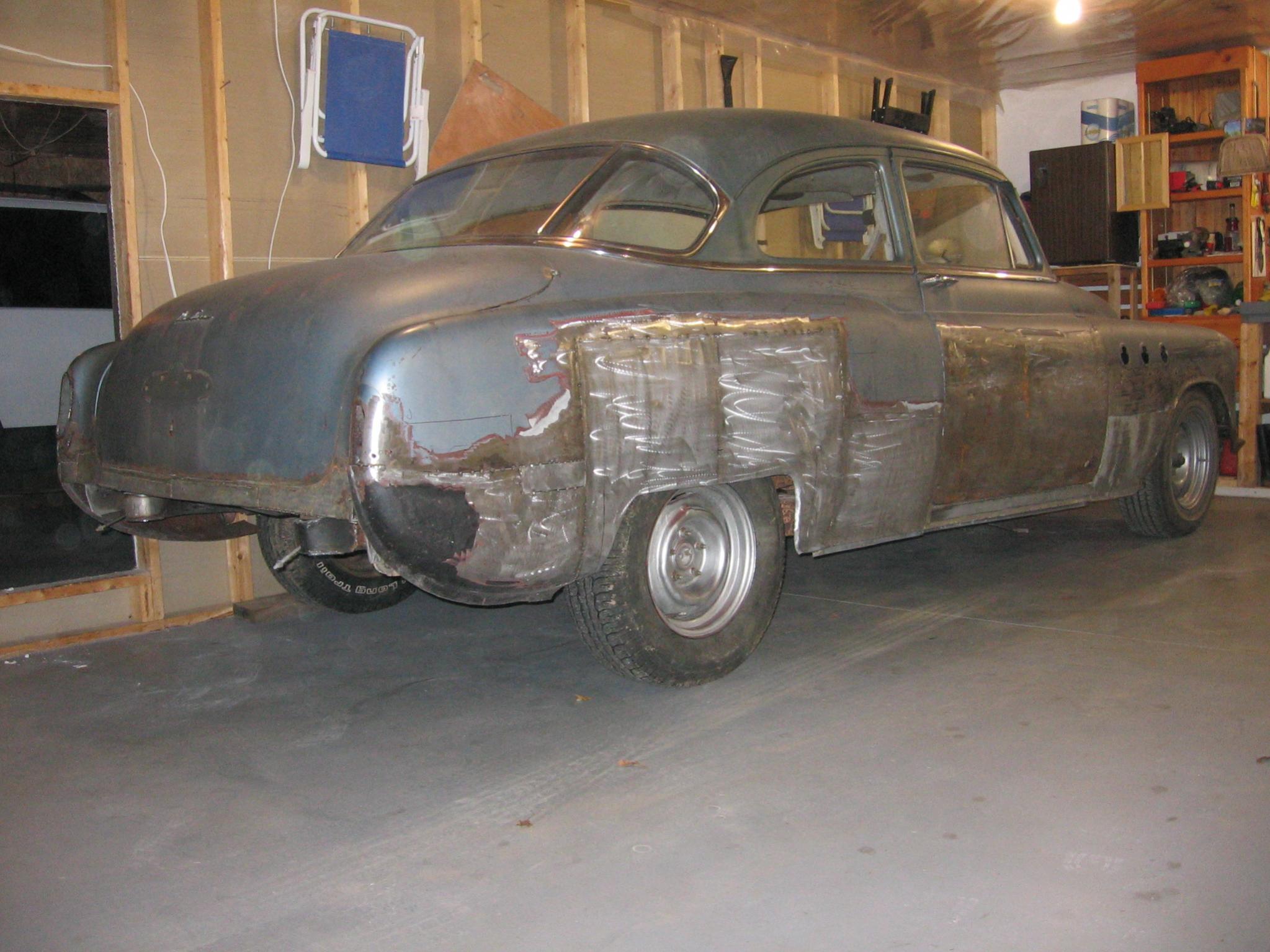

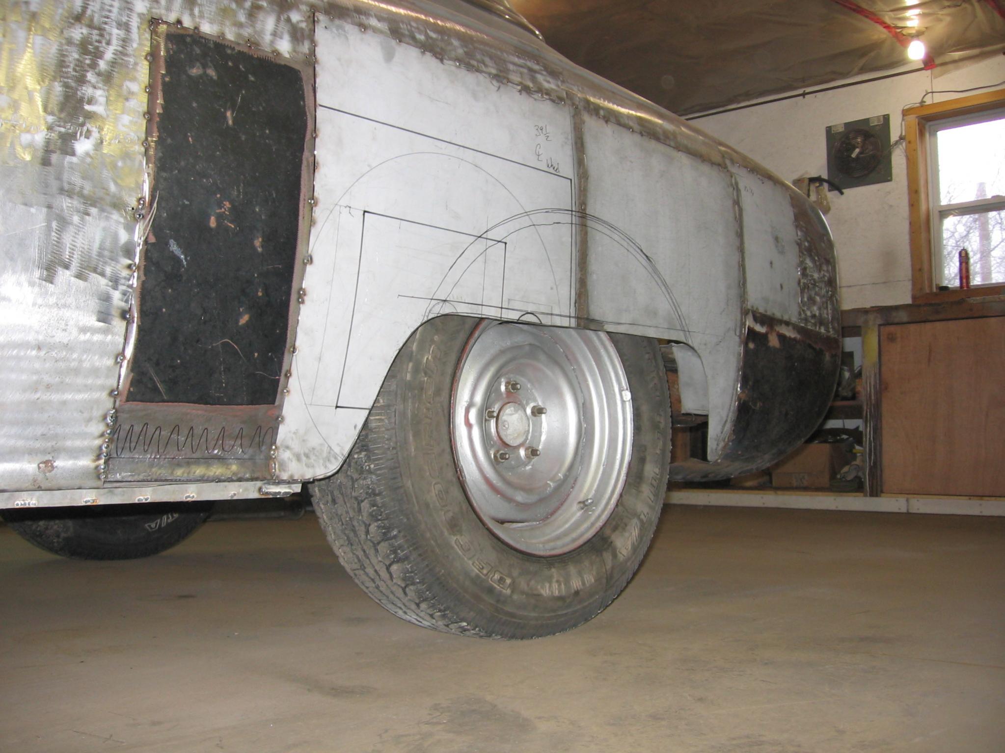

    Well I got started on the drivers side quarter panel redo . I was not pleased with the way it turned out last winter . I know that I had way to much warpage in the entire panel so the result was to much filler . It would eventually crack and you know, only after the car was painted . So off with the old panels and on with the new . First to go was the gas filler area that I did last year . This area warped from being to much in a hurry and to much heat . So I cut it all out and put in new . I then cut all of the reveal line off right up to the new B pillar panel that I did last winter . This is still good as I went a little slower in this area and didn't get much warpage . Was able to get the return tacked back on as well as the previously mentioned gastank filler door area . Thanks for the good coversation and brainstorming Dana . I will be over for that bumper sometime this week for sure . Later , Andy...

    Well guys 2 weeks of holidays, got some projects done in the house and in the garage , until today . My plow truck is in desperate need of floors . As this is non hamb friendly vehicle just know that its not going to be a fun project . Believe me . Anyways the buick is on the backburner but I did manage to get both the quaterpanels on .In the second and third pictures you can see another part of the doner chevy quarterpanel being used . Its so important to not throw anything out when you are building . That chevy has saved my *** more than once and the chop is not even started yet . So the exterior of the body is 90% rust free. Just the doors left to patch up . Andy...
