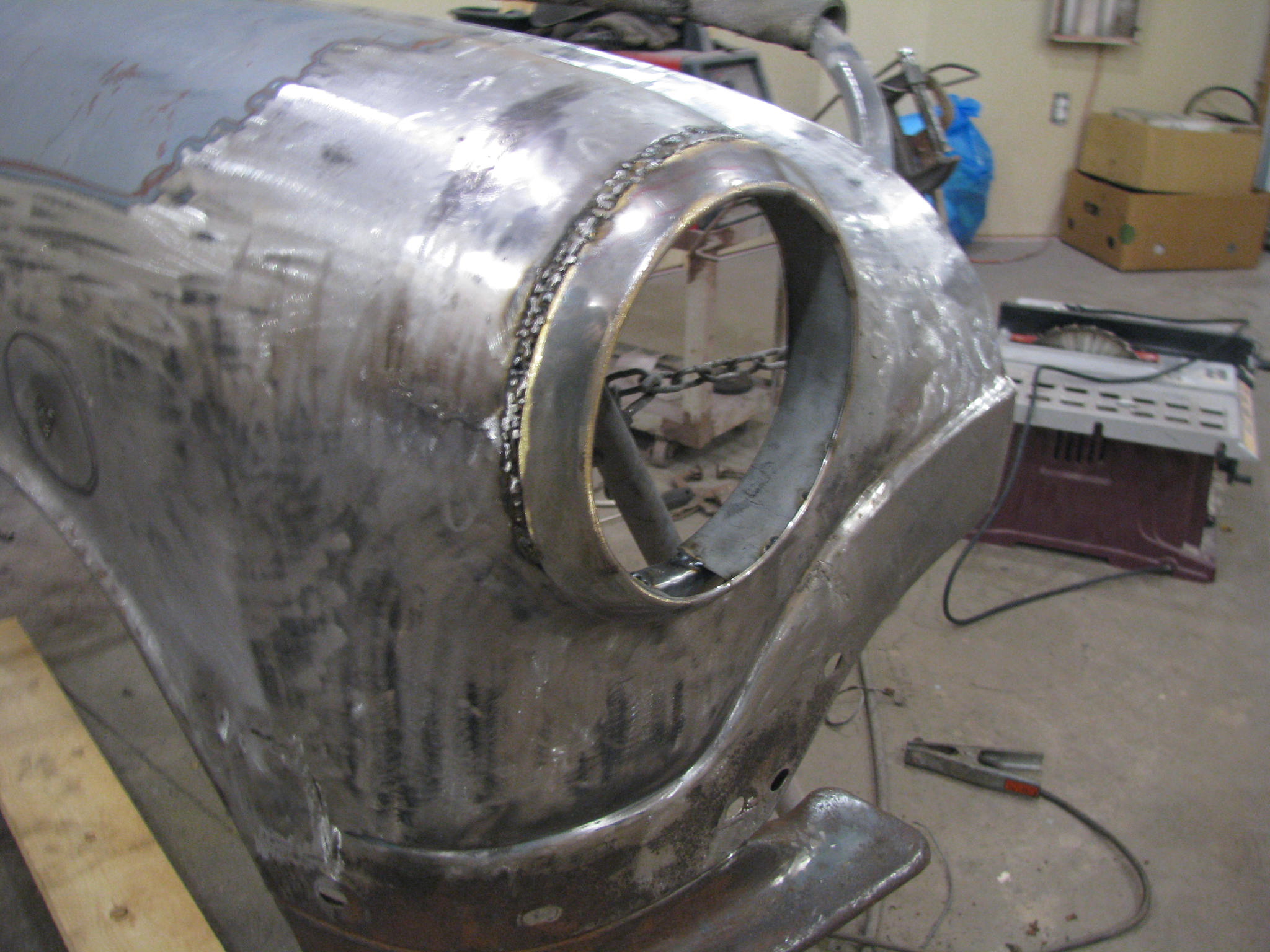

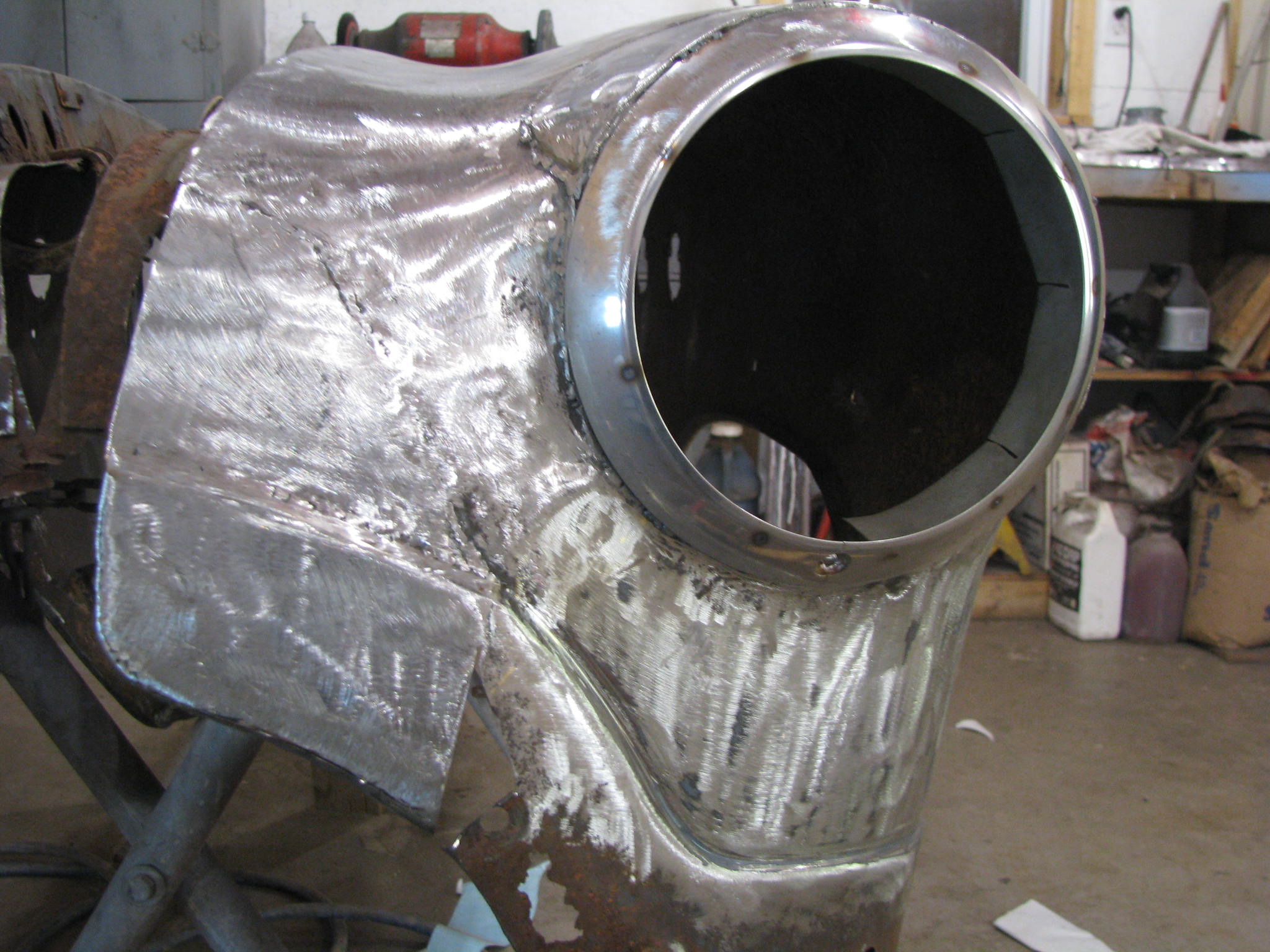

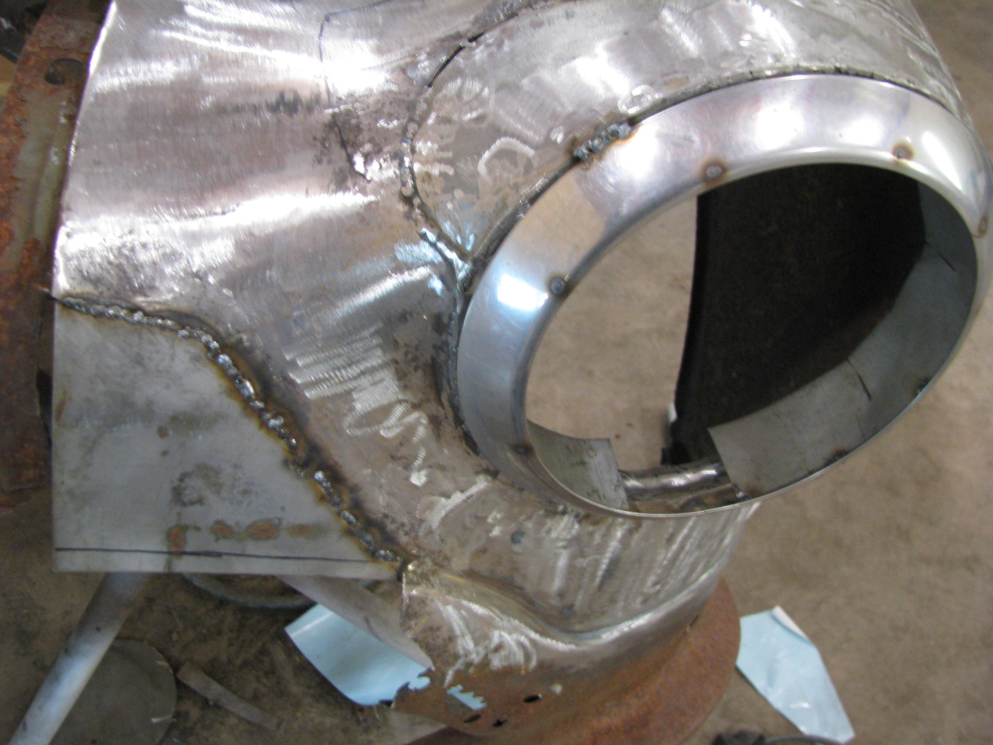

    Slow but sure progress. The fender is coming along . I scored some very nice headlight buckets from Ohio should be in soon . I will be able to finish this fender french job . Turning out good . The headlights are frenched a tasteful 1 1/2 inches. Just enough.

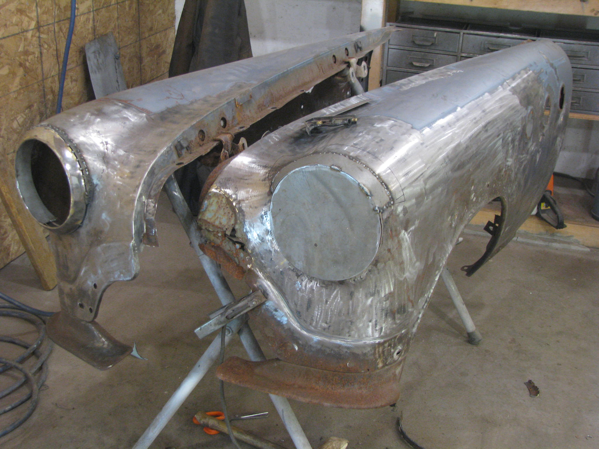

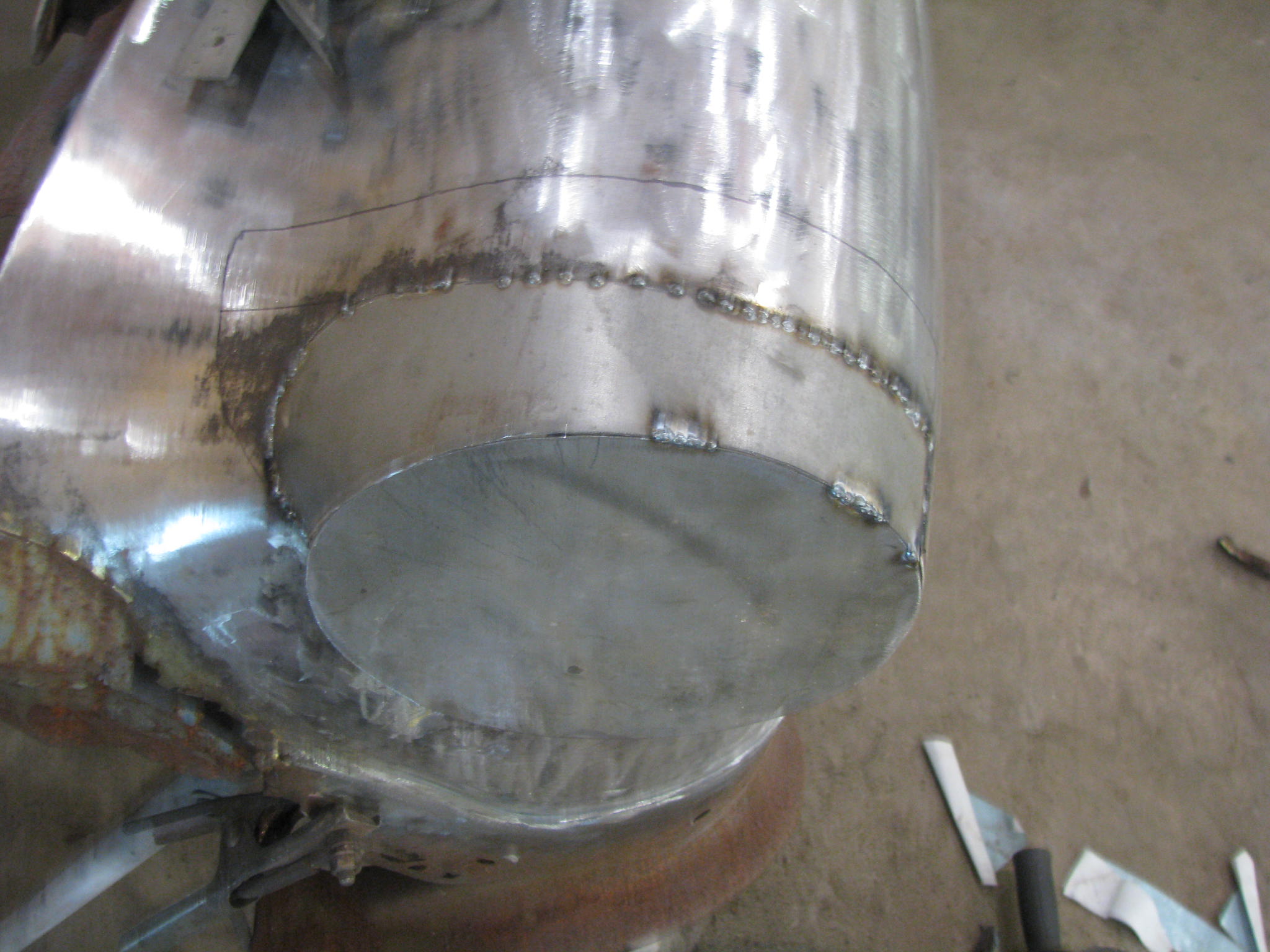

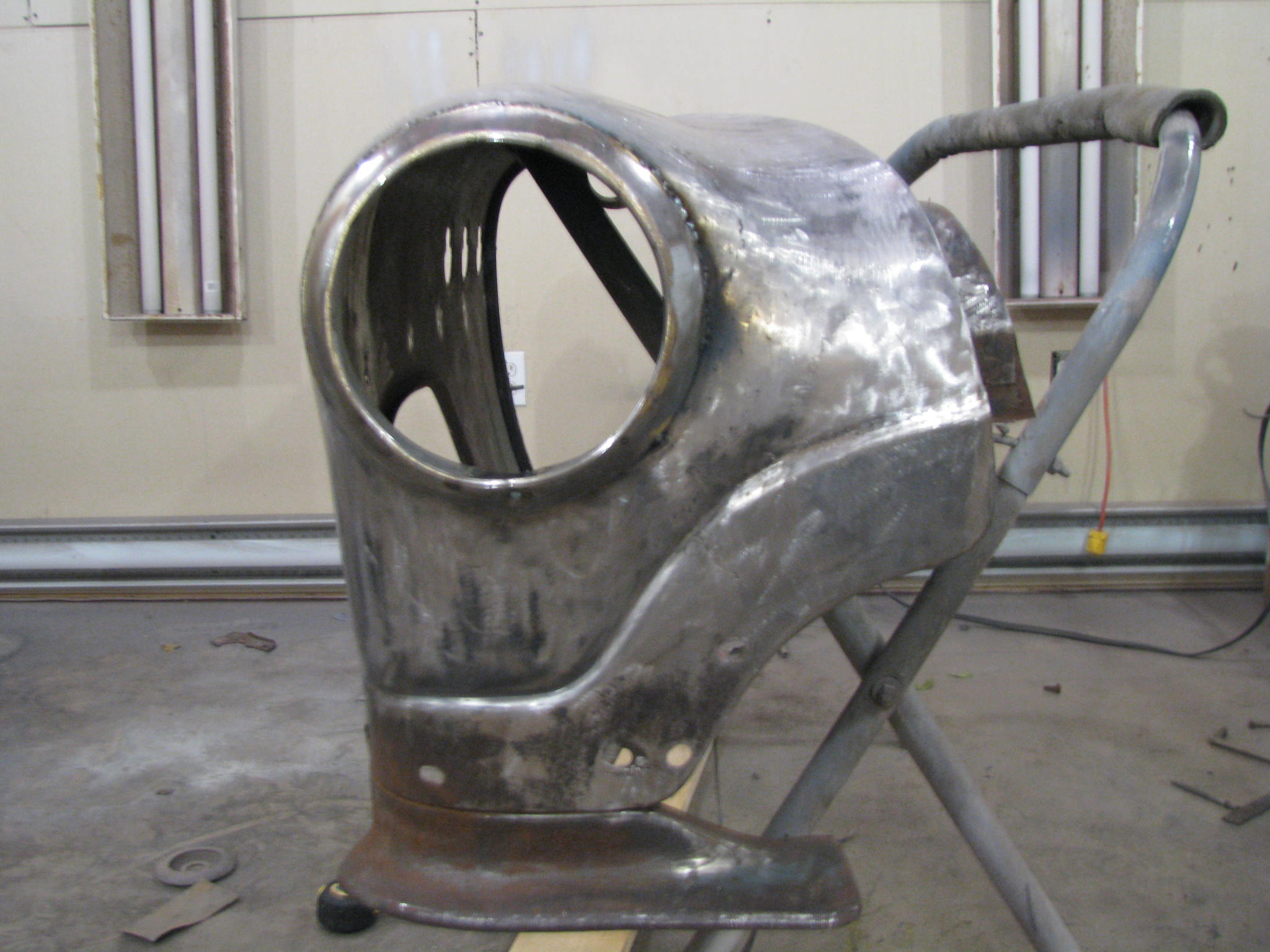

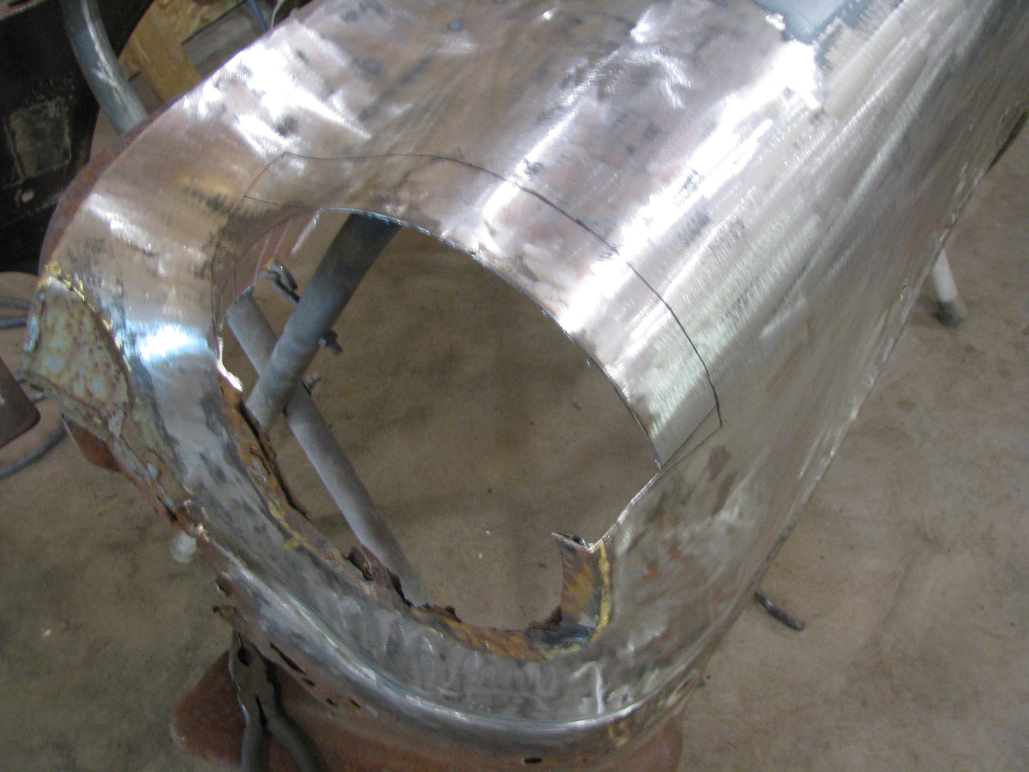

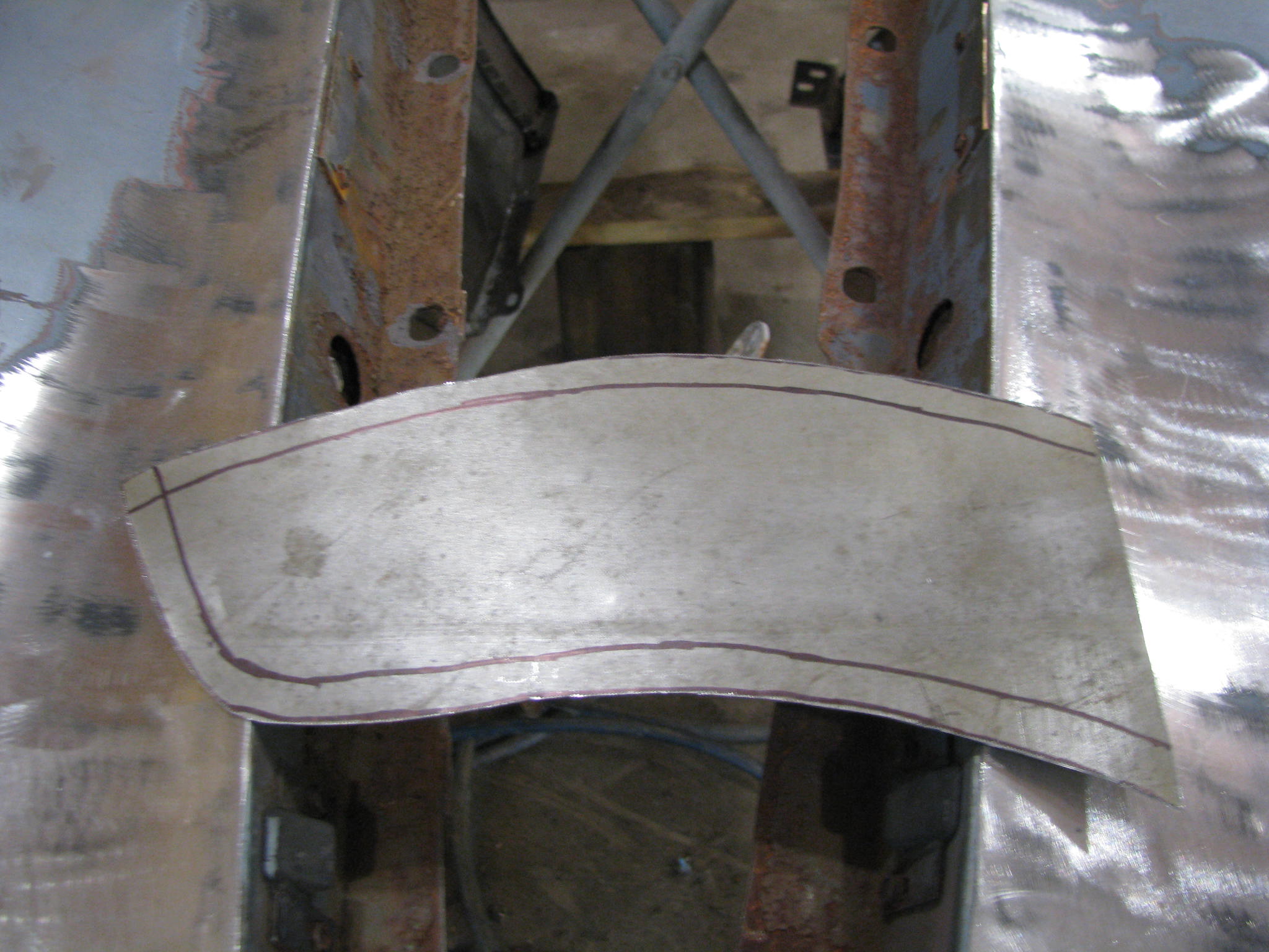

    A few more pics of the progress on the front fenders. Mustache is hard to shape but its getting there. First picture is of the mustache before shaping . Lots of shrinking and stretching to get it there . I wish I had more time tonight I would have had it done :mad: . Tomorrows another day.
    C-Ya

    Heres the Pics . They didnt send with the last post . :mad:

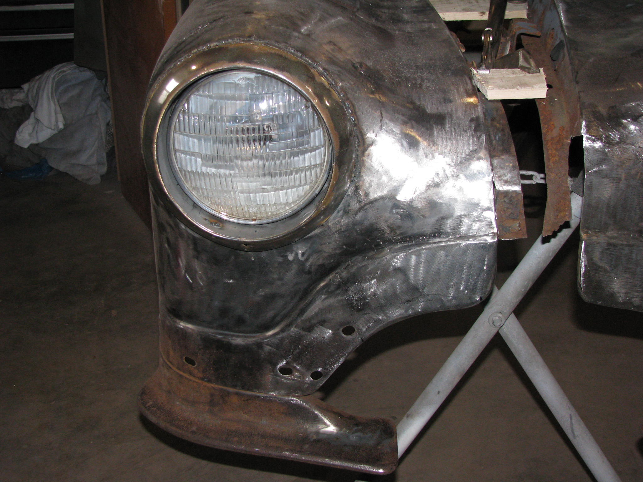

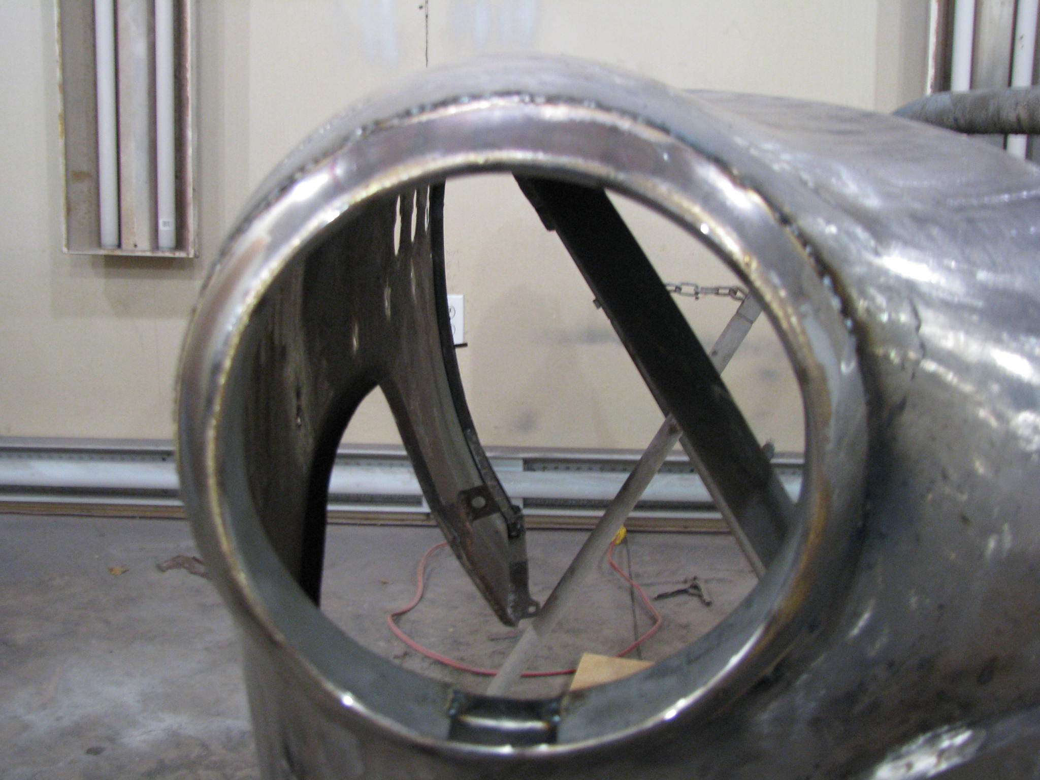

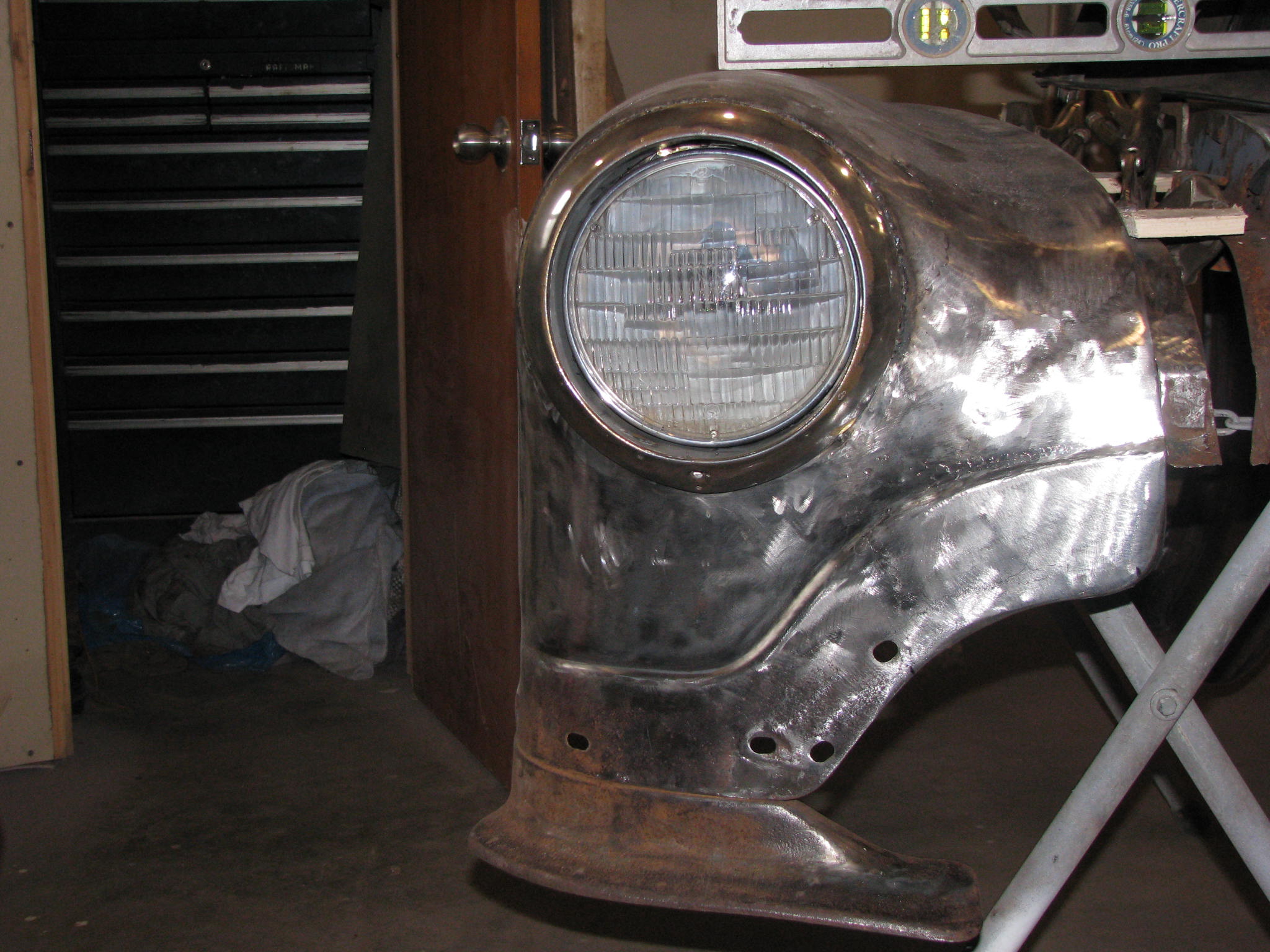

    Well thats 1 headlight done on to the other . What do you think ? :D

    Your frenched headlight looks very good. Keep up the good work!

  15. Looks great! I love the progress :) I have to say I was a little puzzeled at first about the closed up headlight, but I guess it's for stabillyty right? More pics! please!
    Klaus
  16. aw1950
    Joined: Dec 21, 2008
    Posts: 1,511
    aw1950
    Thanks for the words of encouragement boys and yes Kuztomklaus you are right . It was easier to weld in new flanges on both fenders this way . It helped to keep the form of the fender . Once welded I just cut out the opening as needed. Keep checking up now and then lots more to come :rolleyes:

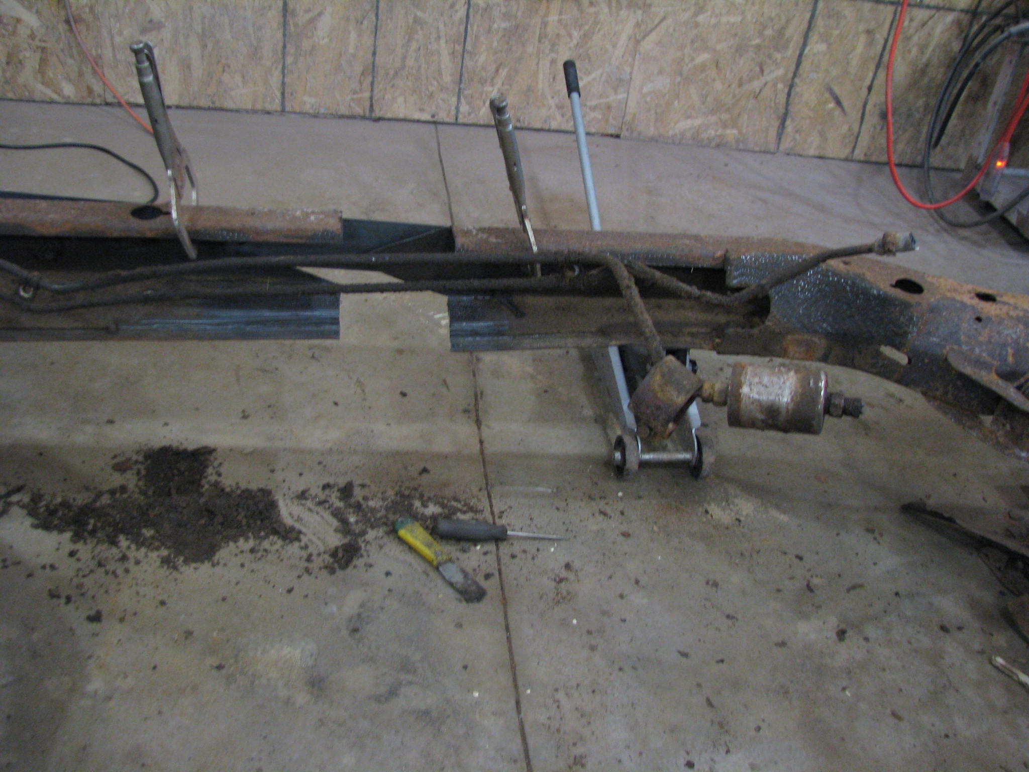

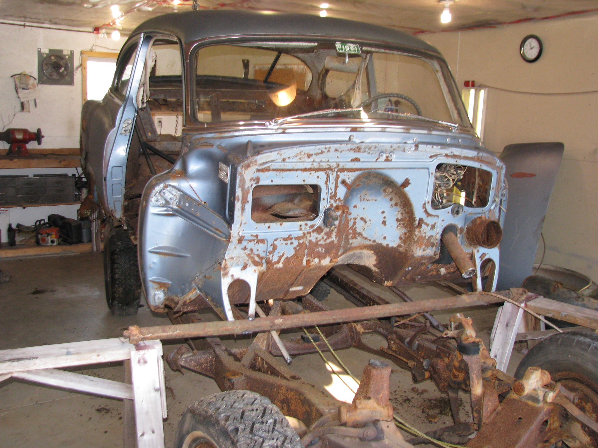

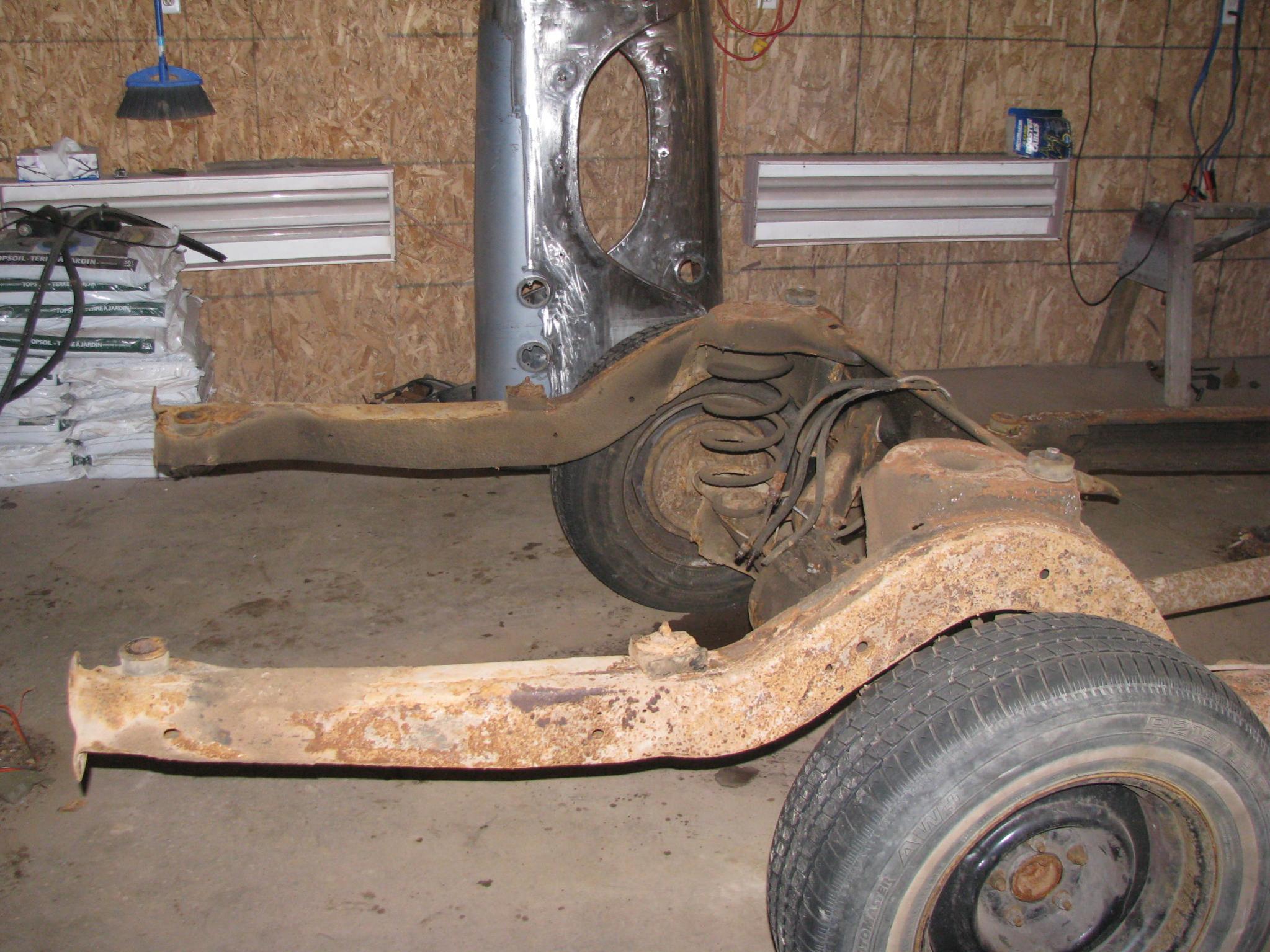

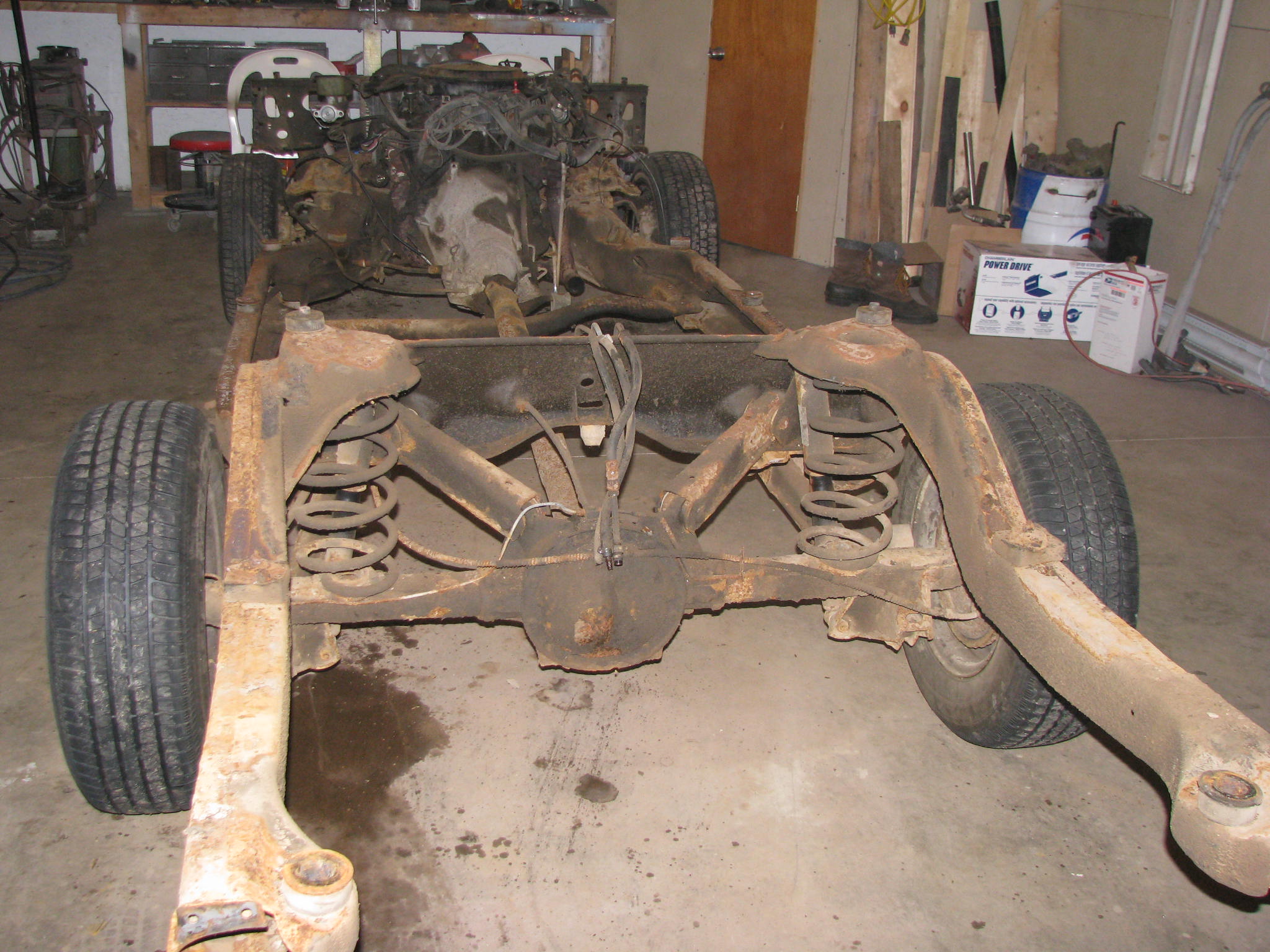

    Another update . A buddy came over and 4 hours later this is where we are at . This is the point I need to be . The frame will be cut and the 5.5 inches will be added . Then it will be time to bring the buick in and seperate it from the original frame . I cant wait for that . Its like an early Christmas present . :rolleyes:
  21. aw1950
    Posts: 1,511
    aw1950

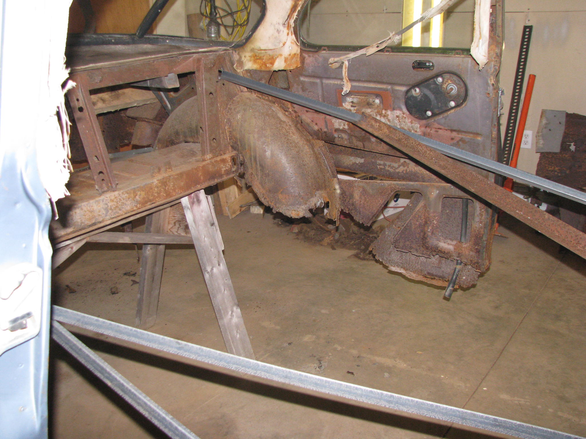

    Well today was productive . Started by rolling out the frame and storing it for the time being . Next we drug out from around the back of the garage the Buick. After the removal of the few remaing body bolts ( 1 ) LOL I braced the car up and the threw a 2x4 in across the trunk opening . Wrapped the chainfalls to it and away we went . ( Liftoff ) Blocked the front up on sawhorses and rolled out the old frame .
    Next up is the removal of 7 inches from the frame under the trunk area of the frame as it is that lenght to much in relation to the Buick .
    Then, because you should always repair frame with frame I will take that 7 inch piece , cut it down to 5.5 inches and add it to the middle of the frame . This will bring the frame to the correct 121.5 inches in wheelbase that I need for the Buick .
    Moving right along wish me luck :D

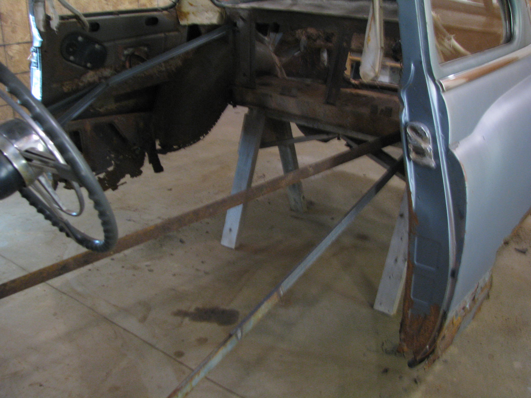

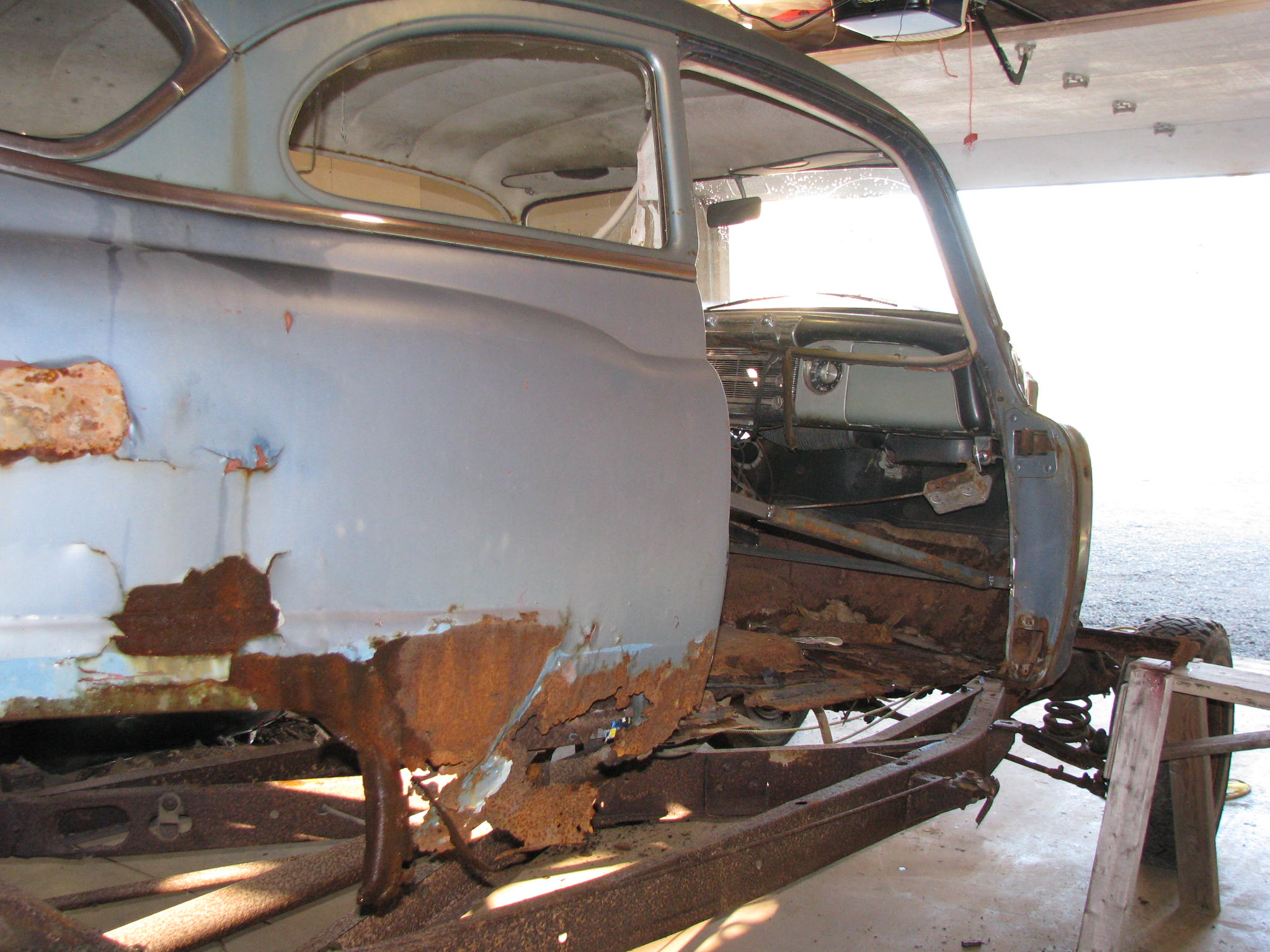

    Well another update . Got to steal away a couple hours tonight and I cut out what was remaining of the original floor . Not much of it left to say the least . Not really enough time to do too much more than that , but I did do a lot of looking and thinking of what my plan of attack is .
    Maybe tomorrow before work I will get the Buick moved to one side of the shop and get the frame back in and cut and lengthen the frame so I can lower the buick over theframe . Then it will become clearer as to where to start in the build .
    Where into the fun stuff now :D

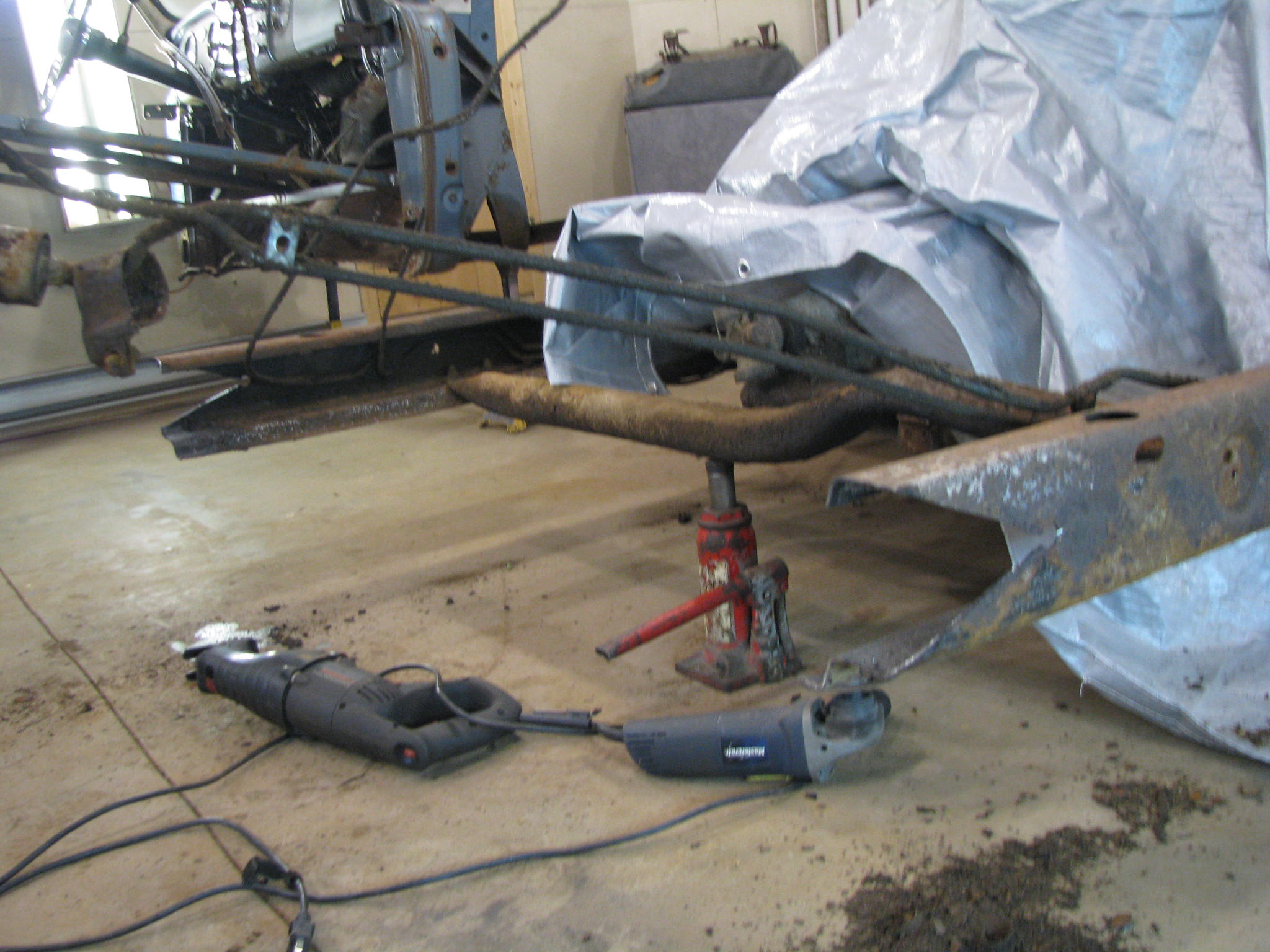

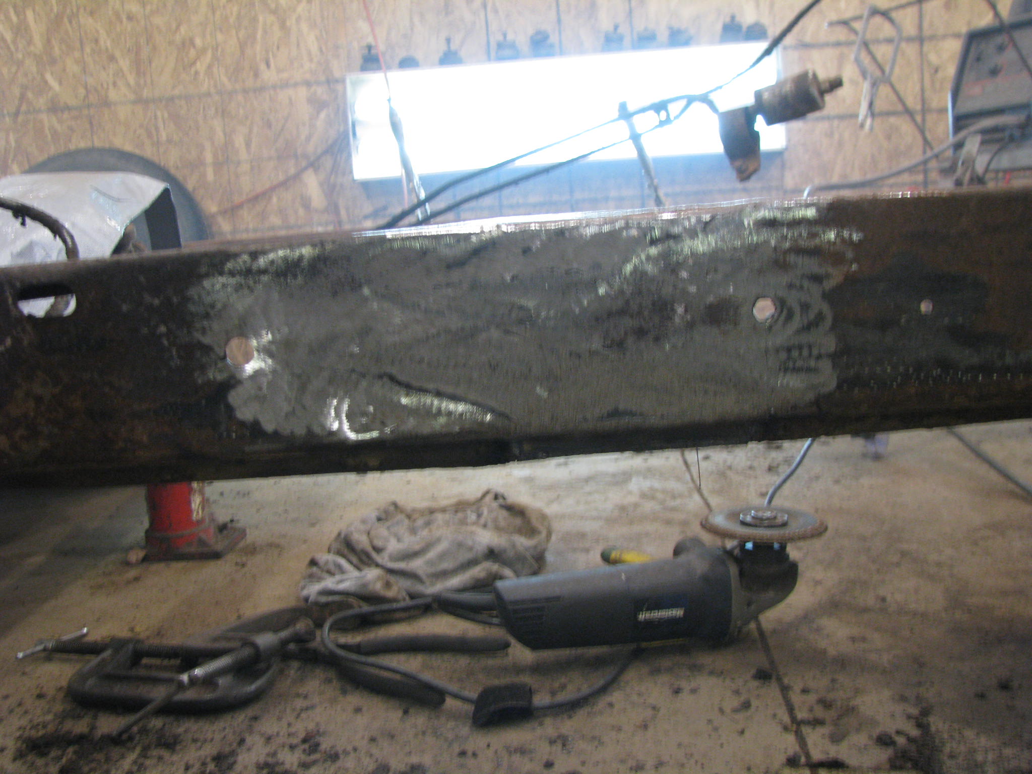

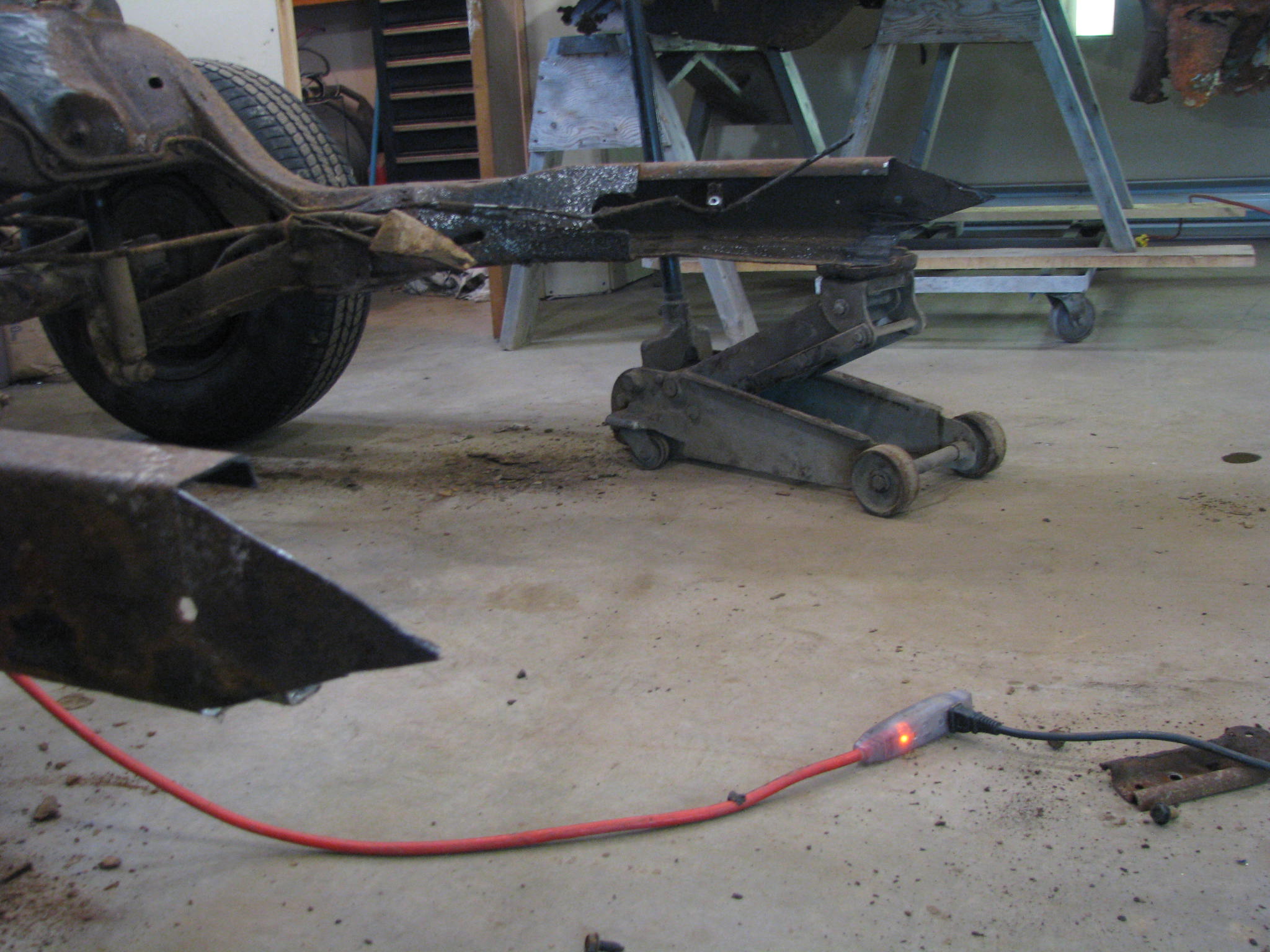

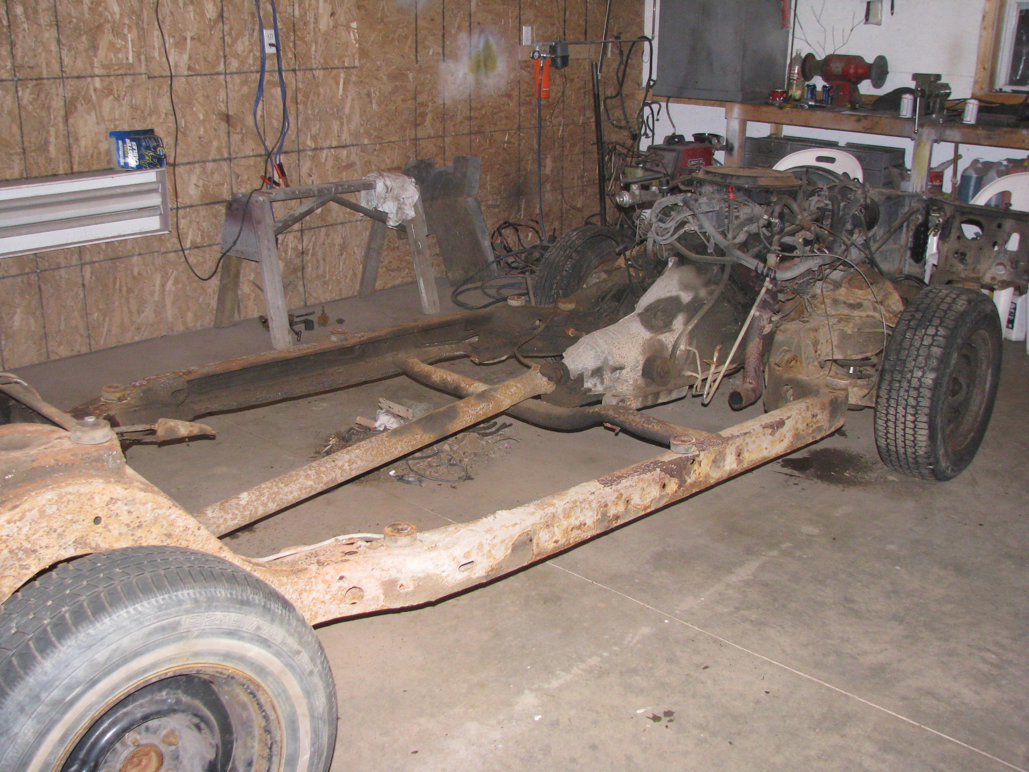

    More Progress I had a few hours today and was able to seperate the two frame halfs. I will put in the 5.5 inches maybe tomorrow if time permits . Enjoy the pics for now all you pic junkies LOL ! :rolleyes:

  28. aw1950
    Posts: 1,511
    aw1950
    Well thats one side down one to go . 3 Hours of work I wish I had more time today . :mad:
