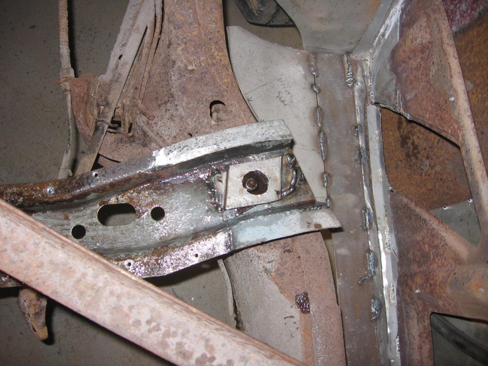

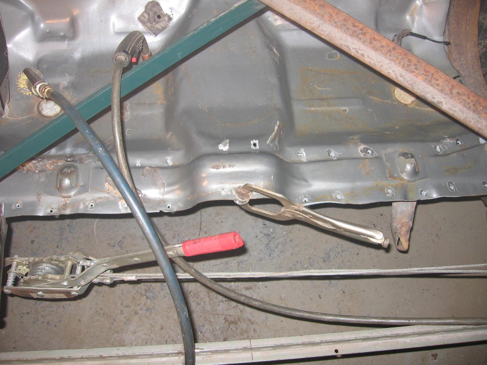

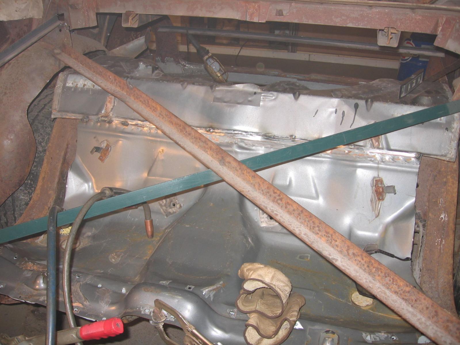

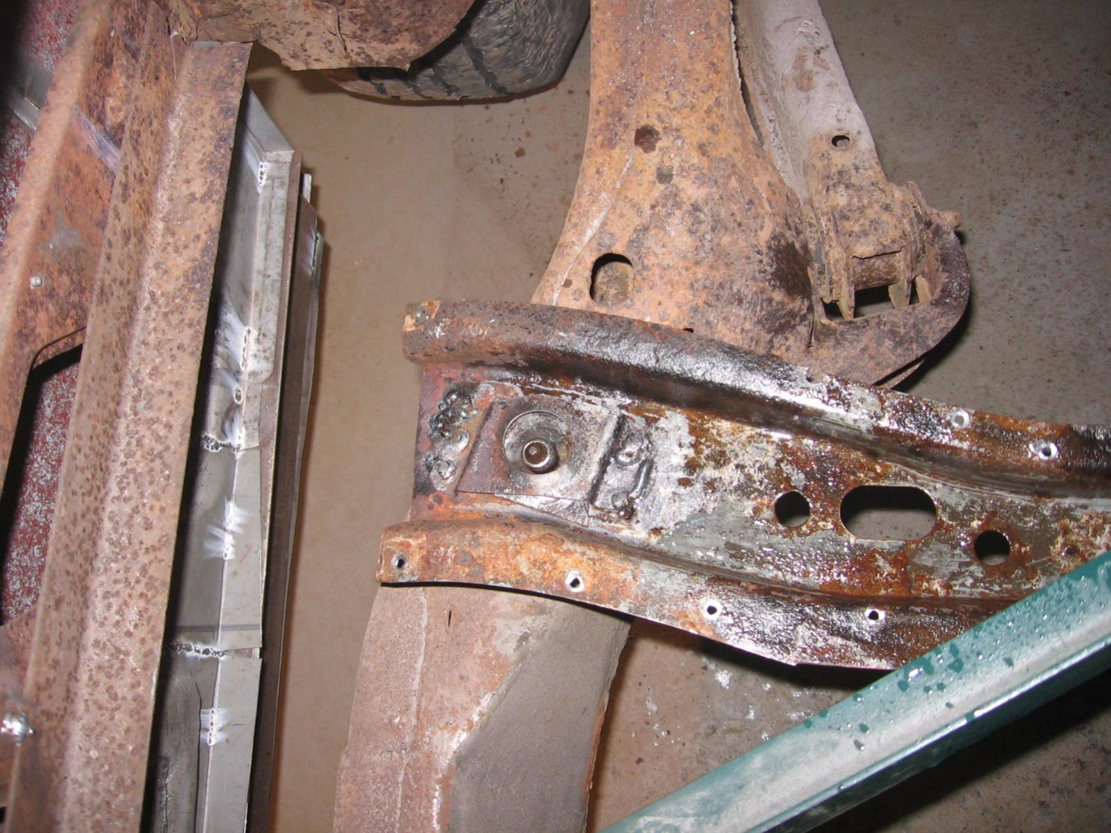

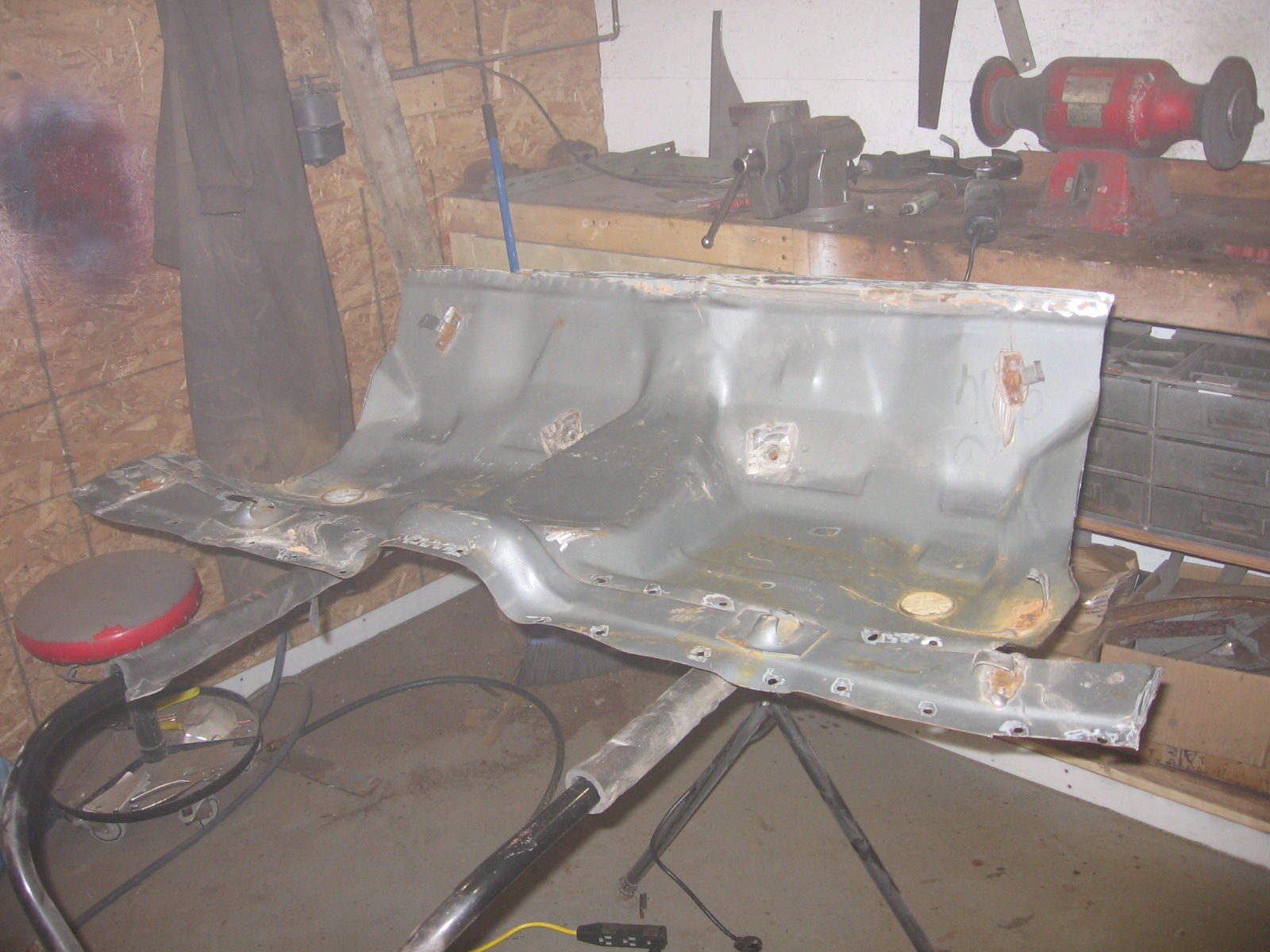

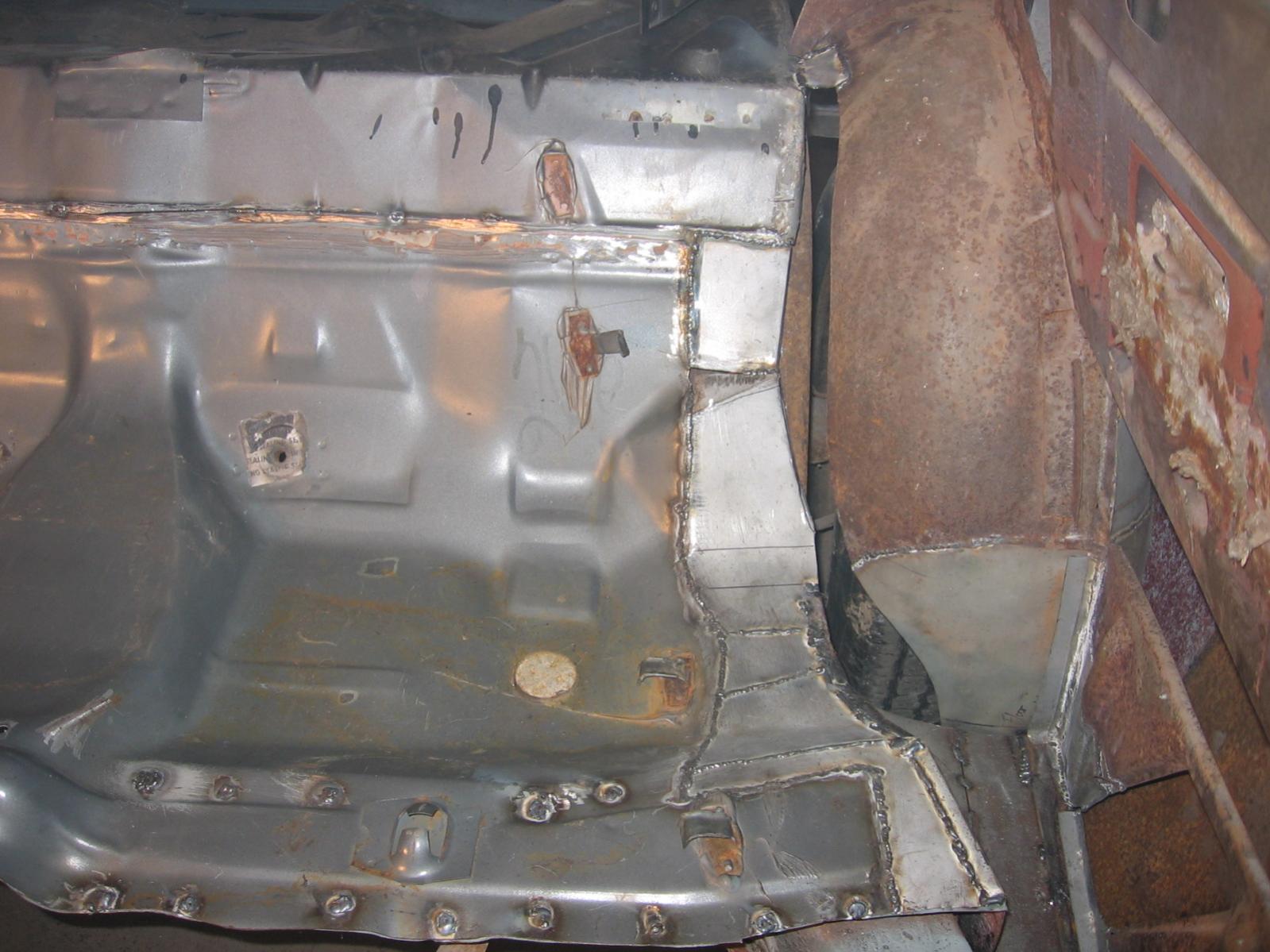

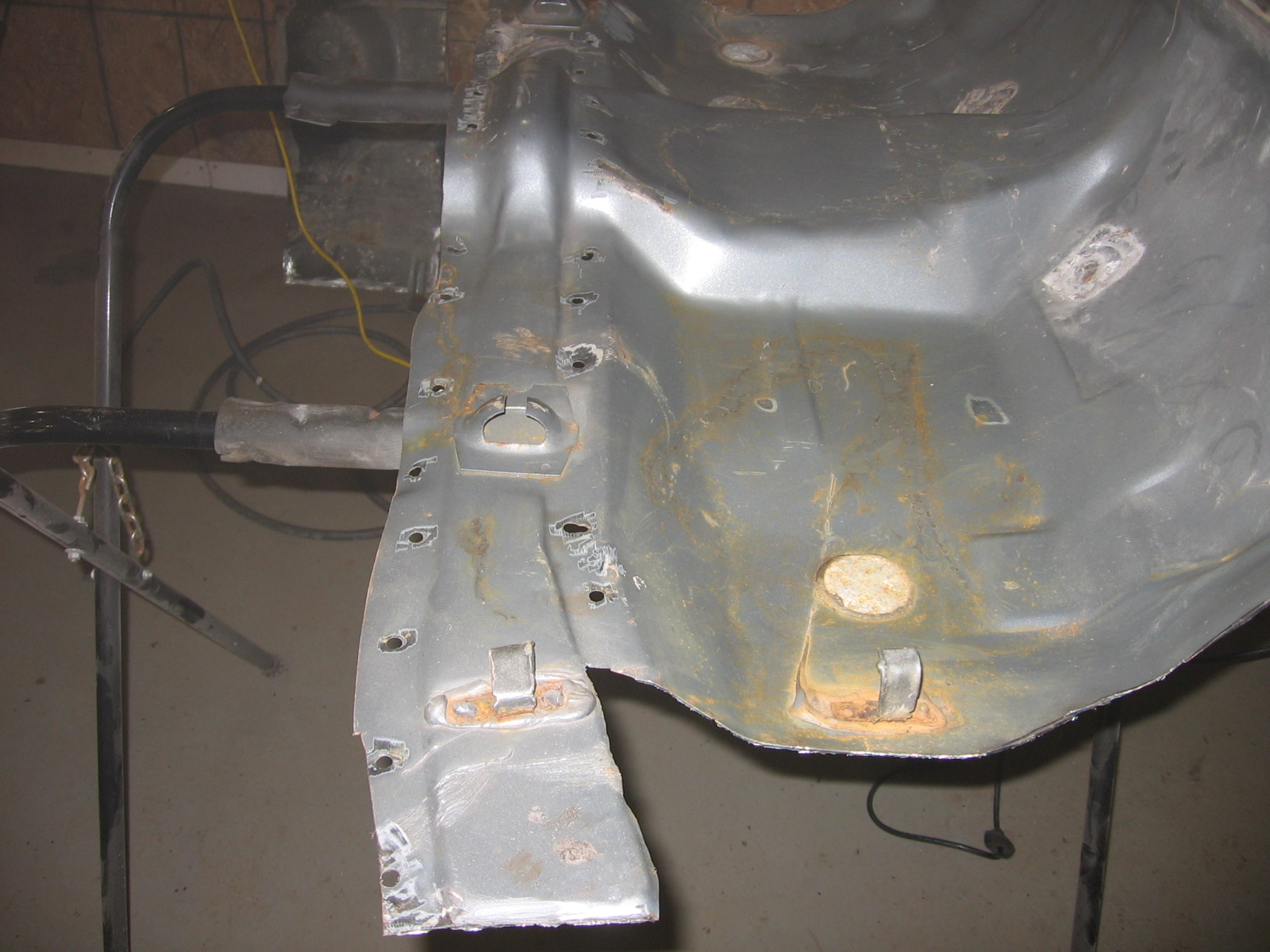

    Well I am trudging along . The slow boring stuff seems to take so long . :mad: . I had to drill out all the spotwelds and fix the left side of the crossmember. The cage that held the bodymount nut was toast as well so I duplicated it from the right side that was still excellant .The new one is in the 3rd pic along with the repaired ends of the crossmember . I cut out all the bad rust from the seatpan and fixed any rust issues that the spotweld flanges might have had . It seems like a lot cut out but the ends would have to go , good or bad anyways . The last couple pics are just of the floor seatpan starting to be welded back onto the rear riser trunkpan that is over the coil spring pockets . Slow but sure I'll get there just like all you guys out there , I am sure you know what I mean . Andy...

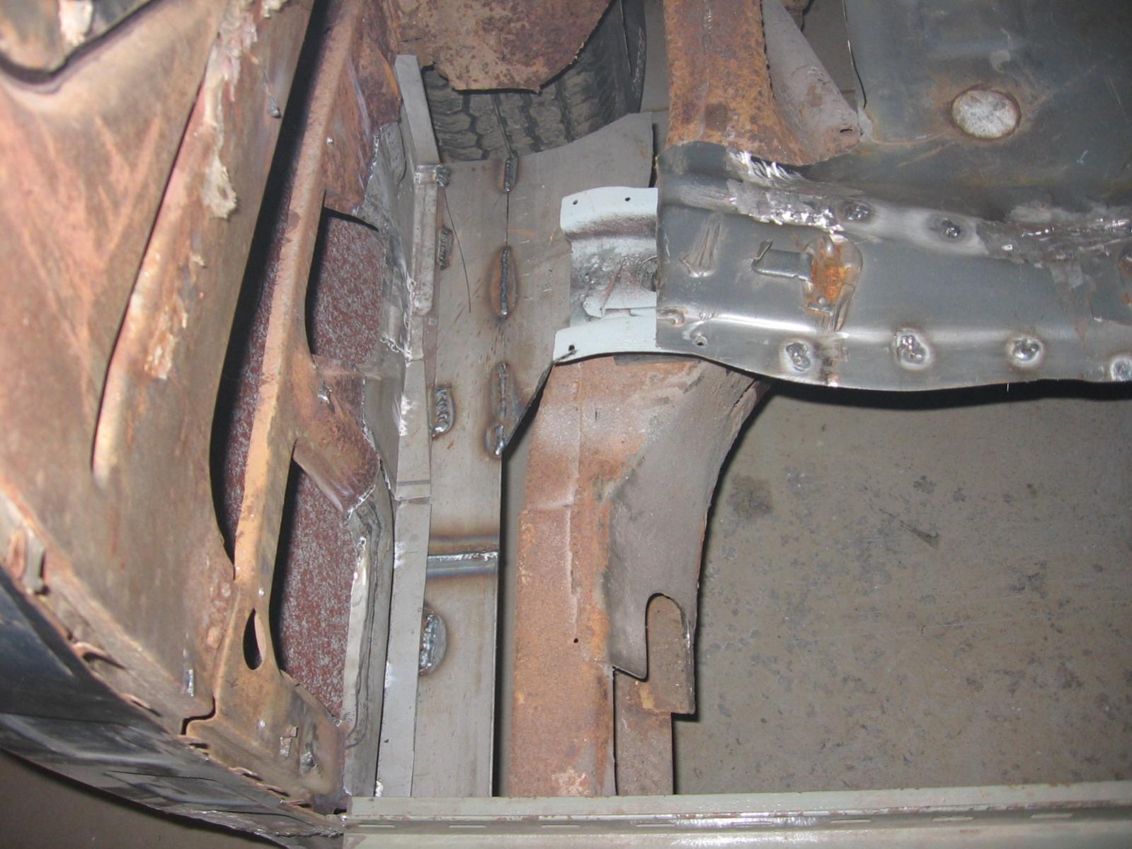

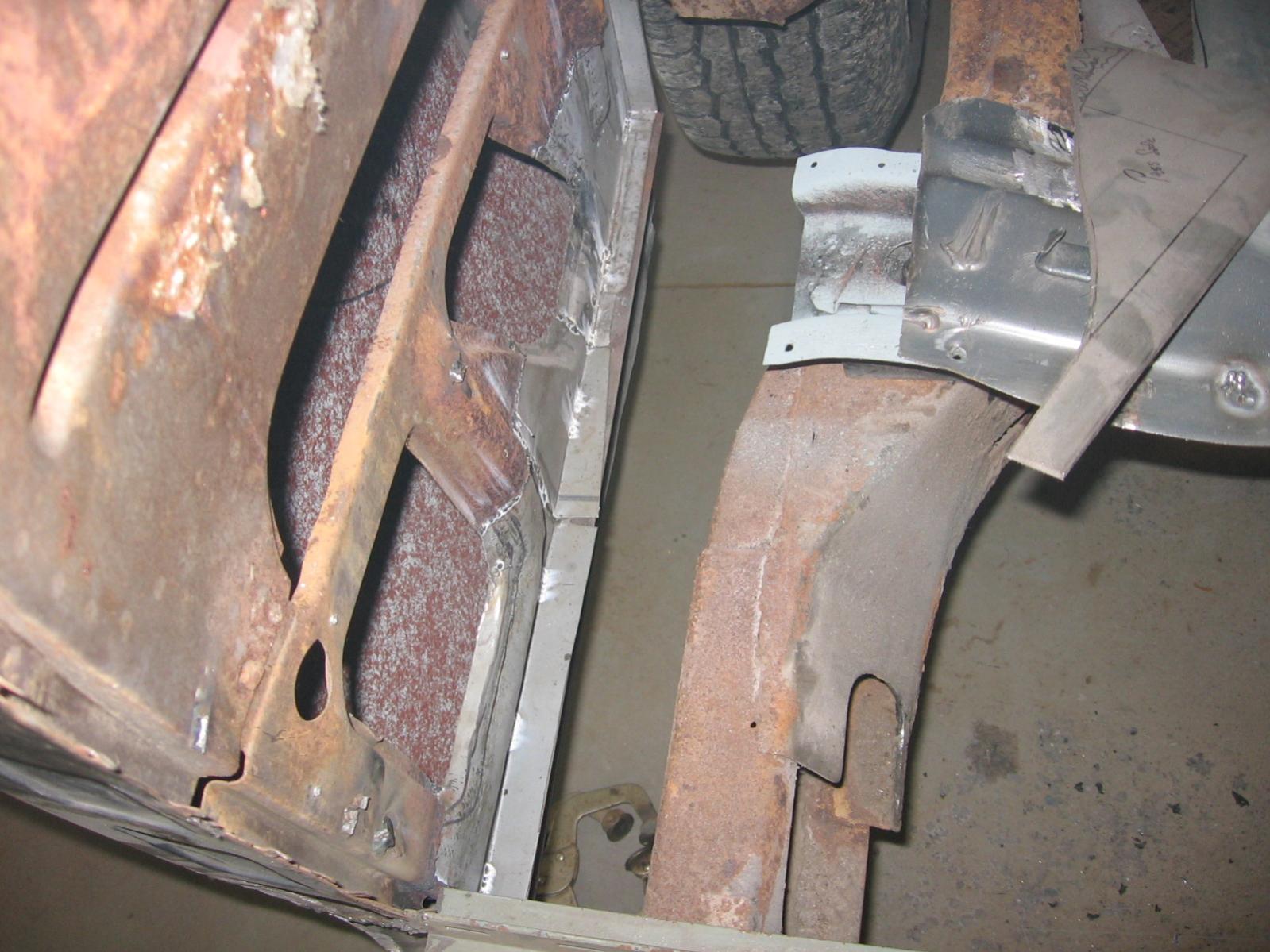

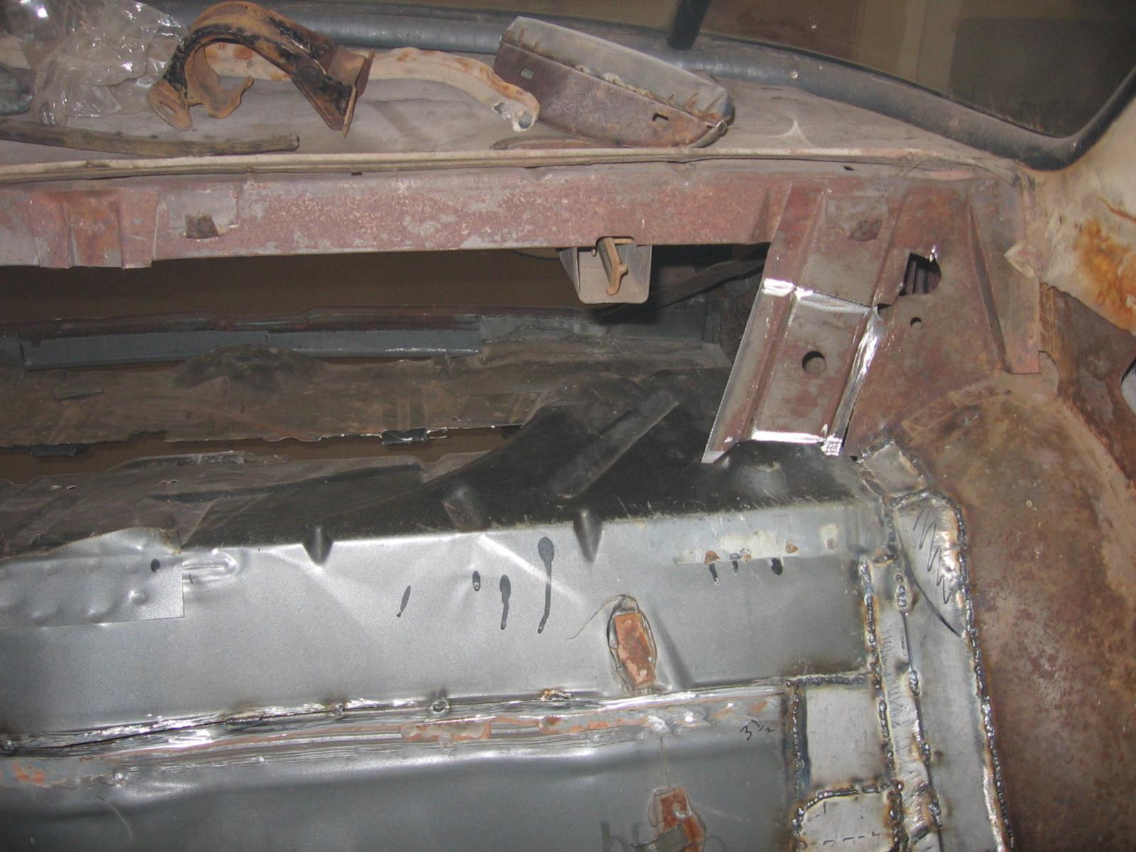

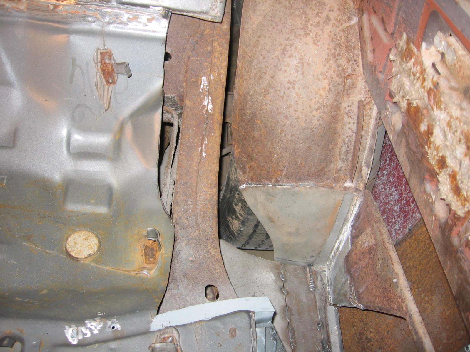

    More tying in of the rear sheetmetal ,wheelwells and inner rockers . I cant believe now that the driver side is somewhat tied together the drivers door closes so much easier . The pasenger side inner rocker return is now in , Pic 4 and now I can tie in the rest of the middle crossmember to the return . This will make the car very solid . At this point I will begin the dis***embly of the gl*** and trim for the chop . Stay tuned , It will be a couple weeks away yet . Andy..
