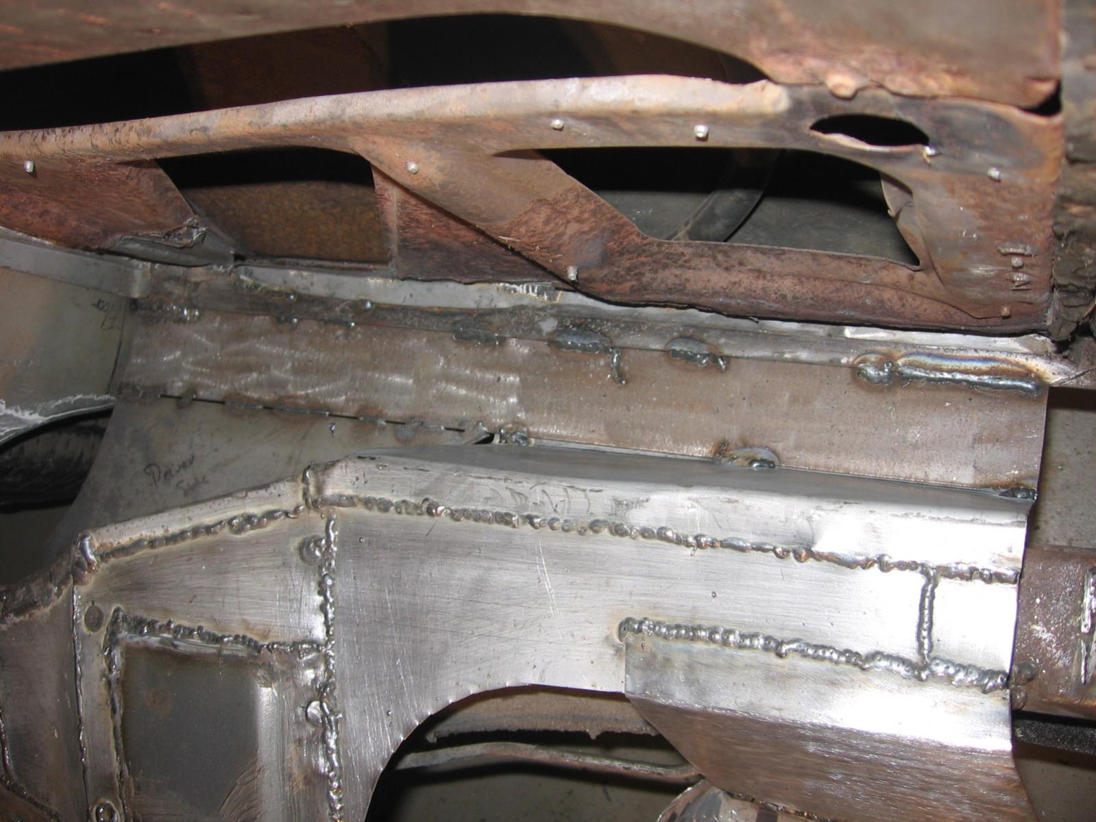

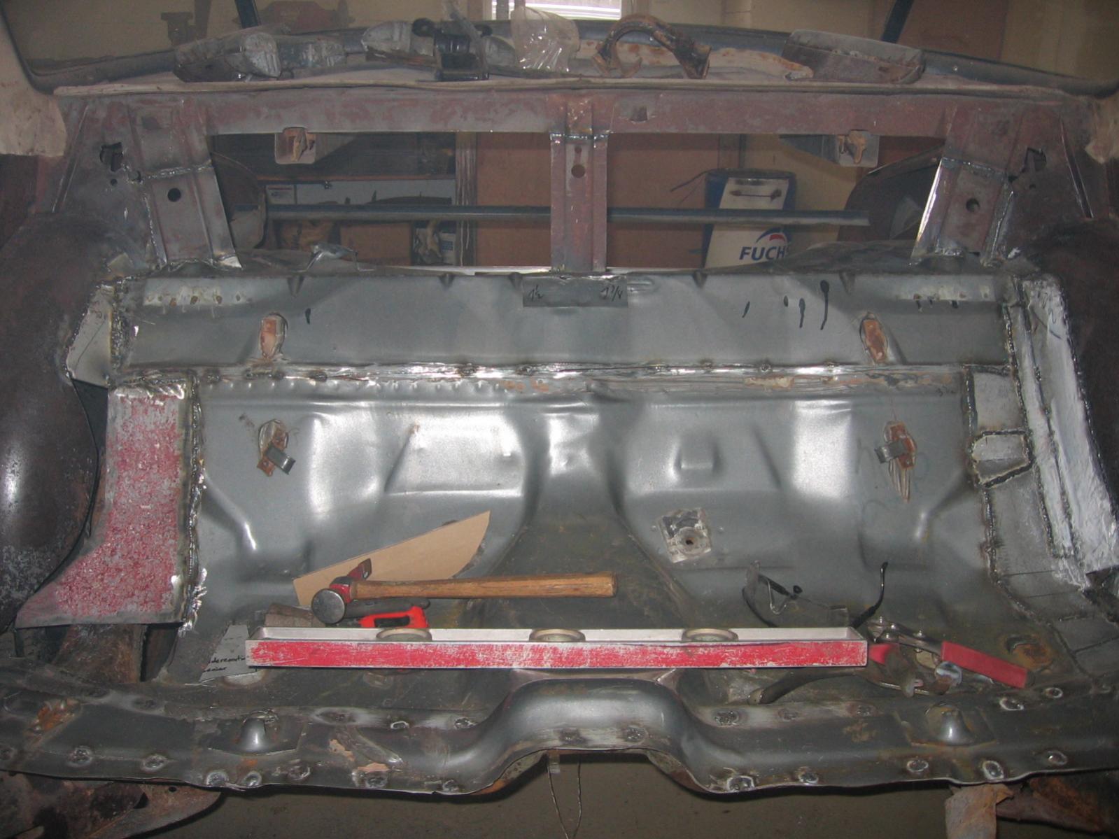

    aw1950

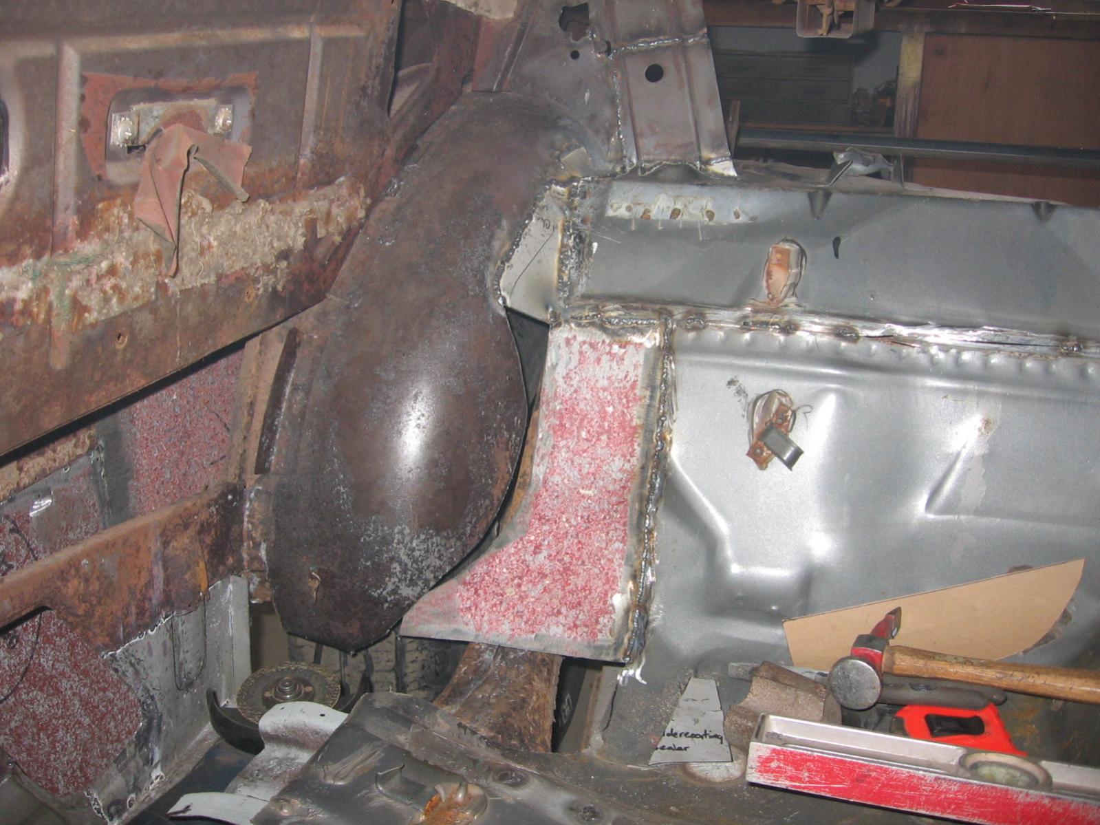

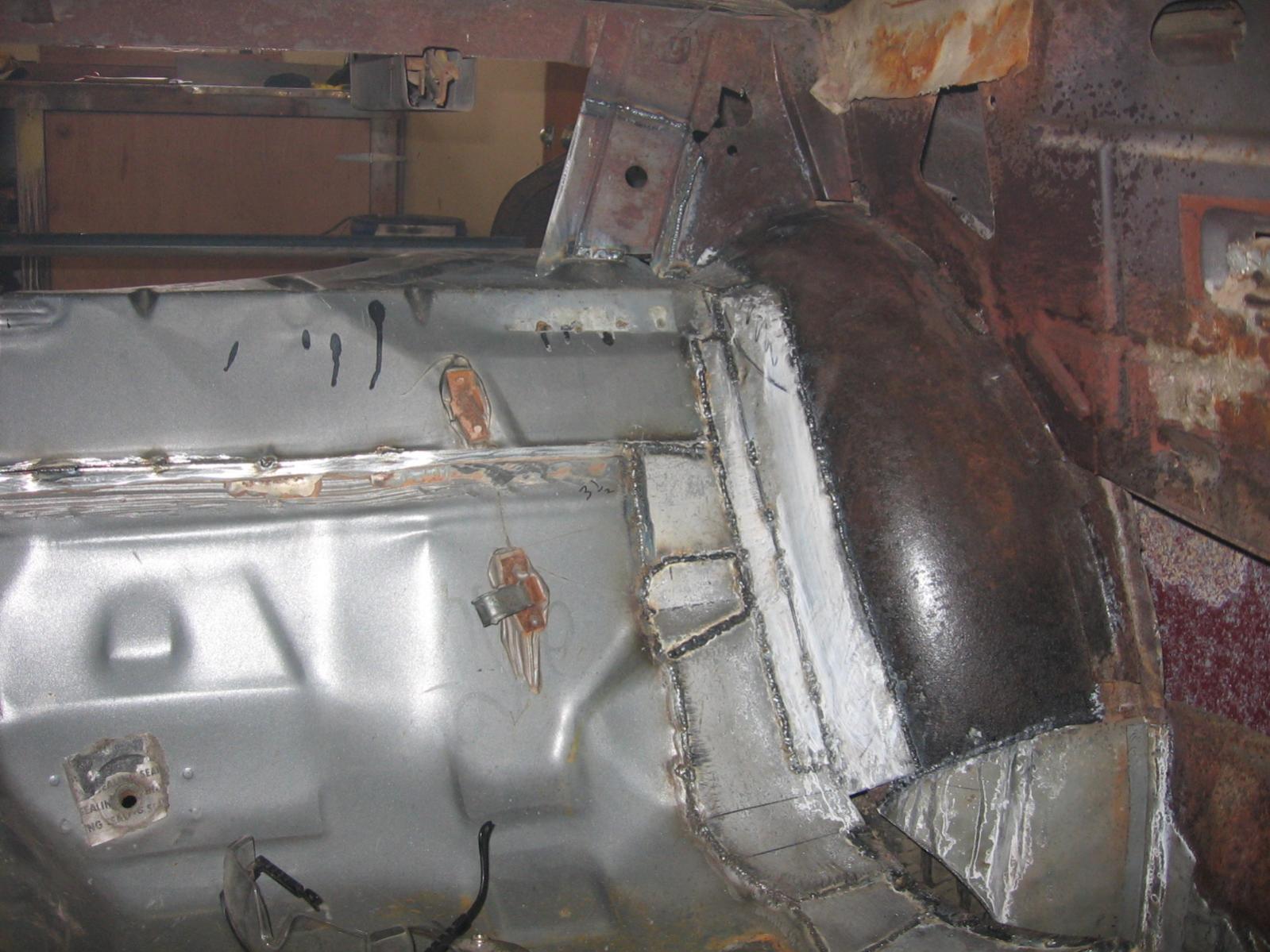

    Just more rear floorpan work . Getting there though :rolleyes: . Andy..

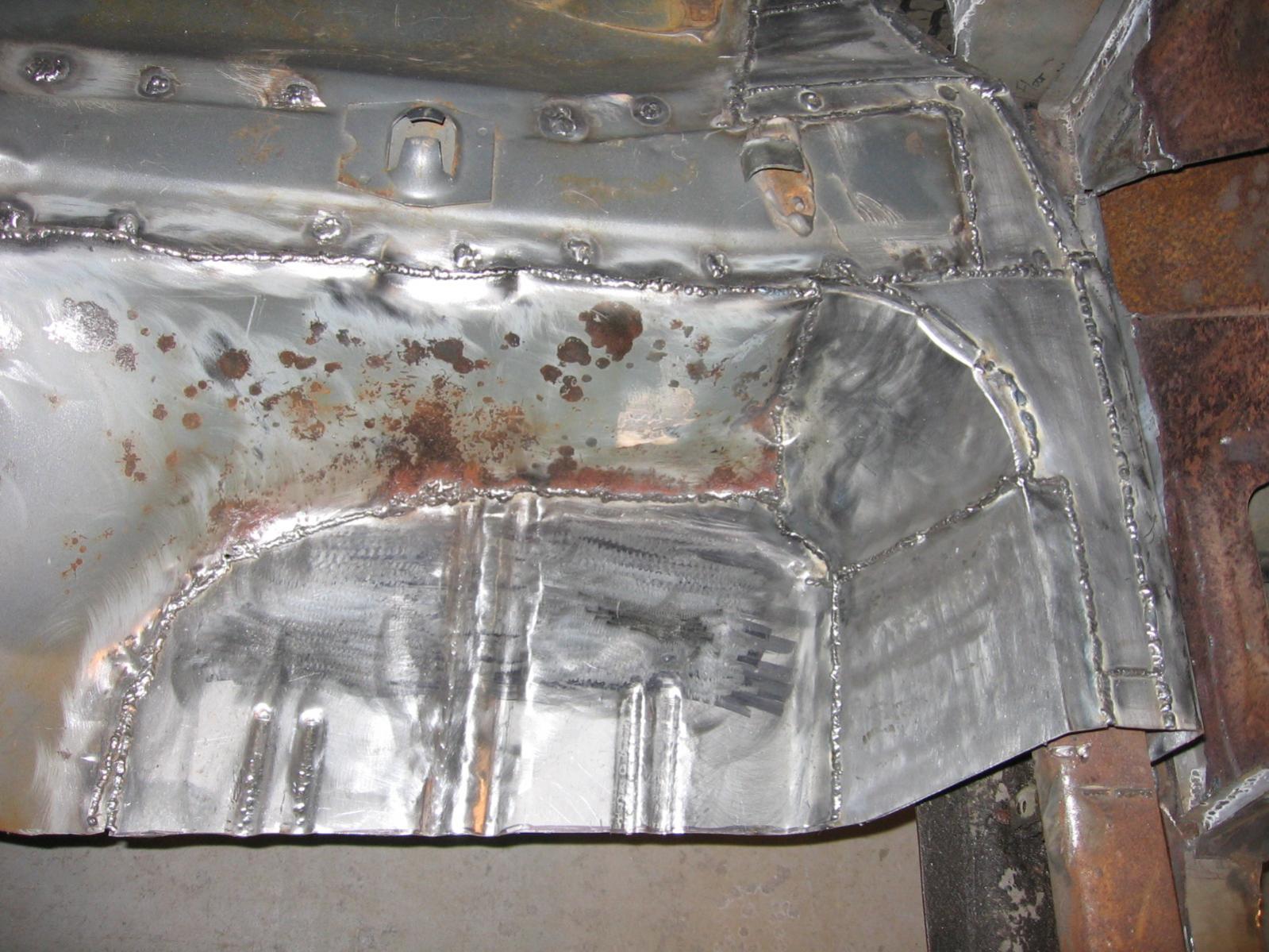

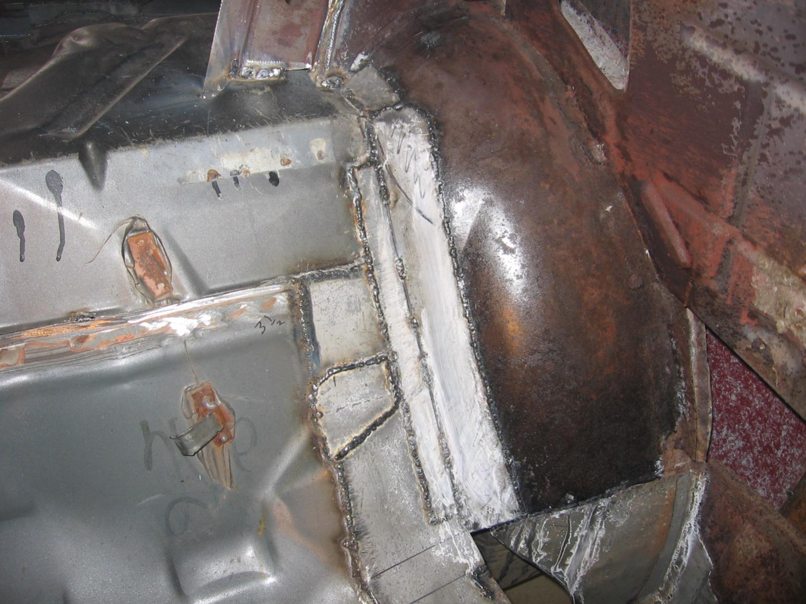

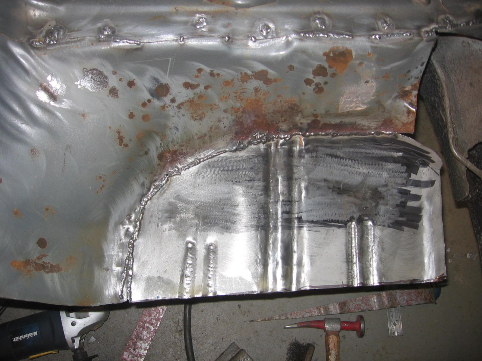

    Well its been a week or so I managed to get a little something done . Caught the damn flu last weekend :mad: cut into shop time some . Had to make a rear floorpan for the drivers side rear footwell . Formed this up and welded her home . The corner piece was a bit of a ****** but preseverance pays off . I cant seam seal any of this as when the car goes to rotissire I will be welding all this on the bottom side as well . Put the engine back in with the new relocated mounts and it fits like a glove . There is an inch of clearance at the firewalll to the head on the right side . Perfect . Now I can use the stock length driveshaft . That save about 400.00 denerios . Cha ching !!!
