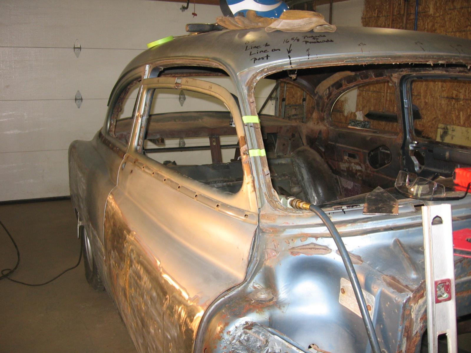

    Right now Rob I am in the process of laying out the cutlines . Right now I have the p*** side B post and A post taped up . A 2 1/2 " chop at the B post gives a 3" at the A pillar . Seems like a lot as the windshield will shrink to 15" in height . 3" at the B pillar will give almost 4 " at the A pillar . I think that would be to much and the car would look overchopped . Seeing as I will have some muscle in the shop that day maybe I will start out conservatively and work my way down till it looks right . Better to air on the side of caution .Tyler Durbans car is good with a conservative 2 " at the B pillar and 2.5 " at the A pillar but I dont like the fact he moved the rear gl*** forward . It put that hump in the back above the rear window . As far as the rear window goes as the previous posts say I ruined my rear gl*** so it comes down to this do I say screw it and use it anyway and lay the 3 piece down or s**** that and run the chevy back gl*** ? I have a source for replacement rear gl*** an old guy has 2 parts cars . So I am not totally screwed just pisses me off . More money out for a stupid oversight . Rob you had to bring it up again as I sit here I am starting to get pissed again for doing the bonehead deed . Geesh !!:mad: What was your opinion on the rear gl*** issue ?? How much chop did you do to your

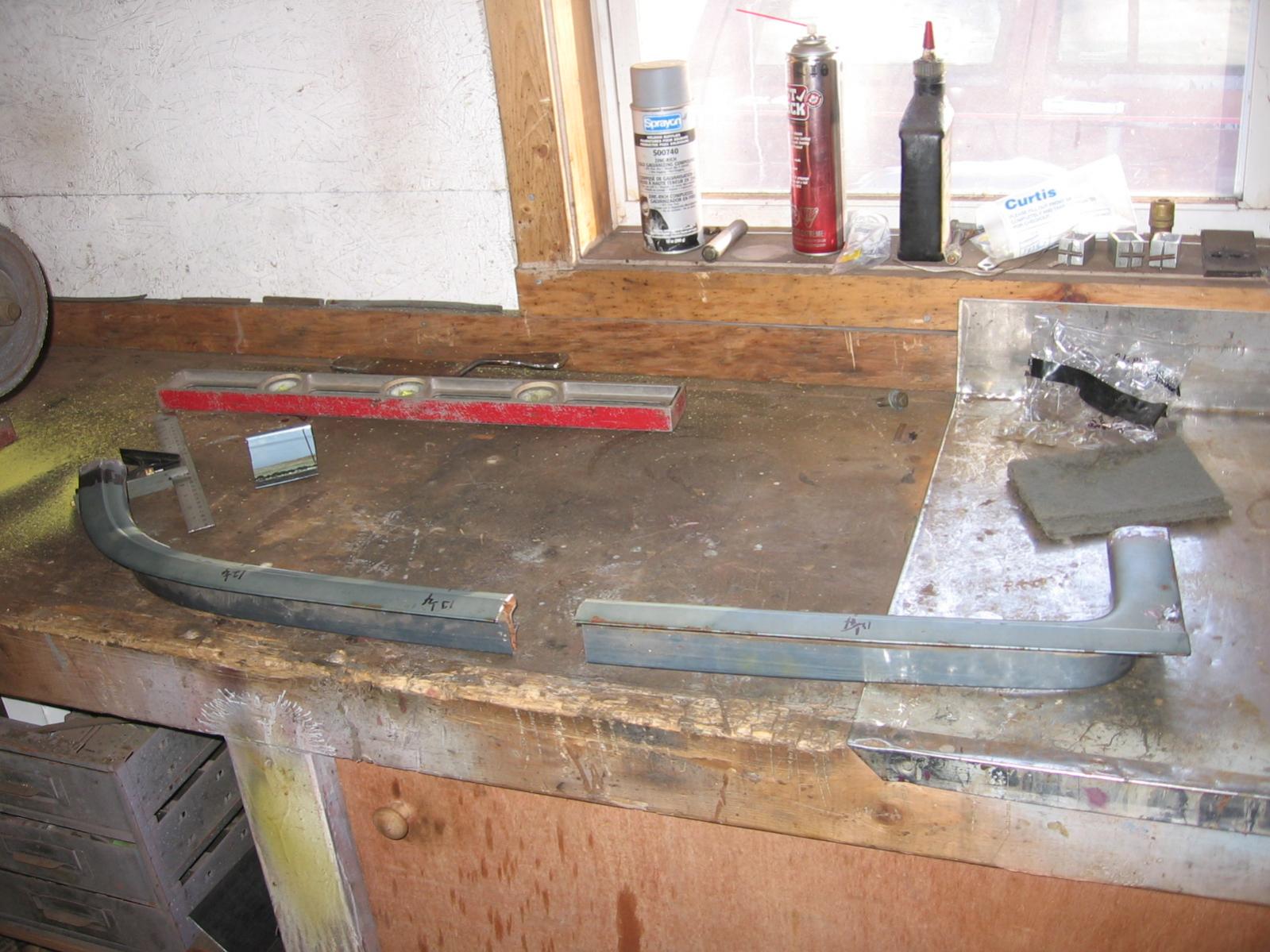

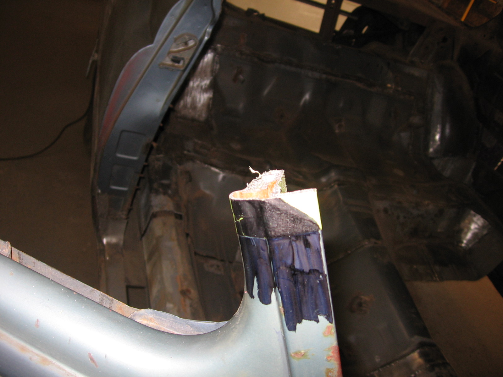

    Well Brerhair my first option is now the only option .I will go the full 3 inches at the A pillar . Today I cut one doortop off and cut the 2.5 inches by the B post. So I am now commited . 3 full inches at the A pillar. I have a few pictures from today . I wanted to see what 2.5 at the B posts looks like . I think thats the magic number . I suppose that I can go more if I want a more raked look as I go pillar to pillar . Well see .

    A few pics from an hour and a half I was able to steal away from the day.
