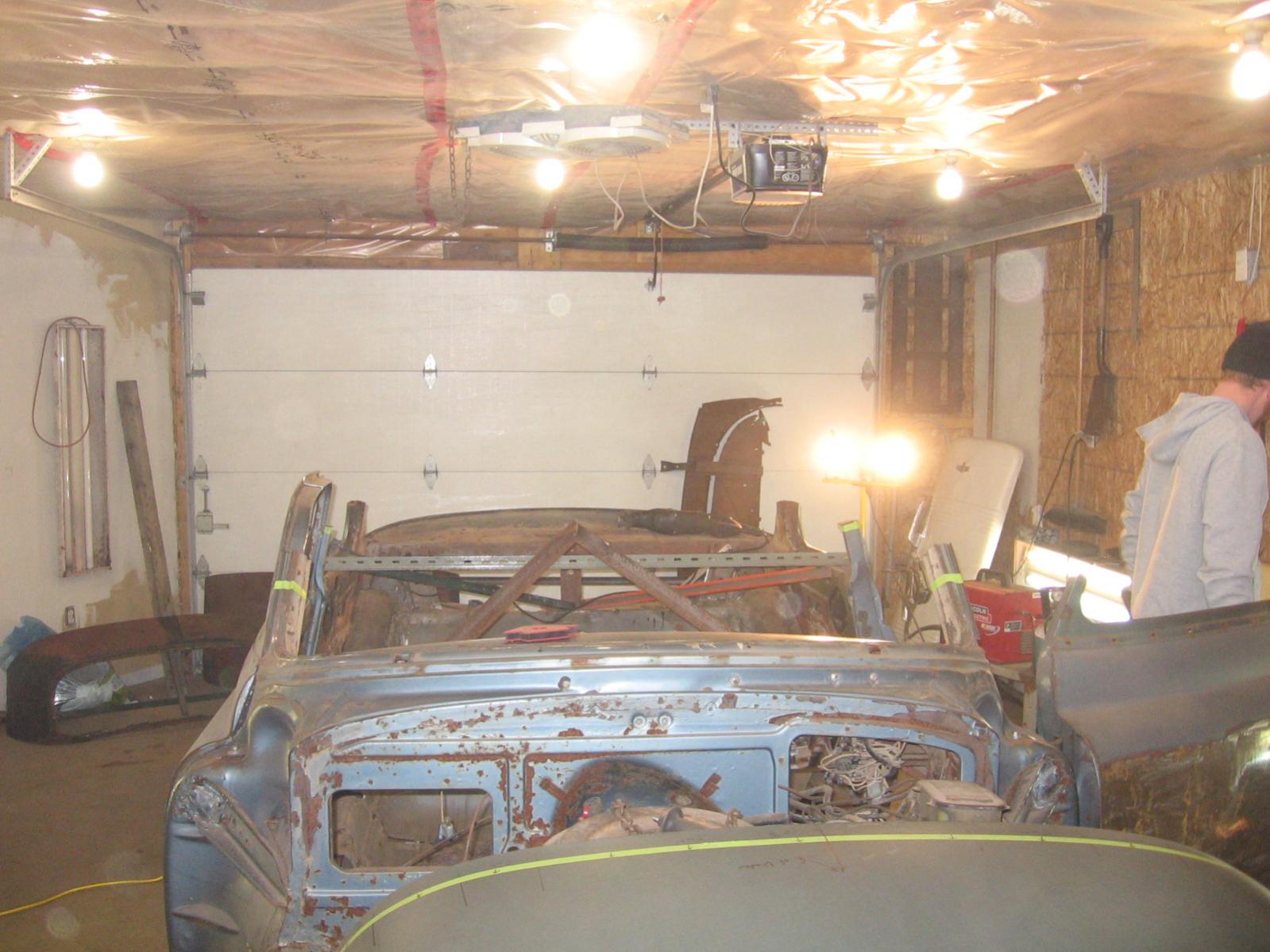

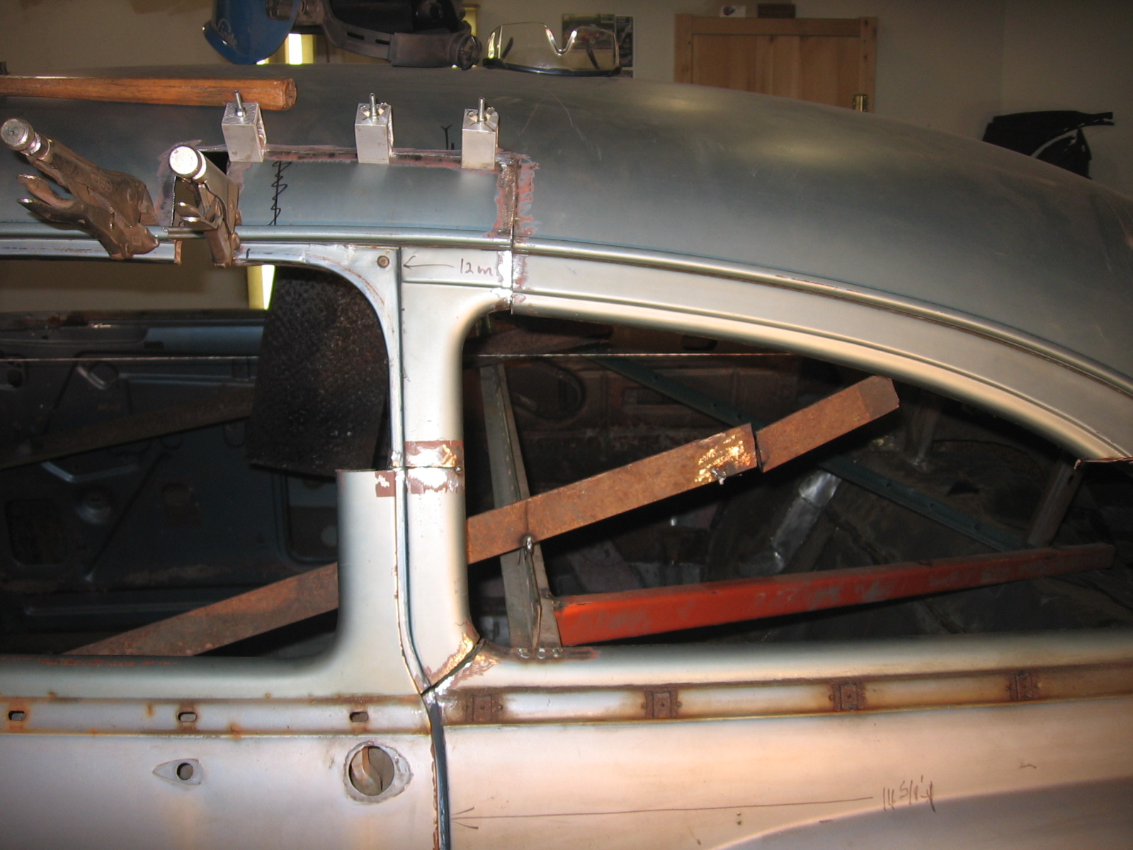

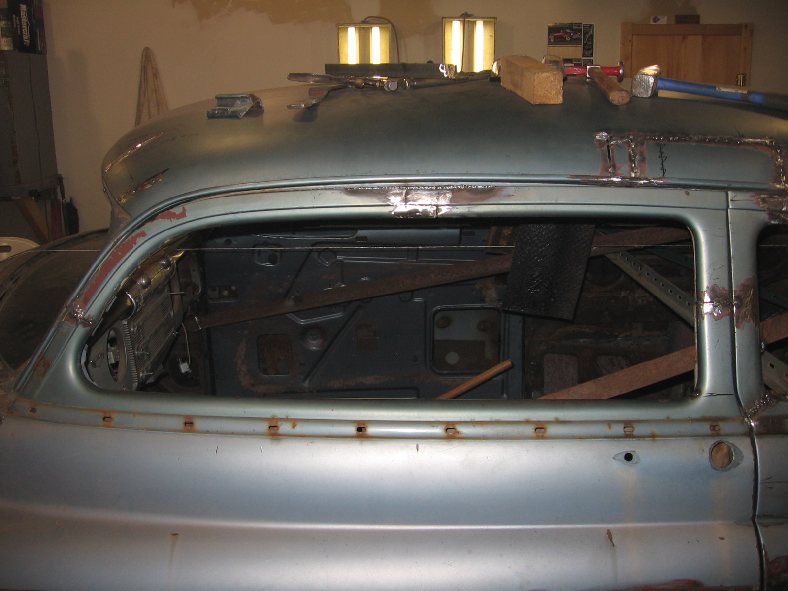

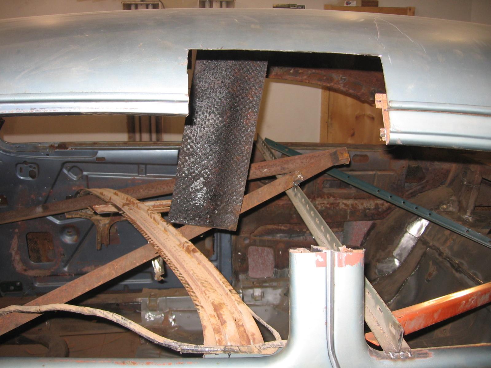

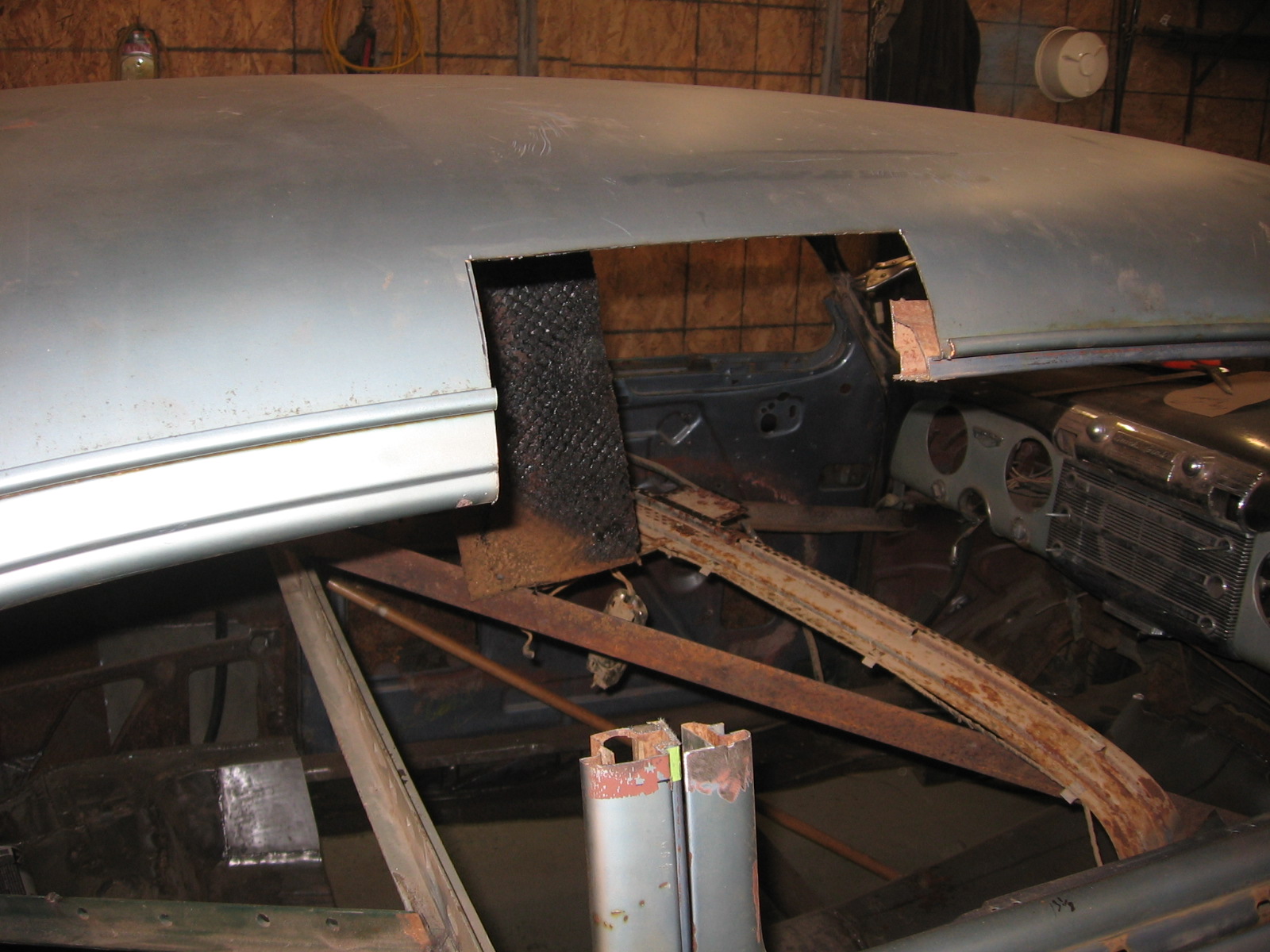

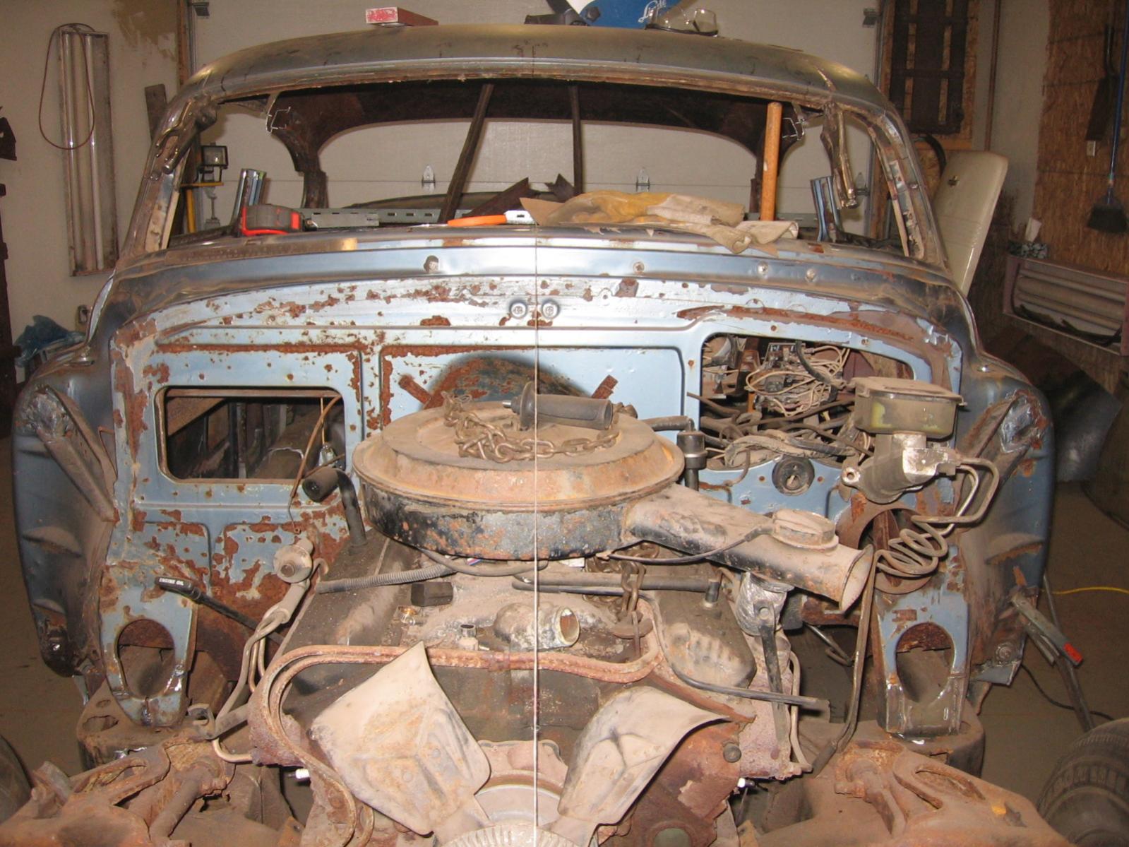

    Well I did not think this would get started toady , This far aways . Drivers door cut and out of the way . All braced up and ready to go . The 52 Window gets the nod . I personally like the looks of the big C pillar . It gives it more of a custom touch in my opinion !! Number 5 No turning back now . No 7 chopped the 3" and reinstalled to get a feel of the look . More pics comin ! Andy...

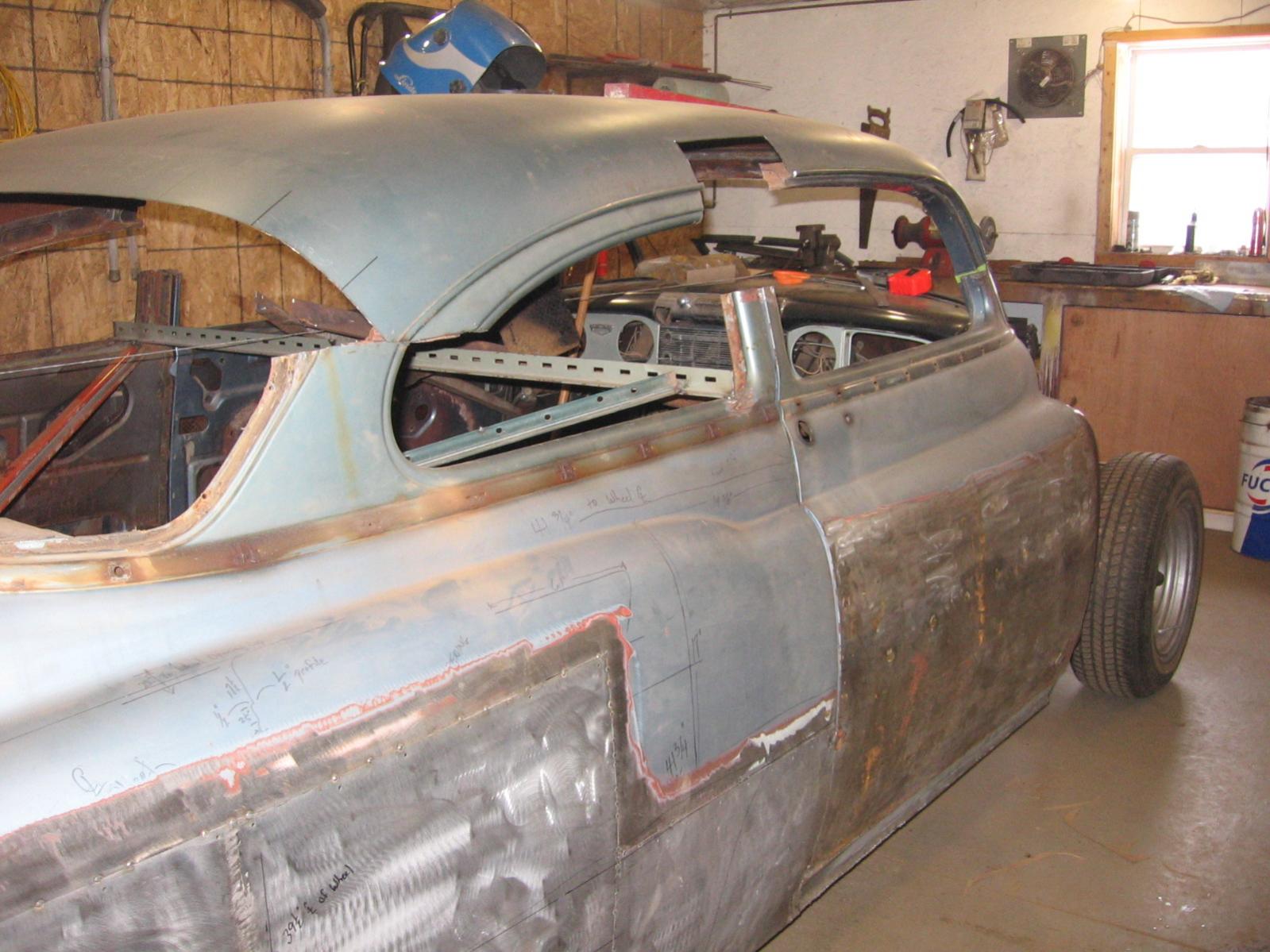

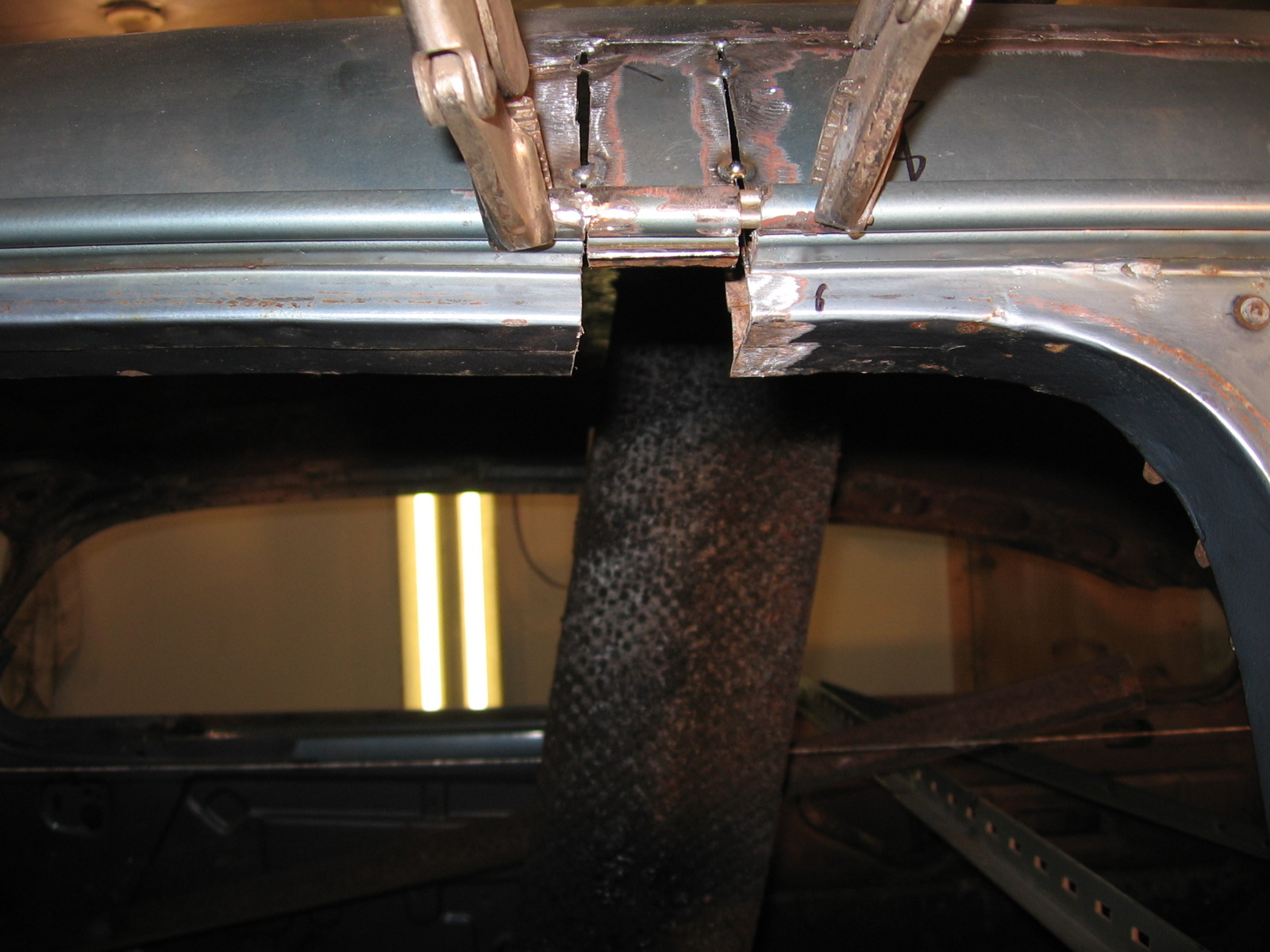

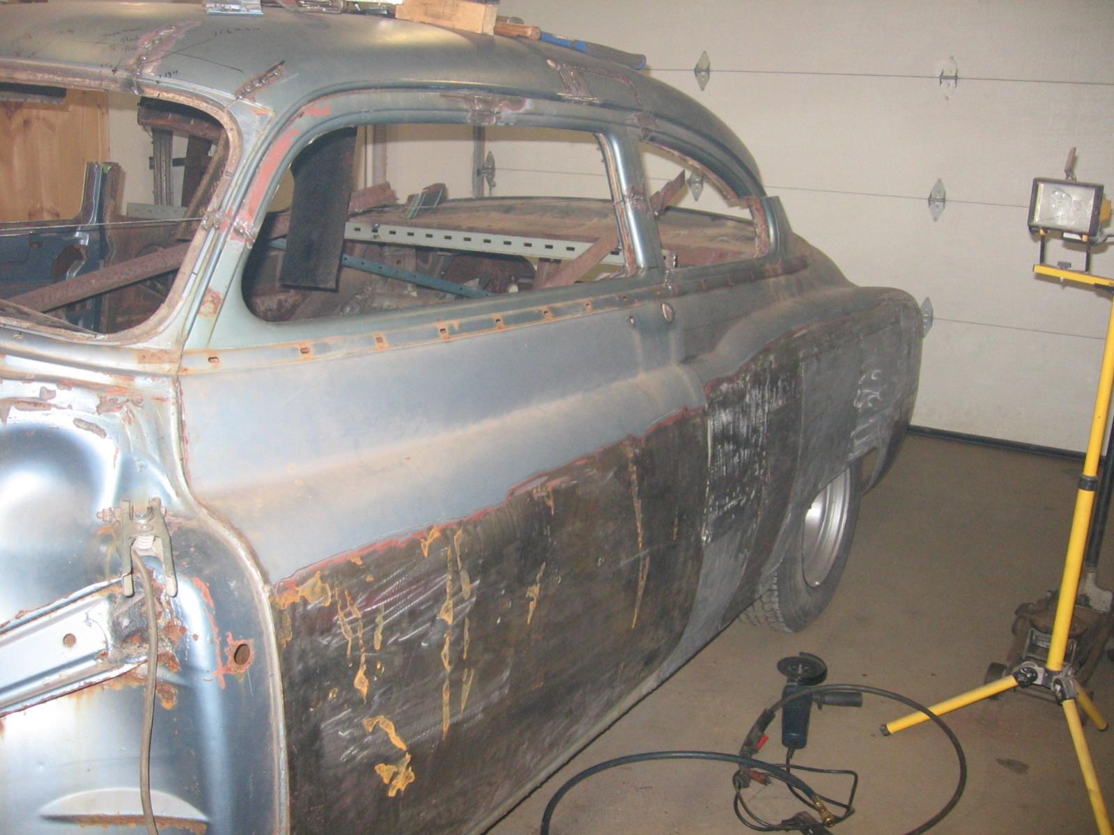

    More pics from the days progress . Now the fun begins with lots of realignment of A,B and C pillars . Will start at the front and move to the rear .

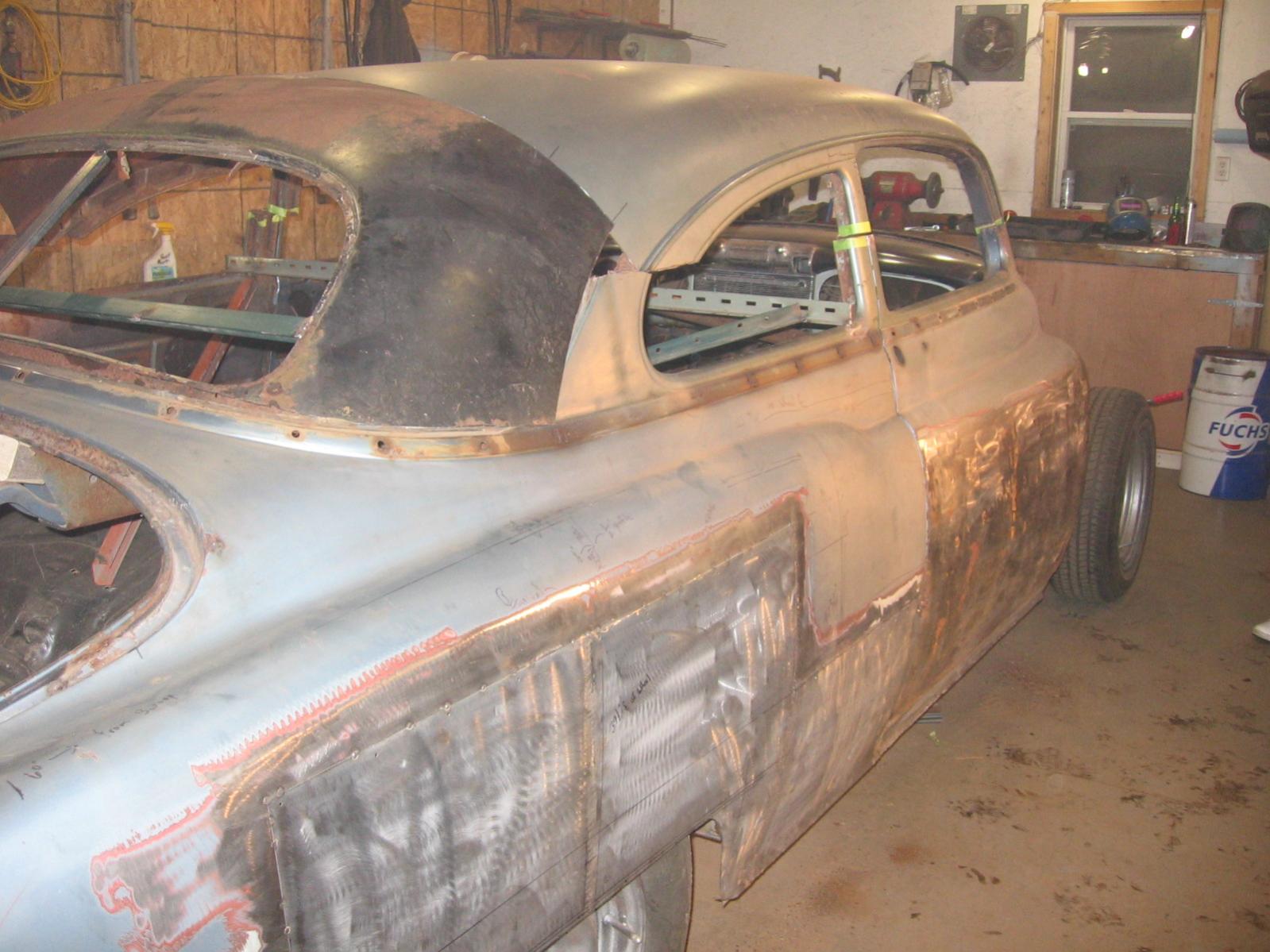

    Some more pics . I will let the pics speak for themselves . Just another chop thread. Same **** different pile . Thanks James D , Andy..

    Thanks Fitzee . Got a guy comin over this morning and I am thinking of another 1/2" at the A pillars I am not sure yet though . I need some help with the big old floppy piece of sheetmetal .Take some braces out of the roof and man does it looses strength, go figure :rolleyes: Did you get the front frame rails off of the 52 yet ? / grafted onto flatliner ? . Andy

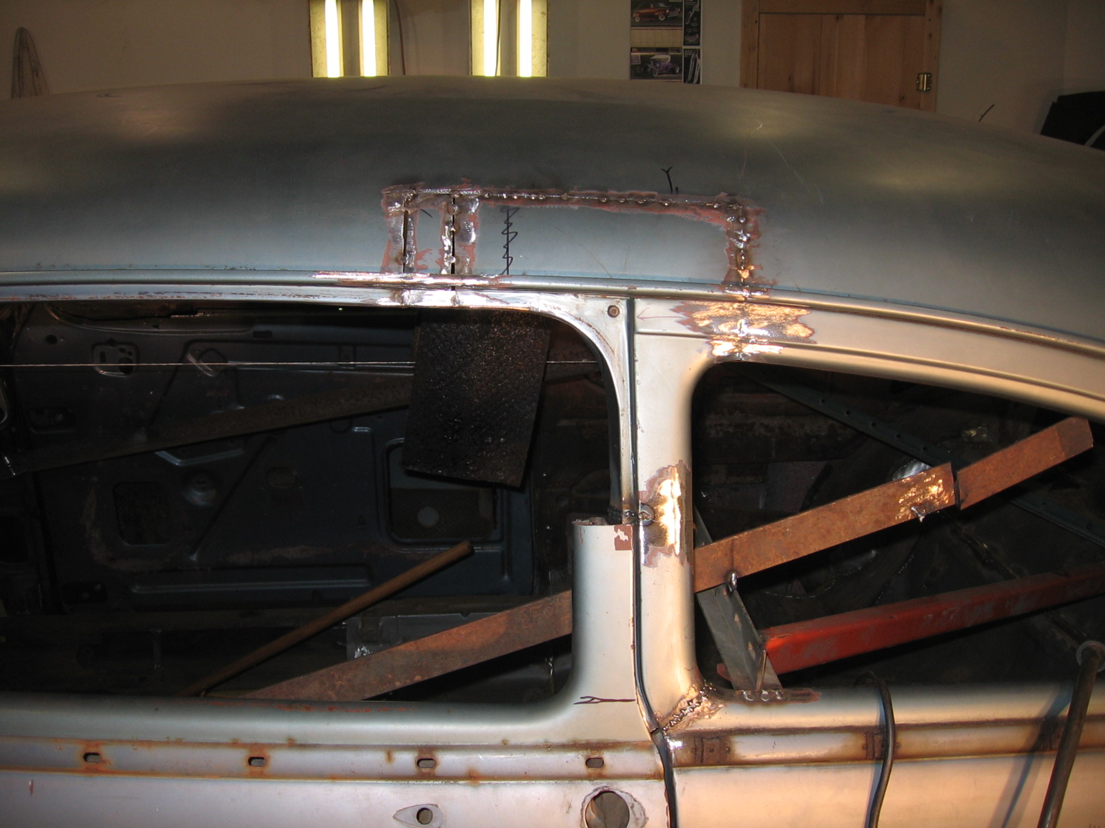

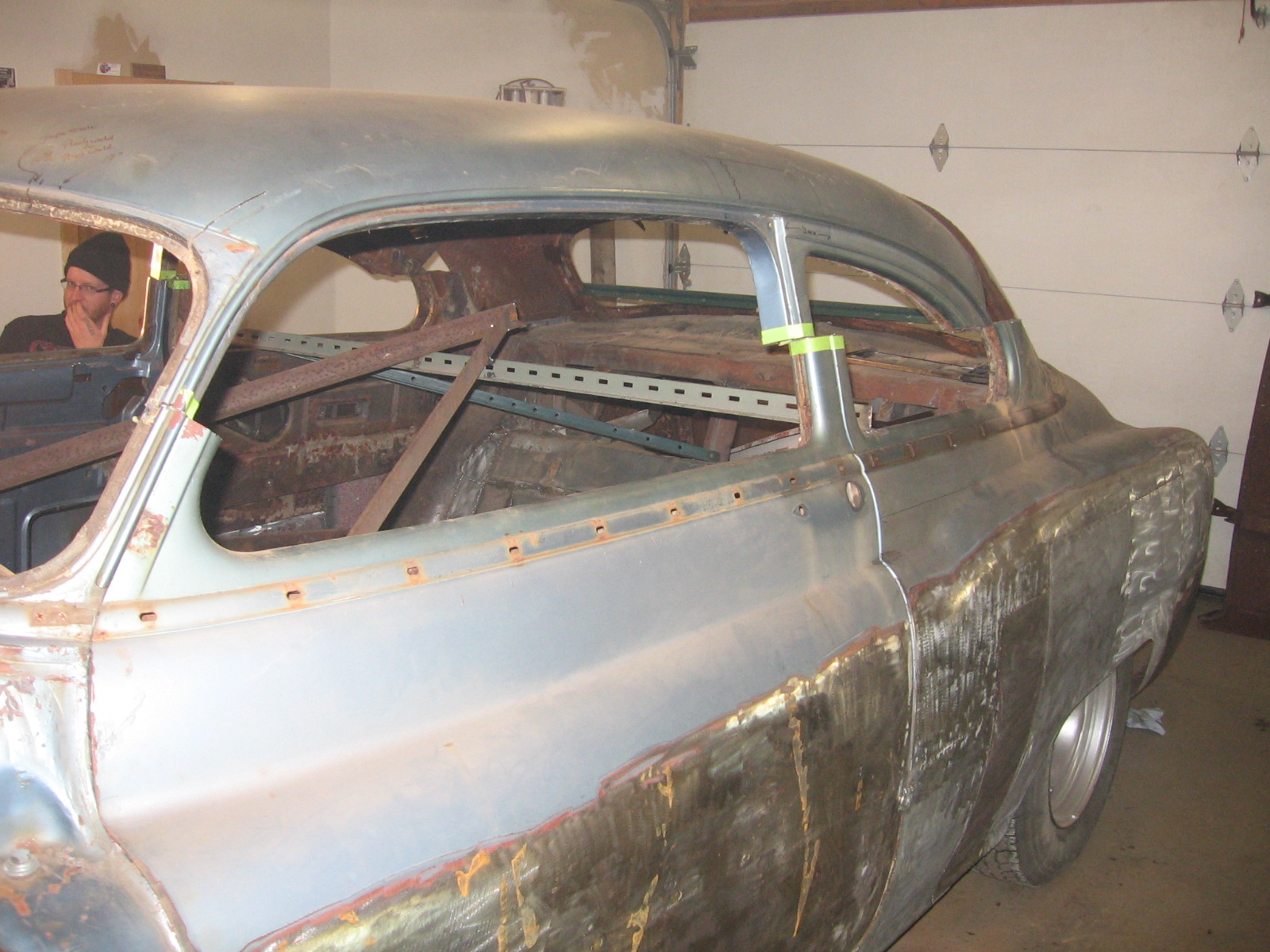

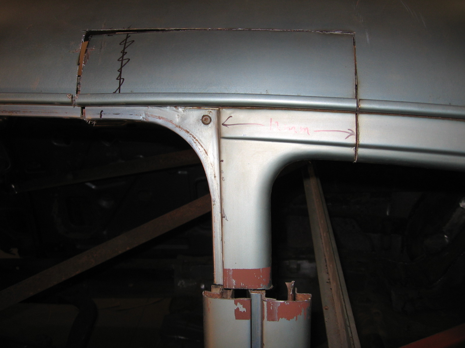

    You getting that new shop built yet Doug . Thanks for the words of encouragement . I screwed up and have to undo the A posts that are tacked on . I have one A pillar roof section (P***enger Side ) that looks good and one that has a noticable low spot . I know what I did and it needs to come apart and the two slices I made at the roof corners need to be symetrical to one another.I failed to do that and one post had to be pulled and the other was just put in place . Thats why it dosent look symetrical from side to side . Better to find this little blunder now . Not to bad of a fix , at least I figured it out and didn,t try to cover it up with a ton of filler. :rolleyes: Later , Andy...

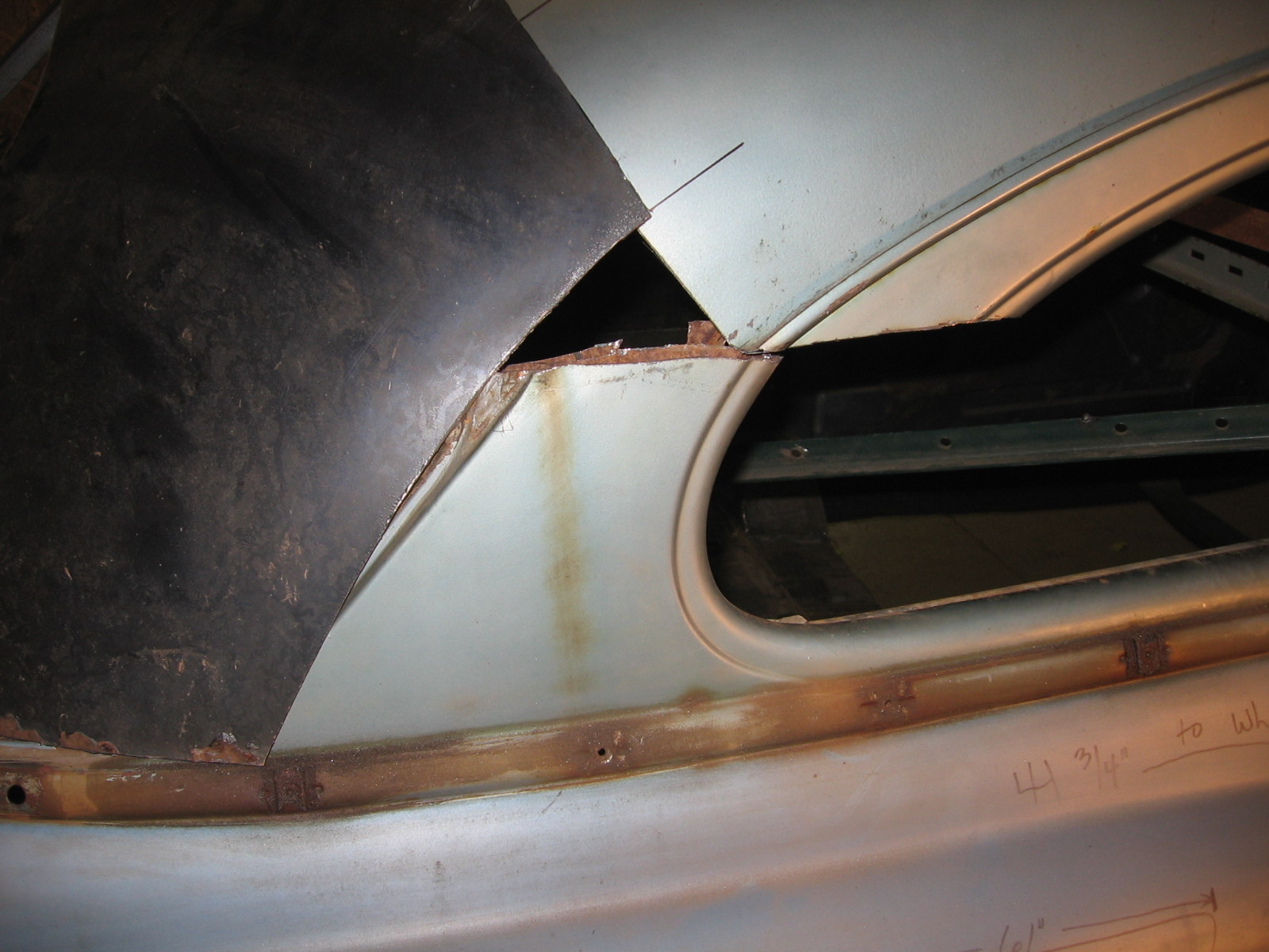

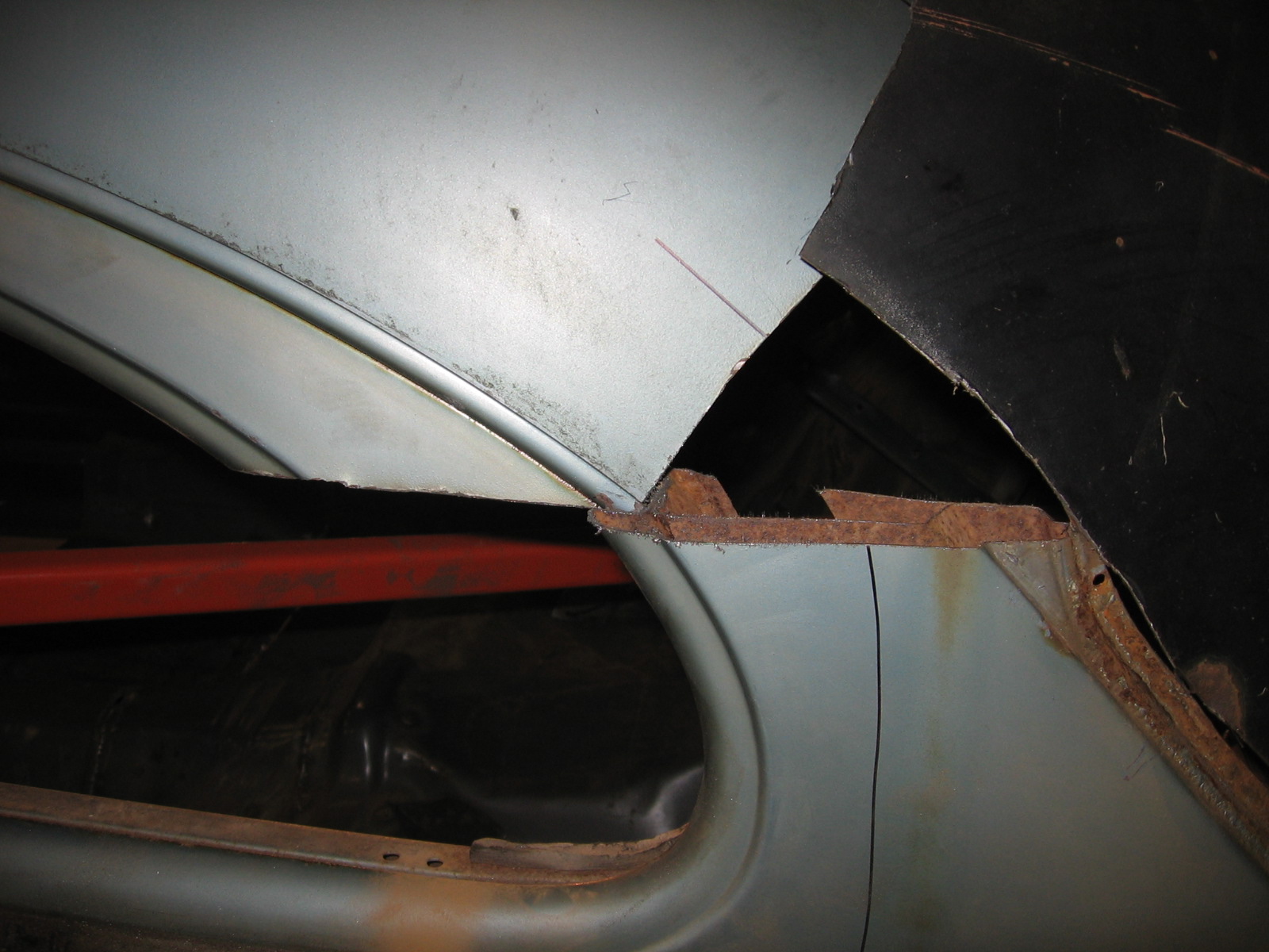

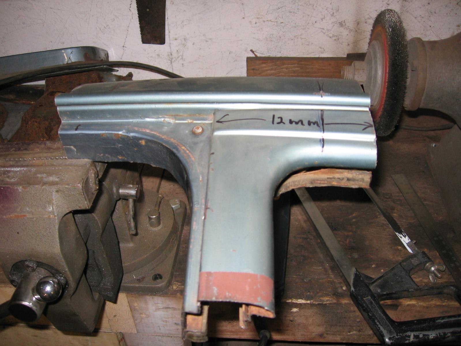

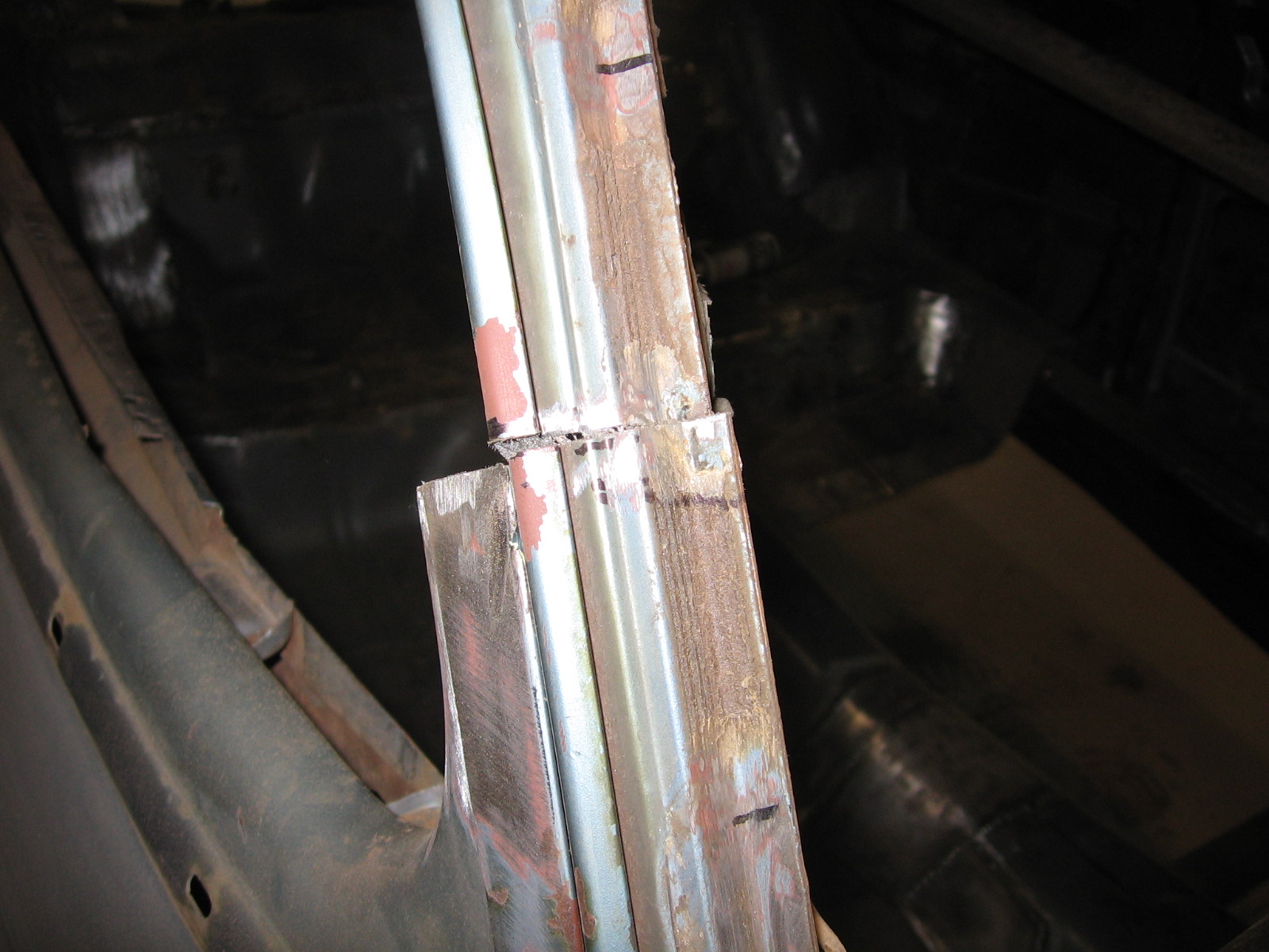

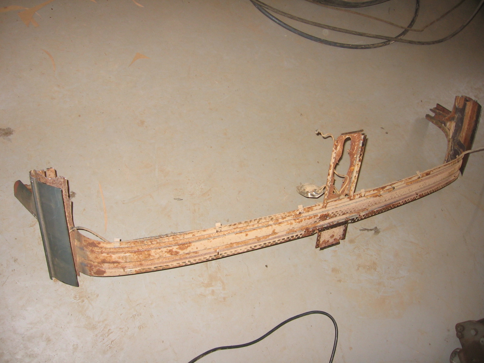

    Starting on the B Pillar reconstruction . Had to cut the whole post off to get the proper angle . I made some panel clamps a few weeks ago . They come in some handy . I need to make some more . I only have these 3 for now . Starting the filler piece at the driprail is the last picture . Andy

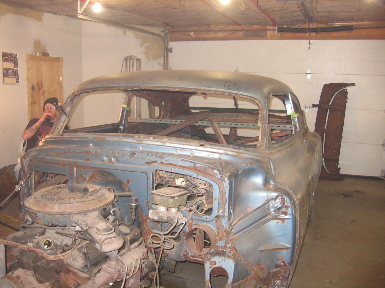

    A few more ! This stuff takes time thats for sure . I was in the shop at 8:30 AM til 5:00PM tonight . Progress none the least . I have a line on a 47 Desoto that a guy wants gone for nothing . Dont know what I would do with it we'll see . ??? Andy..

    Brerhair , the A pillar issue in simple terms , I ****ed up and only cut one roof section above the windshield and left the other uncut .When I did that the roof got flatter on that side as it spread to meet the A pillar . Physics man physics LOL . Then I couldnt figure out why one side looked high and stock looking and the other side looked like it was flatter . Fixed it by putting a slice at the same spot on each side . Now it looks symetrical .
