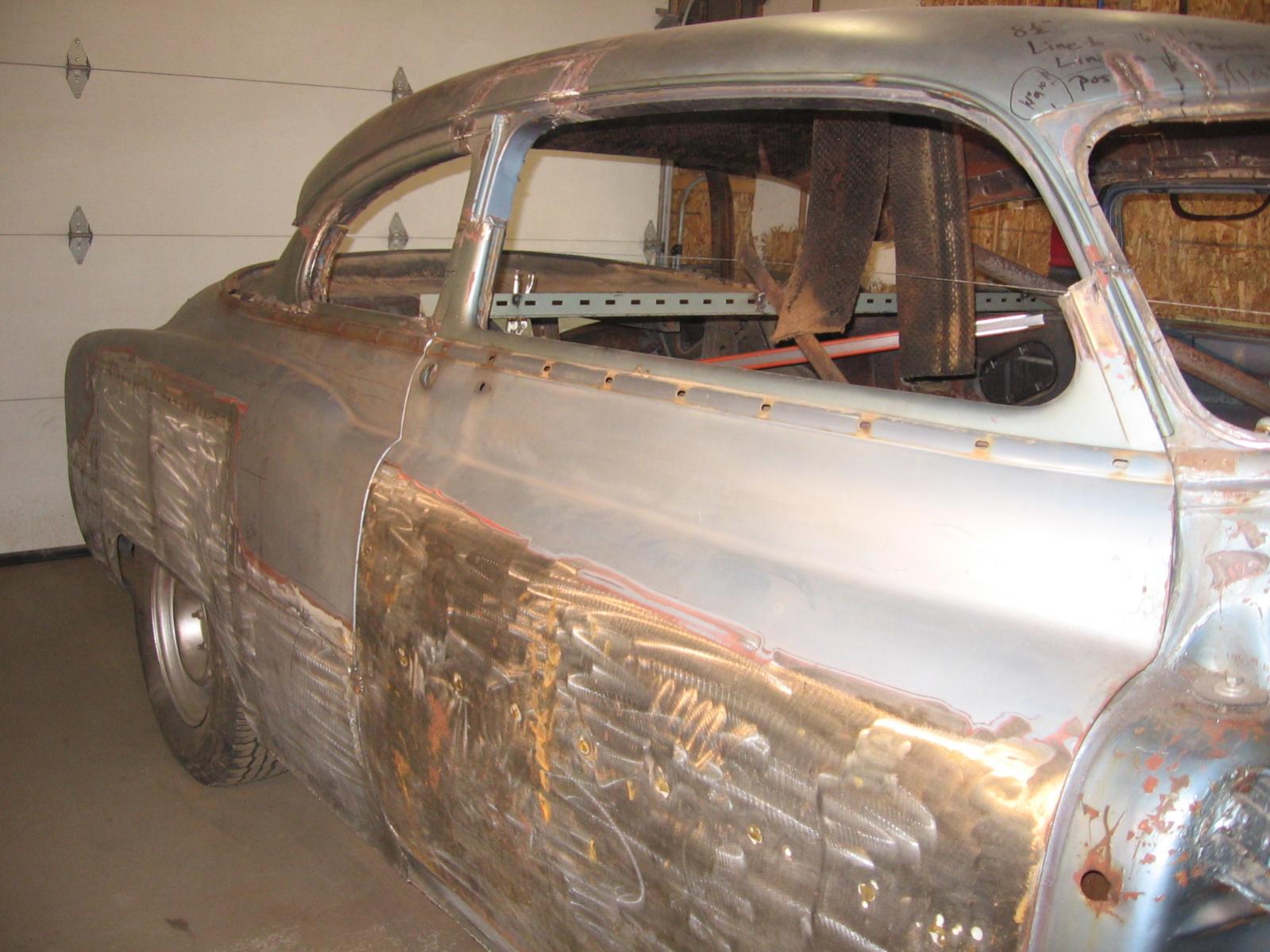

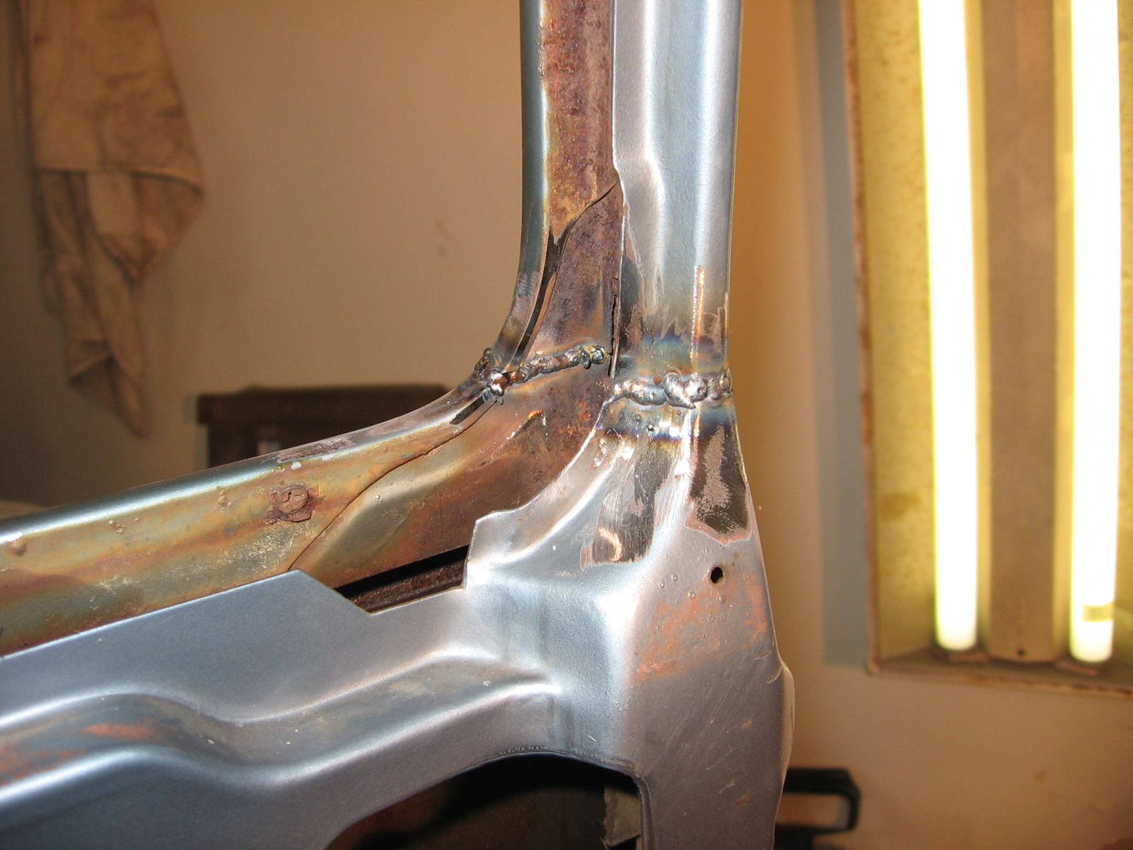

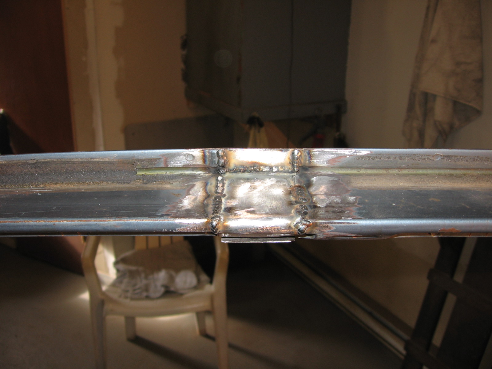

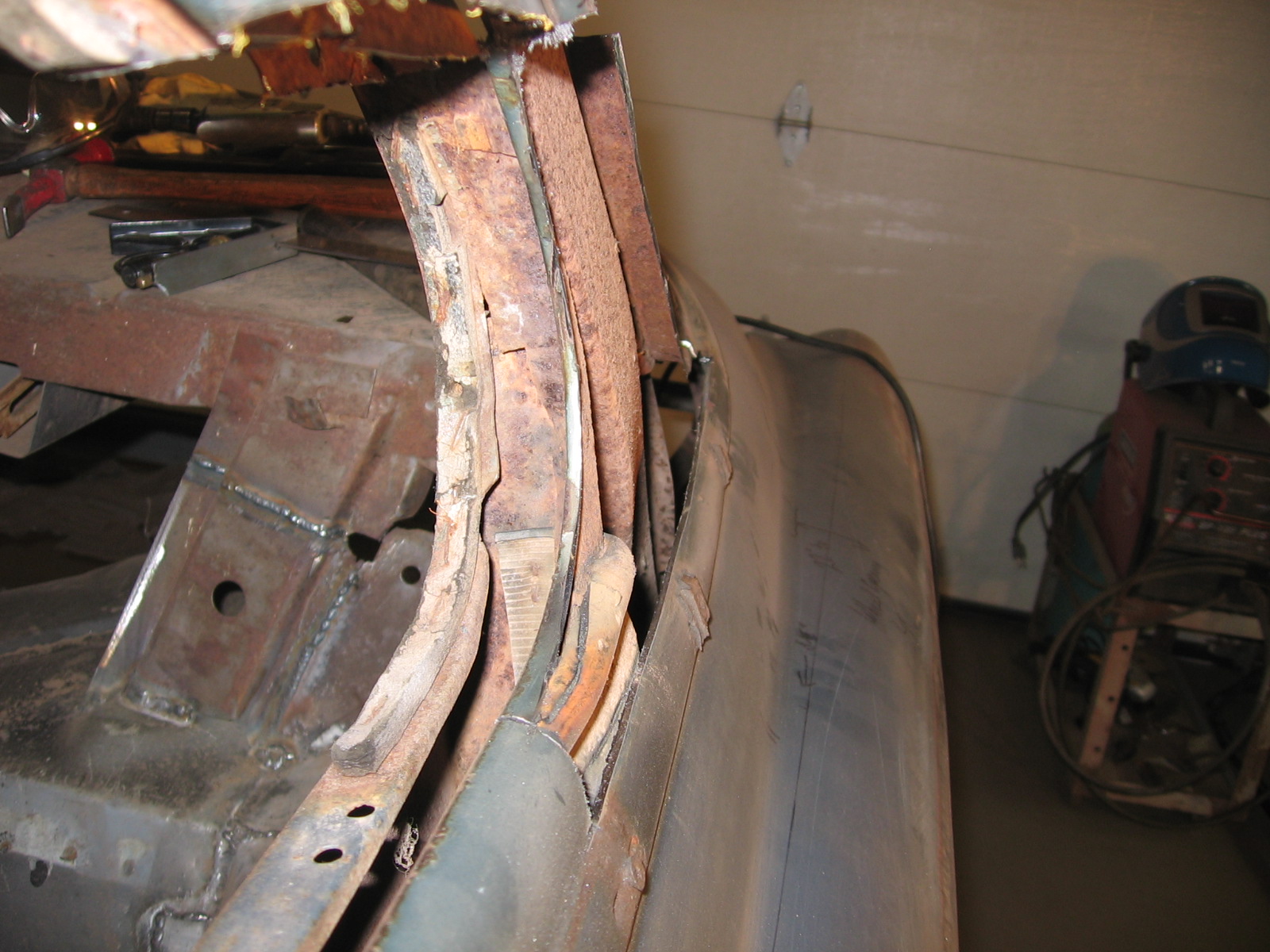

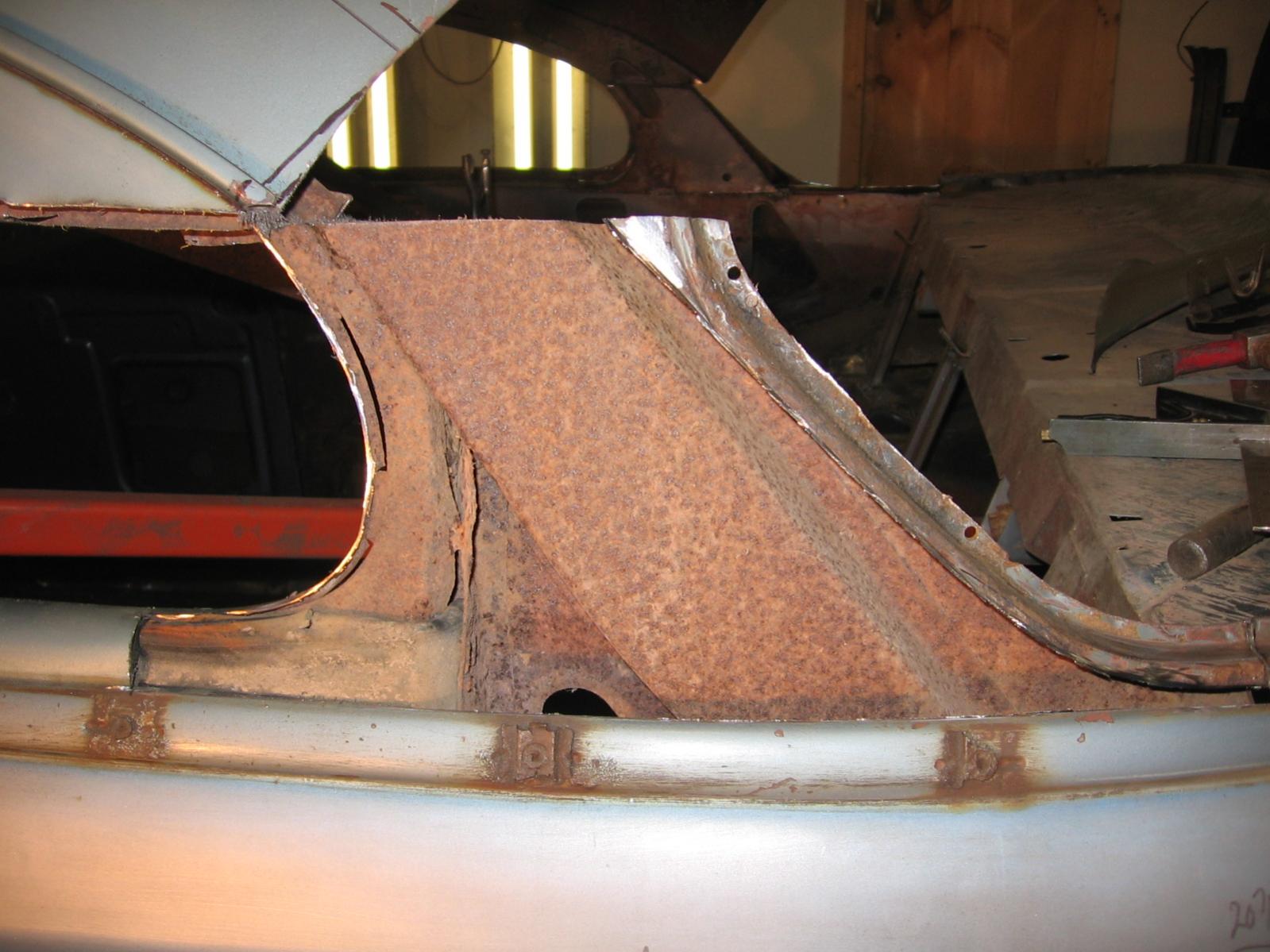

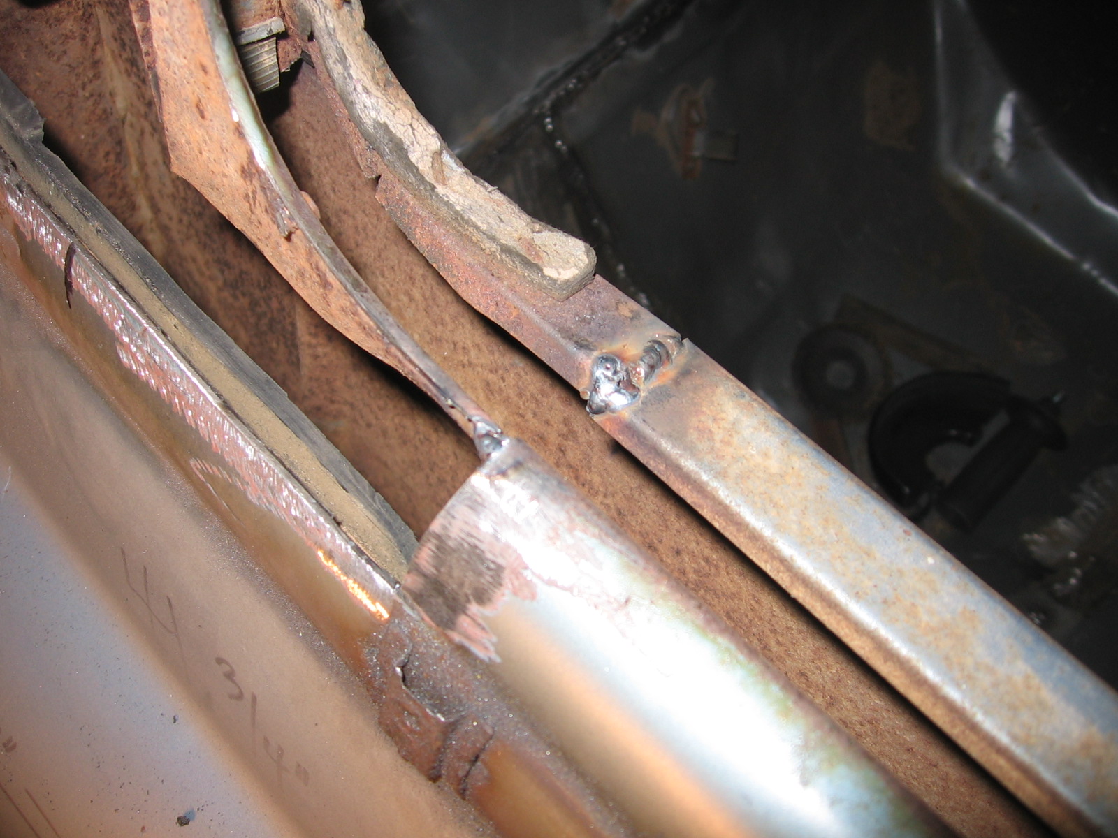

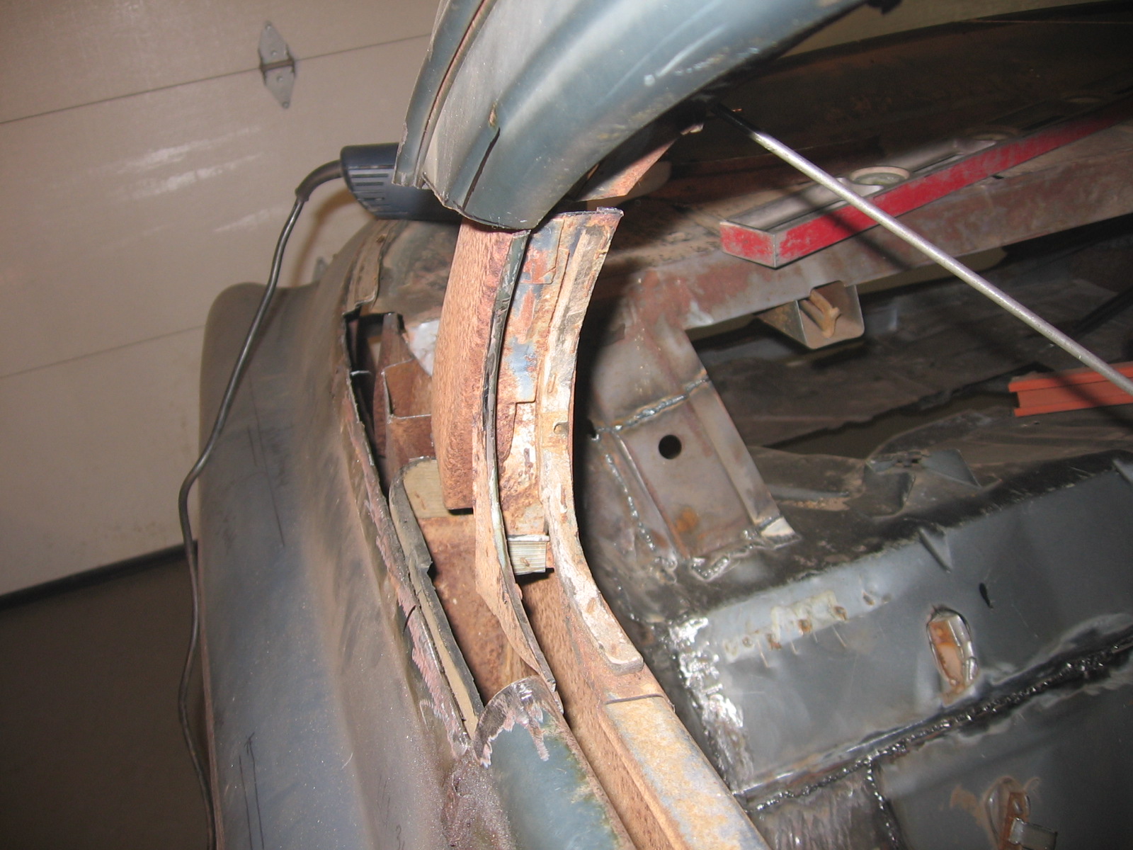

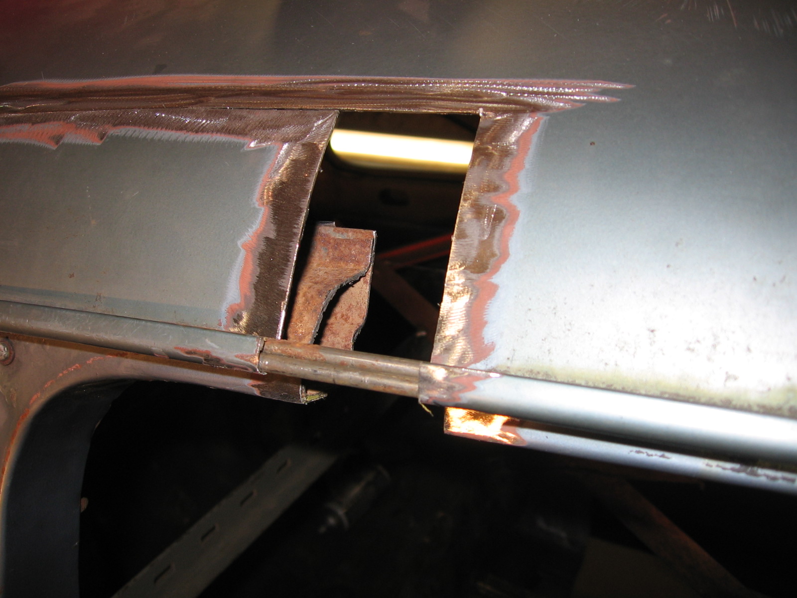

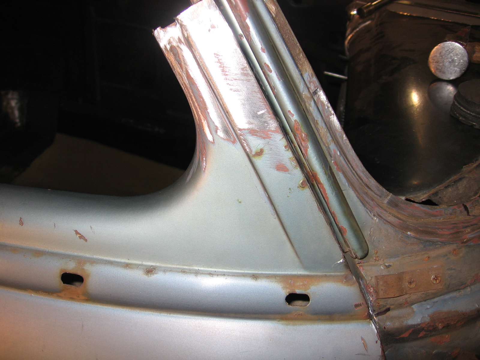

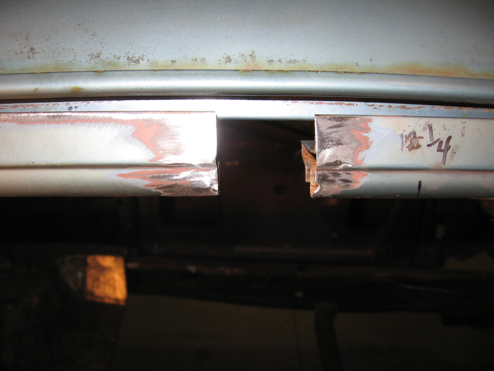

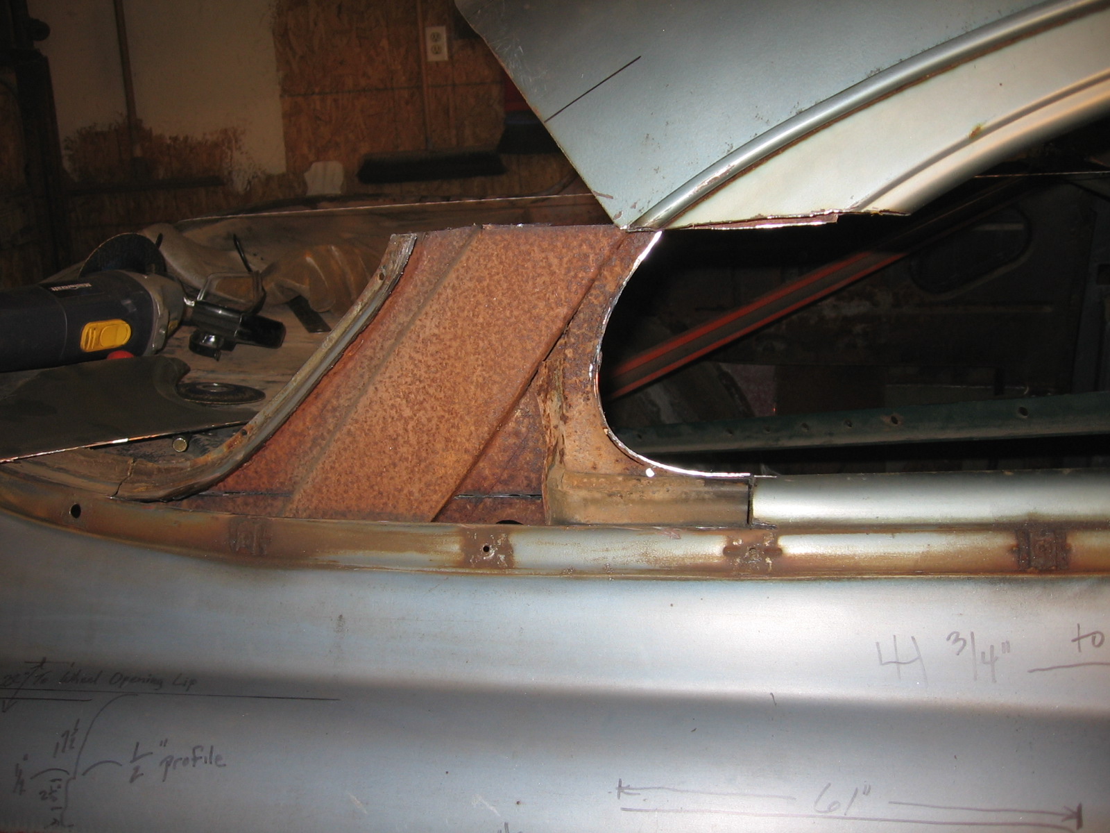

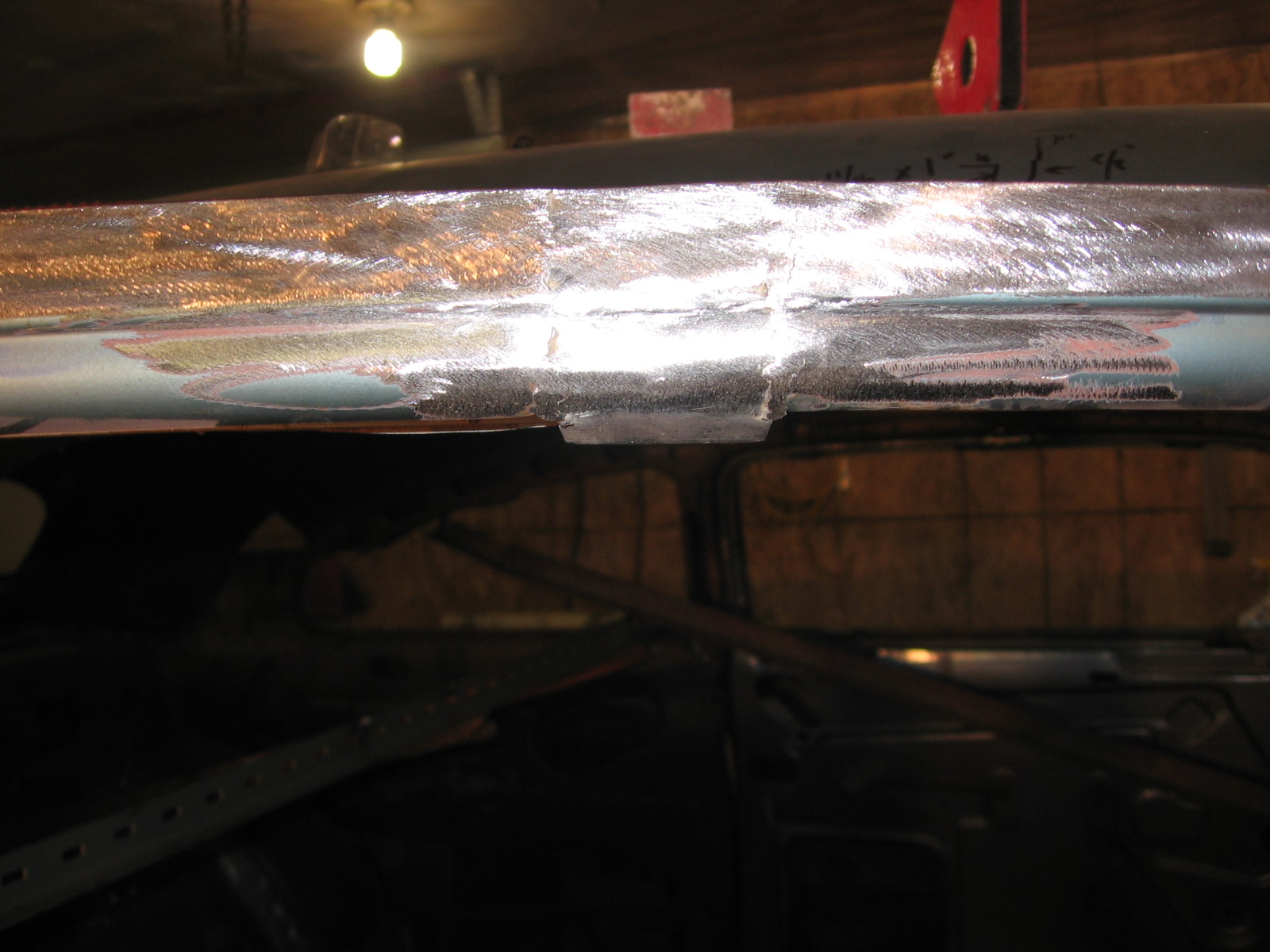

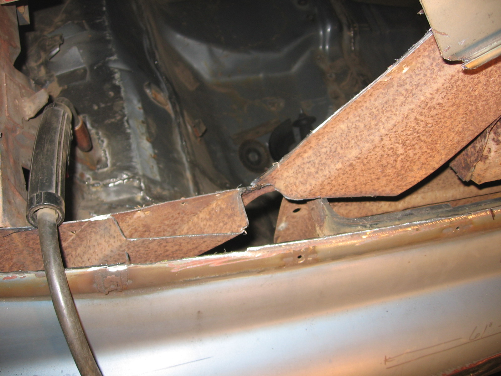

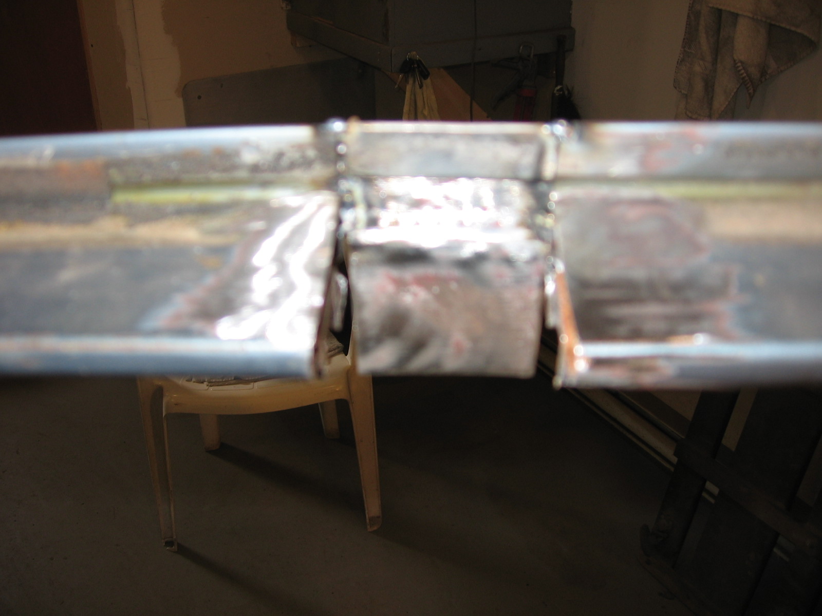

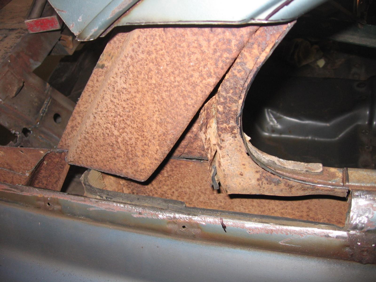

    More progress on the Buick today . I started on the B pillar right side . Pissed around fitting the post till it was a match with the other side . I am off 1 degree in regaurds to the lean inward of the pillars . Not noticible at all . This side went together easier and straighter than the left side . Pic 6 is the start of the C pillar dis***embly . I sliced the skin off of the C pillar so I could get to the inner structure . Andy..

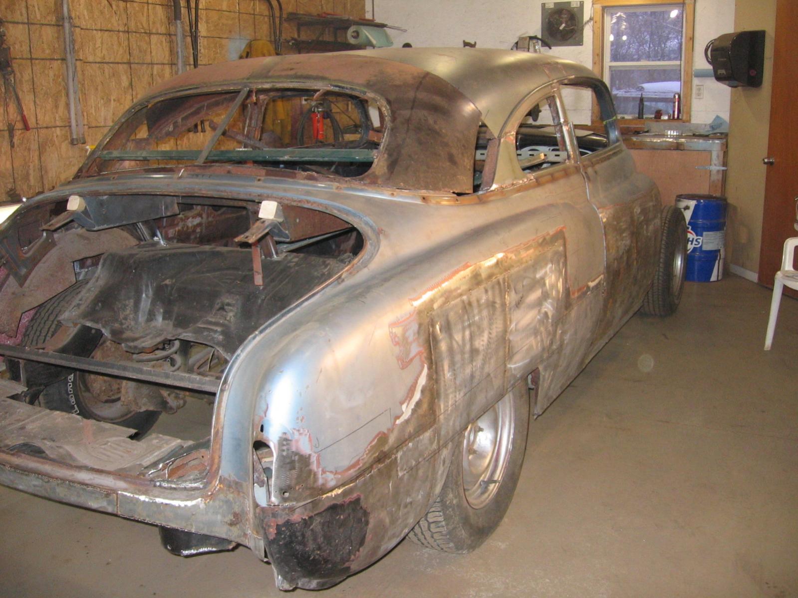

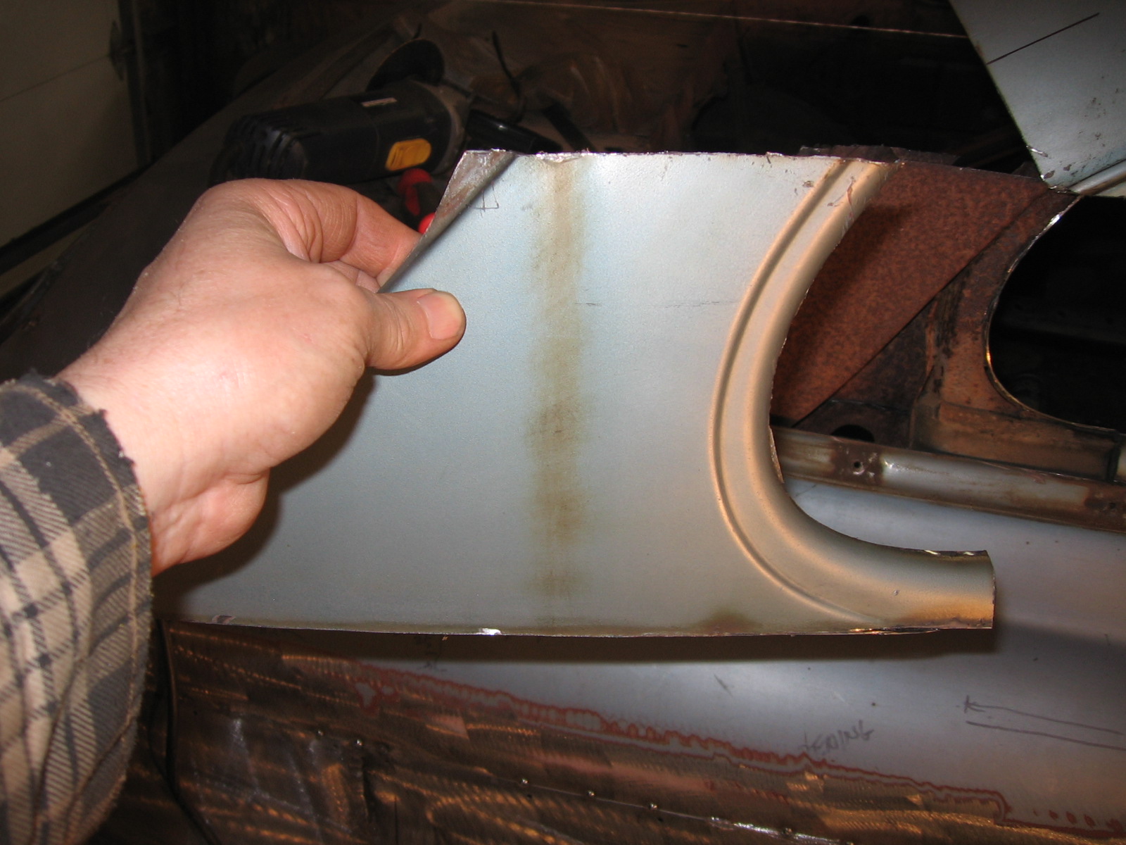

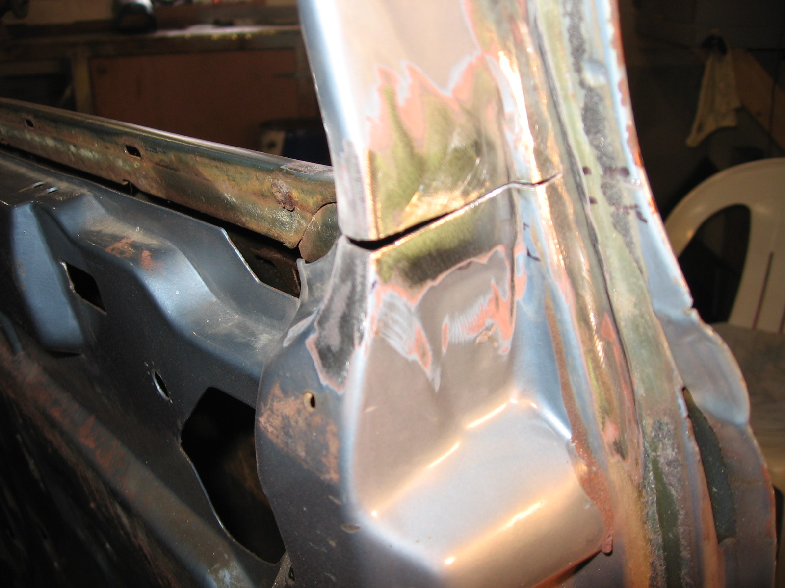

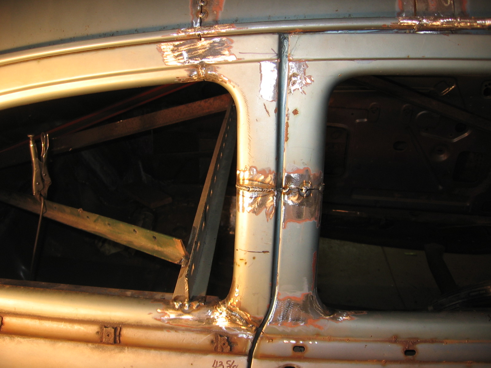

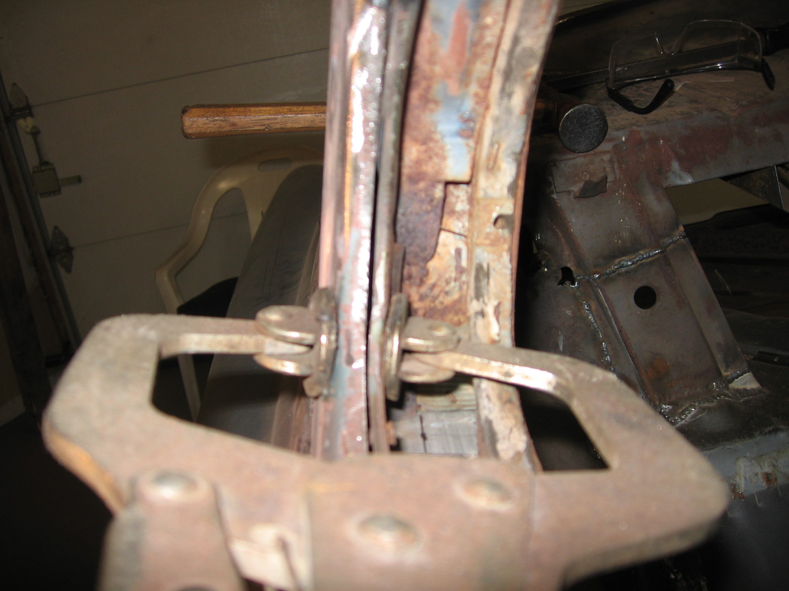

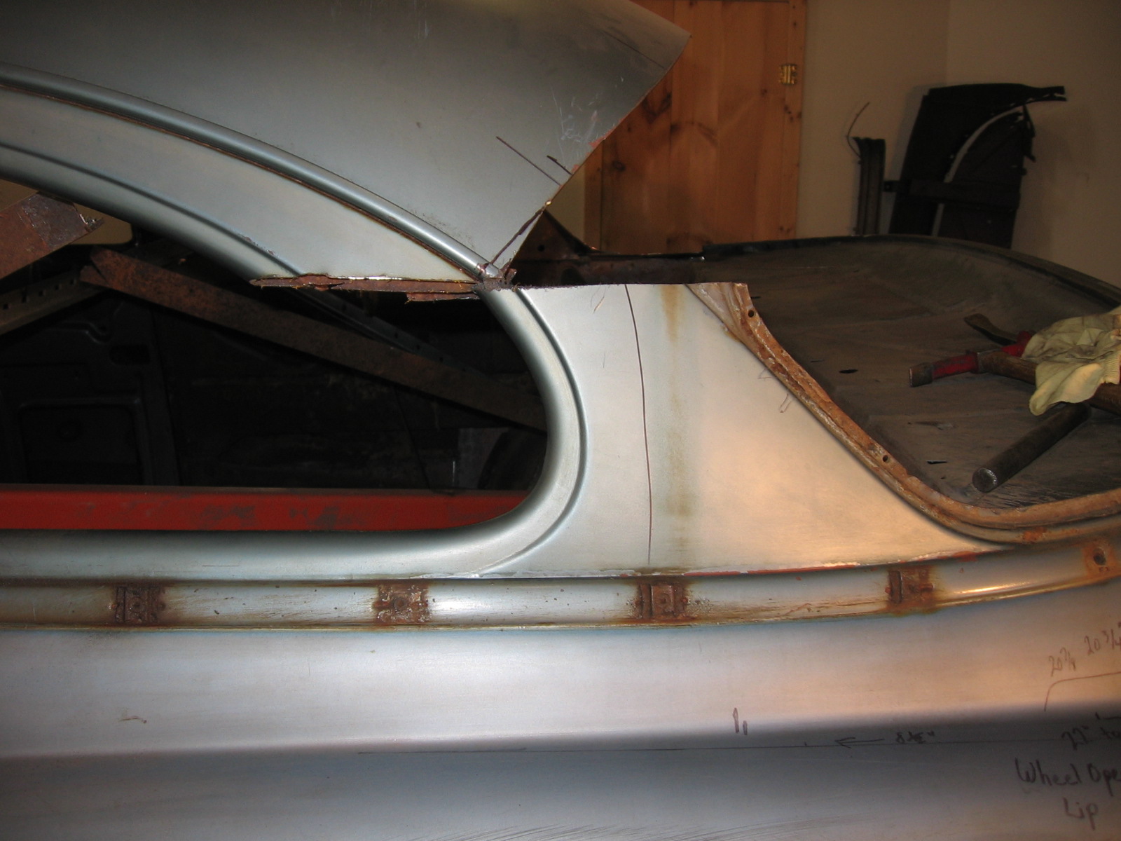

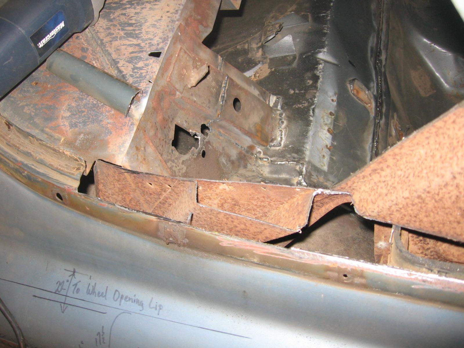

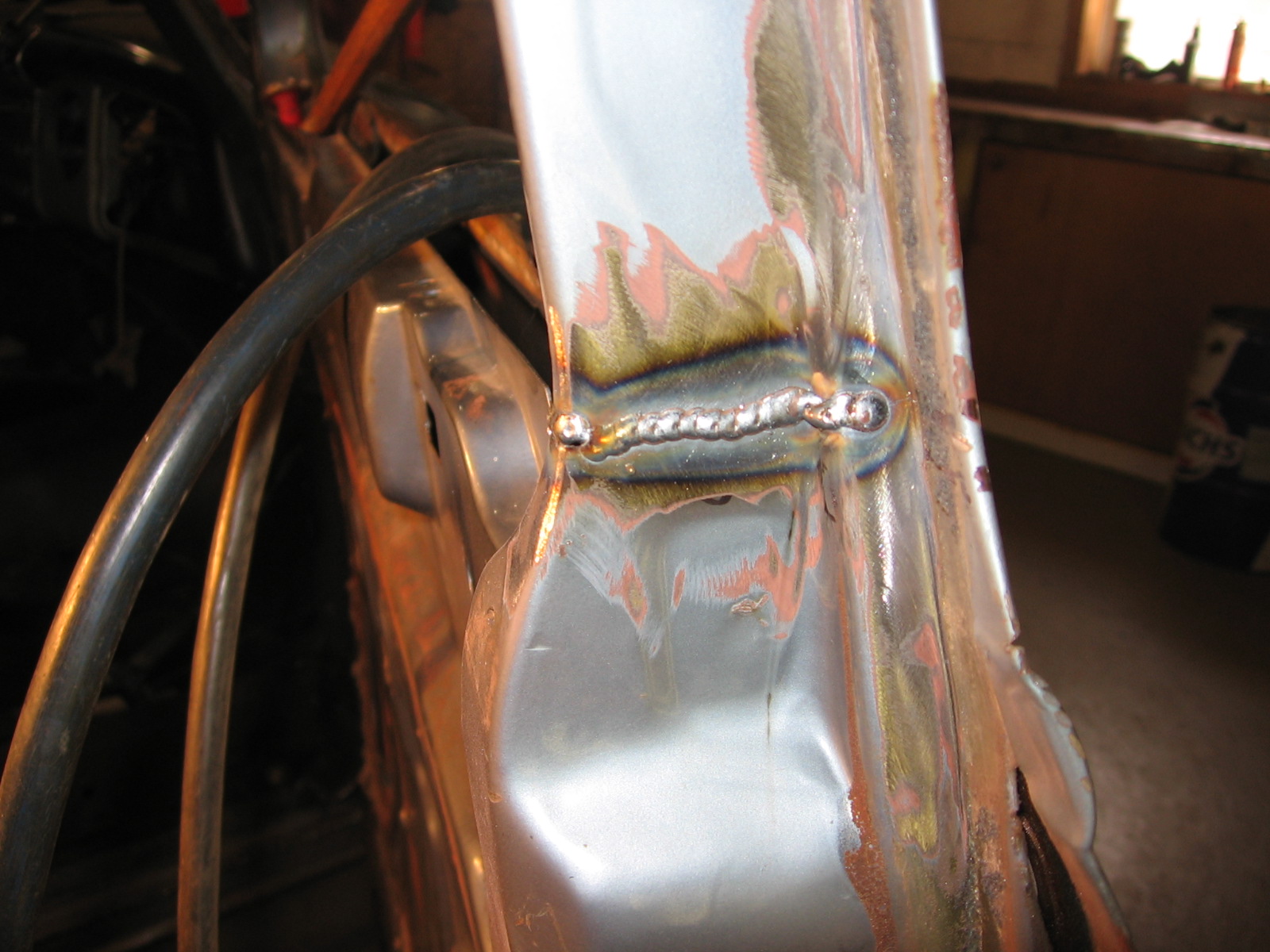

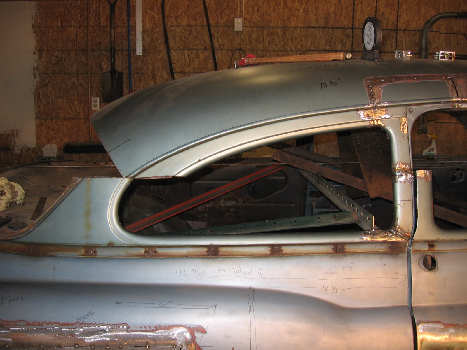

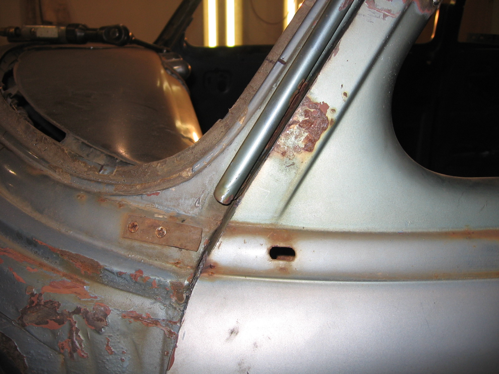

    More of the C pillar . Cut out the rear structure . Mock up of the C pillar curve . I didn't have to slice the panel at all for the curved part like so many chops I've seen . Works for me . I had to slice through the skin at the curve close to where the window rolls up into the panel . There will be a picture coming with visegrips squeezing the two panels back together . I will weld a panel on the inside off the C panel that will act as a transition plate from one half of the C panel to the other for strength . It should strengthen it enough .

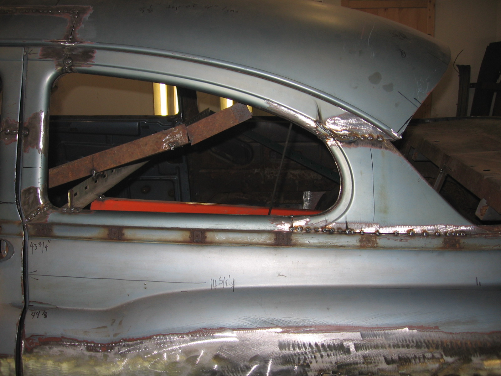

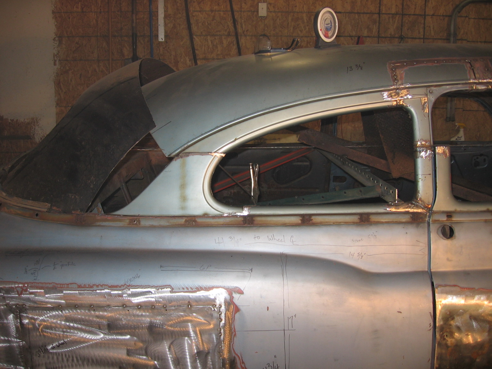

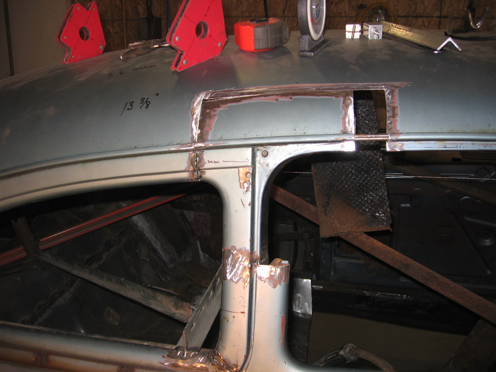

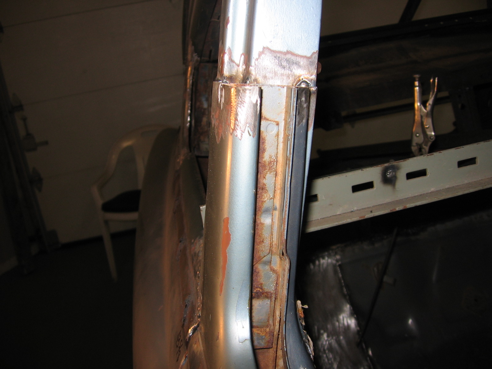

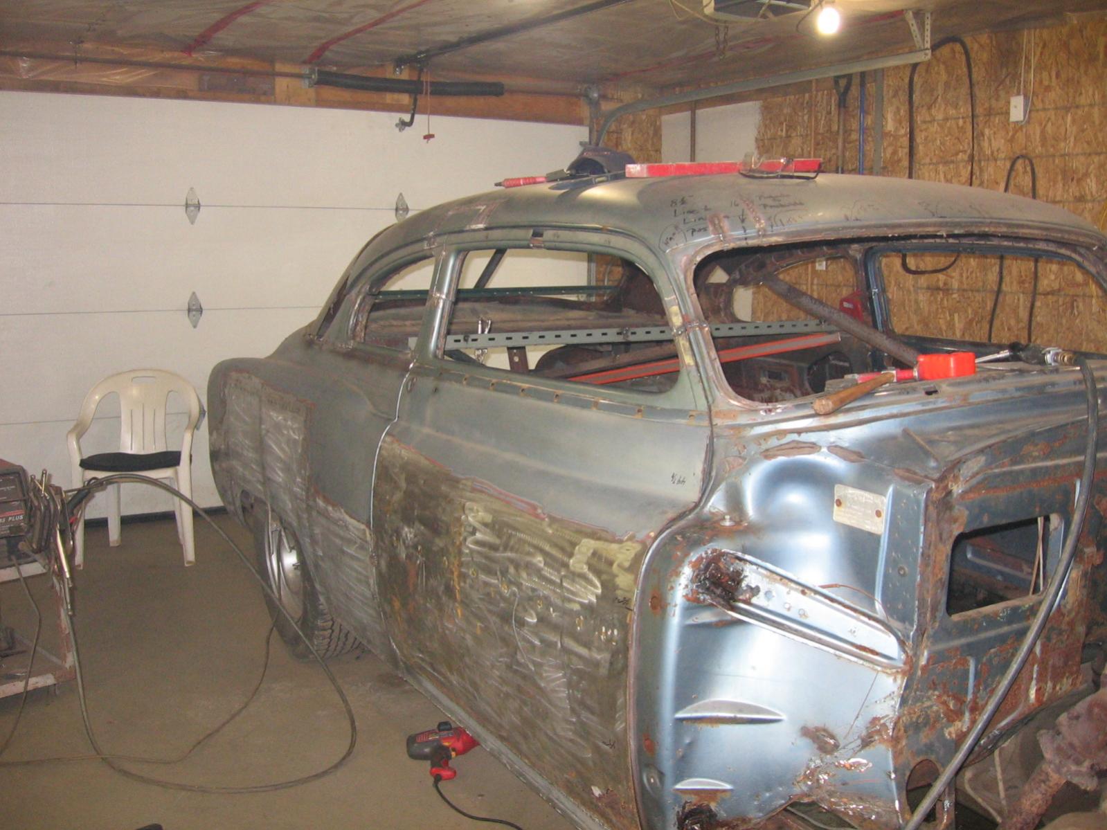

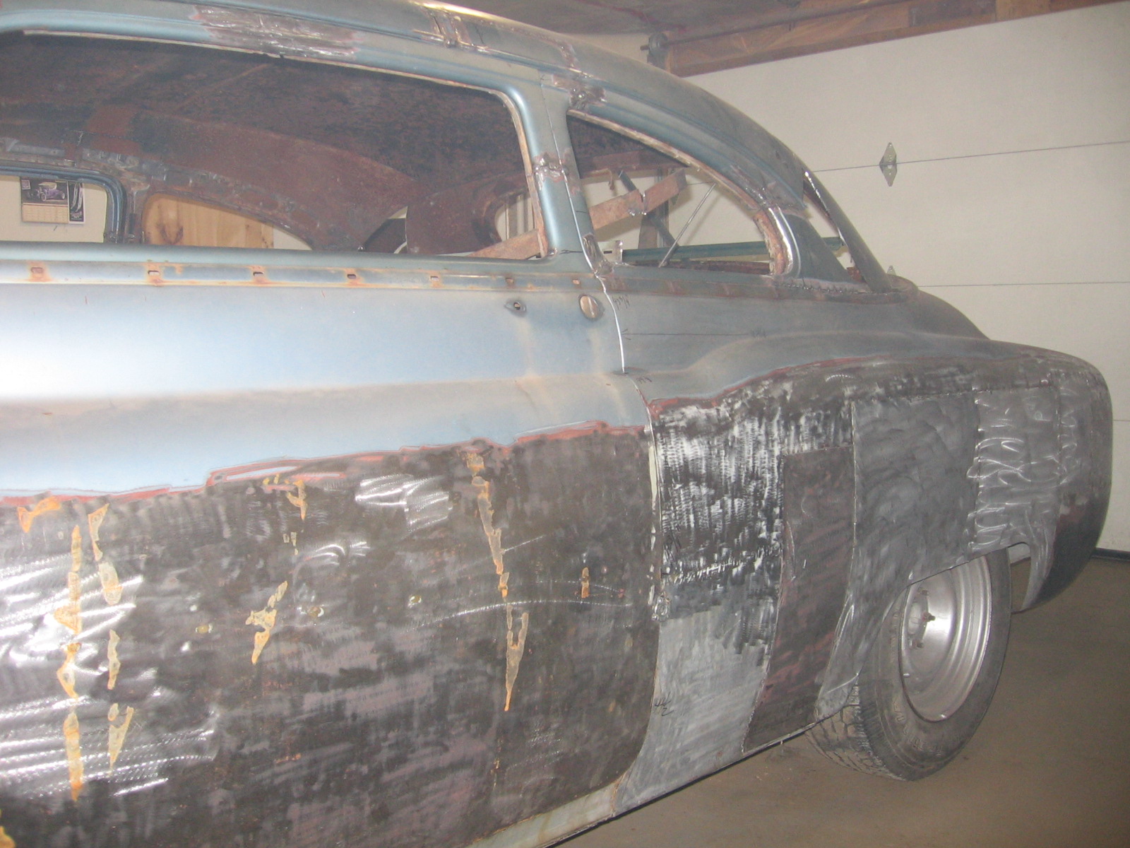

    More of the job and a few from the end of a productive day . A couple more weekends and the pillars and doortops should be all in . Then it will be onto the back gl*** and filler panels . Maybe sooner , who knows . I like the flow so far in the roofline . No hump yet anyways ...

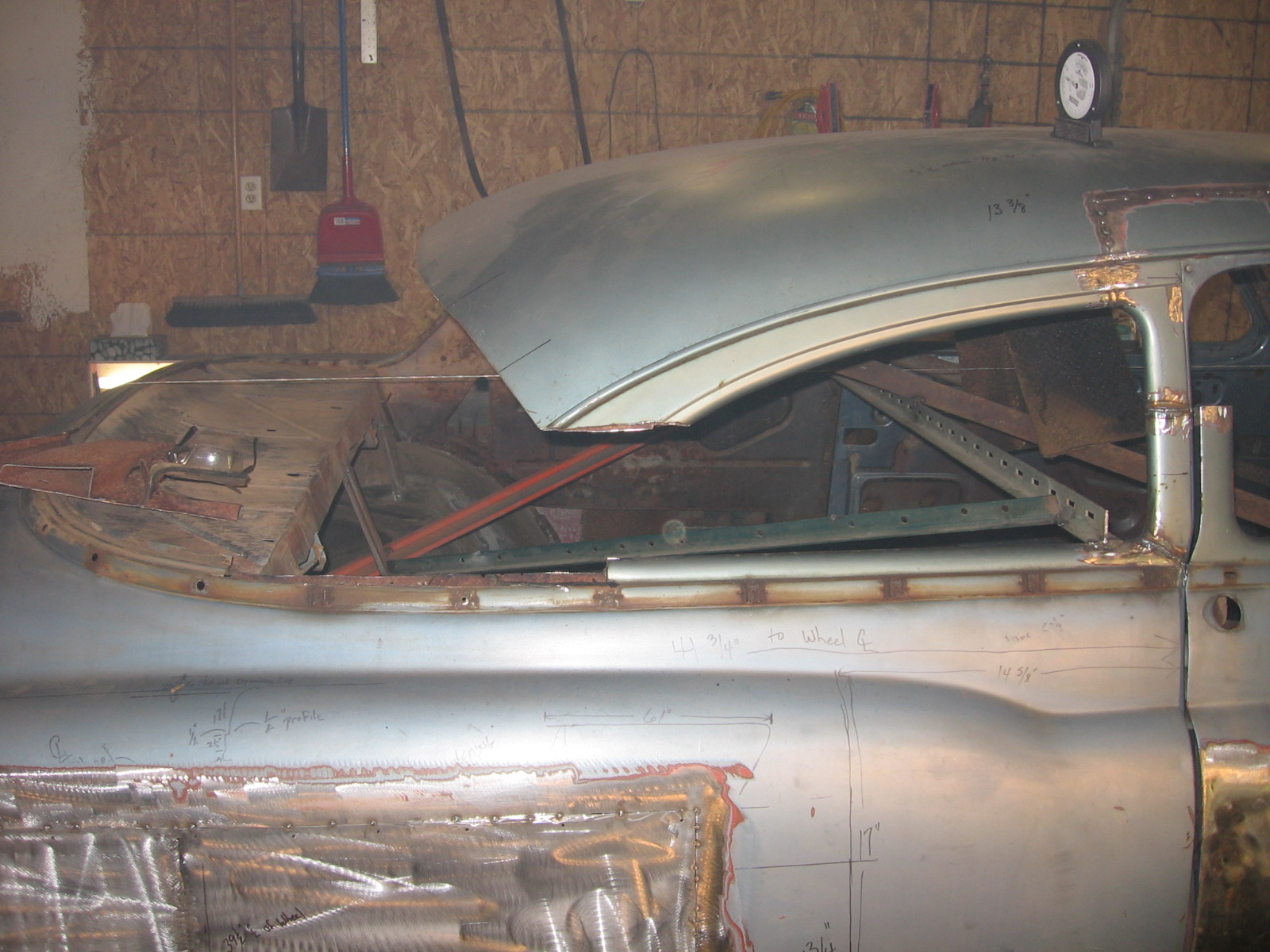

    Just a couple more to complete my progress shots for the day . Andy..

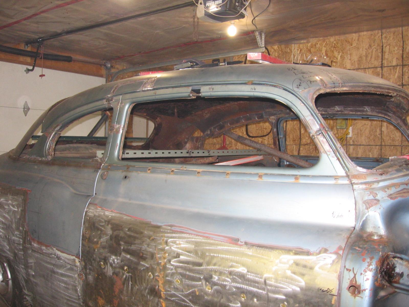

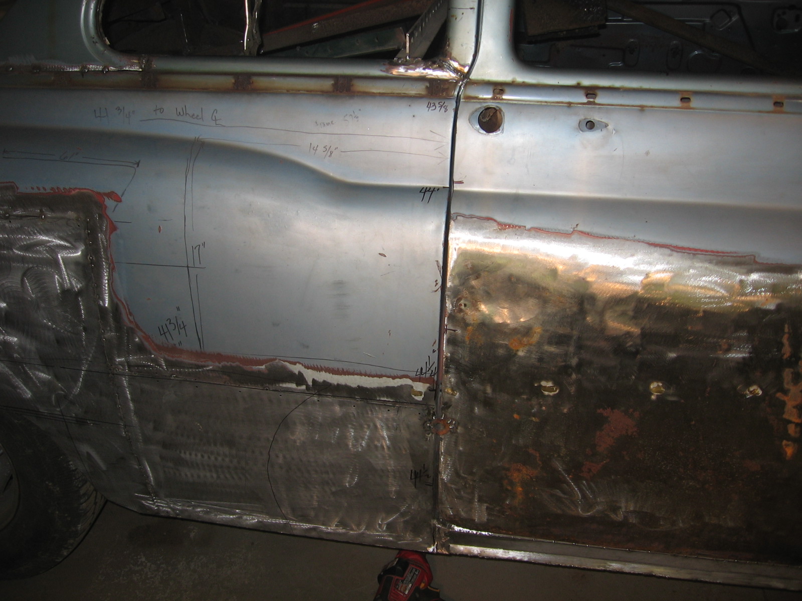

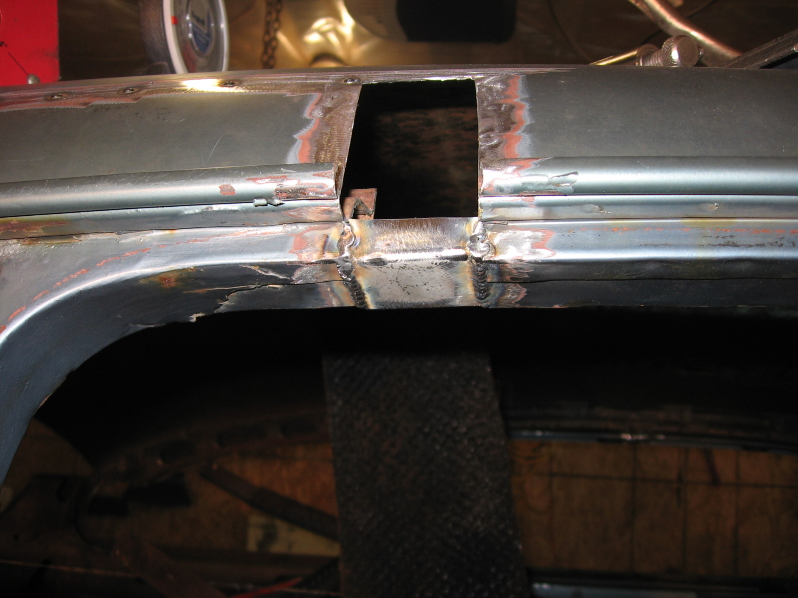

    I am gonna tell you guys who are following along . I had the most frustrating week . I could not for the life of me get the correct door gap on the p***enger door . It all started last Sunday and got worse from there . I have about 16 hours on the door and finally prevailed . I ended up having to take some off the door as it was binding at the A pillar post . I took some off of the door frame itself to get it to stop binding. You can see in the first and third pics. the new gap that I cut in . Now the doors close with no binding . I have come to the realization that these old cars were not the same on both sides . Case in point the drive side door opening is 1/8 of an inch larger than the p***. side . Dont sound like much but I gonna tell ya it can play havoc with you when your tryin to align things . I had to walk away more than once this week . Frustrating to say the least . I am sure you guys have had to endure the same from time to time on a build . Andy

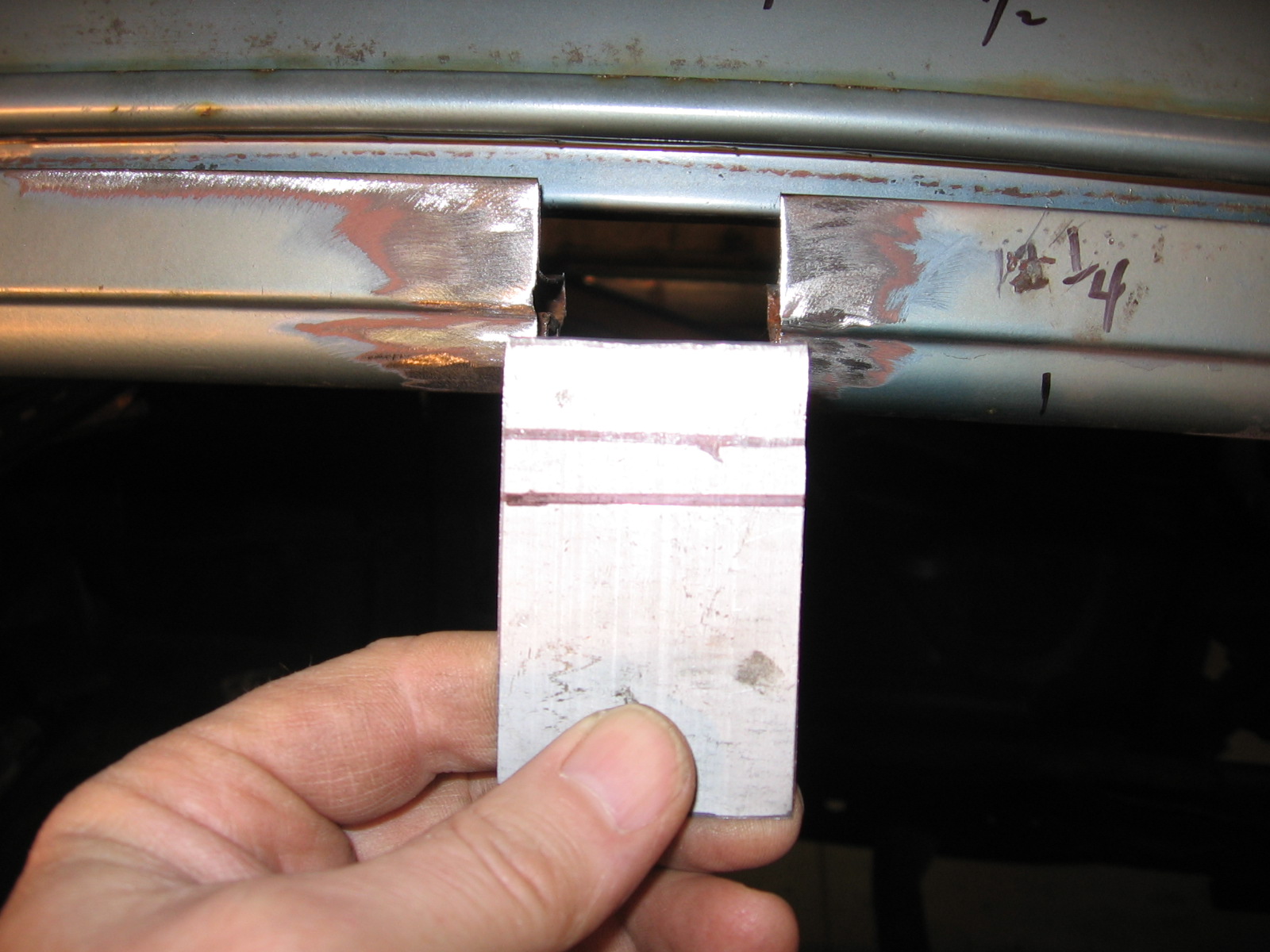

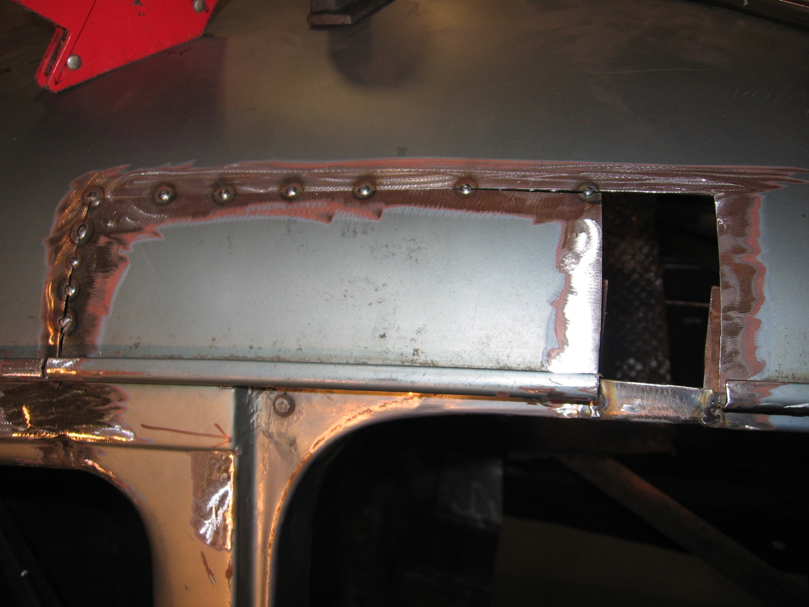

    Some pics from today . First pic is of the difference of the leaned post and the door frame although you cant see very well in the picture . 14 degrees canted inward from the 3 " chop .Various cuts and welds from today . I had to make a filler strip fro the door top 2 " wide and I had to make the reveal in it as well . I think it turned out pretty good . I suppose you could say that I am biased though LOL! Andy..

    A couple more from the day . I have the C pillars welded in . There is sure a lot of welding and grinding to go . Maybe I will get out there tomorrow before work and get the rear gl*** mocked in . I think the chev back window will win out . I like the looks of it . Andy
