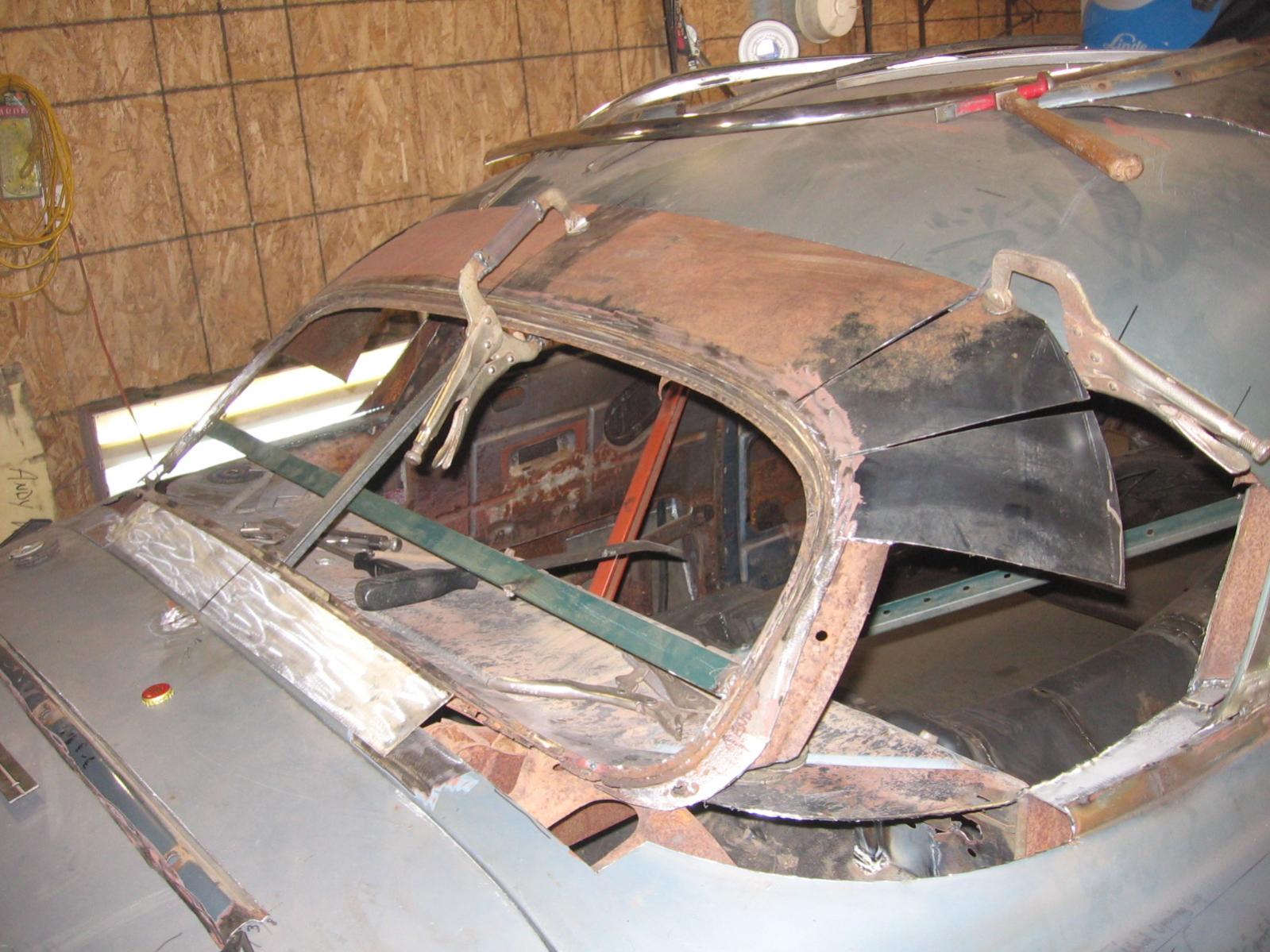

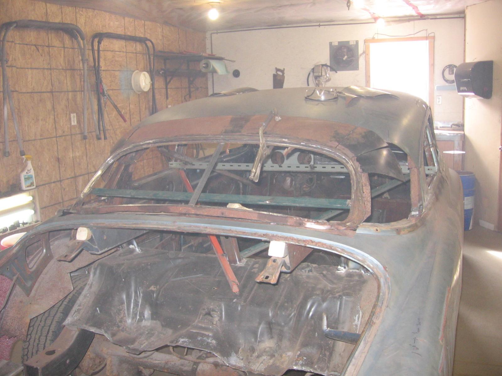

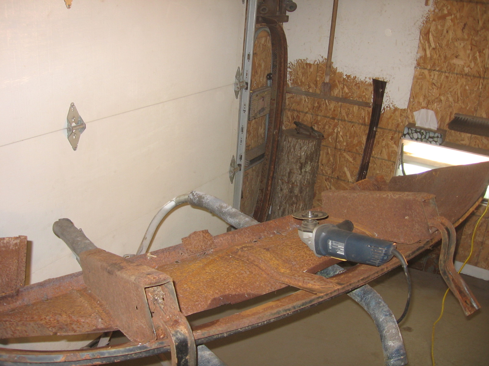

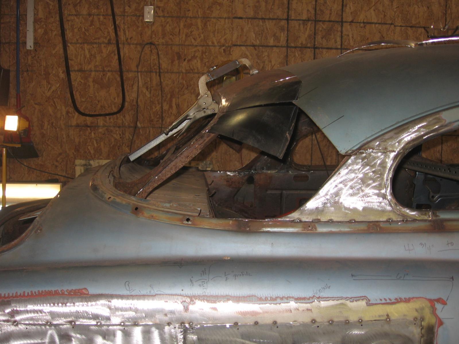

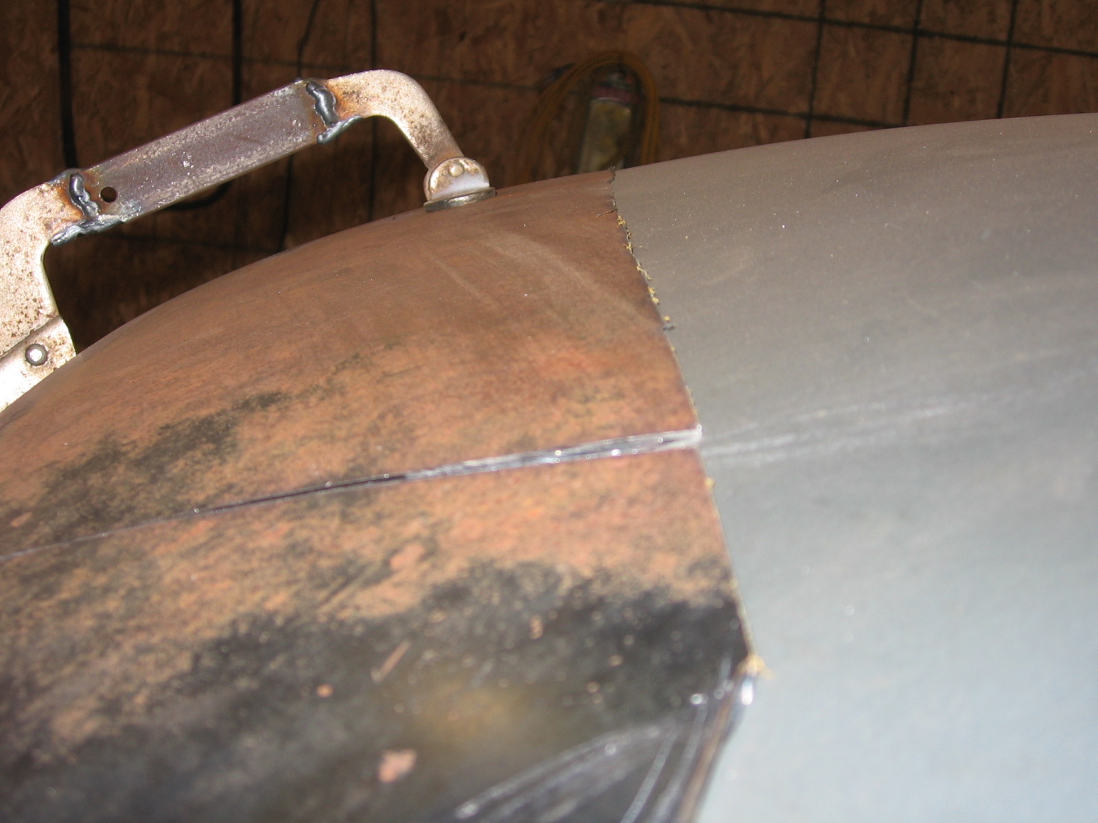

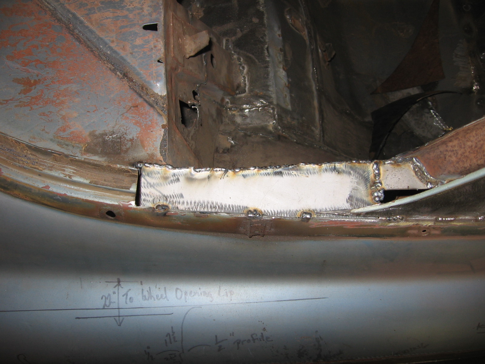

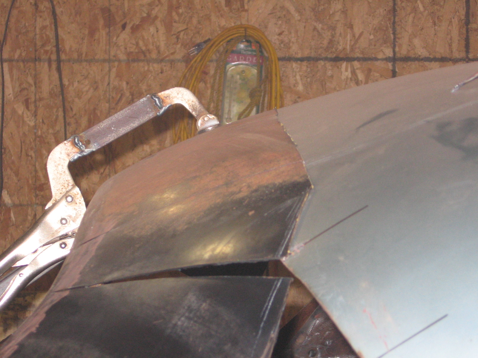

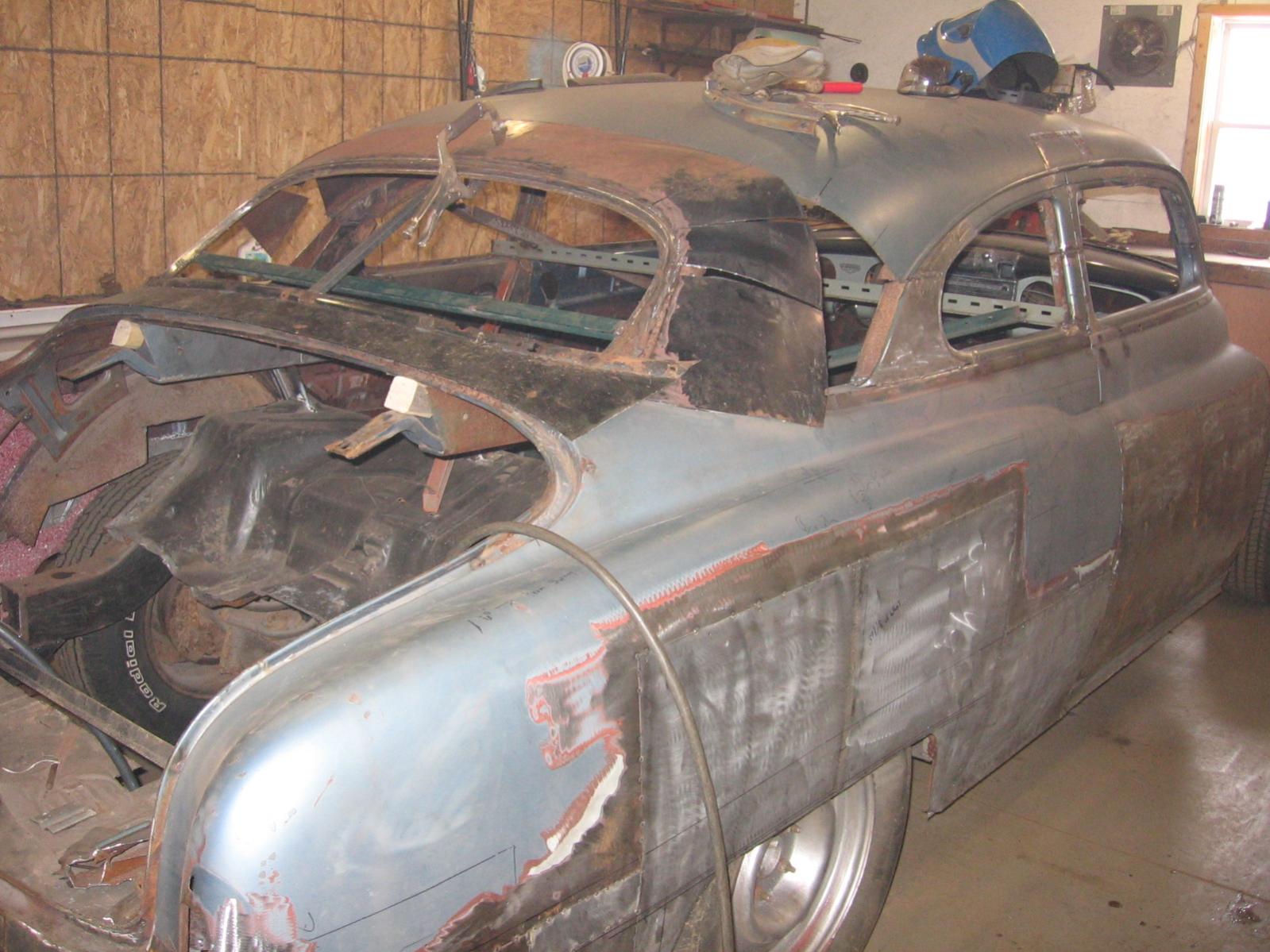

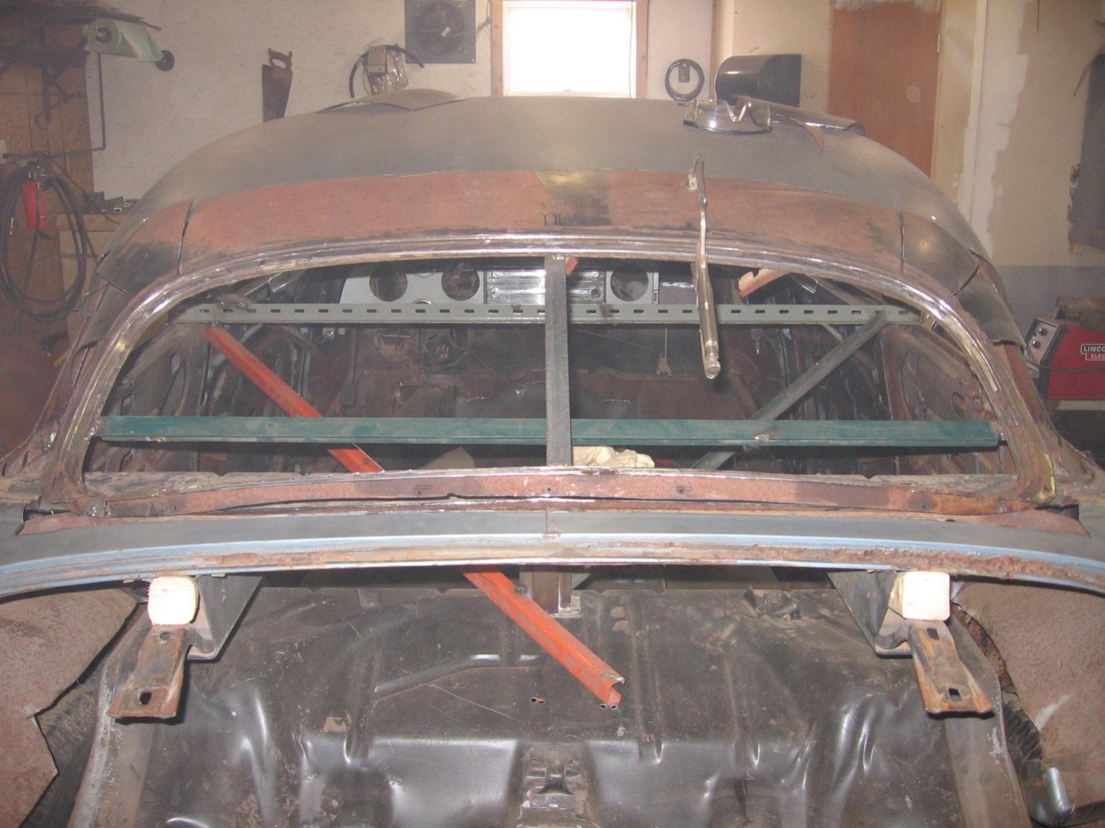

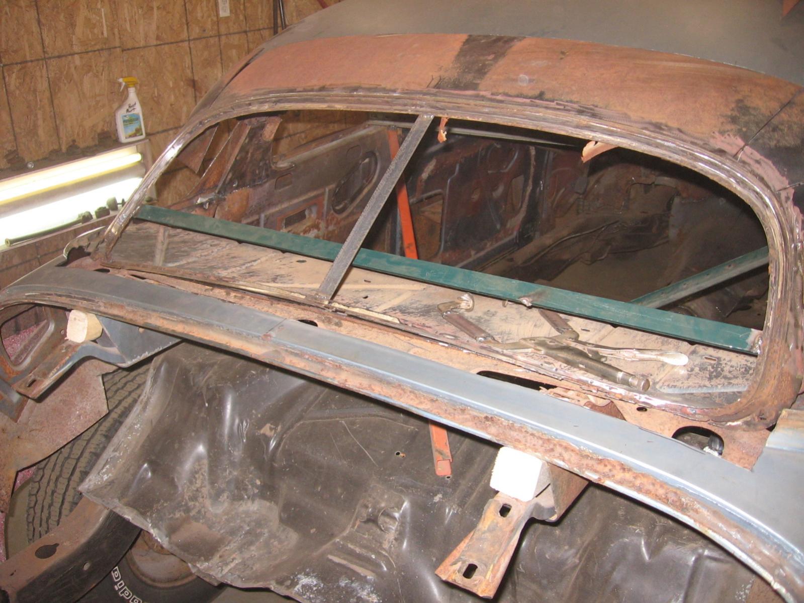

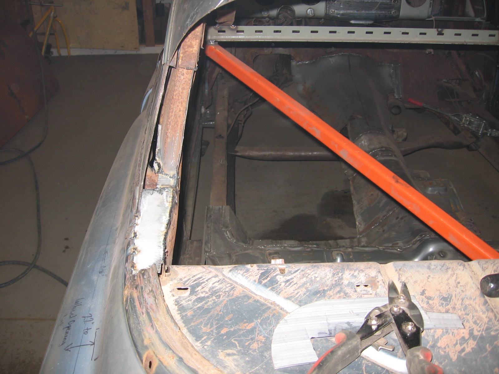

    Some done today before work . I had to cut out the beltline trim to sink the chevy rear window . I think the flow is dead on . If you can make out in the 6th picture I need to trim more on the window frame so the beltline will flow into the Buicks original line . Lots of finessing to say the least.

    Fitzee I will keep plugging away thats for sure . I will be taking more pics and that 3/4 view will be coming shortly . the roof actually moved forward 5.25 inches . I am ***uming that there will be a lot of pics coming from your thread next weekend ??? Andy...

    Lots of pictures Thats the plan.. that back window do fit it nice.. Keep the pics coming

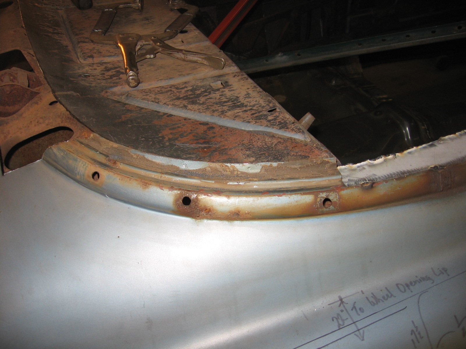

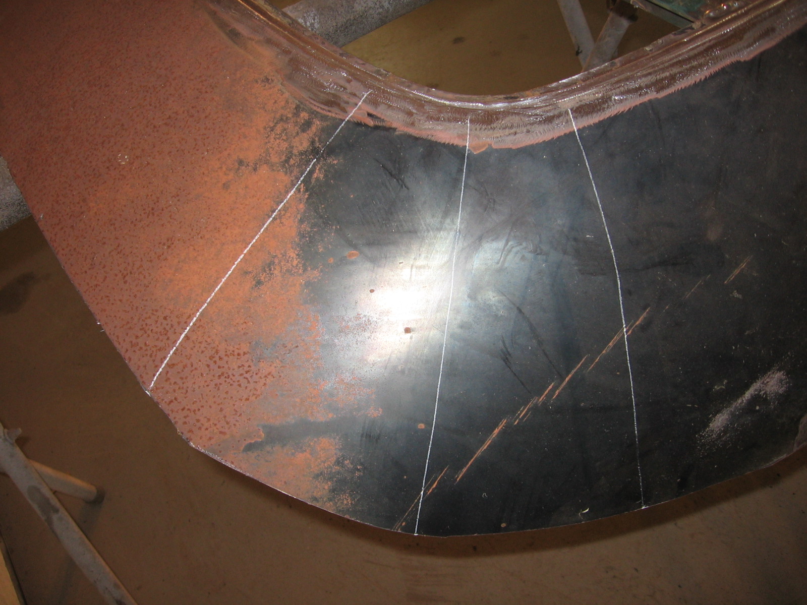

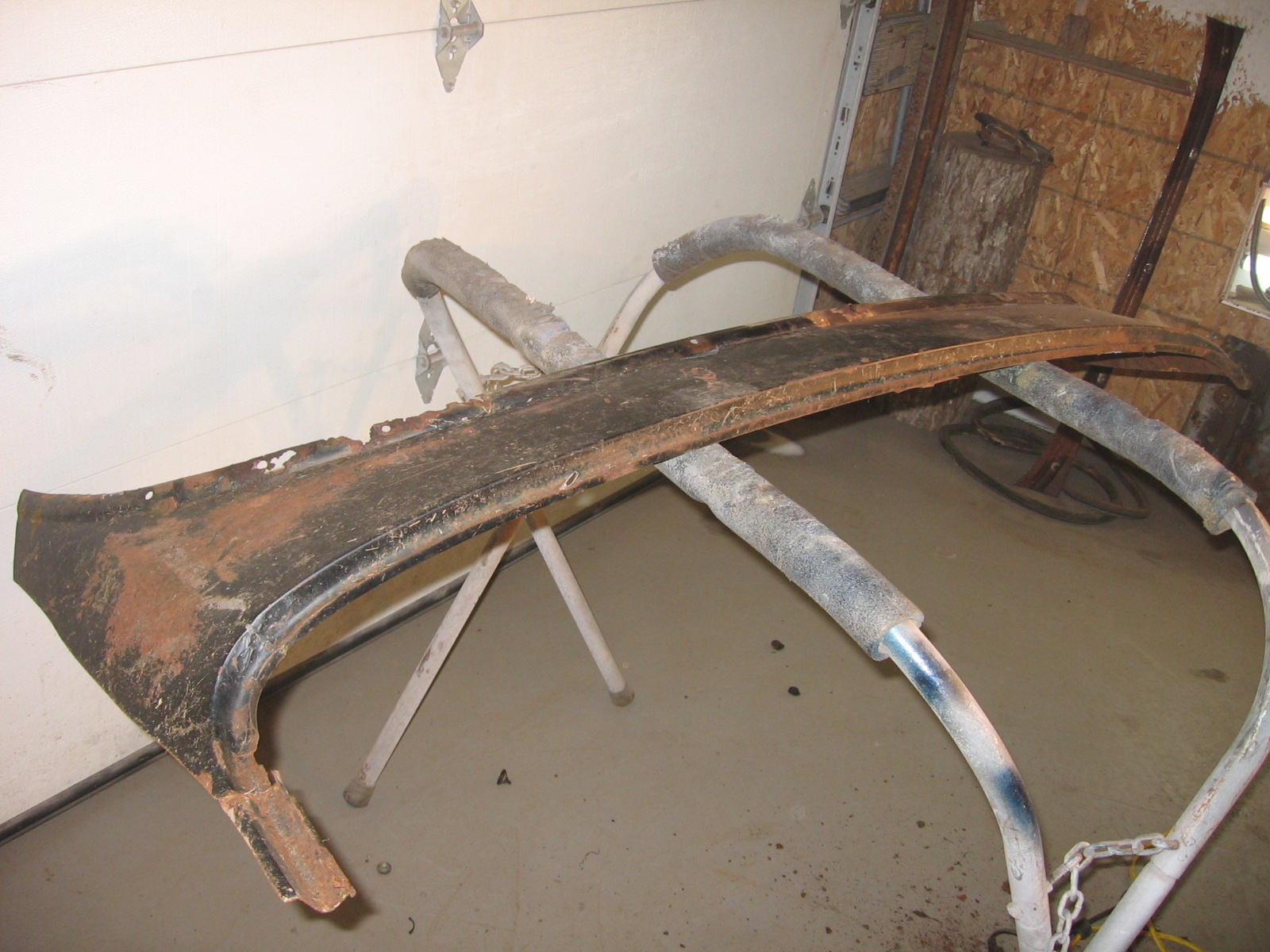

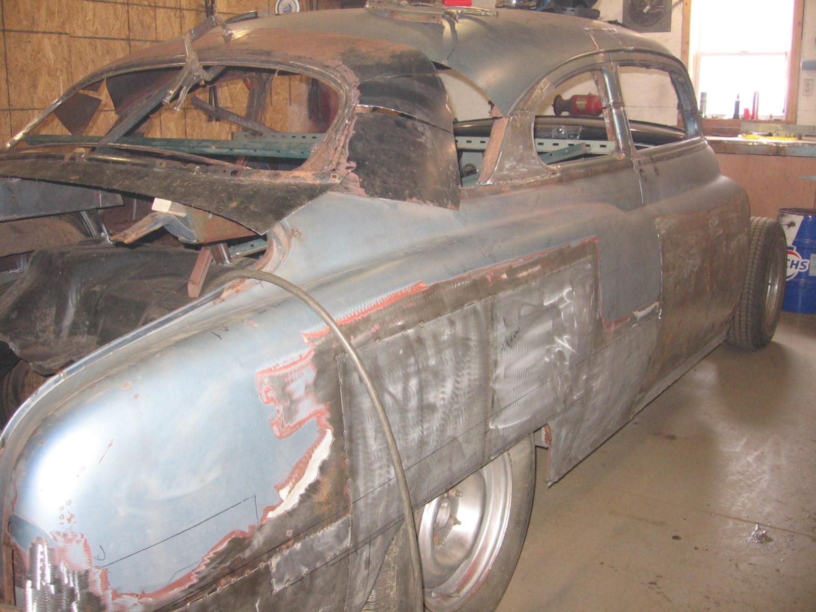

    Some pics for you ! i am in deep now .I removed the catwalk from the 51 chev and am going to incorperate it into the chop . I filled in the void left behind when the C pillars slid forward . this strengthened up the pillar considerably . I had to cut out the original beltline of the buick . I will reuse it as progress moves ahead . Andy...

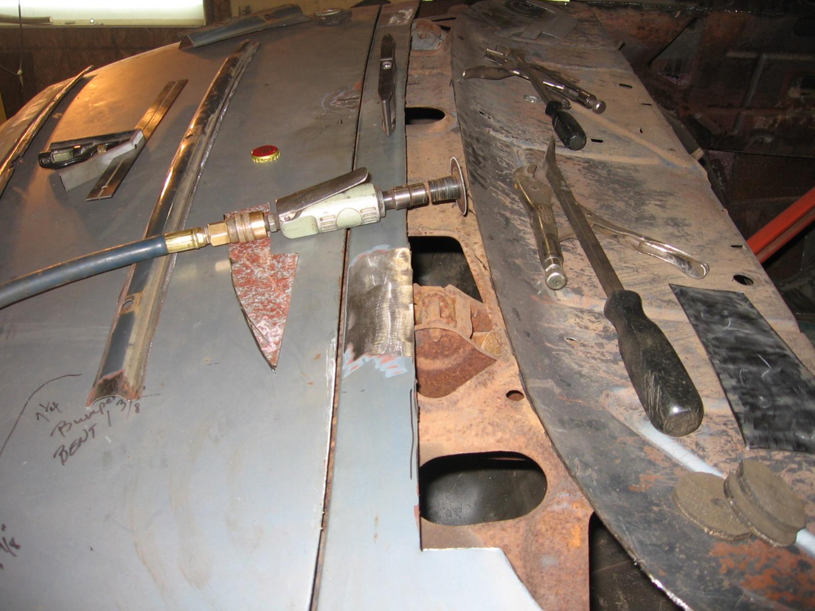

    A few more . Andy

    Heres what I am thinking on the rear catwalk area. I know its hard to see but the catwalk now flows on the same plane as the window itself . The stock buick catwalk area was flat before . I think it looks better running this way. I tried to show it in the last picture Andy .

    I dont know Andy, it just doesnt look quite right to me. The way it angles right into the gap between the catwalk and deck lid just doesnt flow. Also have you checked to make sure the deck lid doesnt hit it when opened fully?

    Well now, thats a good question Doug . I will have to check that out and get back to ya. That may be an issue . Thanks for the critque ! Andy...

    You are doing great work man, my 2 cents on the catwalk though, take a closer look at it before decide on your final look. I went through the exact same thing (my 53 old has the same body style as the buick), in my case though, to get the proportions right I had to make the catwalk wider because I also moved the roof forward, the difference though is I made mine into a hardtop. I had to make it a hardtop because the 4 door conversion forced me into it to make it look right. My window is out of a 40 Merc. I spent alot of time just looking at a the car from a distance and drawing it on paper until I got it right. Great updates by the way.

    Although you guys are giving me some different options its also worring me a little as well . I thought I had it right . Now tomorrow I will have to have another look . Damn !!! 53 , your olds looks great . A job well done . The train of thought on my chop is that the rear window plane should run right into the catwalk and then flow onto the trunklid on a different plane . This is somewhat how it was stock . If I move the window forward more, my trim will be out of alignment and I am also afraid of getting that dreaded hump on the roof that you see so many chops having !!! Andy...

    I notice that with back windows like this when you lay them down the middle on the bottom tend to rase up.. Im also concered with how the corner of the gl*** will flow around the corner. Not having anything between the window and the truck might be trouble.. Back windows can be a pain..Personally Ill build the rear piller first so that flows to the car and then figure out the back gl***. your will figure it out.. we have faith in you..
