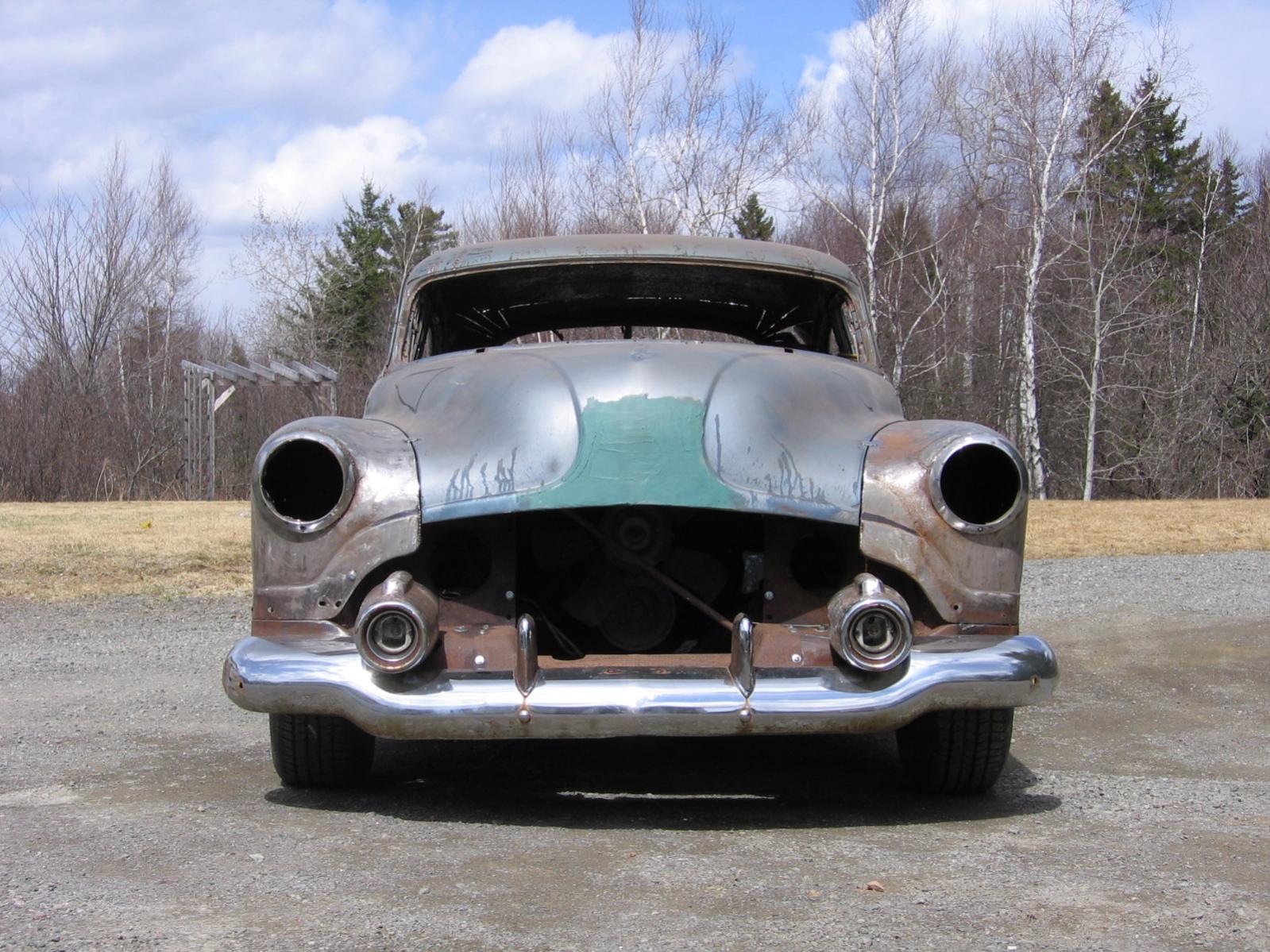

    I don't like rounded hood edges. Looks too much like a Merc or shoebox Ford. The mustache and cascade waterfall grille is what makes a Buick distinctive. Andy, see my pm to you...

    Put some wanted ads on kijiji in the cl***ic cars section Andy, I have had great luck finding stuff that way. Good move pulling the bumper outwards ...great minds think alike eh :D too many cars seem to have them moved way too close to the body, doesnt look right to me when they do that,with very few exceptions!

    Thanks for the input Nali but I think i will pull the Caprice seats apart and see what makes them tick . I will engineer them so they can pivot forward . Thats the plan anyways . I dont like highbacks or anything that is to puney of a seat in one of these big old cars . They look to out of place for my taste anyways . Andy..
    JR9162 thanks for the comment . I would only go the way of a full custom look if I dont have any luck at all on either your suggestion or original Buick Mustashe trim / extensions . There is an old guy 20 mins from me that has some extensions but he wont part with them . He thinks that as soon as he sells them he will need them . Oh well !!!

    Yoy could always make your own "trim" from steel and weld it on ? You would at least keep the Buick design that gives it the look? Thats what I would do if I couldnt find usable orig stuff. I will ask around and if you want put a wanted ad on in NS for you..not sure about the guy at the Truro show, let me know if you go to it though maybe we could hook up! I take it the parts cars you were talking about in the winter dont have what you need? I found probably 95% of everything for the 47 within 50 miles of my house...even found the coupe carc*** through a wanted ad on kijiji !

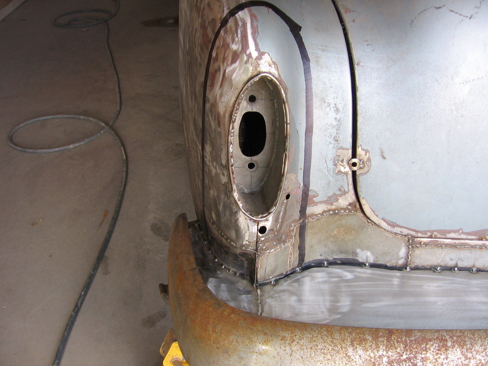

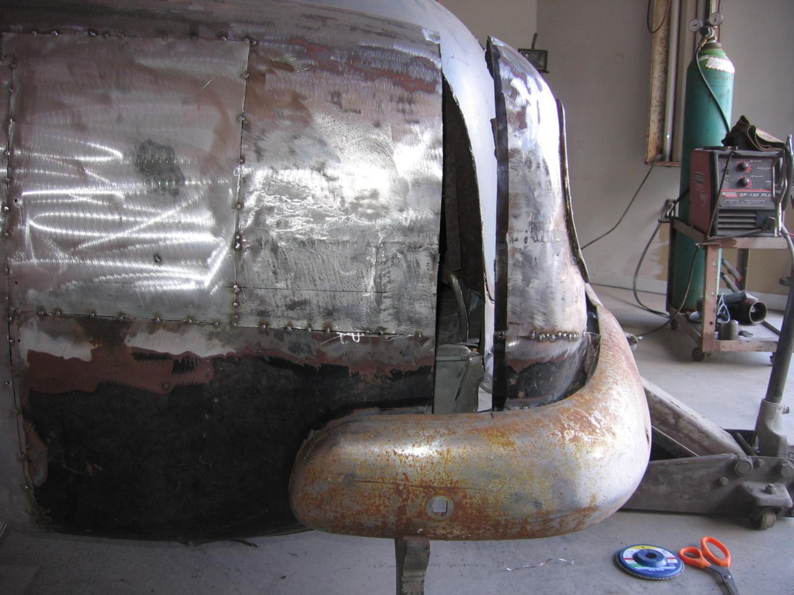

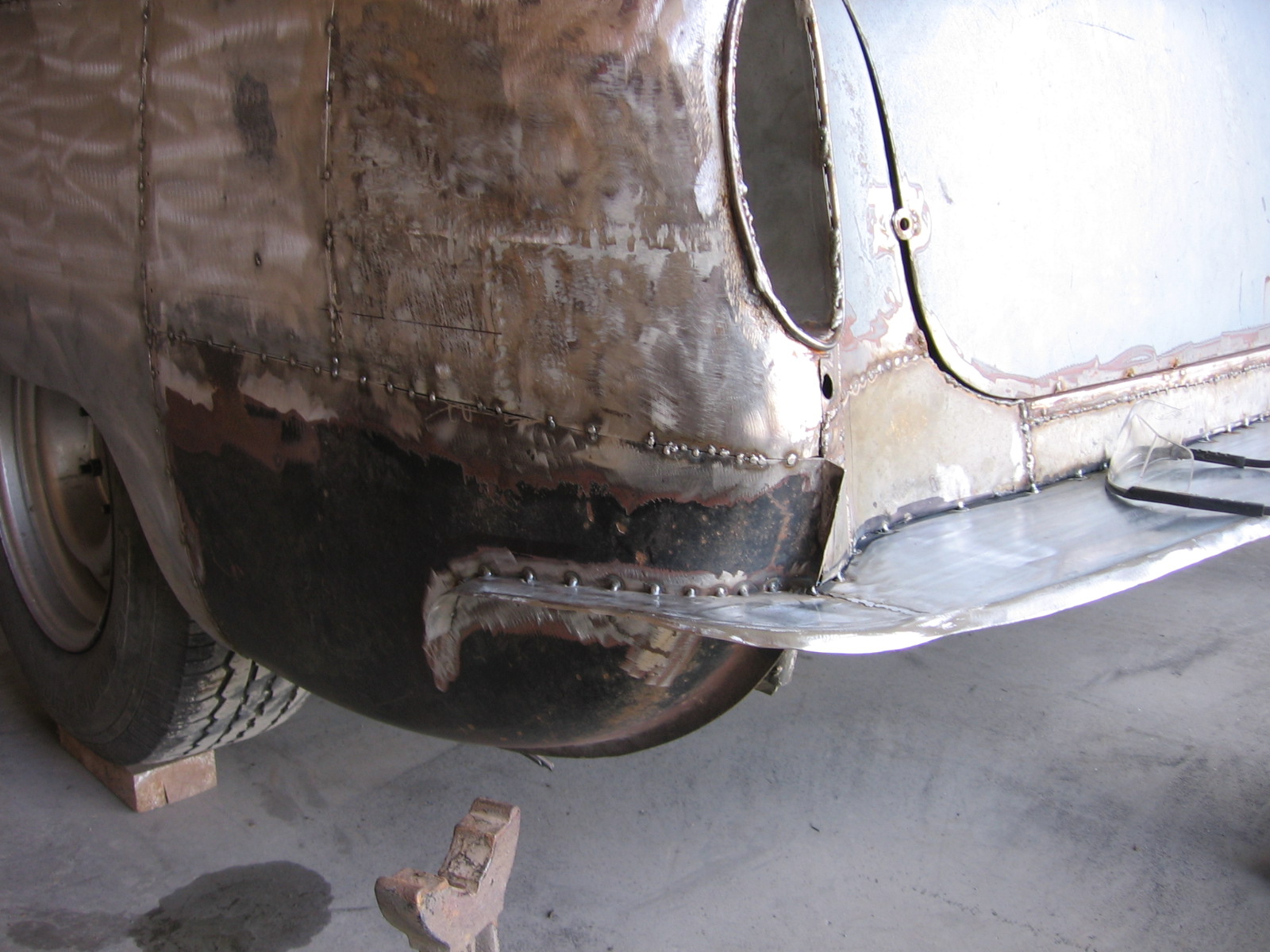

    Some progress pics of the rear filler panel . Just start getting it together and there you go . Cut it apart again . I n the next set of pics you will see hopefully what I am trying to pull off . Andy..

    Angled or straight with a 2 inch filler ???

    I know they started that **** about a year ago ! If you get any leads around here (Halifax Annapolis Valley areas) that you would like me to check out just let me know! I think I like the straight up look, but it would be easier to judge if ya had a full on pic from the rear

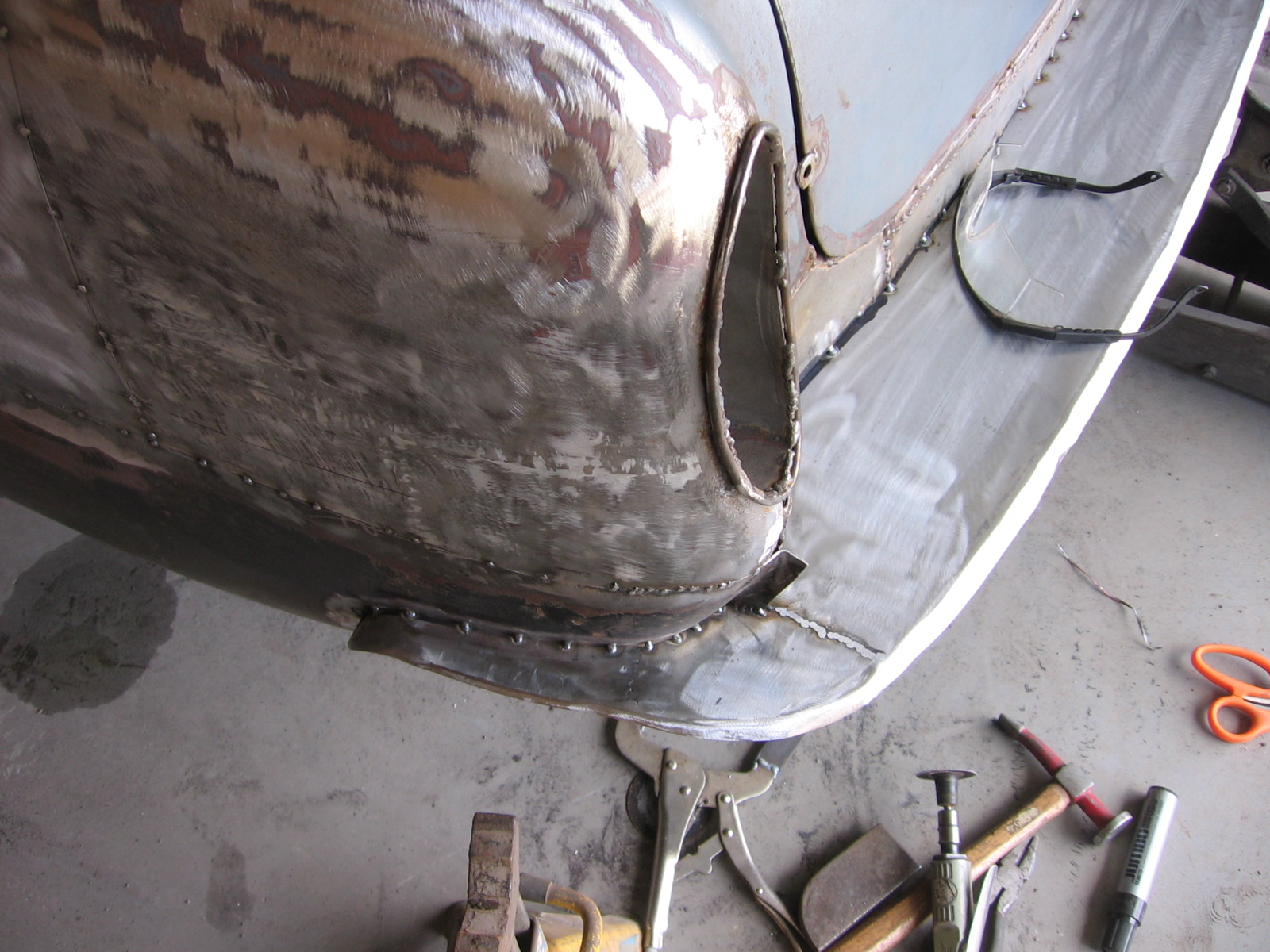

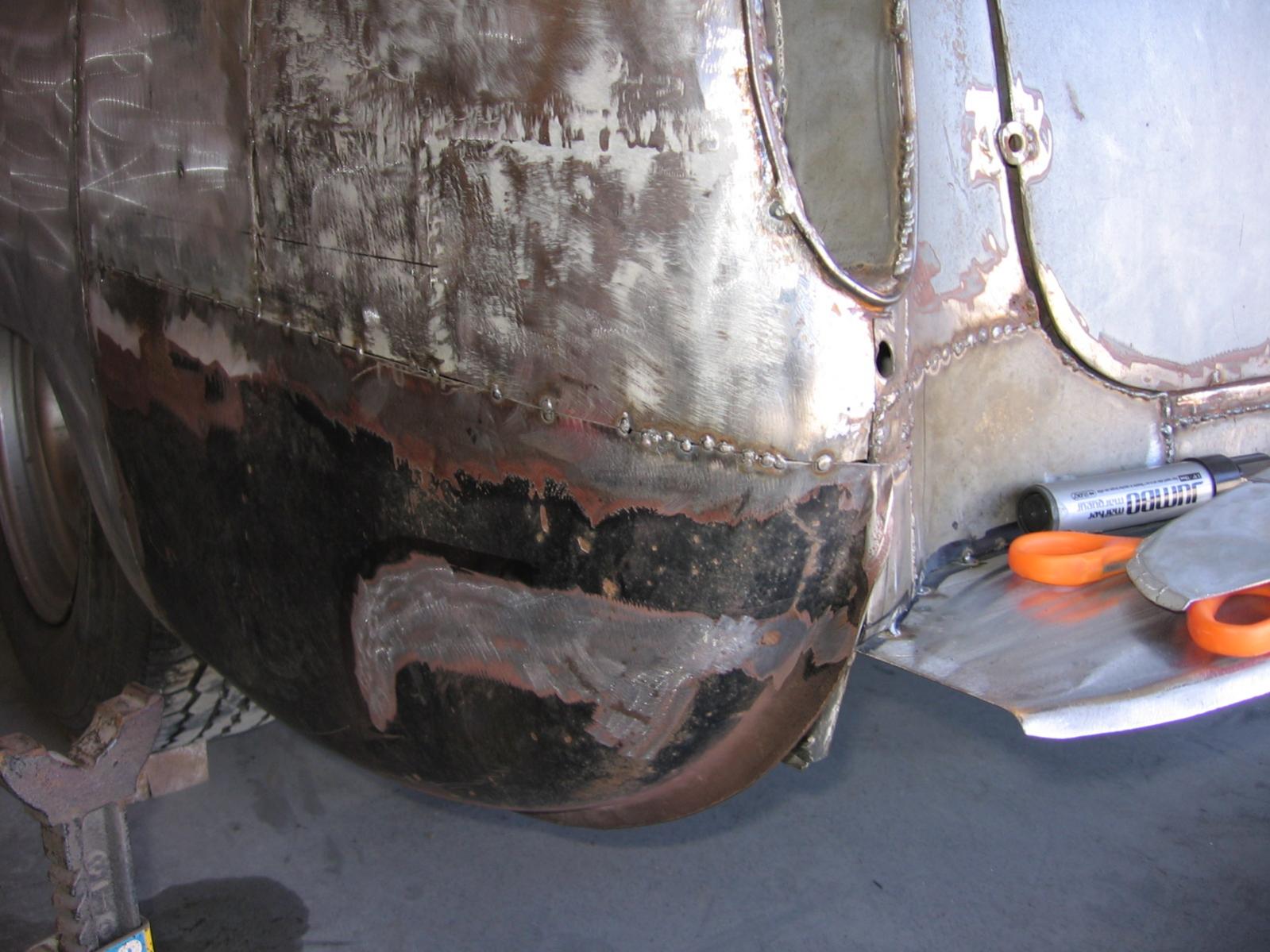

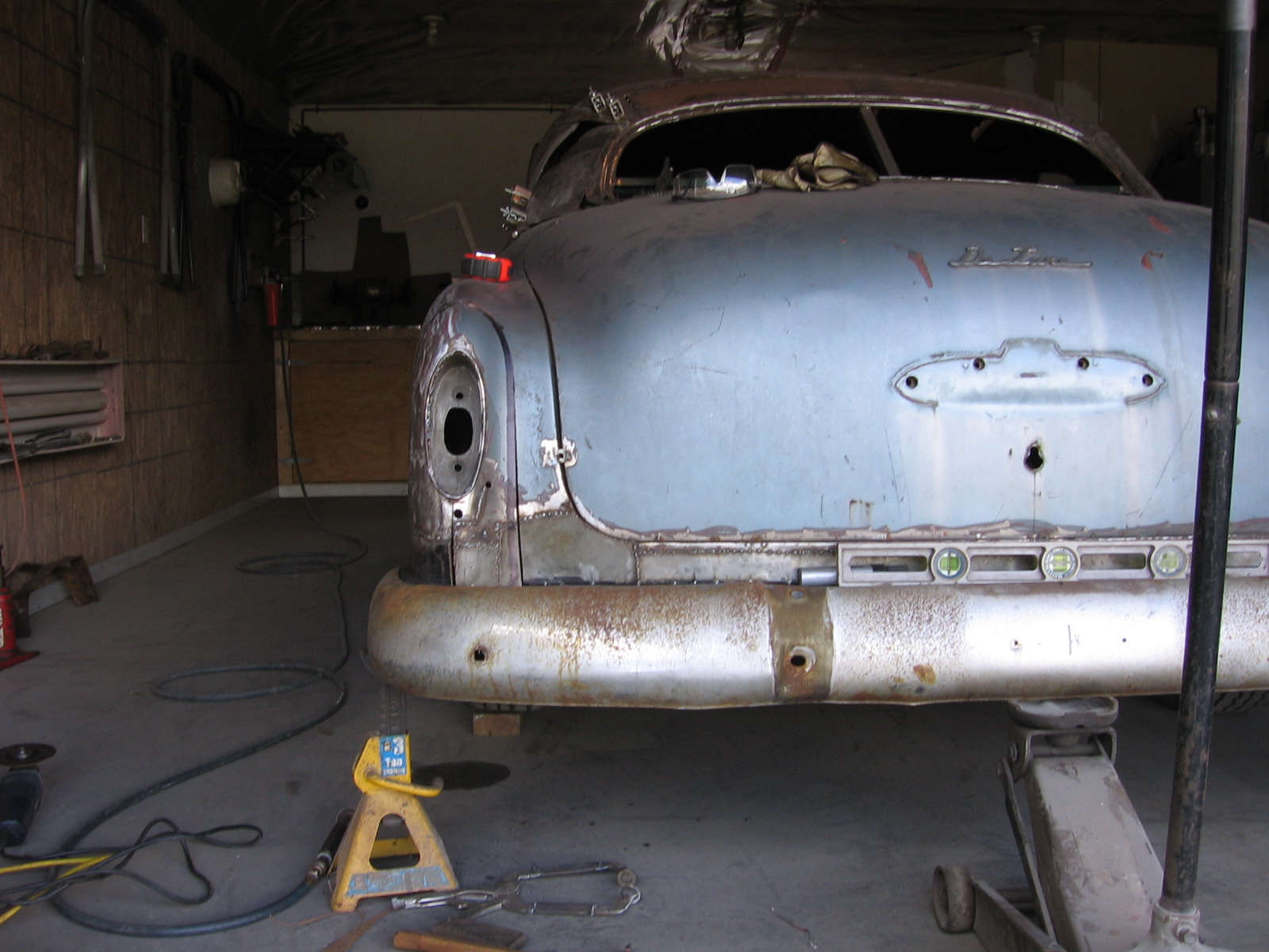

    Got to reworking the rear of the car around the tailight driverside . I like how well it flows . There is a nice rounded contour to the whole housing at the fillerpanel . The panel ws opened 2.5 inches at the bottom to get the quaterpanel to flow better .Obviously I went with the slanted flow instead of straight . ( Side profile ) Last pic is the starting of the p***enger side . I used 3/16 CRS round rod on the filler panel to duplicate the contour of the drive side . I want these two to be as identical as possible . We are to fussy with these old cars in regaurds to fitment and gaps . According to my buddies Dad whose 78 , these old cars were never great to begin with . So when we spend hours trying to figure out how come something wont fit right we have to ask , did it ever fit right from the get go ??? Some food for thought . Andy...

    A few more pictures that I took today with a little more done on the rear tailpan section . How they look so different on the outside , you need to do that once in a while . Andy

    Definitely helps to look at them from a distance. Looking good!

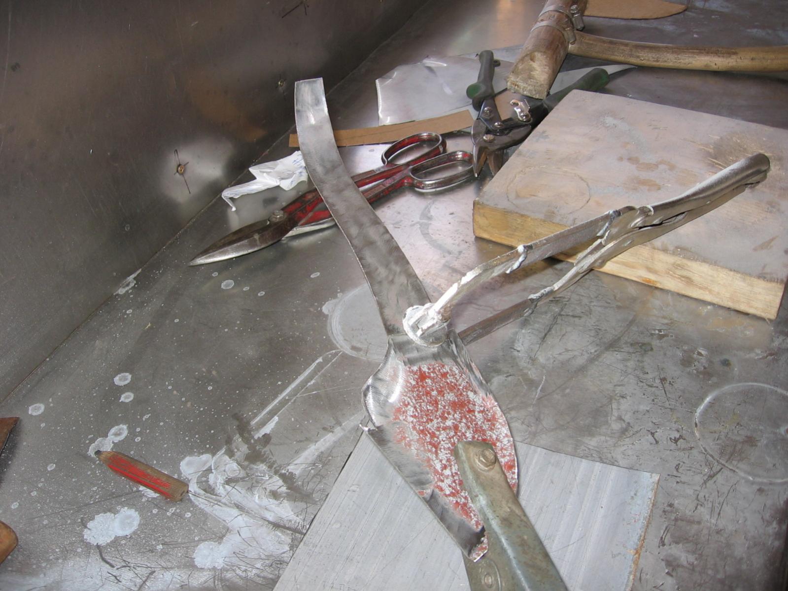

    A friend of mine gave me a few rod like this. I don t know the brand. I had absolutelly no succes with it on copper, alu and zinc parts ..
    It fifn t flow at all, and was gummy, even melted.
    I you find good ones, please let us know.
