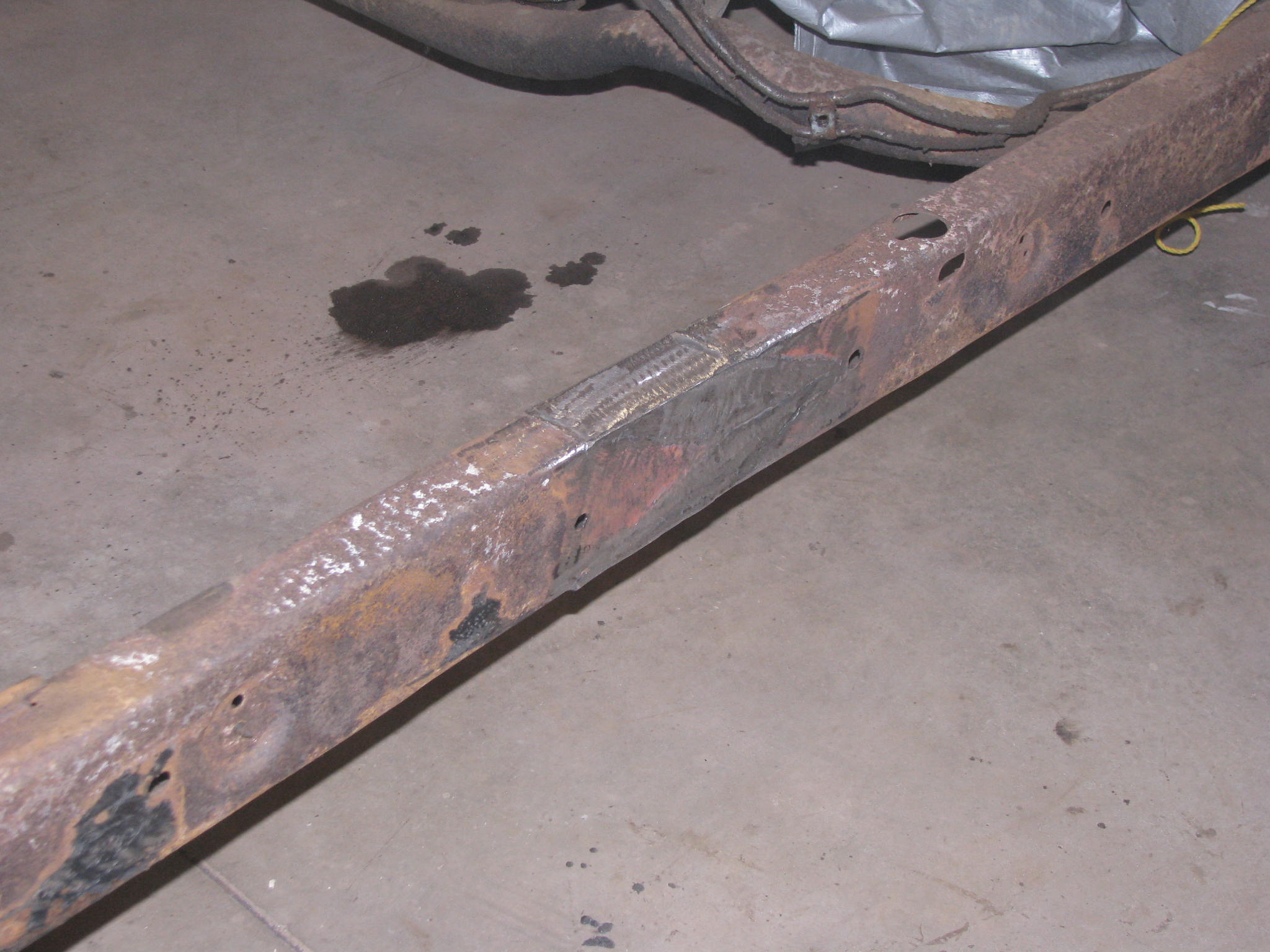

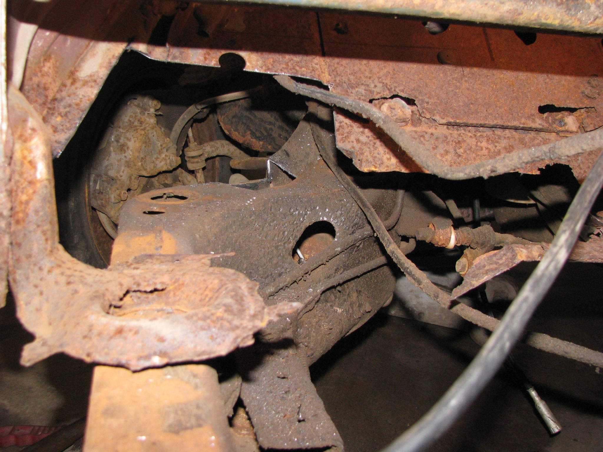

    Cool. So, the shape of that cut increases the length of the weld joint. Is that right?
  2. aw1950
    Joined: Dec 21, 2008
    Posts: 1,511
    aw1950
    Yes Brerhair that is correct there is more strength in a repair like this over a **** joint . Theres more of an area that is welded .A friend of mines uncle told us quite some time ago to never cut and **** weld a frame together . Always try to V it or in his case a Z pattern . He welded heavy equipment as a living and did it for 40 years . I would think that he knows what he is talking about .
    I did it on my 1986 F-150 and the frame never gave me a problem . He also said if at all possible always weld frame with frame if you have access to old pieces.

    You can make that splice even stronger by welding in some fish-plate or even a couple of lengths of heavy 2" angle-whatever you have laying around.
    Nice work so far. Really looking forward to seeing the Buick body dropped onto the Caprice ch***is!

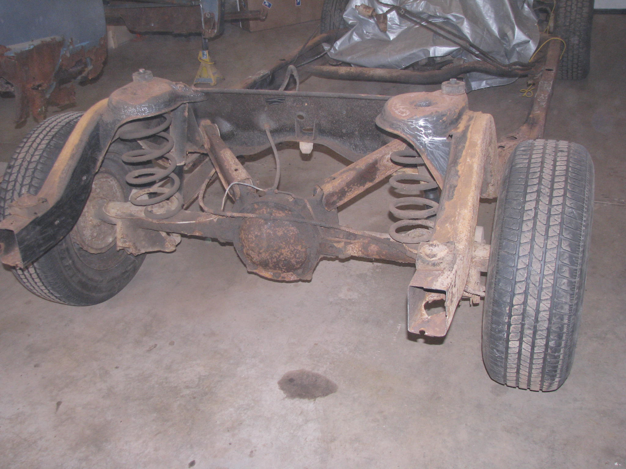

    Just a Christmas eve update . I stole away a few hours this AM and finished up what I started last night . I am back to having a roller again , but 5.5 inches longer . Be a few days I am sure before I am back at this again . Anyway , Merry Christmas to all .

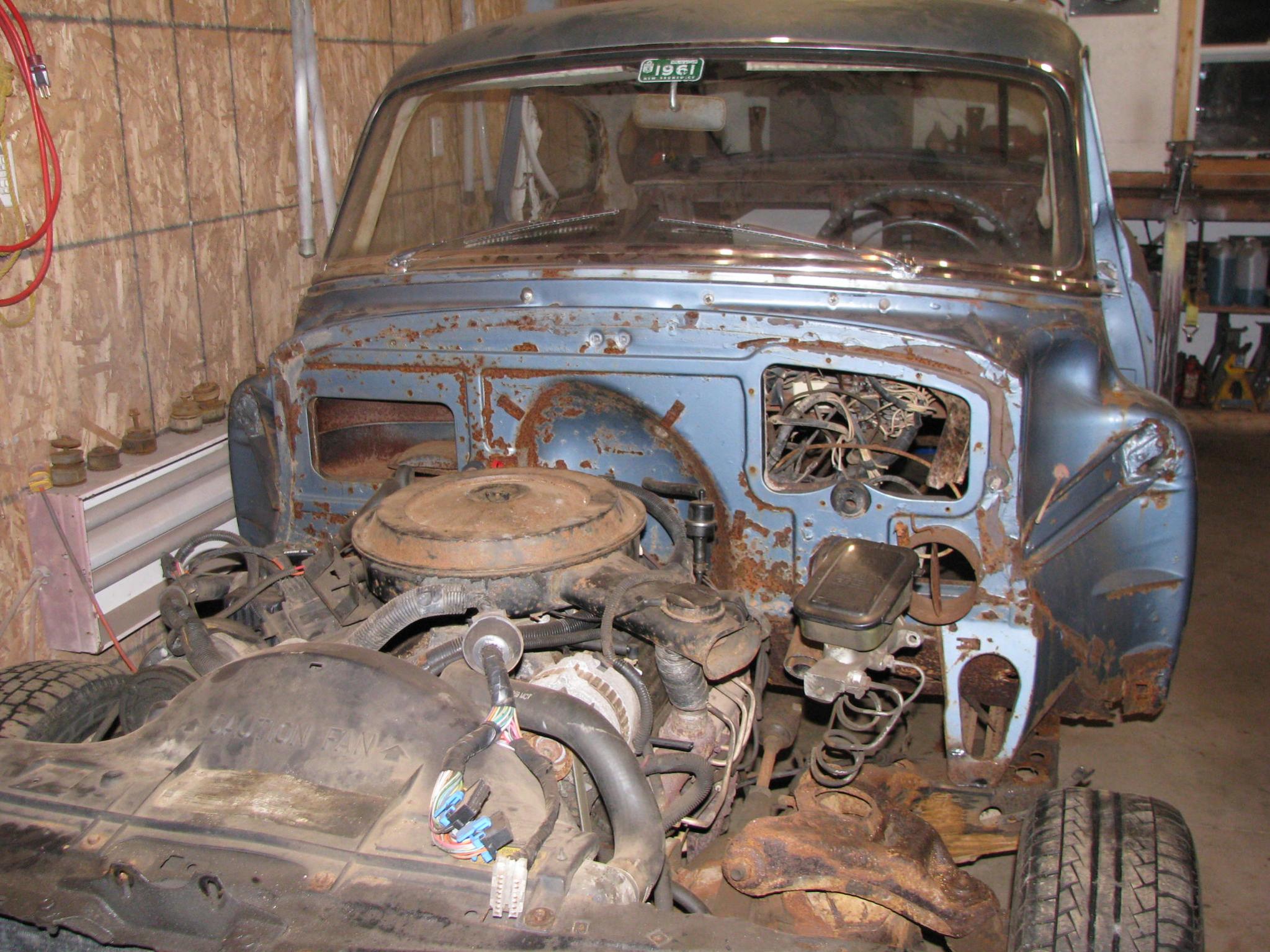

    Hello All

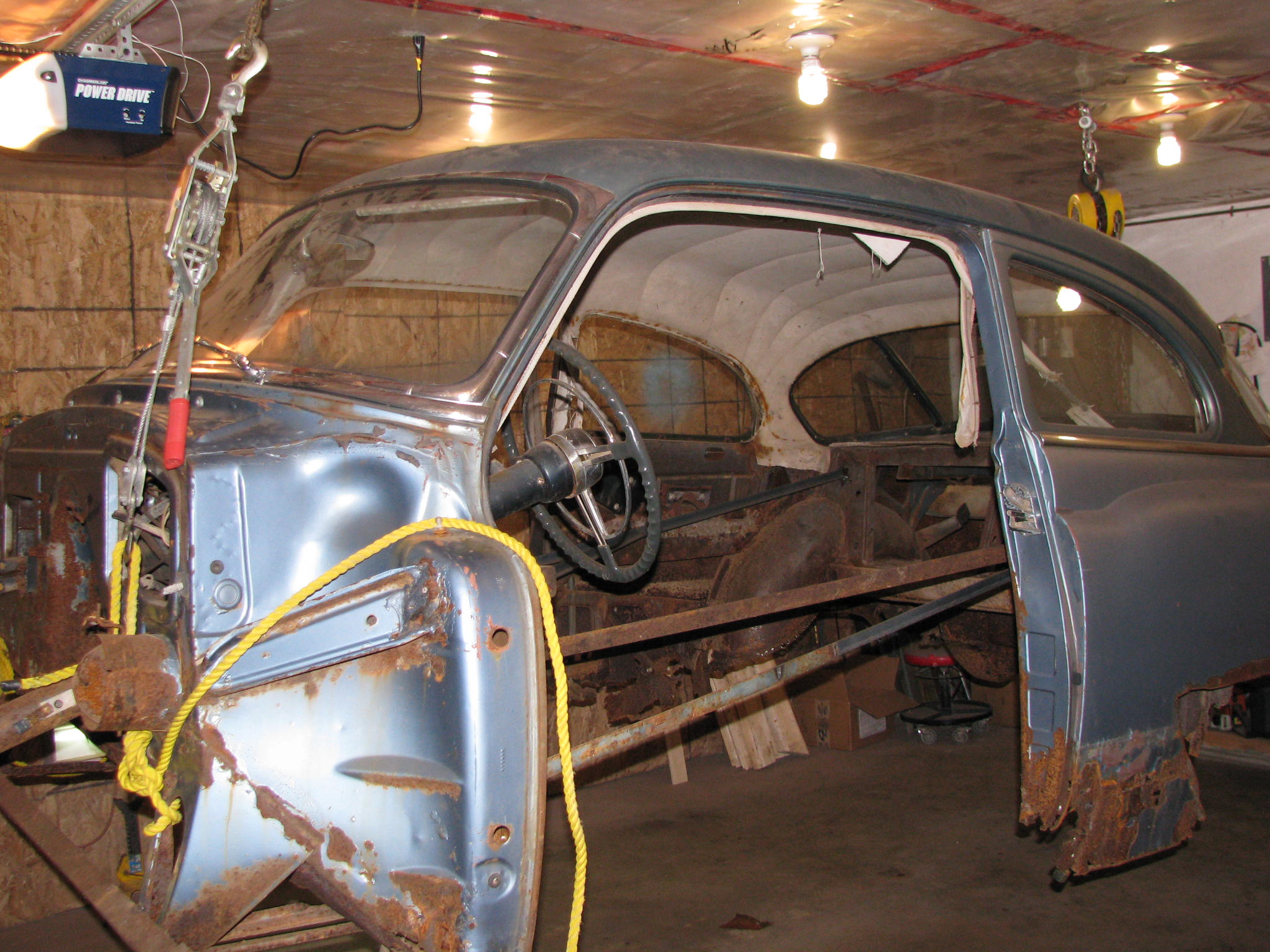

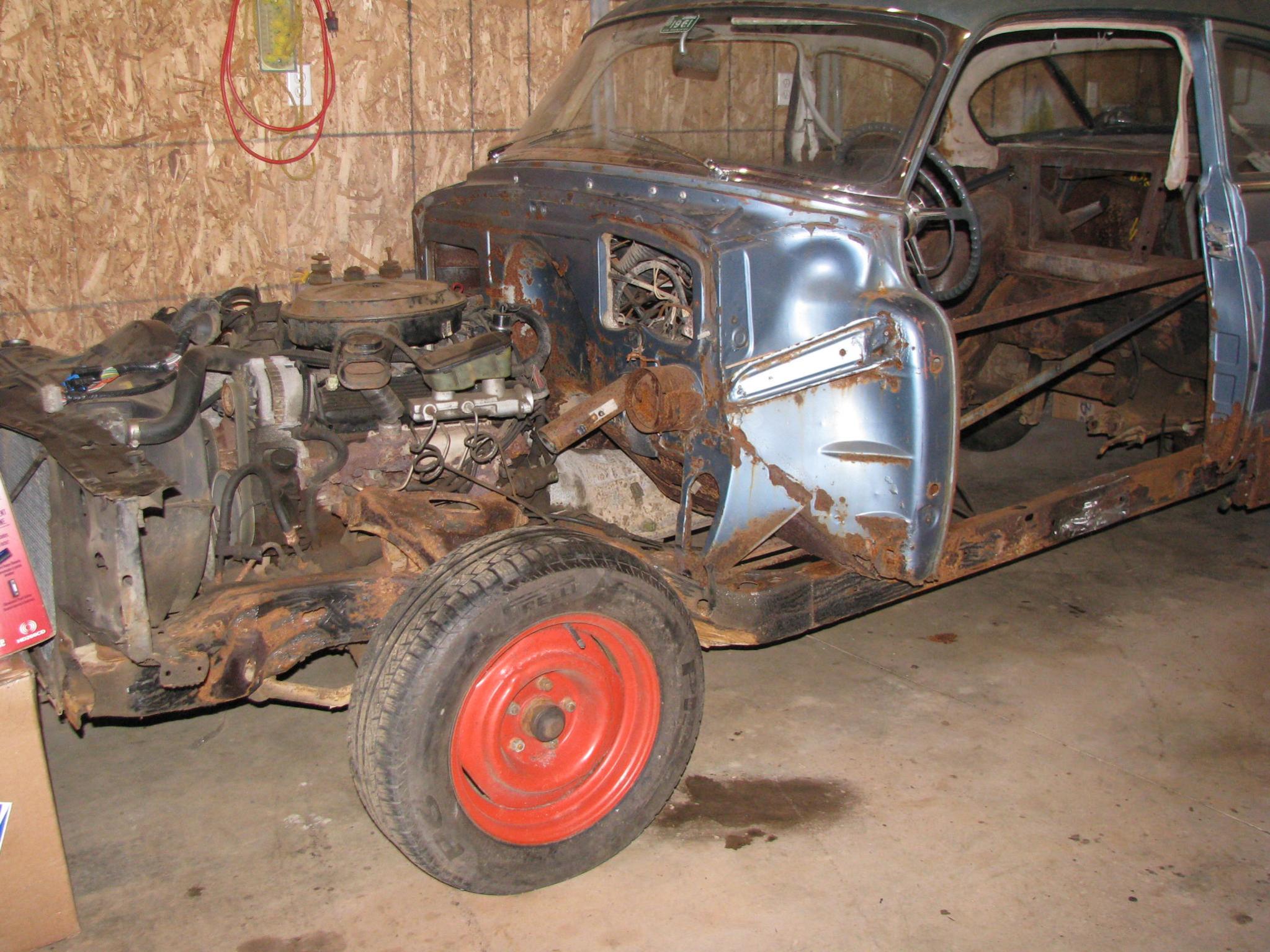

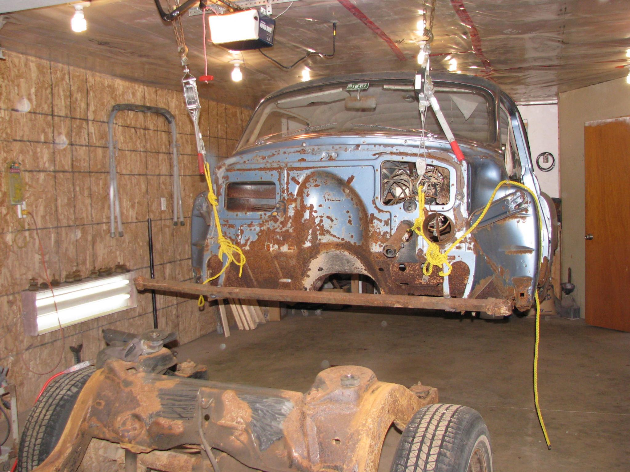

    I have a few more pics here , not to much accomplished other than the lowering of the 51 onto the caprice frame . A few obsevations. I see that I need to lower the front frame mounts a few inches and I also have to continue to remove the rest of the floor ( trunk ) all the way to the tailpan . That way I can lower the body down over the frame as far as I want and then start the reconstruction of the floorpans and body frame mounts . This is all in good time , after all it is a long winter . A few hours a week and it will be a roller by the spring . :D Have a look .
    Sorry the pics are out of sequence a bit but all from this evening .

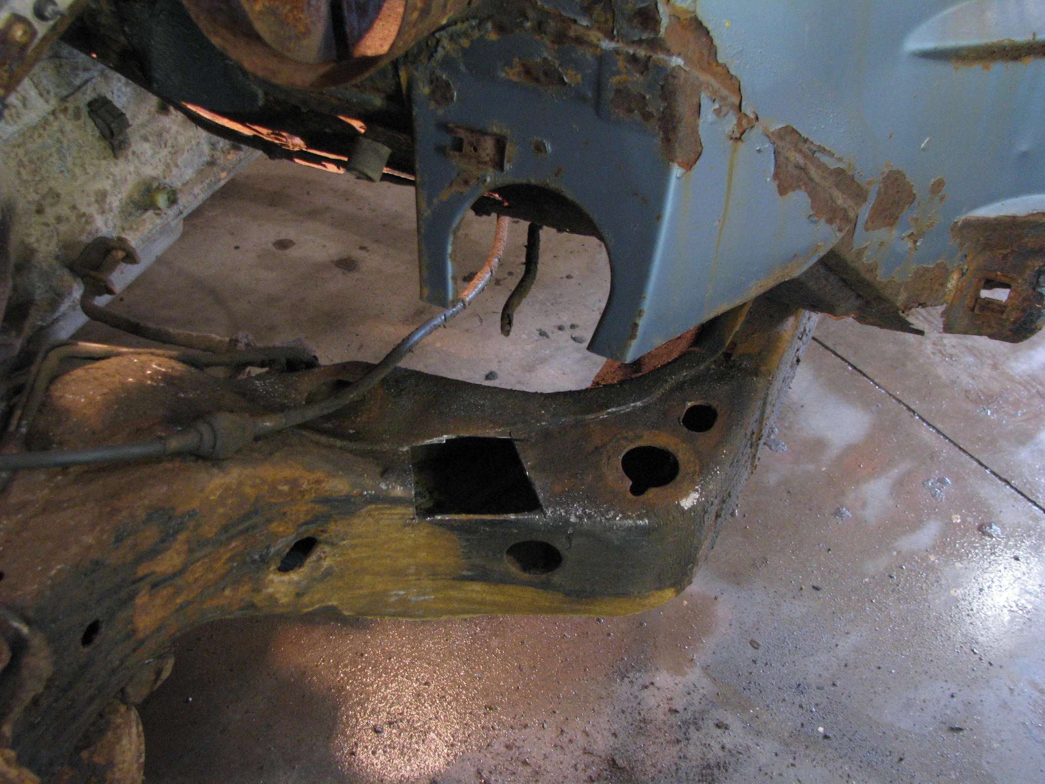

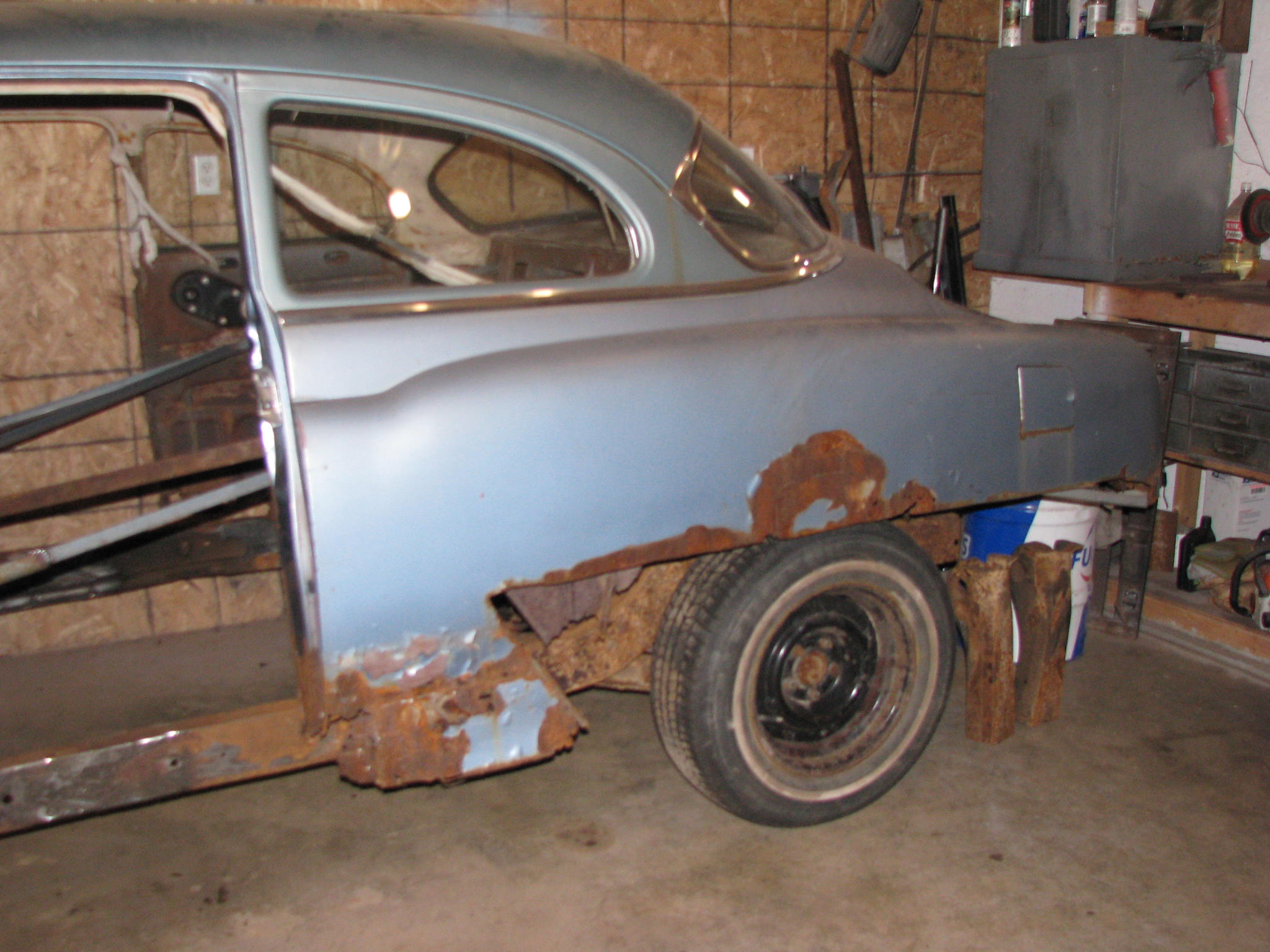

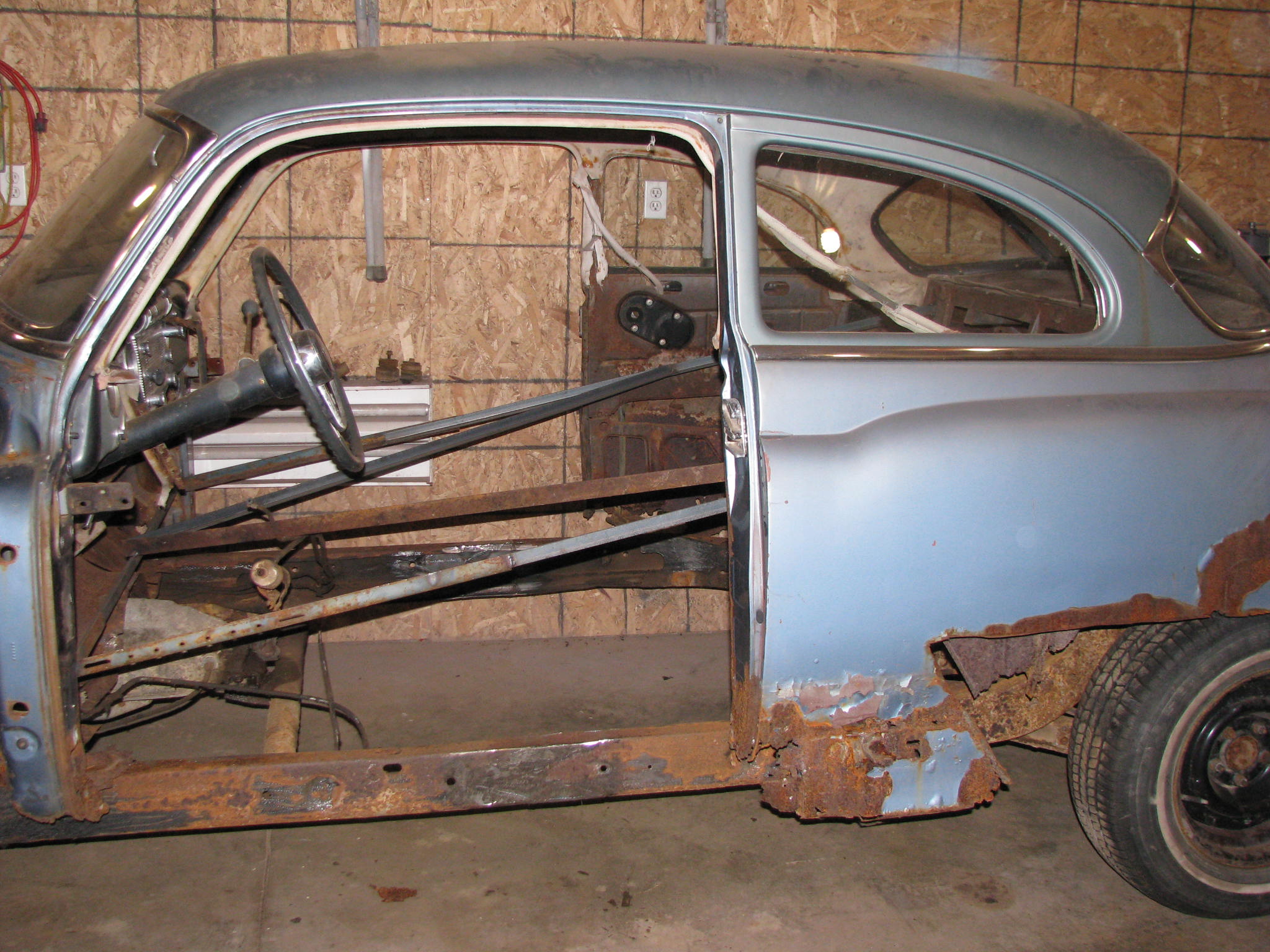

    Just another short note . I began to sink the body into the frame . You can see where the frame has been cut . On these GM frames the frame kicks up at this point . You need it to be flat for the buick body support to lay . As you can see I cut the body support and will section what I need out of it when I determine the amount I am going to channel the body over the frame. The third picture is the original main body A piller support that is currently supporting the body . I will section this piece as well . Its nice to see that it rest right on top of the frame . These two sectioned body supports will be what will hold the body to frame . This will mimic the 1951 body to frame mounting points . Thats it for now will post more as progress continues . :D

    Merc o I dont know the width of a Olds but I do know that the caprice is 57 1/2 outsid of frame to outside of frame above / below the trans crossmember . The frame of the caprice tapers back as you go from front to back . I think overall 3 inches but dont hold me to it !!!
