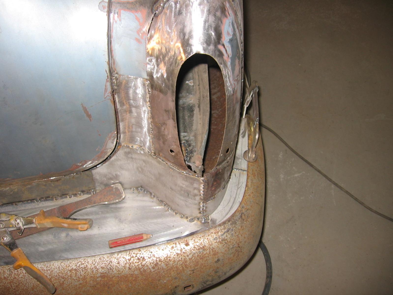

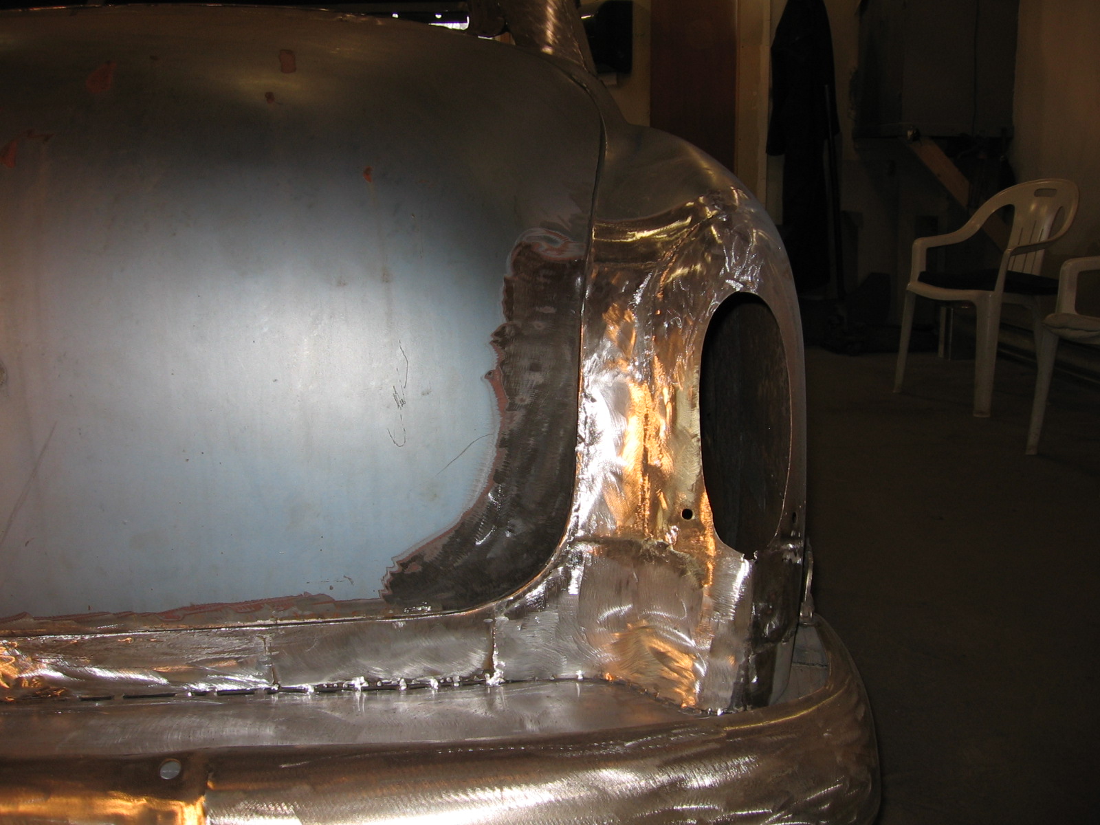

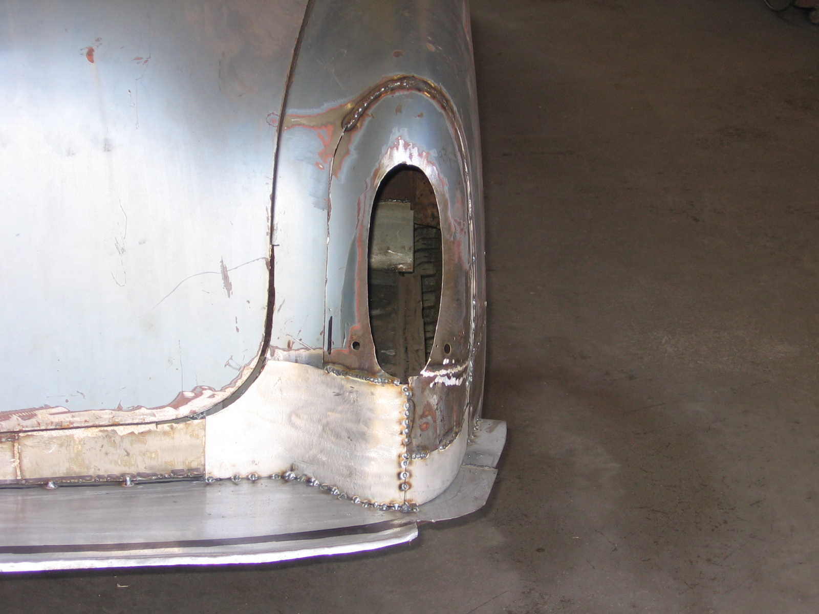

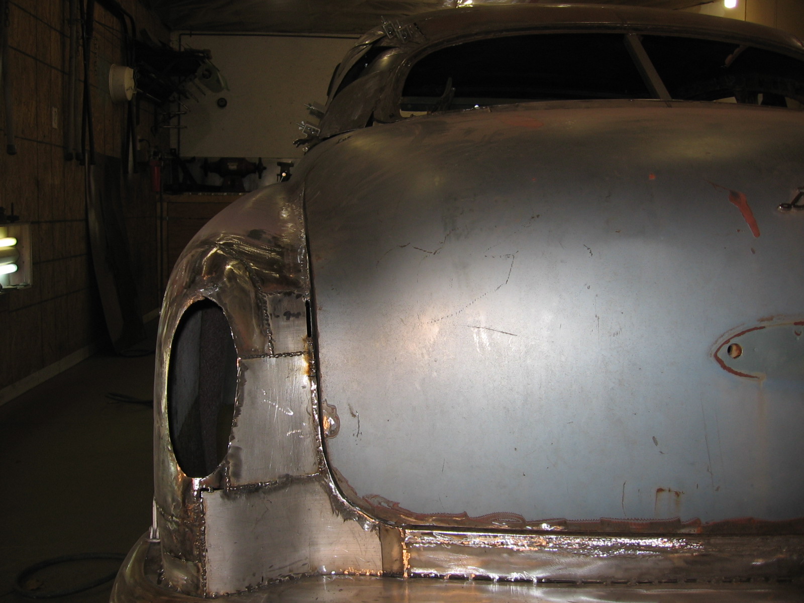

    Well there might be some that like viewing progress pictures even tohugh it is pretty much a carbon ofthe left side . So for those of you , here you are . The right side 75% completed . Have a look . Andy...

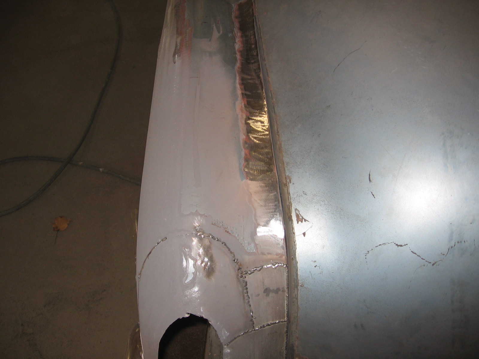

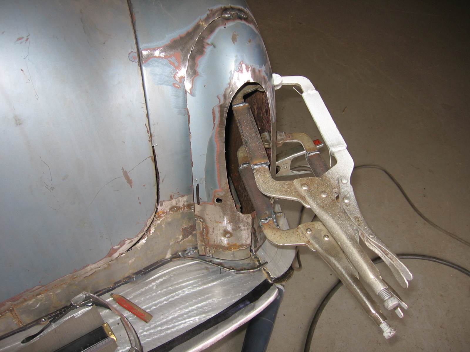

    A few more from today . Andy..

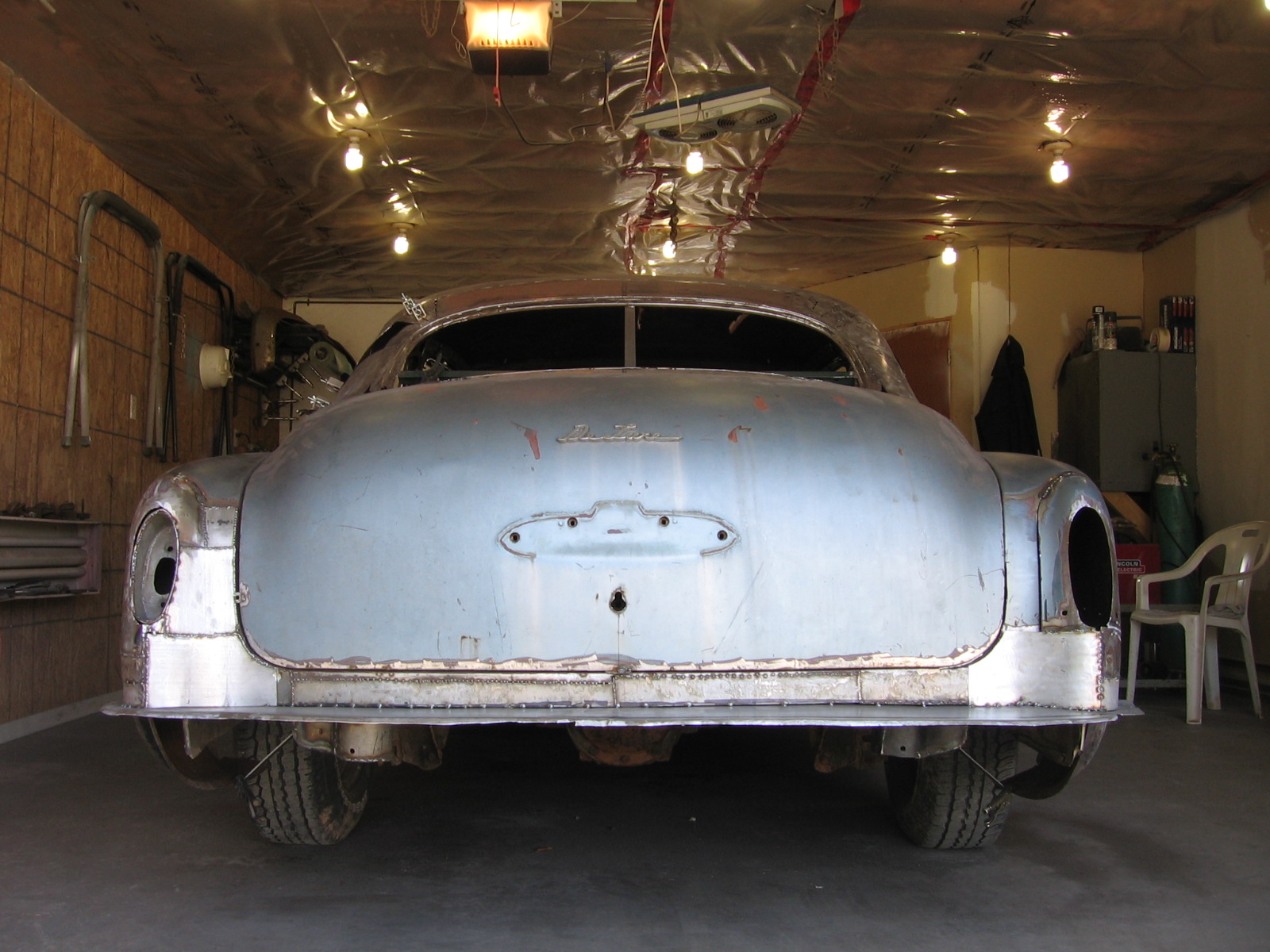

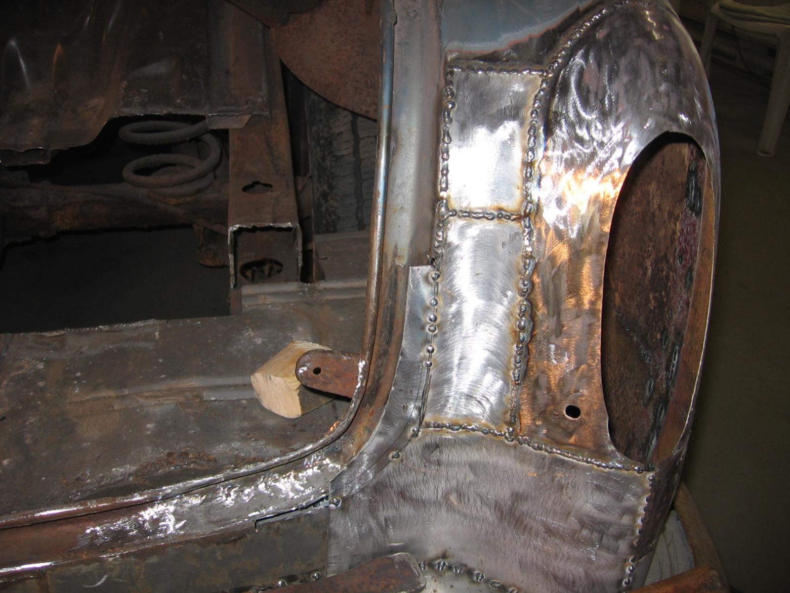

    Got a little accomplished this weekend . I worked on the rear bumper on Saturday . I spent 3 hours taking some kinks out and getting it to fit right . No pics but you cant take a picture of frustration , can you ? LOL Anyway today I ran a tap through the threaded adjustment plates for the trunklid and bolted it on . The gaps are good at the top and on the sides the lid is flush but the gaps get way off on the sides . I will have to cut along the trunk opening at the offending places and close up the gaps where needed . That comes later . In these pics you can see that I have closed up the quarter tailight surround on te p***enger side . I will have to wait to see the final profile result on the next fine day . I like what I see so far . I had to rework the lower right side panel to get the correct gap around the corner . Still a little fabrication and then a lot of finishing of these areas . Andy...

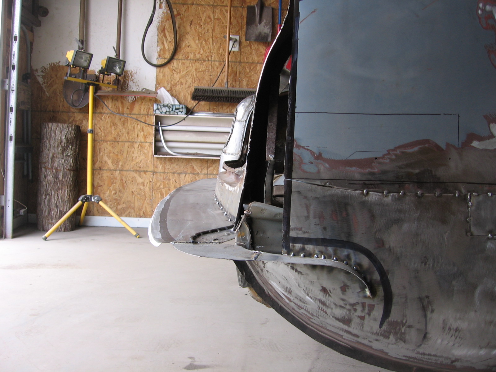

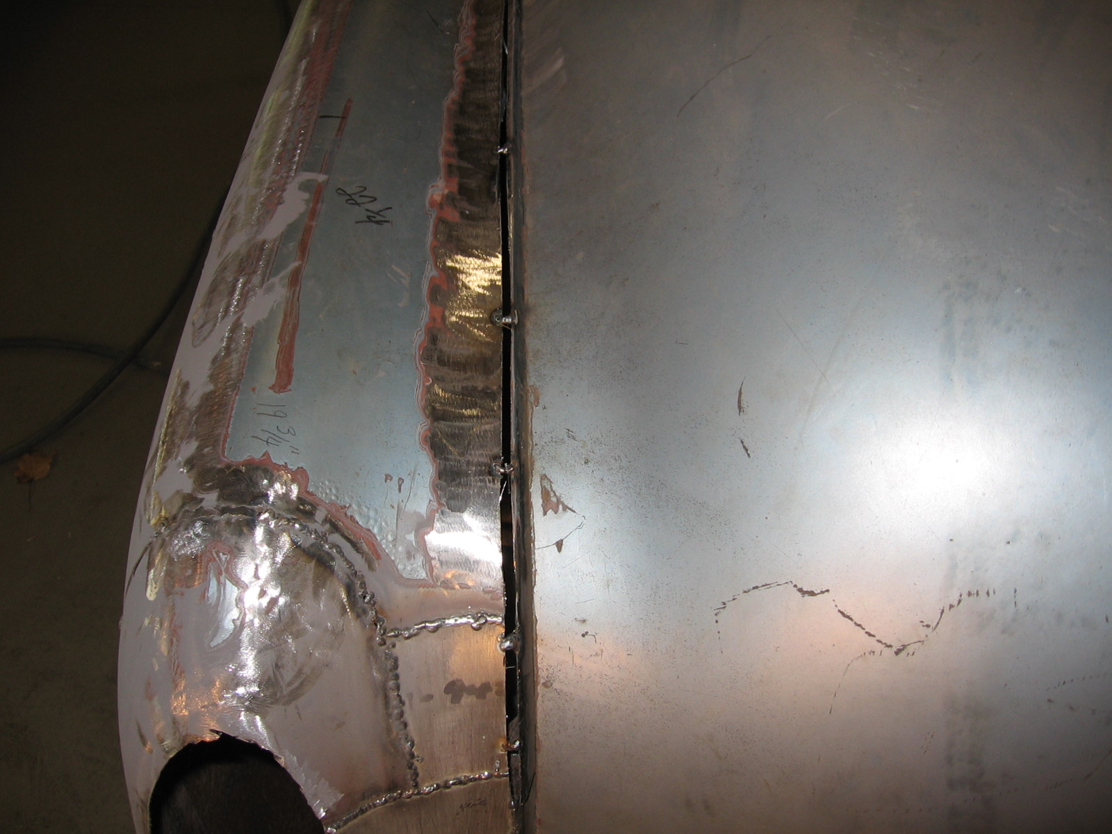

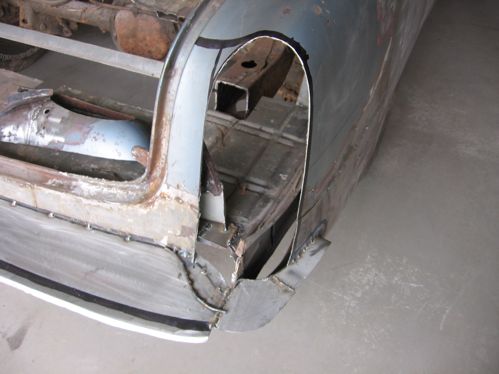

    Well movin along slow but sure . I had to cut the left rear quaterpanel at the side trunk opening . The gap was way off . Have a look . The first picture shows the wide gap it is at least 7/16 open . I cut it and brought it down to 3/16 . Its hard to explain but on the bottom corner I used 3/16 CRS to form the corner . It looks a lot better now . I see that I will have to do the Right side as well . Thats for another day . Andy...
