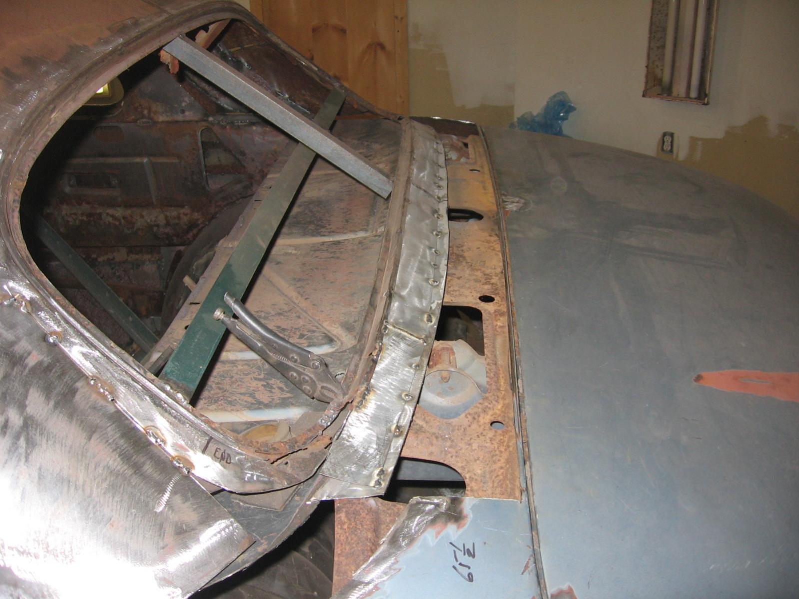

    Got some done today . I tackled the drive side of the roof back in line . I made a template of the roof on the pasenger side and compared it to the drive . I need to make longer slits in the roof for the roof to come down and flow right . I also cut off the driprails up to the doors . I was at a hotrod shop today and they did to a 49 Sedanette what I was planning and that was to cut the rails and run some 5/16 CRS to replace . They welded them on from the top . I will weld them on on the bottom of the rod and use seam sealer for a new driprail . Andy..

    Good on ya brother! Really admire you tackling the chop by yourself, not many who do that. Looking good!

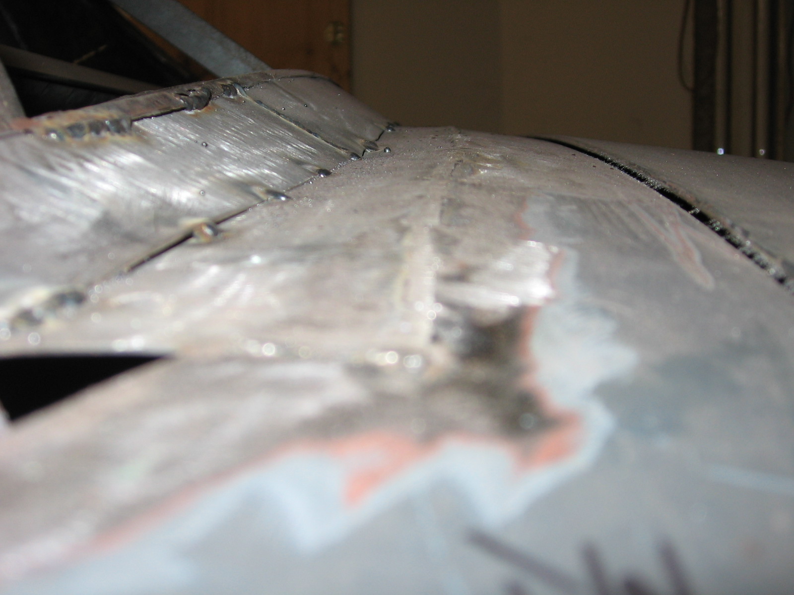

    Last night, I had a dream. I thought about all the grinding you ll have to do, and woke up crying . :p
    Nice idea the hooks for the home made Cleco ! I made mine also, and didn t think about this . Stupid simple and clever trick ....
    Doesn t the gap quite wide give any trouble to fill with a MIG ? Or do you use a copper plate ?

    Thanks Jimmy . I studied a lot of magazines and threads on here as well before the slice . Turning out good from my perspective so far . Lots of filling and grinding to go . Andy..
    LOL the dream thing is something I should be disturbed about . I made the panelclamps over the winter . I only have seven made up . If I need more I just make them as required . As for the wide gaps I do use a copper plate but I also will use sheetmetal and fill them that way as well .

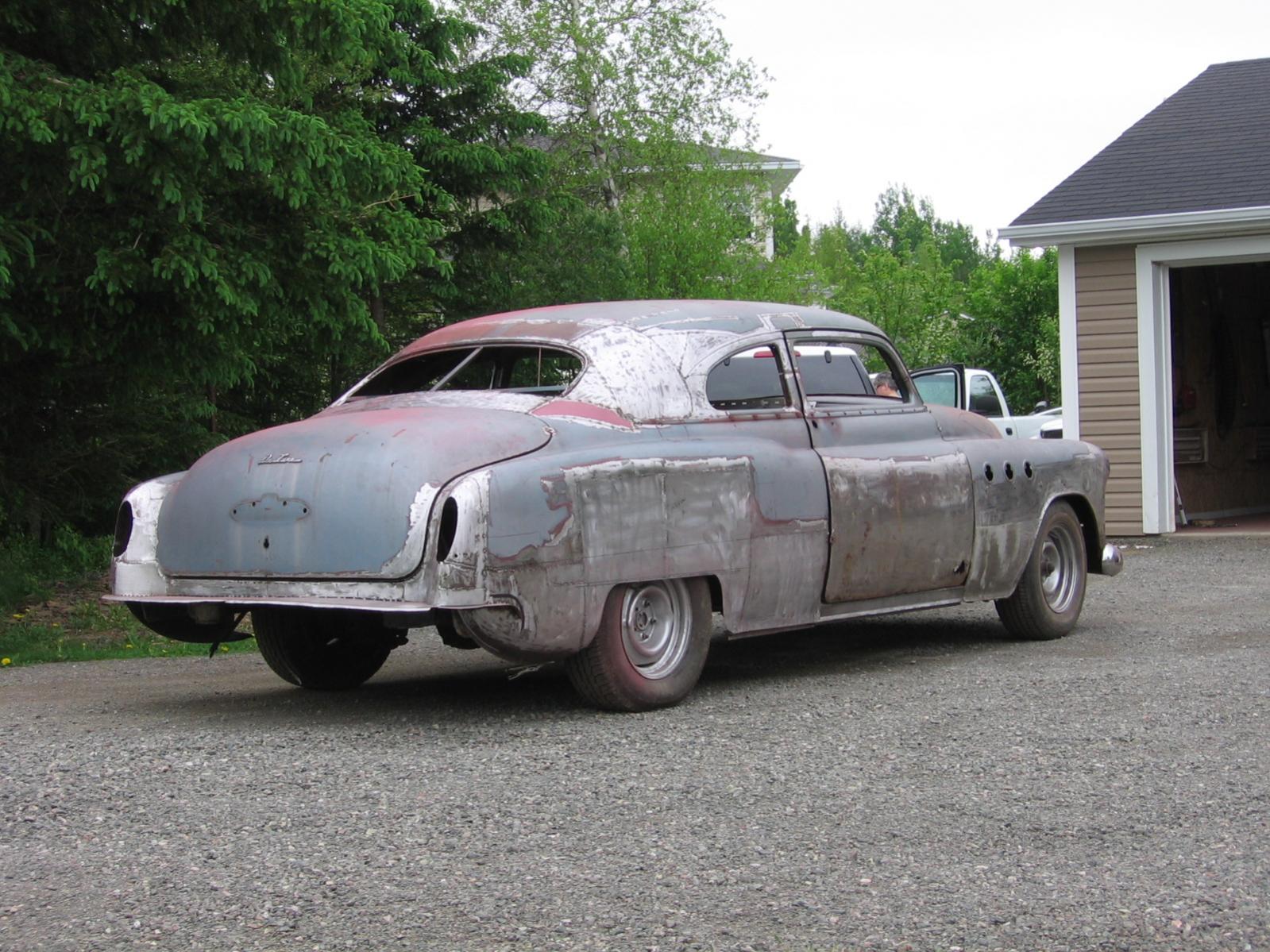

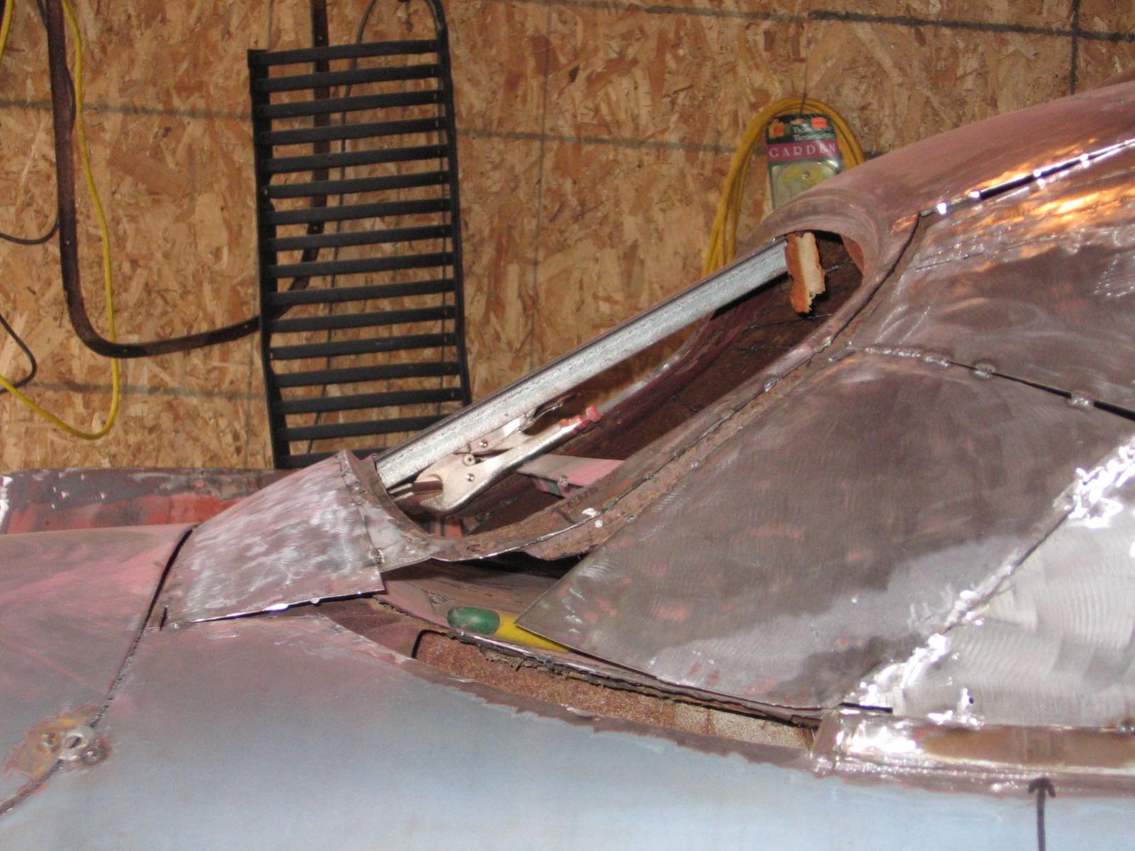

    Well I started to have another look at the rear sailpanel and the beltline trim wasn't going to work . So in these pics you see that I am starting to s***ch things together then I realized that as much as I kept denying it things weren't right . As Fitzee said some posts back these chev windows are not the best foe a chop because the lower corners want to dive under the plane of the outer skin . The deeper the chop the worse it gets . It looks good from the pictures but it is quite bad . More to come later this evening .

    So I cut the back window free and had to rework the angle of the rear . It flows on the same plane as the top part of the window right down to the trunk opening . This was the only option available and still be able to use the Buick beltline trim . I didnt want to lose the trim like so many other customs . I think I am almost there but then again I thought that a few months ago as well . The last pictures are of my score of parts from North Sydney NS . 1950 Buick 2 Dr sedan front and rear seats . A decent door for the right side and a 1949 Mercury bumperette / overider . I may throw that one on EBay as it is not wide enough to use on the Buick bumper . The door may look bad visiually but it is actually in better shape the my original door . I will blast it up patch it and hang it on the car at some point . I think I will get back into the B pillars and give them a lean forward , we'll see . Andy...

    Congrats on scoring your seats! I agree, they are a key component to the overall vibe. But you're making me break out in a rash fretting over your chop! Wwwwwhhhhhhoooooooaaaaaa, but that's a lot of work! :eek:

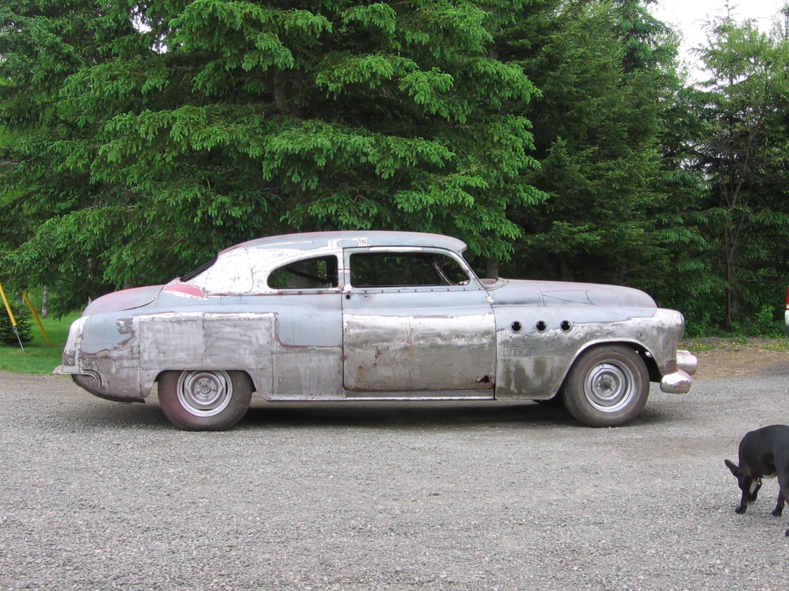

    Wheels are turning slow now that spring is in full swing wont get much done for a while now but this is the outcome so far . In the 3rd pic I am seeing that te rear window seems to small ??? If I rework the B pillars and slant them and angle the rear side window at the back a little more forward maybe then I will have it . What do you guys think ?? Andy...

    thanks for your input . i will be taking it all apart later and starting over . Even though you cant see it the roof is off to the right and is having a negative effect on the outcome of the chop on that side . I will have to remove the whole roof again and start over . I may take another inch out of the pillars . I think I would prefer a little deeper chop if I have a do over . We will see !! Andy

    Having trouble seeing what you're seeing Andy. Rear side window gl*** looks to be same size as front door gl***, no?
    I'm cringing here thinking about what you're about to do :eek:.
    Andy's Chop Top School of Hard Knocks. You, sir, have some gumption.

    Well ya know Jimmy when its not right its not right . I am sure there are lots of guys who have done something over again to set things right . I am not to thrilled with this setback but being my first ever attempted chop I should expect a few hard knocks now and then . LOL !!! Later , Andy...

    first of all man that is coming along nicely.. I see what your talking about in the third pic.. what I see is the rear section of the roof is to thick..If you moved the window back it will take the thickness out of it..

    As much as I hate to say it, due to the work it will involve, I agree that the window is just a bit too small. Or the C-pillar is too fat, however you want to view it. The shape isn't bad though.
    But the front 3/4 view of the car looks awesome!
