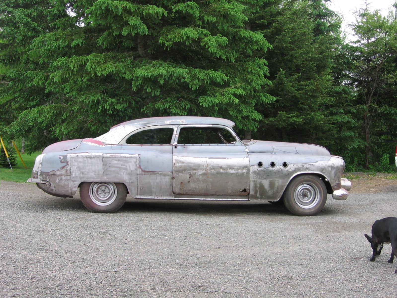

    That looks killer hacknwhack . And yes the proposed project would add more time to the build . I know what you mean by the short and fat back *** of this car . Maybe when I alter the roof again it will flow better . I want more slope to the roof , so off it comes . Andy...

    Cool sled. C pillar too fat indeed. slanting b pillar will help the rear quarter window and shrink front side window also; which would be good. lowering the rear of the roof (chopping rear more vs. front) and sliding a bigger rear backlight forward will also help. Easy for me to say :)

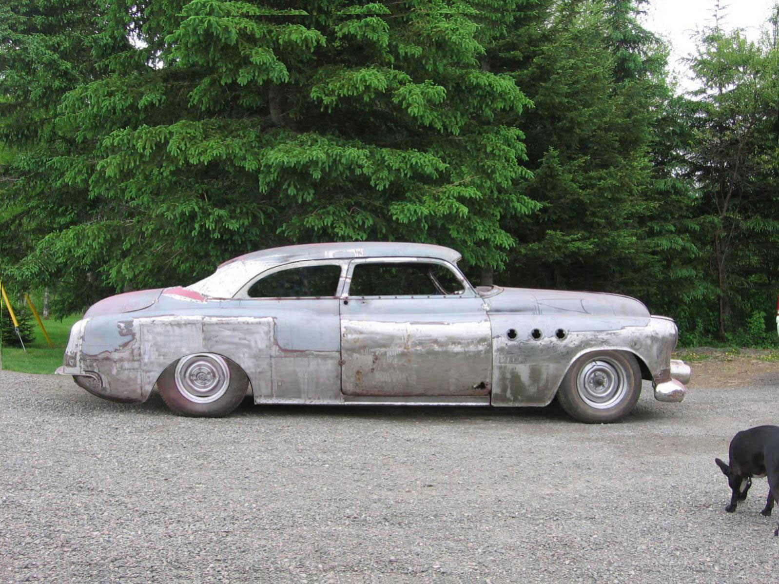

    Chopped cars just dont look right until they are lowered......:D

    Andy, not sure what style you wanted for skirts so if you have something specific in mind pm me a link to a pic. Also just so you know the pic I redid is chopped more in the rear than in the front and the trunk lid was sectioned some. A lot of work to match the pic but as far as you have went so far whats a rechop timewise in the whole project? Its only time right? :D

    LOL I dont think the wife would appreciate you chopping and sectioning her dog but I think its hilarous !! Andy PS thanks Doug for the skirts and lake pipes . I am not to sure now that I see a rendition with them on the car . I kinda like the Photoshop pic without . Indulge me one more time if you will . Same side profile , no skirt , lakepipes either and then radius the wheel arch like ( I believe ) a 55 or 56 Buick . I know you guys arent a big fan of radius . Lets see it anyway please so we can put that idea to bed also . Andy...

    With 1955 Buick rear wheel arch. Not a big fan of this look myself.

    Well boys and girls . I have to admit this chopping thing is a ***** if you dont take your time . Ask me how I know , Its all been removed and lowered another inch at the B pillar . It flows now, longer and sleeker . The old saying is true haste makes waste . Waste of time , effort , welding gas , wire , electricity , sheet metal, all in all a big **** up that is totally my fault . It only become obvious when I went to lay some metal on the C pillar p*** side . The B pillar on the drive side is at 18 degrees and the B pillar on the p***. side is only 15 degrees . That isn't cool , and it let me know in a hurry once I started to try and work the p***. side C pillar . No pictures yet , as I am ***hamed of the regression . It just looks like it did 4 months ago . Maybe in a few days I might be throwing up some new profile pictures . Later , Andy....
