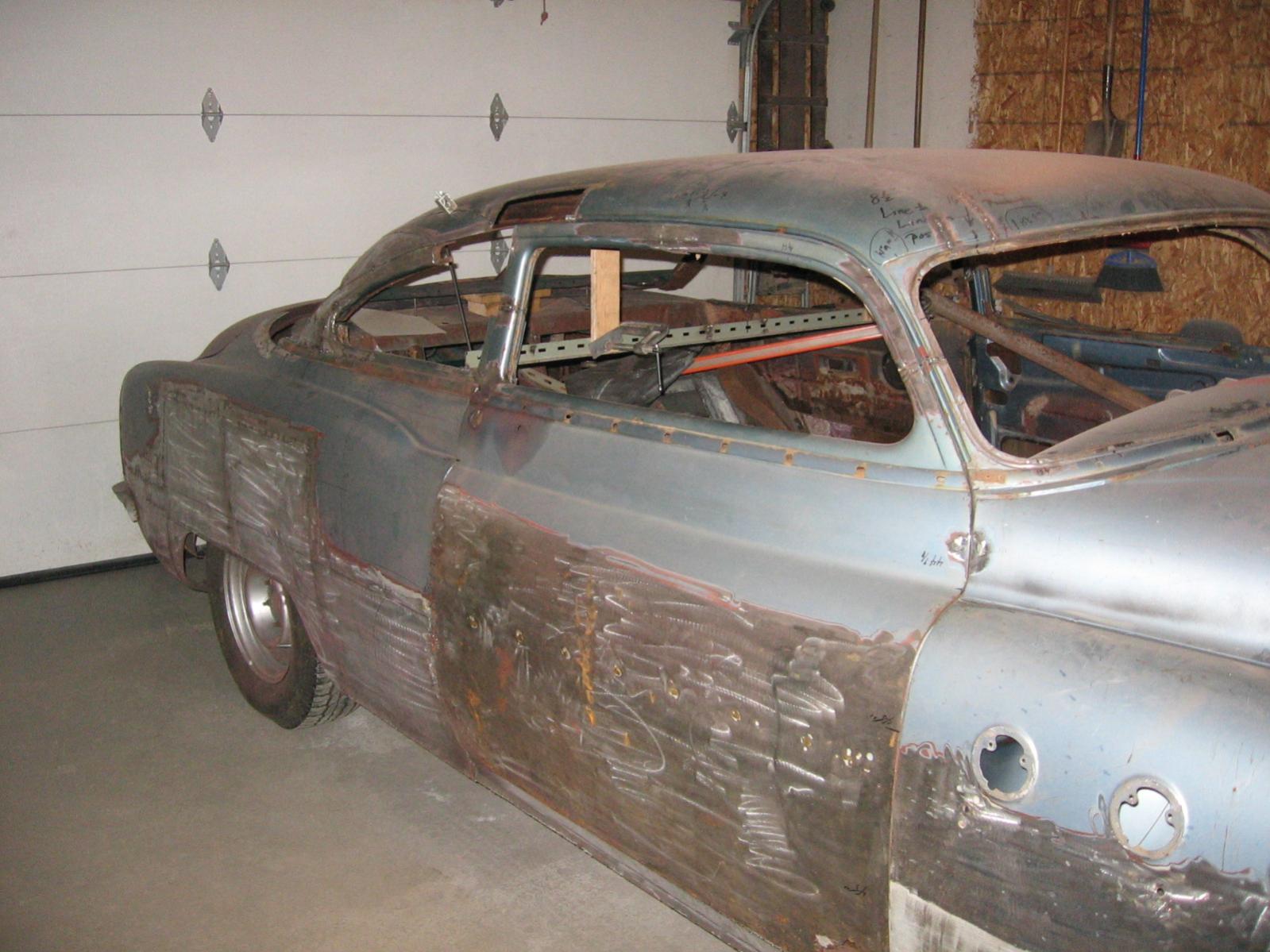

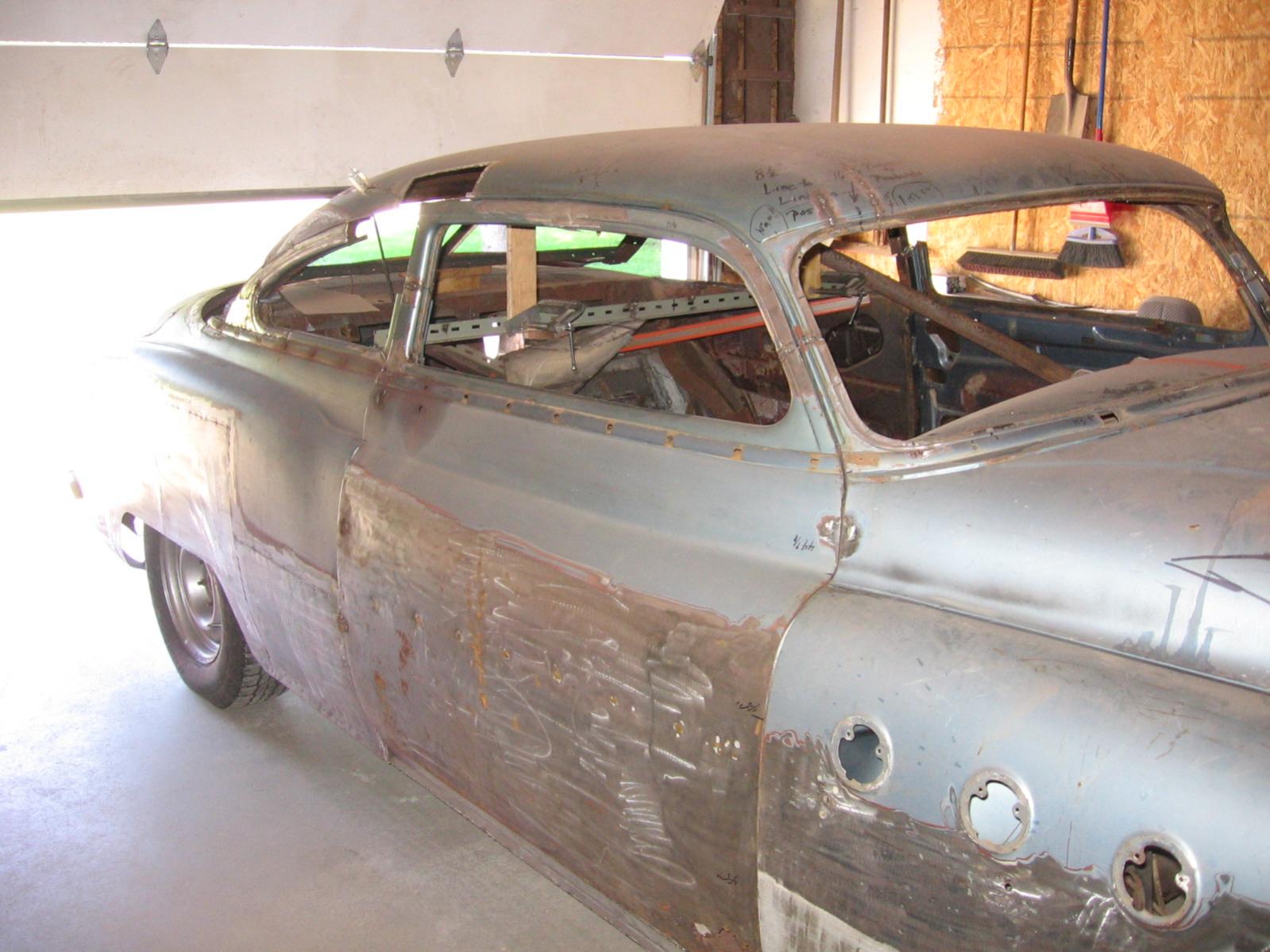

    Just a quick update . Some pics . I like the profile better for sure . A lot of work though . I removed 1 more inch on the chop . Not the windshield though .

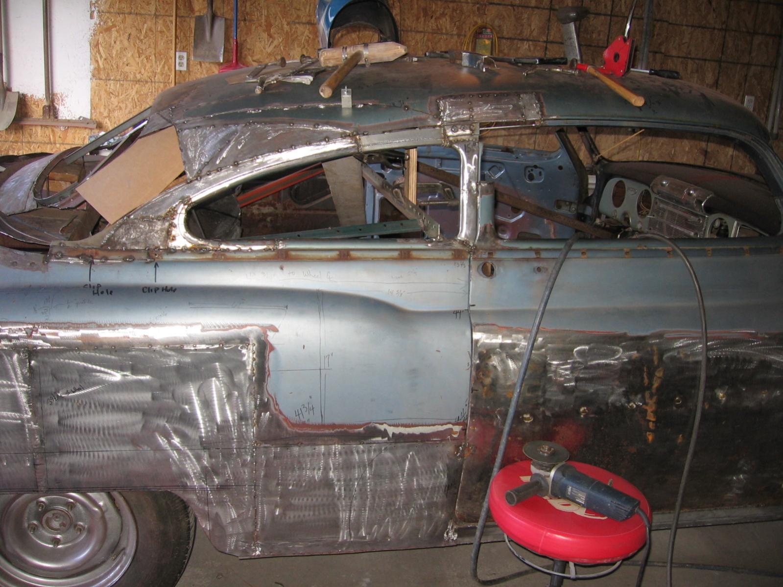

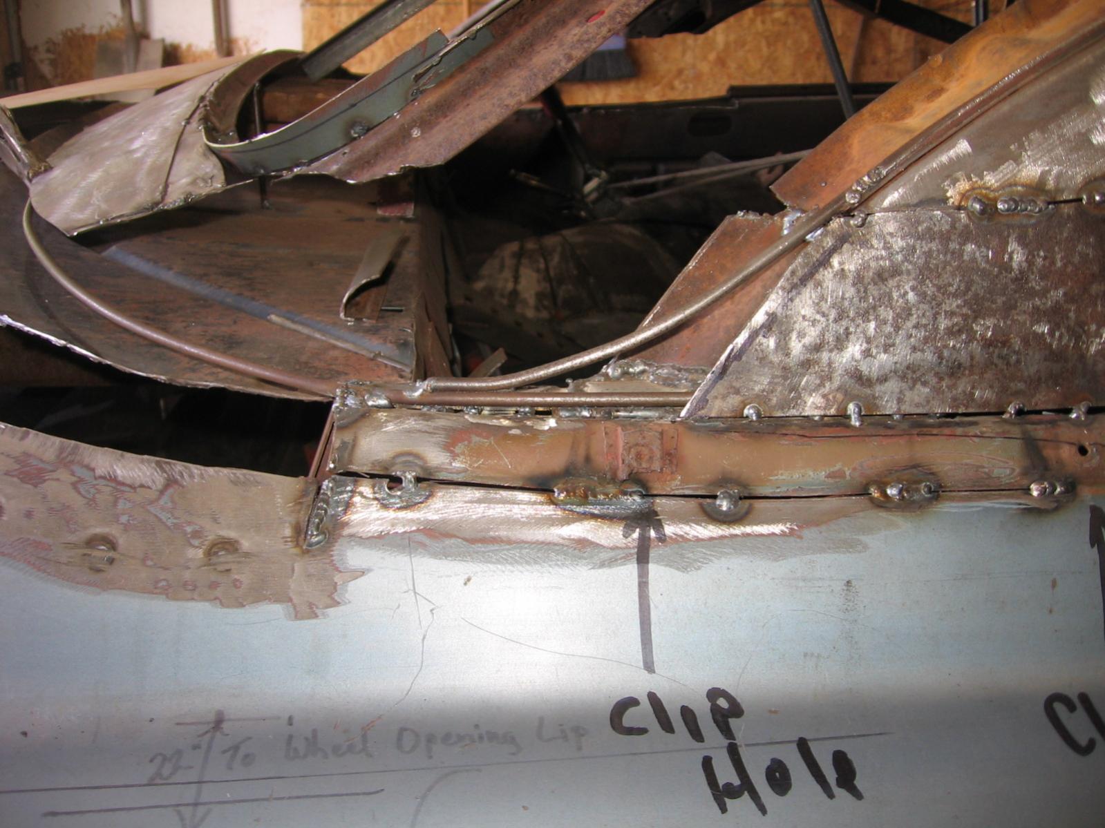

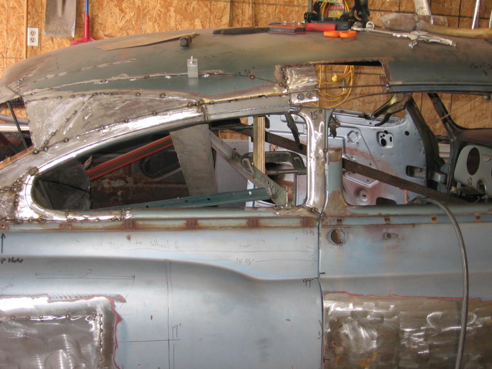

    A few more pics of the rechop progress . There is 8 hours on this section alone believe it or not . Very slow and arduous to say the least . Just have to plug away at it and it will get done . Had to reshape the door opening but no pics of that . Had to make a 6.5 inch piece that filled the elongated window opening . There is a swage line in that piece as well that I needed to form into it . Maybe you an see it ??? I am using 3/16 CRS to preform the window openings . I dont think I took any pics of that either . Have a look . Andy

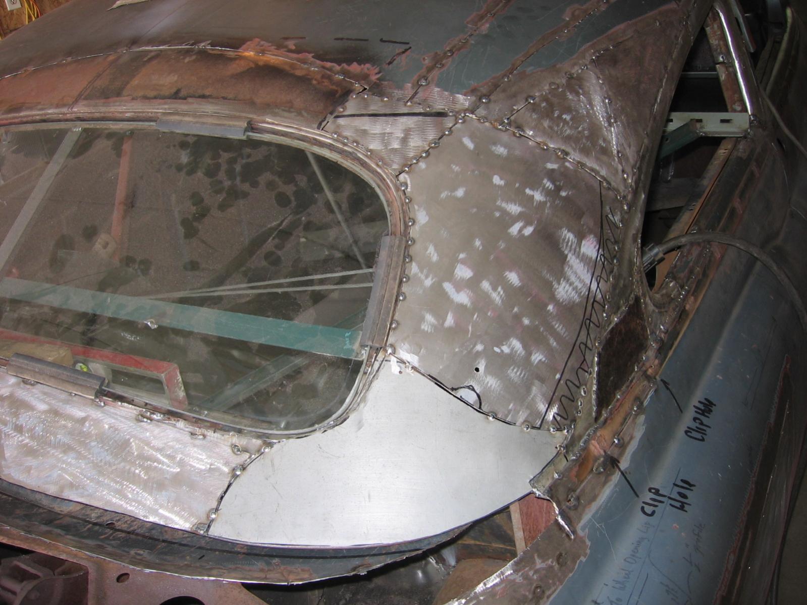

    Got some more done today , and Sunday before work . Seems like a full day of work already doing this stuff . Lots to think about . Off to my rael job so I can relax, LOL !! I am liking the profile and the larger rear side window a lot better . I am not going to slant the B pillars but maybe will round the door tops . Thats not so labor intensive and still gives the illusion of slanted B pillars .Thats for later . I think my biggest mistake previously was the fact I was trying to keep the stock 51 Buick beltline trim and it was not going to work with the 51 Chevrolet Coupe rear gl*** as it is 20 % narrower than the Buick . So had to let that idea go and we'll see what I come up with for trim in the future. Andy...

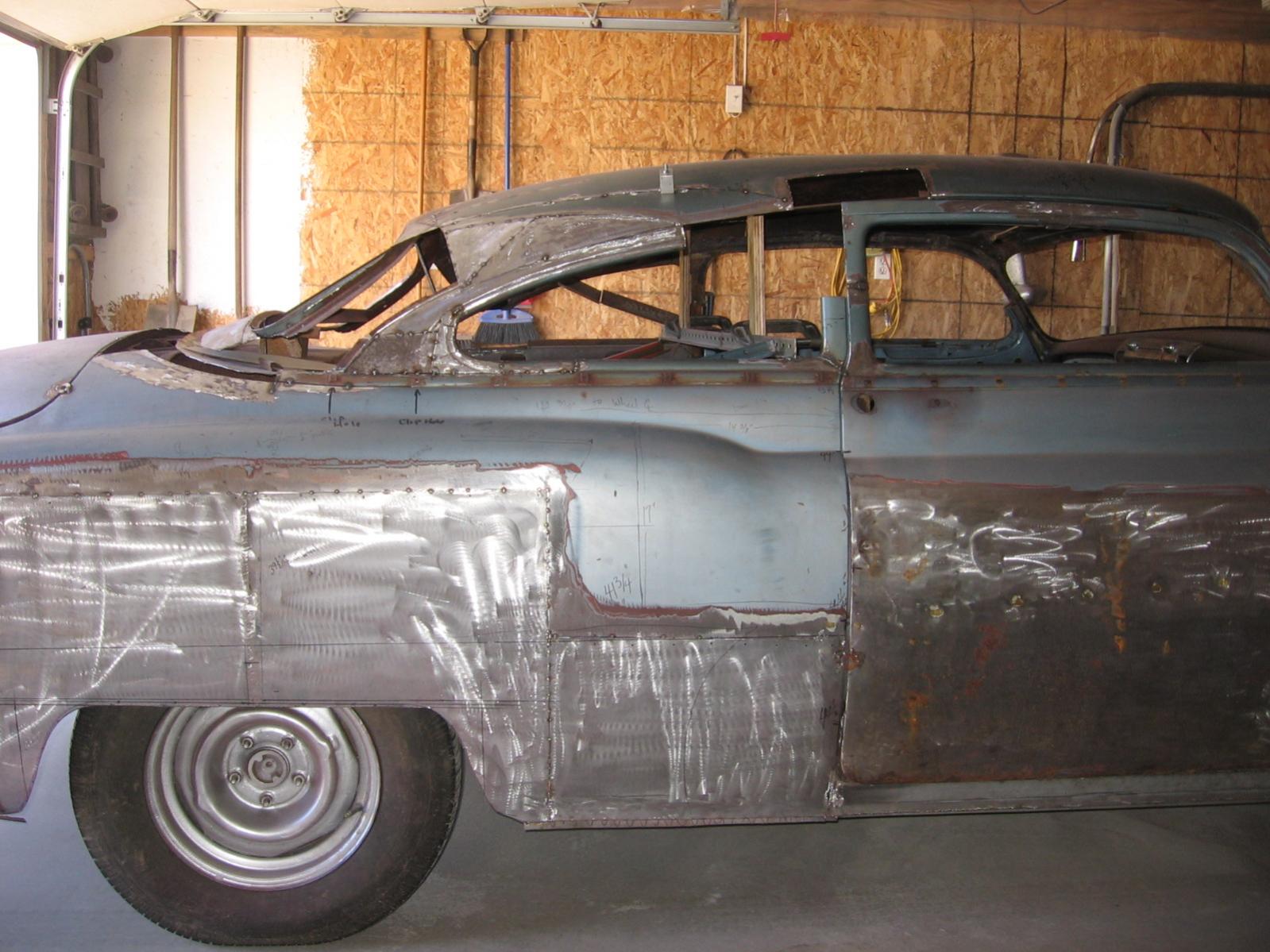

    Some more progress . Slow but sure coming back together . Andy...

    Its not likely going to happen . I have enough going on with this rechop . I like the non slanted look that Racerdad photoshoped for me a couple pages back . I may round the door tops though . That will give the illusion of slanted B pillars somewhat . With the rear sidegl*** elongated now the flow of the roofline is much better now . Hopefully I will get some time on the car tomorrow . Andy...

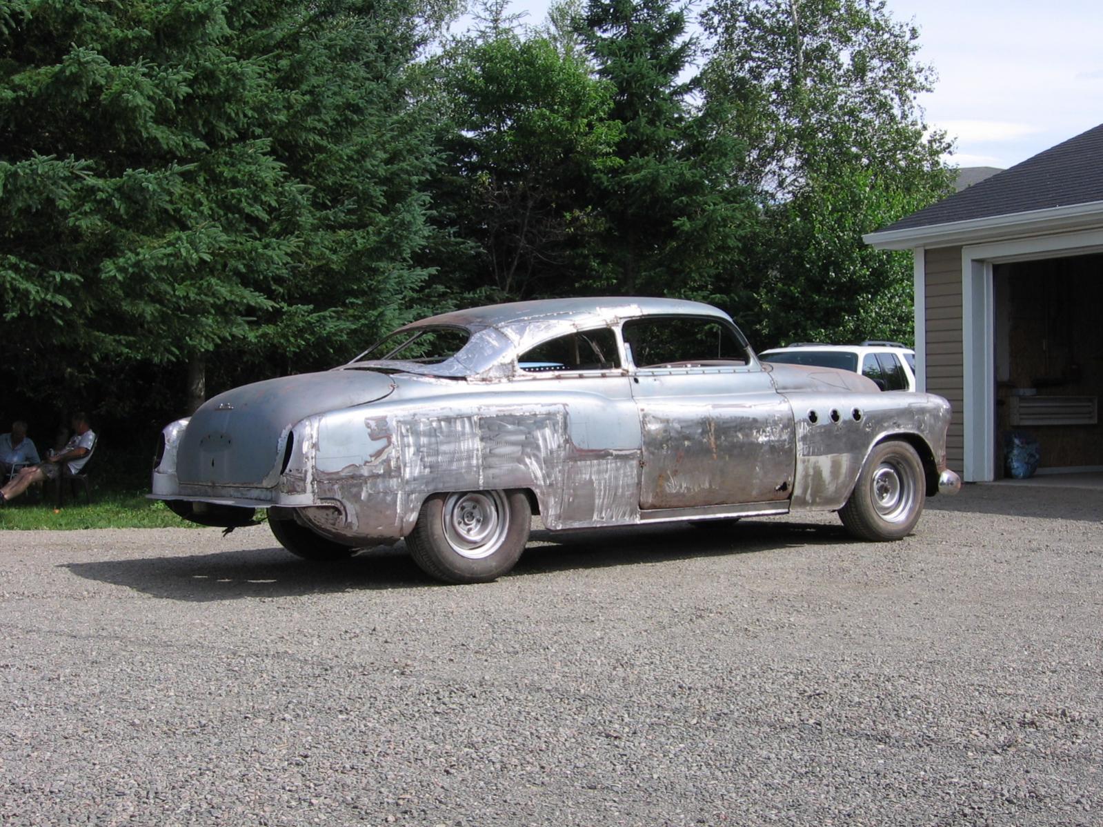

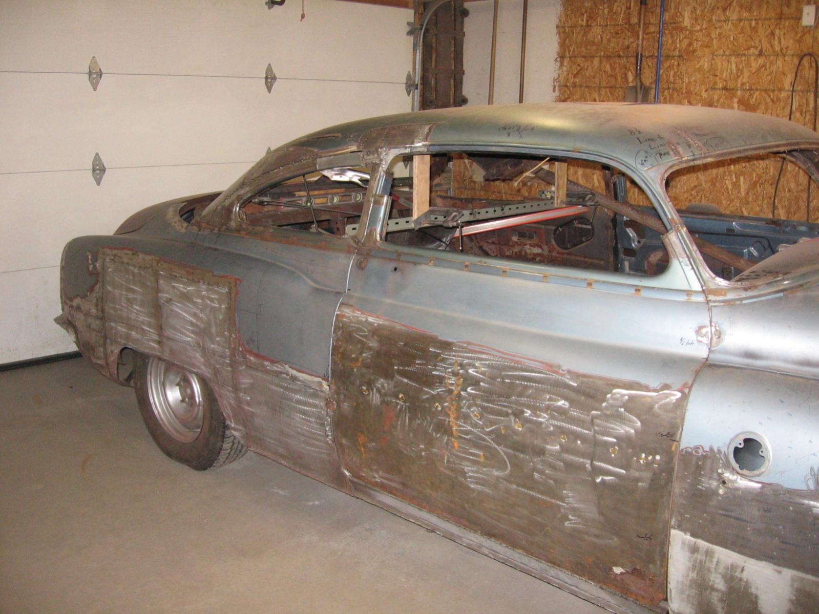

    Cleaned the shop today . No work was done on the Buick but a buddy showed up with his 56 Ford . Its a Kansas car so it has minimal rust . I painted it 4 years ago and we will be shooting it again next year as there are a few spots that need attention . Getting to the profile of the Buick now , thats a lot better wouldn't you say ? The elongated window looks good . I am pleased so far with the rechop . I am glad I cut another inch out of the profile . Andy.. PS the first picture is what I had to start from again last week only it was on the p***enger side . Now you know why I was having a ****fest .
